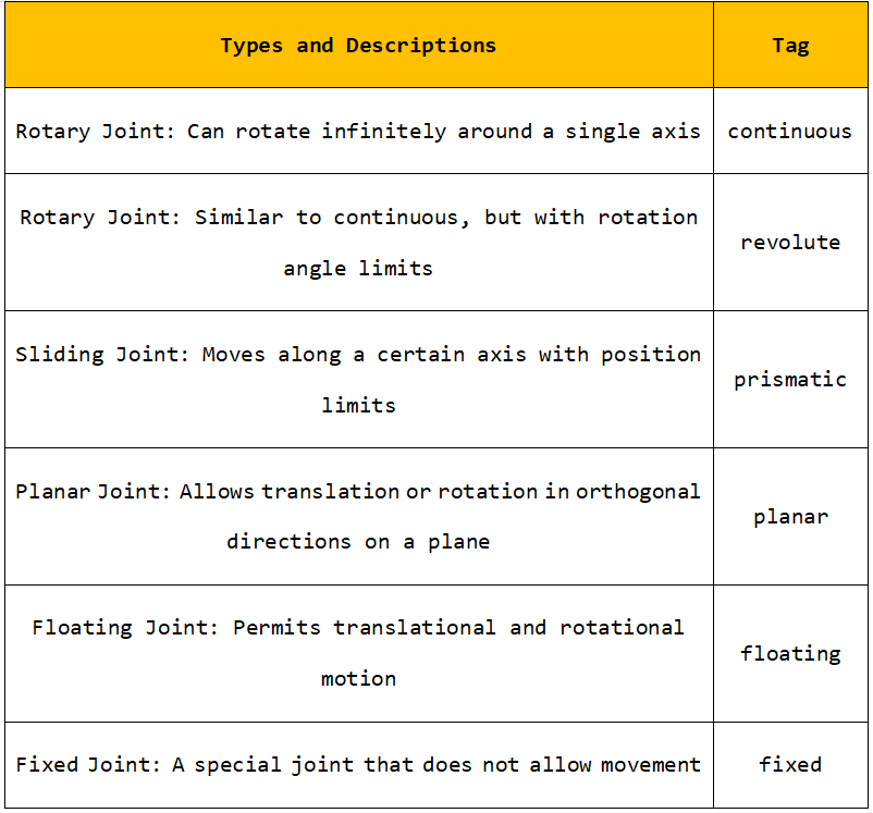

(3) Set joint
① To write the first joint, use indentation to indicate that the joint belongs to the current model being set. Then, specify the name and type of the joint as follows: “<joint name=’joint name’ type=’joint type’>”. Finally, include “</joint>” to indicate the completion of the joint definition.
to learn about the type of the joint, please refer to “6.1.3 Basic Syntax of URDF Model -> joint”.

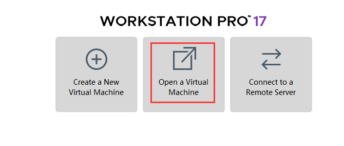

(3) Open a virtual machine.

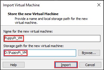

(4) Navigate to the location where the virtual machine was extracted, select the “PuppyPi_VM.ovf” file, and click “Open”.
(5) Click “Browse” to set the virtual machine storage path. It is recommended to store it on a solid-state drive (SSD), as the read/write speed of the storage drive will affect the virtual machine’s performance. Finally, click “Import”.
(6) Click “Power on this Virtual Machine” to run it.

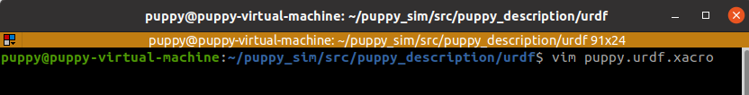

6.2.2 Open Robot Dog URDF Model File

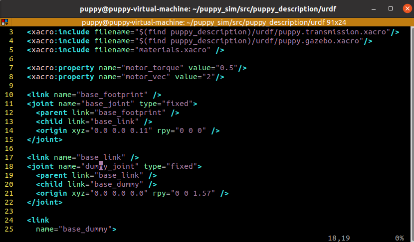

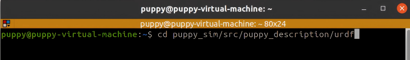

(1) In the Ubuntu system of the VMware virtual machine, press “Ctrl+Alt+T” to open the terminal. Then, enter the following command to navigate to the folder where the URDF model is stored:cd puppy_sim/src/puppy_description/urdf.
(2) For example, to open the robot dog’s URDF model, enter the following command in this directory:
vim puppy.urdf.xacro
(3) If the screen appears as shown below, it confirms that the PuppyPi robot dog’s URDF model file has been successfully opened.

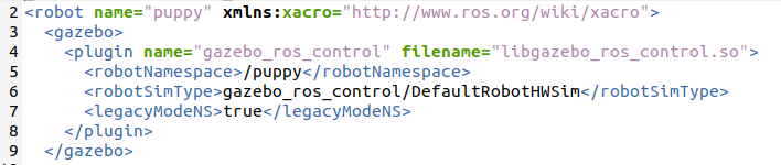

This section is primarily used to define the physical characteristics, joint controls, sensors, and other information of the robot’s components for simulation, control, and testing in the Gazebo environment. Since the code is relatively long, it will be divided into three parts for easier explanation, covering the following sections:
(1) Gazebo Plugin Definition
This section defines a Gazebo plugin, “gazebo_ros_control”, which is used for controlling the robot. The actual implementation of this plugin is provided by the library “libgazebo_ros_control.so”. Additionally, it sets the Gazebo simulation type and defines the namespace for the robot model.

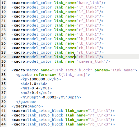

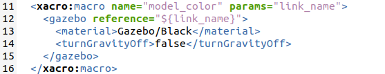

(2) Macro Definitions
This section defines several Xacro macros, which are used to easily set the color and physical properties of the robot’s links. The “model_color” macro is used to set the color of a link, while the “link_setup_block” macro is used to define the physical properties of a link.
(3) Using Macro
Use the following macros to set the color and physical properties of each link in the robot model. The “model_color” macro simplifies the process of setting the link’s color. This macro accepts a link_name parameter and assigns the specified link a black material while enabling gravity for that link.

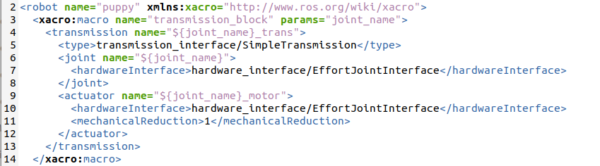

  • Analysis of puppy.transmissions.xacro
The transmissions.xacro file defines the transmission system within the robot model, including the transmission methods between joints and motors. During runtime, ROS will convert the ‘transmissions.xacro’ file into the robot’s transmission system. This file consists of the following two main parts:
(1) Xacro Macro Definitions
Xacro macros are used to define templates for the transmission system using the <xacro:macro> tag. The <transmission> tag specifies the type and name of the transmission system, the <joint> tag defines the joint actuator interface, and the <actuator> tag sets the mechanical reduction ratio and other related properties.
(2) Defining Different Transmission Types
The transmission block Xacro macro is invoked to define the corresponding transmission for each joint. This allows the robot’s transmission system to be consistently defined through configuration files.

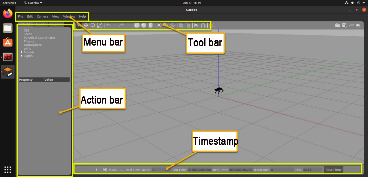

6.3 Gazebo Introduction
6.3.1 Gazebo Introduction
Gazebo is a 3D dynamic simulator that accurately and effectively simulates robots in complex indoor and outdoor environments. Similar to game engines providing high-fidelity visual simulation, Gazebo offers high-fidelity physics simulation. It provides a comprehensive set of sensor models and a user-friendly interaction method for both users and programs.

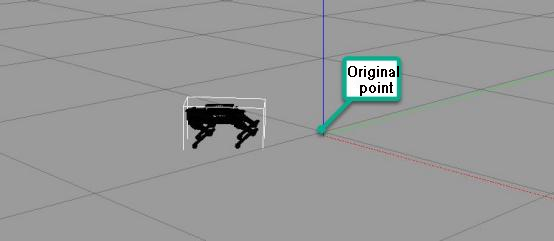

(1) World Coordinate System
The World Coordinate System is a stationary reference coordinate system located on the ‘ground.’ It undergoes no translation or rotation changes over time. Of course, here, the term ‘ground’ is broadly defined. For example, if the robot is on a tabletop, the world coordinate system would be situated on the plane of that table.

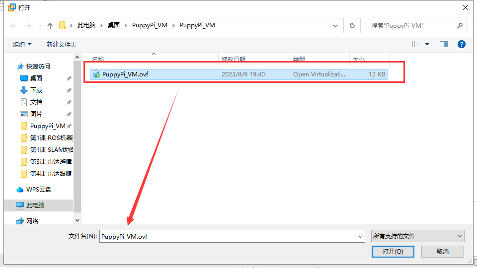

(4) Navigate to the extracted virtual machine directory, select ‘PuppyPi_VM,.ovf’, and click “Open”.
(5) Click “Browse” to set the storage path for the virtual machine. It is recommended to use an SSD (Solid State Drive) for storage, as the read/write speed of the storage disk will affect the performance of the virtual machine. Finally, click “Import”.

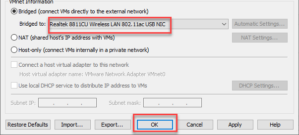

(2) After successfully connecting to the hotspot, open VMware and click “Edit > Virtual Network Editor” in the menu.
(3) In the network card list under “Bridge Mode”, select the wireless network adapter of your computer. The name of the wireless network adapter may vary by device but typically includes “802.11ac” in its name. Select the adapter with “802.11ac”, and click “OK” to confirm.

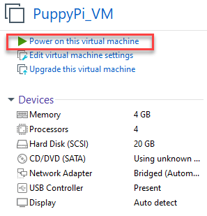

(4) Click “Power on this Virtual Machine” and wait for the boot process to complete.

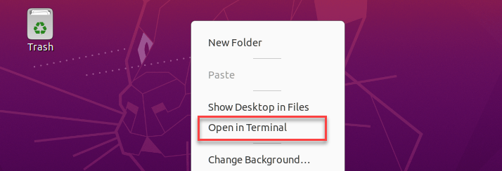

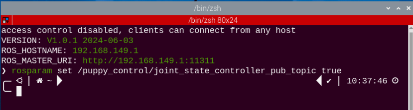

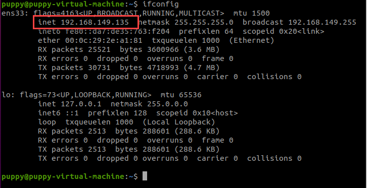

(5) Once on the Ubuntu desktop, right-click anywhere, select “Open in Terminal” to launch the terminal.
(6) Enter the following command and press Enter. The red box in the terminal output will display the IP address of the Ubuntu system.
ifconfig
If the IP address is not displayed after entering the ifconfig command, please check whether you are properly connected to the Puppy hotspot. If the connection is correct but the IP is still not found, you can manually obtain the IP address by entering the command sudo dhclient ens33. By default, ens33 is the name of the network interface.

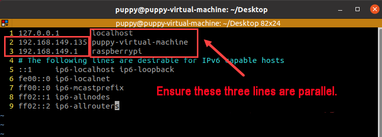

6.4.3 Confirm System Environment
(1) Go to the Ubuntu desktop, right-click, and select “Open in Terminal” to open the command line.
(2) In the terminal, enter the following command to open the network configuration file:
sudo vim /etc/hosts
(3) Replace the IP addresses on lines 2 and 3 (shown in the image) with the IP addresses of the virtual machine and Raspberry Pi.
• Ensure that the indentation of the new IP addresses matches that of the previous lines. • In direct connection mode, the default IP of PuppyPi is 192.168.149.1.
(4) Enter the following command to update the configuration.
source ~/.bashrc
(5) Access VNC, open the terminal, and enter the following command to send PuppyPi’s action data to Gazebo:
rosparam set /puppy_control/joint_state_controller_pub_topic true

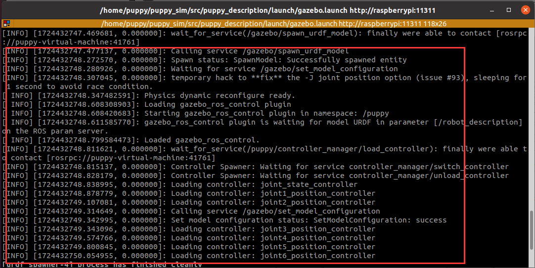

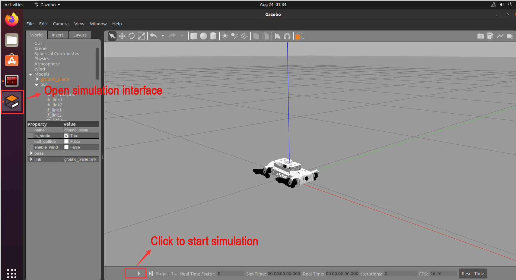

6.4.4 Start Gazebo Simulation Tool
(1) In the virtual machine terminal, enter the following command to launch Gazebo simulation and wait for the service to start. If the content shown in the image below appears, it means that Gazebo has successfully started:
roslaunch puppy_description gazebo.launch
(2) Click the Gazebo simulation software icon on the left taskbar of the Ubuntu system page to enter the simulation interface. Then, click the “Start” button at the bottom of the Gazebo simulation page to begin the simulation.
6.4.5 Gazebo GUI Introduction
The simulation interface is as below:
Name Function
Menu Bar Used for configuring or modifying simulation software parameters, and for various interactive features.
Toolbar Provides the most commonly used options for interacting with the simulator.
Timestamp Allows you to control the time within the virtual space
Action Bar Allows you to manipulate the model and modify parameters
Scene The main section of the simulator, where the simulation models are displayed

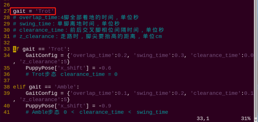

(1) First, go back to the VNC and enter the following command to check if the gait is set to Trot:
rosed puppy_control puppy_demo.py
(2) Next, enter the following command and press Enter to start the Trot gait:
rosrun puppy_control puppy_demo.py
(3) You will observe that the robot dog starts running with the Trot gait, and it begins to move in the simulation software as well.
(4) By default, the program is set to the Trot gait. If you want to switch to another gait, enter the command in VNC to locate the section in the code shown below. For example, to change to the Amble gait, replace gait = 'Trot' with "gait = 'Amble'".
(5) Press “ESC” to enter the command mode, then type “:wq” to save the changes:
:wq
