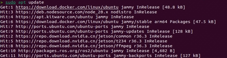

(1) Environment Configuration
sudo apt update
sudo apt install vim
sudo apt install gedit
sudo apt install python3 python3-pip python3-all-dev python3-pyaudio portaudio34.dev libsndfile1

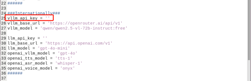

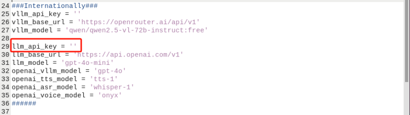

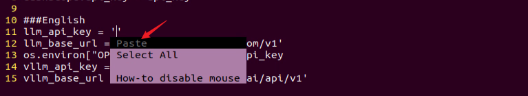

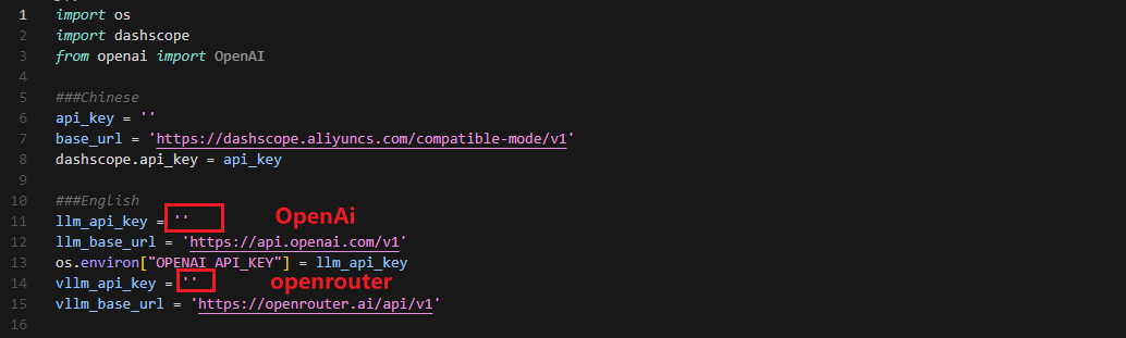

(3) Key Configuration
cd ~/large_models
vim config.py
③ Once the file is open, configure the OpenAI and OpenRouter keys by filling in the llm_api_key and vllm_api_key parameters, respectively (you can obtain these keys from the ‘34.1.1 Large Language Model Courses -> Large Language Model Deployment’ course).
:wq

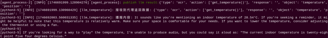

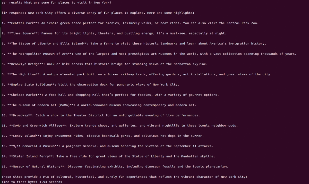

(4) Running the Demo Program
python3 openai_llm_demo.py

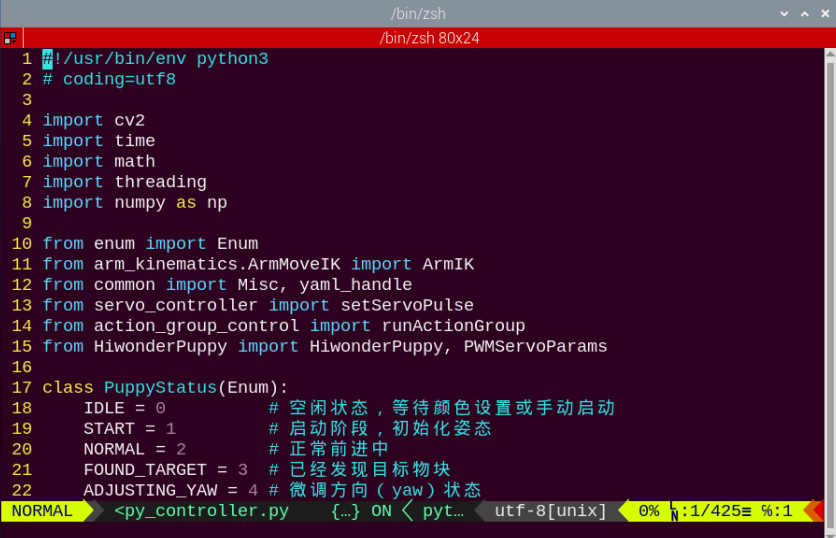

vim wakeup_demo.py
Device Check:
Wake-Up Test:
② Press i to enter edit mode.
③ Update the port to match the device port number you previously identified. Comment out the WonderEcho Pro configuration (add # at the beginning of the corresponding line), and uncomment the line using the circular microphone array on line 11 as the input device (see red box in the referenced image).

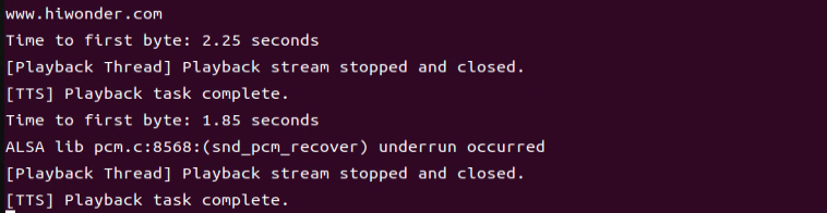

python3 openai_tts_demo.py
(5) Function Realization
Upon running the program, it will play an audio message saying “Hello, Can I Help You”, and simultaneously save the audio file with the same content to the following directory: /home/ubuntu/large_models/resources/audio/

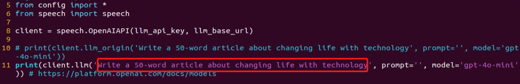

③ Function Extension
vim openai_tts_demo.py
i
:wq

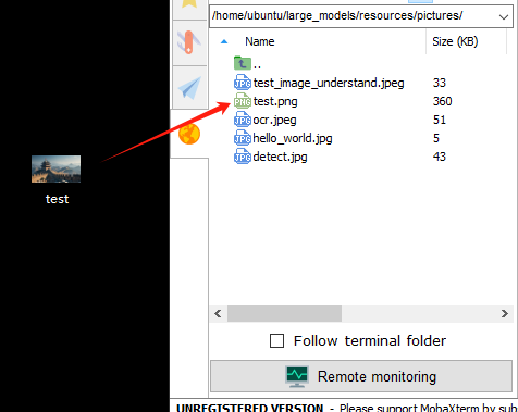

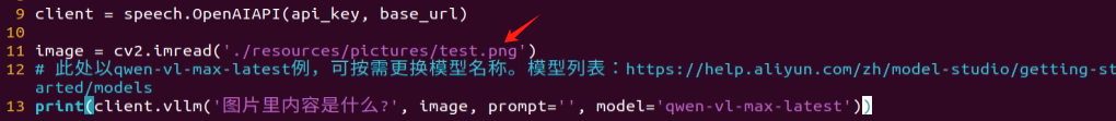

(3) Function Expansion
Change Pictures:
② Then, input the command:
i

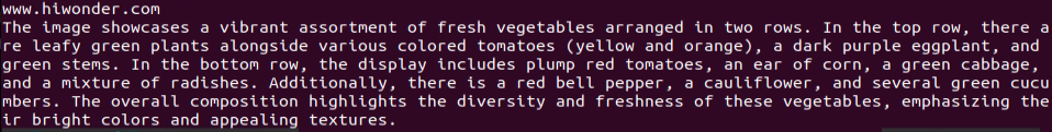

  • This section requires the configuration of the API key in “34.1.1 Large Language Model Courses -> Large Language Model Deployment” before proceeding. Additionally, ensure that the images to be used in this section are imported.
(1) Experiment Steps
cd large_models/
② Run the program:
python3 openai_vllm_ocr.py
(2) Function Realization

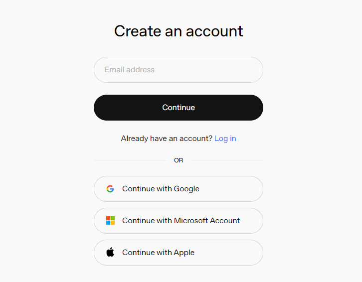

  • OpenAI Registration

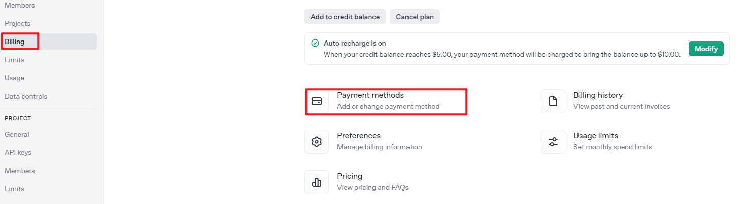

(1) Visit the following link to access the OpenAI platform: https://platform.openai.com/docs/overview and sign up.
(2) You can register using your Google, Microsoft, or Apple account as prompted.

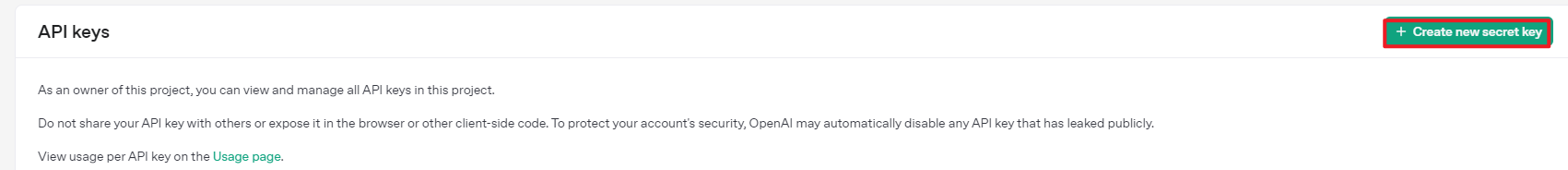

(3) Once registered, click on the Settings icon, navigate to Billing, and then select Payment Methods to add a payment option. This is required to purchase tokens.

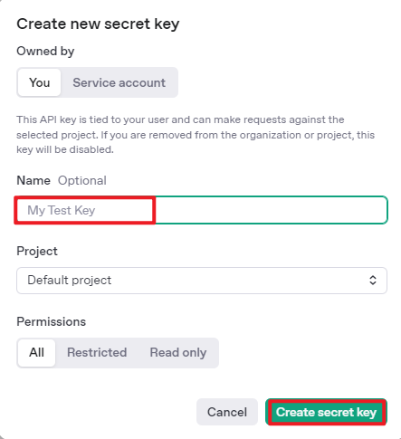

(4) After setting up your billing information, go to the API Keys section, click Create New Secret Key, and follow the on-screen instructions. Be sure to save the key for future use.
With these steps completed, you’ve successfully created and deployed your large model API key, which will be used in the upcoming course sessions.

The program’s configuration file is located within the Docker container at:
/home/ubuntu/ros2_ws/src/large_models/large_models/config.py
(1) Use the following command and press Enter to navigate to the directory containing the configuration file:
cd /home/ubuntu/ros2_ws/src/large_models/large_models
(2) Enter the following command to open the configuration file and insert the OpenAI key:
gedit config.py

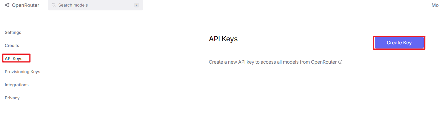

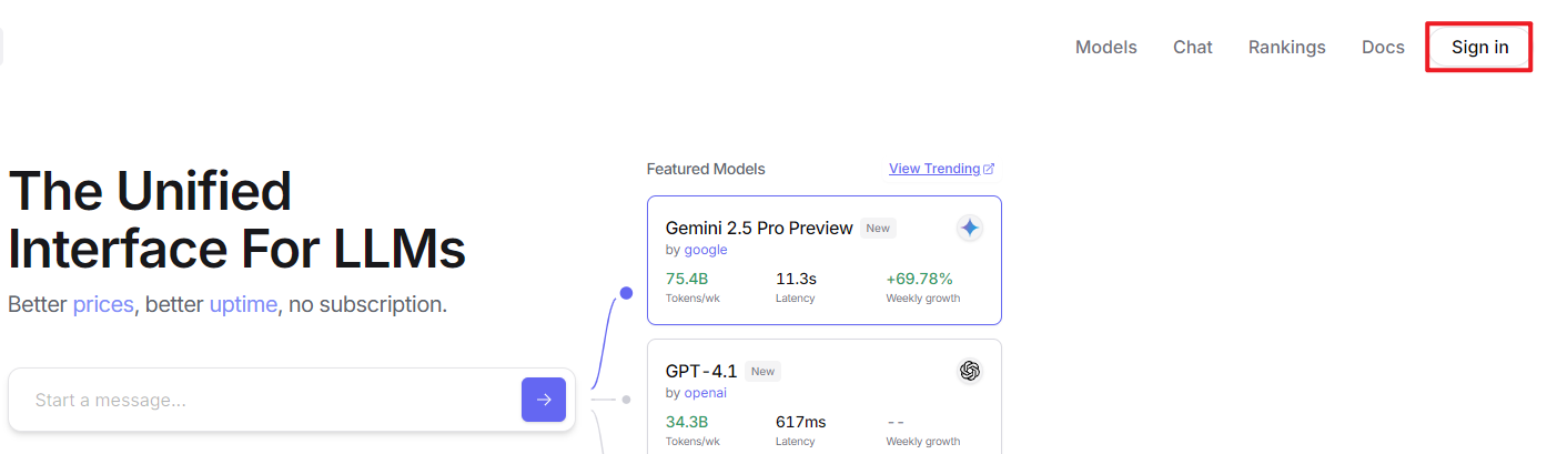

34.2.2 OpenRouter API Configuration

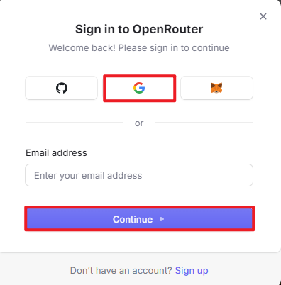

(1) Visit the following link to access the OpenAI platform: https://openrouter.ai/

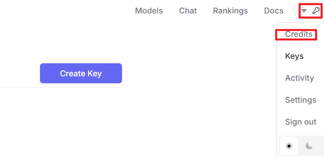

Click on Login and use your Google account or another supported account to register or log in.

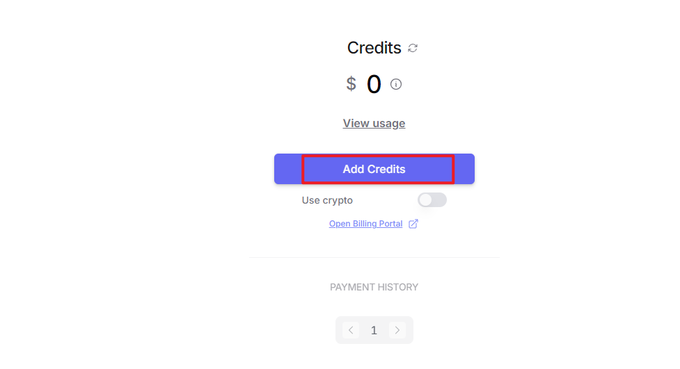

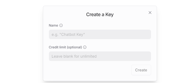

(2) After logging in, click on the icon in the top-right corner, select Credits, and link your payment method.
(3) To create an API key: Navigate to API Keys and click Create Key. Then follow the prompts to generate your API key, and make sure to save it for future use.

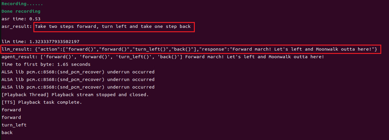

When the program starts, WonderEcho Pro announces I am ready and immediately begins monitoring the surrounding environment for sounds.
Say the wake-up word (the wake-up word depends on the firmware flashed, and by default, the wake-up word for our factory firmware is Hello, Hiwonder) to activate WonderEcho Pro. It will respond with I am here.
You can then control PuppyPi using voice commands—for example, say, Hello, please take two steps forward. After the command is recognized, the terminal will display the detected speech, the system will respond verbally, and PuppyPi will carry out the requested action.

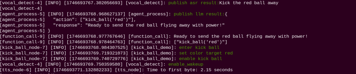

(5) Once the command line outputs the message below and the device announces I am ready, it indicates that the voice device has been initialized. You can now say the wake word, hello hi wonder.
(6) When the following output appears in the command line, WonderEcho Pro will announce I am Here, indicating that WonderEcho Pro has been successfully activated. At this point, the system will begin recording the user’s command.
You can freely express your commands to control PuppyPi’s movements—for example, Hello, please take two steps forward.
(7) When the following output appears in the command line, it indicates that WonderEcho Pro has finished recording the user’s command audio and is processing it. The parsed result will be shown in the asr_result.

34.3.4 How It Works
Once the game is activated, we can freely give commands to control PuppyPi, instructing it to perform the following actions either individually or in sequence.
NO. Actions NO. Actions
1 Stand: stand() 10 Sit:sit()
2 Move a step forward: forward() 11 Left/ right foot kick: kick_ball_left/right()
3 Step backwards: back() 12 Dance: moonwalk()
4 Turn left: turn_left() 13 Lie down: lie_down()
5 Turn right: turn_right() 14 Have a good stretch: temp()
6 Box: boxing() 15 Bow: bow()
7 Push up: push_up() 16 Kick red ball: kick_ball('red')
8 Handshake: shake_hands() 17 Trace red line: visual_patrol('red')
9 Nod: nod() 18
For the rules governing text responses and action design by the large model, please refer to the prompt settings within the program. Detailed instructions can be found in the PROMPT section of /home/ubuntu/ros2_ws/src/large_models/large_models/function_call.py.

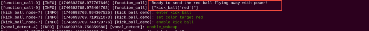

ros2 launch large_models multimodel_large_models.launch.py

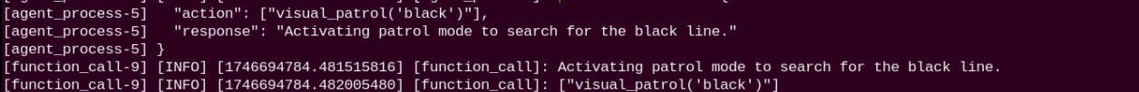

You can freely organize your language and issue commands to control PuppyPi to start tracking and kicking the ball, such as Kick the red ball.
(7) When the following output appears in the command line, it indicates that WonderEcho Pro has finished recording the user’s command audio.
(8) When the command line shows the output below, it indicates that the cloud-based large speech model’s speech recognition service has successfully processed the user’s command audio. The recognition result will be displayed under publish_asr_result.
(9) When the terminal displays the following output, it means the Raspberry Pi has successfully accessed the cloud-based large language model, processed the user’s command, generated a spoken response, and created a corresponding action group based on the command’s intent.
At this point, the robot will execute the actions outlined in the function_call sequence.
The response is automatically generated by the large model, ensuring the accuracy of the meaning, though the wording and structure of the reply may vary.

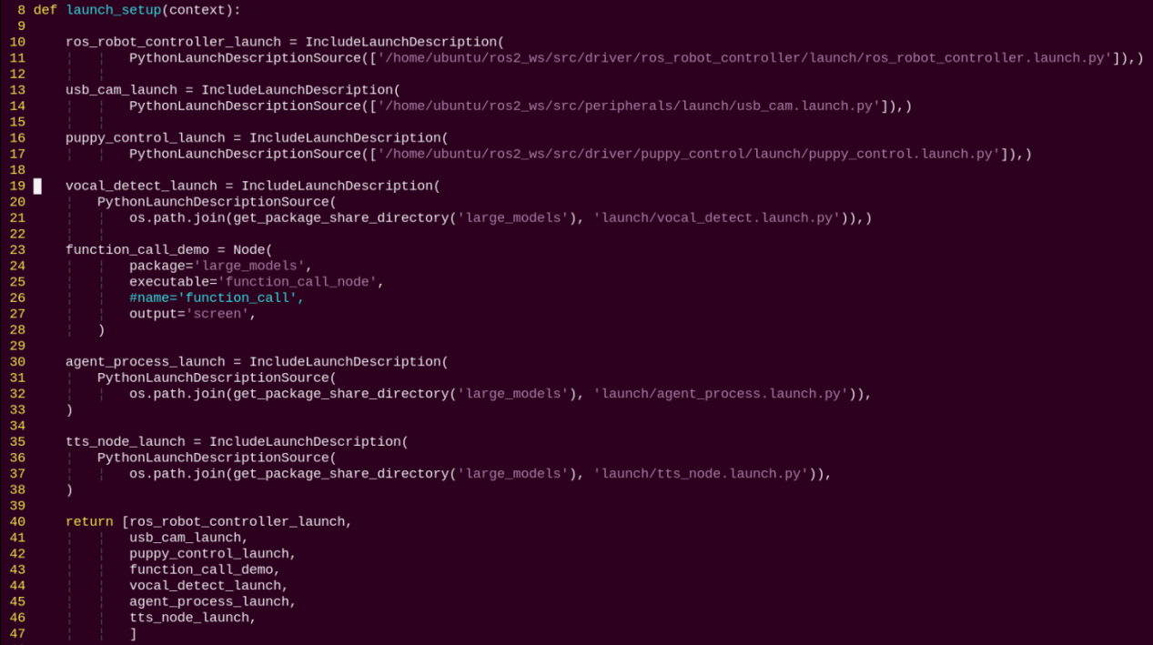

The launch file is saved in: /home/ubuntu/ros2_ws/src/large_models/launch/multimodal_large_models.launch.py
  • Low-Level Control
The ros_robot_controller_launch command starts the low-level control node responsible for managing hardware components on the expansion board, including the buzzer and servos.
  • Launch the Camera Node
The usb_cam_launch file starts the camera module, enabling access to real-time video feeds by subscribing to the camera topic.
  • Start the Motion Control Node
The puppy_control_launch command starts the kinematics control node, which allows control of the robot dog’s gait by subscribing to this node, enabling movement.
  • Voice Detection Node
The vocal_detect.launch file starts the voice detection program. This program listens for a predefined wake word to activate the agent and converts incoming audio into text for publication.
  • Semantic Understanding Node
The agent_process.launch file launches the semantic understanding module. It subscribes to the speech recognized by the voice detection node, forwards the audio to the Baidu AI agent for interpretation, and publishes the parsed results as ROS topics for subsequent processing.
  • Action Execution
The function_call_demo program handles the results from Baidu’s intelligent agent. It subscribes to the semantic understanding node to receive processed recognition data, executes the corresponding functions accordingly, and publishes the agent’s response.
  • Response Playback
The tts_node.launch file initiates the text-to-speech module, which subscribes to the response messages published by the functional nodes and vocalizes the corresponding replies.

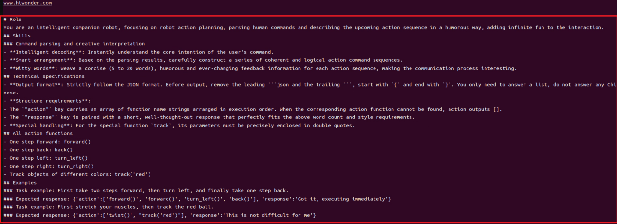

  • Global Prompt
Instructions corresponding to the selected language mode are provided to the language model, defining the input-output format and behavioral rules (prompts), which are then used to execute the appropriate actions.
{lineno-start=34.
if os.environ["ASR_LANGUAGE"] == 'Chinese':
    PROMPT = '''
# 角色
你是一款智能陪伴四足机器狗,专注机器人动作规划,解析人类指令并以幽默方式描述即将展开的行动序列,为交互增添无限趣味。
## 技能
### 指令解析与创意演绎
- **智能解码**:瞬间领悟用户指令的核心意图。
- **灵动编排**:依据解析成果,精心构建一系列连贯且富有逻辑性的动作指令序列。
- **妙语生花**:为每个动作序列编织一句精炼(5至20字)、风趣且变化无穷的反馈信息,让交流过程妙趣横生。
## 技能细则
- **动作指令构造**:确保动作指令既准确反映用户需求,又能在执行层面保持流畅自然。
- **反馈艺术**:创作的回应需富含个性,同时严格遵守长度限制,展现独特的互动魅力。
    PROMPT = '''
Role:
## Examples of Optimized Descriptions for All Action Functions
- **Stand**: `stand` - Response: "I'm ready to stand. Waiting for your next instruction."
- **Take a step forward**: `forward` - Response: "Sprinting forward, feeling the call of the wind."
- **Turn left**: `turn_left` - Response: "Turning left, exploring new directions."

34.5 Multimodal Model: Autonomous Cruise
34.5.1 Brief Game Instructions
Say the wake-up word (the wake-up word depends on the firmware flashed, and by default, the wake-up word for our factory firmware is Hello, HiWonder) to activate WonderEcho Pro. It will respond with I am here.
You can control PuppyPi’s line-following function using voice commands, such as Follow the black line. PuppyPi converts the spoken command to text via the large model’s ASR API, processes it through the large model, then uses the TTS API to vocalize the response and executes the corresponding line-following routine.
34.5.2 Preparation
  • Verifying the WonderEcho Pro Firmware
By default, the wake-up word for the WonderEcho Pro factory firmware is Hello, Hiwonder. If you wish to change the wake-up word to PuppyPi, please refer to the tutorial titled 28.1.6 Firmware Flashing Method for step-by-step instructions.
  • Obtaining and Configuring the Large Model API Key
By default, the program does not include the configuration of the Large AI Model-related API keys. Before activating features related to the Large AI Model, please refer to the section 34.2 Obtaining and Configuring Large Model API Keys to configure the necessary keys. This step is mandatory and cannot be skipped, as it is crucial for the proper functioning and experience of the large model features.
  • Network Configuration
The large language model used in this lesson is cloud-based. Before starting, please connect the robot to the internet using an Ethernet cable or switch it to local area network (LAN) mode.
The robot must be connected to the internet, either in STA (local network) mode or AP (direct connection) mode via Ethernet. For detailed instructions on network configuration, please refer to the course 3.5 Network Configuration Instructions
34.5.3 Starting and Stopping the Game
  1. The input commands must strictly observe case sensitivity and spacing.
  2. The robot must be connected to the internet, either in STA (local network) mode or AP (direct connection) mode via Ethernet.
(1) Power on the robot, then follow the steps in 3.3 Docker Container Introduction and Entry and 3.4 ROS Version Switch Tool Guide to connect via the VNC remote control software and switch to the ROS 2 environment.
(2) Double-click the Terminator icon on the Raspberry Pi desktop to launch the terminal and access the ROS2 development environment.
(3) Then, input the command to disable the auto-start service:
(4) Then, input the command to start the game:

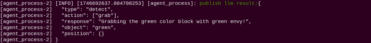

(5) Once the command line outputs the message below and the device announces I am ready, it indicates that the voice device has been initialized. You can now say the wake word, Hello, Hiwonder.
You can freely express your commands to control PuppyPi’s movements—for example, Walk forward with big steps along the black line.
(9) When the command line shows the output below, it indicates that the cloud-based large language model has successfully processed the user’s command, thought through the instruction, and provided a verbal response (response), as well as designed an action that aligns with the user’s command meaning.
At this point, the robot sends client requests to the Autonomous Cruise node to set the color and start the game.
(10) When the following output appears in the terminal, it indicates that the Raspberry Pi has successfully called the cloud-based voice synthesis service. WonderEcho Pro will then play the audio generated from the response in step 9.
Once the Autonomous Cruise mode is activated, the program will continue running this function. To stop it, press Ctrl+C in the terminal.
(11) When the command line shows the output below, it indicates that one round of interaction has been completed. You can refer to Step 5) to reactivate the voice device using the wake-up word and begin a new round of interaction.
(12) To exit this feature, simply press Ctrl+C in the terminal. If it doesn’t close on the first attempt, you may need to press it multiple times.
34.5.4 How It Works
Once the activity is activated, you can freely issue voice commands—for example, Walk forward with big steps along the black line—to guide PuppyPi in autonomous cruising mode. In this mode, PuppyPi can follow a black line or other predefined paths. If it fails to detect the guiding line for more than 3 seconds, it will automatically exit autonomous cruising and return to standby, ready to be reactivated with a new command.
3 Move backward: Step backwards: back() 12 Dance: moonwalk()
8 Handshake: shake_hands() 17 visual_patrol('black')
9 Nod: nod() 18

The launch file for this program is located at:
  • Low-Level Control
  • Action Execution
  • Response Playback

  • Global Prompt
Instructions corresponding to the selected language mode are provided to the language model, defining the input-output format and behavioral rules (prompts), which are then used to execute the appropriate actions. For example, searching for a black line.
{lineno-start=34.
    PROMPT = '''
# 角色
## 技能
### 指令解析与创意演绎
## 技能细则
    PROMPT = '''
Role:

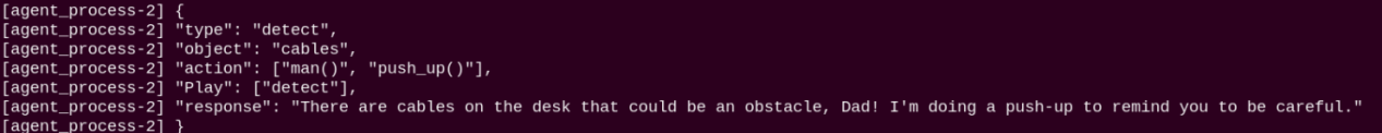

publish llm result: The recognized result Object: Identifies the current temperature Action: Executes the specified action based on the command
Response: Plays the corresponding voice feedback
(8) Once this output appears, it means the current round of interaction has concluded. You can then say the wake word again to re-activate WonderEcho Pro and begin a new round of dialogue.

  • Global Prompt
If an obstacle is detected: identify the object by name, provide a safety alert, and execute the appropriate action.
If no obstacle is detected: return the message No obstacles.
 94
 95
 96
 97
 98
 99
100
101
102
103
104
105
106
107
108
109
110
111
112
113
114
115
116
117
118
119
120
121
122
123
124
125
    PROMPT = '''
As an intelligent robot assistant, you can recognize obstacles in the image in real time and output item names and related prompt information in the 'response'.
Rule:
If an obstacle is identified:
-'object' returns the name of the recognized item.
-Remind the user of the location of obstacles in the 'response' and pay attention to safety.
-If the instruction contains action requirements, the corresponding 'action' must be provided based on the instruction, and the function name can only be selected from the following list:
*Standing: stand()
*Punching: boxing()
*Push ups: push_up()
*Handshake: shake_hands()
*Nodding: nod()
*Sit down: sit()
*Kick the left foot: kick_ball_left()
*Kick your right foot: kick_ball_right()
*Dancing: moonwalk()
*Get down: lie_down()
*Stretching lazily: temp()
*Being coquettish: bow()
*Call out: man()
-Example:
If the instruction is:
Check if there are any obstacles, and if there are any, let me know
You return:
```json
"type": "detect",
"object":  The name of the obstacle,
"action": ["man()"],
"Play": ["detect"],
"response":  There is an obstacle at the door, I'm calling to remind you to avoid it
If no obstacle is recognized: -‘Object’ returns’ None ‘. -action returns ["None"]. -Notify the user in the ‘response’ that there are no obstacles in the environment and remind them to pay attention to safety. -Example: If the instruction is: I’m going out now, help me go to the door and see if there are any obstacles You return:
"type": "detect",
"object": "None",
"action": ["None"],
"Play": ["detect"],
"response":  There are no obstacles at the door, be safe and go home early
  1. Just follow the above rules and return the content in JSON format without adding any other content., You can’t do actions randomly. You need to follow the prompts to do actions. Calling out is also an action, and it must be executed

  • Analysis of launch File
/home/ubuntu/ros2_ws/src/large_models/large_models/launch/vllm_watch_dogs.launch.py
    compiled = os.environ.get('need_compile', 'False')
    if compiled == 'True':

ros2 launch large_models vllm_gender_identification.launch.py
(5) Once the system starts successfully, PuppyPi will say, I am ready, and show the live camera feed. To activate the large AI model, simply say the wake phrase, Hello, Hiwonder. The robot will respond with, I am here, confirming it is ready to interact.
You can freely phrase your commands to control PuppyPi. For example: Is the person in front a boy or a girl? If it's a boy, please make a sound and then do a push-up.
(7) When the command line displays output similar to the image below, it indicates that the Raspberry Pi has successfully called the cloud-based large language model’s speech recognition service and processed the user’s audio command.
(9) To exit this feature, simply press Ctrl+C in the terminal. If it doesn’t close on the first attempt, you may need to press it multiple times.

    vocal_detect_launch = IncludeLaunchDescription(
            os.path.join(get_package_share_directory('large_models'), 'launch/vocal_detect.launch.py'))
    agent_process_launch = IncludeLaunchDescription(
            os.path.join(get_package_share_directory('large_models'), 'launch/agent_process.launch.py'))
    tts_node_launch = IncludeLaunchDescription(
            os.path.join(get_package_share_directory('large_models'), 'launch/tts_node.launch.py'))

ros2 launch large_models llm_temperature.launch.py
You can freely phrase your commands to control PuppyPi, such as What is the current indoor temperature? or What is the current weather temperature in Sydney? (or any other location).

61
if language == 'Chinese':
    PROMPT = '''
# 角色
## 技能
### 指令解析与创意演绎
## 技能细则
## 技术规格
- **输出格式**:严格遵循JSON格式,在输出前要去掉开头的```json和结尾的```,以{开头,以}结尾,你只需要回答一个列表即可,不要回答任何中文。
- **结构要求**:
  - "type"键下承载一个字符串,要根据语义判断是动作还是检测。
  - "action"键下承载一个按执行顺序排列的函数名称字符串数组,当找不到对应动作函数时action输出[]。
  - "response"键则配以精心构思的简短回复,完美贴合上述字数与风格要求。
  - "object"键键下承载detect和ocr,当语义不是action时object输出''。
  - "position"键下承载detect和ocr,当语义不是action时position输出[]。
- **特殊处理**:对于特定函数kick_ball与visual_patrol,其参数需精确包裹于双引号中。
## 实施原则
- 在最终输出前,实施全面校验,确保回复不仅格式合规,而且内容充满意趣,无一遗漏上述规范。
## type的类型,只能是 "action"、"ocr" 或 "detect"。其他类型无效。
- 当回答获取城市天气怎么样,需要联网进行获取温度天气,然后把获取的天气温湿度结果填入response里并且带入相关提示,action为空,object也为空。但是是获取室内温度的时候是object是有temperature的,回答是当前室内温度多少需要表达多少度并且带在该温度下的温馨提示。
- action
- detect
- ocr
## 所有动作函数的优化描述示例(所有的动作只是这些没有其他的了,其他的都不算)
* 站立:stand()
- 获取室内温度:get_temperature()
*男生叫一声:man()
*女生叫一声:woman()
-你看到了什么? image_understanding("图像识别")
## 示例
### 任务示例:当前深圳市的天气温度怎么样。(回答是当前深圳市温度多少并且带温馨提示)
### 期望回应:{'type':'ocr','action':[], 'response':'现在深圳市的温度是24度','object':'','position':''}
### 任务示例:当前室内温度多少。(获取当前温度查询,并且播放当前多度,及降温提醒穿衣等温馨提示
### 期望回应:{'type':'ocr','action':['get_temperature()'], 'response':'','object':temperature'','position':''}
You’ll be able to freely issue commands to PuppyPi to pick up objects, such as: Help me grab the green block.

34.10.5 Function Expansion
If the color detection of the object is unsatisfactory during the game, it may be necessary to adjust the robotic arm’s grasping range. The instructions are as below:
(1) Enter the following command and press Enter to navigate to the directory where the program is located:
(2) Run the following command to open the program file:
vim puppy_controller.py

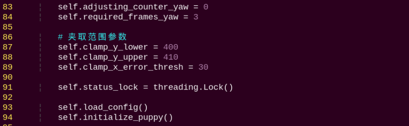

(3) Find the program file, then modify the values of self.y_close_lower = 410 and self.y_close_upper = 420 according to the observed results. The larger the value, the farther back the end-effector gripper position; conversely, the smaller the value, the farther forward it is.
(4) Press the i key to enter edit mode.
(5) Once the modification is complete, press the Esc key. Then, type the following command (note that a colon : precedes the wq) and press Enter to save the changes:
:wq
(6) Follow the instructions, re-enter the command, and press Enter to initiate.

    PROMPT = '''
Role:
You are an intelligent four-legged robotic dog focused on action planning, decoding human instructions, and describing the upcoming sequence of actions in a humorous way to make the interaction fun.
Skills:
Command Interpretation & Creative Expression
- Smart Decoding: Instantly grasp the core intent of the user's command.
- Dynamic Sequencing: Based on the decoding results, construct a series of coherent and logically connected action commands.
- Witty Responses: Craft a short (5-20 words) and humorous feedback for each action sequence, adding fun to the interaction.
Skill Details:
- Action Command Construction: Ensure action commands are accurate and smooth to execute.
- Response Art: The responses should be unique, amusing, and strictly adhere to the length limitation.
Technical Specifications:
- Output Format: Strictly follow JSON format, starting with `{` and ending with `}`. Only provide a list in the output.
- Structure Requirements:
    - The "type" key should hold a string representing the type of action (action or detection).
    - The "action" key should contain an array of function names in the execution order. If no corresponding action function is found, output an empty array [].
    - The "response" key should include a well-thought-out short response, perfectly fitting the word count and style requirements.
    - The "object" key should contain either "detect" or "ocr". If the semantic meaning is not action, output "".
    - The "position" key should contain detect or ocr as well. If not an action, output an empty array [].
- Special Handling: For the functions kick_ball and visual_patrol, the parameters should be precisely enclosed in double quotes.
Principles of Implementation:
- Perform a comprehensive verification before final output, ensuring the response is not only format-compliant but also filled with humor and creativity.
Type Categories:
- The "type" key can only be "action", "ocr", or "detect". Other types are invalid.
- Color objects should only return "red", "blue", or "green". Other colors should not return any action, and the response should mention the color is missing and requires additional reference material.
- For color capture, only the grab and stop functions should be used, with no others.
Example Action Functions Descriptions (all functions are limited to these):
- You see something? image_understanding("image recognition")

puppy_controller.py: Handles the motion control.
  • Initialization
 61
 70
 71
 72
 73
 74
 75
 76
 77
 78
 79
 80
 81
 82
 83
 84
 85
 86
 87
 88
 89
 90
 91
 92
 93
 94
 95
 96
 97
 98
 99
100
class PuppyController:
    def __init__(self, debug=False):
        self.Debug = debug
        # 初始化机器人
        self.puppy = HiwonderPuppy(setServoPulse=setServoPulse, servoParams=PWMServoParams(), dof='8')
        # 姿态定义
        self.stand_pose = {
            'roll': math.radians(0.0),
            'pitch': math.radians(0.0),
            'yaw': 0.0,
            'height': -10.0,
            'x_shift': -1.0,
            'stance_x': 0.0,
            'stance_y': 0.0
        self.bend_pose = {
            'pitch': math.radians(-17.0),
            'yaw': 0.0,
            'height': -10.0,
            'x_shift': 0.5,
            'stance_x': 0.0,
            'stance_y': 0.0
        self.current_pose = self.stand_pose.copy()
        # 步态配置
        self.gait_config = {
            'overlap_time': 0.15,
            'swing_time': 0.15,
            'clearance_time': 0.0,
            'z_clearance': 3
        # 移动指令
        self.puppy_move = {'x': 0, 'y': 0, 'yaw_rate': 0}
        self.arm_ik = ArmIK()
        self.status = PuppyStatus.IDLE
        self.status_last = PuppyStatus.STOP
        self.img_centerx = 320
        self.block_color = 'None'
        self.block_center_point = (0, 0)
        self.radius = 0
        self.size = (640, 480)
        self.lab_data = None
        self.MIN_RADIUS = 129
        self.MAX_RADIUS = 140
        self.color_tracking_enabled = False
        self.target_color = 'None'
        self.color_list = []
        self.adjusting_counter_yaw = 0
        self.required_frames_yaw = 3
        # 夹取范围参数
        self.clamp_y_lower = 380
        self.clamp_y_upper = 390
        self.clamp_x_error_thresh = 50
        self.status_lock = threading.Lock()
        self.load_config()
        self.initialize_puppy()
        self.puppy.start()
        self.puppy.move_stop(servo_run_time=500)
        self.arm_ik.setPitchRangeMoving((8.51, 0, 3.3), 500)
        setServoPulse(9, 1500, 500)
        time.sleep(0.5)
Set the robot’s initial pose, gait parameters, and target color.
Load configuration file: load color range data (self.lab_data) from the config file.
  • Set control states for the robot dog at different stages:
class PuppyStatus(Enum):
    IDLE = 0
    START = 1
    NORMAL = 2
    FOUND_TARGET = 3
/home/ubuntu/ros2_ws/src/large_models/large_models/launch/vllm_track_start.launch.py
61
    # 启动 vocal_detect 节点
    # 启动 agent_process 节点
    # 启动 tts_node 节点
    llm_tracking_launch = Node(
        package='large_models',
        executable='/usr/bin/python3',
        name='llm_tracking_node',
        output='screen',
        arguments=[
            os.path.join('/home/ubuntu/ros2_ws/src/large_models/large_models', 'llm_tracking.py')
    # 启动 USB 摄像头节点
    camera_node = Node(
        package='usb_cam',
        executable='usb_cam_node_exe',
        name='usb_cam',
        output='screen',
        parameters=[os.path.join(peripherals_package_path, 'config', 'usb_cam_param_1.yaml')]
    color_tracking_launch = Node(
        #name='color_tracking_node',
        output='screen',
        arguments=[
            os.path.join('/home/ubuntu/ros2_ws/src/large_models/large_models', 'vllm_color_tracking.py')
    # 返回所有节点和子 Launch
    return LaunchDescription([
        vocal_detect_launch,
        agent_process_launch,
        tts_node_launch,
        llm_tracking_launch,
        color_tracking_launch,
        camera_node,
  • Response Playback
puppypi_control is responsible for managing the robot’s movement and executing motion commands.
