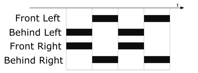

20.1.2 Trot Illustration

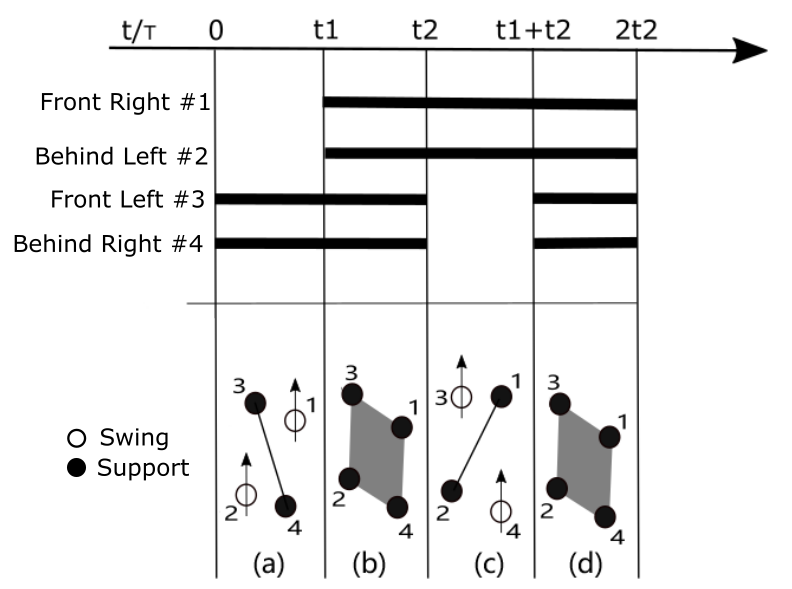

Trot is a gait in medium to low speed where the feet at diagonal opposite ends of the body strike the ground together. This most frequently used quadruped gait has a wide motion range, and combines stability and speed.
When PuppyPi is in Trot gait, its feet at diagonal opposite ends of the body strike the ground together. Take the figure below for example.
In (a), NO.1 and 2 legs of PuppyPi will lift and swing forward, and NO.3 and 4 legs are in support of the body to ensure that the center of gravity is at the intersection of the diagonal lines. At this time, NO.1 and 2 legs are in swing phase while NO. 3 and 4 legs are in support phase.
In (b), four legs touch the ground at the same time. All the legs are in support phase.
In (c), NO.3 and 4 legs will lift and swing forward, and NO.1 and 2 legs are in support of the body to ensure that the center of gravity is at the intersection of the diagonal lines. At this time, NO.3 and 4 legs are in swing phase while NO. 1 and 2 legs are in support phase.
In (d), four legs touch the ground at the same time. All the legs are in support phase.
Completing (a), (b), (c) and (d) actions indicates that PuppyPi finish a integrate cycle of action.

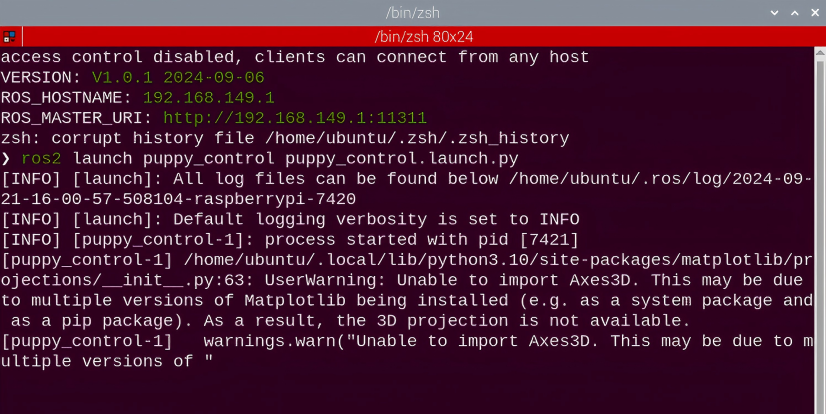

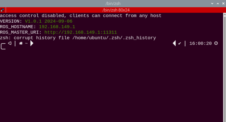

(1) Power on the robot, then follow the steps in 3.3 Docker Container Introduction and Entry and 3.4 ROS Version Switch Tool Guide to connect via the VNC remote control software and switch to the ROS 2 environment.
(2) Click open command line terminal.

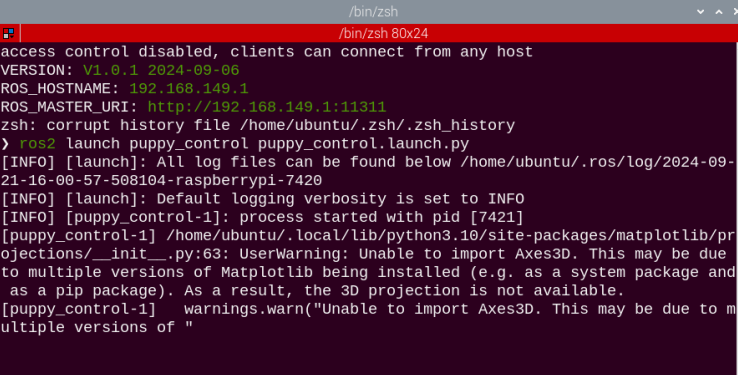

(3) Enter the command below and press Enter to open the program files
ros2 launch puppy_control puppy_control.launch.py

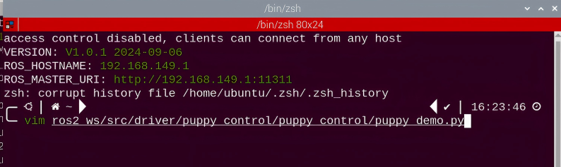

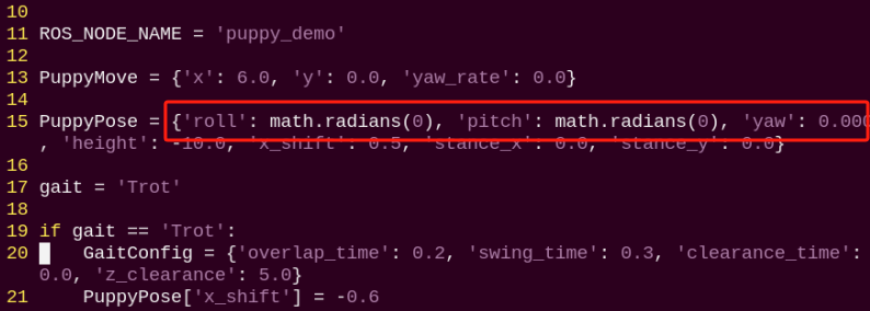

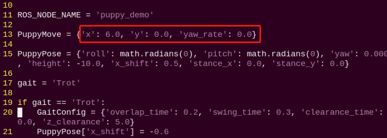

(4) Open a new ROS2 terminal, and run the following command to open the program file using the vim editor.
vim ros2_ws/src/driver/puppy_control/puppy_control/puppy_demo.py

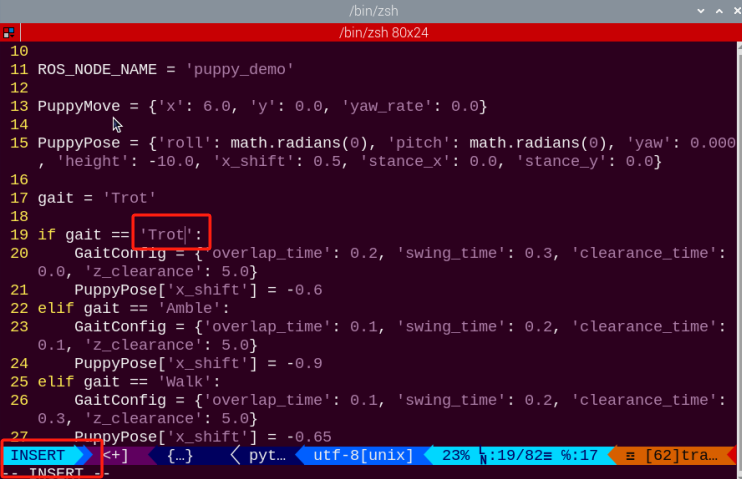

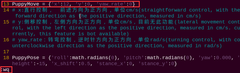

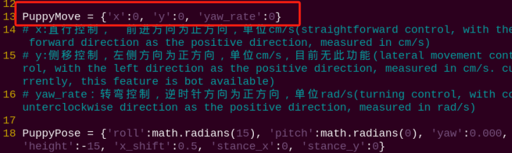

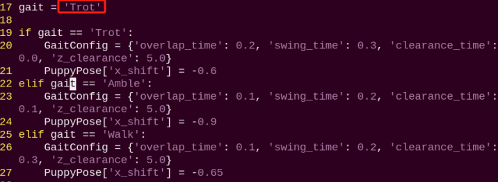

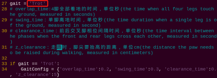

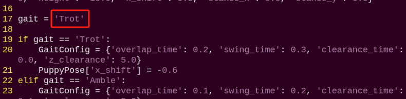

(5) The code to call the gait can be found in the location shown in the image below. By default, the program executes the Trot gait, so it can be called and run directly.

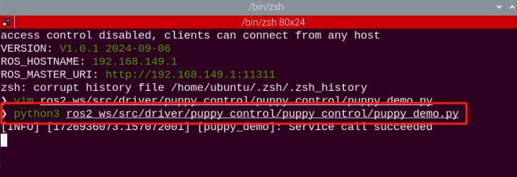

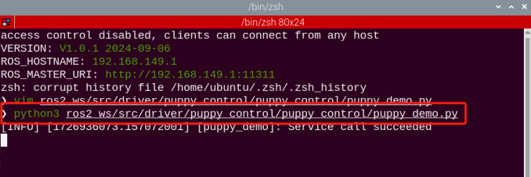

(6) Run the following command to initiate the game.
python3 ros2_ws/src/driver/puppy_control/puppy_control/puppy_demo.py
(7) If you need to terminate this game, use shortcut ‘Ctrl+C’. If the terminal cannot be closed, please try again.

  • Gait Selection

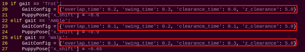

There are three built-in gaits, including Trot, Amble and Walk. And Trot is the initial gait by default.
	gait = 'Trot'
# overlap_time:4脚全部着地的时间,单位秒(the time when all four legs touch the ground, measured in seconds)
	# swing_time:单脚离地时间,单位秒(the time duration when a single leg is off the ground, measured in second)
	# clearance_time:前后交叉脚相位间隔时间,单位秒(the time interval between the phases when the front and rear legs cross each other, measured in seconds)
	# z_clearance:走路时,脚尖要抬高的距离,单位cm(the distance the paw needs to be raised during walking, measured in centimeters)
if gait == 'Trot':
    GaitConfig = {'overlap_time': 0.2, 'swing_time': 0.3, 'clearance_time': 0.0, 'z_clearance': 5.0}
    PuppyPose['x_shift'] = -0.6
    # Trot步态 clearance_time = 0(Trot gait clearance_time = 0)
elif gait == 'Amble':
    GaitConfig = {'overlap_time': 0.1, 'swing_time': 0.2, 'clearance_time': 0.1, 'z_clearance': 5.0}
    PuppyPose['x_shift'] = -0.9
	     # Amble步态 0 < clearance_time < swing_time( Amble gait 0 < clearance_time < swing_time)

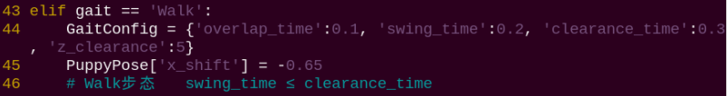

elif gait == 'Walk':
    GaitConfig = {'overlap_time': 0.1, 'swing_time': 0.2, 'clearance_time': 0.3, 'z_clearance': 5.0}
    PuppyPose['x_shift'] = -0.65
     # Walk步态   swing_time ≤ clearance_time(Walk gait   swing_time ≤ clearance_time)
If want to change the gait, we can directly modify “Trot” as “Walk”.
gait = 'Trot'

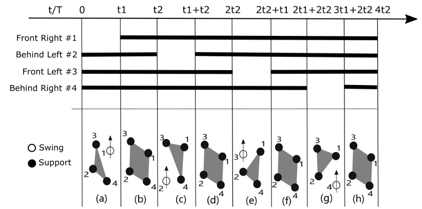

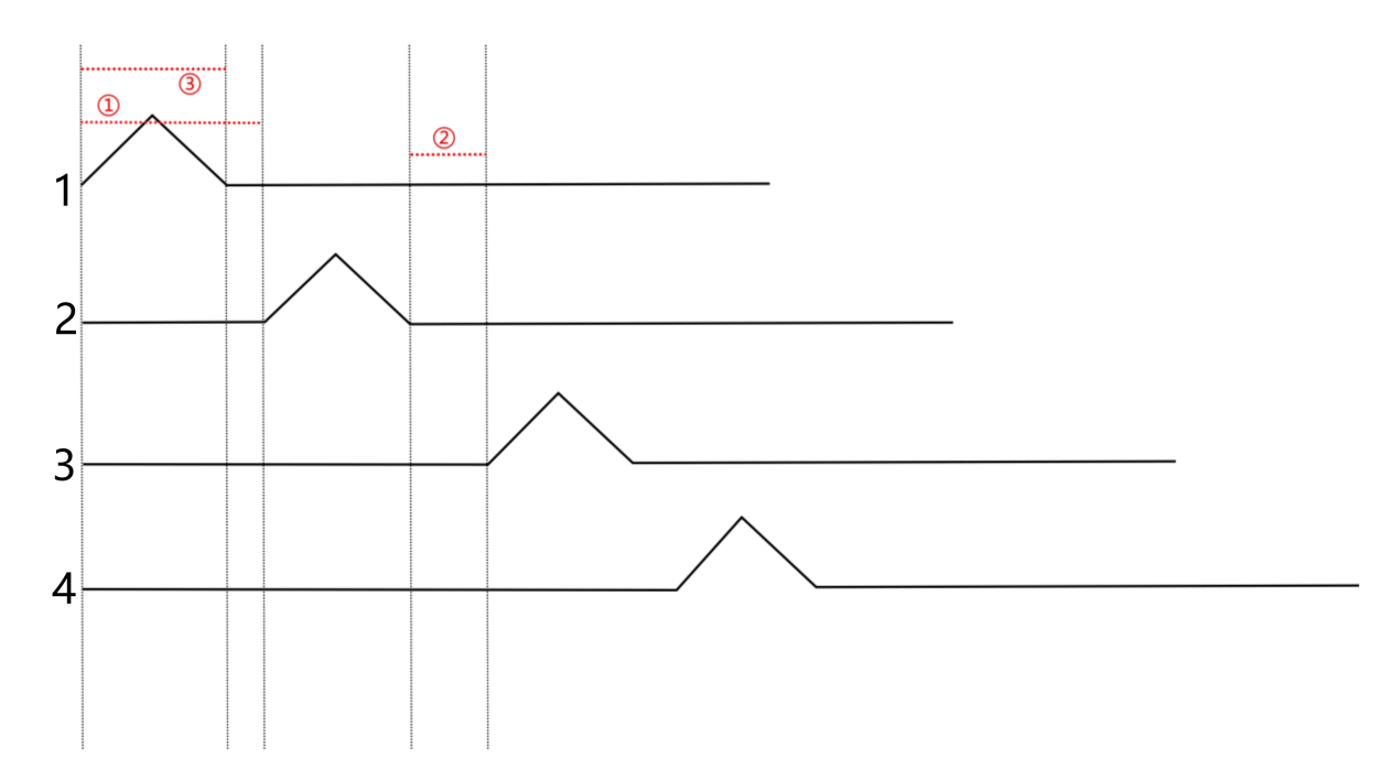

Walk is stati c gait where 3 legs are on the ground at least and 1 leg swings at most.
The sequence of different legs to swing is right front->left hind->left front->right hind, that is 1->2->3->4 as the picture shown.
In (a), NO.1 leg of PuppyPi will lift and swing forward, and NO. 2, 3 and 4 legs are in support of the body.
In (b), 4 legs are on the ground.
In (c), NO.2 leg will lift and swing forward, and NO. 1, 3 and 4 legs are in support of the body.
In (d), 4 legs are on the ground.
In (e), NO.3 leg will lift and swing forward, and NO. 1, 2 and 4 legs are in support of the body.
In (f), 4 legs are on the ground.
In (g), NO.4 leg will lift and swing forward, and NO. 1, 2 and 3 legs are in support of the body.
In (h), 4 legs are on the ground.
Completing (a), (b), (c), (d), (e), (f), (g) and (h) actions indicates that PuppyPi finish a integrate cycle of action.

(3) Enter command and press Enter to access the underlying motion control file.
(4) Run the following command to open the program file using the vim editor.

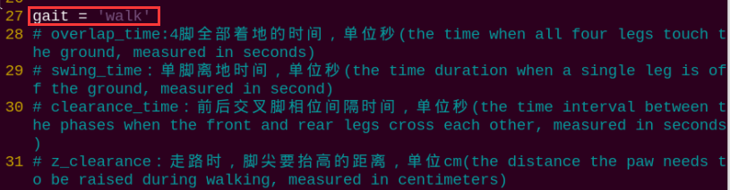

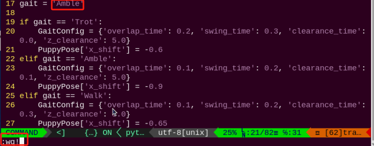

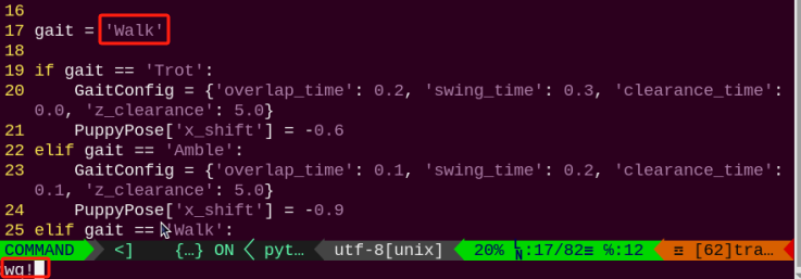

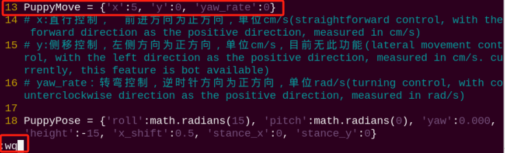

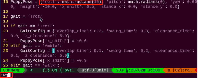

(5) The code to call the gait can be found at the location shown in the image below. By default, the program executes the Trot gait. Press the ‘i’ key to enter edit mode.
(6) Change “Trot” to “Walk”, then press the “Esc” key, enter the command, and press Enter to save and exit.
:wq
(7) Open a new terminal, enter the command, and press Enter to start the demo:

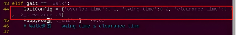

  • Walking Frequency Adjustment
We can modify the following parameters to adjust its walking frequency. The shorter the time, the higher the frequency. The longer the time, the lower the frequency.
The meaning of the parameters in bracket is as follow.
① The first parameter overlap_time is the time when all the legs touch the ground. The unit is second.
② The second parameter swing_time is the time when one leg is off the ground. The unit is second.
③ The third parameter clearance_time is interval between the lifts of legs at diagonal opposite ends of the body. The unit is second.
④ The fourth parameter z_clearance is the lifted height in cm during walking.
Under Walk gait, please ensure clearance_time>swing_time and overlap_time>0. If you want to better observe the Walk gait, we can extend swing_time and overlap_time but the walking stability will be influenced due to lower frequency. For example, we modify clearance_time as 5, swing_time as 3, and overlap_time as 2.

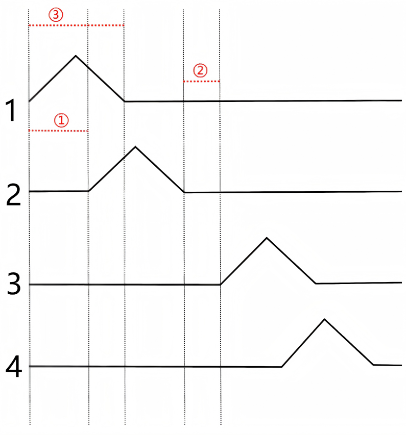

Amble is static gait which is considered as accelerated Walk gait. During motion, 2 legs are on the ground at least and 2 legs swings at most.
The motion process of Amble gait is the same as that of Walk gait. And the sequence of different legs to swing is right front->left hind->left front->right hind, that is 1->2->3->4 as the picture shown.
The difference between Amble and Walk gait is NO.2 leg is lifted after NO.1 leg touch the ground under Walk gait, while under Amble gait, NO.2 leg is lifted after NO.1leg is lifted but not touch the ground.
(2) Click to open command line terminal.
(3) Enter the following command and press Enter to open the program files
(4) Enter the following command to open the program file using the Vim editor:

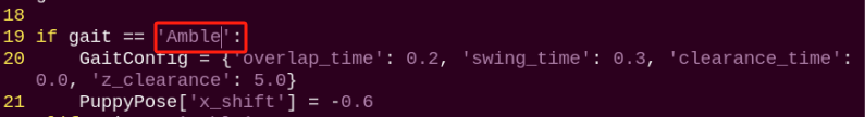

(5) The code to call the gait can be found at the location shown in the image below. By default, the program executes the Trot gait. Press the “I” key to enter edit mode.
(5) Change “Trot” to “Amble”, then press the “Esc” key, enter the command, and press Enter to save and exit:
:wq!
(7) Open a new terminal, enter the following command, and press Enter to start the demo.
(8) To stop the demo, press “Ctrl+C” in the terminal window. If it doesn’t stop immediately, please try again.
20.3.4 Program Outcome
PuppyPi will amble with two legs in support of the body at least and two legs swinging at most. Amble gait is the accelerated Walk gait. The leg sequence diagram is as follow.

The source code lies in /row2_ws/src/driver/puppy_control/puppy_control/puppy_demo.py
  • Gait Selection
	gait = 'Trot'
if gait == 'Trot':
If want to change the gait, we can directly modify “Trot” as “Walk” or “Ample”.
Under Walk gait, please ensure clearance_time>swing_time and overlap_time>0. If you want to better observe the Walk gait, we can extend swing_time and overlap_time, but the walking stability will be influenced due to lower frequency. For example, we modify clearance_time as 5, swing_time as 3, and overlap_time as 2.

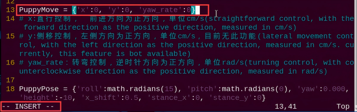

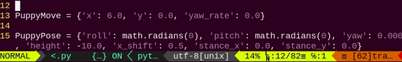

(5) Press the “i” key to enter edit mode. Modify the code to: .
future = self.set_mark_time_client.call_async(SetBool.Request(data=True))
(6) After making the changes, press the “Esc” key, then enter the following command and press Enter to save and exit:
:wq
(7) Open a new terminal, enter the following command, and press Enter to start the demo:
20.4.2 Project Outcome
After the game starts, PuppyPi will march on the spot with Trot gait. The legs at diagonal opposite ends of the body lift or touch the ground together. The leg sequence diagram is as the figure below.

(3) Input command below and press Enter to initiate the underlying control service.

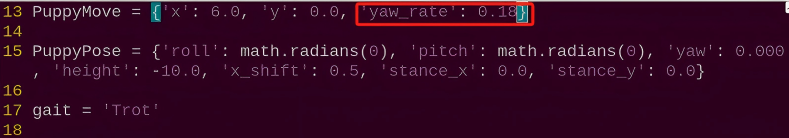

(5) Locate the code shown in the image below:
(6) Press the “i” key to enter edit mode. For example, to make the robot dog turn counterclockwise at 0.18 rad/s, modify the code to:
(7) After making the changes, press the “Esc” key, then enter the following command and press Enter to save and exit:

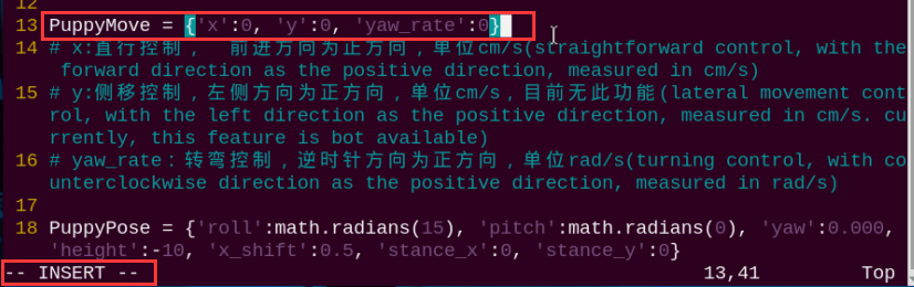

The source code of this program lies in /row2_ws/src/driver/puppy_control/puppy_control/puppy_demo.py
  • Motion Parameter Adjustment
Through setting the corresponding parameters, adjust PuppyPi’s moving direction.
PuppyMove = {'x': 5.0, 'y': 0.0, 'yaw_rate': 0.0}
The meaning of parameter in the bracket is as follow.
The third parameter “yaw_rate” is used to control PuppyPi to turn, ranging from -0.89~0.89 rad/s. When the value is positive, PuppyPi will turn counterclockwise. When the value is negative, PuppyPi will turn clockwise. The greater the absolute value, the greater the turning angle.
Take the camera at front as the first-person perspective, and the rotation direction is as the picture shown.
1rad/s corresponds to 57.3°/s. For example, if you want to set the rotation speed as 30°/s, we should set “yaw_rate” as 0.52. (30/57.3â‰?.52)

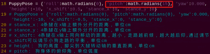

20.6.2 Program Explanation
The source code of this program is located in a Docker container: /row2_ws/src/driver/puppy_control/puppy_control/puppy_demo.py
Take Trot gait for example.

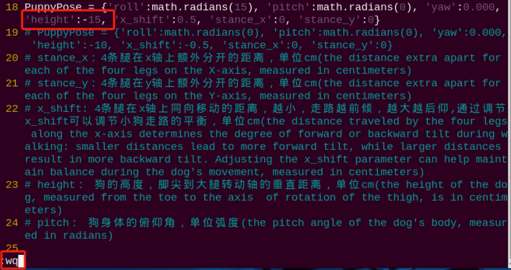

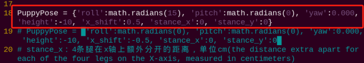

PuppyPose = {'roll': math.radians(0), 'pitch': math.radians(0), 'yaw': 0.000, 'height': -10.0, 'x_shift': 0.5, 'stance_x': 0.0, 'stance_y': 0.0}
In the program above, parameter “x_shift” is the distance that PuppyPi’ s four legs move in the same direction on X axis. It ranges from -10 to 10 cm. We can adjust this value to balance PuppyPi’s body.
-0.6” is the default balance value under Trot gait. As PuppyPi walks in different way under different gaits, the balance value varies.
The smaller the x_shift, the greater PuppyPi leans forward. The larger the x_shift, the greater PuppyPi leans back.
20.6.3 Operation Steps
Take controlling PuppyPi to lean 2cm forward. Please follow the steps below to operate.
The input command should be case sensitive. And the key words can be complemented by “Tab” key.
(3) Input the following command and press Enter to initiate the underlying motion control node.
(5) Modify the parameter `PuppyPose[‘x_shift’]`. The default balance value for the Trot gait is -0.6. In this case, change the value to -2, which is smaller than the balance value, causing the robot dog to lean forward. After making the change, press the “Esc” key, then enter the following command to save and exit:
:wq
(6) Open a new terminal, enter the following command, and press Enter to start the demo:
(7) If you need to terminate the game, use short-cut ‘Ctrl+C’. If you fail to close the game, please try again.
  • This modification method applies not only to the Trot gait but also to other gaits.
  • In this example, a large adjustment is made to clearly observe the effect. For actual adjustments, it is recommended to make smaller incremental changes.
20.6.4 Program Outcome
After the game starts, PuppyPi will walk with body leaning forward under Trot gait.

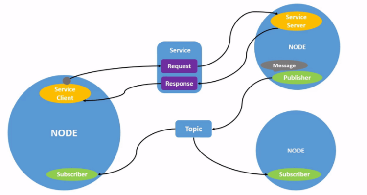

20.7 Basic Communication of ROS Robot
20.7.1 Communication Method
The ROS system is a distributed computing environment. It not only allows multiple nodes to run on a single robot but also enables them to run on multiple robots that communicate with each other, as long as these robots are on the same network.
Therefore, the communication architecture of ROS is the soul of ROS and also the key to the normal operation of the entire ROS system. There are four communication methods in ROS: Topic (topics), Service (services), Parameter Service (parameter server), and Actionlib (action library).
In ROS, topics use an asynchronous communication mechanism. They employ a publish/subscribe model, where data is transmitted from publishers to subscribers. Multiple subscribers or publishers can exist for the same topic. The topic model is illustrated in the following diagram:
Topic Model (publish/subscribe)

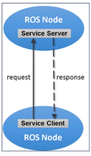

Service adopts Synchronous Communication Mechanism and uses client/ server model. In this model, client will send request, and server will response after processing.
Service Model (request/answer)

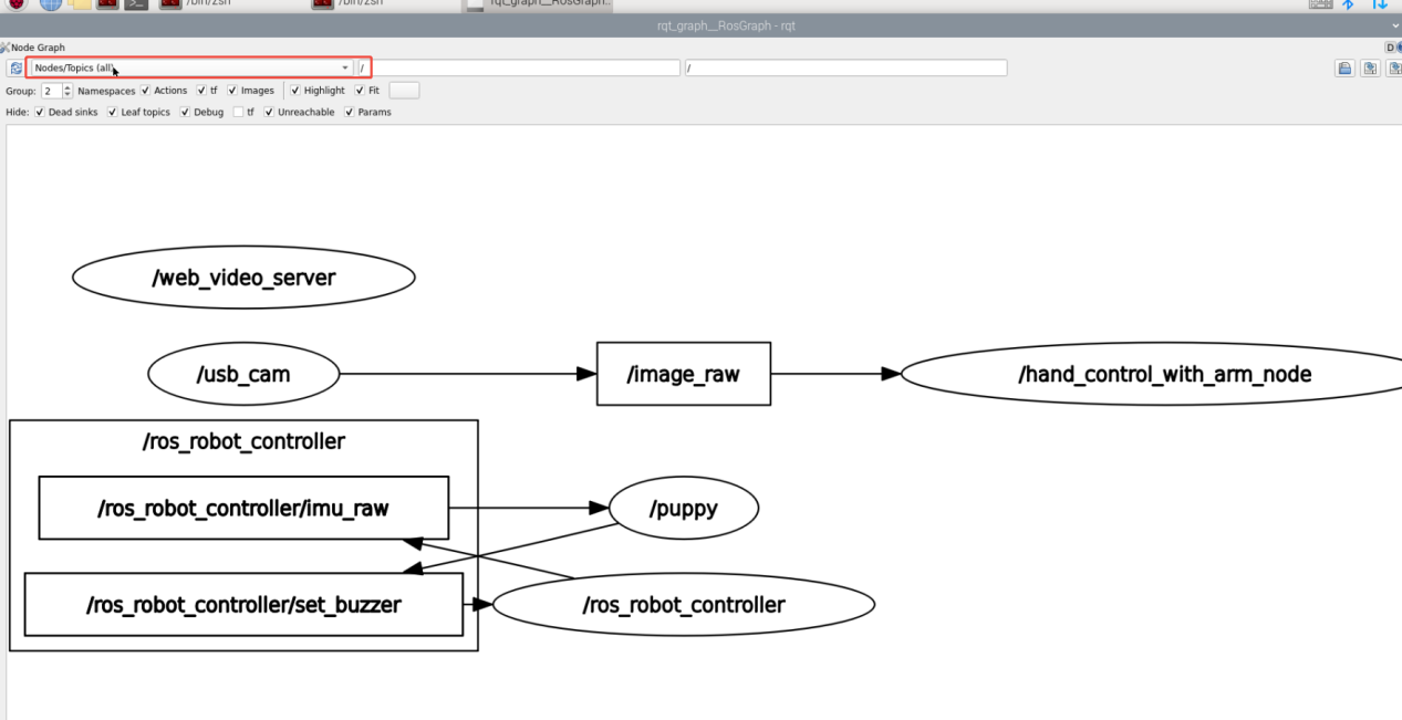

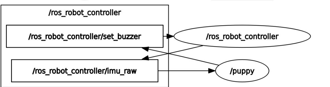

  • Check Topic Communication
ROS comes with RQT tool. And we can use the corresponding tool to check the communication between the nodes of PuppyPi.
The input command should be case sensitive, and the key words can be complemented by “Tab” key.

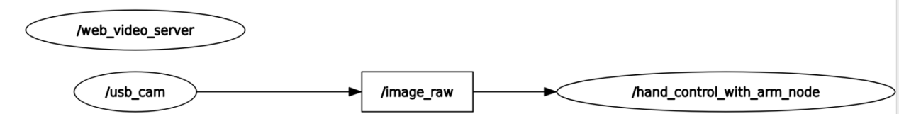

(3) Run the following command and hit Enter key to start the tool.
rqt_graph
(4) Please find the codes as the figure below shown, and set it as “Nodes/Topics(all)
The interface displays the communication graph for the current environment. In the diagram:
① Rectangles represent topics
② Ellipses represent nodes
The visualized communication flow reflects the system’s behavior after the robot powers on and initializes communication automatically.
  • Topic Communication
Communication Flow:
The following outlines the main communication processes:
(1) /usb_cam and /web_video_server Nodes:
① Both nodes publish data to the image_raw topic:
  • usb_cam: Captures image data from the physical camera.
  • web_video_server: Streams the video feed to remote clients.
② These topics provide image data to downstream nodes, such as /hand_control_with_arm_node.
(2) /ros_robot_controller:
① IMU Data Handling: Subscribes to /ros_robot_controller/imu_raw to receive IMU data for navigation and control.
② Buzzer Control: Publishes to /ros_robot_controller/set_buzzer to control the robot’s buzzer.
③ Robot Control: Communicates with the puppy topic to control the robot dog’s movement.
(3) /hand_control_with_arm_node:
① Subscribes to the image_raw topic to receive real-time video streams.
② Uses visual input to interact with and control the robot.
(4) Summary of Communication Relationships
① Publishers and Subscribers: ROS 2 nodes communicate using a publish–subscribe model.
  • /usb_cam and /web_video_server act as publishers, publishing image data to the image_raw topic.
  • /hand_control_with_arm_node is a subscriber that receives image data from this topic for processing.
② Data Flow Overview:
  • Image Stream:Image data is published by /usb_cam and /web_video_server to image_raw, which is then utilized by nodes like /hand_control_with_arm_node.
  • IMU Data:/ros_robot_controller subscribes to /ros_robot_controller/imu_raw to retrieve IMU data used in movement control.
  • Buzzer Control:/ros_robot_controller publishes commands to /ros_robot_controller/set_buzzer to activate the buzzer.

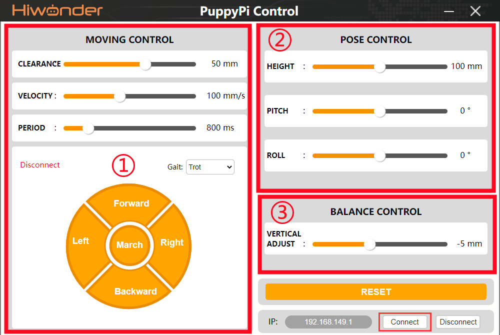

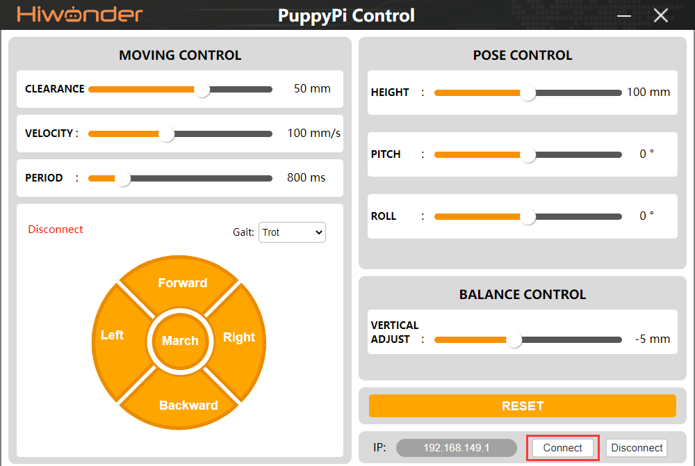

20.8 PC Software Control
To avoid interference, please cut off the connection to app first, then control PuppyPi through PC software.
If the software cannot be opened, please install the driver which can be found in the same folder.
(1) Power on the robot, then follow the steps in 3.4 ROS Version Switch Tool Guide to connect via the VNC remote control software and switch to the ROS 2 environment.
(2) Click to open the Terminator ROS2 terminal, then run the following command to configure the network connection.
ros2 run rosbridge_server rosbridge_websocket --ros-args -p port:=9090
(3) Open a new command-line terminal by clicking the icon . Then execute the command below to enable the motion control node.
20.8.1 Open PC Software
Extract the PC software to any English path, then find the application below and open it. Please turn off the firewall before opening the PC software.
20.8.2 PC Software Connection
(1) Turn on PuppyPi
(2) Please wait until the buzzer beeps, at this time ROS system boots up successfully. Then connect your computer to the WiFi starting with HW. Note: if you are using desktop computer, wireless network card is required.
(3) Open PC software, and then click “Connect”. After a while, PC software will connect to the PuppyPi.
20.8.3 Interface Layout

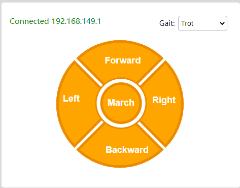

(1) Motion Control Area
Icon Function
The maximum lifted height of leg during walking in mm
Moving speed in mm/s
Time taken to complete one gait
Switch between Trot, Amble and Walk gait.
Buttons for motion control. Click the button or press corresponding key to realize control
(2) Posture Control Area
Icon Function
Adjust PuppyPi to high, medium or low standing posture
Angle for PuppyPi to look up and down. When it is positive, PuppyPi will look up. When it is negative, PuppyPi will look down. The greater the absolute value, the larger the pitch angle.
Angle of left and right tilt. When it is positive, PuppyPi will tilt to right. When it is negative, PuppyPi will tilt to left. The greater the absolute value, the larger the roll angle.
(3) Center of Gravity Control
Icon Function
The default value is -5. The smaller the value, the more it leans forward; The larger the value, the more it leans back.

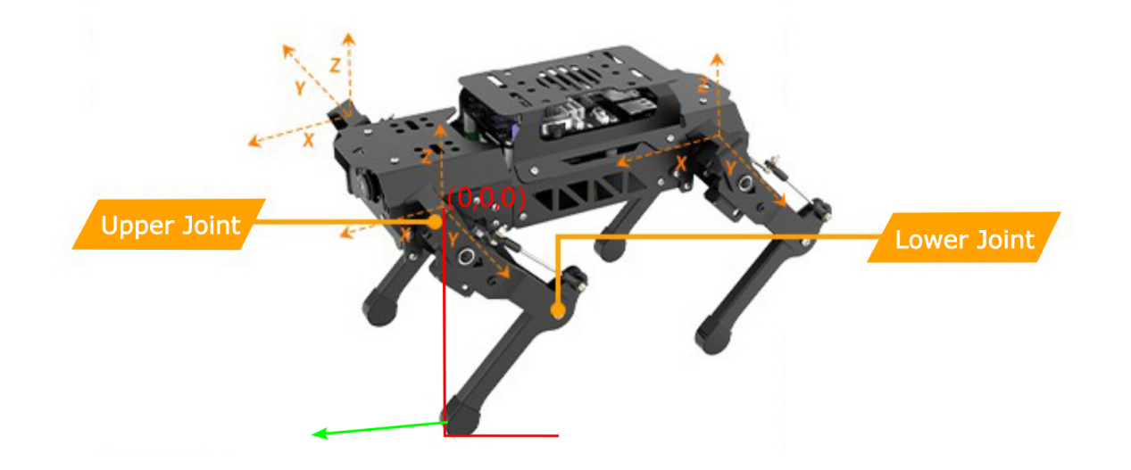

Inverse kinematics matters in PuppyPi’s path planning and control, because whether the inverse kinematics solution is fast and accurate directly affect the precision of PuppyPi’s path planing and control. Therefore, fast and accurate inverse kinematics solution is essential.

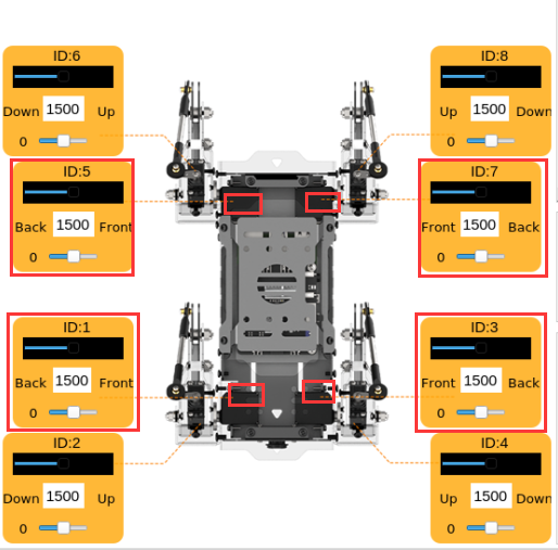

For PuppyPi, what inverse kinematics is that solve the rotation angle of upper joint and lower joint according to the foot coordinate. The joint distribution is as the picture shown.

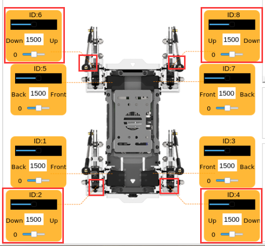

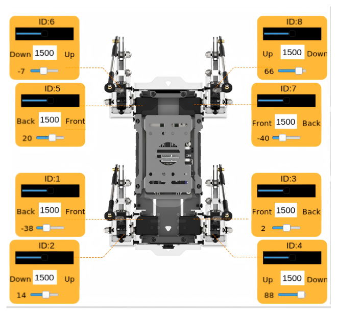

The rotation angle of upper joint is controlled by ID1,3, 5 and 7 servos on PuppyPi’s body.
And the rotation angle of lower joint is controlled by ID 2, 4, 6 and 8 servos on upper joints. Linkage mechanism is adopted in the control.
The solution procedure is divided into two steps.
(1) Calculate the position to which the upper and lower joints move so as to solve the rotation angle of the corresponding servo.
(2) According to the rotation angle of servo, calculate the corresponding value, and then directly control the servo to rotate.

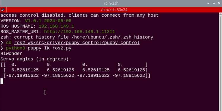

(2) Acquire servo angle
Calculate the servo angle through inverse kinematics.
joint_angles = puppy.fourLegsRelativeCoordControl(foot_locations)
(3) Control servo to rotate
Calculate the pulse width of the servo according to the angle value so as to directly control servo rotation.

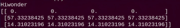

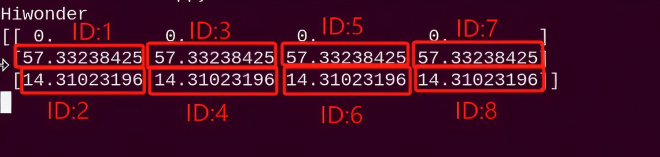

(4) Display servo angle
The servo angle will be displayed on the terminal.

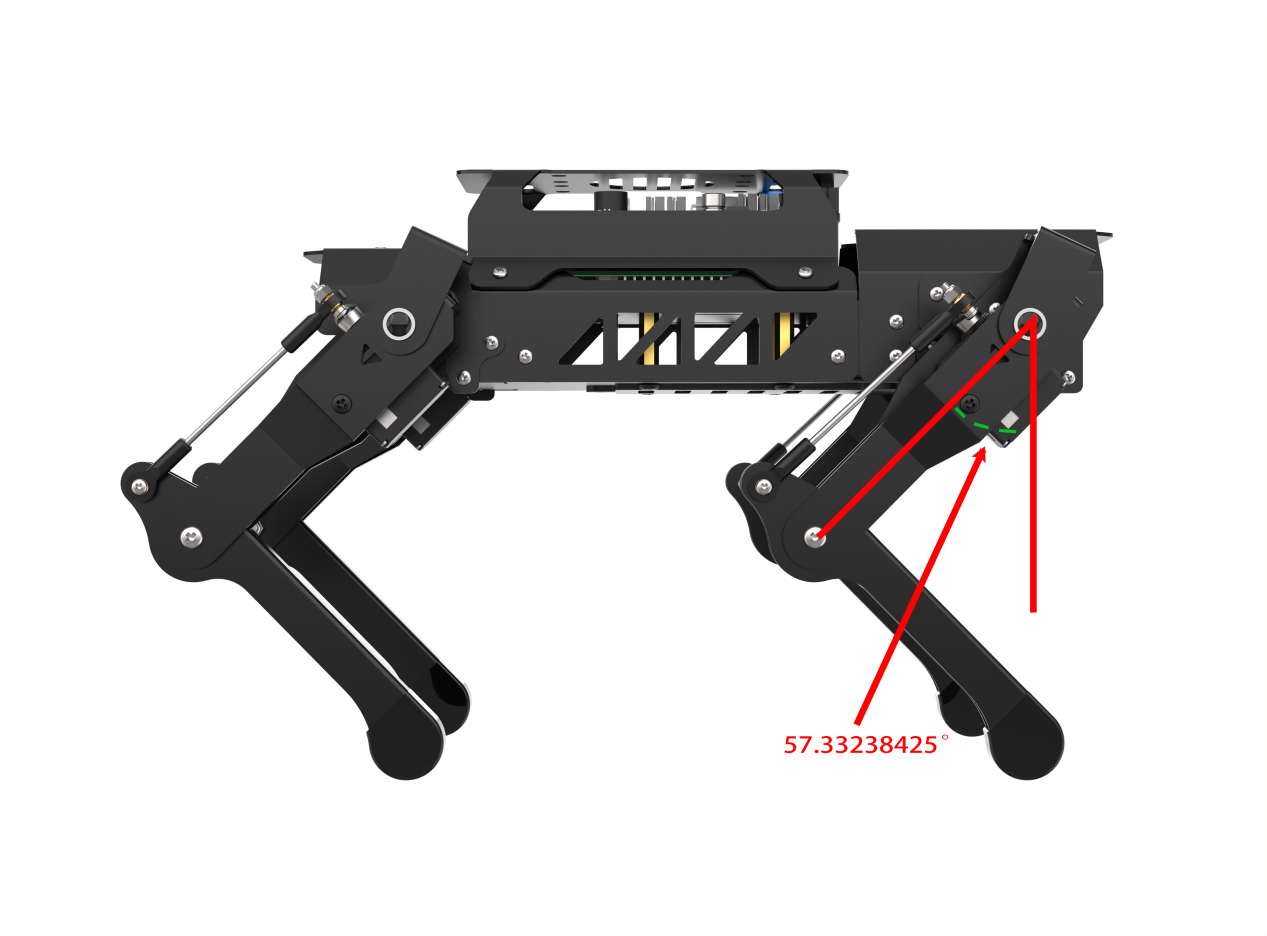

The unit of the “joint_angles” is radian. And joint_angles times 57.3 equals the final servo angle in degree.
The angle of corresponding servo is as the figure below.
Let’s take a look at the relationship between servo angle and PuppyPi’s posture. Take ID1 and ID2 for example.
In this program, the angle of ID1 servo is 57.33238425, and the current posture of PuppyPi is as the figure below shown.
When the angle of ID1 servo is positive, the corresponding leg will swing backward. When it is negative, the leg will swing forward.

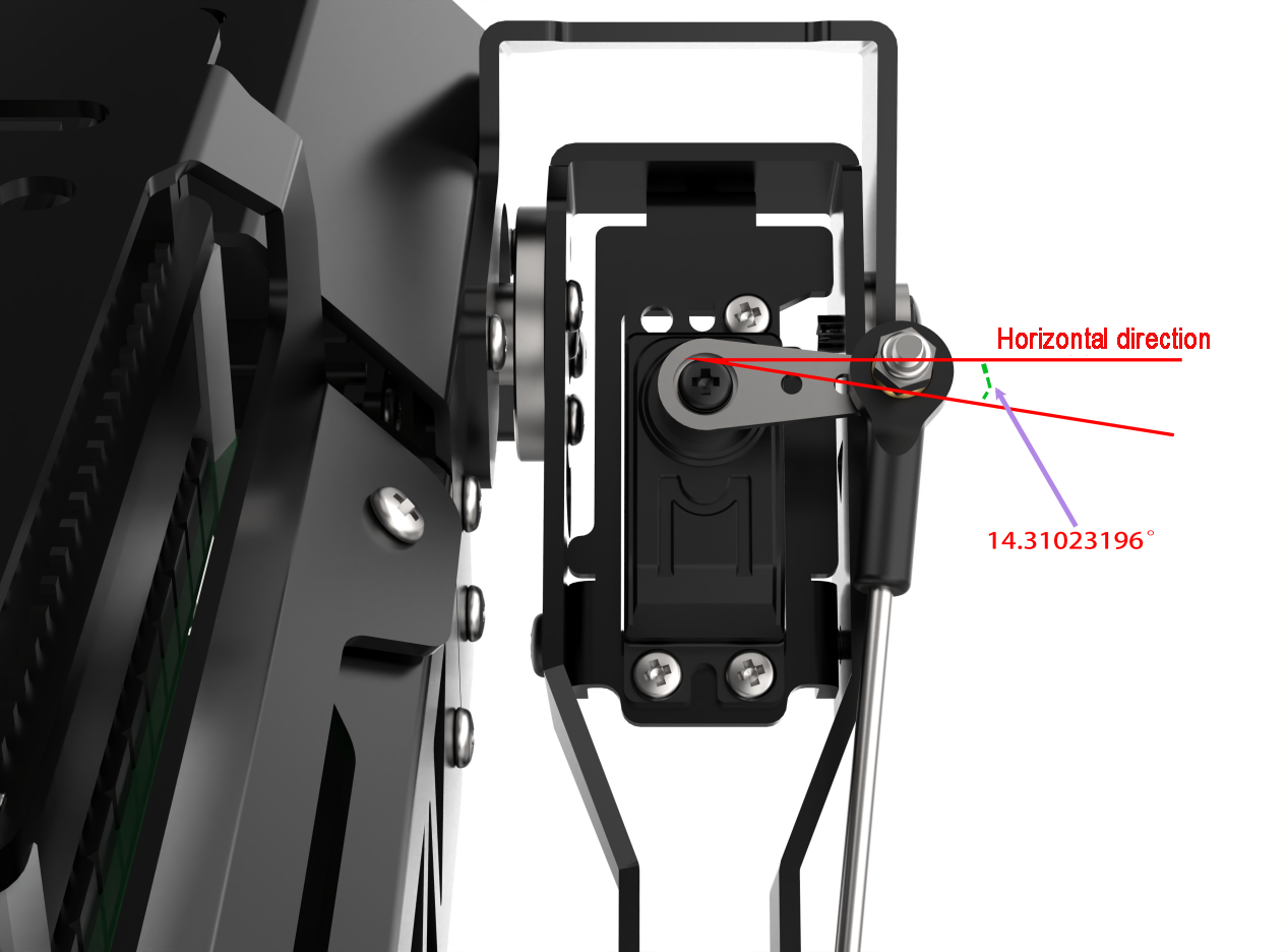

The angle of ID2 servo is 14.31023196, and the current posture of PuppyPi is as the figure below shown.
When the value is positive, the servo arm of ID2 servo is below the horizontal. When it is negative, the servo arm is above the horizontal.
20.11 Posture Parameter Instruction
20.11.1 Introduction
The parameter of static posture includes standing height, pitch angle, roll angle, etc.
PuppyPi’s posture can be changed through adjusting the coordinates of 4 footholds. And we need to call “puppy_demo.py” file to set the posture.
This file is stored in /row2_ws/src/driver/puppy_control/puppy_control/puppy_demo.py
20.11.2 Parameter Illustration
Through modifying the following parameter, we can adjust PuppyPi’s posture.

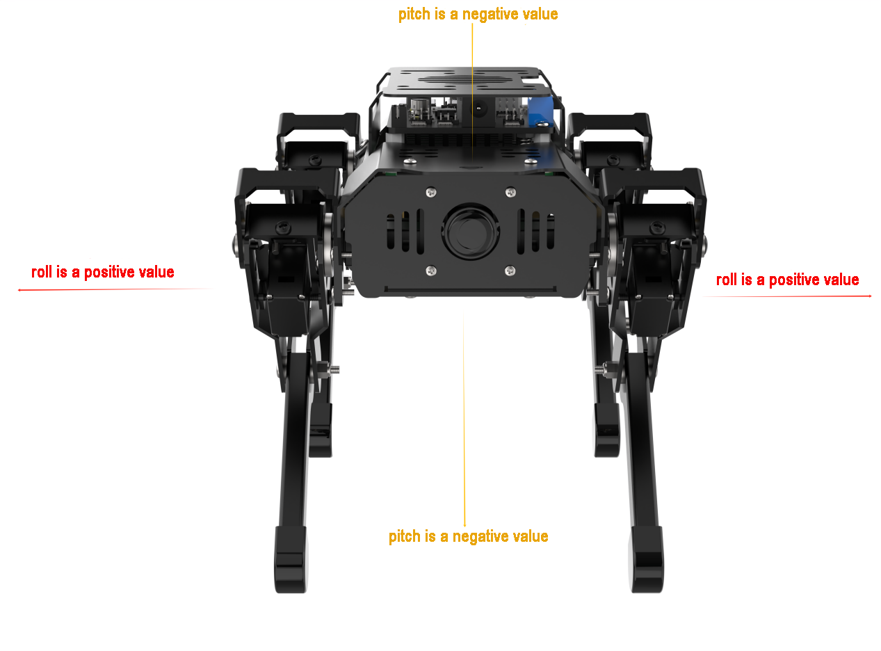

PuppyPose = {'roll':math.radians(0), 'pitch':math.radians(0), 'yaw':0.000, 'height':-10, 'x_shift':-0.6, 'stance_x':0, 'stance_y':0}
And we mainly adjust x_shift, height, pitch and roll. The explanation for the parameters are listed in the table.
Parameter Explanation
x_shift It represents that the distance that 4 footholds moves in the same direction on the X axis. It is used to balance PuppyPi's body during moving. It ranges from -10 to +10 cm.
height It indicates body height, that is the perpendicular distance between the foothold and the center of upper joint. It ranges from -15 to -5 cm.
pitch It refers to the pitch angle of the robot body ranging from -31 to +31 degree. With PuppyPi as the first vision, when the pitch angle is positive, it will look up. When the pitch angle is negative, it will look down. The larger the absolute value, the larger the pitch angle.
roll It represents that the roll angle of the body ranging from -31 to +31 degree. With PuppyPi as the first vision, when the pitch angle is positive, it will tilt to right. When the pitch angle is negative, it will tilt to left. The larger the absolute value, the greater it tills.
For example, set its body height as 10cm, and make it loop down 20° and tilt 15° to the right
PuppyPose = {'roll':math.radians(15), 'pitch':math.radians(-20), 'yaw':0.000, 'height':-10, 'x_shift':-0.6, 'stance_x':0, 'stance_y':0}

(3) Input the command to edit “puppy_demo.py
(4) Then, open a terminal again and enter the command to open the program file using the Vim editor.
(5) Press ‘i’ to enter edit mode. To facilitate observation, set the speed to 0 by modifying the ‘x’ parameter in ‘PuppyMove’ to 0, as shown in the image below:
(6) Modify the ‘roll’ and ‘pitch’ parameters in ‘PuppyPose’. The ‘roll’ represents the roll angle, and the ‘pitch’ represents the pitch angle. Both angles have a range of ‘-31° to 31°’, with the unit in degrees.
we should take PuppyPi as first-person perspective when making adjustment. When the value of “roll” is positive, PuppyPi will tilt to left. When it is negative, PuppyPi will tilt to right. When the value of “pitch” is positive, PuppyPi will look up. When it is negative, PuppyPi will look down.
(7) For this example, to make the robot dog tilt 15 degrees to the left, modify the ‘roll’ value to 15. After making the change, press the ‘Esc’ key, then enter the command and press Enter to save.
:wq
Modifications for other directions follow the same procedure, and you can adjust them as needed.
(8) Enter the command to run the program and press Enter (the command is entered in two steps):
cd ros2_ws/src/driver/puppy_control/puppy_control
python3 puppy_demo.py
To exit this mode, simply press ‘Ctrl+C’ in the LX terminal window. If the exit command doesn’t work, try pressing ‘Ctrl+C’ multiple times.
20.12.3 Program Outcome
After the game starts, PuppyPi will stand as tilting 15° to the left.

20.13.4 Dynamic Gait Control
  • Gait Introduction
Trot is a dynamic gait in which the feet at diagonal opposite ends of the body lift and strike the ground together. For example, NO.1 and NO.2 leg, or NO.3 and NO.4 leg, move synchronously.
We can control the gait through the control program.
  • Operation Steps
(3) Input the following command to start editing.
(4) Find the code that calls the gait in the position shown in the image below. By default, the program executes the Trot gait, so you can directly call and run it.
  • Dynamic Gait Setting
We need to set three parameters, including the time when 4 legs all touch the ground, the time when one leg lifts and the interval to switch between front leg and hind leg.
The codes to be set are in the red frame.
overlap_time represents the time when 4 legs all touch the ground, swing_time refers to the time when one leg lifts, and clearance_time is interval to switch between front leg and hind leg.
Please ensure clearance_time=0, overlap_timeï¼? and swing_timeï¼? when setting.
In Trot gait, PuppyPi’s four legs switch in this sequence, 1 2â†? 4â†? 2, as shown in the below figure.
The bulge represents that the leg is lifted, represents the time when four legs all touch the ground and represents the time when one leg lifts the ground.

(2) Operation Steps
① Power on the robot, then follow the steps in 3.3 Docker Container Introduction and Entry and 3.4 ROS Version Switch Tool Guide to connect via the VNC remote control software and switch to the ROS 2 environment.
② Click to open command line terminal.
③ Input the command below to access the program file.
④ You can find the code calling the gait at the location indicated in the following image. The program is default to execute Trot gait, therefore we need to modify the program. Press “i” key to enter editing mode.
⑤ Modify “Trot” as “Walk”.
  • Static Gait Setting
Please ensure that clearance_time swing_time and overlap_time when setting.
In Walk gait, PuppyPi’s four legs switch in this sequence, 1â†?â†?â†?â†?, as shown in the below figure.
The bulge represents that the leg is lifted, â‘?represents that the interval to switch between front leg and hind leg, â‘?represents the time when four legs all touch the ground and â‘?represents the time when one leg lifts the ground.

(4) The code that calls the gait can be found at the location shown in the image below. By default, the program executes the Trot gait. Press the ‘i’ key to enter edit mode.
(5) Modify “Trot” as “Amble
  • Quasi-static Gait Setting
Please ensure that 0<clearance_time<swing_time and overlap_timeï¼? when setting.
In Amble gait, PuppyPi’s four legs switch in this sequence, 1â†?â†?â†?â†?, as shown in the below figure.

During PuppyPi is moving, there are two types of parameters, including motion parameter and gait parameter. The gait parameters include the time when 4 legs all touch the ground, the time when all leg lifts and the interval to switch between front leg and hind leg. And motion parameter includes moving speed and rotation speed.
We need to call “puppy_demo.py” file to set the parameter.
The source code of the program is located in the Docker container at: /row2_ws/src/driver/puppy_control/puppy_control/puppy_demo.py
The motion status can be adjusted through modifying the parameters.
The parameters to be adjusted is in the red frame.
The parameters in picture 1 is the motion parameters, and picture 2 is the gait parameters.
The explanation for the parameter is listed below.
overlap_time Time when the ends of 4 legs all touch the ground. The unit is s.
swing_time Time when the ends of 2 legs all lift. The unit is s.
clearance_time Interval to switch between front leg and hind leg. The unit is s.
z_clearance During moving, the lifted height of the end of the leg. The unit is cm
x The moving speed ranging from -20 to +20 cm/s. When the value is positive, PuppyPi moves forward. When it is negative, it moves backward. The larger the absolute value, the faster PuppyPi moves.
yaw_rate Turning speed ranging from -0.89 to +0.89 rad/s. With PuppyPi as first-person perspective, when the value is positive, PuppyPi turn clockwise. When it is negative, PuppyPi turns counterclockwise. The larger the absolute value, the faster PuppyPi turns.
For example, we make PuppyPi turns counterclockwise in 30°/s and moves in 5cm/s. And the parameters are set as the figure shown.
The unit of 0.52 is rad/s and the converted angular velocity is 30°/s (0.52*57.3°/s�0°/s)
(4) Press “i” key to start editing. For better observation, set the speed as 0, that is set “x” in “PuppyMove” as 0, as the picture shown.
(5) Modify “height” in “PuppyPose” to adjust PuppyPi’s height within -15~-5 cm.
the smaller the value, the higher the height. -15 is the maximum height and -5 is the minimum height.
(6) For example, we modify “height” as -15. After modification, press “Esc”, and input “:wq” to save
:wq
(7) Input command and press Enter to run the program.
(8) If want to close this game, we can press “Ctrl+C”. If it fails to close the game, please try again.
20.14.3 Program Outcome
After the game starts, the body height will be lifted to the set height.

(3) Open a new ROS terminal, and run the following command to edit the file ‘puppy_demo.py’.
(4) Modify “x” in “PuppyMove” to adjust PuppyPi’s speed within -20~20 cm/s.
  • When the parameter is positive, PuppyPi will move forward. When the parameter is negative, PuppyPi will move backward.
  • The larger the absolute value of the parameter, the faster the robot moves.
  • Under different gaits, speed adjustment has influence on its stability, therefore we should adjust the speed base on the actual performance of robot.
(5) For example, we modify “x” as 12 to set the moving speed as 12 cm/s. After modification, press “Esc” and then input “:wq” to save.
The modification of the backward speed follows the same procedure. Everyone can try different speed settings to compare the changes in the robot dog’s speed.
(6) Input the command below to press Enter to run the program.
(7) If want to close this game, we can press “Ctrl+C”. If it fails to close the game, please try again.
20.15.3 Program Outcome
After the game starts, PuppyPi will move in the set speed.

(3) Input the following command to edit “puppy_demo.py
(4) Press “i” to start editing. For better observation, we need to modify “x” in “PuppyMove” as 0 to set the speed as 0.
(5) Modify “pitch” in “PuppyPose” within -31°~31°. “pitch” represents the pitch angle. When the value is positive, PuppyPi will look up. When it is negative, PuppyPi will look down. For example, we modify “pitch” as -15 to make PuppyPi look down 15° .
(6) Next, set the robot dog to the Trot gait. Locate and check if the ‘gait’ parameter is set to ‘Trot’. By default, the program uses the Trot gait, so no modification is needed. If it is not set to ‘Trot’, change it to ‘Trot’.
(7) Finally, modify the ‘x’ parameter in ‘PuppyMove’. For example, change the value to the default 5, so the robot dog moves forward at a speed of 5 cm/s. After making the change, press the ‘Esc’ key, then enter the command to save the changes.
:wq
  • You also can modify other gaits in this way.
  • The pitch angle should be modified based on the actual situation to avoid the influence on running.
(8) Input the following command and press Enter to run the program.
(9) If want to close this game, we can press “Ctrl+C”. If it fails to close the game, please try again.
20.16.3 Program Outcome
After the game starts, PuppyPi will Trot with head down.
