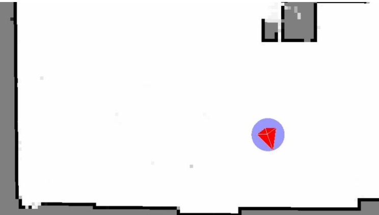

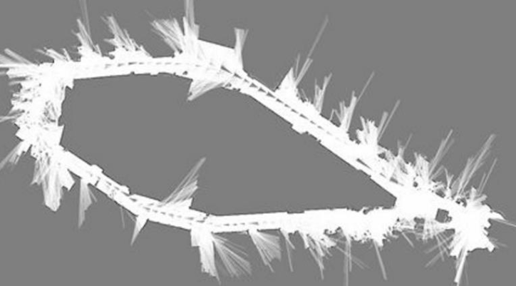

31.1.4 Evaluation of Map Building Results
After the map construction is completed, the following points can be used to determine if the results meet the navigation requirements:
(1) Whether the edges of obstacles in them map are clear.
(2) Whether there are areas in the map that do not match the actual environment (e.g. loop closures).
(3) Whether there are gray areas within the robot’s operational area in the map (e.g. unscanned areas).
(4) Whether there are obstacles in the map that will not exist during subsequent localization (e.g. moving obstacles).
(5) Whether the map ensures that the robot has explored every position within its operational area, with a 360-degree field of view.

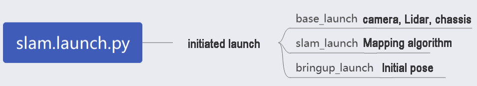

31.2.5 Launch File Analysis
The launch file is located in the Docker container at: /home/ubuntu/ros2_ws/src/slam/launch/slam.launch.py
(1) Import library
The launch library can be referenced in the official ROS documentation for detailed explanations:
(2) Setting the Path
if compiled == 'True':
(3) Launching Other Files
        launch_arguments={
            'sim': sim,
            'master_name': master_name,
            'robot_name': robot_name
        }.items(),
        launch_arguments={
            'use_sim_time': use_sim_time,
            'map_frame': map_frame,
            'odom_frame': odom_frame,
            'base_frame': base_frame,
            'scan_topic': '{}/scan'.format(frame_prefix),
            'enable_save': enable_save
        }.items(),
        bringup_launch = GroupAction(
         actions=[
             PushRosNamespace(robot_name),
             base_launch,
             TimerAction(
                 period=6.0,
                 actions=[slam_launch],
base_launch: Launches the required hardware for the system.
slam_launch: Launches the basic mapping setup.
puppy_control: Launches the motion control setup.
