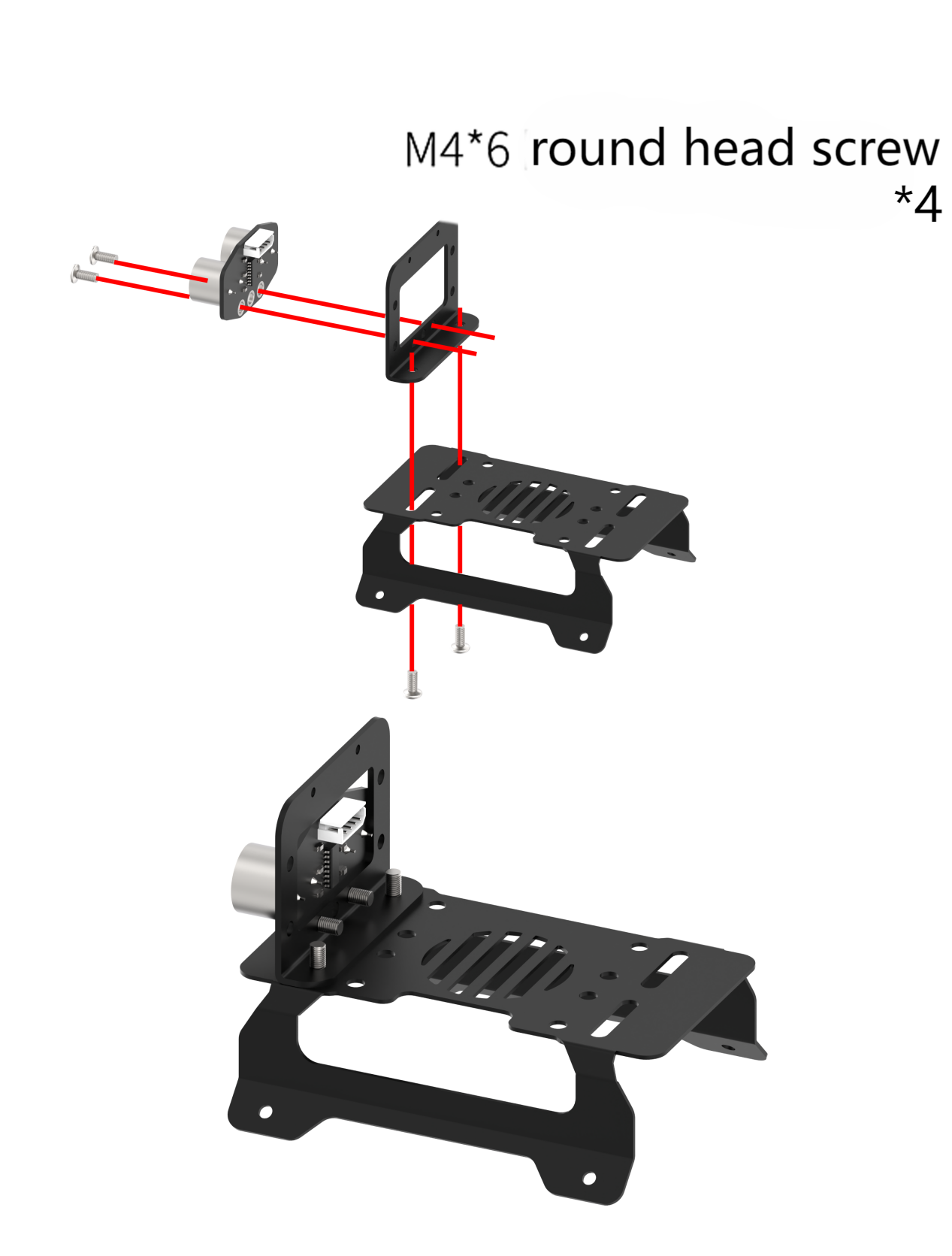

  • Assembly
13.1.2 Getting Ready
Prepare a glowy ultrasonic sensor and connect it to any IIC interface on Raspberry Pi expansion board with 4PIN wire as the picture shown.
4PIN wire adopts anti-reverse plug in design, please don’t insert violently.

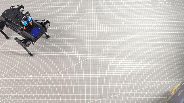

After the program starts, place an obstacle in front of the glowy ultrasonic sensor. Then the measured distance will be printed on the terminal. And the RGB colored light will illuminate in corresponding color according to the distance.
Distance ≤ 300mm: red light on.
300mm≤ Distance ≤ 500mm: green light on.
Distance ≥500mm: blue light on.

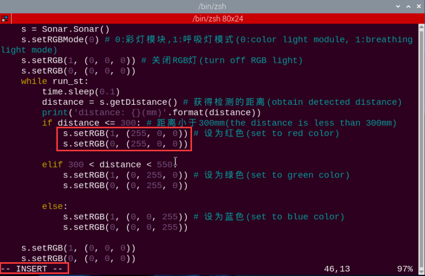

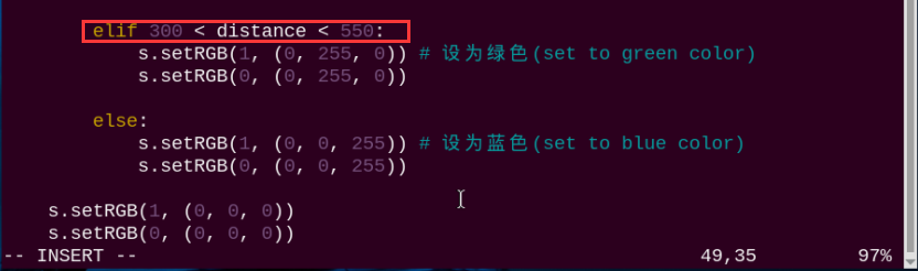

The corresponding distance range of different light colors can be modified. For example, we set green light to turn on when “300<distance<550”, and blue light to turn on when “distance>550”.
(1) Click at upper left corner to open Terminator.
(2) Enter the following command and press Enter to open the program file.
rosed puppy_extend_demo sonar_control_demo.py
(3) Next, scroll down to the codes in the red frame. Press i key to enter the editing mode.
(4) Modify the values as the picture shown.

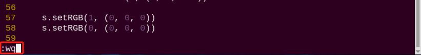

(5) After modification, press “Esc”, input” :wq”and press Enter to save and exit editing.

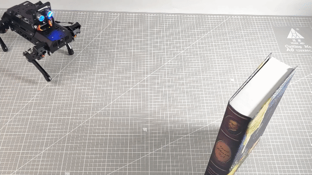

13.2.5 Program Outcome
After the program starts, place an obstacle in front of the glowy ultrasonic sensor. Then the measured distance will be printed on the terminal. When distance is greater than 300mm, RGB light will emit blue light and PuppyPi will keep moving forward. When the distance is less than or equal to 300mm, RGB light will emit red light and PuppyPi will keep turning left.

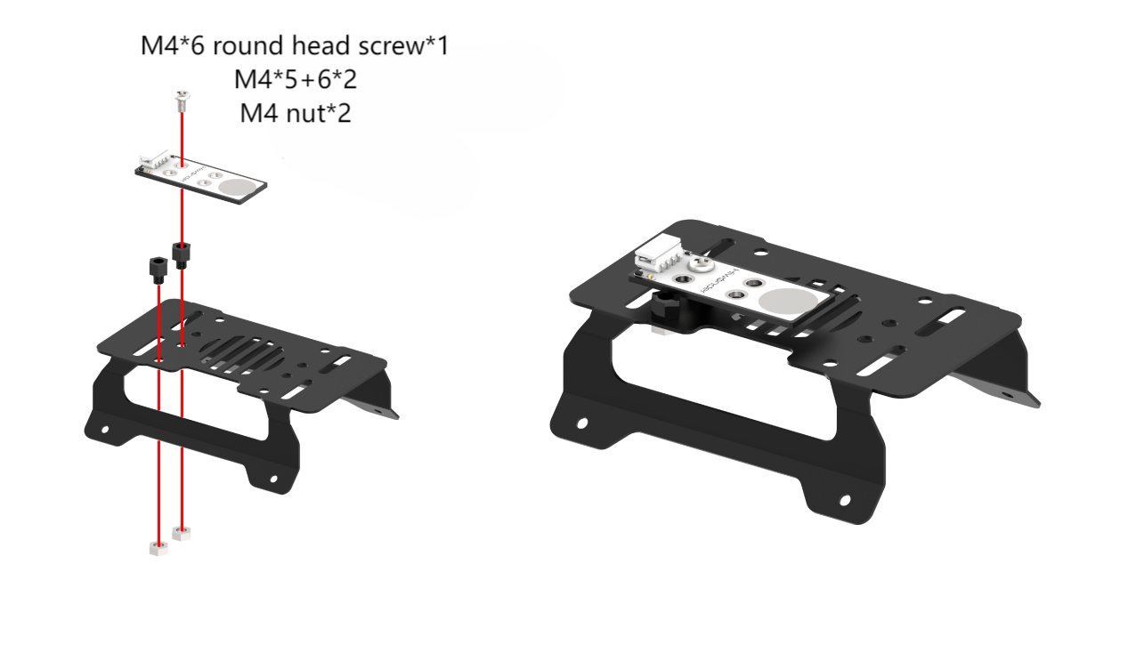

13.3 Touch Sensor Installation and Sensing

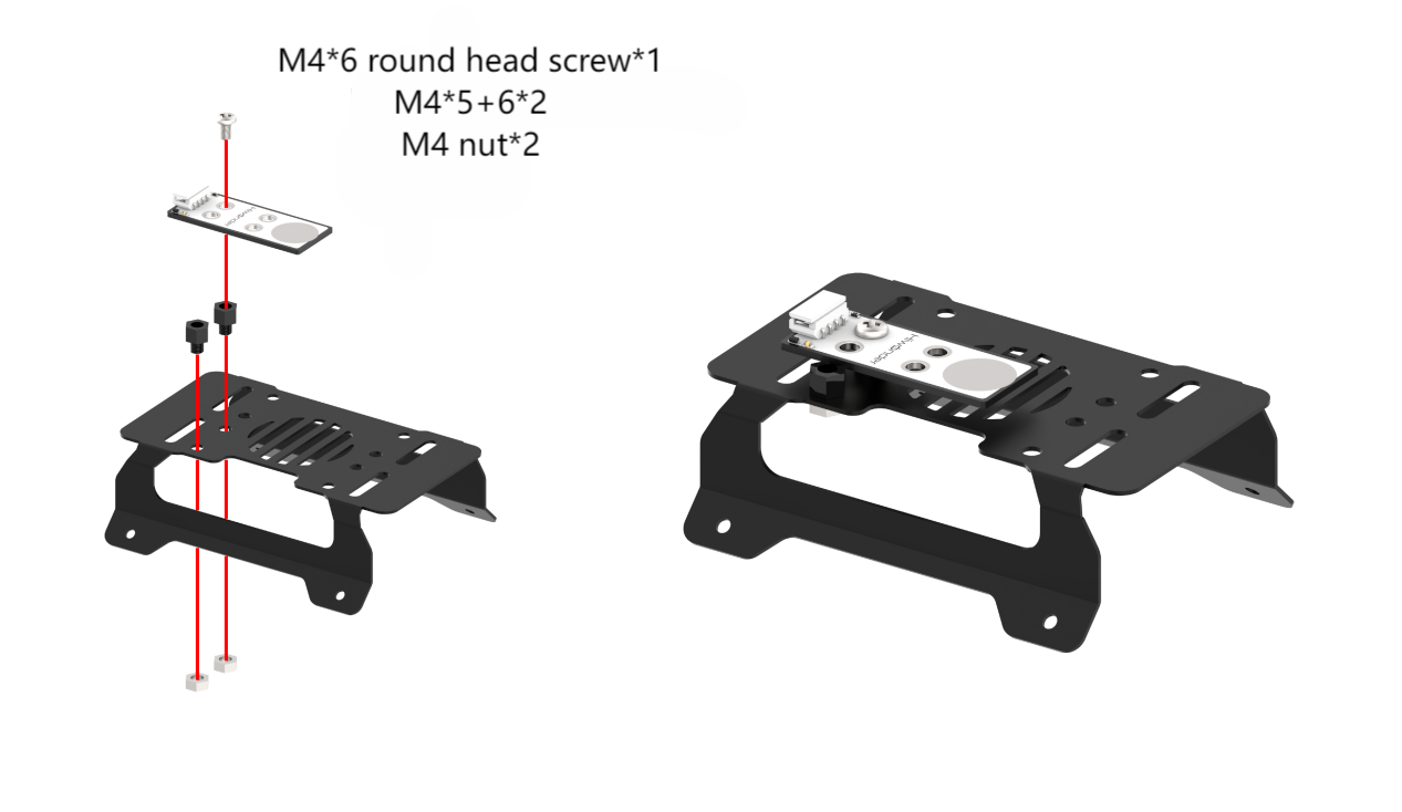

  • Assembly
13.3.1 Getting Ready
Prepare a touch sensor and connect it to 5V GND IO22 IO24 interface on Raspberry Pi expansion board with 4PIN wire as the picture shown.

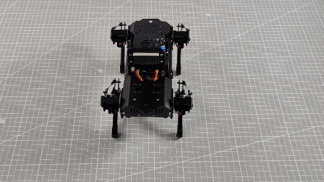

  • Assembly

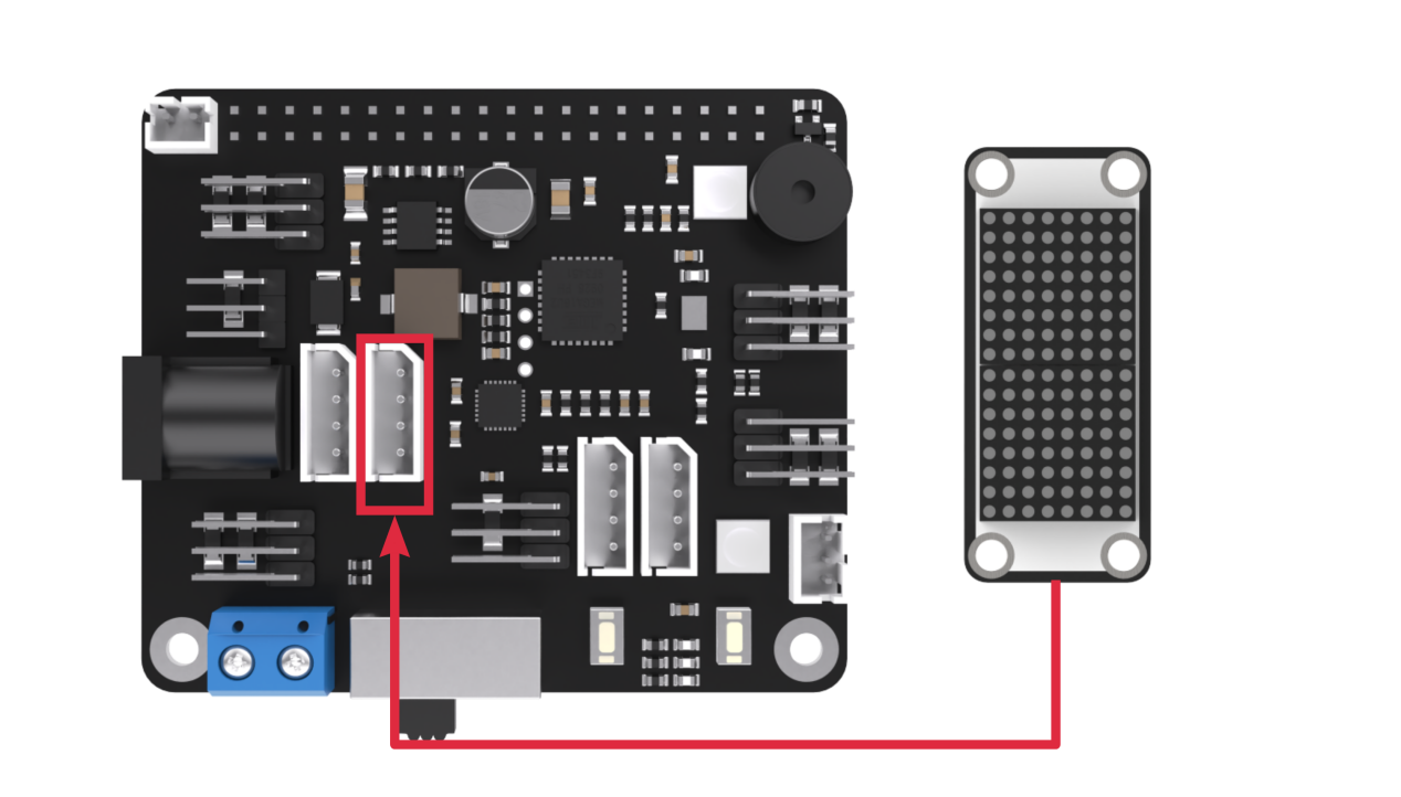

13.4.1 Getting Ready
Prepare a dot matrix display and connect it to 5V GND IO7 IO8 interface on Raspberry Pi expansion board with 4PIN wire as the picture shown.
4PIN wire adopts anti-reverse plug in design. Please do not insert it to the interface violently.

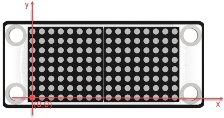

13.4.2 Dot Matrix Display Introduction
Dot matrix display module composed of two 8x8 LED dot matrix screens, which can be controlled through driving the control chip. It features high brightness, no-flicker display, convenient wiring, etc. And it can display various content, including number, text, pattern, etc.

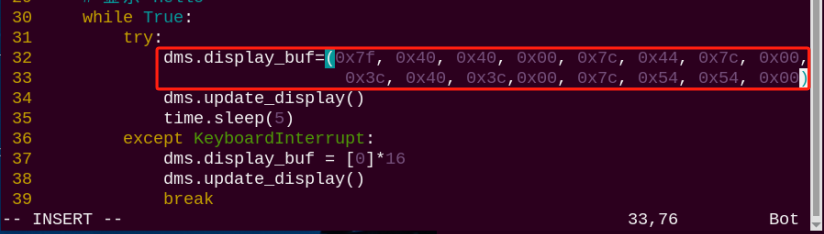

13.4.3 Program Logic

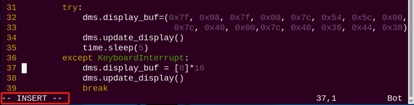

In this program, a set of hexadecimal data is used to control the dot matrix screen to display the content. A set of hexadecimal data consists of 16 data each of which controls a column of LED.
It is simple to set the data. For example, control the dot matrix display to display Hello.
The parameter in brackets of 32nd and 33rd line are the array for setting the displayed pattern. The converted binary number of its first element 0x7f is 01111111 which represents the light status, that is off on on on on on on on.
As the same, the rest 15 elements are also for controlling the LED lights to display “Hello”.
You can find “Instructions for Using the Font Software” in the same directory of this section, where you can quickly obtain control arrays using the font software.
The source code of this program locates in /home/ubuntu/puppypi/src/puppy_extend_demo/scripts/lattice_display_demo.py

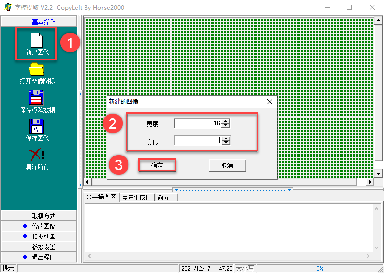

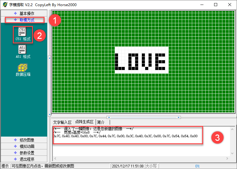

Before modification, we need to obtain the address of the character on the dot matrix display through the Internet.

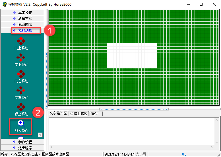

(1) Double-click to open the CharacterMatrix software in this directory.
(2) First, click on “New Image”, then in the pop-up settings box, set the size parameters for the dot matrix module. Here, set it to “16*8”. After setting, click “OK”.
(3) Then click “Simulated Animation” and “Enlarge Grid” in order to enlarge the dot matrix simulation area on the right side.
(4) Then, use the mouse to click and draw the display content in the right area.
(5) After finishing the drawing, click “Modeling Method” and then “51 Format” in sequence to obtain the address symbol (please remember the address symbol for the subsequent steps).

(7) Find the following code in the interface.
(8) Press i key on the keyboard to enter the editing mode.
(9) Replace the default address symbol in the program with the address symbol obtained from the font software, as shown in the following figure:

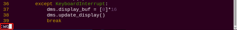

(10) After modification, press Esc and enter wq and the press Enter to save the modified content

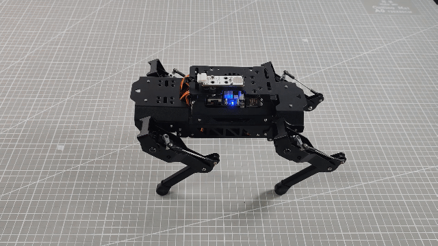

13.5.5 Program Outcome
After the program starts, PuppyPi will keep standing. When we first touch the metal plate of touch sensor, PuppyPi will squat when sensing the touch. When we touch the metal plate twice, PuppyPi will shake.
