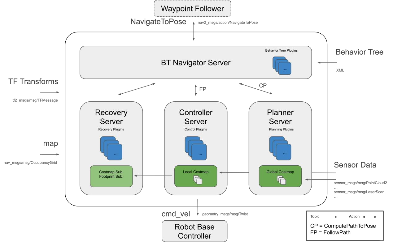

The Nav2 project builds upon and extends the spirit of the ROS navigation stack. Its goal is to enable mobile robots to move safely from point A to point B. Nav2 can also be applied to other scenarios, including robot navigation and dynamic point tracking. During this process, tasks such as dynamic path planning, motor speed calculation, obstacle avoidance, and recovery behaviors need to be completed.
Nav2 uses behavior trees to call modular servers to perform actions. These actions may include path computation, force control, recovery, or any other navigation-related tasks. These actions are executed through independent nodes that communicate with the behavior tree (BT) via ROS Action servers. The diagram below provides an overview of Nav2’s architecture:
The above architecture can be broadly divided into one major component and three smaller components.
(1) The Major Component:
BT Navigator Server: This is the main service that orchestrates and calls the three smaller services mentioned below. It serves as the central hub for navigation tasks.
(2) The Three Smaller Components:
① Planner Server: The Planner Server’s task is to compute a path that satisfies some goal functions. Depending on the selected naming convention and algorithm, this path may also be referred to as a route. Essentially, it is responsible for finding a path on the map.
② Controller Server: Known as the local planner in ROS1, the Controller Server follows the global path or completes local tasks. In simple terms, it controls the robot’s movement based on the path found by the Planner Server.
③ Recovery Server: The Recovery Server acts as a fault-tolerant system. Its goal is to handle unexpected situations or failures and autonomously resolve these issues. For example, if the robot falls into a pit during navigation, the recovery server helps it find a way to recover and continue its task.
By continuously switching between path planning, robot control, and autonomous recovery, the robot can perform autonomous navigation. However, using a static SLAM-built map alone is insufficient during navigation. New obstacles may appear during the robot’s movement, or previously detected obstacles may disappear. Therefore, the map maintained during navigation is dynamic. Based on the update frequency and usage, the map can be categorized into the following two types:

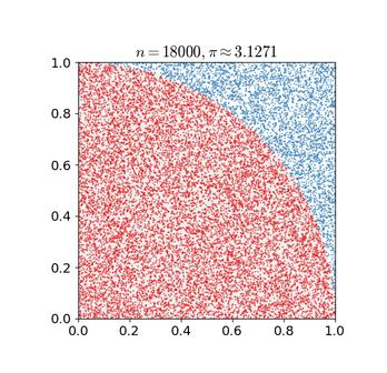

Monte Carlo Localization (MCL) involves a particle update process for a one-dimensional robot. Initially, a group of particles is randomly generated, each representing possible states of the robot, including position, direction, or other estimated state variables. Each particle has a weight, indicating its similarity to the actual system state. Next, the state of each particle for the next time step is predicted based on the expected behavior of the real system. Subsequently, the weights of particles are updated based on measurements, with particles that match the measurement being assigned higher weights. Afterward, resampling is performed, discarding highly unlikely particles and replacing them with more probable ones. Finally, the weighted mean and covariance of the particle set are calculated to obtain the estimated state.
Monte Carlo methods vary, but tend to follow a specific pattern:
(1) Define the domain of possible inputs.
(2) Randomly generate inputs from the probability distribution over the domain.
(3) Perform deterministic computations on the inputs.
(4) Summarize the results.
Two important considerations are:
(1) If these points are not uniformly distributed, the approximation may be poor.
(2) This process requires many points. If only a few points are randomly placed within the entire square, the approximation is usually poor. On average, increasing the number of points improves the accuracy of the approximation.

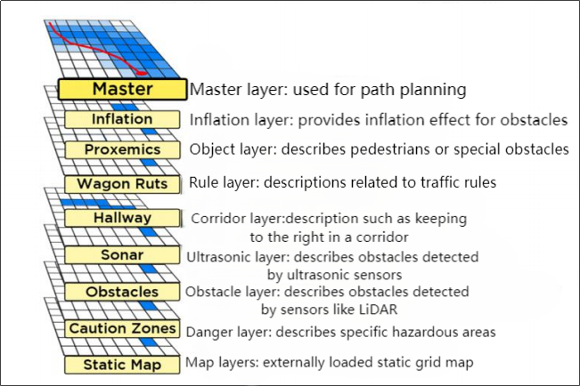

32.2.4 Costmap
Whether generated by a laser scanner or depth camera, 2D or 3D SLAM maps cannot be directly used for actual navigation. They must be converted into costmaps. In ROS, costmaps are typically represented in grid format. Each grid cell in the grid map occupies one byte, which is eight bits, capable of storing data from 0 to 255. This means that each cell cost (the value of the grid) ranges from 0 to 255, with only three scenarios considered: Occupied (presence of obstacles), Free (open space without obstacles), and Unknown Space (areas where information is lacking).

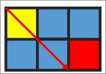

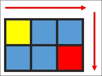

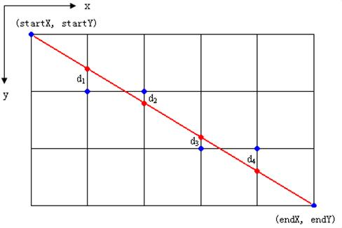

Before introducing costmap_2d, let’s first talk about the Bresenham algorithm. The Bresenham Line Algorithm is used to draw a straight line determined by two points. It calculates the closest points on an n-dimensional grid to the line segment. This algorithm only requires relatively fast integer addition, subtraction, and bit shifting operations, making it commonly used for drawing lines in computer graphics. It is one of the earliest developed algorithms in computer graphics.
Scan through the center of pixels in each row and column to construct a set of virtual grid lines as shown in the diagram above. Calculate the intersections of the line with each vertical grid line in the order from the starting point to the endpoint of the line, and then determine the pixel closest to this intersection point within the column of pixels based on the sign of the error term.
Algorithm Core Idea: Assume: k = dy/dx. Because the starting point of the line is at the center of a pixel, the initial value of the error term d is set to d0 = 0. As X increases by 1, the value of d increases correspondingly by the slope value k of the line, that is, d = d + k. Once d ≥ 1, subtract 1 from it to ensure that d remains between 0 and 1. When d < 0.5, the pixel closest to the current pixel is the one at the upper right corner (x+1, y+1), and when d < 0.5, it is closer to the right pixel (x+1, y). For convenience in computation, let e = d - 0.5, where the initial value of e is -0.5, and the increment is k. When e ≥ 0, take the pixel at the upper right corner of the current pixel (xi, yi) as (x+1, y+1), and when e < 0, it is closer to the right pixel (x+1, y). To avoid division, integers can be used. Since only the sign of the error term is used in the algorithm, it can be replaced as follows: e1 = 2*e*dx.

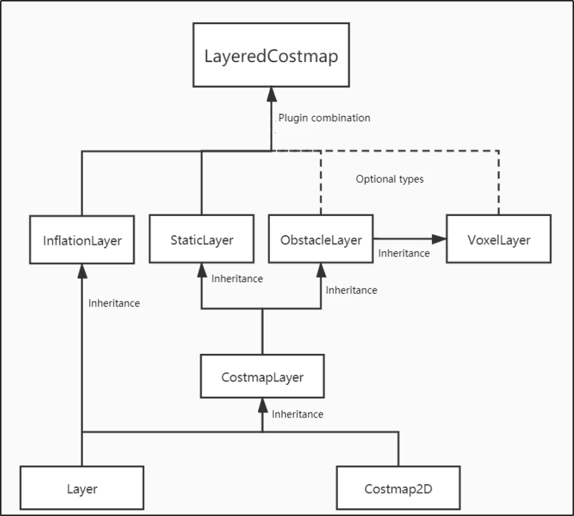

The Costmap2D class maintains the cost values for each grid. The Layer class is a virtual base class that provides a unified interface for various plugin costmap layers. The most important interface functions include:
The initialize function, which calls the onInitialize function, initializes each costmap layer separately.
The matchSize function, used in both the StaticLayer and ObstacleLayer classes, calls the matchSize function of the CostmapLayer class. This function initializes the size, resolution, origin, and default cost of each costmap layer, ensuring consistency with the layered_costmap. For the InflationLayer class, it calculates a cost table that varies with distance based on the inflation radius. This allows for querying the cost values of inflated grid cells based on distance. Additionally, the seen_ array is defined to mark whether a grid cell has been traversed. For the VoxelLayer class, it initializes the size of voxel grids.
The updateBounds function adjusts the size range that the current costmap layer needs to update. For the StaticLayer class, it sets the update range of the costmap to the size of the static map (note: the static layer is generally used only in the global costmap). For the ObstacleLayer class, it traverses the sensor data in “clearing_observations” to determine the boundaries of the obstacles.
The initialize and matchSize functions are executed only once. The updateBounds and updateCosts functions are executed periodically, with their execution frequency determined by map_update_frequency.
The CostmapLayer class inherits from both the Layer class and the Costmap2D class and provides several methods for updating cost values. The StaticLayer and ObstacleLayer classes need to store the cost values of the instantiated costmap layer, so they both inherit from the CostmapLayer class. The StaticLayer class updates its costmap using static grid map data, while the ObstacleLayer class updates its costmap using sensor data. The VoxelLayer class, compared to the ObstacleLayer class, additionally considers data along the z-axis. The main difference in their effects is reflected in the clearing of obstacles: one performs clearing in a two-dimensional plane, while the other handles it in three dimensions.
The costmap is highly flexible in measuring obstacles, allowing for the creation of specific layers as needed, where obstacle information can be maintained. If the robot is equipped only with a laser scanner, an Obstacles layer should be created to maintain the obstacle information detected by the laser scanner. If the robot also has ultrasonic sensors, a new Sonar layer should be created to maintain the obstacle information detected by the sonar sensors. Each layer can have its own rules for updating obstacles, such as adding obstacles, removing obstacles, and updating the confidence of obstacle points, which greatly enhances the scalability of the navigation system.

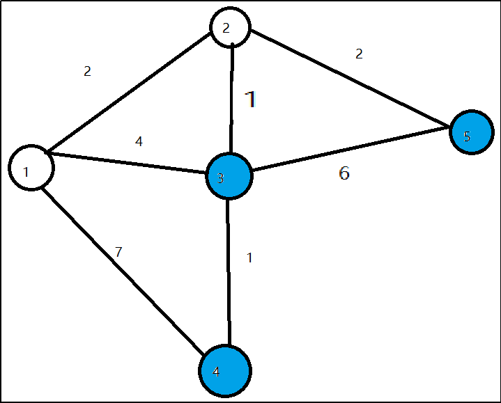

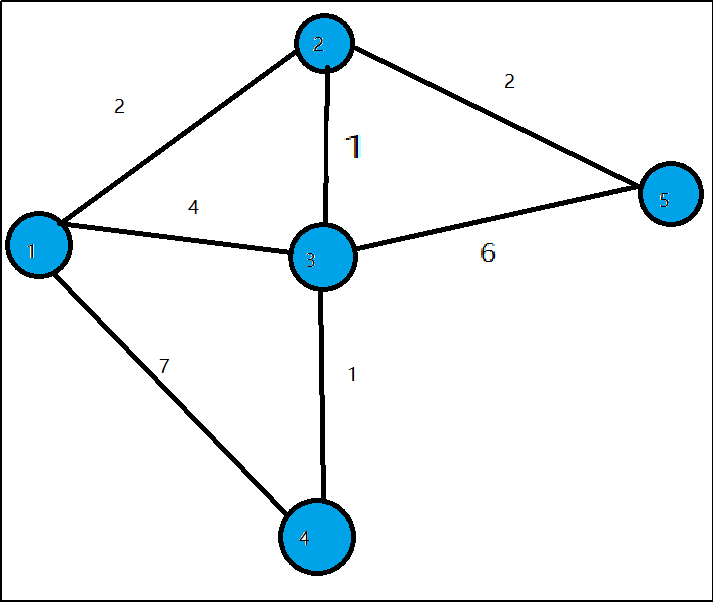

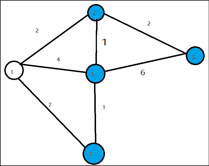

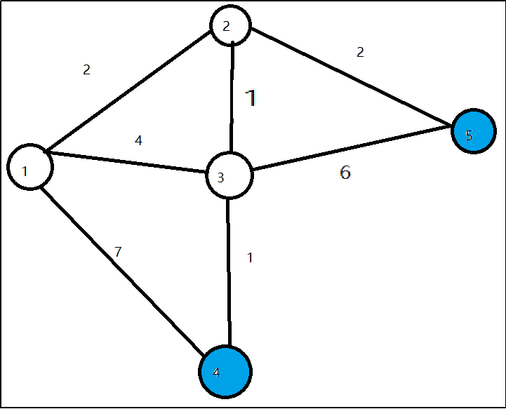

The Dijkstra algorithm is a typical shortest path algorithm. It is a single-source shortest path algorithm characterized by expanding outward from the starting point in a breadth-first search manner until reaching the destination. It is a breadth-first algorithm that considers edge weights and is one of the most commonly used algorithms in global path planning problems.
Below is an illustration of the Dijkstra algorithm.
(1) At the beginning, we initialize dis[start] to 0, and the rest of the points are initialized to inf.
(2) In the first loop, we find the point 1 with the minimum dis value. We then mark 1 as visited and update the dis values of all adjacent blue points. Specifically, we set dis[2] = 2, dis[3] = 4, and dis[4] = 7.
(3) In the second loop, we find the point 2 with the minimum dis value. We then mark 2 as visited and update the dis values of all adjacent blue points. Specifically, we set dis[3] = 3 and dis[5] = 4.
(4) In the third loop, we find the point 3 with the minimum dis value. We then mark 3 as visited and update the dis value of the adjacent blue point. Specifically, we set dis[4] = 4.
(5) In the following two loops, we mark points 4 and 5 as visited, respectively, and the algorithm ends. We have found the shortest paths from the start node to all other nodes.

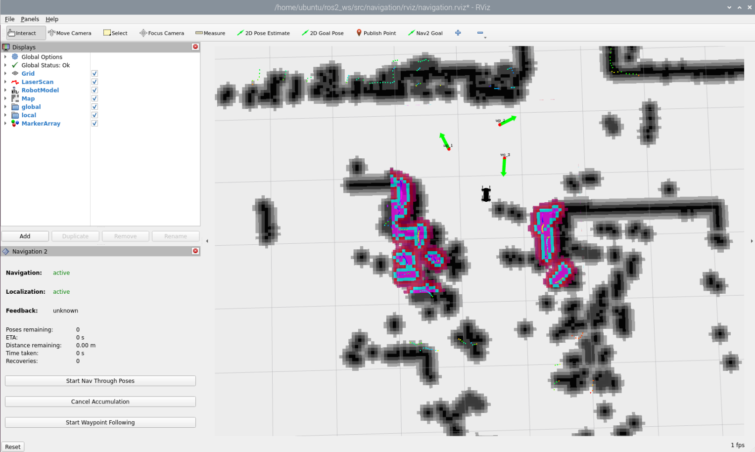

(4) Open a new terminal, enter the following command to launch the RViz tool and display the navigation:

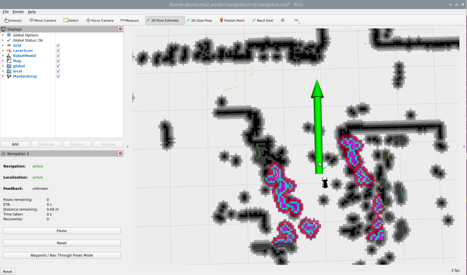

Single-Point Navigation

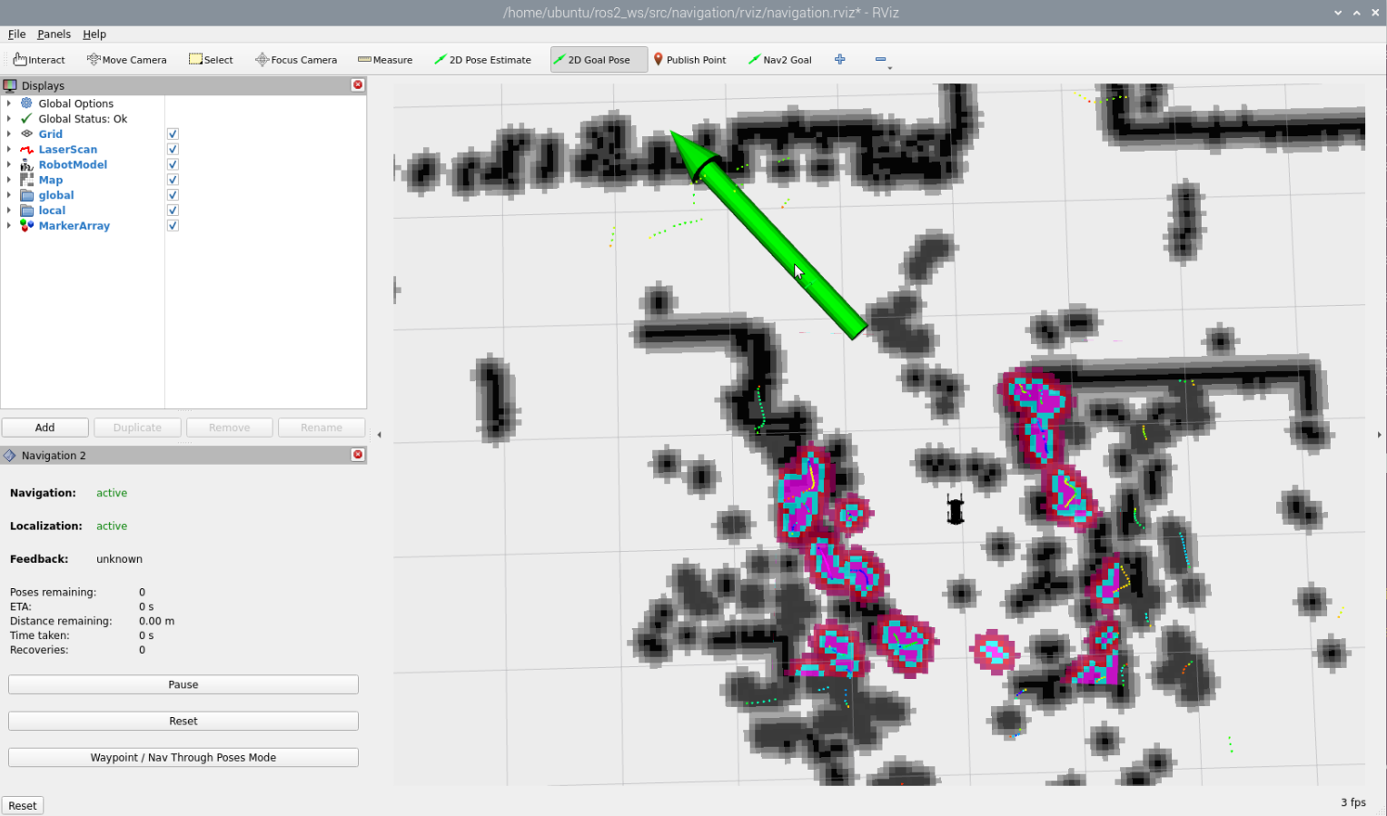

In the software menu, the “2D Pose Estimate” is used to set the initial position of the PuppyPi robot; the “2D Goal Pose” is used to set a single goal point for the robot; and the “Publish Point” is used to set multiple goal points for the robot.
To set the robot’s initial position, click on
. On the map interface, select the location and click and drag the mouse to set the robot’s pose.
(1) After setting the initial position, it will appear as shown below:

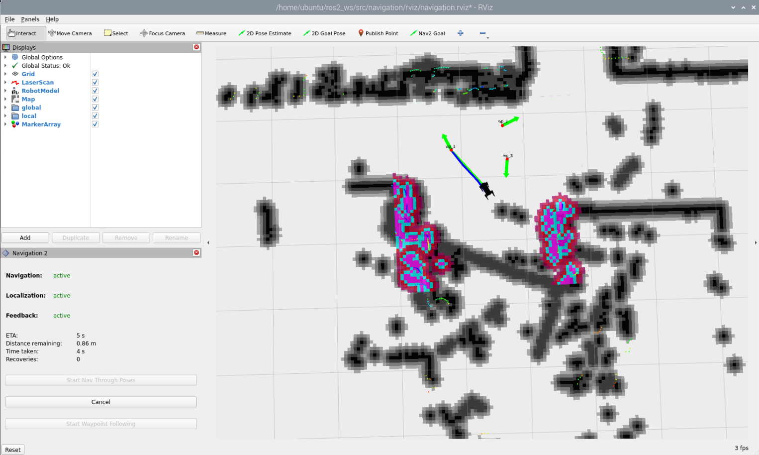

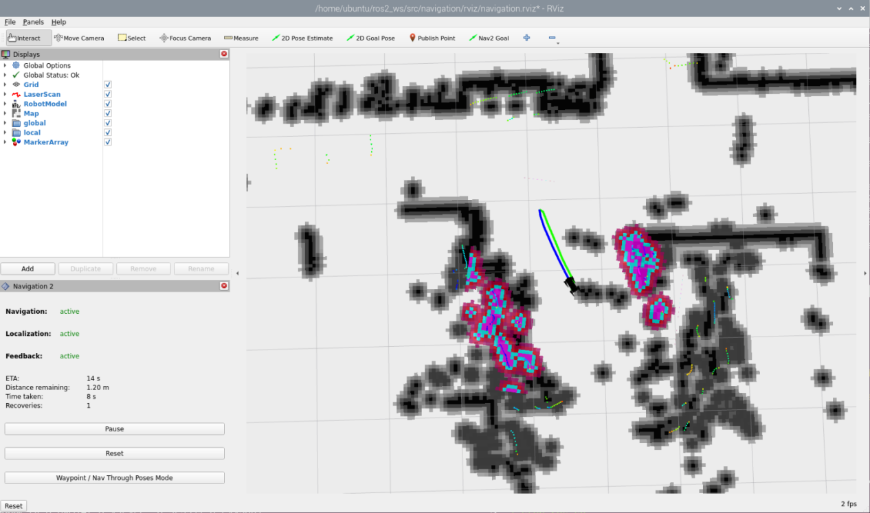

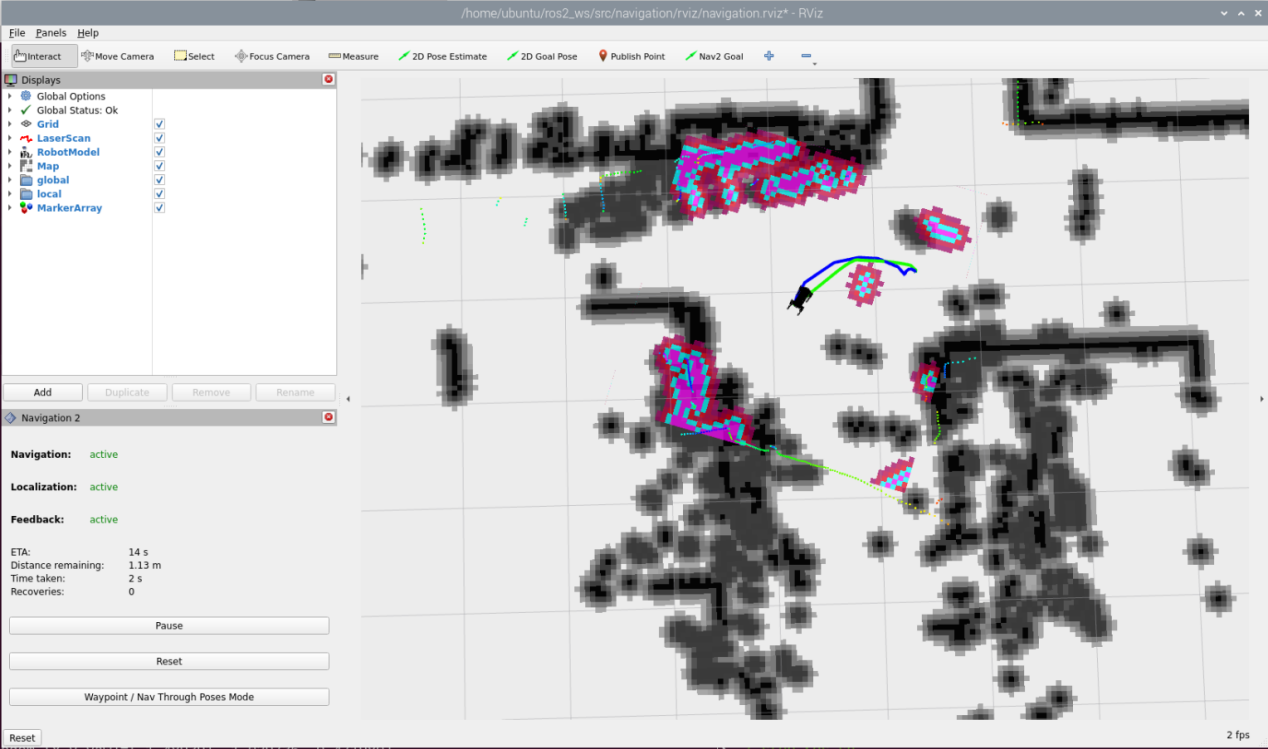

(2) To set the goal point, click
and select a location on the map. Click once on the point you wish to set as the target. Once selected, the robot will automatically generate a route and move to the goal point.
(3) After confirming the goal point, the map will display two paths: the straight line (green) between the robot and the goal point, and the planned path (dark blue) for the robot.
(4) If an obstacle is encountered, the robot will navigate around it while continuously adjusting its pose and travel path.

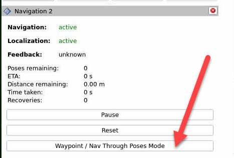

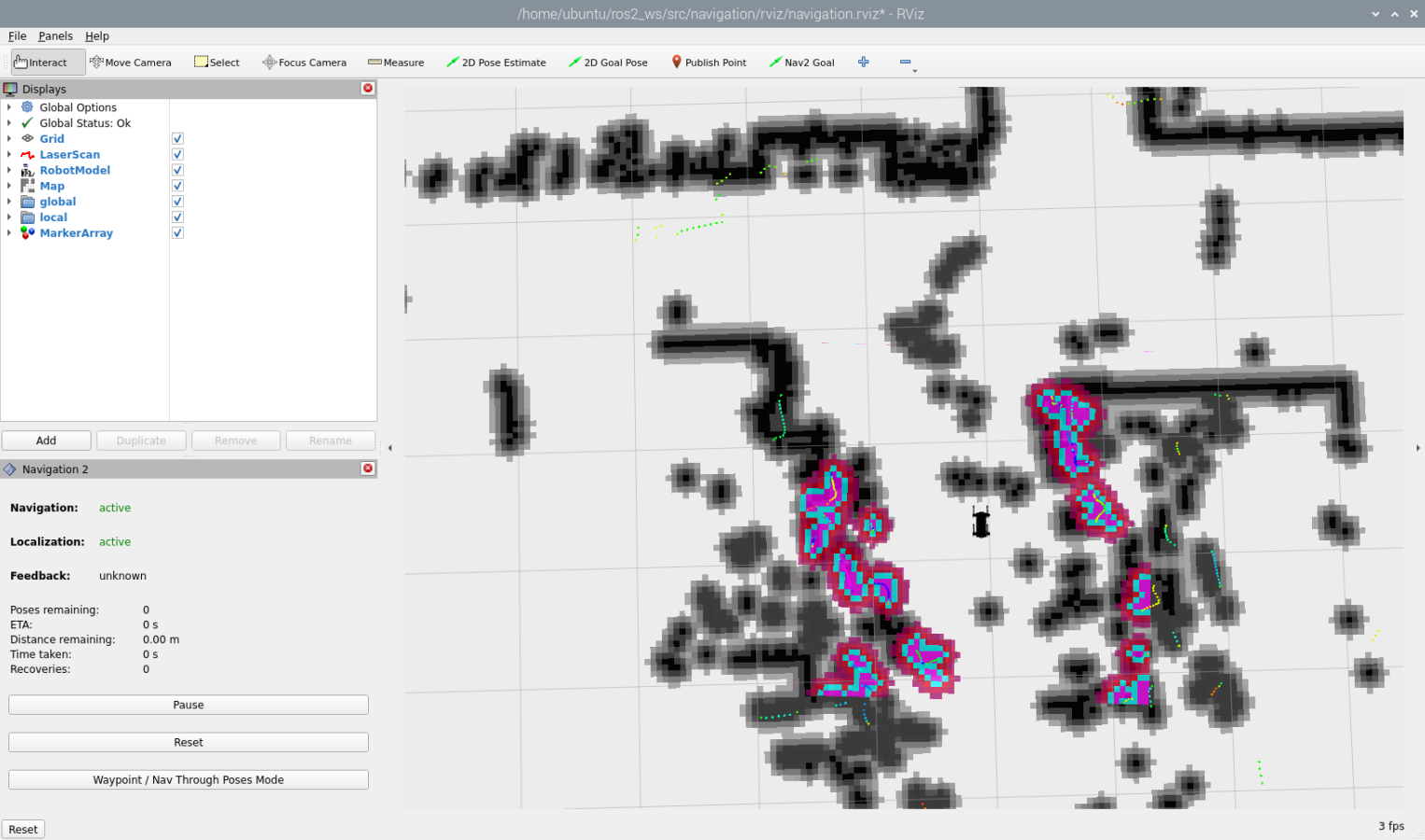

Multi-Point Navigation

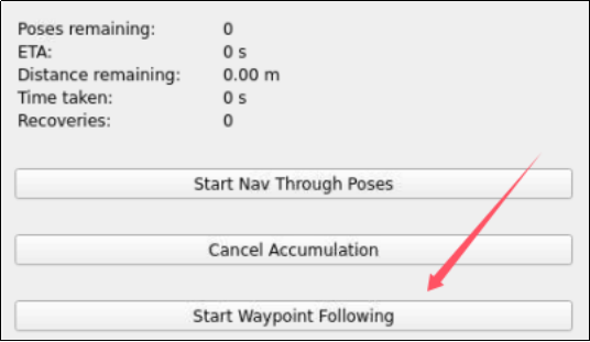

(1) Click the “Waypoint” button to begin multi-point navigation.
(2) Set multiple navigation points using
as shown below:
(3) Finally, click “Start Nav Through Poses” or “Start Waypoint Following” to enable navigation. “Start Nav Through Poses” will not focus on the robot’s pose at each navigation point, while “Start Waypoint Following” will control the robot’s pose at each point.
(4) The multi-point navigation will proceed as shown below, with the robot reaching each goal point in order:
(5) The multi-point navigation effect is as below:
