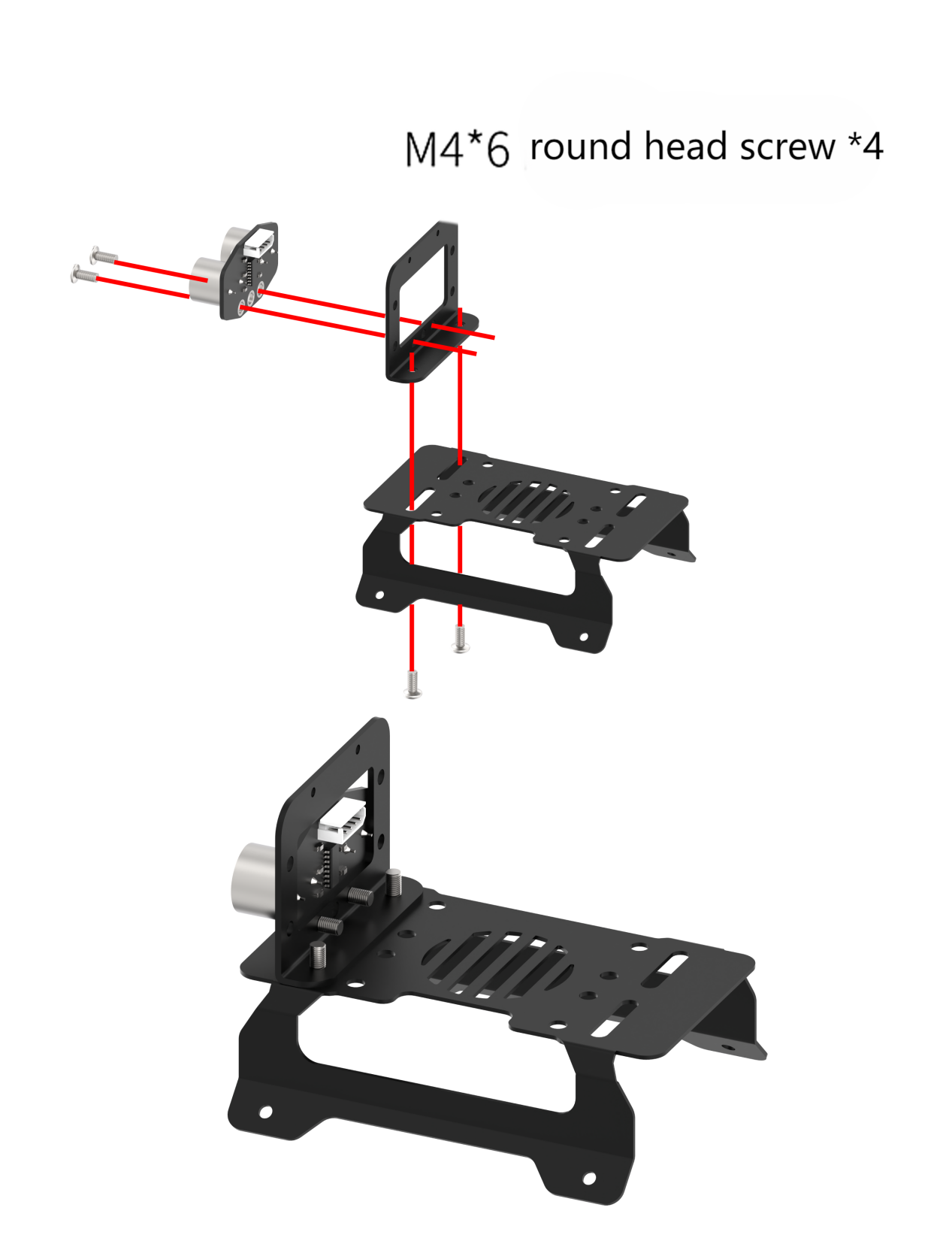

  • Assembly

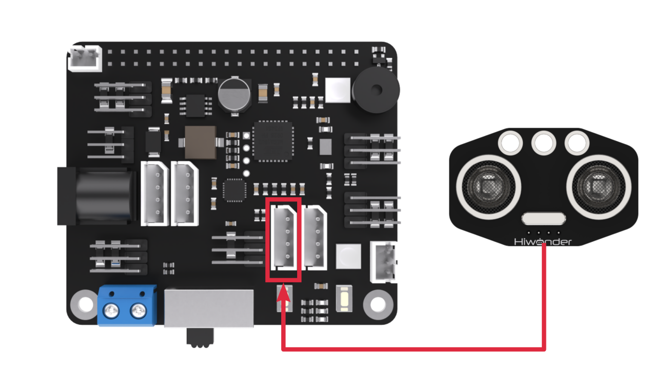

29.1.1 Getting Ready

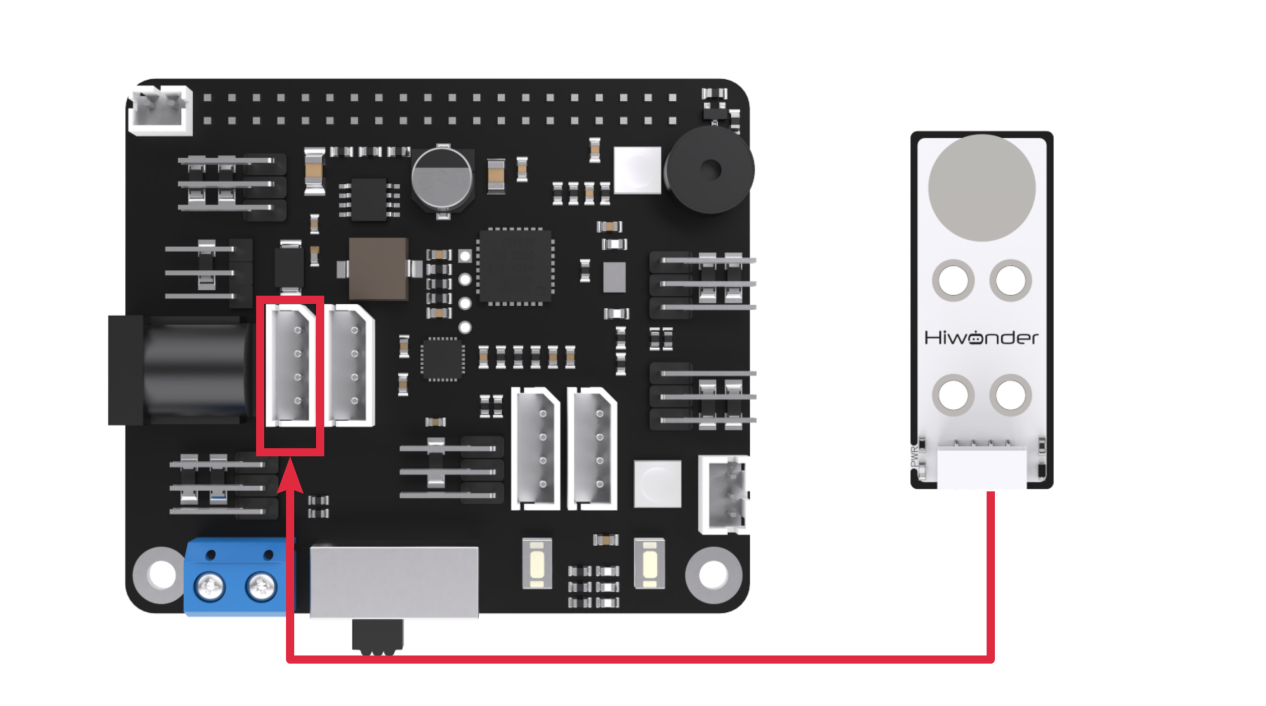

Prepare a glowy ultrasonic sensor and connect it to any IIC interface on Raspberry Pi expansion board with 4PIN wire as the picture shown.
4PIN wire adopts anti-reverse plug in design, please don’t insert violently.

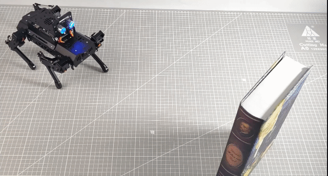

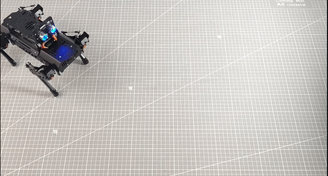

29.1.5 Program Outcome
After the program starts, place an obstacle in front of the glowy ultrasonic sensor. Then the measured distance will be printed on the terminal. And the RGB colored light will illuminate in corresponding color according to the distance.
Distance ≤ 300mm: red light on.
300mm≤ Distance ≤ 500mm: green light on.
Distance ≥500mm: blue light on.

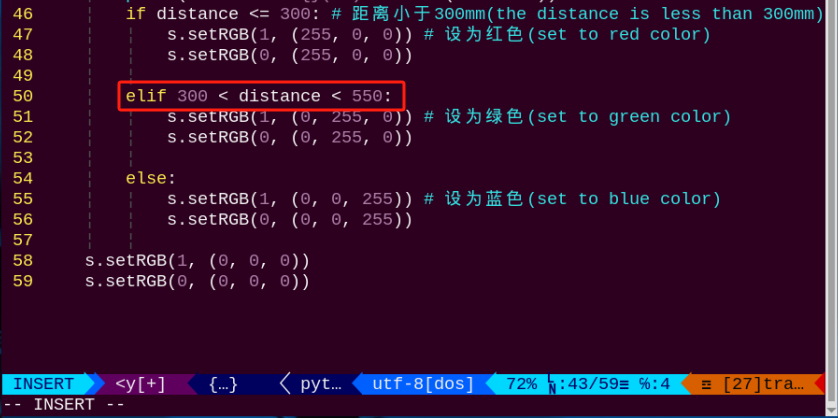

  • Modify Distance Range
The corresponding distance range of different light colors can be modified. For example, we set green light to turn on when 300<distance<550, and blue light to turn on when distance>550.
(1) Click at upper left corner to open Terminator.
(2) Enter the following command to switch to the directory containing the programs:
cd ros2_ws/src/example/example/puppypi_with_sensor
(3) Enter the following command and press Enter to open the gameplay program file:
vim sonar_control_demo.py

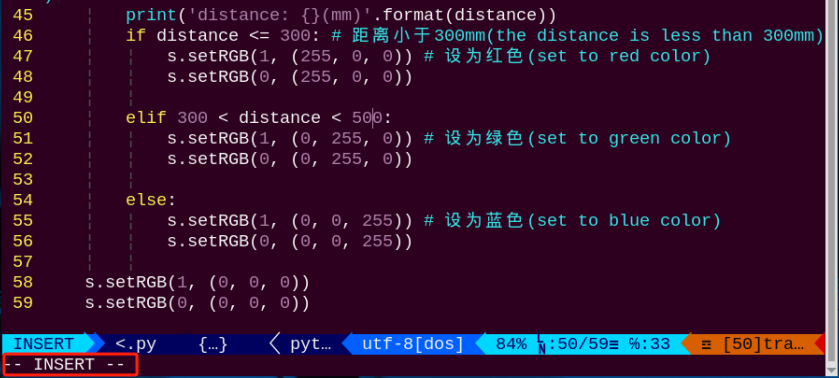

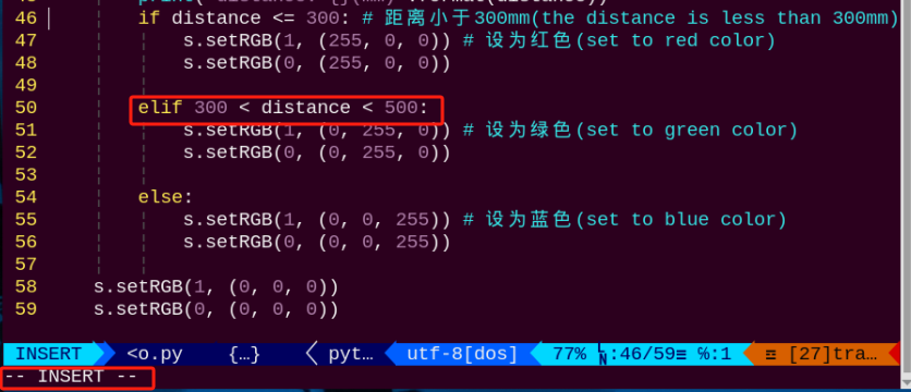

(4) Locate the code section highlighted in the image below. Press the “i” key to enter edit mode.
(5) Modify the data as illustrated.

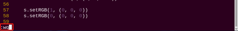

(6) When you finish editing, press the “Esc” key. Then type “:wq” (with a colon) and press Enter to save your changes and exit.

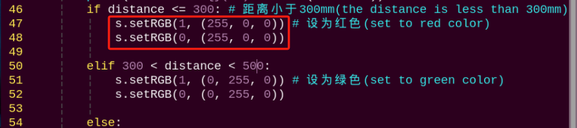

  • Customizing RGB Light Colors
You can also change the color of the RGB lights. This example demonstrates how to change the light color from red to yellow by following these steps:
(1) Refer to steps (1) and (2) in Section 6.1: Adjust the Detection Distance for the RGB Light to open the gameplay program file.
(2) In the opened file, locate the code segment highlighted below. Press the “i”key to enter edit mode.
(3) Adjust the RGB values to change the light color.
Replace s.setRGB(1,(255,0,0)) and s.setRGB(0,(255,0,0)) with s.setRGB(1,(255,255,0))and s.setRGB(0,(255,255,0)) as shown in the example.
RGB values correspond to the intensity of Red, Green, and Blue components of a color. By mixing these primary colors in varying proportions, any color can be produced. When the values are similar, the color tends toward gray or white/black tones. Higher values produce lighter colors (closer to white), while lower values produce darker colors (closer to black).
(4) After modification, press Esc, input :wq and press Enter to save the modified data.

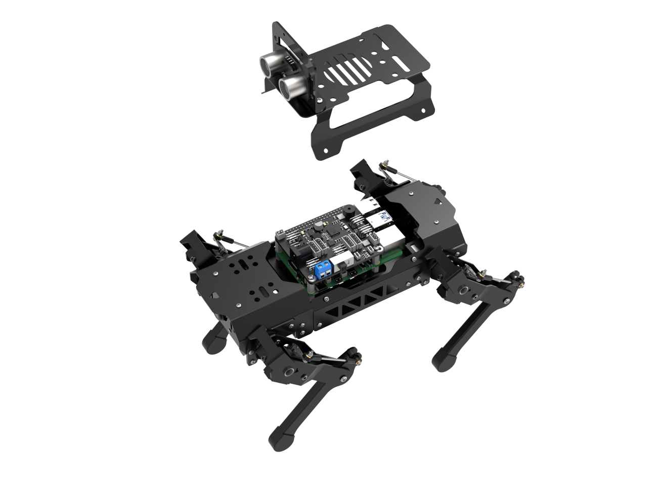

  • Assembly
29.2.1 Getting Ready
Prepare a ultrasonic sensor and connect it to any IIC interface on Raspberry Pi expansion board with 4PIN wire as the picture shown.

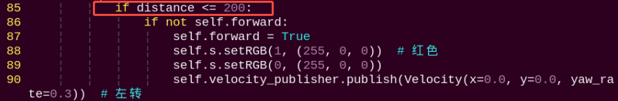

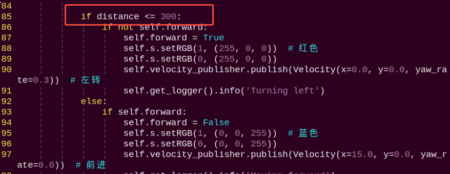

(4) Find the section of code that sets the detection distance. Press i to enter edit mode.
(5) Change the value from 300 to 200 as needed.
(6) After editing, press Esc, then type :wq and press Enter to save and exit the editor.

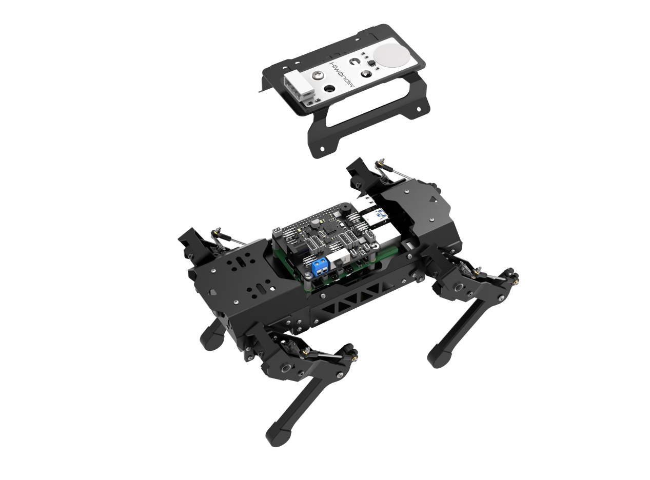

29.3 Touch Sensor Installation and Sensing

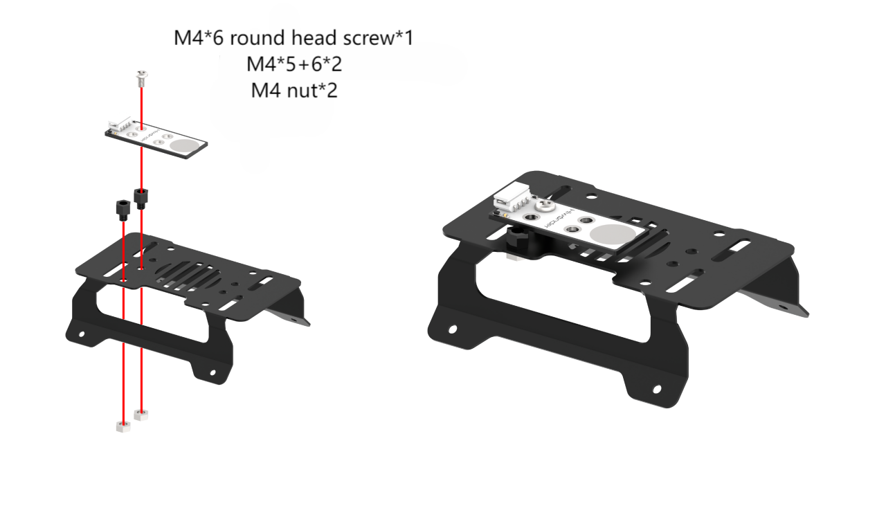

  • Assembly
29.3.1 Getting Ready
Prepare a touch sensor and connect it to 5V GND IO22 IO24 interface on Raspberry Pi expansion board with 4PIN wire as the picture shown.

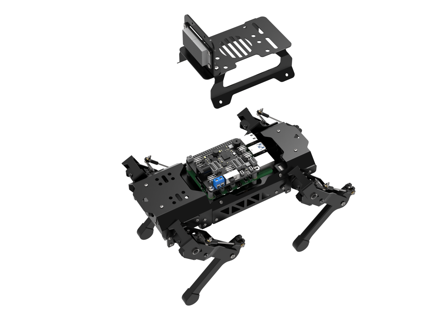

29.4 Dot-matrix Installation and Display
  • Assembly
29.4.1 Getting Ready
Prepare a dot matrix display and connect it to 5V GND IO7 IO8 interface on Raspberry Pi expansion board with 4PIN wire as the picture shown.
4PIN wire adopts anti-reverse plug in design. Please do not insert it to the interface violently.

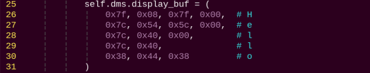

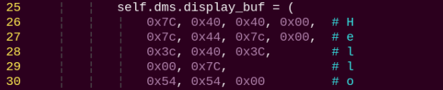

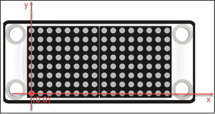

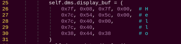

In this program, a set of hexadecimal data is used to control the dot matrix screen to display the content. A set of hexadecimal data consists of 16 data each of which controls a column of LED.
It is simple to set the data. For example, control the dot matrix display to display Hello.
The parameter in brackets of 32nd and 33rd line are the array for setting the displayed pattern. The converted binary number of its first element 0x7f is 01111111 which represents the light status, that is off on on on on on on on.
As the same, the rest 15 elements are also for controlling the LED lights to display “Hello”.
You can find “Instructions for Using the Font Software” in the same directory of this section, where you can quickly obtain control arrays using the font software.

The current displayed content is Hello. If you need to modify the content, like Love, please follow the below steps to operate.

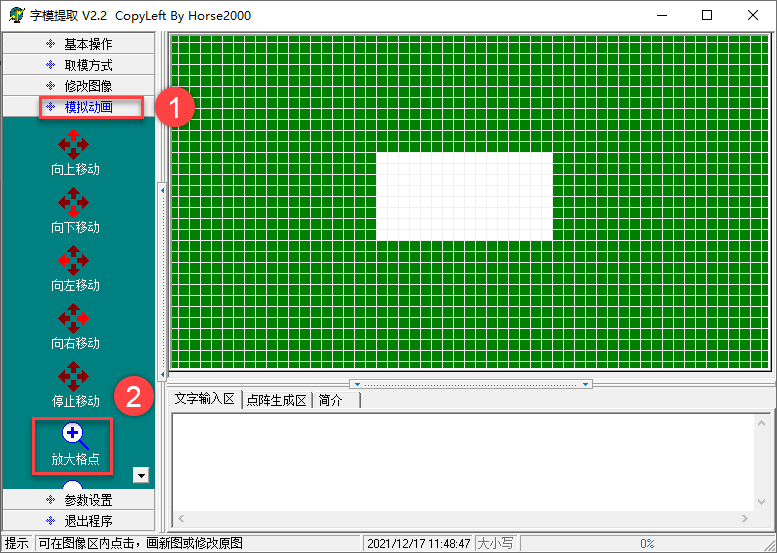

Before modification, we need to obtain the address of the character on the dot matrix display through the Internet.

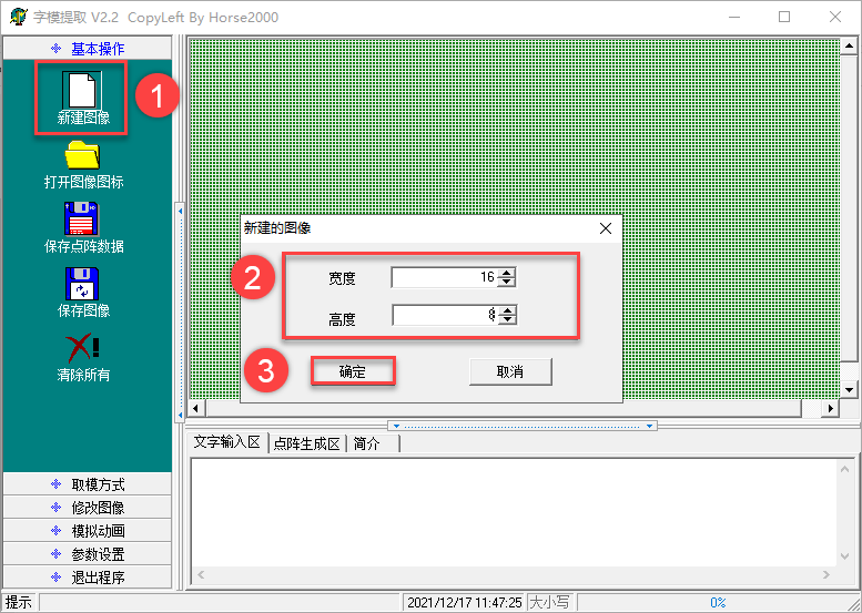

(1) Double-click to open the CharacterMatrix software in this directory.
(2) First, click on “New Image”, then in the pop-up settings box, set the size parameters for the dot matrix module. Here, set it to “16*8”. After setting, click “OK”.

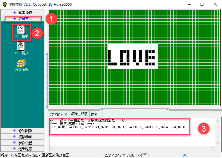

(3) Then click “Simulated Animation” and “Enlarge Grid” in order to enlarge the dot matrix simulation area on the right side.
(4) Then, use the mouse to click and draw the display content in the right area.
(5) After finishing the drawing, click “Modeling Method” and then “51 Format” in sequence to obtain the address symbol (please remember the address symbol for the subsequent steps).
(6) Open a new command-line terminal by clicking the icon . Then enter the following command to navigate to the directory containing the programs.
(7) Run the command below to access the program file.
vim lattice_display_demo.py
(8) Locate the code as indicated.

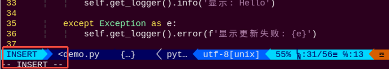

(9) Press i key on the keyboard to enter the editing mode.
(10) Replace the default address symbol in the program with the address symbol obtained from the font software, as shown in the following figure:
(11) After modification, press Esc and enter :wq and the press Enter to save the modified content
