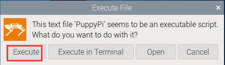

(1) Double click
(2) Click “Execute” in the pop-up window, and then we can open PC software.

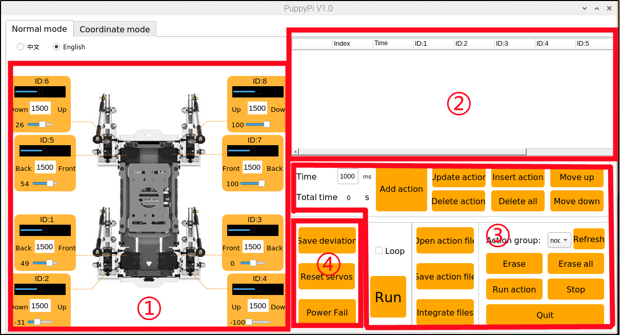

Under normal mode, the interface is divided into 4 zones, including servo control area, action list, action group setting area and deviation setting area.
(1) Servo Control Area
PuppyPi’s posture can be adjusted through modifying the corresponding servo value.
| Icon | Function |
Servo ID |
Used to adjust servo angle within 500~2500 |
Used to adjust servo deviation within -100~100 |
(2) Action List
The duration and servo parameter of the action are displayed in the action list.
| Icon | Function |
Action number |
The duration of the action |
Angle value of the corresponding servo. We can double click the value to modify |
Run the selected action |
(3) Action Group Setting Area
| Icon | Function |
The time taken to run the individual action. We can modify the value directly. |
The total time taken to run the whole action group |
Add the current servo value set in the servo control area to the bottom of action list to form a new action |
Replace the selected servo parameter in the action list with current value set in servo control area. And the Time will be substituted by the value set in ![]() |
Insert one action above the selected action in the action list. The value of inserted action is the same as that set in servo control area. And the Time is the same as ![]() |
Move the selected action to the previous line |
Delete the selected action in the action list |
Delete all the actions in the action list |
Move the selected action to the next line |

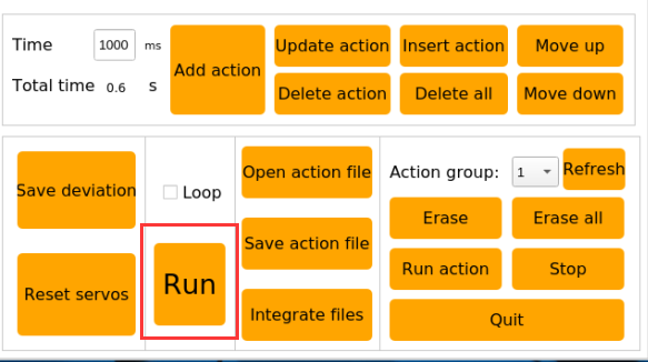

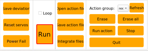

Run the actions in the action list once. If "Loop" is selected, the actions will be ran in loop. |
Open the action group file we want |
Save the actions in the action list to the designated path |
Firstly, click to open a action group, and then click this button to open other action group. After that, two action groups are integrated. |
Display the action groups saved in PC software |
Refresh the selected action group |
Delete the selected action group file |
(�? Delete all the action group files. |
Execute the selected action group once |
Stop running action group |
Exit the PC software |
the action group files are all saved to the path “/home/ubuntu/software/puppypi_control/ActionGroups”.
(4) Deviation Setting Area (The deviation of PuppyPi has already been adjusted before delivery)
| Icon | Function |
Save the adjusted deviation |
Restore the value of all servos in the servo control area to 1500. |
After clicking it, we can adjust the rotation angle of the servo manually. |

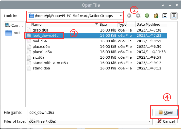

(3) Click “Open Action File” to open the action group file located in the same directory as this document.
(4) The action details list will display the opened action group.

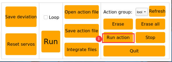

(5) Click “Run” to execute the action group.

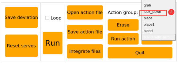

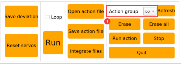

(6) Alternatively, click the dropdown button for the action group, select the desired action group to run, and then click “Run” to execute it.

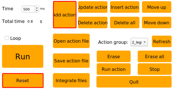

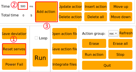

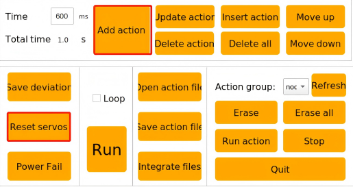

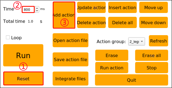

(2) Action 1: click

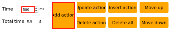

to make PuppyPi restore to initial posture. And modify the Time as 500ms. Then click
to add this action to the action list.
Then the specific parameters of action1 are updated to the action list.
please remember to click “Add Action” button after each setting.

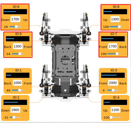

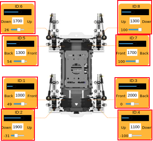

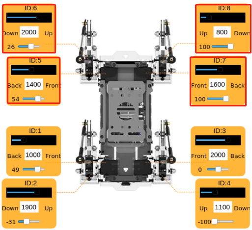

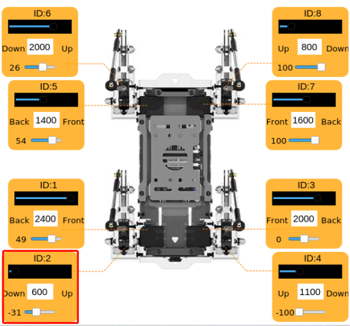

(4) Action 2: please set the servo parameter as the figure below shown to lift up front half its body. And click “Add Action” button to save this action to the action list.
(5) Action 3: follow the picture below to adjust the servo parameter to lift up front half its body more greatly. And click “Add Action” button to save this action to the action list.

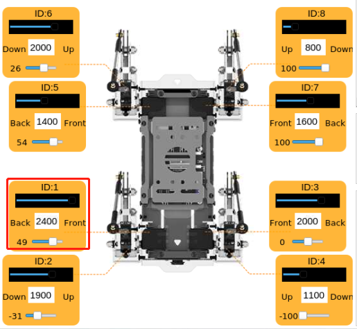

(7) Action 5: adjust the servo parameter of ID1 servo as below to make the upper joint of front right leg swing forward. And set the time as 400ms. Then click “Add Action” button.

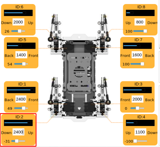

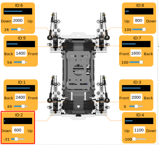

(8) Action 6: modify the value of ID2 servo as the picture shown to make the lower joint of front right leg to swing upward. Then click “Add Action” button.
(9) Action 7: modify value of ID2 servo to make the lower joint of front right leg to swing downward. Then click “Add Action” button.

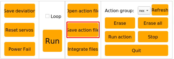

21.3.3 Save Actions

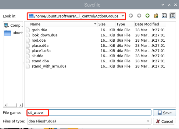

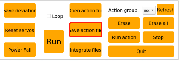

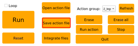

(1) For the convenience of later debugging and management, click “Save Action File” to save this action group.
(2) Save the action group to “/home/ubuntu/software/puppypi_control/ActionGroups” and we can name it “sit_wave”. Then click “Save”.

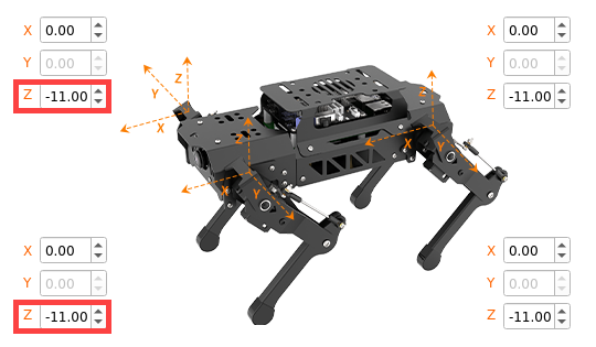

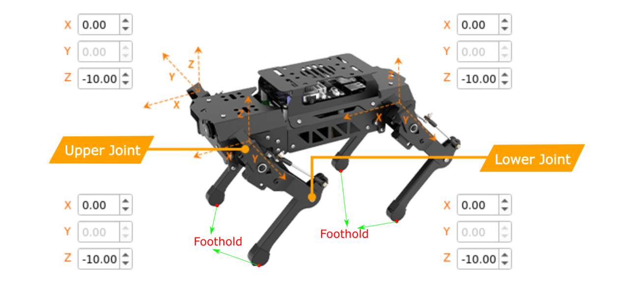

21.4.2 Coordinate Explanation
The joint distribution of PuppyPi is as the picture shown.
X-axis coordinate is used to adjust the rotation angle of upper joint, which ranges from -15 to 15. The larger the value, the greater the upper joint rotates forward. The smaller the value, the greater the upper joint rotates backward.
Z-axis coordinate is used to adjust the flexion and extension of lower joint. It ranges from -15 to -1, and its absolute value is the height of PuppyPi.
Take -10 as critical point. When Z-axis coordinate is greater than -10, the larger the value, the greater the lower joint flexes, which means that the angle between the upper leg and lower leg is smaller. When Z-axis coordinate is smaller than -10, the smaller the value, the greater the lower joint extends, which means that the angle between the upper leg and lower leg is bigger.

(2) Action 1: click “Reset Servo” button to make PuppyPi return to the initial posture. And modify the time as 800ms. Then, click “Add Action” button.
The specific parameters of this action are displayed on the action list. The coordinates of 4 legs are all (0�?�?10), which means that PuppyPi’s height is 10cm.

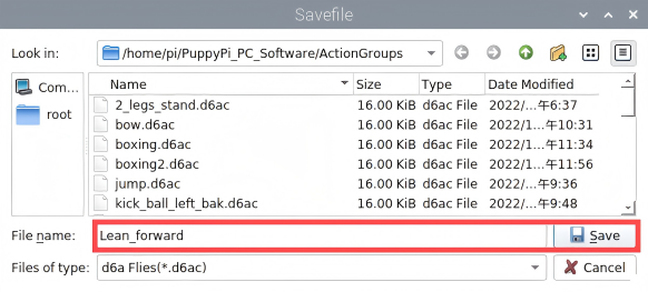

21.4.4 Save Action
(1) Click “Save Action File” to save this action group.
(2) Save the action group to “/home/pi/PuppyPi_PC_Software/ActionGroups” and we can name it “Lean_forward”. Then click “Save”.

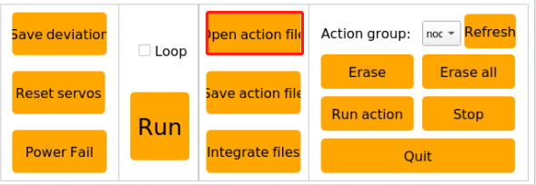

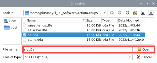

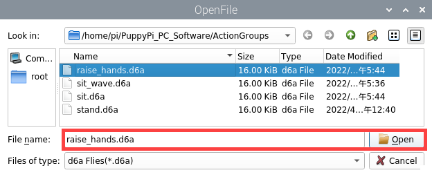

(2) Click “Open Action File” button, and then double click “raise_hands” action group to open it.
At this time, the parameters of “raise_hands” is updated to the action list

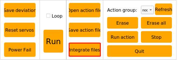

(3) Click “Integrate Action File”, and then open “sit.d6a” to completer integration.
At this time, parameters of “sit” is added behind the parameters of “raise_hands”.
(4) Click “Run” button. Then PuppyPi will execute this new action group.

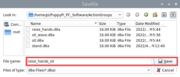

(5) Click “Save Action File” button, name this new action group “raise_hands_sit”, and the click “Save”.
