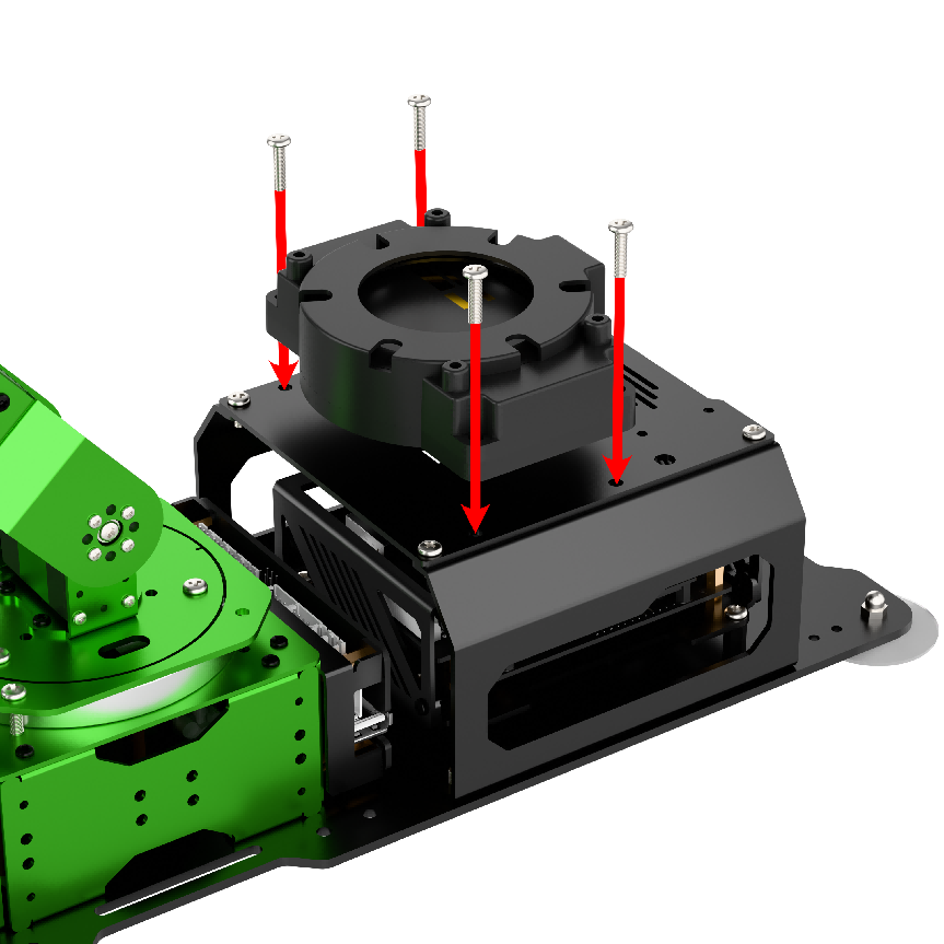

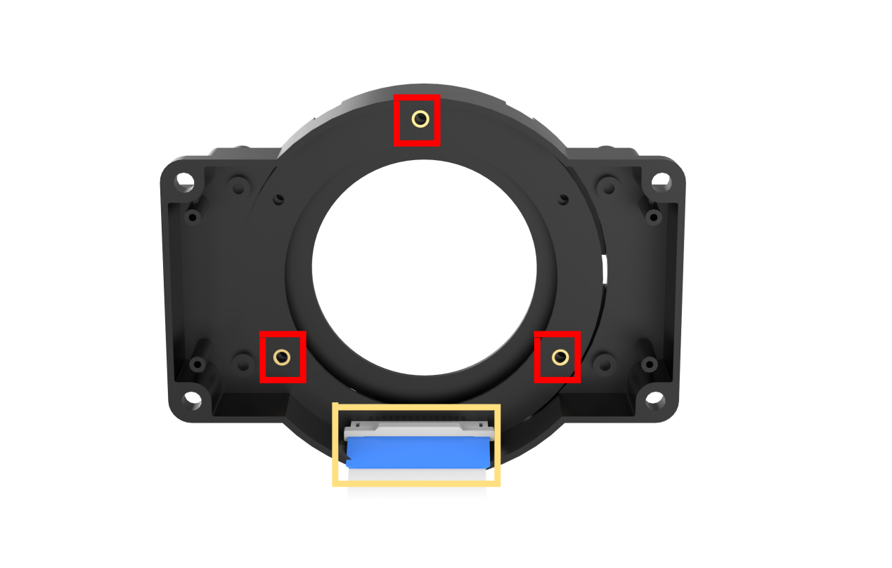

(1) Fix the 6-Microphone array to the JetArm using four M4*6 screws.
(2) The image below shows the assembled configuration of the 6-microphone array.

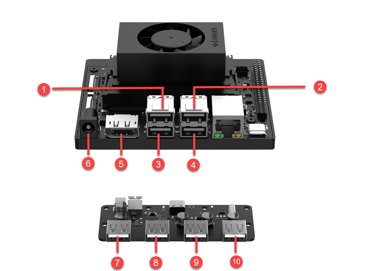

(3) Connect the 6-CH microphone array to USB Port 2 on the controller, as shown below.

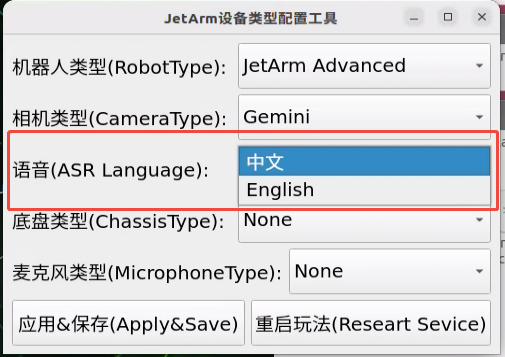

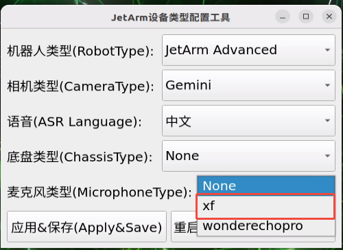

(1) The robot is equipped with a 6-microphone array.
To change the recognition language, open the configuration tool by double-clicking the “Tool” icon on the desktop .
In the tool interface, select your preferred language.
(2) If you are using the 6-microphone array, select “xf” as the microphone type (as shown in the image below).
(3) Click “Apply & Save” to confirm and save your settings.

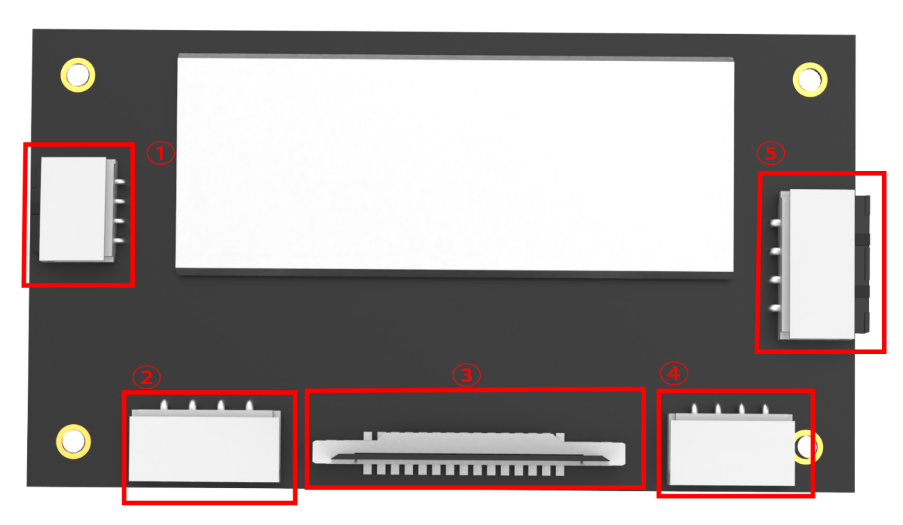

9.3 R818 Noise Reduction Board
9.3.1 R818 Noise Reduction Board Introduction
The R818 noise reduction board serves as a voice front-end solution featuring a multi-microphone array. Powered by a high-performance quad-core edge computing processor, this module internally incorporates iFLYTEK’s voice algorithm. Leveraging the spatial filtering characteristics of the microphone array, it uses angle positioning to awaken individuals. This creates a directional pickup beamforming, suppressing noise outside the beam and enhancing far-field audio pickup quality. Specifically designed for human-machine interaction terminals, it integrates a high-performance echo cancellation algorithm to alleviate the challenges of speech and semantic recognition. Developers can seamlessly integrate this module to empower products with functionalities like multi-microphone audio capture, wake-up, noise reduction, and echo cancellation.
9.3.2 R818 Noise Reduction Board Specification
The purpose of the interface on the R818 noise reduction board is outlined below:
Interface NO. Name Function
1 Serial port For PC software communication
2 Reference signal port Power amplifier/echo cancellation reference signal
3 Microphone port Connect to 6-channel microphone array
4 Independent power port Power input port
5 UAC port Audio output port

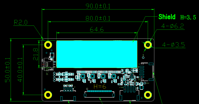

  • Structure & Size
Front view:
Back view:

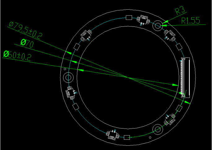

9.4 6-Channel Ring Microphone Array Introduction
9.4.1 Introduction to 6-Channel Microphone Array

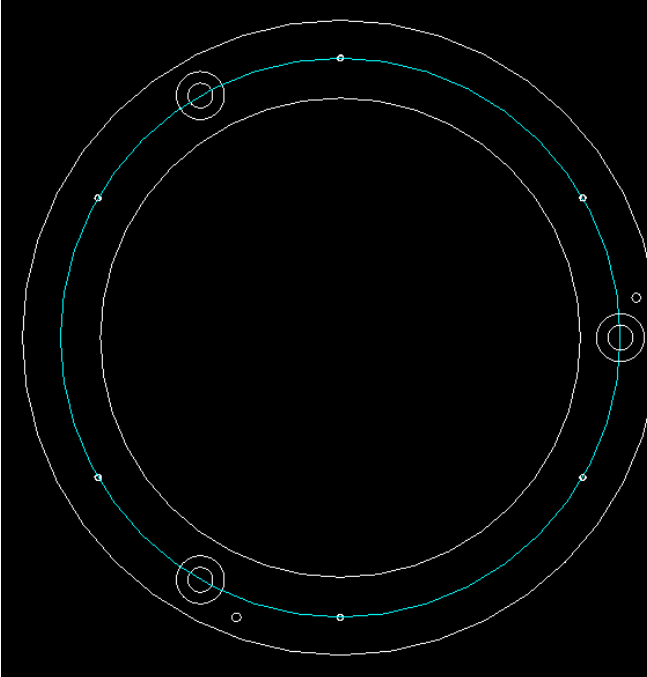

The 6-Channel Ring Microphone Array is a board designed for microphone pickup, known for its heightened sensitivity and excellent signal-to-noise ratio. It incorporates six analog silicon microphones arranged in a circular pattern. When integrated with the mainboard, it excels in delivering advanced features such as Acoustic Echo Cancellation (AEC), reduction of environmental noise, and factory-level sound pickup capabilities extending up to 10 meters.
9.4.2 Ring 6-Channel Microphone Array Specification

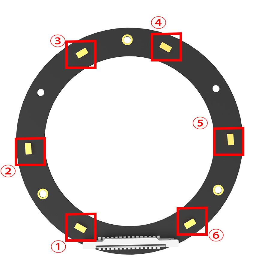

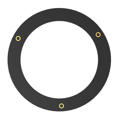

The structure of the ring 6-channel microphone array is as below:
Front: Back:

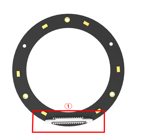

(1) Signal interface: connects to R818 noise reduction board.
(2) At the rear, six analog silicon microphones are strategically arranged in a circular pattern to optimize audio reception.
9.4.3 6-Channel Ring Microphone Array Parameter
  • Performance Parameter
Key parameter:
Microphone Sensitivity Signal-to-noise ratio PCB size External port
SPA1687LR5H-1 -3dBV/Pa 65dB 115mm×12mm×1.2mm Microphone signal port

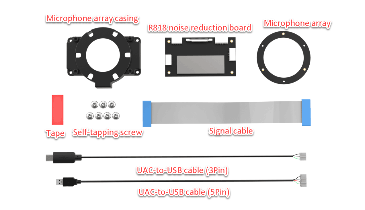

(1) Please gather the items depicted in the picture below:

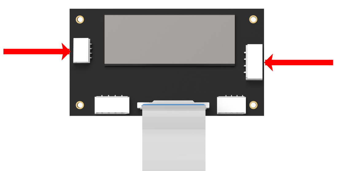

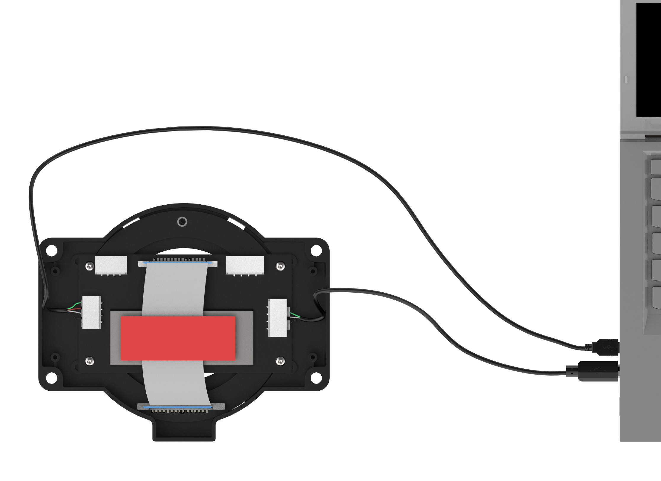

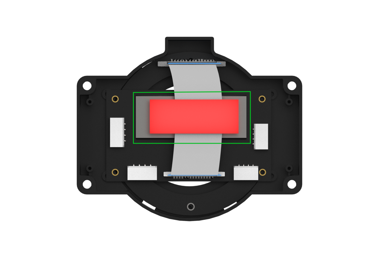

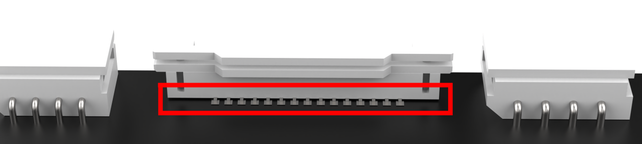

(2) Connect the microphone array to the noise reduction board. Be cautious while inserting the connection cable to avoid any forceful insertion that may lead to damage to the port.
(3) Connect the two UAC-to-USB cables to the noise deduction board as below:
(4) Connect the serial port connection cable and UAC cable to the corresponding port on the noise reduction board. First, attach the ring microphone array to the casing. Use the screws to secure it in the three holes highlighted by the red boxes in the image below. Additionally, be sure to align the signal cable connector properly, as shown in the yellow box in the image below.
(5) Next, connect the noise reduction board, which has already been wired, to the corresponding slots in the casing. Pay attention to the orientation of the noise reduction board, as shown in the image below. Use 3M adhesive to secure the signal cable in place, as indicated by the green box in the image.
Tighten the four screws:
(6) Connect the two USB cables to the laptop and run a test to check if the computer recognizes the port numbers. This completes the wiring and installation of the microphone array.

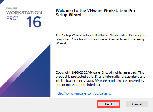

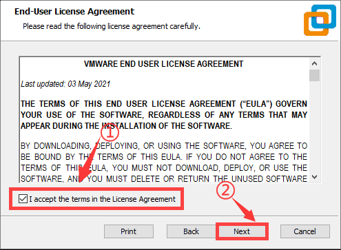

9.6.1 Install VMware Workstation Software
A virtual machine is essentially a computer generated through software emulation, offering a usage experience similar to that of a physical computer. Popular virtual machine software options include VMware Workstation (often called VMware), VirtualBox, Microsoft Virtual PC, and more. In this section, we’ll use the example of installing VMware Workstation, initiating, and configuring a virtual machine for explanation.
(1) Extract the virtual machine software package saved in Virtual Machine Installation Pack
(2) Find the folder where the virtual machine was extracted, and double-click on the virtual machine executable file.

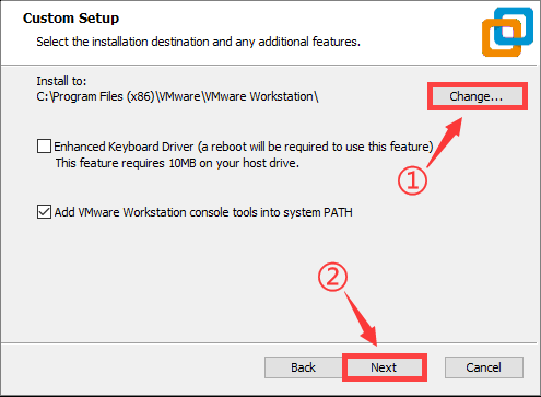

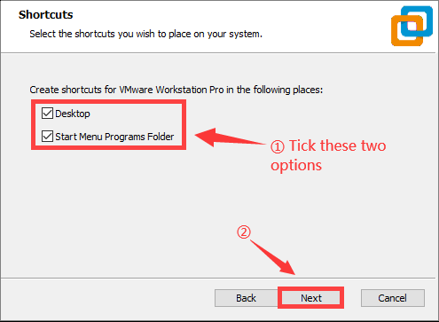

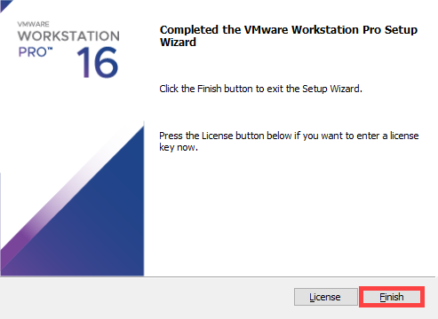

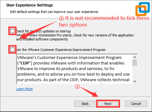

(3) Follow the images below to complete the virtual machine installation.

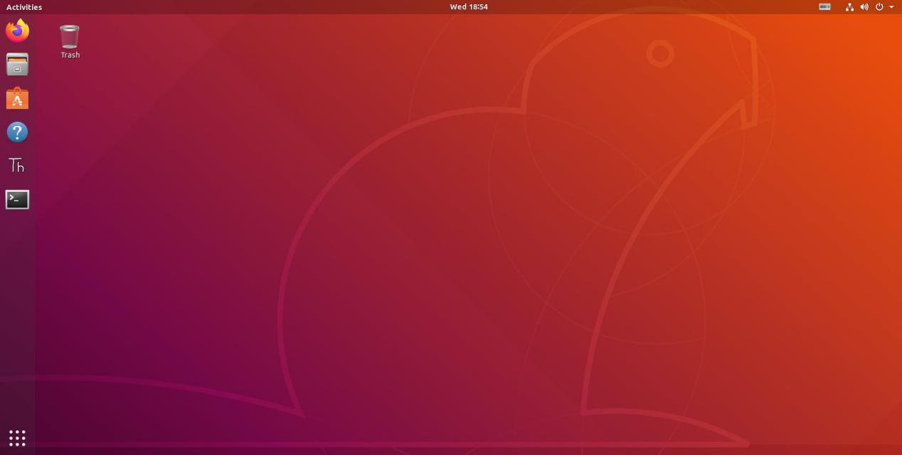

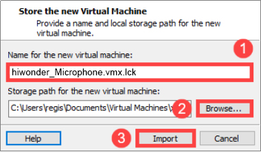

9.6.2 Import Virtual Machine

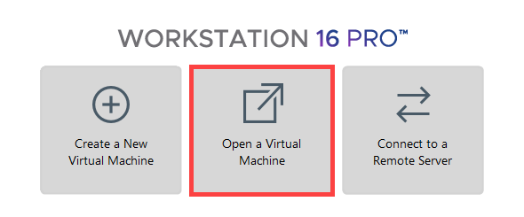

(1) After entering the virtual machine interface, click on “Open Virtual Machine”.
(2) In the popup window, locate the image file under the directory 2 Tools/6 Voice Recognition Environment Set Up Tool/6-Channel Microphone Array Image. Open the image file (the actual name of the image may vary; this image is for reference only).
(3) After opening, you can change the virtual machine’s name and local storage path.
It takes time to import the image. Please be patient.
(4) After importing, power on this virtual machine.
(5) The virtual machine interface is as pictured.

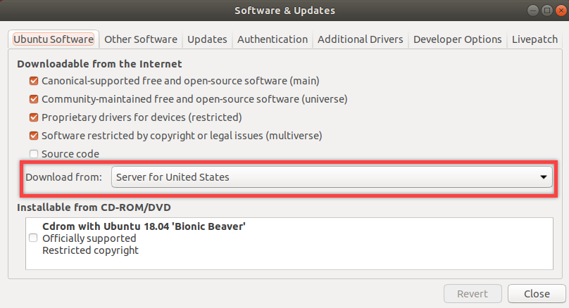

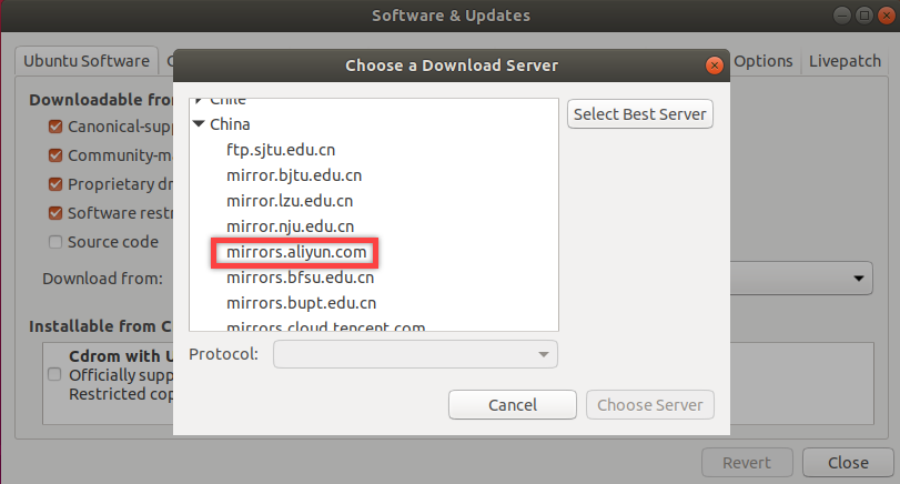

9.6.3 Change Source
This step matters, and please do not skip. Otherwise, installation package downloading will go wrong due to the internet.
Source functions as APP Store on iOS and Android, where users can download and update.
Ubuntu’s default software download server is officially designated. If the files is downloaded slowly or error occurs during downloading, you can switch the software server to other source for downloading.
Take changing into aliyun for example. And you can select the appropriate source based on your country or region.

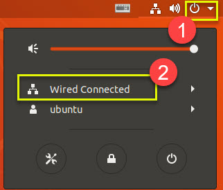

(1) Click the buttons as pictured to check the network status.

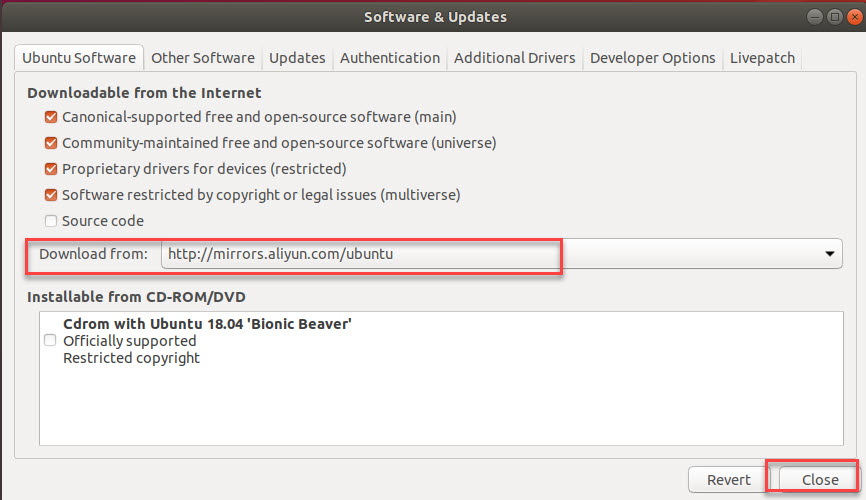

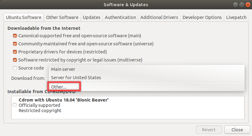

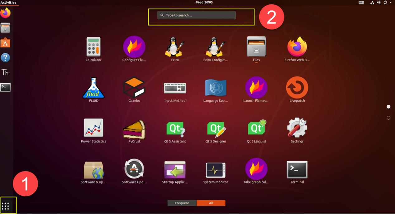

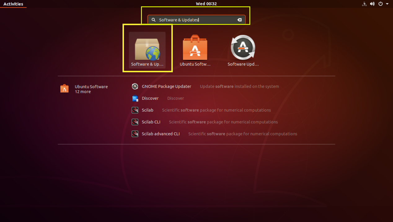

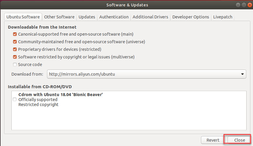

(2) Then search Software & Updates, double click the icon to open.

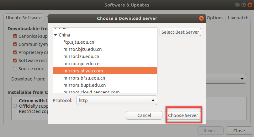

(3) Click Download from->Other
(4) Scroll the list to find aliyun server. (China->mirrors.aliyun.com)

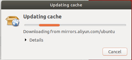

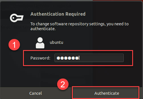

(5) If you are not sure which server is suitable, you can click Select Best Server. After selection, you are required to input the set password. The initial password is ubuntu, then click on Authenticate
(6) Finishing authentication, you can click close

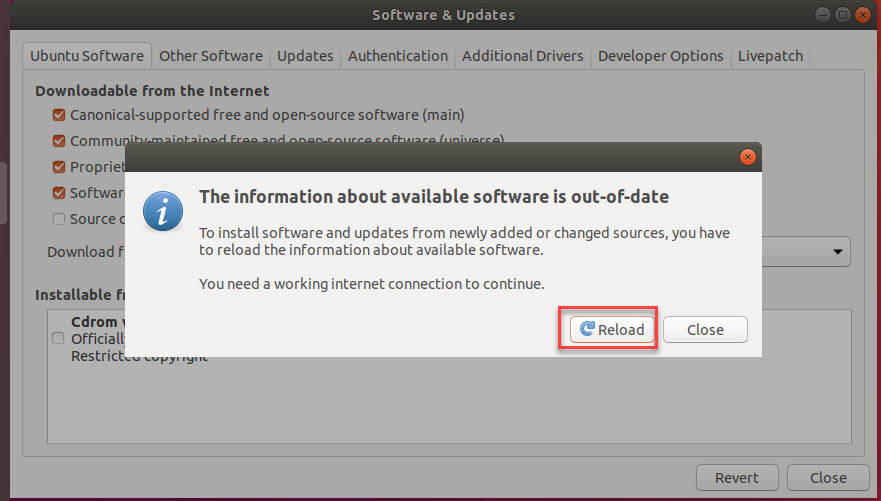

(7) If the following dialog box pops up, just click Reload to update. Then close the page after update.

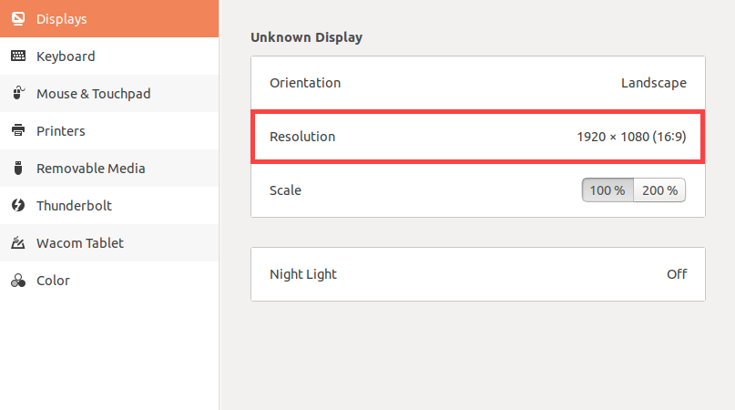

9.6.4 Change Resolution
If you need to change the resolution, follow the instructions to operate.

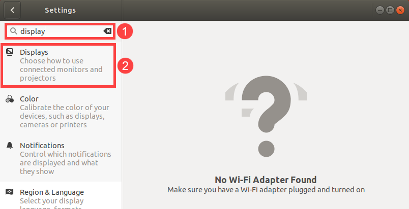

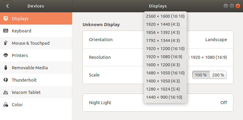

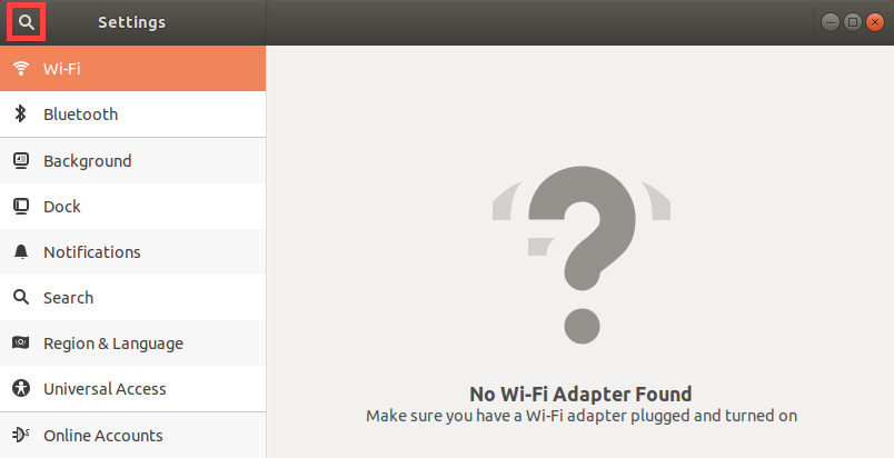

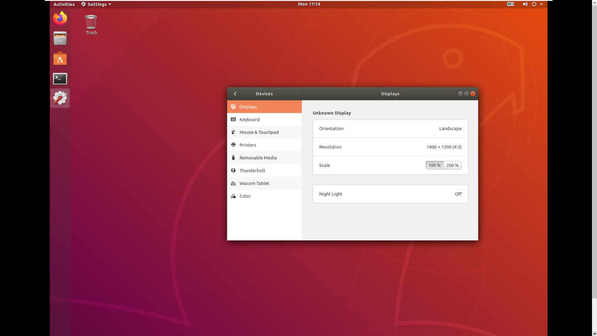

(1) Open Settings, and click search button at the bottom left corner, then input display
(2) Select the resolution you want, then follow the pop-up instructions to complete modification.
(3) The final display effect is as follow.

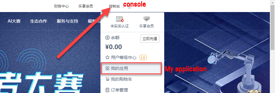

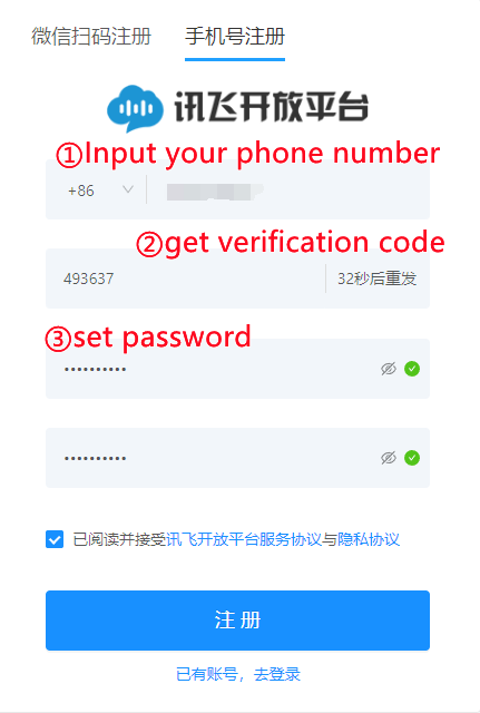

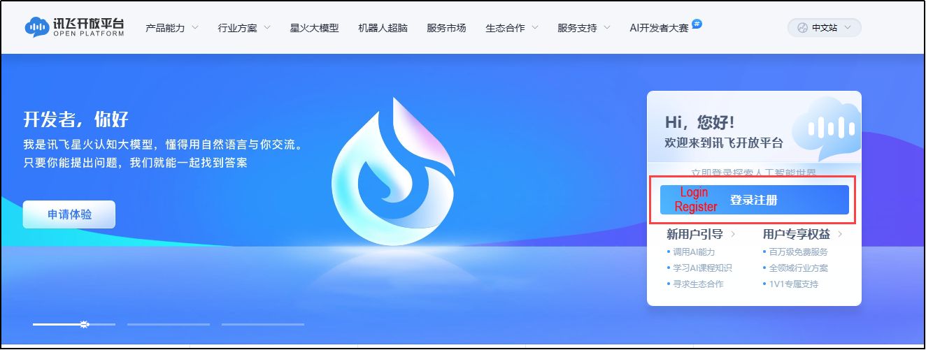

(1) Enter iFLYTEC website, https://www.xfyun.cn/, then click sign in to create an account.
(2) Choose Sign up with phone number, and fill in the required information. (select corresponding country code)

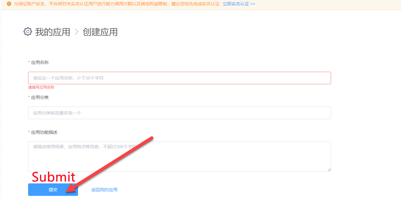

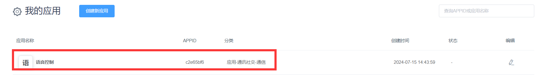

(3) After registration, click console->my application to add new application.
(4) Fill in the required information, and click Submit
(5) Open the application you just added.

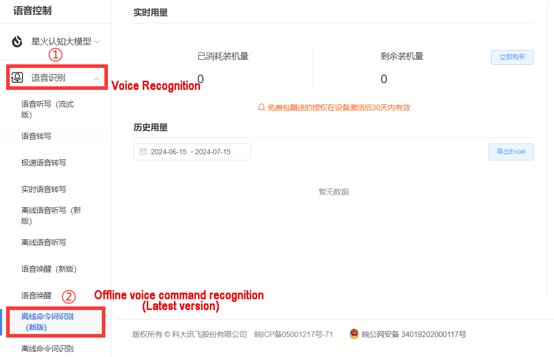

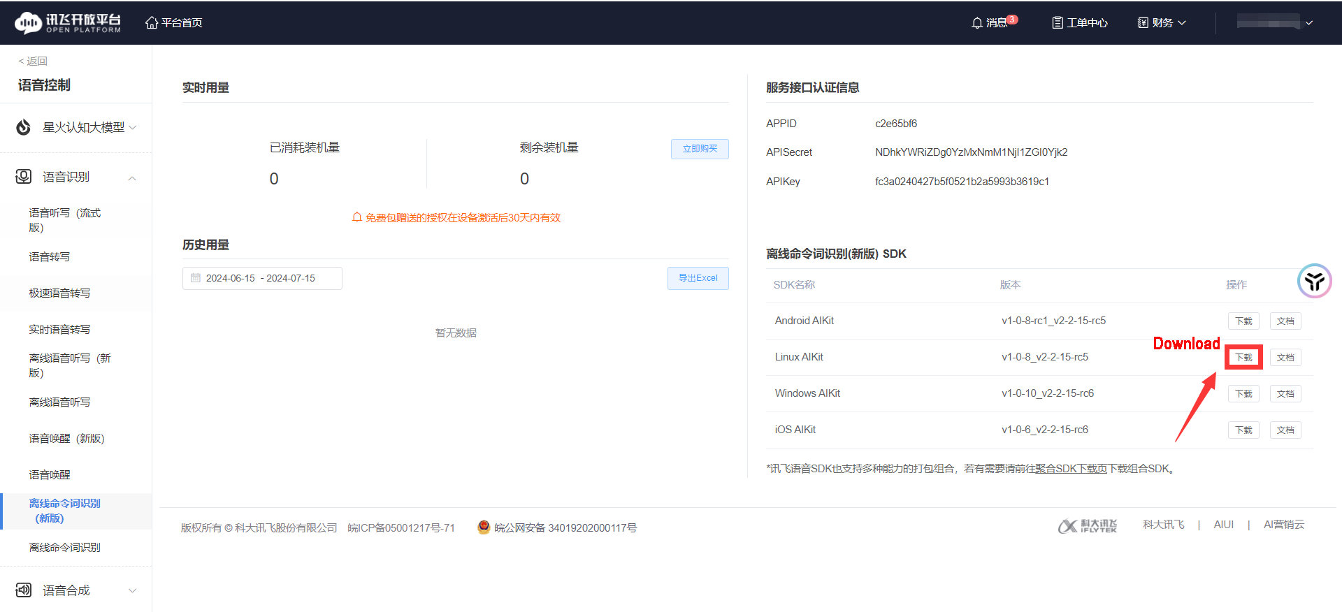

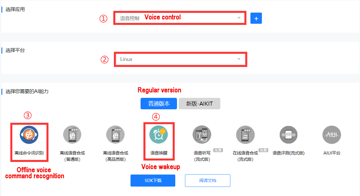

(6) Click Voice recognition->Offline voice command recognition (Latest version)
(7) Download Linux AIKit.
Each new application offers 90-day free trial, and you will be charged if you continue to use it. When free trial expires, you can add new application again, and each person can only request 5 new applications.
(8) Select the username you created and the Linux platform. After making your choices, select the Regular Version below, check Offline Command Word Recognition and Voice Wakeup options, then click SDK Download.
(9) Choose OK to start downloading.

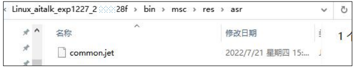

9.7.2 Replace Offline Voice Resources and ID

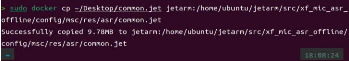

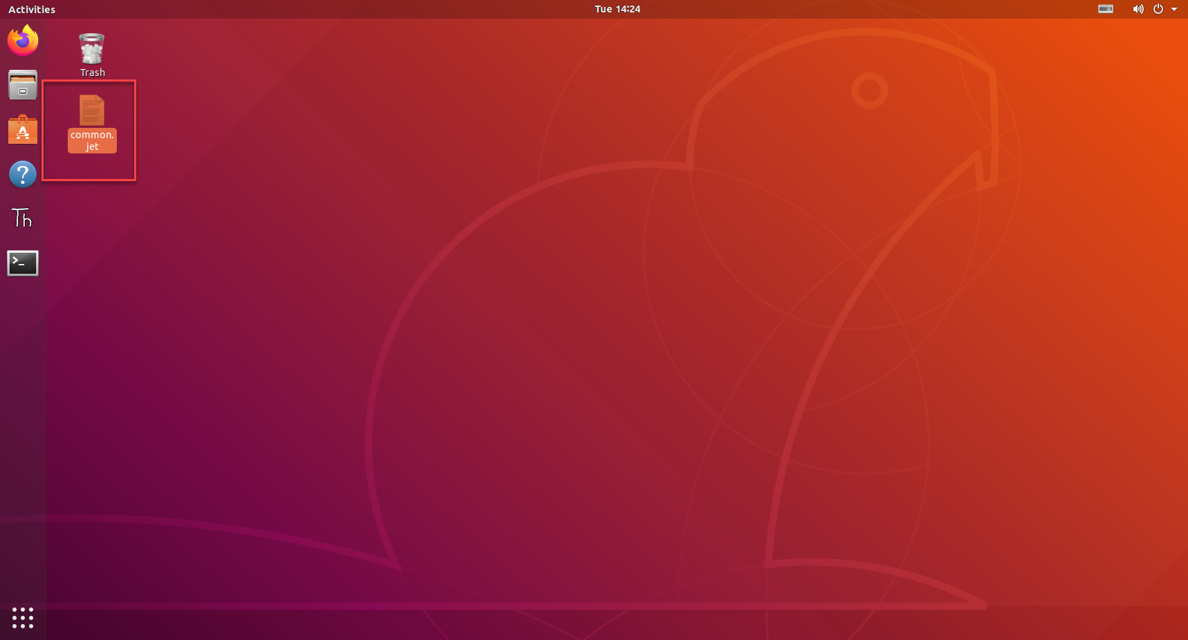

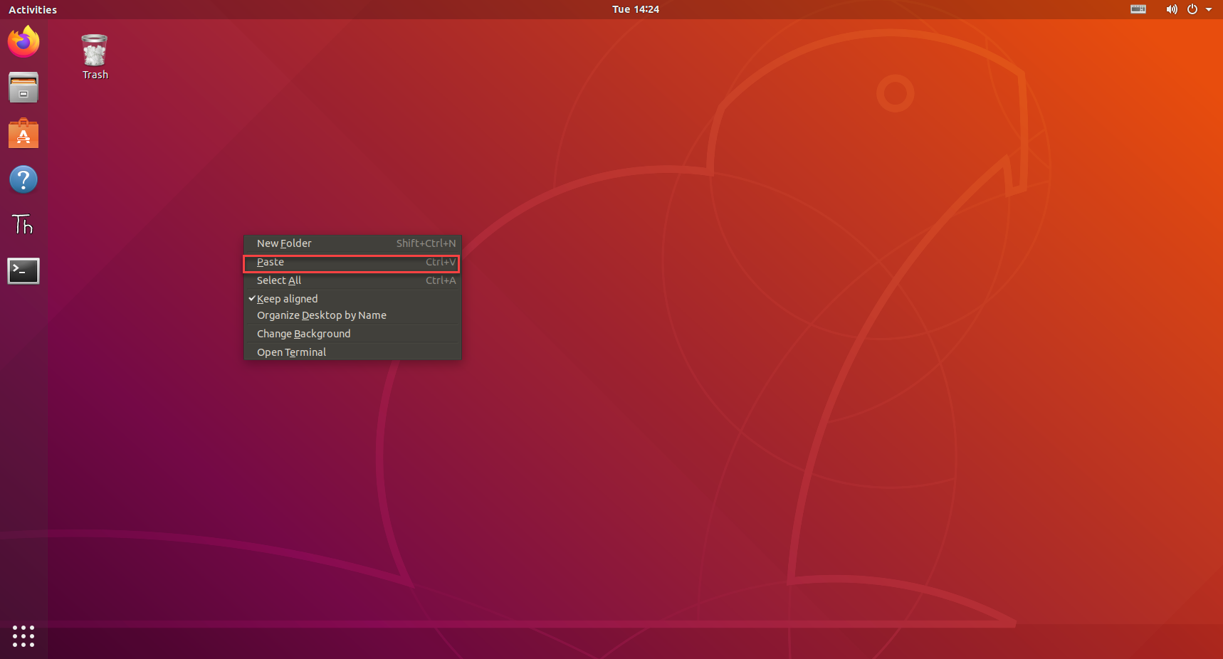

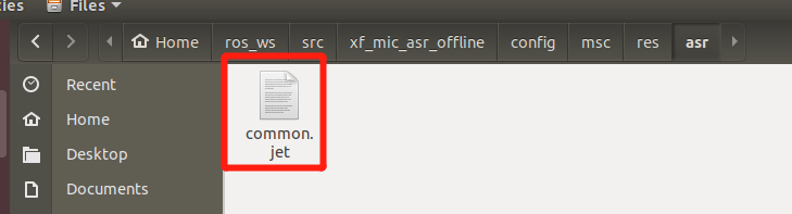

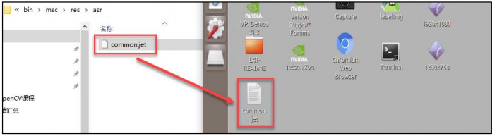

(1) Copy the file, then open the virtual machine, right-click on the desktop’s blank area, and select “Paste”.

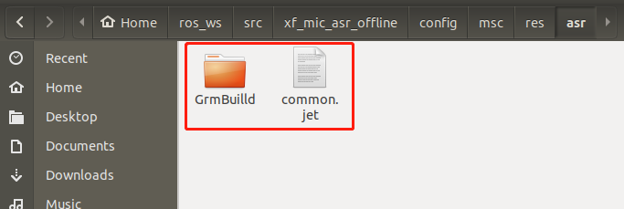

(2) Open the Ubuntu system within the virtual machine, and navigate to the path: ros_ws/src/xf_mic_asr_offline/config/msc/res/asr/ to enter the folder containing offline voice resources. Delete the files highlighted in the red box.
(3) Place the copied files into this folder.

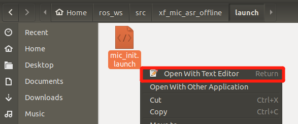

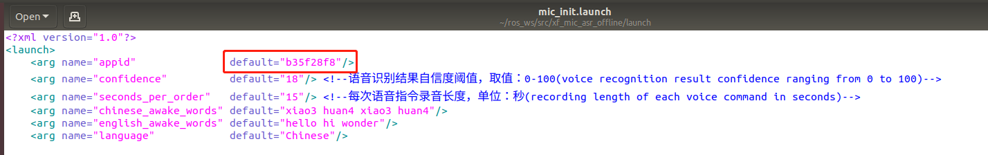

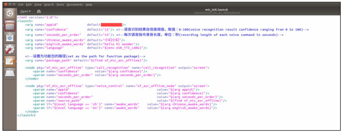

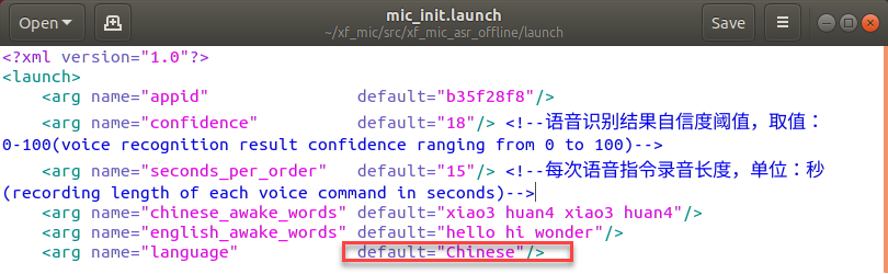

(4) Navigate to the path ros_ws/src/xf_mic_asr_offline/launch, right-click on the mic_init.launch file, and select the highlighted content.
(5) Set the appid in the red box to the appid obtained from iFlytek. After editing, press Ctrl+C to save (Note: The offline voice resources must correspond to the appid).
If overseas users still cannot complete the voice control after following the steps above, please contact our technical support team for guidance.
9.7.3 Change User Parameters

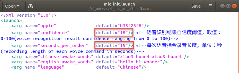

After modifying the APPID, if you wish to make changes to the speech recognition threshold, recording duration, wake-up word, or wake-up speech, you can refer to the methods described below.
(1) Locate the folder ros_ws/src/xf_mic_asr_offline/launch, and right-click mic_init.launch, then select Open With Text Editor
(2) Set confidence thresholds for speech results and the duration of each voice command entry based on the two parameters highlighted in the red box in the following diagram.
(3) Modify the parameter highlighted in the red box below to change the wake-up word.
English wakeup word format: word1 word2 word3
(4) To change the wakeup language, you can directly change the below parameter.
(5) After modification, press Ctrl+S to save the editing.

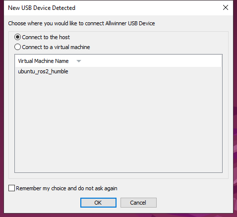

(4) Connect the device to the virtual machine.

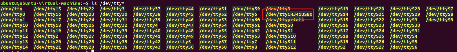

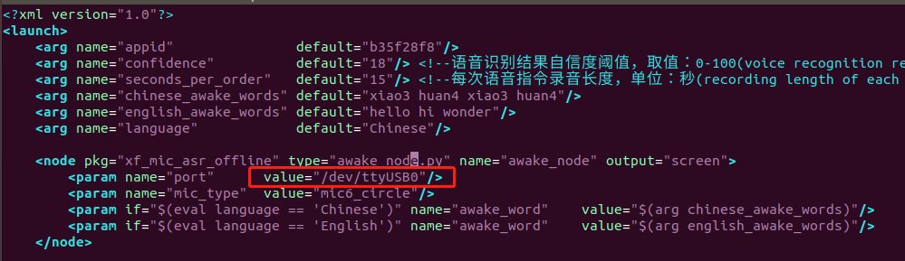

(5) After connecting, press the shortcut key Ctrl+Alt+T to open the terminal and enter the command to check the microphone’s serial port number, as shown in the red box below:
ls /dev/tty*
(6) Enter the following command to navigate to the file directory and open the launch file:
cd ros_ws/src/xf_mic_asr_offline/launch/
vim mic_init.launch
(7) Change the serial port number in the red box to the one obtained in step 5 (/dev/ttyUSB0), then save and exit.

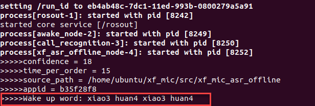

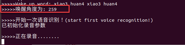

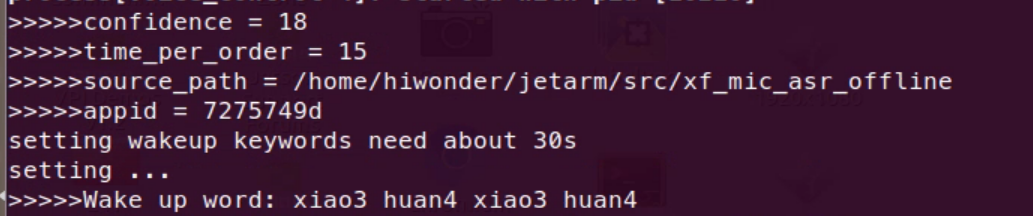

(2) Once initialized, the following content will appear in the terminal. The first startup may take a bit longer, but once completed, the system will be ready.
(3) To wake up the system, simply say “Hello Hiwonder” into the microphone. After activation, the wake-up angle will be displayed in the terminal, as shown below:

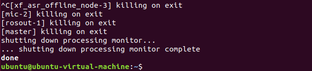

(4) To shut down the node, press Ctrl+C in the terminal window.
(5) To reopen the microphone node, enter the following command:
roslaunch xf_mic_asr_offline mic_init.launch

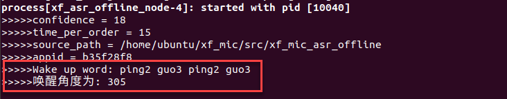

(6) The initial wake-up command is set to Hello Hiwonder Just say this command into the six-microphone array to begin.
Once activated, the wake-up angle will appear in the terminal as “259”, indicating the direction of the sound source relative to the microphone array. (For more on voice interaction, refer to **2. Voice Control Application**)

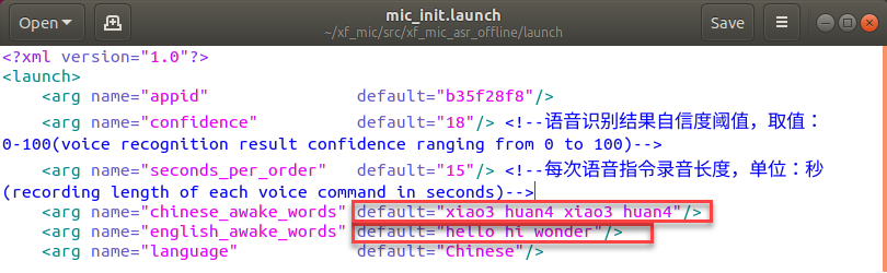

9.9.2 Change Wake-up Voice Command

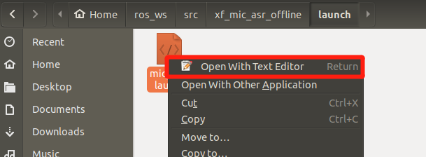

(1) Navigate to the following path, right-click the mic_init.launch file, and select the option shown in the red box:

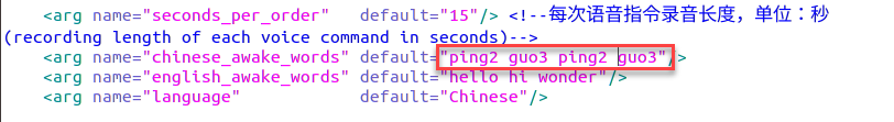

(2) Find the content highlighted in the red box in the image below.
The syntax for English wake-up words: “word1 word2 word3 …”.
(3) For example, to modify the Chinese wake-up words, change “xiao3 huan4 xiao3 huan4” to “ping2 guo3 ping2 guo3”.
(4) After making the changes, press Ctrl+S to save.

If ping2 guo3 ping2 guo3 is successfully recognized but there is no response from the six-microphone array, please restart the “six-microphone array ROS node” (no need to unplug and replug the microphone).

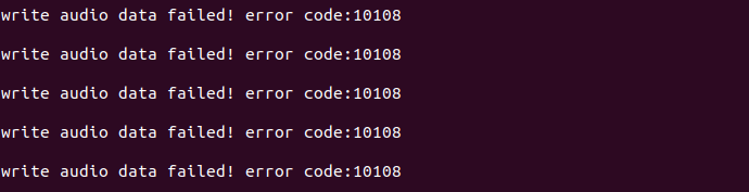

  • 10108 Error Code
Initiating the initialization service for the 6-channel microphone array multiple times may lead to the problem shown in the following image. However, this issue does not impact functionality. To restore normal operation, just repeat the wake-up words Hello Hiwonder

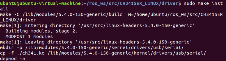

  • Solution for Unable to Find the Microphone Device
If you encounter the “Microphone device not found” error, please follow the steps below to install the microphone driver.
(1) Enter the following command and press Enter to navigate to the directory containing the driver:
cd ros_ws/src/CH341SER_LINUX/driver/
(2) Then, enter the following command to compile the driver:

(3) Enter the command to load the driver:
sudo make load
(4) Install the driver to the system with the following command:
sudo make install
(5) Once the driver is installed, restart the microphone node by entering the command:

As the robot utilizes offline voice recognition, you will require offline voice resources available exclusively on the iFLYTEC Chinese website. Please note that you need to switch the language to Chinese and follow the provided instructions for the process.

(1) Extract the compressed file in the downloaded materials.
You need to locate the relevant file according to the download path.
(2) Locate the extracted folder named “Linux_aitalk_exp1227_21***8f”(where “218f” is the version ID and may vary depending on the official website.) Navigate to the \bin\msc\res\asr folder and find the file named common.jet. Drag this file to the desktop of the virtual machine.
(3) Click to open the command-line terminal, and delete the old files insider the Docker container by entering the command:
rm -rf ~/jetarm/src/xf_mic_asr_offline/config/msc/res/asr/common.jet
(4) Click to open the command-line terminal, and replace the file inside the Docker container by entering the command:
sudo docker cp ~/Desktop/common.jet jetarm:/home/ubuntu/jetarm/src/xf_mic_asr_offline/config/msc/res/asr/common.jet
(5) Back to terminal, and enter the following command to edit the initialization content:
gedit ~/jetarm/src/xf_mic_asr_offline/launch/mic_init.launch
(6) Assign the appid within the red box below with the appid obtained from iFLYTEC website. Finally, press Ctrl+S to save the file.

roslaunch xf_mic_asr_offline mic_init.launch enable_setting:=true
The terminal will display pertinent prompts. During the initial activation, a 30-second wait is required. Once the terminal prints the designated wake-up word, for instance, Wake up word: xiao3 huan4 xiao3 huan, you can proceed to speak the wake-up word to activate the microphone.
Press Ctrl+C to exit after activating the wake-up word.

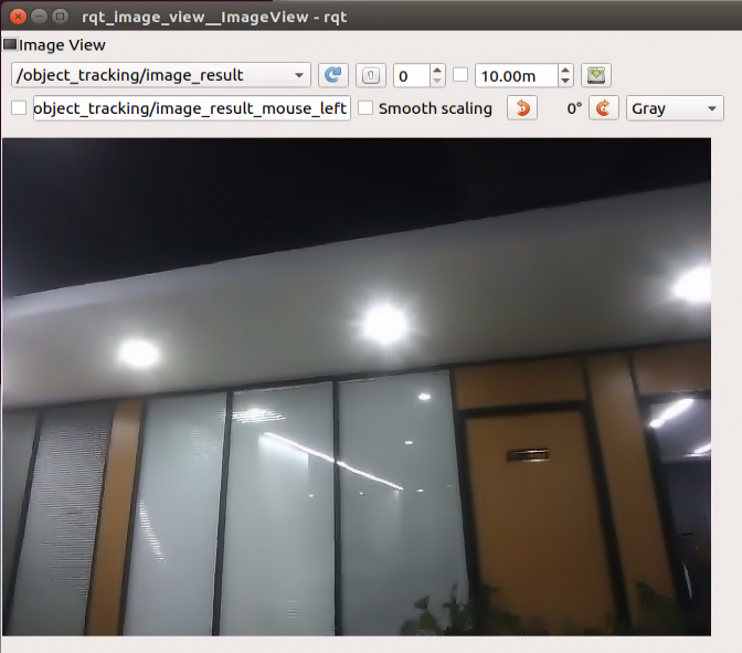

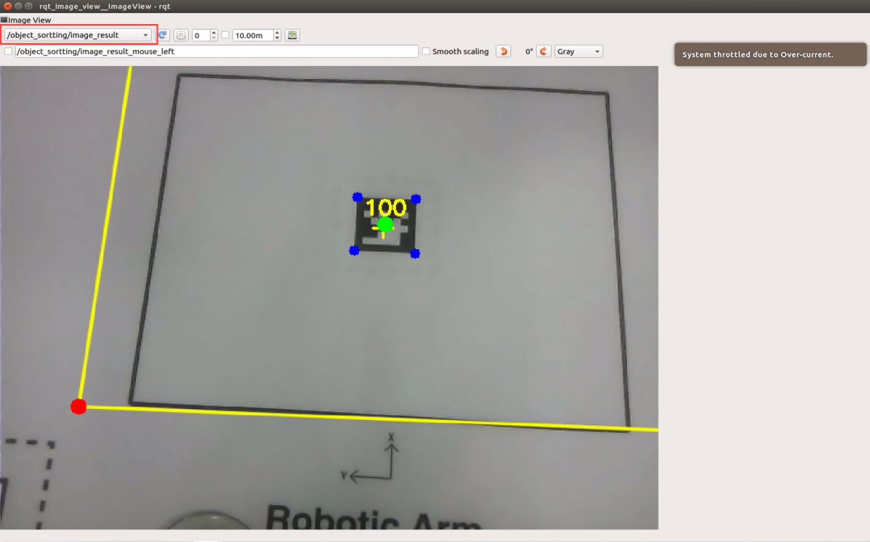

(6) If you need to access the live camera feed, open a new terminal, and execute the following command to open the visualization tool.
rqt_image_view
(7) Simply select the channel /object_sortting/image_result for color recognition and sorting.
(8) If you need to terminate the running program, use short-cut Ctrl+C

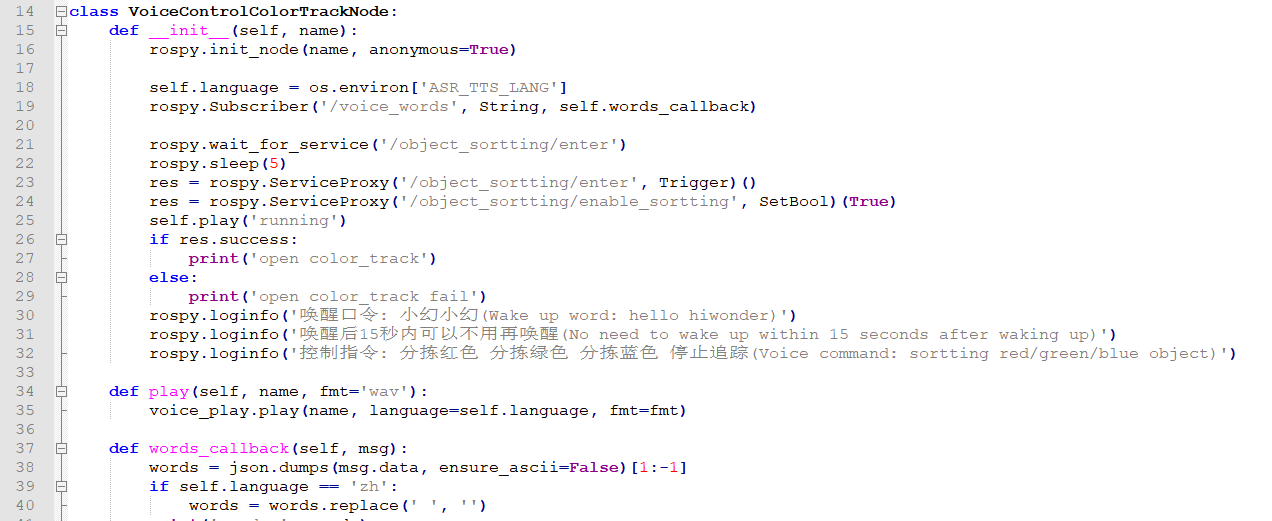

9.12 Voice Controlled Color Tracking

(6) If you need to access the live camera feed, you need to open a new terminal, and execute the below command to open the visualization tool.
rqt_image_view
(7) Choose the color recognition and sorting topic /object_tracking/image_result

  • Initiate Voice Controlled Color Tracking
Initiate the VoiceControlColorTrackNode class, and name the sorting node as voice_control_color_track
class VoiceControlColorTrackNode(Node):
    def __init__(self, name):
        rclpy.init()
  • Initialization Function
        self.create_subscription(String, '/asr_node/voice_words', self.words_callback, 1, callback_group=timer_cb_group)
        self.client = self.create_client(Trigger, '/asr_node/init_finish')
        self.client = self.create_client(Trigger, '/object_tracking/init_finish')
        self.start_client = self.create_client(SetBool, '/object_tracking/enable_color_tracking')
        self.set_color_client = self.create_client(SetFloat64, '/object_tracking/set_target_color', callback_group=timer_cb_group)
        self.set_color_client.wait_for_service()
rclpy.init(): Initializes the ROS node and related variables.
self.language: Sets the language for the game.
create_subscription: Subscribes to the information from the voice recognition node /asr_node/voice_words and calls the callback function words_callback() to obtain the recognized voice information.
wait_for_service: Indicates waiting for the service to be operational.
create_client: Represents the published service and its type.
  • play() Voice Response Function
Define the name, language and format of the voice file using play() function.
    def play(self, name):
  • words_callback() Callback Function
Match the voice command issued, determine the command with the highest match, and instruct the robot to track the corresponding color block.
61
    def words_callback(self, msg):
        words = json.dumps(msg.data, ensure_ascii=False)[1:-1]
        if self.language == 'Chinese':
            words = words.replace(' ', '')
        if words is not None and words not in ['唤醒成功(wake-up-success)', '休眠(Sleep)', '失败5次(Fail-5-times)',
                                               '失败10次(Fail-10-times']:
① Utilize the json.dumps() function to convert a Python data structure into a JSON string, streamlining network transmission.
② Voice command evaluation. Verify that the voice command is not empty and does not match commands such as “wake-up-success,” “Sleep,” “Fail-5-times,” “Fail-10-times,” etc.
70
71
72
73
            if words == '追踪红色' or words == 'track red object':
                req = SetFloat64.Request()
                req.data = 1.0
                res = self.send_request(self.set_color_client, req)
                if res.success:
                    self.play('start_track_red')
                    self.play('track_fail')
③ Take tracking red as example.
Firstly, check if the voice command is 追踪红色 or track red object. If it is, invoke the send_request() function to set the target color for color tracking to 1.0 (red) [2.0 and 3.0 correspond to green and blue, respectively].
Use the play() function to play the voice response for tracking red color.
