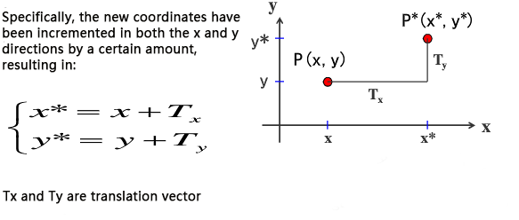

  • Translation Transformation
Translation involves moving point P along a straight path from one coordinate position to another.
The formula for homogeneous coordinates is as follows:
Translation is a rigid transformation that displaces an object without inducing deformation, ensuring that every point on the object moves by an equal amount of coordinates.

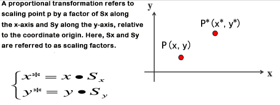

  • Ratio Transformation
The scaling factors Sx and Sy can take on any positive integer values. If the values are less than 1, the object’s size will decrease. If the values exceed 1, the object will enlarge. Setting both values to 1 will maintain the object’s original size.
(1) Sx = Sy ratio:
(2) Sx <> Sy ratio:
When Sx = Sy, the scaling transformation becomes a uniform scaling transformation, calculated using the following matrix:

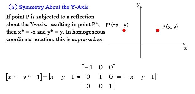

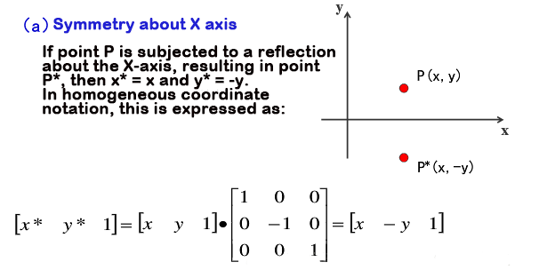

  • Symmetrical Transformation
Symmetric transformation, alternatively referred to as reflection or mirror transformation, produces an image that mirrors the original shape across a specific axis or the origin.

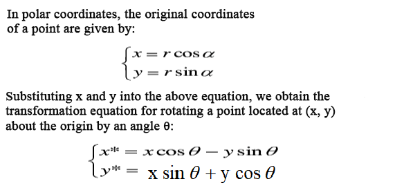

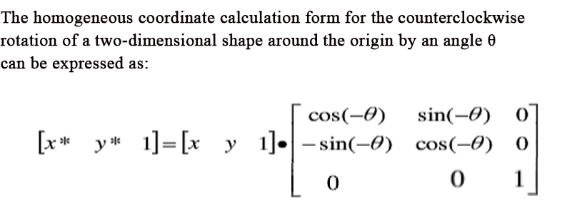

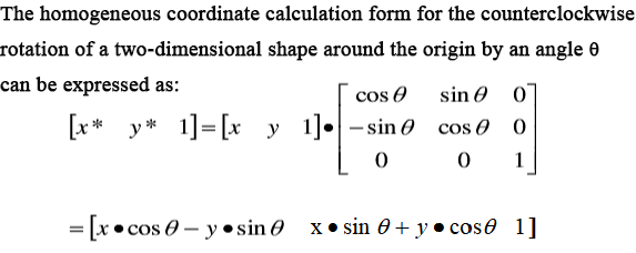

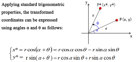

  • Rotation Transformation
Two-dimensional rotation refers to the process of repositioning point P by rotating it around the coordinate origin at a certain angle θ (counterclockwise as positive, clockwise as negative) to obtain a new point P*. The transformation equation for the rotation of point P is initially determined with the origin as the reference point.

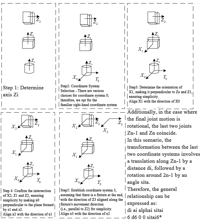

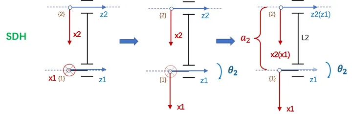

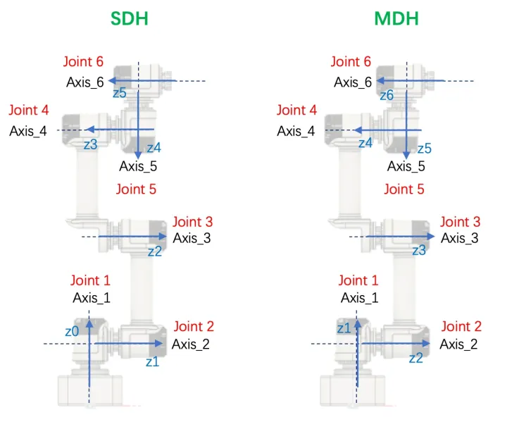

① Set the initial position and designate labels for the links and joints. Generally, the initial position of a robotic arm is assumed to be fully extended upward, with the lateral joints oriented along the x-axis. The diagram on the right in the following image provides a visual representation of the link structure.
② Verify the axis lines of each joint and the z-axis. The axis lines represent the axes along which each joint rotates or moves. The z-axis corresponds to the current axis line, with an arbitrary direction (in this case, opposite to the motor rotation direction is chosen). The notation for the subscripts may differ between the two methods, so it’s important to pay attention to the sign of the subscripts. The subscript on the z-axis indicates which coordinate system it belongs to.

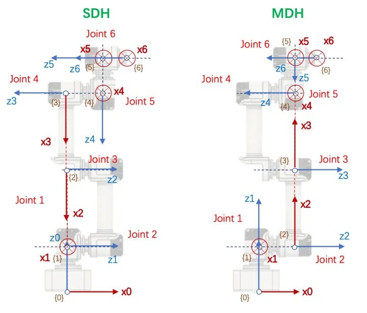

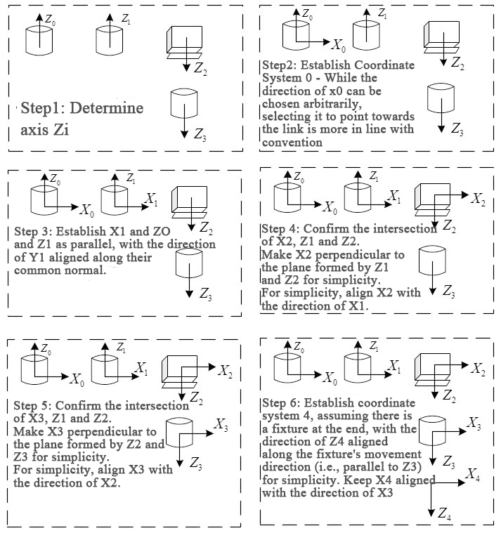

(3) Set Coordinate System for Each Joint
Begin by locating the origin of the {i} coordinate system and determining the x_i axis. In SDH, if the axis lines of {i} and {i-1} intersect, the intersection point becomes the origin. The x_i axis lies on the perpendicular bisector of the plane formed by the two axis lines, with an arbitrary direction. If the axis lines do not intersect, the origin is set at the point of intersection between the common perpendicular and the current joint axis {i}. The x_i axis then lies along this common perpendicular, with an arbitrary direction. In MDH, if the axis lines of {i} and {i+1} intersect, the intersection point becomes the origin, and the x_i axis lies on the perpendicular bisector of the plane formed by the two axis lines, with an arbitrary direction. If the axis lines do not intersect, the origin is set at the point of intersection between the common perpendicular and the current joint axis {i}. The x_i axis then lies along this common perpendicular, with an arbitrary direction. As there can be numerous parallel axis lines and an infinite number of common perpendiculars, and the directions of x and z axes can be arbitrarily set, this results in many possible versions of the parameter model.
(4) Adding Initial and Final Coordinate Systems
In SDH, {0} is already designated, so {6} is added at the end. In MDH, {6} is already designated, so {0} is added at the beginning. The setting of coordinate systems at the initial and final ends depends on practical considerations and personal preferences.
The following describes the process of establishing coordinate systems.
Given the substantial flexibility in selecting the z-axis, x-axis, and origin, the method outlined above represents just one of several possible approaches to establishing coordinate systems. Decisions regarding how to establish coordinate systems should be guided by individual circumstances and considerations.
(5) Determining the 4 D-H Parameters
Refer to the table generated in the first step and fill in the values one by one. Initially, do not concern yourself with the subscripts on the parameters as it may lead to confusion. Both the SDH and MDH methods involve coordinate transformations from the preceding coordinate system to the next one. When writing the ith row, focus on the relationship between {i-1} and {i}. However, there is a difference in the order of parameters.
Here, we will use the example of the second row in the table. When i=2, we perform the coordinate transformation from {1} to {2}.
The order for SDH is θ → d → α → a.
Rotate the x_{i-1} axis of coordinate system {i-1} about the z_{i} axis to align with the x_{i} axis. The rotation angle is θ_{i}, with the right-hand rule defining the positive direction as the z-axis.
① Translate the x_{i-1} axis along the z_{i-1} axis to the x_{i} axis by a distance of d_{i}.
② Using the result of the previous transformation, rotate the z_{i-1} axis of coordinate system {i-1} about the x_{i-1} axis to align with the z_{i} axis. The rotation angle is α_{i}, with the right-hand rule defining the positive direction as the x-axis.
③ Translate the z_{i-1} axis along the x_{i-1} axis to the z_{i} axis by a distance of a_{i} until the two coordinate systems coincide.

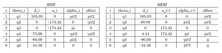

Following the rules of SDH, the table below can be derived. In the diagram above, theta_2 is set to -90, but since it is a variable parameter, we designate it as q2.

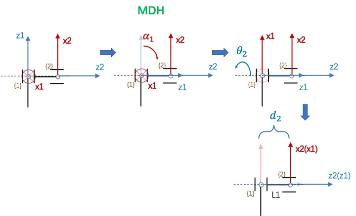

The order for MDH is α → a → θ → d.
① Rotate the z_{i-1} axis of coordinate system {i-1} about the x_{i} axis to align with the z_{i} axis. The rotation angle is α_{i-1}, with the right-hand rule defining the positive direction as the z-axis.
② Translate the z_{i-1} axis along the x_{i-1} axis to the z_{i} axis by a distance of a_{i-1}.
③ Using the result of the previous transformation, rotate the x_{i-1} axis of coordinate system {i-1} about the z_{i-1} axis to align with the x_{i} axis. The rotation angle is θ_{i}, with the right-hand rule defining the positive direction as the x-axis.
④ Translate the x_{i-1} axis along the z_{i-1} axis to the x_{i} axis by a distance of d_{i}, until the two coordinate systems coincide.
Applying MDH rules, the table below can be generated. In the diagram above, theta_2 is assigned as 90, but as it is a variable parameter, we represent it as q2.

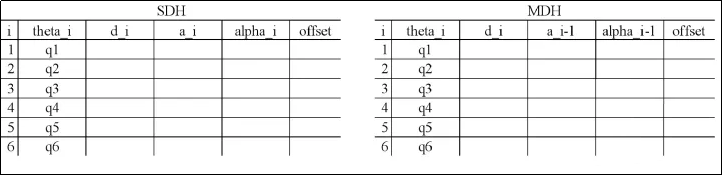

(6) Complete Table

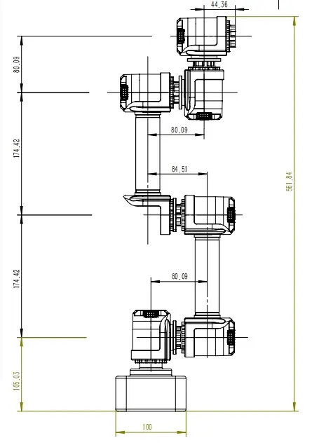

Fill in the table based on the DH method model and engineering drawings. (The official two-dimensional drawings and three-dimensional model dimensions are inconsistent. Since the primary use is the three-dimensional model, I measured the three-dimensional drawings again myself.)

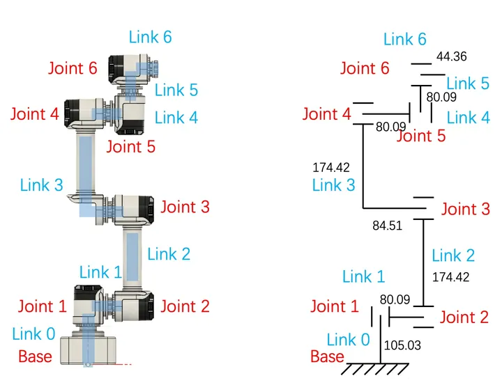

3.2.2 JetArm DH Model

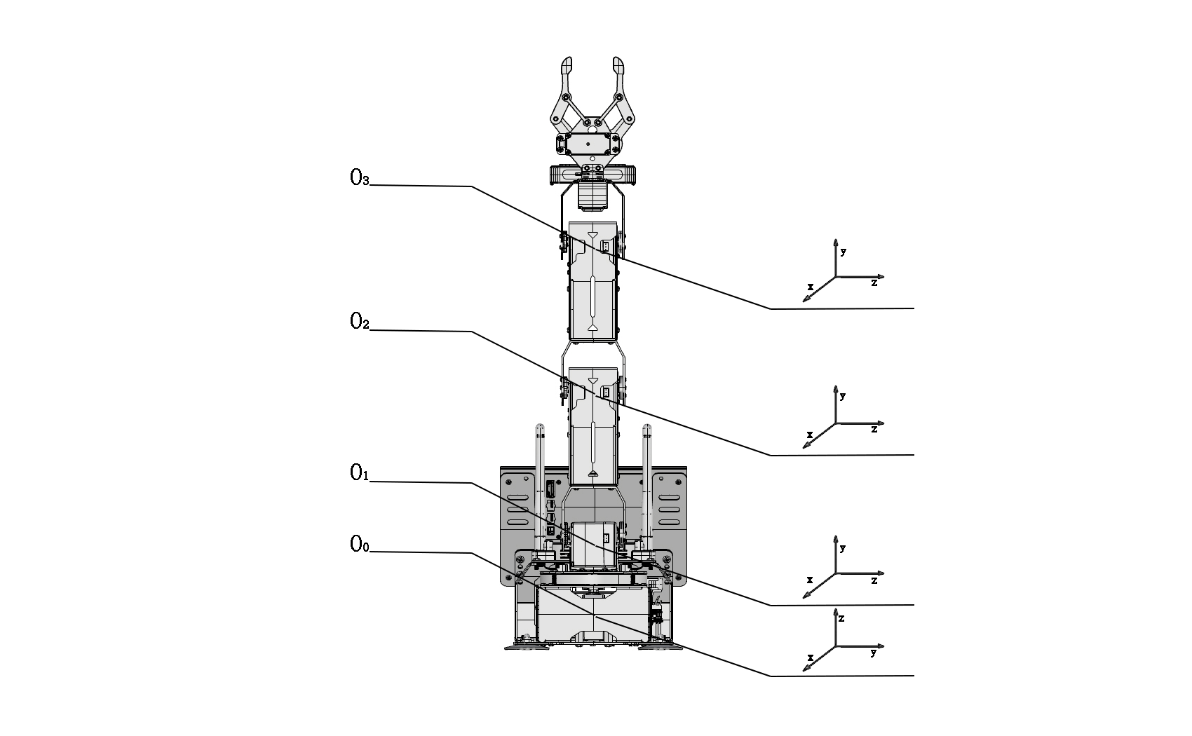

(1) JetArm DH coordinate system:
(2) DH Model List:
Please refer to the file below:

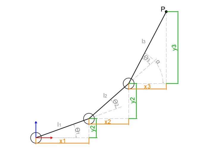

3.3 Forward Kinematics Analysis
3.3.1 Introduction to Inverse Kinematics
  • Introduction
Forward kinematics refers to the process of deriving the motion of the end effector from the joint movements of a robot. It involves calculating the position and orientation information of the end effector based on the joint coordinates of the robot.
Forward kinematics is easier to understand and implement because it directly calculates the position and orientation of the end effector from the robot’s joint movements. In robot control, forward kinematics is widely used in trajectory planning, simulation, visualization, and other aspects.
  • Forward Kinematics Logic
The forward kinematics of a robotic arm is typically expressed in the following functional form:
This equation indicates that the pose of the end effector is a function based on the joint coordinates. If expressed using homogeneous transformations, the expression is a simple product of individual link transformation matrices given by Equation (2). For N links in a robotic arm, the expression becomes:
For any robotic arm, regardless of the number and configuration of its joints, the forward kinematics solution can be calculated. The practical task space for most robotic arms is typically three-dimensional. Controlling the motion of a robotic arm involves providing specific voltage control signals to each joint, causing them to move to specific angles and achieve the desired pose. For a 6-axis robotic arm, the overall matrix transformation is often denoted as T6.

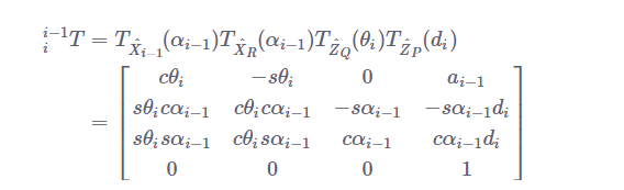

The homogeneous transformation matrix form of DH is as follows:
Obtain the homogeneous transformation matrix for a single joint of JetArm:

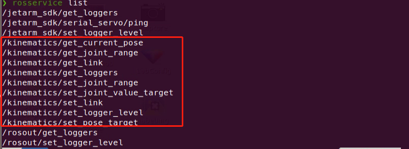

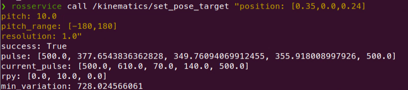

(4) Open a new terminal, and type the command below to access the robot arm kinematics service.
rosservice list
Service Function
/kinematics/get_current_pose Acquire robot's current pose
/kinematics/get_joint_range Retrieve the motion range of each joint
/kinematics/get_link Get joint link information of the robot
/kinematics/get_loggers Retrieve the log information from the kinematics module
/kinematics/set_joint_range Set the motion range of the robot's joints
/kinematics/set_joint_value_target Set the angle of the target joint to achieve the pose control
/kinematics/set_link Configure the joint linkage information for the robot
/kinematics/set_logger_level Set the logging level for the kinematics module
/kinematics/set_pose_target Set the target pose for the robot's end effector

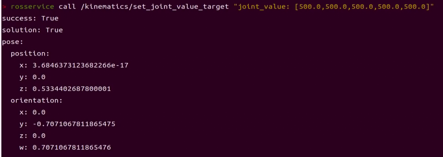

  • Invoke Service
Open a new terminal , and execute the command below.

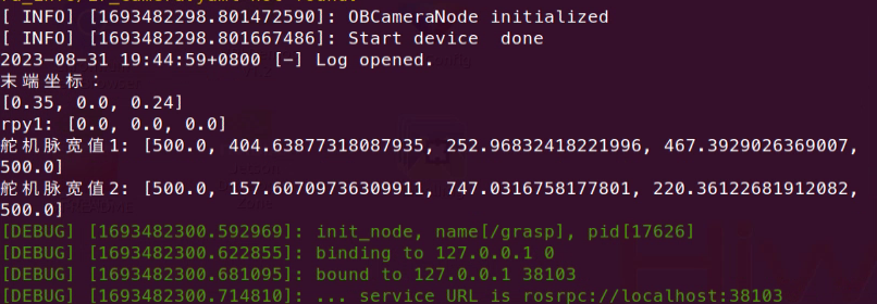

rosservice call /kinematics/set_joint_value_target "joint_value: [500.0,500.0,500.0,500.0,500.0]"
By inputting the rotation angles of servos 1-5, you can obtain the pose information of the robotic arm after movement. The information includes coordinates along the XYZ axes and the orientation represented using quaternions.
The service call here only displays the pose information; the robotic arm does not physically move.

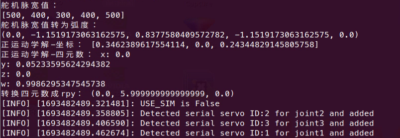

	rospy.init_node('fk_demo', anonymous=True) #初始化节点(initialization node)
Create an object named fk for forward kinematics calculations. This object will calculate the position of the robot’s end effector.
	fk = ForwardKinematics(debug=True)
(3) Set the Information Print on Terminal
Print the servo pulse width value on the terminal.
print("舵机脉宽值:")
servo_list = [500,400,300,400,500]
print(servo_list)
Print the radian value on the terminal.
print("舵机脉宽值转为弧度:")

(4) Obtain the Forward Kinematics Solution
Display the forward kinematics solution in the form of coordinate systems, quaternions, and Euler angles.
res = fk.get_fk(pulse)  #获取运动学正解(get kinematics solution)
print('正运动学解-坐标:', res[0])
print('正运动学解-四元数:', res[1])
print('转换四元数成rpy:', transform.qua2rpy(res[1]))

We simplify the model of the robotic arm by removing the base pan-tilt and the end effector, focusing on the main body of the arm. From the diagram, we can see the coordinates (x, y) of the endpoint P of the robotic arm. Ultimately, it is composed of three parts (x1 + x2 + x3, y1 + y2 + y3).
In the diagram, θ1, θ2, and θ3 are the angles of the servos that we need to solve, and α is the angle between the gripper and the horizontal plane. From the diagram, it’s evident that the top-down angle of the gripper α = θ1 + θ2 + θ3. Based on this observation, we can formulate the following equation:
The values of x and y are provided by the user, while l1, l2, and l3 represent the inherent mechanical properties of the robotic arm’s structure.
For ease of calculation, we will preprocess the known components for a holistic consideration:
Substituting m and n into the existing equation and simplifying further, we can obtain:
Through calculation, we have:
We observe that the above expression is the quadratic formula for a single variable, where:
With this information, we can determine the angles θ1 and, similarly, calculate θ2. Consequently, we can determine the angles for all three servos. By controlling the servos based on these angles, we can achieve control over the coordinate position.

(3) Open a new command-line terminal , and run the command below to view the robot arm kinematics service.
  • rosservice list
Service Function
Programe outcome

Open a new command line terminal , and execute the command below and complement the command using Tab key.
rosservice call /kinematics/set_pose_target “position: [0.35,0.0,0.24]
pitch: 10.0
pitch_range: [-180,180]
resolution: 1.0”
Enter the target position’s xyz coordinates (must be of float type). The pitch represents the servo’s pitch angle, with a range of (-180,180). The pitch_range denotes the angle range, also within (-180,180), and resolution adjusts the angle range, fixed at 1.0.
If the set target position and angle cannot be successfully reached by the robotic arm, the corresponding servo information will not be displayed in the terminal. In this case, the service call only displays pose information, and the robotic arm does not move.

(3) Set Terminal Printing Information
Print the end coordinate on the terminal.
print("末端坐标:")
coordinate = [0.35,0.0,0.24]
print(coordinate)
Create an empty list: servo_list
servo_list = []
(4) Obtain Kinematic Inverse Solutions
Retrieve kinematic inverse solutions from get_ik, convert the solutions into servo pulse width values, and store these values in the servo_list array.
res = get_ik(coordinate,0, [-180, 180])  #获取运动学逆解(get kinematics inverse solution)
if res != []:
    for i in range(len(res)):
        print('rpy%s:'%(i + 1), res[i][1])  # 解对应的rpy值(derive the corresponding roll, pitch, and yaw (RPY) values)
        pulse = transform.angle2pulse(res[i][0])  # 转为舵机脉宽值(convert to servo pulse-width value)
        servo_list = pulse[0]
        for j in range(len(pulse)):
            print('舵机脉宽值%s:'%(j + 1), pulse[j])
