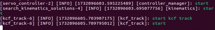

(1) Click-on to open the command-line terminal, then execute the following command to disable the app auto-start service:
(2) Execute the command below to launch the camera file.
ros2 launch example camera_topic_invoke.launch.py
(3) If you need to terminate the running program, press ‘Ctrl+C’. If the program fails to stop, please retry.
(4) To avoid the interference on the following app functions, please execute the command to initiate the app service. Once you hear a beep sound from the robot, the service has been restarted successfully.

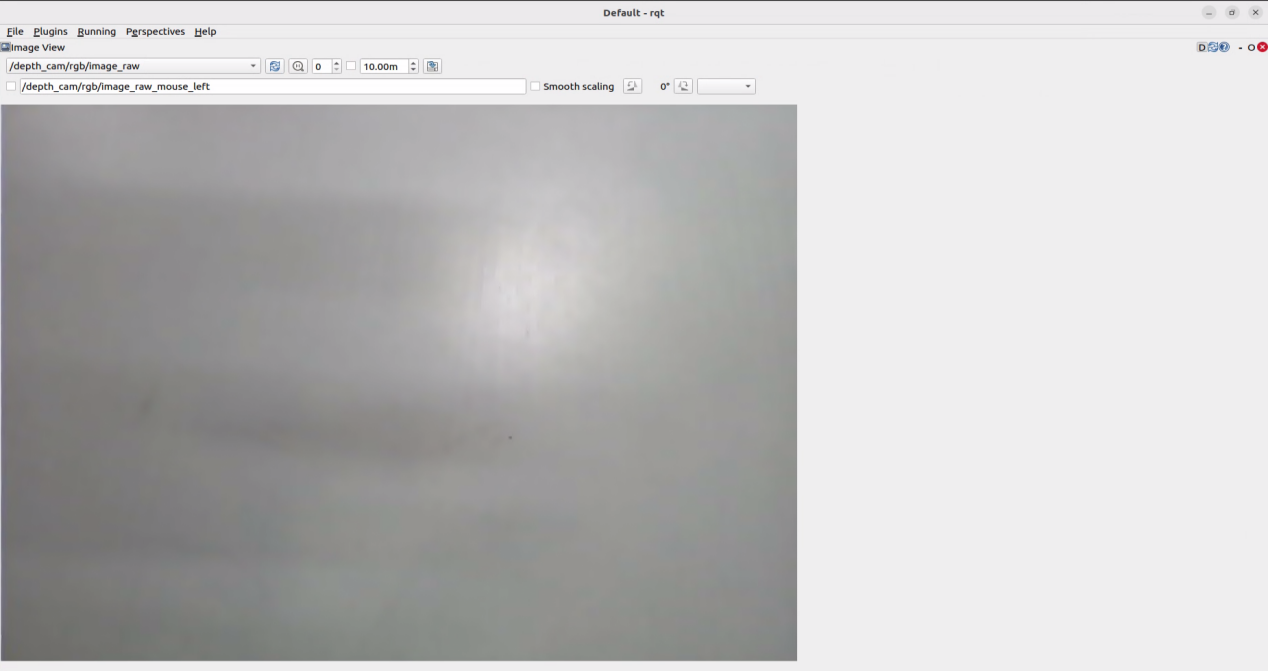

  • Program Outcome
The live camera feed will pop up.

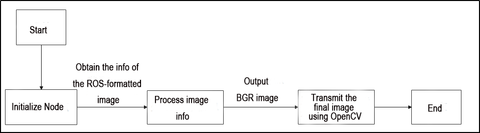

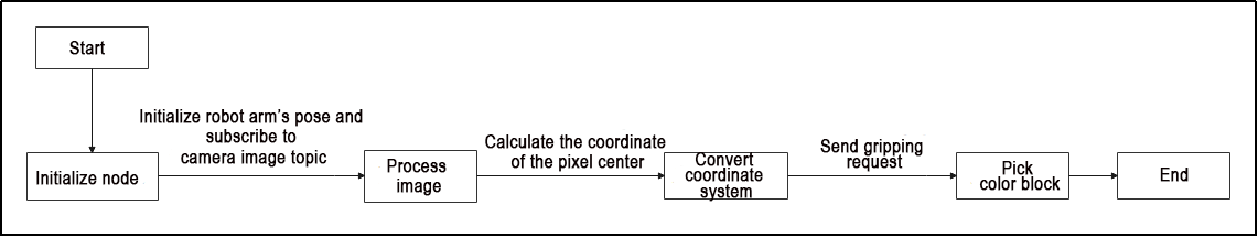

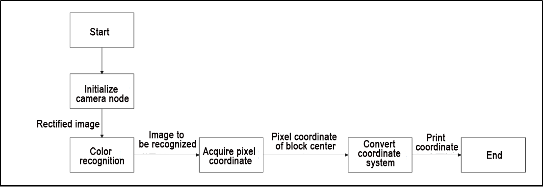

The program implementation logic is as pictured:
Following the program flowchart, the main function of the program involves processing the captured image and transmitting the final image.

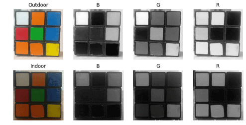

The image we perceive is actually composed of pixels arranged by three color components: B (blue), G (green), and R (red) in each frame. A color model, also known as a color space, is a mathematical model that uses a set of values to describe colors.
RGB is a commonly used color space type, but there are several others, including the GRAY color space (for grayscale images), Lab color space, XYZ color space, YCrCb color space, HSV color space, HLS color space, CIELab* color space, CIELuv* color space, Bayer color space, among others.
Each color space excels in addressing specific problems, and to conveniently handle a particular issue, one may need to perform color space type conversion. Color space type conversion refers to transforming an image from one color space to another. For example, when using OpenCV to process images, one might perform conversions between the RGB color space and the Lab color space. During tasks like feature extraction or distance calculation, it is common to convert the image from the RGB color space to the grayscale color space. In some applications, it may be necessary to convert color space images to binary images.
  • Common Color Space Type
(1)RGB Color Space
RGB color space includes the following characteristics:
①It is a color space where colors are obtained through the linear combination of the Red (R), Green (G), and Blue (B) components.
② Object illumination affects the values of each channel in this color space, and the three color channels are correlated. Let’s split the image into its R, G, and B components and observe them to gain a deeper understanding of the color space.
From the image below, if you look at the blue channel, you can see that the blue and white parts of the Rubik’s Cube in the second image appear similar under indoor lighting conditions, but there is a noticeable difference in the first image. This non-uniformity makes color-based segmentation in this color space very challenging. Additionally, there is an overall difference in values between the two images. Therefore, the RGB color space exhibits issues with uneven color value distribution and the blending of chromaticity and brightness.

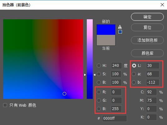

In OpenCV, the numerical range of R, G, B values in the RGB color space is [0-255]. In the Lab color space, the L value range is [0-100], where 0 represents black, and 100 represents white. The a and b values range from [-128, 127], and both a and b values of 0 represent gray.
To further aid in understanding the comparison between RGB and Lab, here is an example using Photoshop software:
①Use the color picker to pick the color.
②The relationship between the Lab and RGB is as below:

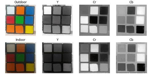

(3)Ycrcb Color Space
The Human Visual System (HVS) is less sensitive to color than it is to brightness. In the traditional RGB color space, the three primary colors (R, G, B) are given equal importance, but brightness information is overlooked.
In the YCrCb color space, Y represents the brightness of the light source, while chrominance information is stored in Cr and Cb. Here, Cr represents the red component information, and Cb represents the blue component information. Luminance provides information about the degree of color brightness or darkness, and this information can be calculated through the weighted sum of intensity components in the illumination. In RGB light sources, the green component has the greatest impact, while the blue component has the smallest impact.
For changes in illumination, similar observations can be made for intensity and color components in LAB. In comparison to LAB, the perceptual difference between red and orange in outdoor images is relatively small, while white undergoes changes across all three components.

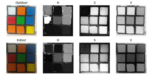

(4) HSV Color Space
The HSV color space is a perceptually-based color model with three components: H (Hue), S (Saturation), and V (Value).
Hue is associated with the dominant wavelengths in the blended spectrum, such as “red, orange, yellow, green, cyan, blue, violet”, representing different hues. If considered from the perspective of wavelength, light of different wavelengths actually reflects differences in hue.
Saturation refers to the relative purity or the amount of white light mixed with a color. Pure spectral colors are fully saturated, while colors like deep red (red plus white) and light purple (purple plus white) are desaturated. Saturation is inversely proportional to the amount of white light added.
Value reflects the brightness of light perceived by the human eye, and this metric is related to the reflectivity of an object. Concerning color, the more white is added, the higher the brightness; the more black is added, the lower the brightness.
One notable feature of HSV is its use of only one channel to describe color (H), making it very intuitive for specifying colors. However, HSV color is device-dependent.
The H component is remarkably similar in both images, indicating that even with changes in lighting, color information remains consistent. The S component in both images is also highly alike, while the V component represents brightness and thus varies with changes in illumination.
There is a significant disparity in the values of red between outdoor and indoor images. This is because the H value represents the starting angle of the color in degrees. Therefore, it may take values between [300, 360] and [0, 60].

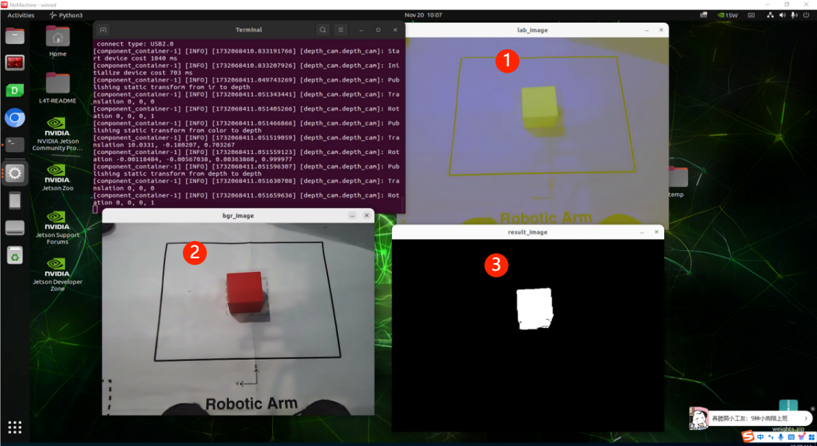

(2) Operation Steps
① Start the robot arm, and access the robot system desktop using NoMachine according to the tutorials saved in 1. Getting Ready->1.6 Development Environment Setup and Configuration
② Double-click to open the command-line terminal, and execute the command, then hit Enter to terminate the app auto-start service.
③ Execute the command and hit Enter to run the game program.
ros2 launch example color_threshold.launch.py
④ In the image:① lab_image (the LAB image converted from RGB);② bgr_image (the image in the BGR color space);③ result_image (the image obtained after applying color thresholding and binarization).
⑤ If you need to terminate the program, please use short-cut ‘Ctrl+C’. If the program fails to stop, please retry.
⑥ After running the previous program, you need to restart the app service by executing the command below.

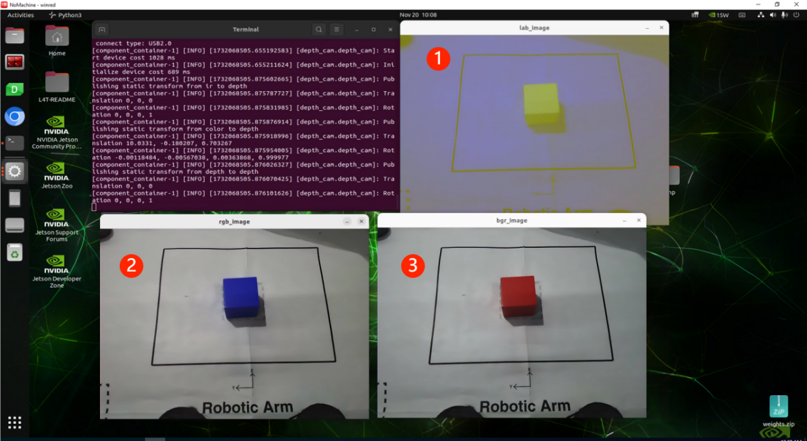

(1) Program Goal
When subscribing to camera images and performing a color space conversion on the acquired images, we can observe images in different color spaces through feedback.
(2) Operation Steps
The input command is case-sensitive, and keywords can be auto-completed using the Tab key.
② Double-click to open the command-line terminal. Execute the following command below to disable the app auto-start service.
③ Execute the command below and hit Enter to run the game program.
ros2 launch example color_space.launch.py
④ The image shows the following: ① lab_image: The image converted from RGB to the LAB color space. ② rgb_image: The original image captured by the camera. ③ bgr_image: The image converted from RGB to the BGR color space.
⑤ If you need to terminate the running program, press short-cut ‘Ctrl+C’. If the program fails to run, please retry.
⑥ After using the previous function, it is necessary to restart the app service; otherwise, subsequent app operations may be affected. Execute the command below and press Enter to initiate the app service.

The program flowchart is as below:
From the above diagram, the program revolves around processing the acquired images and providing live camera feed.

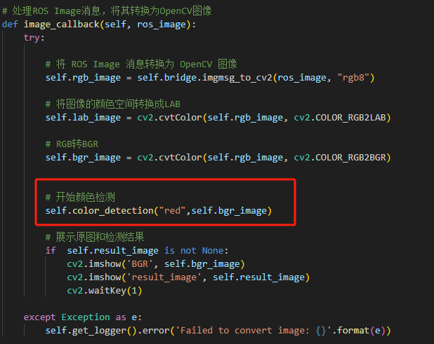

④ Image Callback Function
    # Process ROS Image message and convert it to OpenCV format. 处理 ROS Image 消息并转化为 OpenCV 格式
            # Convert ROS Image message to OpenCV image. 将 ROS Image 消息转换为 OpenCV 图像
            self.rgb_image = self.bridge.imgmsg_to_cv2(ros_image, "rgb8")
            self.bgr_image = cv2.cvtColor(self.rgb_image, cv2.COLOR_RGB2BGR)
            # Convert the image color space to LAB. 将图像的颜色空间转换成LAB
            self.lab_image = cv2.cvtColor(self.rgb_image, cv2.COLOR_RGB2LAB)
            if self.running  and self.bgr_image is not None and self.lab_image is not None:
                # Display the image. 展示图像
                cv2.imshow('rgb_image', self.rgb_image)
                cv2.imshow('bgr_image', self.bgr_image)
                cv2.imshow('lab_image', self.lab_image)
                cv2.waitKey(1)
        except Exception as e:
            self.get_logger().error(f"Error converting image: {e}")
  • self.bridge.imgmsg_to_cv2(ros_image, 'rgb8'): Uses CvBridge to convert a ROS image message (sensor_msgs/Image) into an OpenCV image format (a numpy array). The image format is `rgb8`.
  • cv2.cvtColor(self.rgb_image, cv2.COLOR_RGB2BGR): Converts the RGB image to BGR format, as OpenCV uses BGR by default.
  • cv2.cvtColor(self.rgb_image, cv2.COLOR_RGB2LAB): Converts the RGB image to the LAB color space, which is commonly used for color analysis in image processing.
  • cv2.imshow(...): Displays the RGB, BGR, and LAB images using OpenCV.
  • cv2.waitKey(1): Ensures the OpenCV window is updated and processes keyboard events (with a wait time of 1 millisecond).
  • Exception: Catches and logs any errors that occur during the image conversion process.

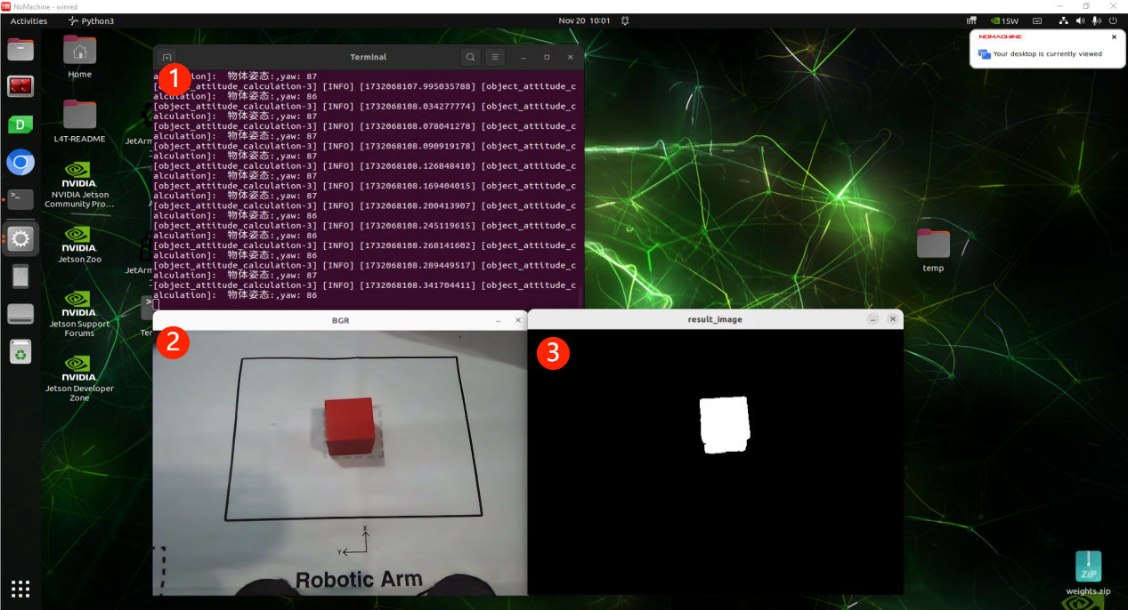

(1) Program Goal
By subscribing to camera image data, the captured images are converted to the LAB color space. Following this conversion, color recognition can be performed using specific color thresholds. After matching the transformed image with the color thresholds, the program identifies the desired colors and prints the recognized color in the terminal. Additionally, it outputs the BGR image and the binary image.

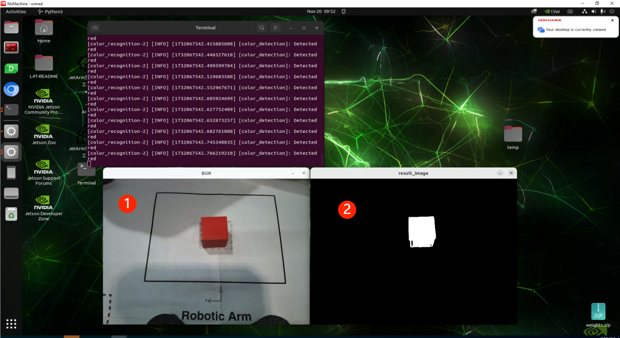

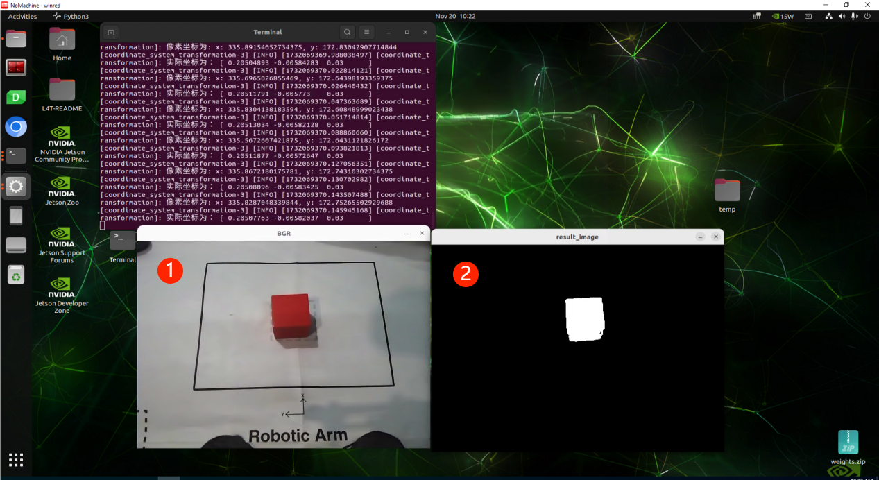

(2) Operation Steps
② Double-click to open the command-line terminal. Execute the command below, and hit Enter to disable the app auto-start service.
③ Execute the following command and hit Enter.
ros2 launch example color_recognition.launch.py

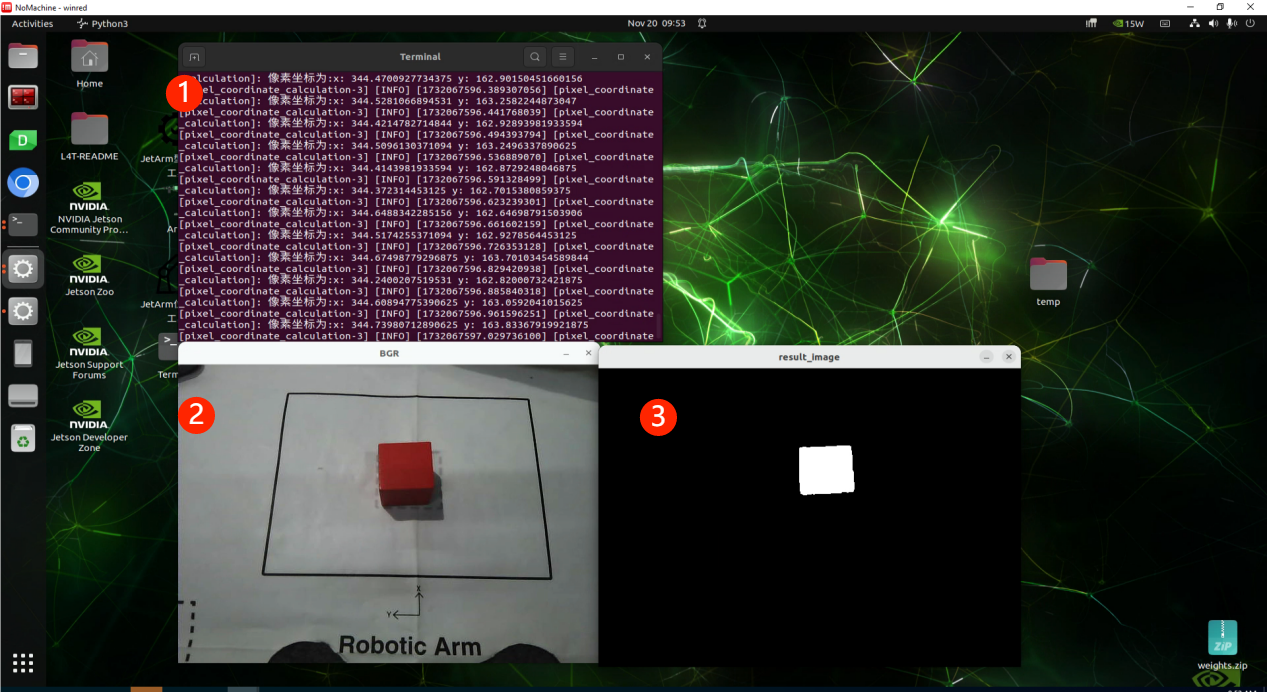

④ The image shows the following: ① BGR: The image in the BGR color space. ② result_image: The binary image generated from the color recognition results.
From the above diagram, the program revolves around processing the acquired images and providing visual feedback.

③ Image Callback Processing Function
61
70
71
    # Process ROS Image message and convert it to OpenCV image. 处理ROS Image消息,将其转换为OpenCV图像
            # Convert RGB to BGR. RGB转BGR
            # Start color detection. 开始颜色检测
            self.color_detection("red",self.bgr_image)
            # Display original image and detection results. 展示原图和检测结果
            if  self.result_image is not None:
                cv2.imshow('BGR', self.bgr_image)
                cv2.imshow('result_image', self.result_image)
                cv2.waitKey(1)
            self.get_logger().error('Failed to convert image: {}'.format(e))
  • Convert ROS image messages to OpenCV images: Use CvBridge to convert ROS image messages to RGB images: self.bridge.imgmsg_to_cv2(ros_image, "rgb8").
  • Convert RGB images to LAB color space: Use OpenCV to convert the RGB image to LAB color space: self.lab_image = cv2.cvtColor(self.rgb_image, cv2.COLOR_RGB2LAB).
  • Convert RGB images to BGR: Transform the RGB image into BGR format using OpenCV: self.bgr_image = cv2.cvtColor(self.rgb_image, cv2.COLOR_RGB2BGR).
  • Perform color detection: Call self.color_detection("red", self.bgr_image) to detect a specific color. In this case, “red” is hardcoded, meaning it will always detect red areas.
  • Display images if color is detected: If a color region is detected, use cv2.imshow to display both the original BGR image and the resulting image.
  • Handle exceptions: If the image conversion fails, catch the exception and log the error message.

    # Color recognition function 颜色识别函数
    def color_detection(self, color, bgr_image):
        self.result_image = cv2.GaussianBlur(bgr_image, (3, 3), 3)
        self.result_image = cv2.cvtColor(self.result_image, cv2.COLOR_BGR2LAB)
        # Set color thresholds and generate a binary image. 设置颜色阈值并生成二值化图像
        self.result_image = cv2.inRange(self.result_image,
                                      np.array(self.lab_data['color_range_list'][color]['min']),
                                      np.array(self.lab_data['color_range_list'][color]['max']))
        self.result_image = self.erode_and_dilate(self.result_image)
        # Find all contours. 找出所有轮廓
        contours = cv2.findContours(self.result_image, cv2.RETR_EXTERNAL, cv2.CHAIN_APPROX_NONE)[-2]
        if contours:
            c = max(contours, key=cv2.contourArea)
            area = math.fabs(cv2.contourArea(c))
            if area >= 2000:
                if self.display:
                    self.get_logger().info(f"Detected {color}")
        # Convert the binary image to BGR format for publishing. 将二值化的图像转换为BGR格式,便于发布
        # result_image = cv2.cvtColor(self.result_image, cv2.COLOR_GRAY2BGR)
        # Publish the color BGR image. 发布彩色 BGR 图像
        self.image_pub.publish(self.bridge.cv2_to_imgmsg(self.result_image, "mono8"))
  • Preprocessing: Apply Gaussian blur using cv2.GaussianBlur to reduce noise, then convert the image from BGR to the LAB color space.
  • Color Extraction: Use cv2.inRange to extract regions of the specified color, generating a binary image. The color threshold is defined by self.color_threshold[color].
  • Erosion and Dilation: Perform erosion and dilation operations on the binary image to clean and enhance the detected areas.
  • Contour Detection: Use cv2.findContours to identify contours in the image and calculate their areas. If the largest detected contour has an area greater than 2000, the target color is considered detected.
  • Result Publishing: Convert the processed binary image into a ROS image message and publish it to the /color_detection/result_image topic.

(1) Start the robot arm, and access the robot system desktop using NoMachine according to the tutorials saved in 1. Getting Ready->1.6 Development Environment Setup and Configuration
(2)Double-click to open the command-line terminal. Execute the command, and hit Enter to disable the app auto-start service.
(3) Execute the command below and hit Enter to run the game program.
ros2 launch example pixel_coordinate_calculation.launch.py
If you need to change the recognition color, you can change the color set at the end of the command to ‘blue’ or ‘green’.
(4) As shown in the picture below, the terminal
① prints the coordinates of the pixels (where ‘x’ represents the horizontal coordinate and ‘y’ represents the vertical coordinate). The window
② named “RGB” in the bottom-left corner displays the feedback image from the depth camera (an image transformed from RGB to BGR). The window
③ named “color_detection”, displays the binarized black and white image generated by the “color_detection” function, highlighting the distinctive features of the subject.
(5) If you need to terminate the running program, press short-cut ‘Ctrl+C’. If the program fails to run, please retry.
(6) After using the previous function, it is necessary to restart the app service; otherwise, subsequent app operations may be affected. Execute the command below and press Enter to initiate the app service.
(2) Double-click to open the command-line terminal, and execute the command below, then hit Enter to terminate the app auto-start service.
ros2 launch example object_attitude_calculation.launch.py
(4) As shown in the image below, the terminal in the top-left corner (①) prints the object’s yaw angle, which corresponds to the gripping angle of the robotic claw. The window in the bottom-left corner (②), labeled “RGB”, displays the depth camera’s returned image (converted from RGB to BGR). The window in the bottom-right corner (③), labeled “result_image”, shows the binary black-and-white image generated by the color_detection function.
(5) If you need to terminate the program, please use short-cut ‘Ctrl+C’. If the program fails to stop, please retry.
From the above diagram, the main logic flow of the program involves processing the acquired image and then recognizing the colors within the image.

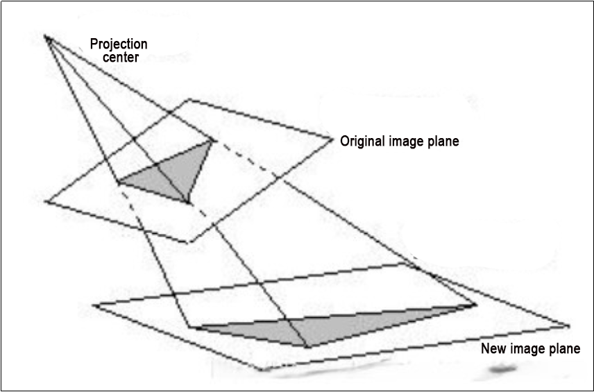

13.1.6 Perspective Transformation
  • Perspective Transformation Description
Perspective transformation refers to the process of projecting an image onto a new viewing plane using the conditions of collinearity among the perspective center, image points, and target points. The goal of perspective transformation is to convert objects that appear as lines in reality but may be skewed in an image into straight lines through the transformation process.
  • Perspective Transformation Function
Perspective transformation is commonly employed in research areas such as vision navigation for mobile robots. In scenarios where the camera is inclined relative to the ground rather than directly facing downward, resulting in an oblique angle, there is a need to rectify the image into a form with a straight, orthogonal projection. This correction is achieved through the application of perspective transformation.
  • Perspective Transformation Principle
The process of converting a three-dimensional object or entity from a spatial coordinate system into a two-dimensional image representation is known as projection transformation. Perspective transformation is an operation that modifies the size and shape of objects, resulting in a three-dimensional effect when applied to a planar figure. For instance, in the case of a rectangle, shear transformation only displaces two vertices on the same edge, both moving in the same direction, while keeping the other two vertices stationary. Conversely, perspective transformation may require moving all vertices of the rectangle, with the two vertices on the same edge moving in opposite directions. Simply put, perspective transformation involves transitioning from a two-dimensional image to a three-dimensional representation and then back to a two-dimensional image.
Based on the schematic principles of perspective transformation, we can formulate the following equations:
The coordinates (X, Y, Z) represent a point in the original image plane, and the corresponding transformed image plane coordinates are (x, y). Since we are dealing with a two-dimensional image, we can set Z=1. Dividing the transformed image coordinates by Z is a way to reduce the image from three dimensions to two dimensions. Thus, we can obtain the following equations:
Usually, we set a33=1 (to simplify obtaining X’, Y’, ensuring that the denominator on the left side of equation 3 is 1). Expanding the above formula, we obtain the situation for a single point:
Equation 3 involves a total of 8 unknowns. To solve for these unknowns, it is necessary to formulate eight sets of equations. This entails manually selecting four points on both the source image and the target image. On the source image, four coordinates are selected: A (x0, y0), (x1, y1), (x2, y2), (x3, y3). Simultaneously, four coordinates are chosen on the target image: B (X’0, Y’0), (X’1, Y’1), (X’2, Y’2), (X’3, Y’3).
By substituting into Equation 3, we can obtain Equation 4 as follows:

  • Operation Steps

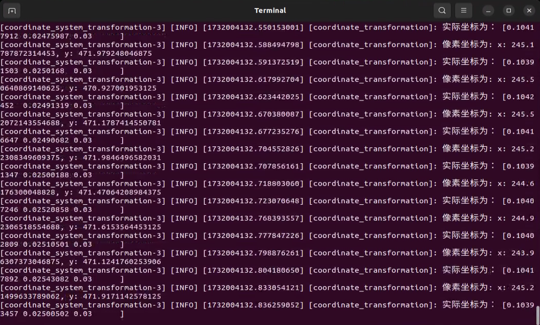

(3) Execute the following command to run the game program
ros2 launch example coordinate_system_transformation.launch.py
(4) In the screen, the left side (①) shows the BGR image (the image converted from RGB to BGR), while the right side (②) displays the color detection image (the processed image after color recognition). The terminal outputs the pixel coordinates of the color block’s center and the corresponding real-world coordinates after conversion.
(5) If you want to terminate the running program, please press ‘Ctrl+C’. If the game cannot be stopped, please retry.
(6) After running the previous program, you need to restart the app service by executing the command below to start the app service.

The program flow chart is as below:
From the above diagram, it can be inferred that the main logical flow of the program involves processing images through color recognition. This process entails extracting the central coordinates of object pixels, converting these coordinates, and obtaining the actual position of the object, which is then printed.

    # Process ROS node data. 处理ROS节点数据
    def image_callback(self, result_image):
            result_image = self.bridge.imgmsg_to_cv2(result_image, "mono8")
            if result_image is not None :
                # Calculate the detected contours. 计算识别到的轮廓
                contours = cv2.findContours(result_image, cv2.RETR_EXTERNAL,cv2.CHAIN_APPROX_NONE)[-2]  # Find all contours. 找出所有轮廓
                if contours :
                    # Find the largest contour. 找出最大轮廓
                    c = max(contours, key = cv2.contourArea)
                    # Decide whether to proceed based on contour size. 根据轮廓大小判断是否进行下一步处理
                    rect = cv2.minAreaRect(c)  # Get the minimum bounding rectangle. 获取最小外接矩形
                    corners = np.int0(cv2.boxPoints(rect))  # Get the four corner points of the minimum bounding rectangle. 获取最小外接矩形的四个角点
                    x, y = rect[0][0],rect[0][1]
                    if self.camera_type == 'USB_CAM':
                        x, y = distortion_inverse_map.undistorted_to_distorted_pixel(target[2][0], target[2][1], self.intrinsic, self.distortion)
                    self.get_yaml()
                    projection_matrix = np.row_stack((np.column_stack((self.extristric[1],self.extristric[0])), np.array([[0, 0, 0, 1]])))
                    world_pose = common.pixels_to_world([[x,y]], self.K, projection_matrix)[0]
                    world_pose[0] = -world_pose[0]
                    world_pose[1] = -world_pose[1]
                    position = self.white_area_center[:3, 3] + world_pose
                    position[2] = 0.03
                    config_data = common.get_yaml_data(os.path.join(self.config_path, self.calibration_file))
                    offset = tuple(config_data['pixel']['offset'])
                    scale = tuple(config_data['pixel']['scale'])
                    for i in range(3):
                        position[i] = position[i] * scale[i]
                        position[i] = position[i] + offset[i]
                    # Print pixel coordinates and actual coordinates. 打印像素坐标、实际坐标
                    self.get_logger().info(f"像素坐标为: x: {x}, y: {y}")
                    self.get_logger().info(f"实际坐标为: {position}")
                    time.sleep(1)
                    self.get_logger().info("未检测到所需识别的颜色,请将色块放置到相机视野内。")
            print(e)
result_image = self.bridge.imgmsg_to_cv2(result_image, "mono8"):Convert ROS Image message to OpenCV image.
contours = cv2.findContours(result_image, cv2.RETR_EXTERNAL, cv2.CHAIN_APPROX_NONE)[-2]:Calculate the detected contours,find all contours.
c = max(contours, key = cv2.contourArea):Find the largest contour.
rect = cv2.minAreaRect(c):Get the minimum bounding rectangle.
corners = np.int0(cv2.boxPoints(rect)):Get the four corner points of the minimum bounding rectangle.
x, y = rect[0][0], rect[0][1]:Get center coordinates of the rectangle
x, y = distortion_inverse_map.undistorted_to_distorted_pixel(:Handle distortion for USB camera
projection_matrix = np.row_stack((:Create projection matrix.
world_pose = common.pixels_to_world([[x,y]], self.K, projection_matrix)[0]:Convert pixel coordinates to world coordinates
Calculate final position:Invert X axis
world_pose[1] = -world_pose[1]:Invert Y axis
position = self.white_area_center[:3, 3] + world_pose:Calculate final position
config_data = common.get_yaml_data(os.path.join(self.config_path, self.calibration_file)): Load offset and scale from config

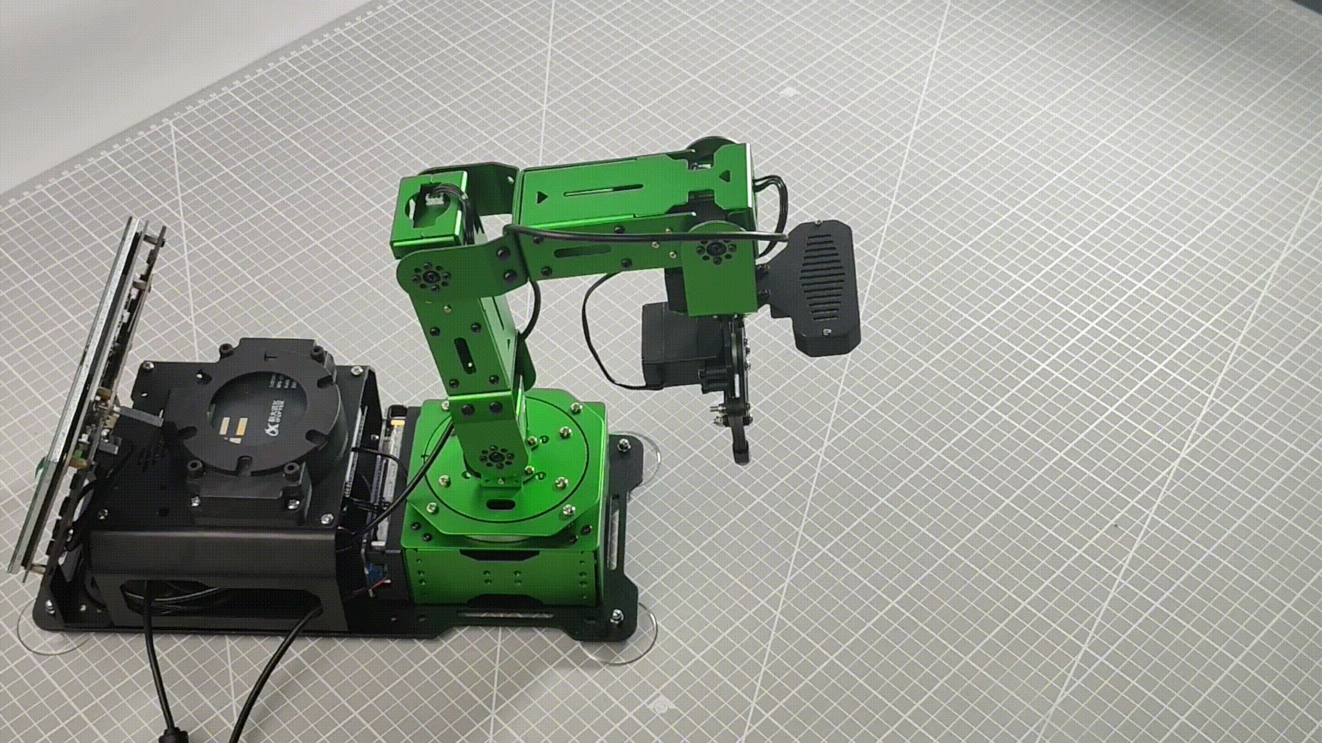

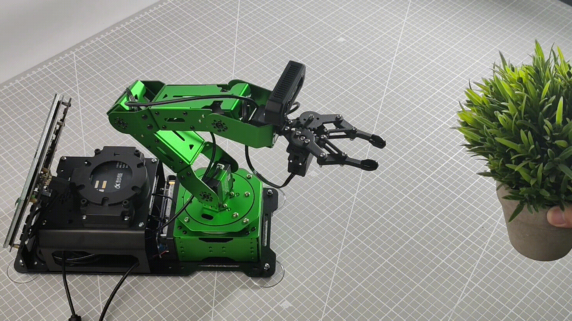

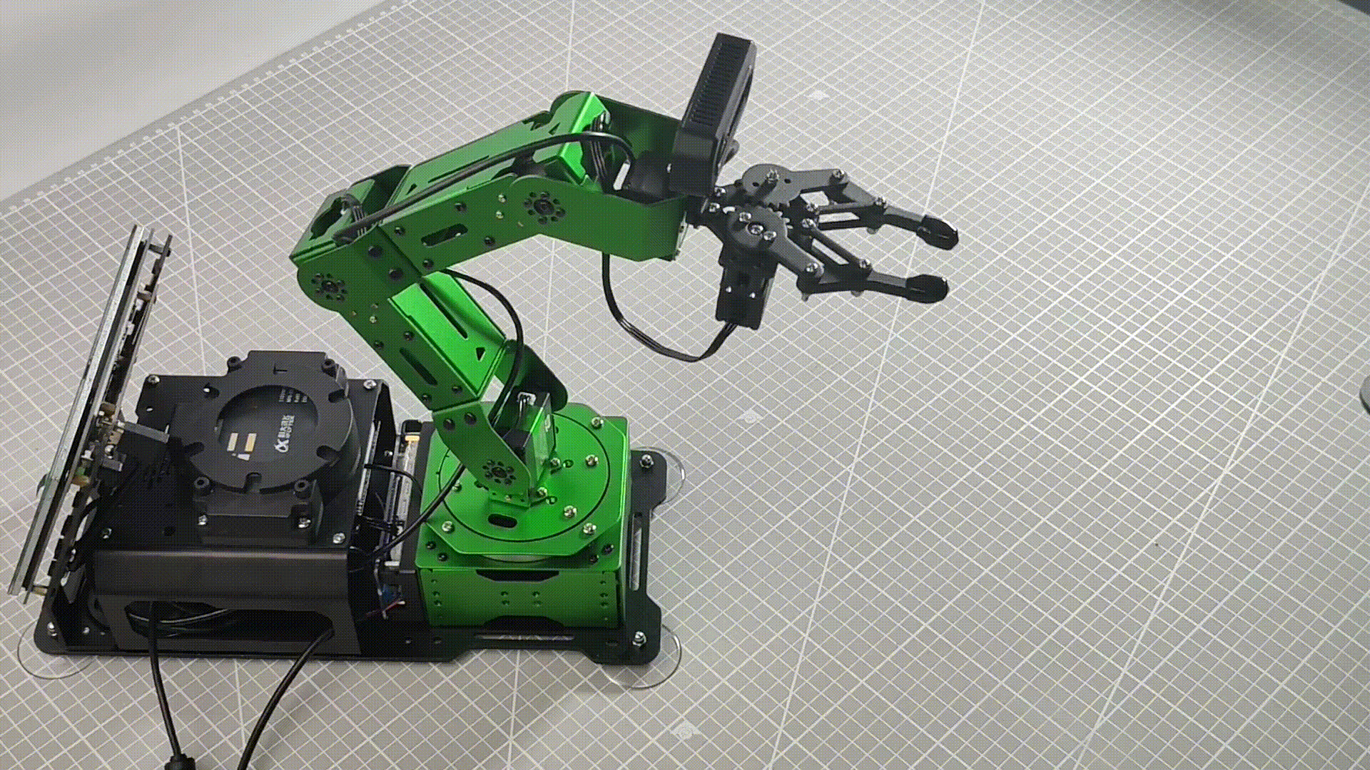

  • Program Logic
When we want the robotic arm to grasp an object according to our requirements, we need to use the coordinates of the object. Based on these coordinates, the servos on the robotic arm rotate to specific angles to facilitate the grasping of the object.
(1) Rotate the robotic arm’s pan-tilt to the target direction.
(2) Move the robotic arm to a position directly above the target.
(3) Control the end effector on the robotic arm to approach the target object.
  • Operation Steps
(3) Execute the command below to start the trajectory planning Demo.
ros2 launch example path_planning.launch.py
The pan-tilt of the robot arm will rotate to align the gripper with the target destination. Subsequently, the robot arm will move to the target location and finally return to its initial pose.
(4) If you need to terminate the program, please use short-cut ‘Ctrl+C’. If the program fails to stop, please retry. After running the previous program, restart the app service by executing the following command and press Enter to initiate the app service.
sudo start start_app_node.service

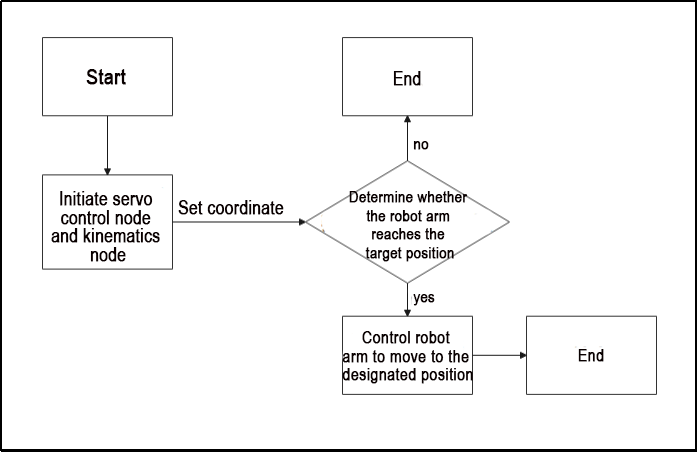

Start the servo control node and kinematics node.Input the specified coordinates into the inverse kinematics to determine if the target point is reachable.
If not reachable: End the program.
If reachable: Use the servo control node with the servo parameters obtained from the inverse kinematics solution to control the robotic arm to move to the specified coordinates, and then end the program.

① The move_0 and move_1 methods use set_pose_target() to set the target position, including coordinates and orientation angles. Then, the send_request function is called to send a request to the kinematics service to check if the robotic arm can reach the target position.
② If the target position is reachable, the servo angles are returned, and the servo positions are updated. If the target position cannot be reached, an error log is output, and further operations are stopped.

13.1.9 Position & Picking
  • Program Goal
The robotic arm can calculate the center coordinates of a recognized object and use inverse kinematics to grasp the object. Here, we take the example of a red block.
  • Operation Steps
The input command should be case sensitive and keywords can be complemented using Tab key.
①Start the robot arm, and access the robot system desktop using NoMachine according to the tutorials saved in 1. Getting Ready->1.6 Development Environment Setup and Configuration
②Double-click to open the command-line terminal, and execute the command below, then hit Enter to terminate the app auto-start service.
③Run the command below to initiate the positioning and gripping demo.
ros2 launch example positioning_clamp.launch.py
It can be observed that the robotic arm will recognize and calculate the coordinates of the colored block, proceed to grasp the block, and the terminal will print both the pixel coordinates and the real-world coordinates of the block. By default, the system recognizes red color. If you wish to grasp other colors, refer to the following section 13.1.11 Change Default Recognizable Colors If color recognition is inaccurate, adjustments can be made by referring to 1. Getting Ready->1.5 Color Threshold Setting
④If you need to terminate the program, please use short-cut ‘Ctrl+C’. If the program fails to stop, please retry. After running the previous program, you need to restart the app service by executing this command below.

  • Source Code Analysis
The source code locates in
/home/ubuntu/ros2_ws/src/example/example/opencv/include/positioning_clamp.py
From the above diagram, the program’s logical flow primarily involves processing images through color recognition, extracting the pixel center coordinates of objects, converting these coordinates to obtain the actual object coordinates, and then sending the actual coordinates to the servo control function for grasping.

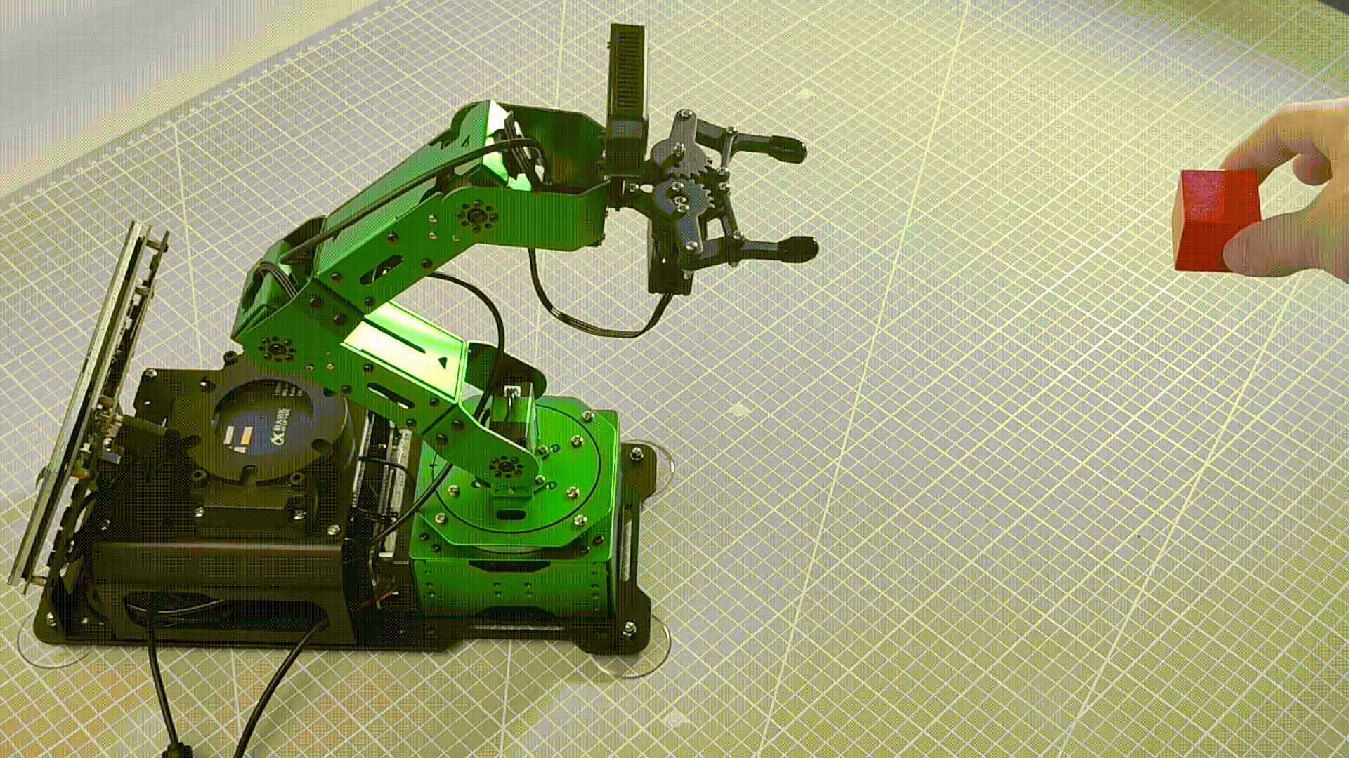

13.1.10 Color Sorting
The robotic arm performs gripping based on the position of the color block, and situates the block in different locations according to its color.
  • Program Logic
To begin, subscribe to the topic messages published by the color recognition node to acquire information about the identified colors.
Next, upon matching the target color, retrieve the central position of the target image.
Finally, employ inverse kinematics to calculate the angles necessary to align the center of the screen with the center of the target image. Publish the corresponding topic message, control servo rotation, and ensure the robotic arm follows the movement of the target.

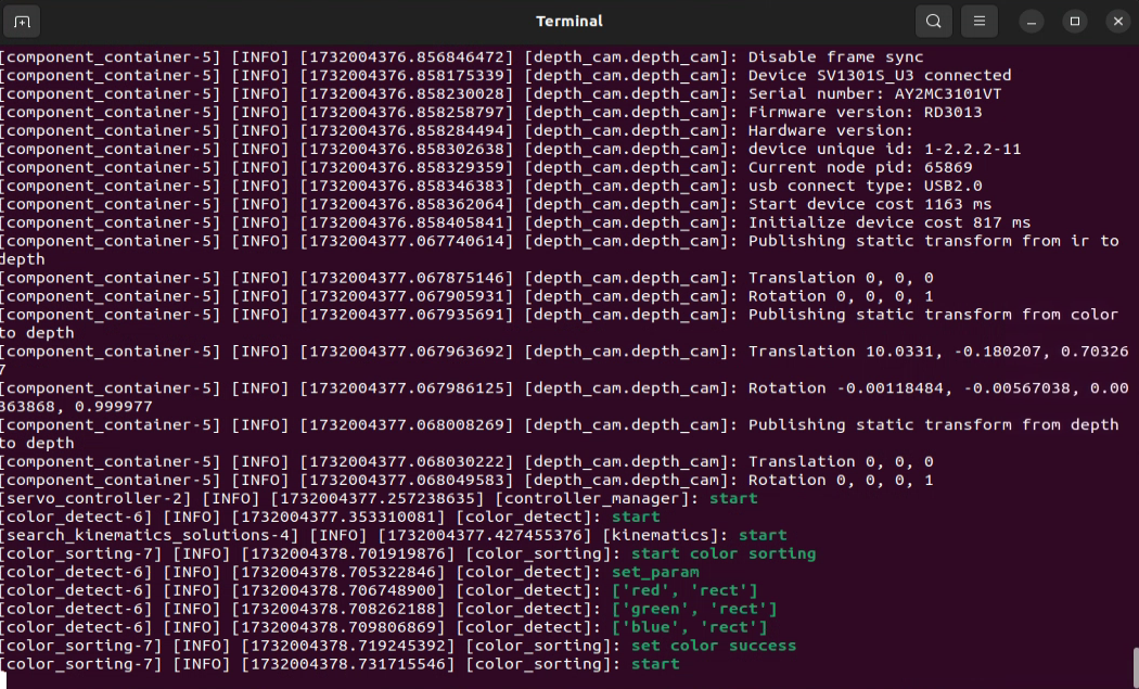

ros2 launch example color_sorting_node.launch.py
(6) After the game starts, you will see the following prompt in the terminal, and the camera feed will automatically pop up.
(7) To close this mode, press ‘Ctrl+C’ in the terminal. If the closure fails, please try again.
(8) If you wish to experience the mobile app features again, enter the command and press Enter to start the app service. Wait for the robotic arm to return to its initial position, and you will hear a ‘beep’ from the buzzer.
  • Program Outcome
Once the game is initiated, place red, green, and blue blocks within the recognition area of the robot arm. When the robot arm identifies the target color block, it will grip it and place it in the corresponding location in the sorting area. If color recognition is inaccurate, refer to 1. Getting Ready->1.5 Color Threshold Setting for adjustments.

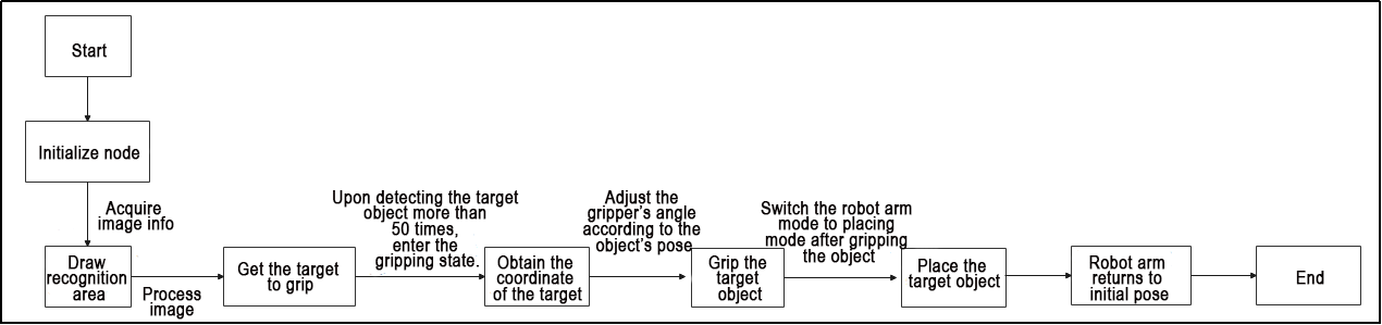

The program flowchart is as pictured.
From the diagram above, the logical flow of the program primarily involves image processing using color recognition. After identifying the target object, the program calls the servo control function based on the coordinates of the target object to initiate gripping. Once gripped, the object is then placed in the designated area. After completing the placement, the robotic arm returns to its initial pose, initiating a new round of detection.

① Retrieve Image from Queue
bgr_image = self.image_queue.get(block=True, timeout=1):Retrieves an image from the self.image_queue. If the queue is empty, it waits up to 1 second. If still empty, the loop iteration is skipped.
② ROI Extraction
if self.start_get_roi:If self.start_get_roi is True, the method self.get_roi() is called to acquire the Region of Interest (ROI), which is then stored in self.roi.
③ Copy ROI
roi = self.roi.copy():Copies the ROI to a local variable roi for further processing.
④ Object Detection Trigger
if len(roi) > 0 and self.enable_sorting and not self.start_transport:If the ROI is not empty, sorting is enabled, and object transport has not started, it calls self.get_object_pixel_position() with the current image and ROI. This returns the detected object’s pixel coordinates (target_info) and the annotated display image (display_image).
⑤ AprilTag Detection
self.at_detector.detect():Converts the BGR image to grayscale and uses the AprilTag detector to identify tags, given the intrinsic camera parameters and tag size (self.tag_size). The results, stored in tags, include tag IDs and corner points.
⑥ Filter Tags by ID
for tag in tags:Iterates over all detected tags and checks if the tag ID is within the list of target labels (self.target_labels).
⑦ Bounding Box Calculation
cv2.minAreaRect():For valid tags, computes the minimum bounding rectangle (rect) and extracts the center, width, height, and angle.
⑧ Store Tag Info
target_info.append():Adds the tag’s positional and orientation information to target_info.
⑨ Reorder by Previous State
target_info = position_change_detect.position_reorder():If previous target information (self.last_object_info_list) exists, reorders the current target_info based on prior data for continuity.
⑩ Update Previous Info
self.last_object_info_list = copy.deepcopy(target_info):Updates the previous target info list with the latest data.
⑪ Annotate Tags
for target in target_info:Iterates over detected targets and annotates each target’s ID near its center point on the image.
⑫ Validate Target Label
if self.target_labels[target[0]]:Checks if the tag ID is within the application’s set of valid targets.
⑬ Skip If Target Locked
if self.target is not None:Skips further processing if a target is already selected.

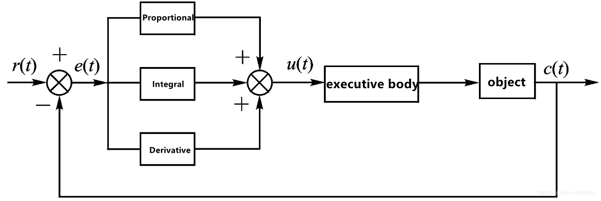

  • PID Algorithm Working Logic
In a closed-loop control system, the output result of the object controlled will be returned to affect the output of the controller so as to generate one or multiple loop. The closed-loop system has positive and negative feedback. If the feedback signal is opposite to the given signal, it is negative feedback. If they are the same, it is positive feedback.

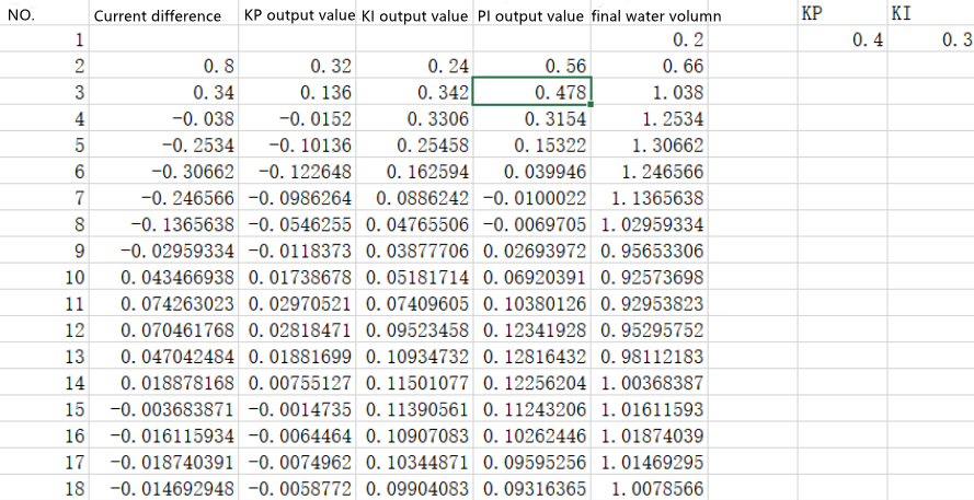

(1) Proportional
Error is the difference between the given value (the set threshold r(t) ) and the measured output (c(t)). After the proportional is introduced, the output of the system is proportional to the error, which can reduce the error quickly and stabilize the system. When the system tends to stabilize, steady-state error will still exist and cannot be eliminated. The control effect of proportional depends on the value of Kp. The smaller the proportional coefficient Kp, the weaker the control and the slower the system response. On the contrary, the larger the proportional coefficient Kp, the stronger the control, and the faster the system response. However, too large Kp will cause the system to generate large overshoot and oscillation. The advantage of proportional control lies in its fast response, but the disadvantage is that there is a steady-state error.

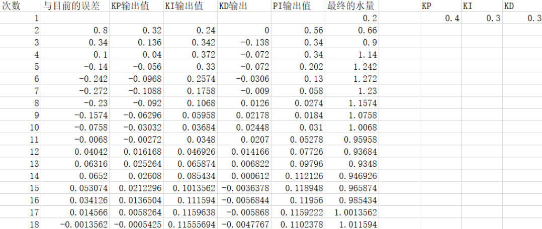

Take a bucket for example. There is a hole at the bottom of the bucket, but you need to maintain the water in the bucket at 1m. And the current water level is 0.2m, and the water will leak 0.1m whenever you add the water. Here, proportional control can be adopted to control the water volume. The current water volume is 0.2m and the target is 1m. Set Kp=0.4. Then u= 0.4*e, and e = last water volume - current water volume
The first error: e(1)=1-0.2=0.8m. Therefore, the volume of the added water is 0.32m (Kp*0.8= 0.4*0.8 = 0.32m), and the current water volume in the bucket is 0.42m (0.2+0.32 -0.1=0.42m)
The second error: e(2) = 1-(0.2+0.32) =0.48m. Therefore, the volume of the added water is 0.192m (Kp*0.48=0.192m), and the current water volume in the bucket is 0.552m (0.52+0.192=0.552)
Lastly, the water level stabilizes at 0.75m, and the error is 0.25m. When you add 0.1m water, the volume of the water added is equivalent to the volume of the water leaking. And this kind of error is called steady-state error.
Steady-state error is defined as the difference between the output under the system tends to stabilize and the target output.

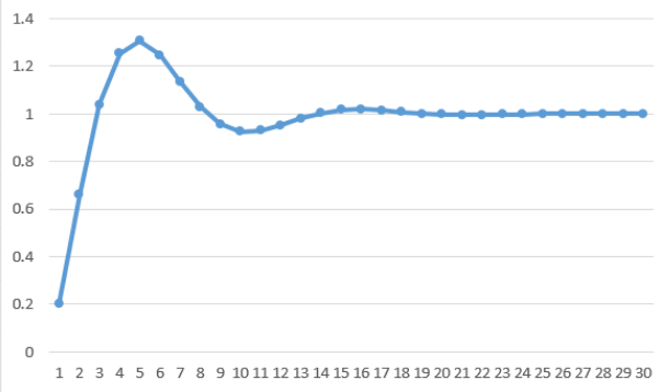

(2) Integral
Integral aims at eliminating the steady-state error. The integral of the error over time is continuously accumulated to keep the output changing so as to reduce the error. If the integral time is sufficient, the steady-state error can be completely eliminated. The smaller Ti is, the stronger the function of integral is. But too strong integral function will make the system overshoot and even oscillate. The advantage of the integral is that the steady-state error can be completely eliminated, but the disadvantage is that the response speed is reduced and the overshoot will be too large.
In the example , the steady-state error still exists after proportional control is adopted. To eliminate it completely, you can add integral control, and set the integral constant Ki as 0.3 (Ki=0.3).
The first error: e(1)=1-0.2=0.8m. Therefore, the volume of the added water is: Kp*0.8= 0.4*0.8 = 0.32m, KI * e(1) = 0.3 * 0.8 = 0.24, and and the final added water is: 0.32m + 0.256 = 0.56. And the current water volume in the bucket is : 0.2+ 0.276 - 0.1=0.66
The second error: e(2)=1-0.66=0.34m. Therefore, the volume of the added water is: Kp*0.34 = 0.4*0.34 = 0.136m, KI * (e(2)+e(1)) = 0.3 * 0.342 = 0.342, and the final added water is: 0.136m + 0.342 = 0.478. And the current water volume in the bucket is : 0.66+ 0.478 - 0.1=1.038
After the Integral control is adopted, the steady-state error is completely eliminated, but overshoot occurs.
(3) Derivative
The slope error can be obtained by differentiating the error, and the slope reflects the change (rate of change) of the error signal, so the error can be adjusted in advance in derivative part. And it takes effect at the moment when the error appears or changes, so as to avoid excessive overshoot and reduce the dynamic error and response time. The larger the derivative coefficient Td, the stronger the ability to suppress the error variation. The advantage of derivative is that it suppress overshoot and speed up the response. The disadvantage is that the anti-interference ability is poor. When the interference signal is strong, it is not recommended to add derivative.
In the above example, the integral effectively eliminates the steady-state error, but overshoot occurs. In order to reduce the overshoot, a derivative control is added. Set Kd as 0.3 (Kd=0.3).
The first error: e(1)=1-0.2=0.8m. Therefore, the volume of the added water is: Kp*0.8 = 0.4*0.8 = 0.32m, KI * e(1) = 0.3 * 0.8 = 0.24. And KD = 0 (because the current water difference is 0.8). The final added water is: 0.32m + 0.256 = 0.56. And the current water volume in the bucket is : 0.2+ 0.276 - 0.1=0.66
The second error: e(2)=1-0.66=0.34m. Therefore, the volume of the added water is: Kp*0.34 = 0.4*0.34 = 0.136m, KI * (e(2)+e(1)) = 0.3 * 0.342 = 0.342. And KD*(e(2) - e(1)) = 0.3*(0.342 - 0.8) = -0.138. The final added water is: 0.136m + 0.342 -0.138 = 0.34. And the current water volume in the bucket is : 0.66+ 0.478 - 0.1=0.9
Compared with proportional control, the overshoot is weakened.
13.2.2 Color Tracking
When the camera identifies the target color block (default is red), the robotic arm moves in sync with the color block’s movement.
  • Program Logic
Firstly, subscribe to the topic messages published by the color recognition node to acquire information about the recognized color.
  • Operation Steps
(2) Double-click to open the command-line terminal.
(3) Execute the command below and hit Enter to terminate the auto-start service.
(4) Enter the command to launch the game program.

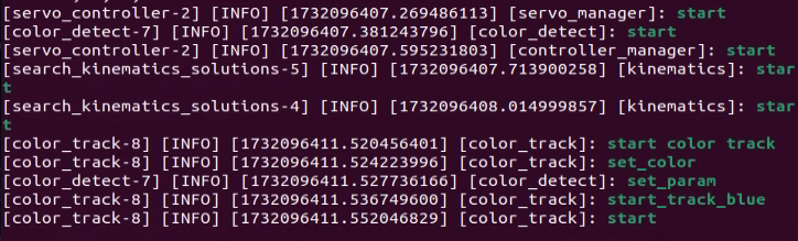

(5) Once the game is initiated, you will see the following message printed in the terminal, and at this point, the camera feed will automatically pop up on the screen.
(6) If you need to terminate the program, please use short-cut ‘Ctrl+C’. If the program fails to stop, please retry.
(7) After running the previous program, you need to restart the app service by executing the following command.
  • Program Outcome
After starting the game, place a red block in front of the robotic arm’s camera. The transmitted image will highlight the recognized target color, and the robotic arm will continuously follow the movement of the target block.
From the above diagram, the program’s logical flow primarily involves processing the acquired image and transmit the live camera feed.

(10) image_callback Function
216
217
218
219
220
221
222
223
224
225
226
227
228
229
230
        # Convert the ros format image to opencv format. 将ros格式图像转换为opencv格式
        with self.lock:
            if not self.thread_started:
                # Start the thread only on the first call. 只在第一次调用时启动线程
                threading.Thread(target=self.image_processing, args=(ros_image,), daemon=True).start()
                self.thread_started = True
        if self.image_queue.full():
            # # Discard the oldest image if the queue is full. 如果队列已满,丢弃最旧的图像
            self.image_queue.get()
        # # Put image into the queue. 将图像放入队列
self.bridge.imgmsg_to_cv2(ros_image, "rgb8"): Use CvBridge to convert the ROS image message (sensor_msgs/msg/Image) into an OpenCV-compatible image format.
np.array(cv_image, dtype=np.uint8): Convert the resulting image data into a NumPy array with data type uint8, which is the standard format for OpenCV image processing.
③ Use self.lock (a thread lock) to ensure thread safety during operations.
self.thread_started is used to mark whether the image processing thread has already been started.
daemon=True indicates that the thread is a daemon thread, meaning it will automatically exit when the main thread terminates.
self.image_queue is a queue.Queue object with a maximum capacity of 2 (set during initialization) used to store image data.
⑦ If the queue is full (self.image_queue.full()), the oldest image in the queue is removed (self.image_queue.get()) to make room.
⑧ The current OpenCV image (rgb_image) is then placed into the queue (self.image_queue.put(rgb_image)) for subsequent processing.

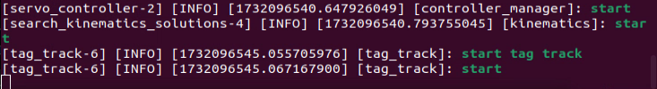

13.2.3 Tag Tracking
When the camera detects the target tag (default: ID2), the robotic arm will follow the movement of the tag.
  • Program Logic
Firstly, subscribe to the topic messages published by the tag tracking node to obtain information about the recognized tag.
Then, upon identifying the target tag, retrieve the central position of the tag image.
Finally, use inverse kinematics to calculate the angles required to align the center of the screen with the center of the target image. Publish the corresponding topic messages to control servo rotation, enabling the robotic arm to follow the target movement.
  • Operation Steps
(4) Execute the command to run the game program.
ros2 launch example tag_track_node.launch.py
(5) After initiating the game, the terminal will display the following message, and the live camera feed will start automatically.
(6) If you need to terminate the game, press ‘Ctrl+C’. If the program cannot be stopped, please retry.
  • Program Outcome
After starting the mode, place the ID1 tag in front of the robotic arm’s camera. The detected tag ID will be displayed in the returned image, and the robotic arm will continuously follow the movement of the ID1 tag.

The program’s logical flowchart is illustrated in the diagram obtained by organizing information from the source files.
The main logic flow of the program involves processing the captured images and displaying the live feed.

        self.get_logger().info('\033[1;32m%s\033[0m' % "start tag track")
        self.start = True
        response.success = True
        response.message = "start"
        return response
    def stop_srv_callback(self, request, response):
        self.get_logger().info('\033[1;32m%s\033[0m' % "stop tag track")
        self.start = False
        res = self.send_request(ColorDetect.Request())
        if res.success:
            self.get_logger().info('\033[1;32m%s\033[0m' % 'set tag success')
            self.get_logger().info('\033[1;32m%s\033[0m' % 'set tag fail')
        response.message = "stop"
        return response
self.get_logger().info("start tag track"): Log output indicating the start of tag tracking.
self.start = True: Set the tag tracking status to True to indicate it has started.
response.success = True: Set the response success flag to True.
response.message = "start": Set the response message to “start”.
self.get_logger().info("stop tag track"): Log output indicating the stop of tag tracking.
self.start = False: Set the tag tracking status to False to indicate it has stopped.
res = self.send_request(ColorDetect.Request()): Send a request to stop color detection.
if res.success:: If the stop request is successful, log the result.
response.message = "stop": Set the response message to “stop”.

(4) Run the command below to initiate the game program.
ros2 launch example kcf_track_node.launch.py
(5) After initializing the game, you will observe the following prompt messages in the terminal, and at this point, the live camera feed will automatically appear.
(6) If you need to terminate the game, press 'Ctrl+C'. If the program cannot be stopped, please retry.
(7) After running the previous program, you need to restart the app service by executing the command below.

After starting the tracking feature, place the object to be tracked in front of the camera. Press the ‘S’ key in the video feed window, then use the left mouse button to draw a selection box around the object. Finally, press Enter. The robotic arm will continuously follow the selected object. (Note: The object should not move too quickly. If the object is lost, simply press ‘S’ again and re-select the object.)

  • Python Source Code Analysis
The Python source code file is saved in
/home/ubuntu/ros2_ws/src/example/example/opencv/include/kcf_tracking.py
The program flowchart is as pictured below:
