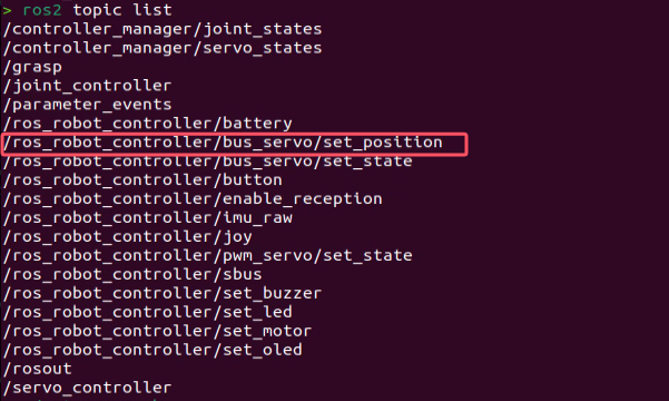

(3) Open a new terminal and run the command to display the topics published after the initiation of the robot arm node.
ros2 topic list

ros2 topic pub /ros_robot_controller/bus_servo/set_position ros_robot_controller_msgs/msg/ServosPosition '{"position": [{"id": 1, "position": 700}]}'

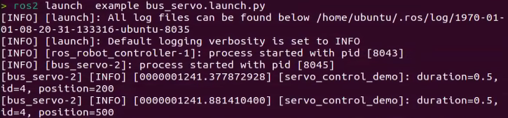

  • Launch File Control
(1) In the window where the robotic arm SDK file is running, press Ctrl+C to stop the launch file.
(2) Next, enter the command to start servo control (the bus_servo_node.py file is called in the launch file).
ros2 launch example bus_servo.launch.py
(3) After starting the example, you will see the robotic arm’s Servo 4 rotating back and forth between angles 200 and 500, and the terminal will display the servo topic information.
(4) If you want to terminate the game, use short-cut ‘Ctrl+C’. If the game cannot be stopped, please have a retry.

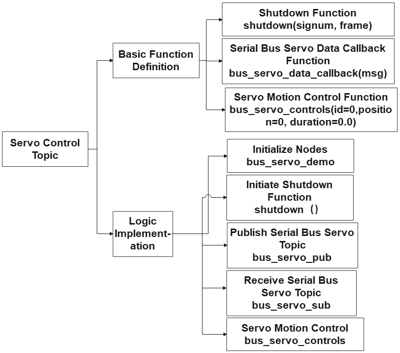

The program logic flowchart is as below:
The diagram above illustrates the main structure of the program’s logic flow, highlighting the division into basic function definitions and implementation logic. Initially, the necessary functions for servo control are established. In the main function, nodes are initialized, interrupt functions are activated to detect signals, and relevant bus servo topics are both published and received. This information is then relayed to the servo control function, enabling effective servo control. The upcoming document will follow the structure outlined in the program’s logic flowchart above.

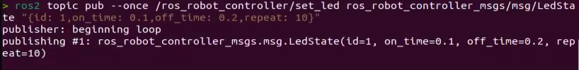

11.2.2 Control LED Through Topic
  • Terminal Control
(1)Open a new terminal, and execute the following command.
ros2 topic pub --once /ros_robot_controller/set_led ros_robot_controller_msgs/msg/LedState "{id: 1,on_time: 0.1,off_time: 0.2,repeat: 10}"
The following four parameters can be obtained:
brightness: LED ID. The ID of the LED on the STM32 controller is 1.
on_ticks: The duration of LED illumination, measured in milliseconds.
0ff_ticks: the duration of LED off time, measured in milliseconds.
repeat: the cycle number of LED on and off.
(2)After the parameters are set, hit Enter key to run the program.
(3)When the program completes running, press ‘Ctrl+C’ to exit. If the program cannot be stopped, you may need to retry.

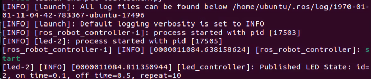

(2) Run the command to initiate the game. The LED on STM32 controller will flicker ten times then go off. The following parameter settings will be printed on the terminal.
python3 ~/ros2_ws/src/example/example/simple/include/led_node.py

ros2 launch example led.launch.py
(3) After the game starts, the LED on the STM32 controller will flicker 10 times then go off. The terminal will print the following parameter settings.

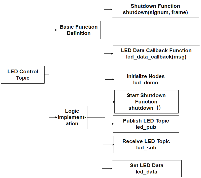

The program’s logic flow, as illustrated above, is mainly categorized into basic function definitions and implementation logic. Initially, the functions required for LED control are defined. Subsequently, within the main function, nodes are initialized, interrupt functions are activated to detect interrupt signals, and relevant topics for the LED are both published and received. The control of the LED is accomplished by configuring parameters related to LED information. The forthcoming document will adhere to the program’s logic flowchart outlined above.

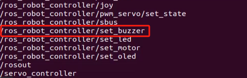

ros2 topic list
Topic Function
/ros_robot_controller/set_buzzer Control buzzer to turn on or off

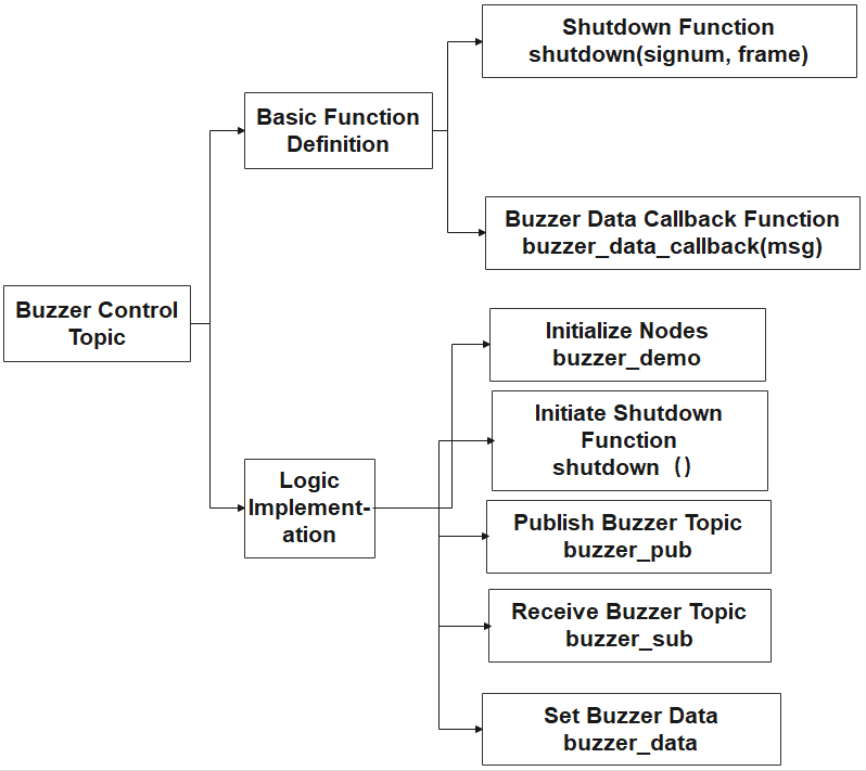

  • Program Analysis
The source code is saved in /home/ubuntu/ros2_ws/src/example/example/simple/include/buzzer_node.py
The program logic flowchart is depicted as below:
From the diagram above, the program’s logic flow is primarily divided into basic function definitions and implementation logic. First, the functions needed to control the buzzer are defined. Then, in the main function, nodes are initialized, interrupt functions are activated to detect interrupt signals, relevant topics for the buzzer are published and received. Buzzer control is then achieved by configuring parameters related to the buzzer information. The content of the following document will be written following the aforementioned program logic flowchart.
