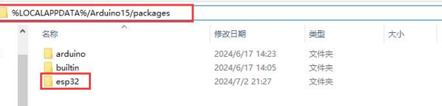

(1) If you installed other versions of ESP32 Package, please delete it before proceeding.
(2) Deletion method: enter “%LOCALAPPDATA%/Ard ui no15/packages” in the file manager’s address bar, and then press “Enter” to navigate the package, and delete the esp32 folder inside.

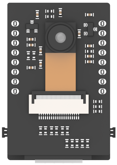

8.2 Introduction to ESP32S3-Cam Vision Module
8.2.1 ESP32S3-Cam Introduction
ESP32-CAM is a small-size camera module that can operate independently as the smallest system. Its is an ideal solution for IoT applications, which is widely applicable in scenarios such as whole-house smart connection, industrial control, smart agriculture, and more. It enables rapid development of solutions, providing users with highly reliable connectivity, and facilitating integration with various hardware terminal devices.

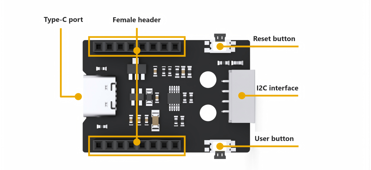

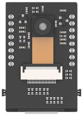

8.2.2 ESP32S3-Cam Expansion Board
Interface Instruction:
Interface Name Instruction
Type C serial port Serial communication, firmware burning
Female connector Connect to ESP32-Cam module
Reset button Press to restart the program
IIC interface Secondary development interface, connecting with the main control.
User button User customized extension development

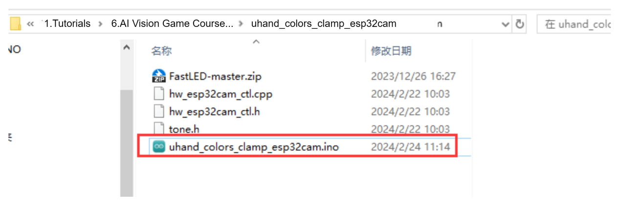

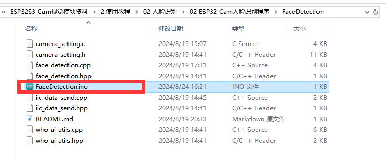

(1) Open any program in the path of the “8. AI Vision Game Course”. Take “8.5 Color Sorting” as an example.
(2) In the program, select “hw_esp32cam_ctl.cpp”.

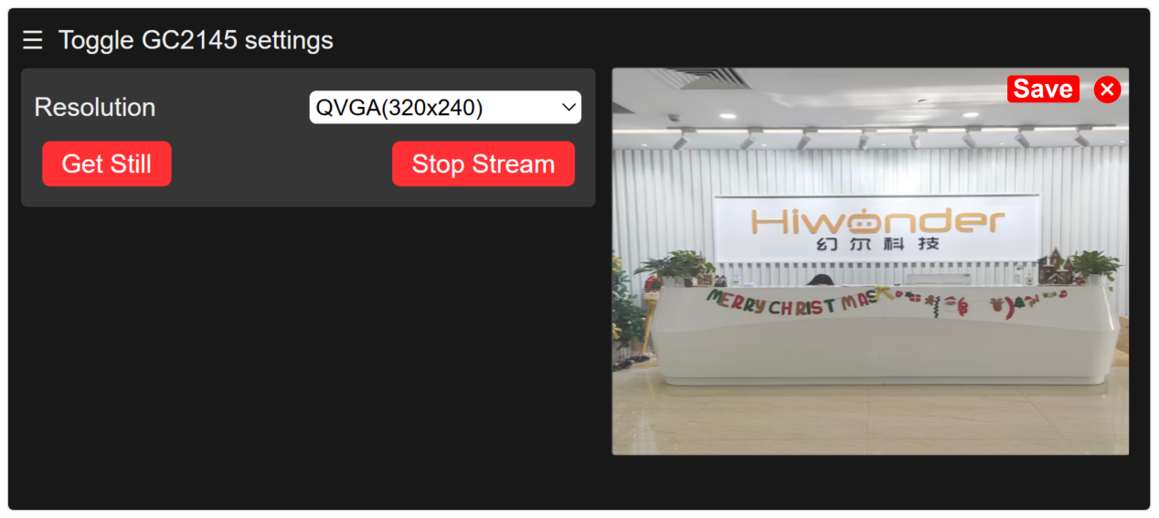

8.4 Live Camera Feed
In this section, you can learn how to connect to the hotspot generated by the ESP32S3-Cam, and then log into a provided URL to view the live camera feed.
Note: if you are unable to use the live camera feed function or have downloaded other program firmwares, please reflash the image transmission firmware. This allows you to use the live camera feed function.
To download the firmware, please refer to “8.4.2 Image Postback Firmware Flashing (Optional)” .
8.4.1 ESP32S3-Cam Camera Connection
  • Connection Modes Introduction
ESP32S3-Cam has two kinds of network modes as follows:
① AP direct connection mode: the development board can open the hotspot to connect with the phone, but it cannot connect to an external network.
② STA LAN mode: the development board can actively connect to a designated hotspot or Wi-Fi, enabling communication with an external network.
The AP direct connection mode is more convenient to operate. We recommend you to first learn the configuration method of the direct connection mode to experience the corresponding functions. The STA LAN mode can be selected according to your needs.
No matter which kind of mode you choose, the game function is the same.
  • Direct Mode Connection (Must Read)
(1) Make sure the camera is connected to the I2C interface on the expansion board and turn the robotic hand on.

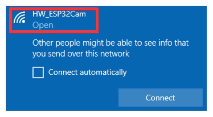

(2) The camera will generate a hotspot named “HW_ESP32Cam”. Click to connect.
(3) After the connection is completed, enter the address “192.168.5.1” in the browser and click to enter the camera transmission interface.

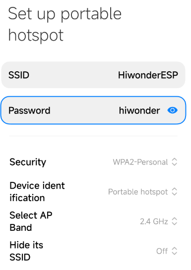

(1) Turn on your phone’s hotspot and set the name as “HiwonderESP” and the password as “Hiwonder”. Note: the name and password of the hotspot should be same as of this text, otherwise the connection won’t succeed.

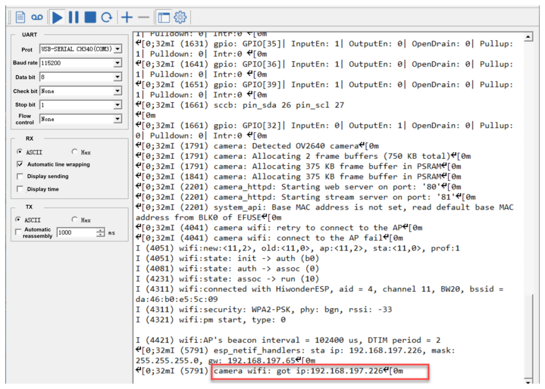

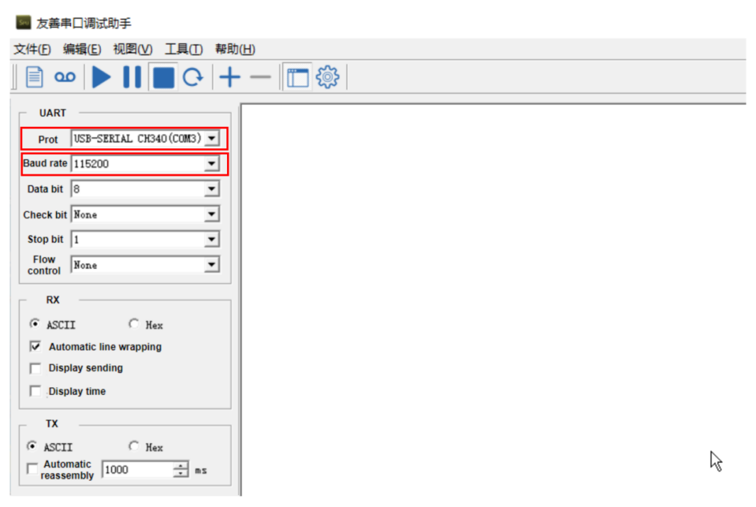

(4) Open the serial port utility tool in the path of “Appendix->erial Port Utility”.
(5) Select a port. Take COM3 as example. The port number may vary. Do not choose COM1 which is the system communication port. Set the baudrate as “115200”.
(6) Click at the upper left of the page to open the serial port communication. Press the “RST” button on the ESP32S3-Cam and scroll down to the last line to check your camera’s IP address “192.168.197.226”. The IP address may vary, please refer to the actual address.

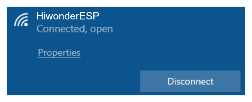

(7) At this time, you can disconnect the Type-C cable and connect the computer to the same hotspot as the camera.
(8) In the browser’s research bar, enter the IP address of the camera “192.168.197.226” to access the feedback interface.

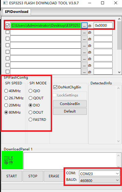

(1) Open the “flash_download_tool_3.9.7” file.
(2) Select the “Chip Type” as “ESP32-S3”, and keep others unchanged. Click “OK”.

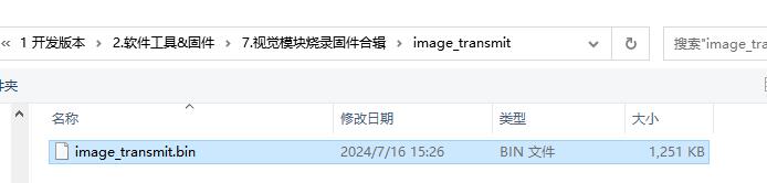

(3) After opening the tool, click “” to select the bin file of the program to be flashed. Take the following live camera feed function firmware as an example:
(4) Check the left side box, the rest of the configuration can be configured as shown below. Select the port number of the vision module occupied in the device as the COM port number .
If you set SPI MODE to DIO as shown in the figure below, and the module cannot work properly after the firmware is flashed, please try setting SPI MODE to DOUT and flashing again.
(5) Click “ERASE” to erase the underlayer firmware. You must do this step first. Next, click “START” to start flash. Then, wait for the download to be completed.

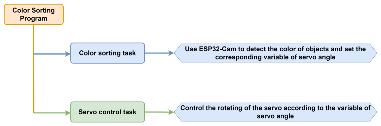

8.5.1 Program Flowchart

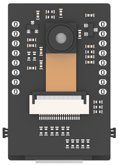

ESP32S3-Cam development board integrates an ESP32 chip and a camera module. After being inserted into the expansion board, it uses the I2C communication interface to read color and face data through I2C communication.
  • Wiring
Align the pins of ESP32S3-Cam with the pin headers on the camera expansion board, and connect it to an I2C interface on the miniArm expansion board with a 4PIN wire.

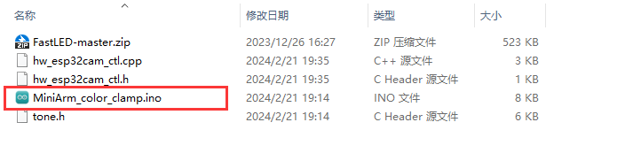

(1) Locate and open the “MiniArm_color_clamp/MiniArm_color_clamp.ino” program file in the same directory as this section.

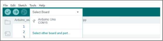

(3) Click “Select Development Board”, and the software will automatically detect the current Arduino serial port. Next, click to connect.

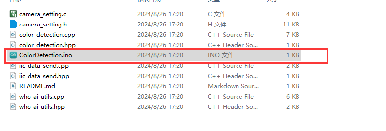

(2) Locate and open the “ColorDetection/ColorDetection.ino” program file.

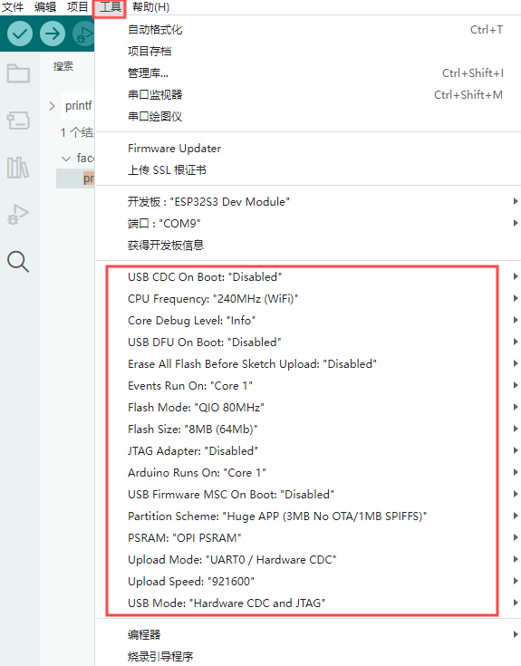

(4) Click the “Tool” in the menu bar, and select the corresponding configuration for the ESP32S3 development board.
(5) Click to download the program to the ESP32S3-Cam, and then wait for the download to complete.

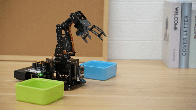

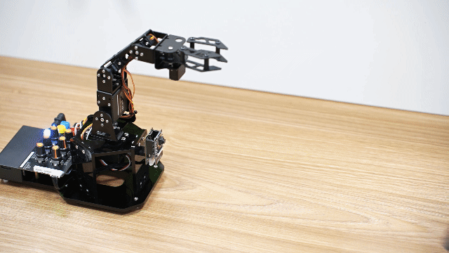

(1) After being powered on, the robotic arm enters the initial position of grasping, and the RGB light on the expansion board lights up blue.
(2) When a blue block is identified, the RGB lights up blue. The robotic arm grasps the block and places it to the left.
(3) When a green block is identified, the RGB lights up green. The robotic arm grasps the block and places it to the right.

After finishing the initialization, it enters the loop main function. First, call the espcam_task function which is used to detect color identification and perform grasp and placement. Then, call the tune_task function to execute buzzer task. Next, call the servo_control function to control servos. Finally, call the action_task() to execute the action group.
81
82
83
84
85
86
87
88
89
90
void loop() {
  // esp32cam communication task
  espcam_task();
  // buzzer sound task
  tune_task();
  // servo control
  servo_control();
  // action group running task
  action_ctl.action_task();
  • ESP32S3-Cam Communication Task

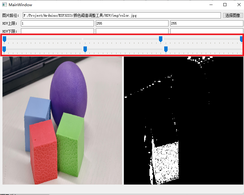

8.5.6 Function Extension
How to modify the recognized color of ESP32S3-Cam? You can refer to the following steps:
(1) Locate and open the “ESP32S3-Cam Color Recognition program\HSV\HSV.dist\HSV.exe” program file in the same path as this lesson.
(2) Select the image file to be imported. The imported image needs to be stored in the “img” folder.
(3) Drag the slider to segment the image with HSV threshold, and adjust it to the appropriate HSV threshold range. You can refer to the following color range table.
Image stretching due to resolution does not affect threshold debugging.
(4) Save the HSV threshold. Locate and open the “ESP32S3-Cam Color Recognition Program/ColorDetection/color_detection.cpp” file in the same path as this lesson. Modify the color data to the saved HSV array. Next, refer to “8.5.3 Program Download -> ESP32S3-Cam Program Download” to flash the modified program into ESP32S3-Cam.
The elements of the array are separated with commas.
(5) Once the flashing is completed, the ESP32S3-Cam can recognize the object with other colors.

  • ESP32S3-Cam Program Download
ESP32Cam_color_trace
(1) Connect the ESP32S3-Cam to the computer with a Type-C data cable.
(2) Locate and open the “ColorDetection\ColorDetection.ino” program file in the same directory as this section.
(3) Select the “ESP32S3 Dev Module” development board.

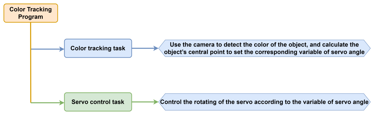

8.6.4 Program Outcome
(1) After the robotic arm is powered on, its pan-tilt returns to the initial position, and the RGB light on the expansion board lights up blue.
(2) When you place the blue block in front of the ESP32S3-Cam camera and move it left and right, the robotic arm’s pan-tilt tracks its movement turning left and right accordingly.
8.6.5 Brief Program Analysis

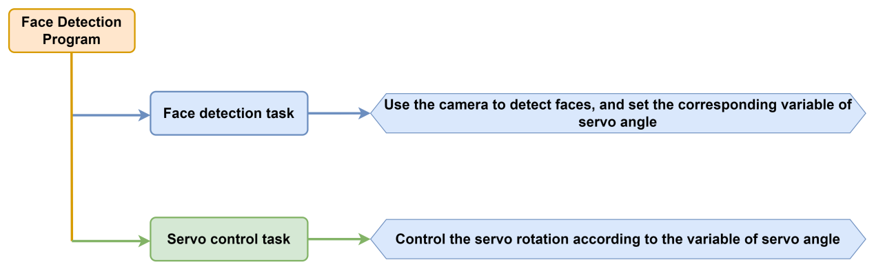

8.7.1 Program Flowchart
8.7.2 ESP32S3-Cam Development Board
  • Wiring

  • Arduino UNO Program Download
MiniArm_face_hello
(1) Locate and open the “MiniArm_face_hello\MiniArm_face_hello.ino” program file in the same directory as this section.
(2) Connect Arduino to the computer with the UNO cable (Type-B).
(4) Click to download the program into Arduino. Then just wait for it to complete.
  • ESP32S3-Cam Firmware Flashing
Face Detection
(2) Locate and open the “ESP32S3-Cam Face Detection Program/FaceDetection/FaceDetection.ino” program file in the same directory as this section.

  • Call Subfunction in a Loop
After finishing the initialization, it enters the loop main function. First, call the espcam_task function which is used to detect face identification and perform the waving action. Then, call the servo_control function to control servos.
void loop() {
  // esp32cam通讯任务(ESP32S3-Cam communication task)
  espcam_task();
  // 舵机控制任务(servo control task)
  servo_control();
