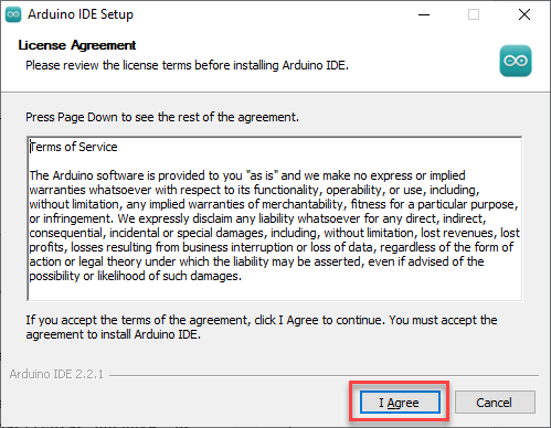

(2) Click “I Agree” to install.

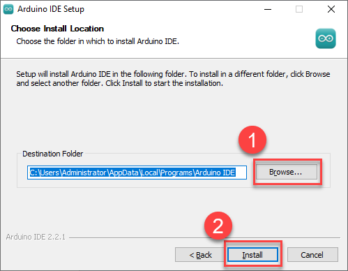

(4) Click “Browse” to choose the installation path, and then click “Install”.
(5) Wait for the installation to complete.

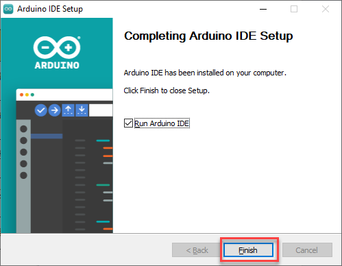

(6) After the installation is complete, click “Finish”.

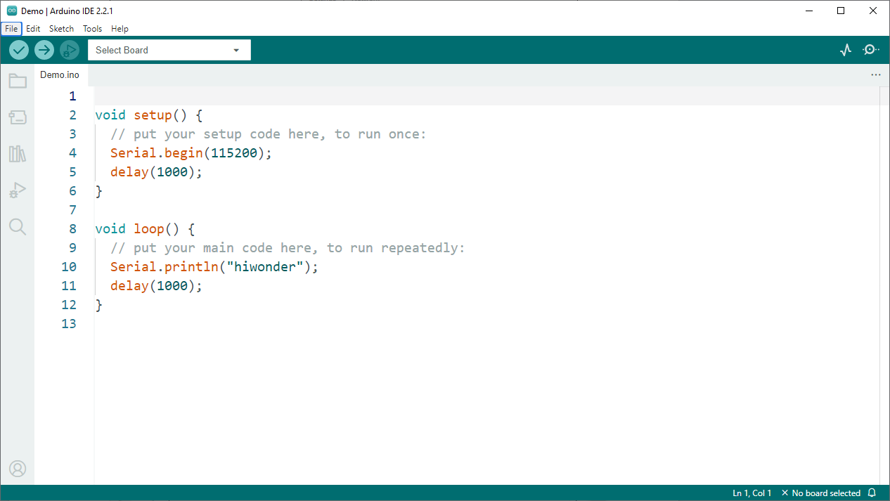

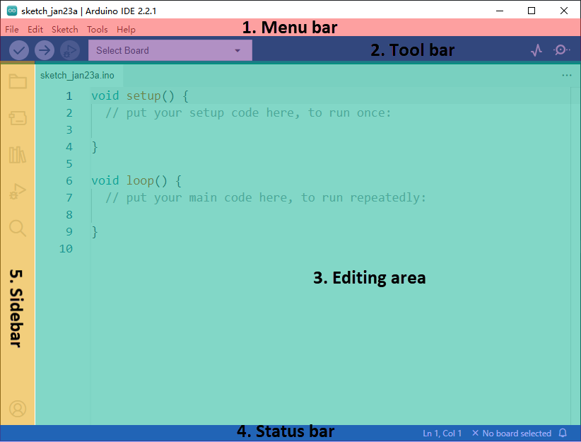

The main interface of Arduino IDE consists of 5 workplaces:
(1) Menu bar: it is responsible for Arduino IDE-related settings.
| Icon | Function |
Create or open a project file, and customize preferences for the main interface. |
Perform text editing such as commenting, indenting or searching for code. |
Configure the entire project, including compiling, running, and adding the library files. |
Select the development board and port, as well as obtain the board information. |
Assist users with getting ready and offer solutions to common issues. |
(2) Tool bar: some tools related to the project, including program compilation, programs download, serial monitor, etc.
| Icon | Function |
Verification. Check if a program is written without errors. If it is fully correct, the compilation process will activate. |
Download the program to the control board. |
Debugging. Some development can be debugged through Arduino IDE in real time. |
Select different boards for different development projects. |
Serial plotter, which can plot data printed to the Arduino serial port into graph. |
Serial monitor, printing serial port information. |
(3) Editing area: the area for editing code.
(4) Status bar: display the status of the current editor, such as the line and column of code, information about the development board, etc.
(5) Sidebar: the core of Arduino IDE is in charge of displaying the working folders, code debugging, library file installation, etc.

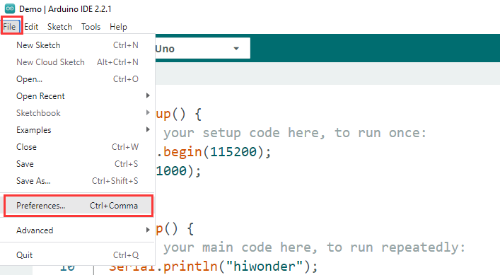

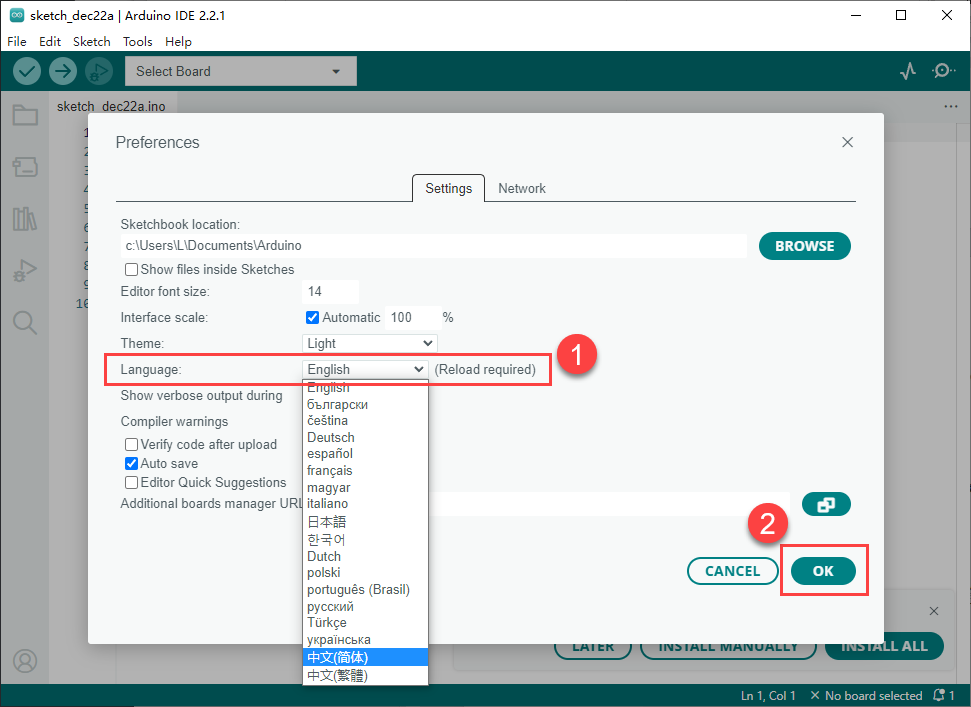

(1) Modify the Chinese interface: select “File -> Preferences” on the Arduino IDE interface. Then, choose Chinese from the “Language”, and click “OK”.
(2) You can modify the project file path, editor text size, color themes, etc by selecting “File -> Preferences” in the pop-up window.

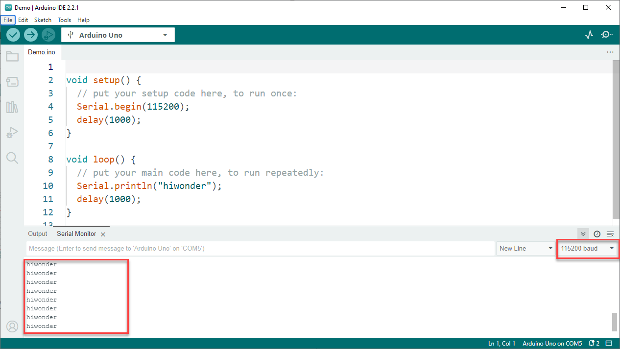

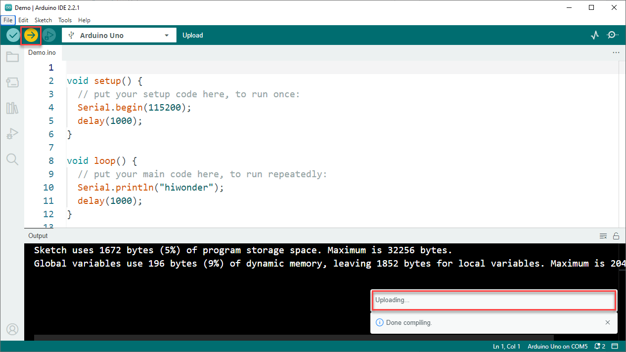

(1) In this case, we will use an example that prints “Hiwonder” to illustrate. Open the example program Demo.ino .
(2) Connect Arduino board to the computer using Type-B cable.

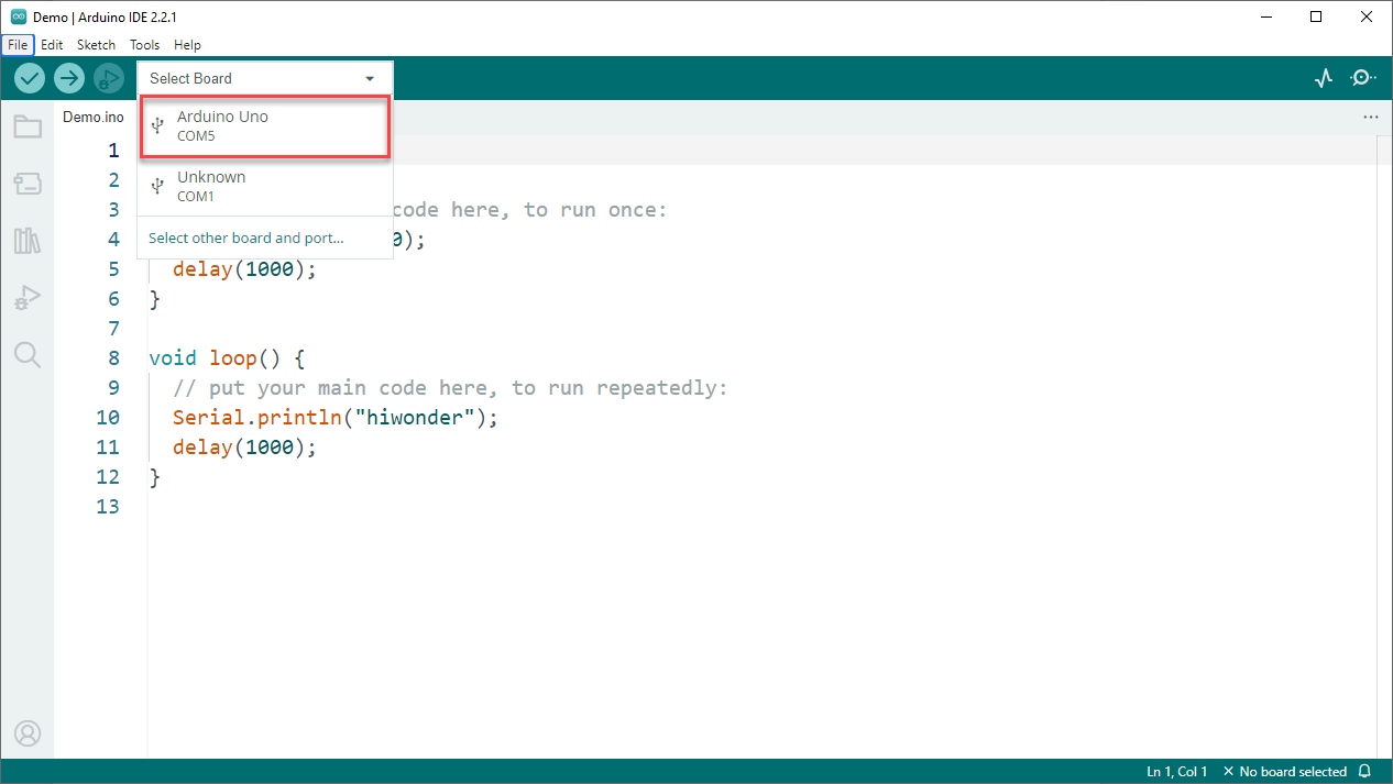

(3) In the “Select board” option, find the corresponding Arduino development board. (Take “Arduino Uno” and “COM5” as en example to demonstrate. The COM port is not unique. You can can check the COM port number in the computer’s device manager. )

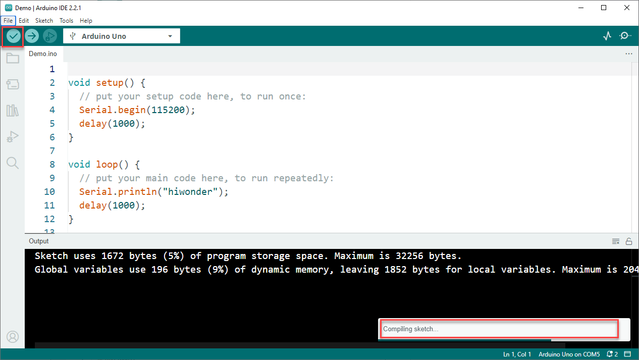

(4) Click
button to compile the program, which can check if the program has syntax errors and other issues.
(5) After the compilation is complete, click
to upload the program into the Arduino development board.
(6) When the upload is done, click
to open the serial monitor. The word “hiwonder” is printed on the serial monitor.

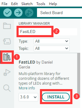

(1) Click
at the sidebar of Arduino IDE interface.
(2) In the pop-up library management bar, enter “FastLED” to automatically search for the library files, then click “install”.
(3) The prompt shown in the red box indicates the successful installation.

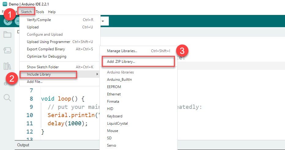

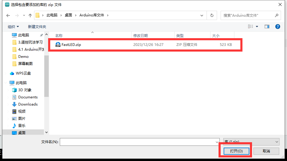

(1) Select “Sketch -> Include library -> Add .ZIP library”.
(2) Search for the “FastLED.zip” file and open it.

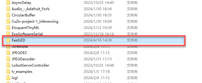

Take the library file “FastLED” as example to illustrate. In Arduino IDE versions 1.8.5 and above, the error above may arise when importing this library file. You can solve this problem by extracting the library file and placing it directly into the ‘libraries’ folder in the path of the project. The specific solution is as follows:
(1) At first, extract the library file “FastLED”.
(2) Click “File->Preferences” in sequence.

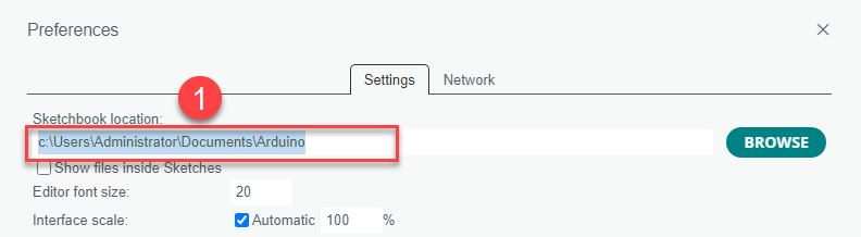

(3) In the opening preferences, copy the path.

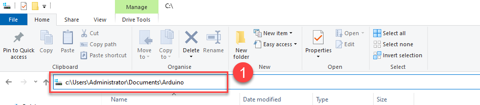

(4) Paste it in my computer, and then press “Enter” to access the path.
(5) Place the previously extracted library file into the “libraries” folder.
(6) Restart Arduino IDE. The library file has been located in the library of Arduino IDE.
