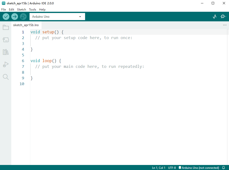

(1) Double click to open it.
(2) Connect the Arduino to the computer with a Type-B cable.

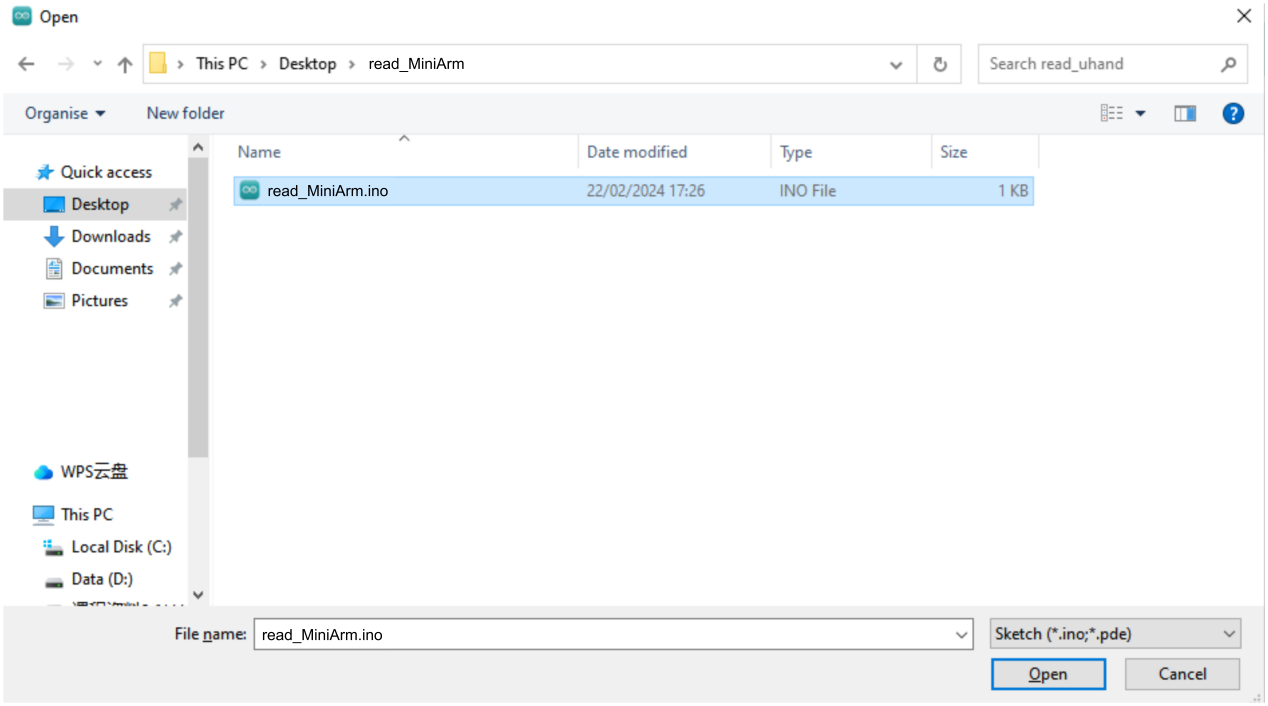

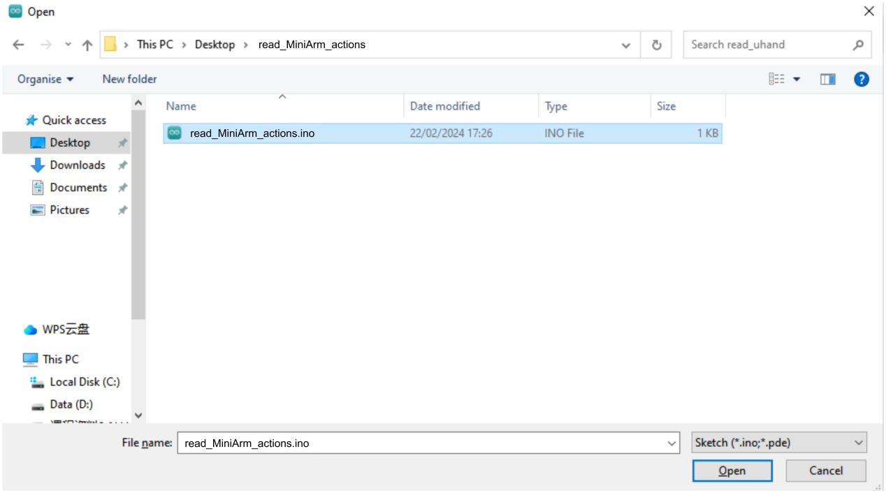

(3) Click “File -> Open”.
(4) Access “Read Action Data Program”. Select “read_mini.ino” program in “read_mini” folder and click “Open”.

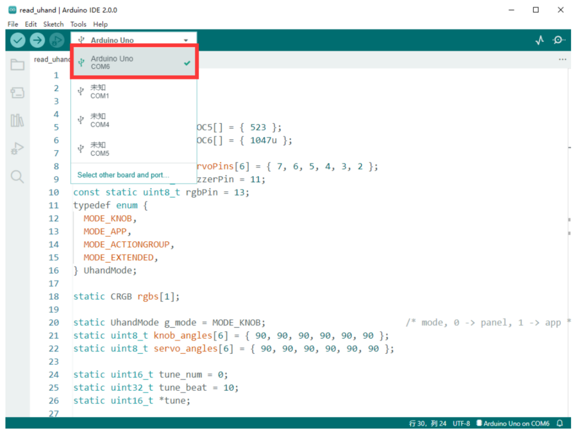

(5) Locate Arduino development board in “Select Board”. (Take Arduino Uno as an example. COM ports are not unique, and their numbers can be checked in computer’s device management. Take COM6 as an example.)

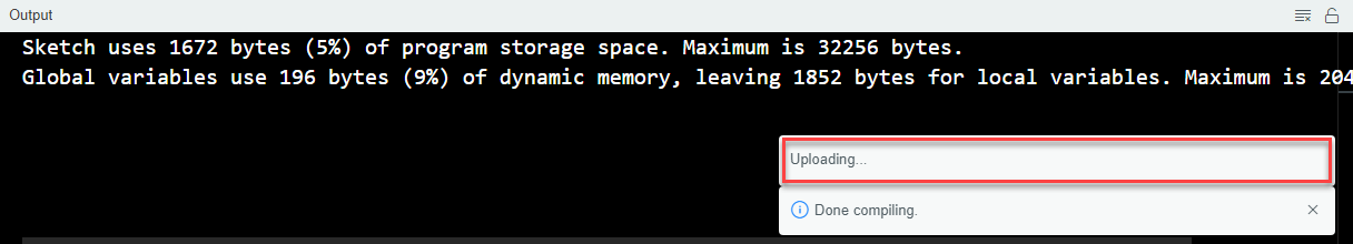

(6) After confirming that everything is correct, click to verify the program. If the program is correct, the status area shows “Compiling Project -> Completed” in turn. Then it displays the number of bytes used by the current project, the program storage space and etc.
(7) After successful compilation, click to upload the program to the development board. The status area shows “Compiling Project-> Uploading-> Upload successfully” in turn. After that, the status area stops printing and uploading information.

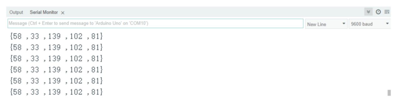

(1) Please keep the Type-B connected to the computer. (Do not plug off the cable during the process to ensure communication.)

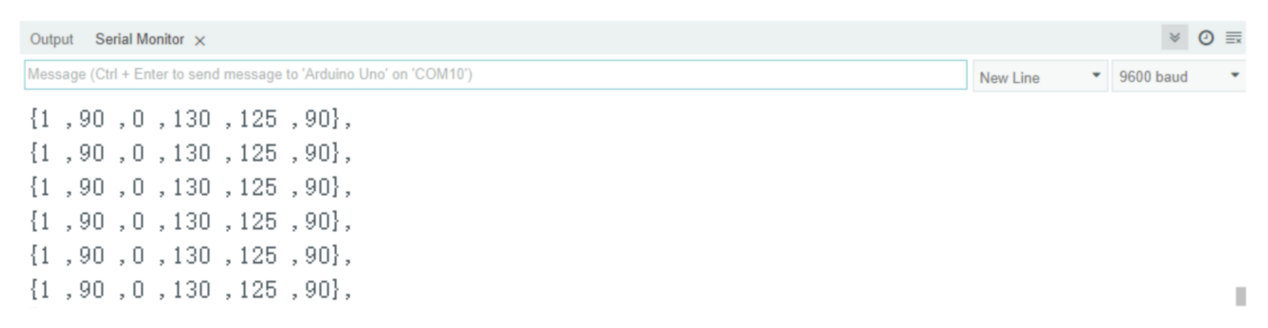

(2) Press “Ctrl+Shift+M” to open the serial port monitor to check real-time angle data of servos No.1 to No.5.
(3) By rotating the knobs (S1 to S5) on MiniArm, you can adjust the corresponding angles of servos. And then save the action data.

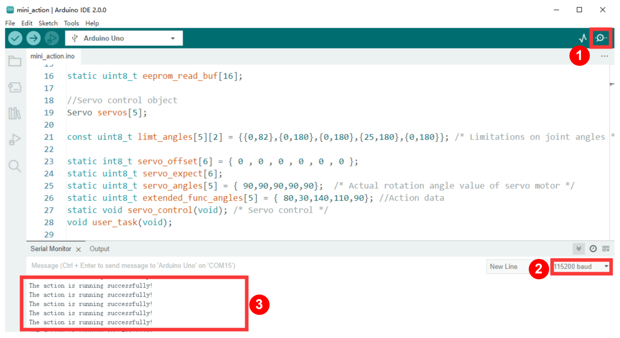

Power the robotic arm on and keep the Type-B connected to the computer. Open the serial port monitor to select the baud rate as “115200”.
Once the action is completed, the serial port monitor will display “The action is running successfully!”, indicating successful execution of the action.
(4) Access “Read Action Data Program”. Select “read_mini_actions.ino” program in “read_mini_actions” folder and click “Open”.

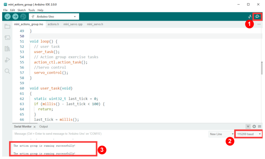

(1) Keep the Type-B cable connected to the computer. Do not unplug it, as it will hinder communication.
(2) Press “Ctrl+Shift+M” to open the serial monitor to view real-time servo data. The data corresponds to the angles of servos 1 to 5 respectively. The 0th bit in the data tells whether the current action group is a valid data or not. “1” is a valid data, which is used to determine if the action is successfully executed during action execution.
(3) Rotate the knobs S1 to S5 on the miniArm to adjust the current rotation angles of the servos. And then save these actions in series to create a new action group.

Power on the robotic arm. Keep the Type-B cable connected to the computer. Turn on the serial monitor, and select a baud rate of “115200”.
Once the action group is completed, the serial port monitor displays “The action group is running successfully!”, indicating successful execution of the action group.
