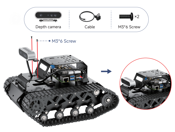

8.1 Install Depth Camera
If the camera module included with your MentorPi system is a monocular type, please consult the following installation procedures for implementation.
Interface indication:

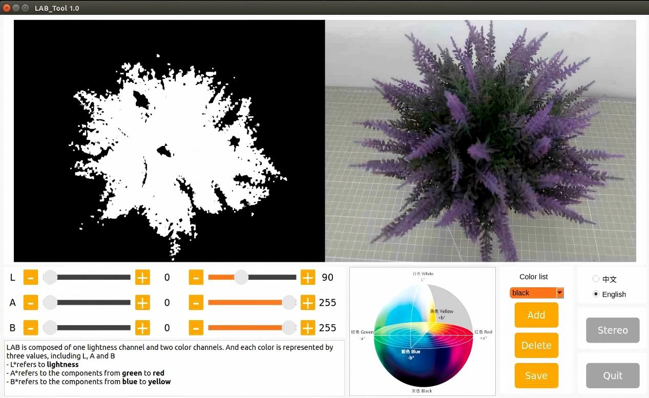

(3) After entering the software, you can see the interface of LAB_Tool, as shown in the figure below:
If the live feed camera does not appear in the pop-up interface, it means that the camera is not connected successfully. Please check if the camera connection cable is properly connected.
(4) Image display area: the left displays the processed image and the right is the raw image.
If the transmitted image does not display normally, it’s the issue of camera connection. In this case, you need to examine if the wiring is connected properly or reconnect it.

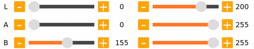

(5) Recognition adjustment area: adjust the color threshold. The function of each button refer to the following table:
Icon Function instruction
The sliders L, A and B are used respectively to adjust the values of the corresponding L, A and B components of the image.
The sliders on the left are the "min" value for each component while the slider on the right are the "max" value for each component.
Add recognizable color.
Click this button to switch between Chinese and English.
Close LAB TOOL.

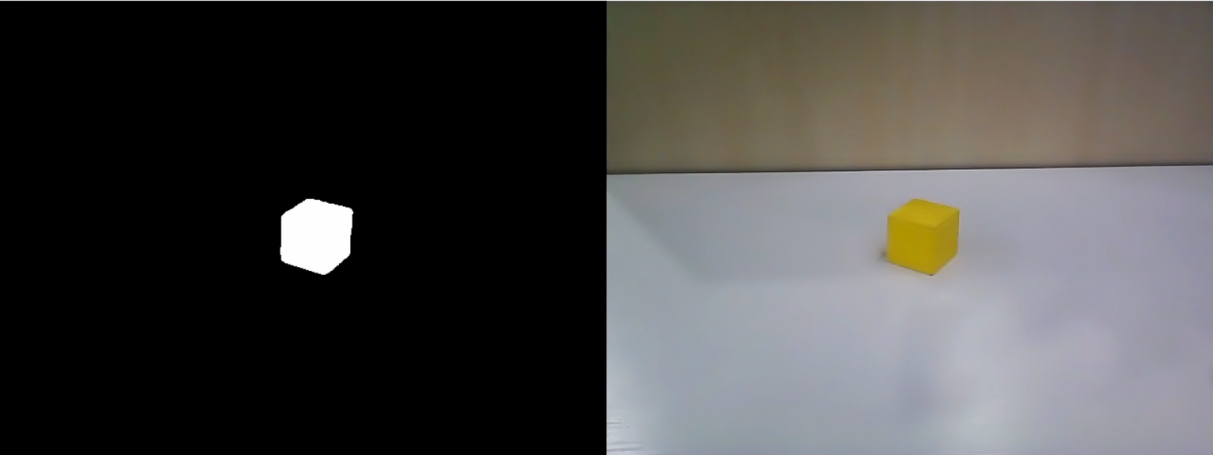

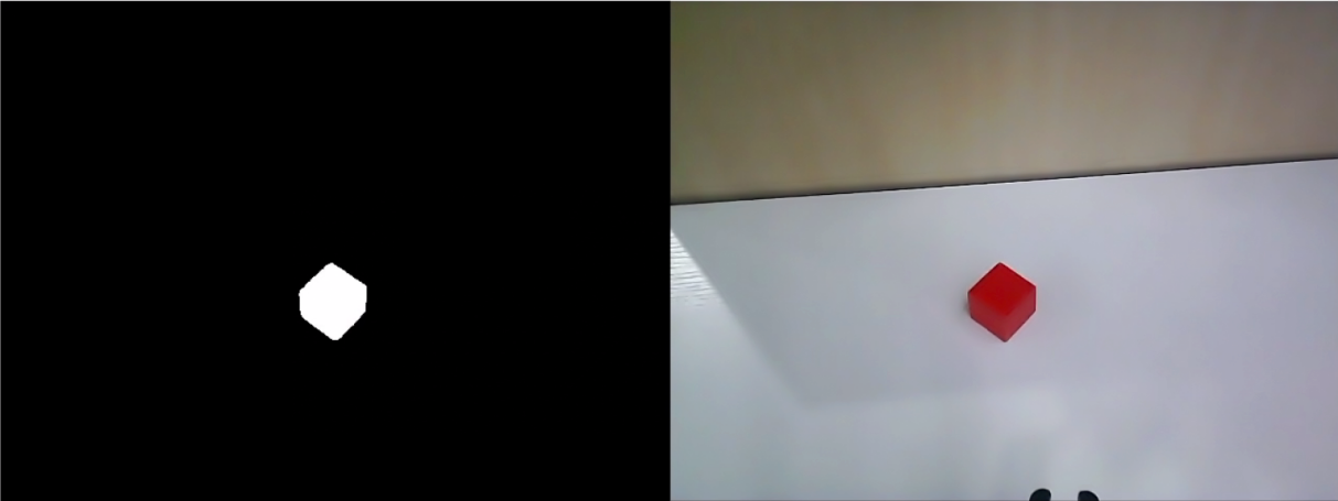

8.2.2 Adjust Color Threshold

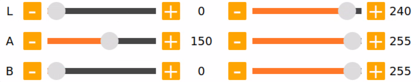

(1) Open LAN tool. Choose the color in the color drop-down list of color recognition area. Take a color “red” as example.
(2) Adjust the “min” values of L, A and B components to “0”, and the “max” values to “225”.
(3) Place the target within the camera’s field of view. Adjust the values of L, A and B component towards the interval representing the target recognition color according to the LAB color space distribution chart.
(4) Adjust the L and B components according to your surroundings. If the red color is light, increase the “min” value of the L component; if it is dark, decrease the “max” value of the component. If the red color tends to be warm, increase the “min” value of the B component; if it tends to be cool, decrease the “max” value of the B component.
L 0~255 Black-white (-L~+L)
A 0~255 green-red(-a ~ +a)
B 0~255 Blue-yellow(-b ~ +b)
(5) Click “Save” button in adjustment area to save the adjustment parameters.

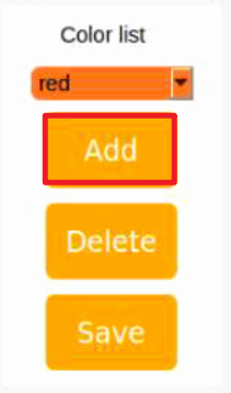

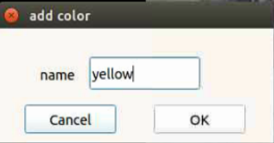

8.2.3 Add New Color
(1) Open LAB tool and click on “Add” button.
(2) Fill in the “name” column with the color name, and click the “OK” button.

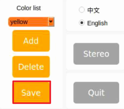

(3) Choose the added color in the color drop-down menu.
(4) Place the target within the camera’s field of view, and adjust the threshold by dragging the L, A, and B component sliders until the area of the colored object within the left screen turns white, while the other areas turn black.
the adjustment method of color threshold refers to “8.2.2 Adjust Color Threshold”.
(5) Click “Save” button in recognition adjustment area to save the adjustment parameters of color threshold.

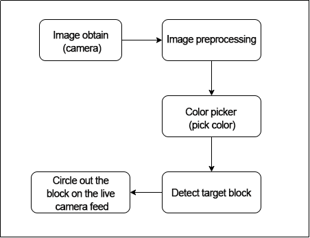

8.3.1 Recognition Process
Firstly, obtain the RGB image from the camera. Scale and apply Gaussian blur to the image. Convert the image from RGB to Lab. (For detailed explanations regarding the Lab color space, you can refer to OpenCV Basic Lesson.)
Next, identify the object color in the circle by using color thresholds, followed by masking of the image portion. (Masking is used to hide certain part of the processed image).
Finally, the recognition results are displayed on the live camera feed.

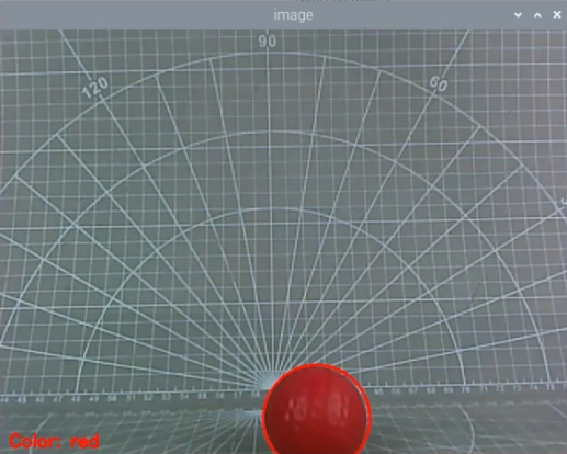

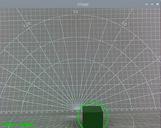

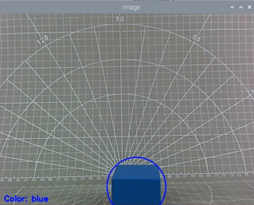

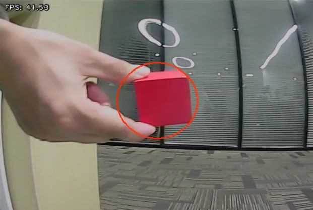

8.3.3 Program Outcome
After the game starts, please ensure that there are no other objects containing recognized colors within the field of view of the camera to avoid affecting the implementation effect.
After the game starts, place the target object within the field of view of the camera. When the target object is recognized, it will be circled up in the same color and the color name will be printed in the lower-left corner of the screen. The program supports red, blue and green object recognition.

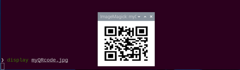

(1) After start the program, it’s necessary to enter characters in the terminal to generate the QR code. Take the input of “hiwonder” as example.
hiwonder
(2) Press “Enter” to display a QR code image containing the input data.
(3) If need to close the program, press “Ctrl+C” in the terminal. If this fails, please try multiple times.
(4) After closing the window, the saved content and its path are printed.

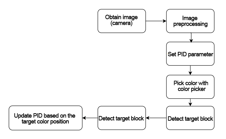

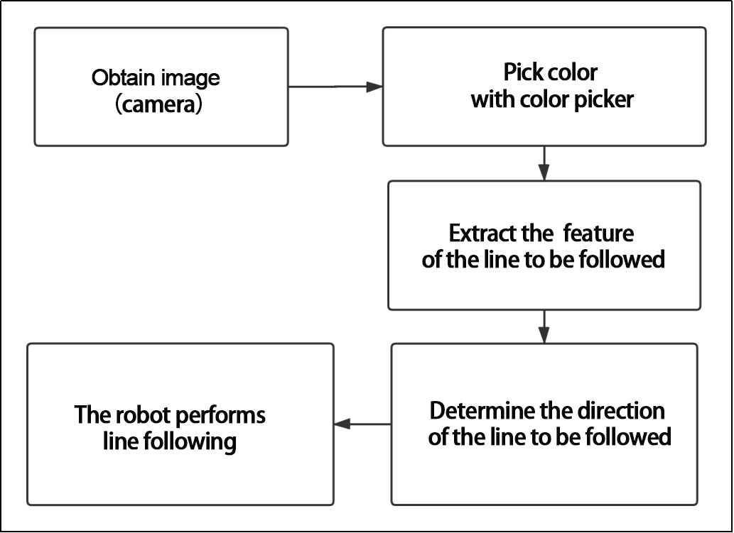

This game involves using the camera to detect the specified color, and making the robot follow the pre-laid line.
8.5.1 Recognition Procedure
Subscribe to the camera node’s topic to get the RGB image.
Find the line to be followed in the image and select it. Pick color to get its color threshold and extract its features. Calculate the robot’s offset from the line’s position in the field of view, and control the robot to move along the line. Keep the line in the center of the field of view by continuously correct the robot’s position. Use the lidar to detect the obstacle, enabling the obstacle avoidance.

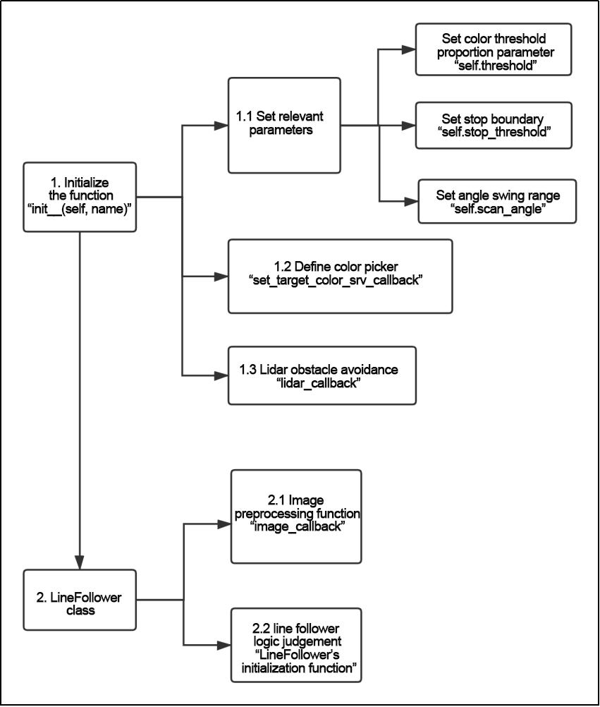

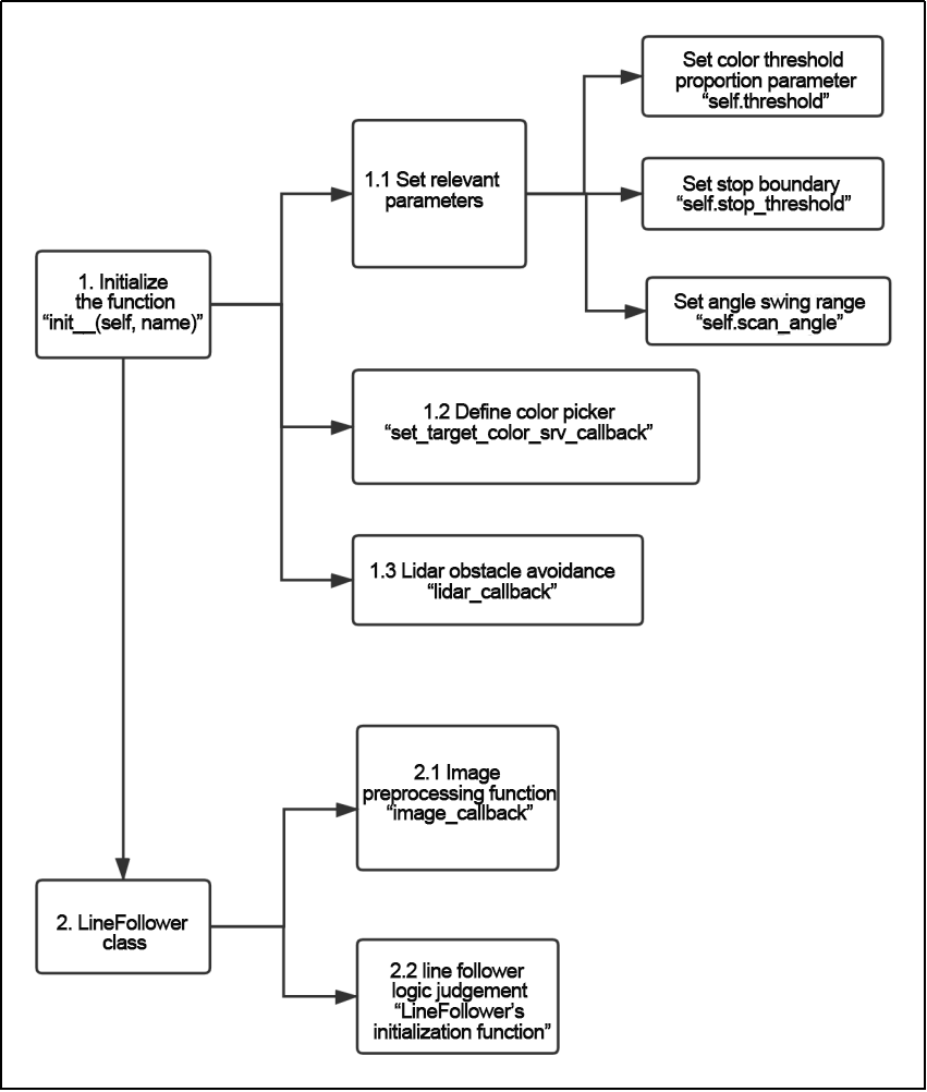

First, some preset parameters such as color threshold ratio, stop threshold, and angle swing range are defined through the initialization function. These parameters can affect the final recognition effect. Then, the color picker object is defined and the additional lidar obstacle avoidance function is set. Next, the LineFollower class is implemented, which mainly includes the image preprocessing function and the logic judgment of line following.
  • Set related parameters of the initialization function “init__(self, name)”
The LineFollowingNode class is used as the starting point of the program, and some basic parameters are defined in the initialization function. The color threshold ratio, stop threshold, and angle swing range need to be noted. All the relevant parameters and definitions are in the “LineFollowingNode” class, as shown in the figure below:
 93

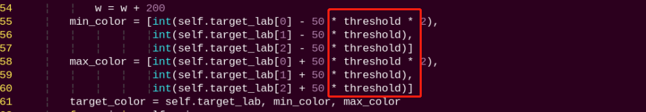

  • Set threshold ratio parameter “self.threshold”:
108
self.threshold = 0.5
The self.threshold parameter sets the weight ratio of color processing to binary image during the color picking. It is called through the initialization function of the LineFollower class, as shown in the figure below:
The above initialization function calls the self.threshold parameter, which sets the minimum and maximum color ranges of the target_color for subsequent binary processing. To achieve better recognition and processing results, the parameters can be kept at default.

In this lesson, let’s use OpenCV to track a red color block with the pan-tilt and display the recognition results through the live camera feed.
Before starting the game, please prepare a red block.
8.6.1 Recognition Procedure
First, subscribe to the topic messages published by the color recognition node to obtain color information. Obtain the RGB image from the camera and resize it. Apply Gaussian blur to the image and convert the color space from RGB to Lab.
Then, perform color recognition on the objects in the circle using color thresholding. Apply masking to parts of the image. Masking is used to globally or locally mask the processed image using selected images, graphics, or objects.
Afterward, perform opening and closing operations on the object images. Next, outline the largest object with a circle.
Opening operation: erode the image and then dilate it. It is used to eliminate small objects, smooth the shape boundary, and not change its area. It can remove small grain noise and break the adhesion between objects.
Erosion: Eliminate the boundary points of the object, causing the boundary to shrink inward, and can remove objects smaller than the structural element.
Dilation: Expand the boundary points of the object, merge all background points in contact with the object into the object, and expand the boundary outward. Then, feedback the recognition results on the feedback screen.
After matching the target color, the center position of the target image is obtained.
Finally, by publishing a corresponding topic message, the servo is controlled to rotate, so that the pan-tile servo can follow the target movement.

Note: After starting the game, please ensure that there are no other objects containing the recognized color in the field of view of the camera, as this may affect the affect the program outcome.
After starting the program, place the target object within the camera’s field of view. Once the target object is recognized, it will be highlighted with a circle and the pan-tilt will track it.

8.7 Chassis Tracking
In this lesson, OpenCV is used to recognize a target-colored block and control the robot chassis to track it.
Before starting this activity, please prepare a color block of any color.
8.7.1 Program Introduction
The program first subscribes to the ROS2 image node image_raw to receive the video feed. By clicking on the image, the user selects the target area, allowing the system to capture and record the color range for target identification. Once the target color is identified, OpenCV calculates the coordinates of its center. The system then determines the offset between this point and the center of the image frame. This offset is passed to a PID controller, which uses predefined parameters to calculate the appropriate movement speed for the chassis. Finally, the control data is published through the chassis control node topic, enabling the robot to track and follow the target accurately.
8.7.2 Operation Steps
Commands are case-sensitive, so please enter them exactly as required. You may use the Tab key to auto-complete keywords for convenience.
(1) Start the robot, and access the robot system using the VNC remote control software by referring the instructions in 2. Remote Tool Installation and Container Access-> 2.1 VNC Installation and Connection
(2) Click-on to launch the command-line terminal.
(3) Run the following command to disable the app auto-start service.
(4) Enter the command below to initiate the game.
ros2 launch app object_tracking_node.launch.py debug:=true
(5) Click to open a new terminal, then enter the following command to launch the camera. Once the live camera feed appears, click on the target area to select and capture its color.
ros2 service call /object_tracking/enter std_srvs/srv/Trigger {}
(6) Enter the following command to start tracking.
ros2 service call /object_tracking/set_running std_srvs/srv/SetBool data:\\ true
(7) To exit this mode, press Ctrl+C in the terminal. If it doesn’t close successfully, please try again multiple times.
After finishing this activity, you can start the mobile app service either by entering a command or by restarting the robot. If the mobile app service is not activated, app-related features will not function properly. (Note: The mobile app service will start automatically after a robot reboot.)
(8) Click and enter the command. Press enter to start the app, and wait for the buzzer to beep. Please enter the command in the system path, not in the Docker container.
8.7.3 Program Outcome
After starting the game, please ensure that no other objects containing the target color are within the camera’s field of view, as this may interfere with proper recognition and tracking.
Once the game starts, place the target object within the camera’s view. When the object is detected, it will be marked with a circle, and the robot will begin tracking it accordingly.
8.7.4 Program Analysis
Based on the observed behavior, review and organize the program’s logical flow as shown in the diagram below.
The source code for this program is located inside the Docker container at: /home/ubuntu/ros2_ws/src/app/app/object_tracking.py

(2) Pid calculates the data of the chassis motion

The received position data is used to calculate the offset from the target. A PID controller then computes the appropriate linear and angular velocities for the chassis, which are continuously published in a loop within the main function.
