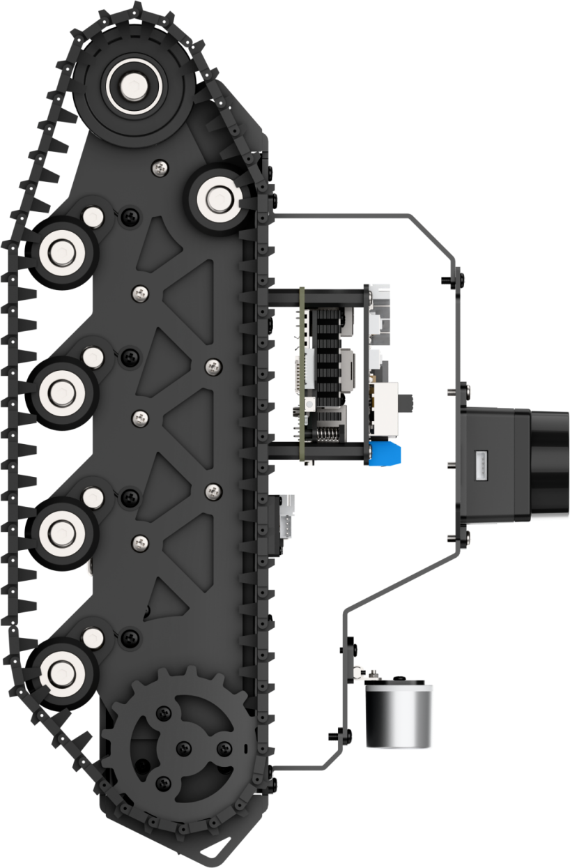

The track is a flexible loop driven by the drive sprocket and runs around the drive sprocket, road wheels, idler wheels, and support rollers.
The track is composed of track plates, track pins, and other components.
3.1.2 Physical Characteristic
  • Drive Sprocket
The drive sprocket is part of the track propulsion system. It transfers power from the motor to the tracks, allowing the tank to move. It’s usually located at the rear of the chassis.
  • Road Wheels
Road wheels support the weight of the tank and help guide the tracks. They ensure that the track presses evenly against the ground, improving stability and ride smoothness.
  • Idler Wheel
Positioned based on the location of the drive sprocket—typically at the front—the idler wheel helps guide the track along the correct path. It prevents the track from slipping off or going off-course.
  • Support Rollers
Support rollers hold up the upper section of the track to prevent it from sagging too much or slipping sideways. They also help reduce vibration while the tank is moving.
  • Chassis
The chassis is the main base of the tank, and it moves using a continuous track system. As the drive sprocket turns, it pulls the track, which unrolls at the front and lays flat under the road wheels. At the same time, the rear part of the track is pulled back up and looped around again. This continuous motion is what propels the tank forward—almost like it’s moving on a self-laying track.

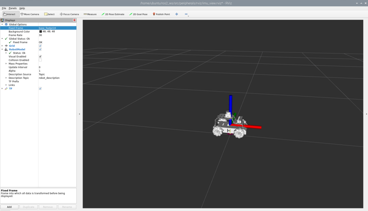

(12) If the below prompt shows up, it means the calibration is complete. To exit, use short-cut “ctrl+c.”
(13) After calibration, execute the command to verify the calibrated model.
(14) You can move the robot to see if it matches the angle and direction of the model.

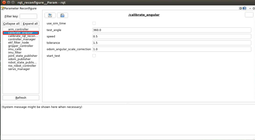

(8) Enter the command and press enter to start the angular velocity calibration.
ros2 launch calibration angular_calib.launch.py

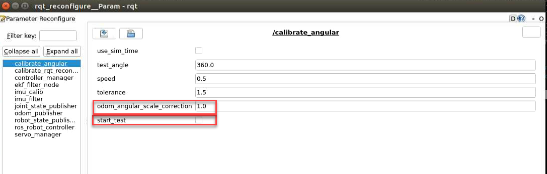

Click “calibrate_angular” on the left side. The calibration interface will appear as shown below.
① test_angle: Specifies the test rotation angle, with a default value of 360°.
② speed: Indicates the linear velocity, set by default to 0.15 meters per second.
③ tolerance: Represents the allowable error margin. A smaller value leads to more noticeable oscillation when the robot reaches the target position.
④ odom_angle_scale_correction: Used to adjust the scale correction for odometry angle measurements.
⑤ start_test: A button to initiate the test for odometry angle scale correction.
Ensure the robot is properly aligned, with the marker positioned directly in front of it. Then check the “start_test” option to begin the test—this will cause the robot to rotate in place. If the robot does not complete a full rotation, adjust the “odom_angle_scale_correction” parameter, which controls the scaling of the motor’s rotational output. It is recommended to fine-tune this value in increments of 0.01.

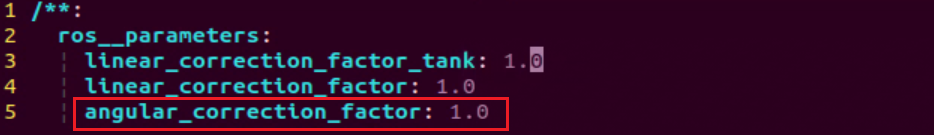

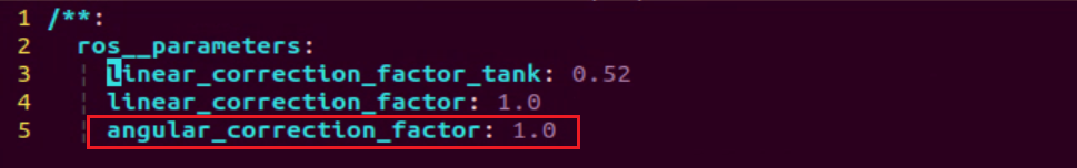

(9) After calibration, enter the command to navigate to the directory containing calibration configuration files. Modify to the calibrated parameter value.
cd ~/ros2_ws/src/driver/controller/config && vim calibrate_params.yaml
Press ‘I’ key to navigate to the editing mode, and modify the value of “angular_correctqion_factor” to the adjusted value of “odom_angule_scale_correction”.
The aforementioned operations are conducted on the Mecanum-wheel version.
(10) After modification, press the “ESC” key, enter “:wq” to exit and save the changes.
(11) If you want to exit the game, press “Ctrl+C” in the terminal interface.

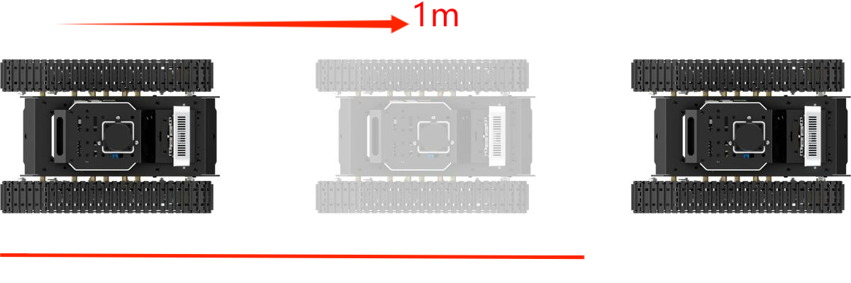

3.2.3 Linear Velocity Calibration
The Ackermann version does not require angular velocity calibration.
The input command is case-sensitive, and keywords can be completed using the Tab key.
Position the robot on a flat and open surface. Mark the starting point with tape or any other indicator in front of the robot, and position the endpoint tape or another marker 1 meter ahead of the robot.
(3) Execute the command and hit Enter to disable the app auto-start service.
(4) Before calibration, navigate to the directory of calibration configuration files to open them.
(5) Modify the linear velocity parameter “linear_correction_factor” to 1.0, then proceed with the calibration.
(6) After modifying, press “ESC.” Enter “:wq” to exit and save.
(7) Enter the command and press enter to start the linear velocity calibration.
ros2 launch calibration linear_calib.launch.py

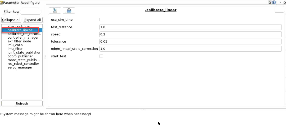

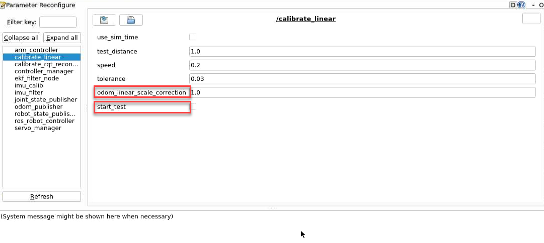

(8) Click “calibrate_linear” on the left side. The calibration interface will appear as shown below.
The meanings of parameters on the left side of the interface are as follows:
① The first parameter “test_distance” represents the testing distance, with a default value of 1 meter.
② The second parameter “speed” represents the linear velocity, with a default value of 0.2 meters per second.
③ The third parameter “tolerance” represents the error value. A smaller error value results in greater robot shaking after reaching the target position.
④ The fourth parameter “odom_linear_scale_correction” represents the odometer linear scale correction.
⑤ The fifth parameter “start_test” is the button to start testing the odometer linear scale correction.
(9) Ensure the robot is properly aligned and positioned at the starting point marker. Check the box for “start_test” and the robot will move forward. If there is deviation, adjust the value of “odom_linear_scale_correction”. This value adjusts the motor’s scaling factor for forward movement. It is recommended to adjust this value by increments of 0.01 each time.
(10) After calibration, enter the command to navigate to the directory containing calibration configuration files. Modify to the calibrated parameter value.
(11) Press ‘I’ key to navigate to the editing mode, and modify the value of “linear_correctqion_factor” to the adjusted value of “odom_linear_scale_correction”.
(12) After modification, press the “ESC” key, enter “:wq” to exit and save the changes.

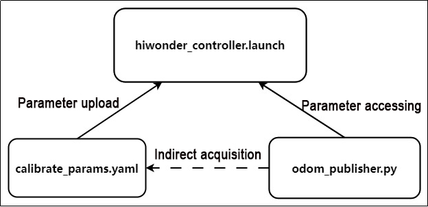

3.3 Publish IMU and Odometer Data
In robot navigation, accurately calculating real-time position is essential. Normally, we obtain odometer information using motor encoders and the robot’s kinematic model. However, in specific situations, like when the robot’s wheels rotate in place or when the robot is lifted, it may move a distance without the wheels actually turning.
To address wheel slip or accumulated errors in such cases, combining IMU and odometer data can yield more precise odometer information. This improves mapping and navigation accuracy in scenarios where wheel slip or cumulative errors may occur.

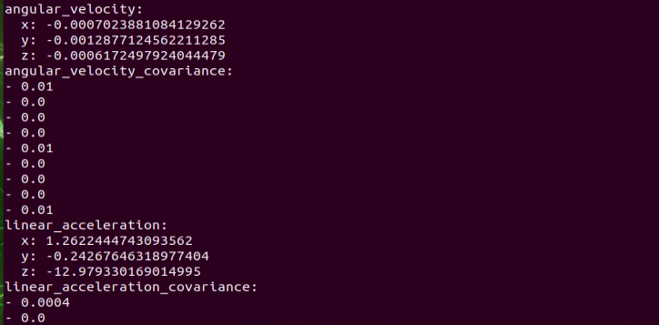

(2) Data Viewing
① Open a new command line terminal, and execute the command to check the current topic.
ros2 topic list
② Enter the command to view the type, publisher, and subscribers of the "/imu" topic. You can replace "/imu" with the topic you want to view. The type of this topic is “sensor_msgs/msg/Imu”.
ros2 topic info /imu
③ Use the following command to display the content of the topic message. Feel free to replace 'imu' with the name of the topic you wish to view.
ros2 topic echo /imu
The terminal will display the data from the three axes of the IMU.

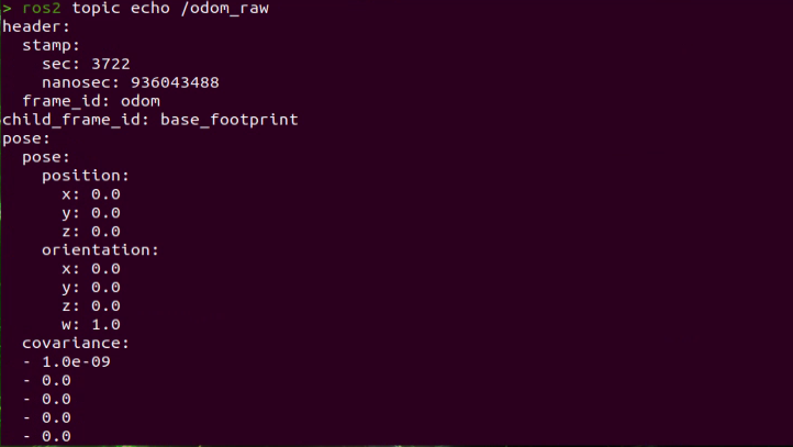

(2) Data Viewing
① Open a new command line terminal, and run the command below to check the current topic.
ros2 topic list
② Enter the command to view the type, publisher, and subscribers of the "/odom_raw" topic. You can replace "/odom_raw" with the topic you want to view. The type of this topic is “nav_msgs/msg/Odometry”.
ros2 topic info /odom_raw
③ Enter the command to print the topic message contents. You can replace the topic you want to view as needed.
ros2 topic echo /odom_raw
The message content includes acquired pose and velocity data.

        self.declare_parameter('linear_correction_factor', 1.00)
        self.declare_parameter('linear_correction_factor_tank', 0.52)
        self.declare_parameter('angular_correction_factor', 1.00)

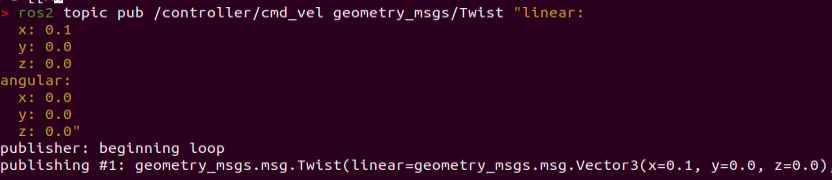

  • Modify Linear Velocity
(1) Open a new ROS2 command-line terminal, then enter the following command to enable the linear velocity control.
ros2 topic pub /controller/cmd_vel geometry_msgs/Twist "linear:
x: 0.0
y: 0.0
z: 0.0
angular:
x: 0.0
y: 0.0
z: 0.0"
The linear field is used to set the robot’s linear velocity. From the robot’s first-person perspective, the positive X-axis points forward, and the positive Y-axis points to the left. There is no movement along the Z-axis. By adjusting the direction and magnitude of the linear velocity, the robot can move forward, backward, or shift left and right.
  • In this scenario, the linear velocity (x) is measured in meters per second, and it is advisable to maintain it within the range of “-0.6 to 0.6”.
  • The z value represents the robot’s angular velocity around the vertical axis — in other words, its yaw rate. It is recommended to keep this value within the range of -2 to 2.
    A value of 0 means no rotation.
    A positive value indicates counterclockwise rotation.
    A negative value indicates clockwise rotation.
    The larger the absolute value, the faster the robot rotates.
The angular parameter defines the robot’s rotational speed.
  • A positive Z value makes the robot turn left.
  • A negative Z value makes it turn right.
  • There is no rotation along the X or Y axes.
You can use the left and right arrow keys on your keyboard to adjust this value.
For example, to move the robot forward, set the linear velocity along the X-axis to 0.1.
(2) To bring the robot car to a stop, open a new terminal and set the linear velocity to '0.0'.
(3) If you need to terminate this program, use short-cut ‘Ctrl+C’.
To bring the robot car to a stop, please create a new terminal and adjust the linear velocity. Using the ‘Ctrl+C’ shortcut alone may not effectively halt the robot car.

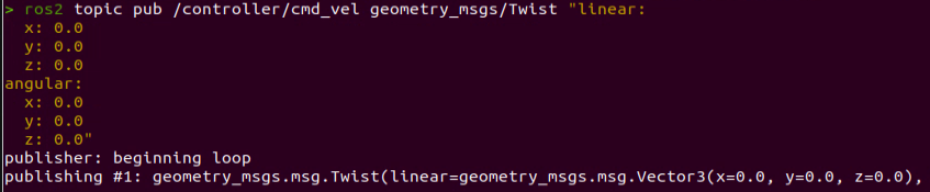

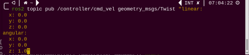

  • Change Angular Speed
(1) Open a new ROS2 command-line terminal, then enter the following command to enable the angular velocity control.
x: 0.0
y: 0.0
z: 0.0
angular:
x: 0.0
y: 0.0
z: 0.0"
“angular” sets the angular velocity of the robot. A positive value for “Z” will make the robot turn left, while a negative value for “Z” will make it turn right. There is no motion in the X and Y directions.
  • The Z-axis value controls the robot’s turning speed, also known as its yaw angular velocity. This determines how quickly the robot rotates in place.
    A positive value makes the robot turn left (counterclockwise).
    A negative value makes it turn right (clockwise).
    The greater the absolute value, the faster the robot turns.
It’s recommended to keep this value within the range of -2 to 2 for safe and stable movement.
Use the left and right arrow keys on the keyboard to adjust the corresponding parameters. For example, to make the robot rotate in place to the left, set the angular velocity Z value to 1.0, then press Enter to execute the command.
(2) To bring the robot car to a stop, open a new terminal and set the angular velocity to '0.0'.
(3) If you want to exit the game, press “Ctrl+C” in the terminal interface.

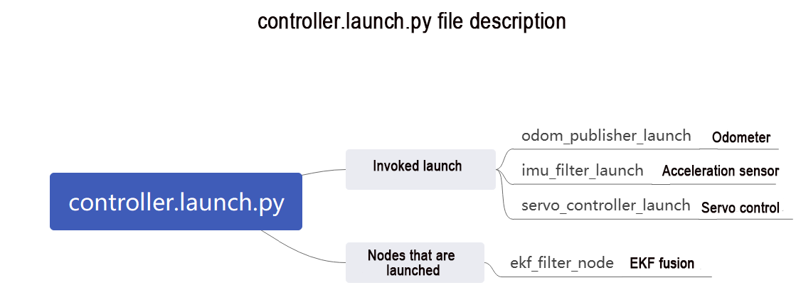

The files include ‘controller.launch.py’ for launch configuration, ‘calibrate_params.yaml’ for parameter configuration, and ‘odom_publisher.py’ for program execution.
During startup, the launch file is executed first. It loads the YAML configuration file and passes the parameters to the ROS nodes. Subsequently, the nodes initialize by reading the configuration parameters from the ROS nodes and communicate with other nodes to collaboratively implement functionalities.
  • Launch File
Source Code
The launch file is located in: /home/ubuntu/ros2_ws/src/driver/controller/launch/controller.launch.py

    odom_publisher_launch = IncludeLaunchDescription(
        PythonLaunchDescriptionSource([os.path.join(controller_package_path, 'launch/odom_publisher.launch.py')
        launch_arguments={
            'namespace': namespace,
            'imu_frame': imu_frame,
            'frame_prefix': frame_prefix,
            'base_frame': base_frame,
            'odom_frame': odom_frame
        }.items()
    imu_filter_launch = IncludeLaunchDescription(
        PythonLaunchDescriptionSource([os.path.join(peripherals_package_path, 'launch/imu_filter.launch.py')
(1) odom_publisher_launch Odometer launch
(2) imu_filter_launch IMU launch

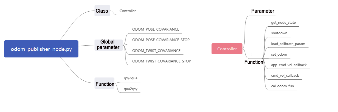

The Python program is saved in: /home/ubuntu/ros2_ws/src/driver/controller/controller/odom_publisher_node.py
  • Import Library
import math
import time
import rclpy
import signal
import threading
from rclpy.node import Node
from nav_msgs.msg import Odometry
from controller import ackermann, mecanum
from ros_robot_controller_msgs.msg import MotorsState, SetPWMServoState, PWMServoState
from geometry_msgs.msg import Pose2D, Pose, Twist, PoseWithCovarianceStamped, TransformStamped
  • Main Function
303
304
305
306
307
def main():
    node = Controller('odom_publisher')
    rclpy.spin(node)
if __name__ == "__main__":
    main()
The controller class is invoked here, and wait for the node to exit.

  • Analysis of the Controller Class
① Invoke kinematics:
104
105

        # Declare parameters
        self.declare_parameter('pub_odom_topic', True)
        self.declare_parameter('base_frame_id', 'base_footprint')
        self.declare_parameter('odom_frame_id', 'odom')
        self.declare_parameter('machine_type', os.environ['MACHINE_TYPE'])
        self.pub_odom_topic = self.get_parameter('pub_odom_topic').value
        self.base_frame_id = self.get_parameter('base_frame_id').value
        self.odom_frame_id = self.get_parameter('odom_frame_id').value
        #self.machine_type = os.environ.get('MACHINE_TYPE', 'MentorPi_Mecanum')
        self.machine_type = self.get_parameter('machine_type').value
The function self.declare_parameter is used to define a certain parameter.
The function self.get_parameter is used to obtain a certain parameter.
pub_odom_topic: Whether to publish the odometry node
base_frame_id: Robot footprint ID
odom_frame_id: Robot odometry ID
linear_correction_factor: Linear velocity correction factor
angular_correction_factor: Angular velocity correction factor
machine_type: Type of robot

  • FAQ
Q: The robot continues to move forward even after pressing “Ctrl+C” in the terminal.
(1) In such a situation, you need to open a new terminal and enter the command:
rostopic pub /hiwonder_controller/cmd_vel geometry_msgs/Twist "linear:"
then press Tab to autocomplete, set the speed to 0, and press Enter to execute.
