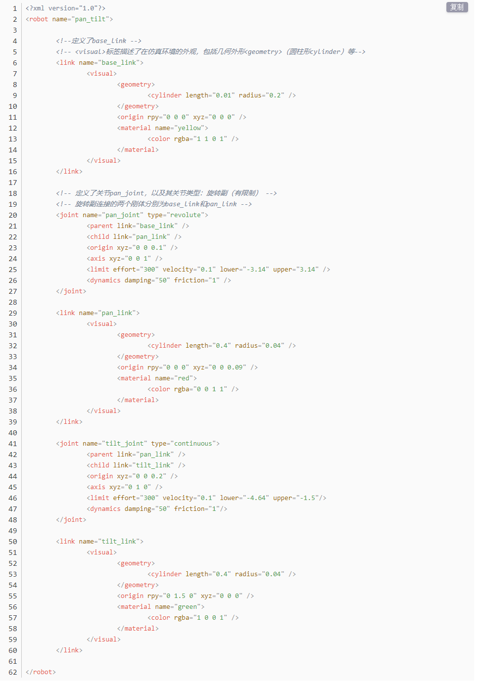

  • Write Simple URDF Model
(1) Name the model of the robot
To start writing the URDF model, we need to set the name of the robot following this format: "<robot name="robot model name">". Lastly, input "</robot>" at the end to represent that the model is written successfully.
(2) Set links
① To write the first link and use indentation to indicate that it is part of the currently set model. Set the name of the link using the following format: "<link name="link name">". Finally, conclude with "</link>" to indicate the successful completion of the link definition.
② Write the link description and use indentation to indicate that it is part of the currently set link, and conclude with "</visual>".
③ The "<geometry>" tag is employed to define the shape of a link. Once the description is complete, include "</geometry>". Within the "<geometry>" tag, indentation is used to specify the detailed description of the link's shape. The following example demonstrates a link with a cylindrical shape: "<cylinder length="0.01" radius="0.2"/>". In this instance, "length="0.01"" signifies a length of 0.01 meters for the link, while "radius="0.2"" denotes a radius of 0.2 meters, resulting in a cylindrical shape.
④ The "<origin>" tag is utilized to specify the position of a link, with indentation used to indicate the detailed description of the link's position. The following example demonstrates the position of a link: "<origin rpy="0 0 0" xyz="0 0 0" />". In this example, "rpy" represents the roll, pitch, and yaw angles of the link, while "xyz" represents the coordinates of the link's position. This particular example indicates that the link is positioned at the origin of the coordinate system.
⑤ The "<material>" tag is used to define the visual appearance of a link, with indentation used to specify the detailed description of the link's color. To start describing the color, include "<material>", and end with "</material>" when the description is complete. The following example demonstrates setting a link color to yellow: "<color rgba="1 1 0 1" />". In this example, "rgba="1 1 0 1"" represents the color threshold for achieving a yellow color.
(3) Set joint
① To write the first joint, use indentation to indicate that the joint belongs to the current model being set. Then, specify the name and type of the joint as follows: "<joint name="joint name" type="joint type">". Finally, include "</joint>" to indicate the completion of the joint definition.
To learn about the type of the joint, please refer to 6.1.2 Joint.
② Write the description section for the connection between the link and the joint. Use indentation to indicate that it is part of the currently defined joint. The parent parameter and child parameter should be set using the following format: "<parent link="parent link"/>", and "<child link="child link" />". With the parent link serving as the pivot, the joint rotates the child link.
③ "<origin>" describes the position of the joint using indention. This example describes the position of the joint: "<origin xyz="0 0 0.1" />". xyz is the coordinate of the joint.
④ "<axis>" describes the position of the joint adopting indention. "<axis xyz="0 0 1" />" describes one posture of a joint. xyz specifies the pose of the joint.
⑤ "<limit>" imposes restrictions on the joint using indention. The "<limit>" tag is used to restrict the motion of a joint, with indentation indicating the specific description of the joint angle limitations. The following example describes a joint with a maximum force limit of 300 Newtons, an upper limit of 3.14 radians, and a lower limit of -3.14 radians. The settings are defined as follows: "effort="joint force (N)", velocity="joint motion speed", lower="lower limit in radians", upper="upper limit in radians".
⑥ "<dynamics>" describes the dynamics of the joint using indention. "<dynamics damping="50" friction="1" />" describes dynamics parameters of a joint.

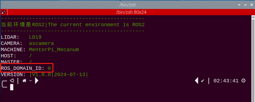

6.2.2 Check Code of Robot Model
(2) Click-on to create a command-line terminal.
(3) Run the command and hit Enter to disable the app auto-start service.
(4) Execute the command and hit Enter key to navigate to the folder containing startup programs.

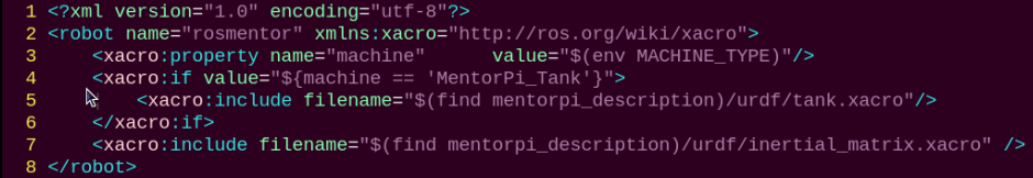

vim mentorpi.xacro
(7) Locate the code below:
Determine the current form of the robot by reading the machine variable to load the corresponding URDF model.
Multiple URDF models are called to compose a complete robot.

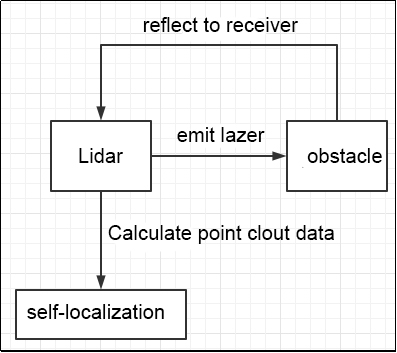

6.3.2 SLAM Mapping Principle
(1) Preprocessing: Optimizing the raw data from the radar point cloud, filtering out problematic data or performing filtering. Using laser as a signal source, pulses of laser emitted by the laser are directed at surrounding obstacles, causing scattering.
Some of the light waves will reflect back to the receiver of the lidar, and then, according to the principle of laser ranging, the distance from the lidar to the target point can be obtained.
Regarding point clouds: In simple terms, the surrounding environment information obtained by lidar is called a point cloud. It reflects a portion of what the ‘eyes’ of the robot can see in the environment where it is located. The object information collected presents a series of scattered, accurate angle, and distance information.
(2) Matching: Matching the point cloud data of the current local environment with the established map to find the corresponding position.
(3) Map Fusion: Integrating new round data from the lidar into the original map, ultimately completing the map update.

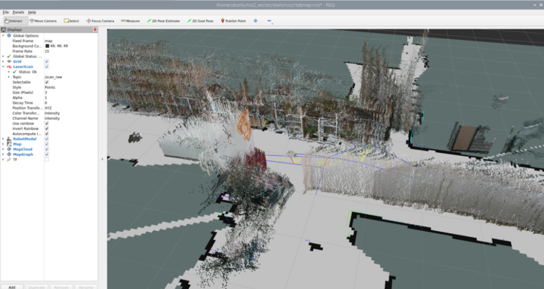

6.4 slam_toolbox Mapping Algorithm
6.4.1 Algorithm Definition

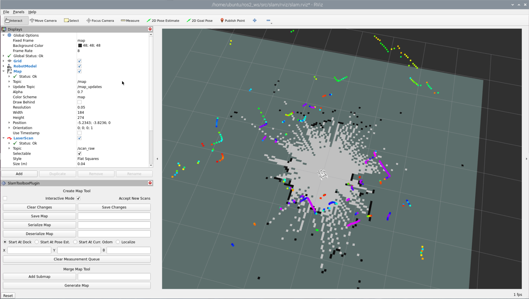

Slam Toolbox software package combines information from laser rangefinders in the form of LaserScan messages and performs TF transformation from odom-> base link to create a two-dimensional map of space. This software package allows for fully serialized reloadable data and pose graphs of SLAM maps, used for continuous mapping, localization, merging, or other operations. It allows Slam Toolbox to operate in synchronous (i.e., processing all valid sensor measurements regardless of delay) and asynchronous (i.e., processing valid sensor measurements whenever possible) modes.
ROS replaces functionalities like gmapping, cartographer, karto, and hector, providing comprehensive SLAM functionality built upon the powerful scan matcher at the core of Karto, widely used and accelerated for this package. It also introduces a new optimization plugin based on Google Ceres. Additionally, it introduces a new localization method called 'elastic pose-graph localization,' which takes measured sliding windows and adds them to the graph for optimization and refinement. This allows for tracking changes in local features of the environment instead of considering them as biases, and removes these redundant nodes when leaving an area without affecting the long-term map.
Slam Toolbox is a suite of tools for 2D Slam, including:
(1) Mapping, saving map pgm files.
(2) Map refinement, remapping, or continuing mapping on saved maps.
(3) Long-term mapping: loading saved maps to continue mapping while removing irrelevant information from new laser point clouds.
(4) Optimizing positioning mode on existing maps. Localization mode can also be run without mapping using the 'laser odometry' mode.
(5) Synchronous, asynchronous mapping.
(6) Dynamic map merging.
(7) Plugin-based optimization solver, with a new optimization plugin based on Google Ceres.
(8) Interactive RVIZ plugin.
(9) RVIZ graphical manipulation tools for manipulating nodes and connections during mapping.
(10) Map serialization and lossless data storage.
KARTO:
Karto_SLAM is a graph-based SLAM algorithm that uses highly optimized and non-iterative Cholesky decomposition to solve sparse systems. It represents the map using a graph structure, where each node corresponds to a robot pose along its trajectory along with associated sensor data. Every time a new node is added, the system recalculates and updates the graph.
The ROS version of Karto_SLAM includes components such as Sparse Pose Adjustment (SPA) for scan matching and loop closure detection.
The more landmarks present, the greater the memory usage. However, compared to other methods, graph-based optimization performs better in large-scale environments because it focuses solely on the pose graph (i.e., robot positions). Once the poses are optimized, the map is then generated based on those poses.

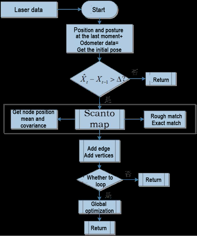

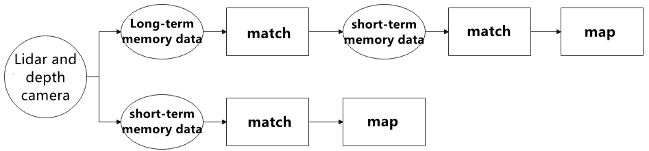

The algorithm framework for Karto_SLAM is illustrated in the diagram below:
From the above diagram, it can be seen that the process is relatively straightforward. The traditional soft real-time operation mechanism of slam involves processing each frame of data upon entry and then returning.

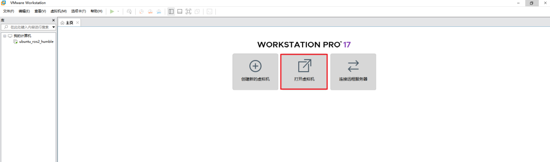

(2) Click on to open the virtual machine.
(3) Enter the virtual machine interface and click on "Open Virtual Machine".
(4) Select the image file provided in this path Virtual Host->Virtual Machine Image Preconfigured with ROS Environment->HiWonder_ros2_humble (for Mapping and Navigation).

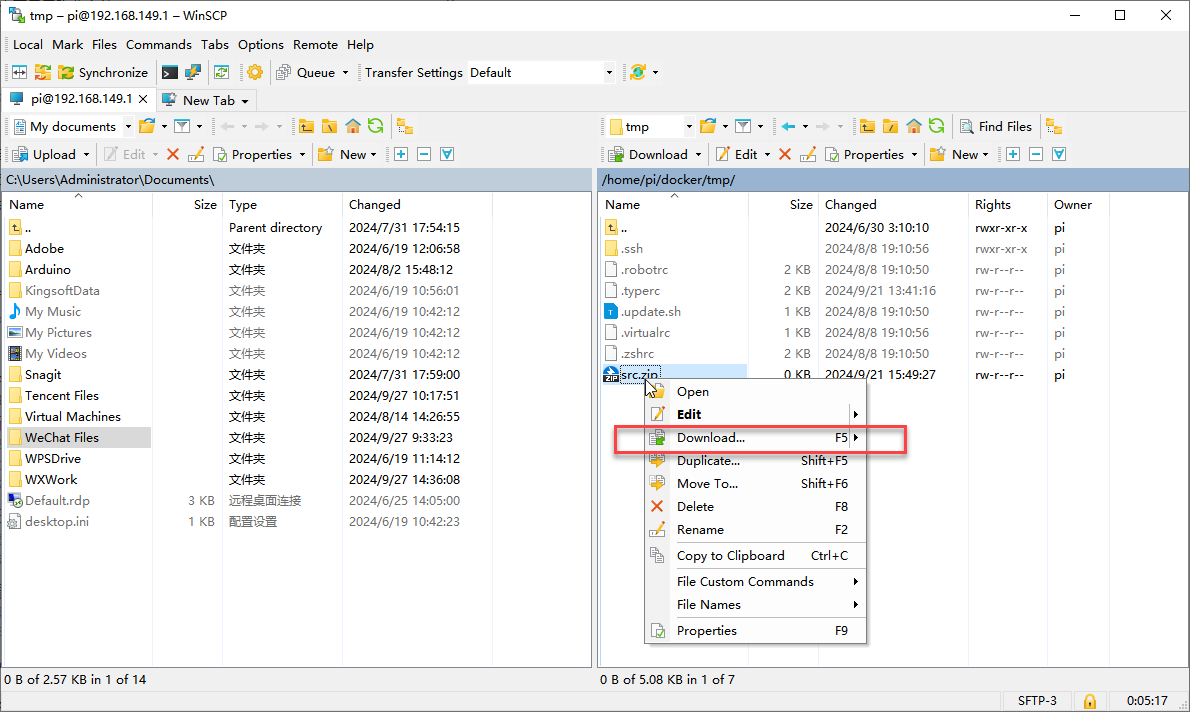

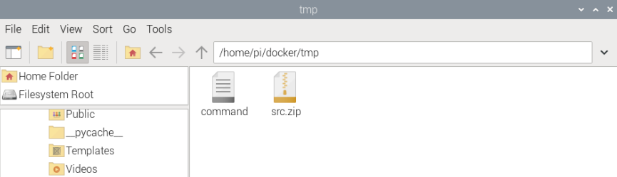

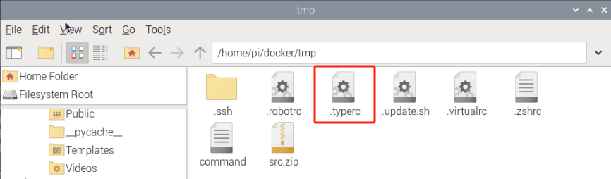

⑩ Click-on to open the file directory, then navigate to the home/pi/docker/tmp directory:
⑪ Use the shortcut 'Ctrl + H' to show the hidden .typerc file:

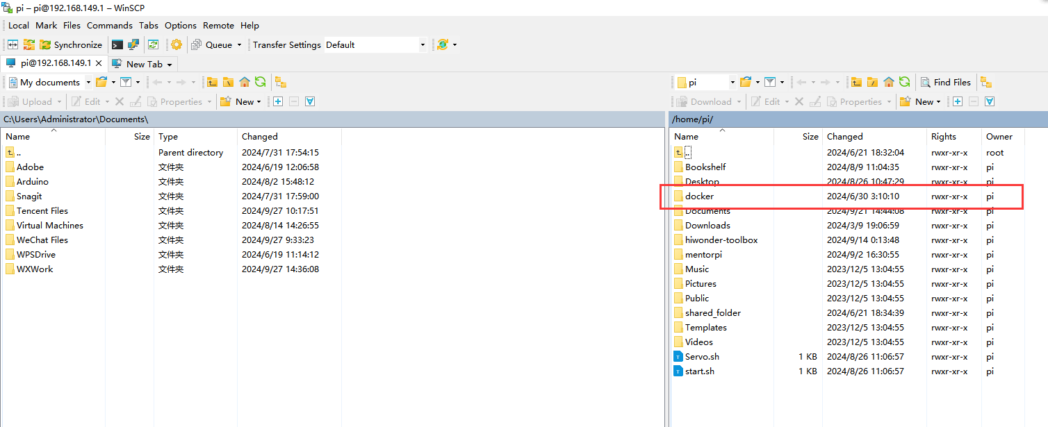

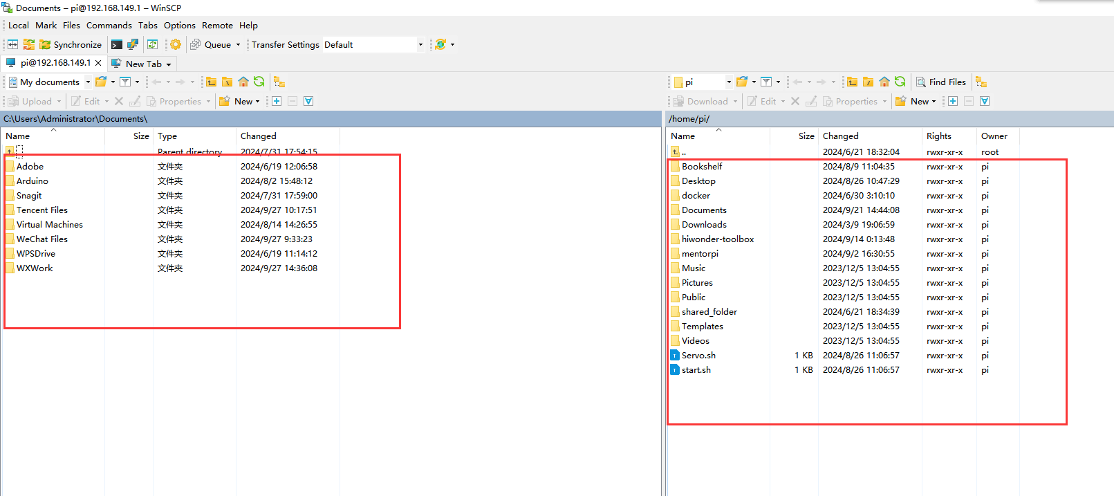

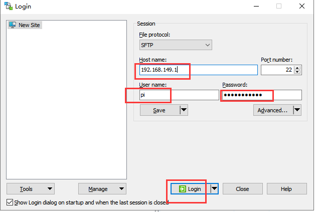

⑫ Refer to the instruction in 6.6 Install WinSCP to install and open the WinSCP tool.

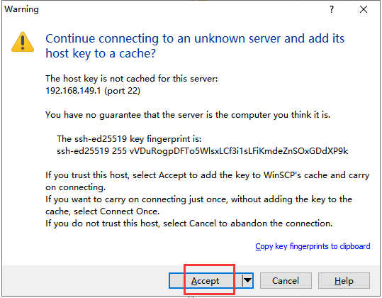

⑬ Enter the IP address of Raspberry Pi "192.168.149.1", username "pi", and password "raspberrypi". Then click "Login".
⑭ Click "Accept" on the pop-up window that appears.
⑮ The left side shows the directory of your computer, and the right side shows the root directory of Raspberry Pi.

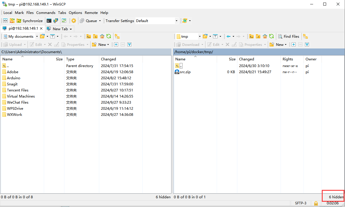

⑯ Select the folder "docker->tmp" and open the shared folder with Docker.
⑰ In the bottom right corner of WinSCP, there is a number indicating the number of hidden files. Double-click on it to display hidden files.
⑱ Select the "src" folder and right-click to choose "Download".
⑲ Select the path where you want to save the file and click "OK".
⑳ Follow step ⑱ to save the .typerc file.

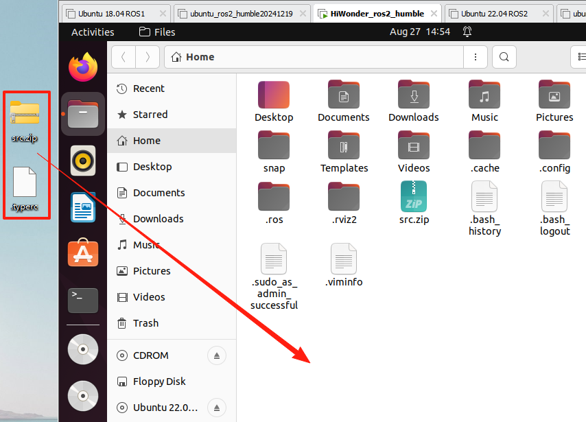

(2) Import files into the virtual machine
① Click-on to navigate to the home directory.
② Drag and drop the .typerc and src.zip files from the computer desktop into the virtual machine:

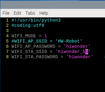

(2) Enter the command to open the WiFi configuration file.
vim hiwonder-toolbox/wifi_conf.py
(3) Press "i" key to enter the editing mode. Change the WiFi configuration file to LAN mode, and modify your own WiFi name and password.
When MentorPi fails to find the target network in LAN mode and automatically switches to Direct Connection mode, the configuration in wifi_conf.py will not be updated. It will still contain the LAN mode settings. If you don’t manually update this file, MentorPi will continue to boot in LAN mode by default the next time it starts.
(4) After finishing writing, press "Esc" and enter the command to save and exit.
:wq
(5) Enter the command to restart the network, or reboot the system. It is recommended to reboot the system.

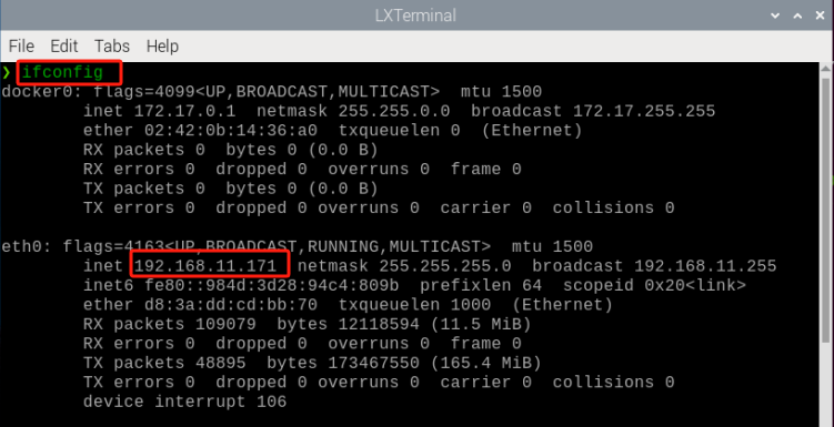

(6) Refer to 1. Getting Ready->1.6 App Control to obtain the robot’s LAN IP address through the app connection.

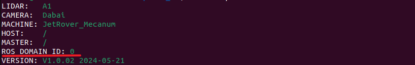

(7) It is important to note that the virtual machine and the robot are connected to the same LAN, and their IP addresses should be within the same subnet:
① Virtual Machine:
② Robot:
(8) After rebooting, click on to open the robot’s ROS2 command line terminal. You will notice that the ROS_DOMAIN_ID is 0, which is the same as on the virtual machine.
① Robot:
② Virtual Machine:

(1) Click-on to open the command line terminal of the virtual machine system.
(2) Enter the command to open the RViz tool and display the mapping results.
  • Enable keyboard control
(2) Enter the command to start the keyboard control node, and press "Enter".
If you see the prompt as shown in the following image, it means the keyboard control service has been successfully started.
(3) Control the robot to move in the current space to build a more complete map. The table below lists the keyboard keys available for controlling robot movement and their corresponding functions:
Key Robot Action

6.5 RTAB-VSLAM 3D Mapping
6.5.1 RTAB-VSLAM Description
RTAB-VSLAM is an appearance-based real-time 3D mapping system, it’s an open-source library that achieves loop closure detection through memory management methods. It limits the size of the map to ensure that loop closure detection is always processed within a fixed time limit, thus meeting the requirements for long-term and large-scale environment online mapping.
6.5.2 RTAB-VSLAM Working Principle
RTAB-VSLAM 3D mapping employs feature mapping, offering the advantage of rich feature points in general scenes, good scene adaptability, and the ability to use feature points for localization. However, it has drawbacks, such as a time-consuming feature point calculation method, limited information usage leading to loss of image details, diminished effectiveness in weak-texture areas, and susceptibility to feature point matching errors, impacting results significantly.
After extracting features from images, the algorithm proceeds to match features at different timestamps, leading to loop detection. Upon completion of matching, data is categorized into long-term memory and short-term memory. Long-term memory data is utilized for matching future data, while short-term memory data is employed for matching current time-continuous data.
During the operation of the RTAB-VSLAM algorithm, it initially uses short-term memory data to update positioning points and build maps. As data from a specific future timestamp matches long-term memory data, the corresponding long-term memory data is integrated into short-term memory data for updating positioning and map construction.

  • Virtual Machine Operation
(2) Enter the command to open the RViz tool and display the mapping effect:

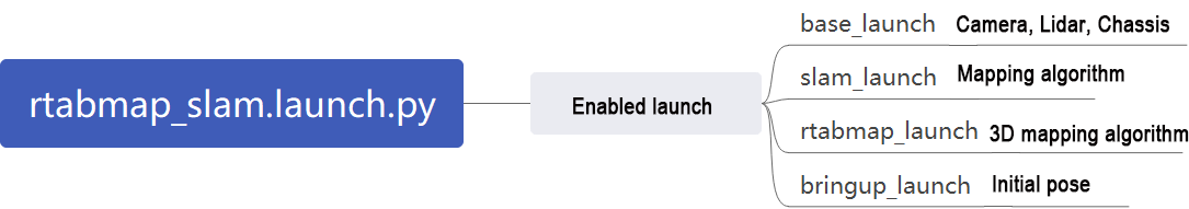

① base_launch: Launch for hardware initialization.
② slam_launch: Basic mapping launch.
③ rtabmap_launch: RTAB mapping launch.
④ bringup_launch: Initial pose launch.

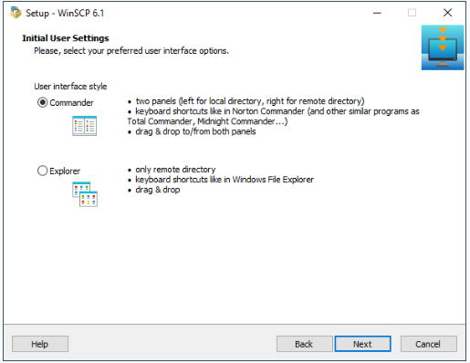

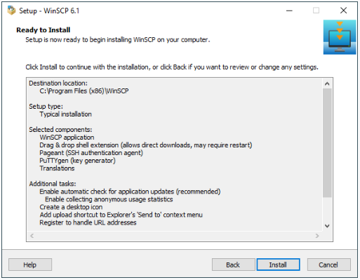

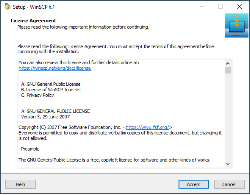

WinSCP is an open-source graphical SFTP client for Windows that supports the SSH and SCP protocols. It can securely copy files between local and remote computers. The tool can also directly edit files.
The installation steps for WinSCP are as follows:

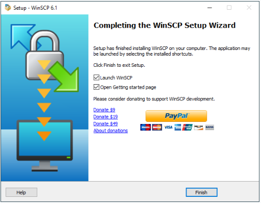

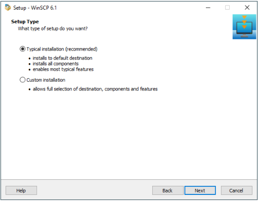

(1) Double-click the WinSCP-5.15.3-Setup.exe installation pack in the directory of this section. Click “Accept” to start installing.
(2) Click "Next".
(3) Click "Next".
(4) Keep the default installation location and click "Install".
(5) After waiting for a moment, a prompt window will appear indicating that the installation is complete. Click "Finish".
(6) After the installation is completed, click to open it.
