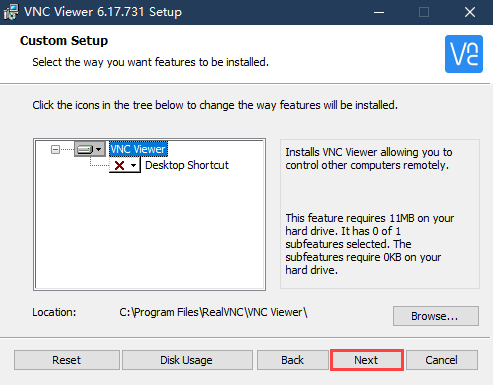

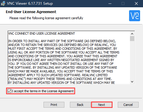

(1) In the “folder”, double-click the VNC-Viewer-6.17.731-Windows file. When the dialog box appears, select “English” as the installation language and click “OK”.
(2) Click “Next” to proceed.
(3) In the “License Agreement” window, select “I accept the terms in the License Agreement”, then click “Next”.
(4) Keep the default installation location and click “Next”. When you are taken to the next screen, simply click “Install”.
(5) Once the installation is complete, click “Finish”.
(6) After the installation, double-click the VNC Viewer icon to open the program and begin connecting.

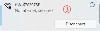

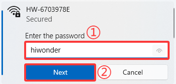

(1) After turning on, it is the AP direct connection mode by default, and Raspberry Pi will launch a hotspot starting with “HW”. Please search for and connect to this hotspot on your computer, as shown below:
(2) Click connection, input the password “hiwonder”.

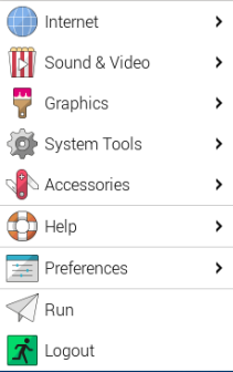

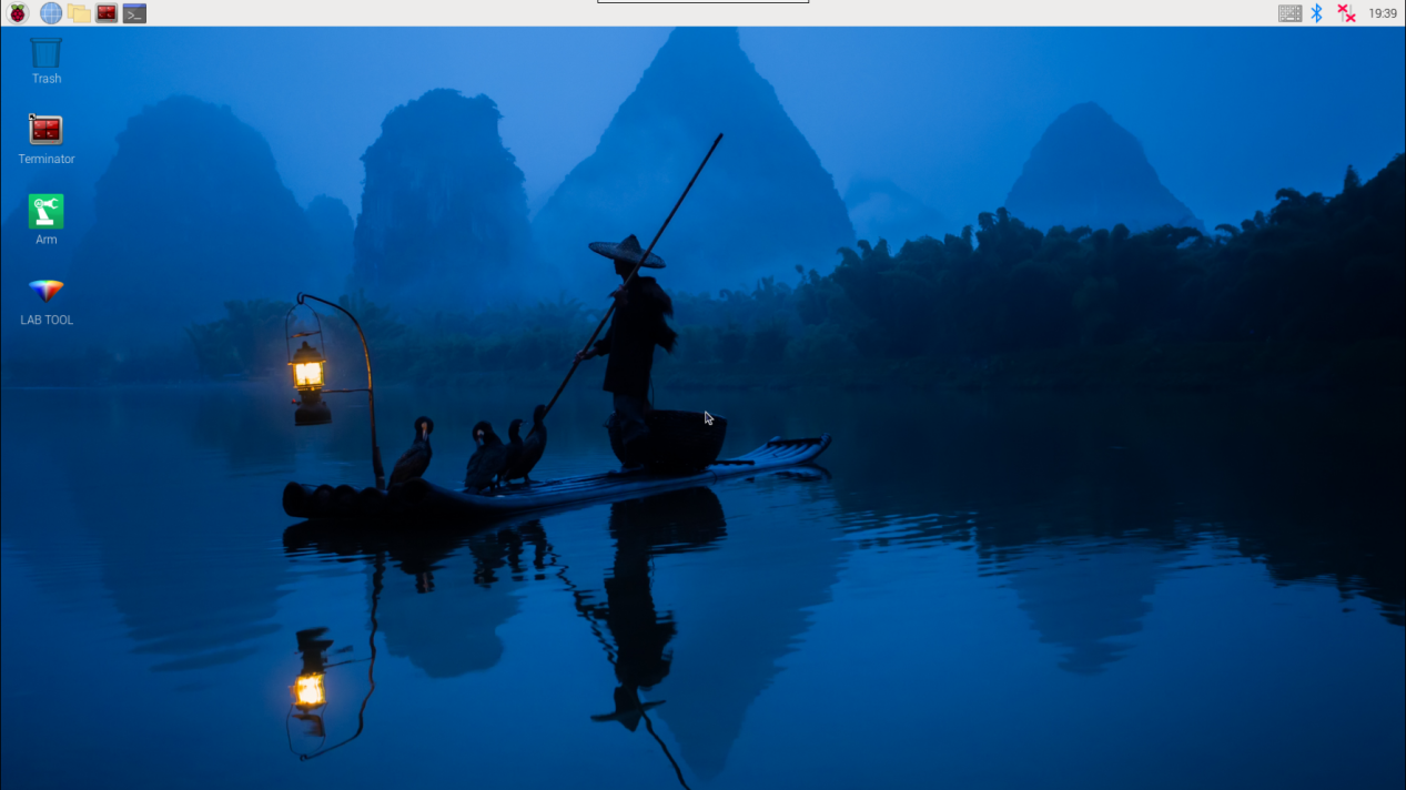

2.1.4 Interface Introduction
After successfully connecting to the MentorPi via VNC, the operating interface will appear as shown below:
The following table provides an explanation of commonly used functions:
Icon Function
Application menu. Click it to select different applications.
Browser comes with the system.
File management.
LX Terminal. Click it to open a command line terminal for entering commands.
Trash can allows you to recover recently deleted files.
PC software allows you to adjust the the position of the pan-tilt and color threshold.

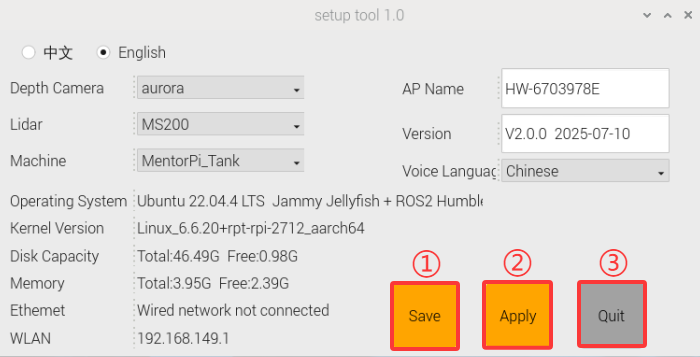

2.2 Robot Version Configuration Instruction
MentorPi offers multiple chassis options (Mecanum wheel or Ackermann steering) and different camera versions. If you need to switch between robot configurations or camera types, please follow the steps below:
  • Configuration Steps
(1) Start the robot and connect it to the VNC. For detailed steps on setting up the connection, please refer to 2.1 VNC Installation and Connection.

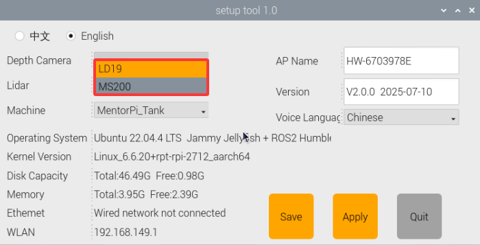

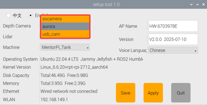

(2) In the remote desktop, double-click the robot system configuration tool . Then, click the “Execute” button to launch it.
(3) Select the appropriate camera type under the Camera Type dropdown:
① “ascamera” represents the 3D depth camera.
② “usb_cam” represents the 2D monocular camera.
③ aurora: refers to the DEPTRUM depth camera used in the robot.

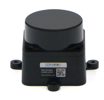

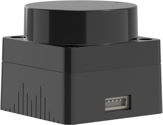

(4) Choose the correct Lidar type:
LD19 Lidar
MS200 Lidar

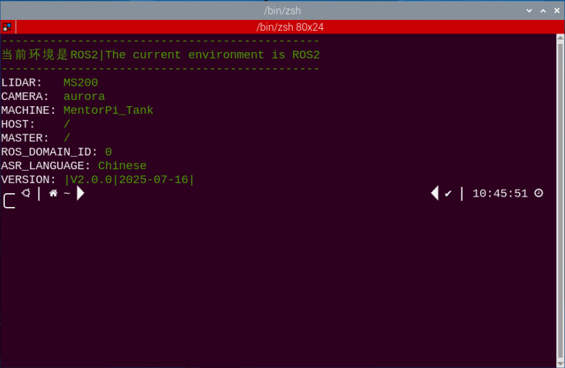

(5) Click the buttons in the following order: “Save” → “Apply” → “Quit”. This sequence must be followed to successfully apply the new configuration.
(6) Wait for a beep sound from the buzzer, indicating that the chassis type has been successfully updated. Then, open the terminal or related tool to check the ROS2 system environment.

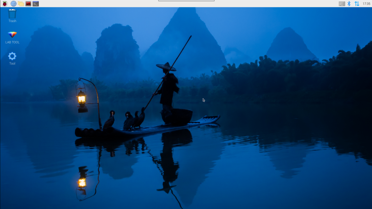

2.3.1 Desktop Overview
After establishing a remote connection via VNC, the Raspberry Pi system desktop will appear as shown in the image below:
Icon Function
Version Switching Tool: switch between different versions and configurations of the robot car.
Color model parameter adjustment tool.
Command Line Terminal: input commands for operations.
Recycle bin.
Raspberry Pi menu bar.
System file folder.

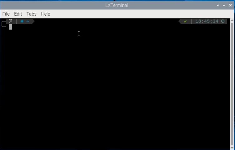

(1) Click the or press Ctrl + Alt + T to launch the LX Terminal.
(2) Type the following command and press Enter:
ls

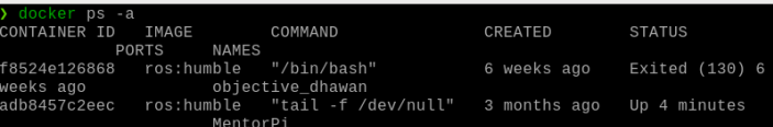

(4) In the terminal, enter the following command to view active and previously run containers:
docker ps -a
(5) Use the following command to access the container:
Replace <container_id> with the actual container ID. It can be abbreviated as long as it remains unique.
docker exec -it -u ubuntu -w /home/ubuntu adb8 /bin/bash

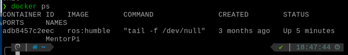

2.4.3 Check Container
Command parameters: docker ps [OPTIONS]
Commonly used parameters:
  • -a: Lists all containers, including those that are currently running and those that have exited
  • -l: Displays the most recently created container
  • -n=?: Shows the n most recently created containers
  • -q: Quiet mode—displays only the container IDs

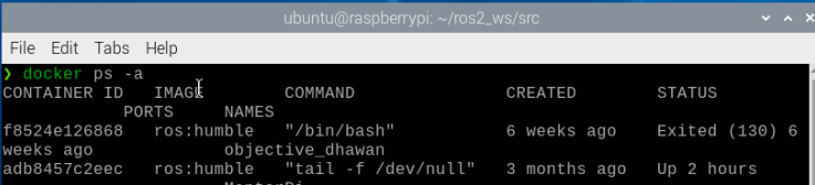

Enter the following command and press “Enter” to display a list of running and previously run containers. The output will show the “container ID”, which is the unique identifier for each container, the “image”, which indicates the name of the image used, the “created” time, which shows when the container was created, and the “status”, which indicates the current state of the container.
docker ps -a

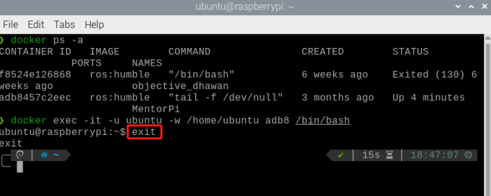

2.4.5 Exit Container
There are two commands for exiting containers:
  • Method 1:
(1) Enter the command below and press “Enter”. This stops the container and exits it.
exit
  • Method 2:
(1) Use “crtl+P+Q”. This detaches from the container without stopping it. Then use docker ps to verify that it is still running:

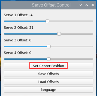

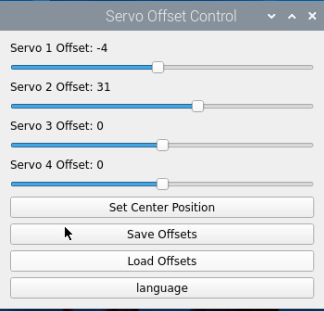

(4) After executing the command, a pop-up window will appear as shown below.
Servo 1: Refers to the servo at the J3 marking on the expansion board
Servo 2: Refers to the servo at the J4 marking on the expansion board
Servo 3: Refers to the servo at the J5 marking on the expansion board
Servo 4: Refers to the servo at the J6 marking on the expansion board
(5) Drag the four sliders shown below to adjust the corresponding servo offsets. The servos will rotate in real time during the adjustment, allowing you to observe their movement and fine-tune the deviation accordingly.
(6) If you’re not satisfied with the adjustment results, click the ‘Set Center Position’ button to reset all servo offsets to their default center positions and readjust as needed.

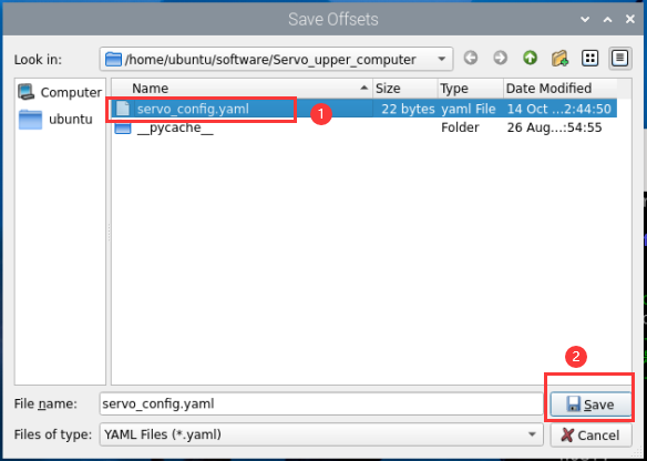

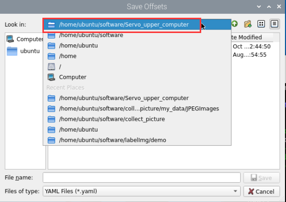

(7) After adjusting the servos to the desired positions, click the ‘Save Offsets’ button to save the calibration settings.
Below is the storage path.
The following file will be saved:
After completing this step, the offset values will be stored. In all future applications involving the servos, this offset file will be automatically loaded to compensate for any servo deviations.
