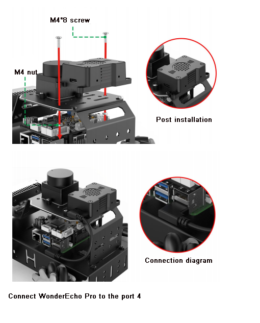

14.1.2 WonderEcho Pro Installation
When installing the WonderEcho Pro, make sure the robot’s front faces forward and the WonderEchoPro’s USB port is oriented to the left—aligned with the Raspberry Pi’s USB ports.

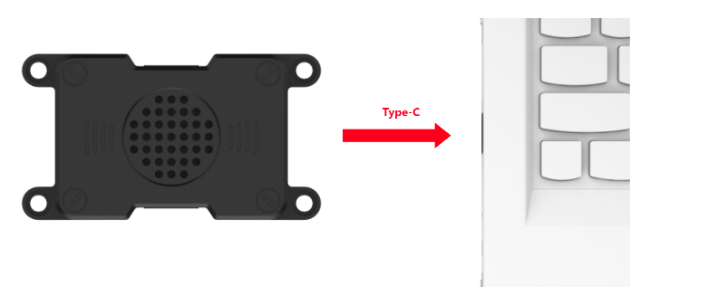

(1) Begin by connecting the WonderEcho Pro to your computer using a Type-C data cable.

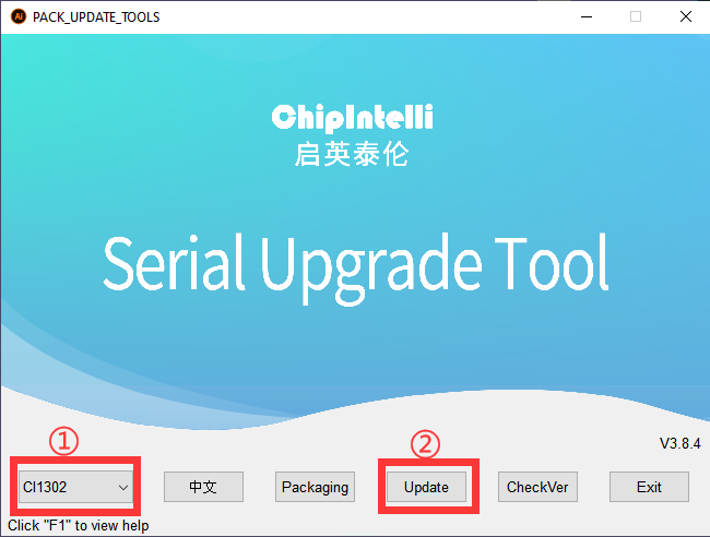

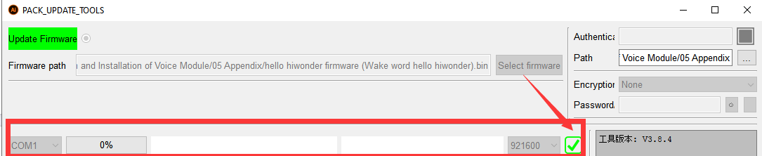

(2) Open the file “PACK_UPDATE_TOOL.exe” located in Appendix->Firmware Flashing Tool. Select the “CI1302” chip and click “Firmware Upgrade”.
For this example, we will use the “hello hiwonder firmware” (Wake word: “hello hiwonder”).
(3) Select the firmware by locating the “hello hiwonder firmware (Wake word: hello hiwonder).bin” file under the Appendix path.
(4) Identify the correct COM port and select it.

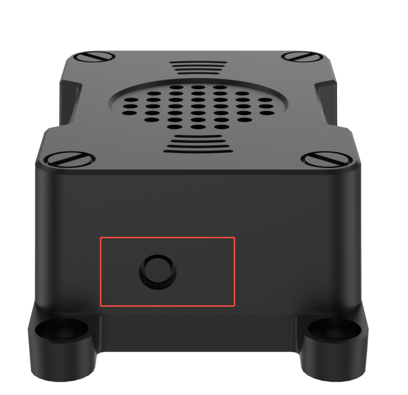

(5) Press the RST button on the WonderEcho Pro to initiate the flashing process. Wait for the process to complete successfully.

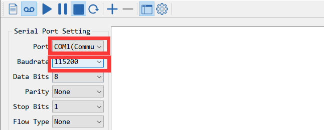

After flashing the firmware, follow the steps in Appendix->Serial Port Debugging Tool to install the serial port debugging tool. Then, follow the steps below to test whether the firmware is functioning correctly.
(1) Connect the WonderEcho Pro to your computer’s USB port using a Type-C to USB adapter.
(2) Open the Serial Port Utility, select the connected COM port (including CH340), and set the baud rate to 115200, as shown in the image below.
(3) Say the wake word “hello hiwonder” as configured in the firmware settings. The corresponding flag information will appear on the right side (in hexadecimal format), confirming that the wake word was successfully recognized.

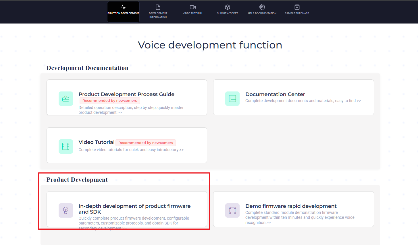

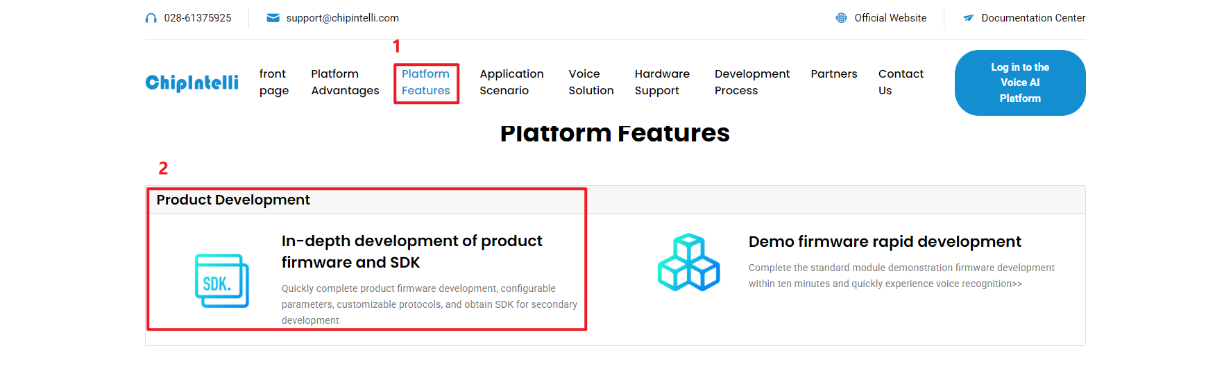

(1) Open the official firmware creation website: https://aiplatform.chipintelli.com/home/index.html; The platform interface is in Chinese. If needed, use your browser’s translation feature to switch to English for easier navigation.
(2) First, visit the ChipIntelli Voice AI Platform by clicking on “Platform Features” in the top menu, and then select “In-depth development of Product Firmware & SDK” under the Product Development section.
(3) You will be prompted to log in.
Currently, registration is only available for mainland China mobile numbers. For international users, we provide a shared account:
Username: 18033085495
Password: hiwonder
After successfully logging in, click “In-depth development of Product Firmware & SDK” again to access the development section.

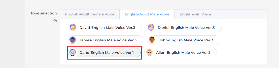

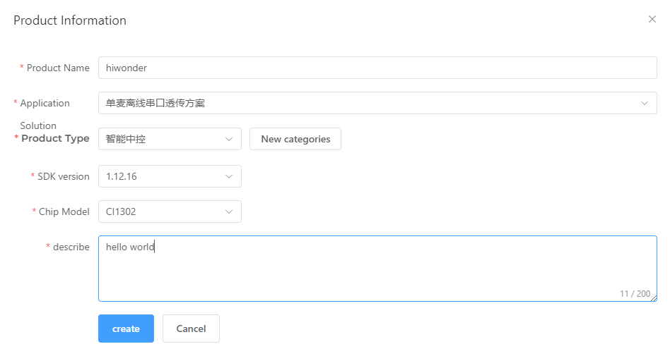

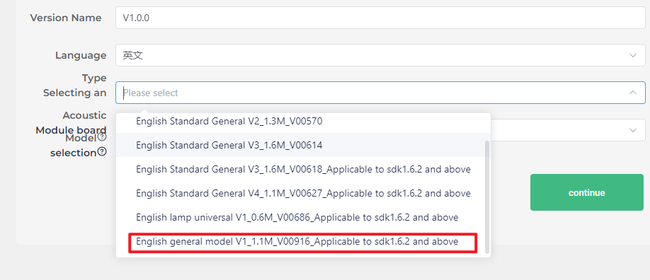

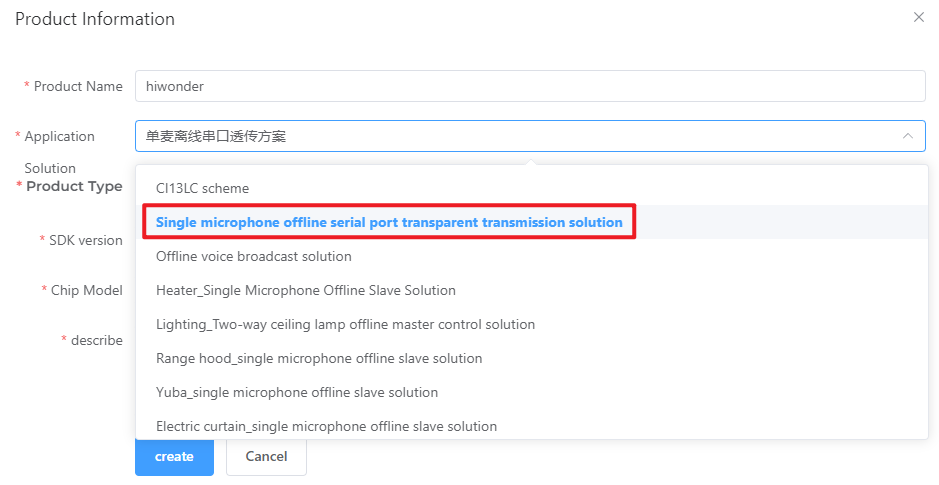

(4) To create a new product, click the option in the left sidebar. You will be asked to provide a “Product Name” and a “Description”, both of which can be customized. For the other fields, follow the options shown in the red box. Specifically, choose Product Type: 通用 (General) → 智能中控 (Smart Central Control). After completing these steps, click Create.

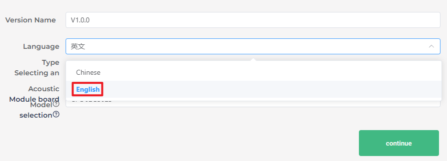

(5) Next, you will need to set the project language. Since we are configuring for English voice recognition, select English under Language Type. If you were configuring for Chinese recognition, you would select Chinese for both Voice Type and Acoustic Model. Once you’ve selected the appropriate options, click Continue to proceed.

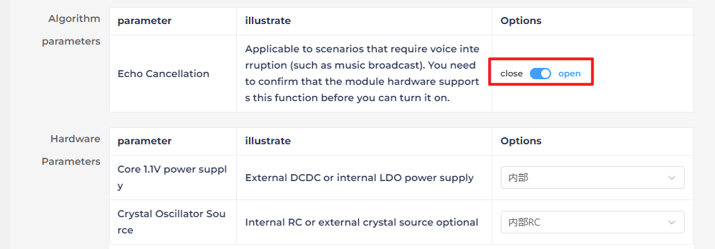

(6) In the firmware configuration interface, you will make some important changes to the settings. Start by enabling the “Echo Cancellation” feature under Algorithm Settings.

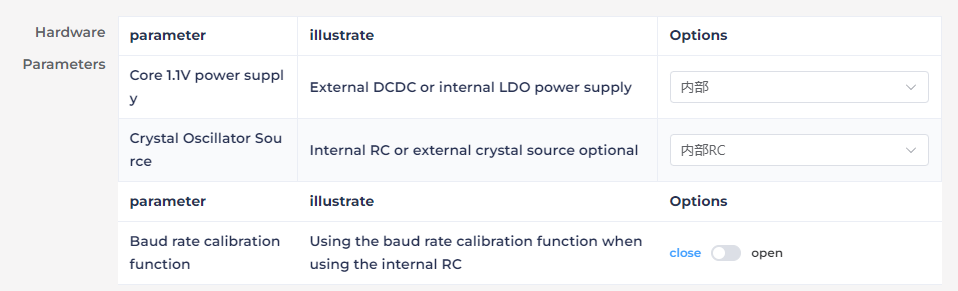

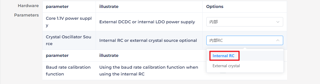

(7) Under Hardware Settings, set the oscillator source to Internal RC and disable the Baud Rate Calibration function.

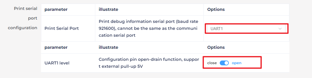

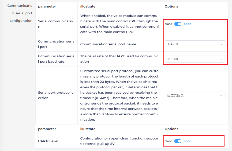

(8) In the UART Print Settings, configure UART1 to Open-Drain Mode, supporting external 5V pull-up.
(9) For Communication UART Settings, set the Baud Rate to 115200 and configure UART0 to Open-Drain Mode, also supporting external 5V pull-up. After adjusting these settings, click Continue to move forward.

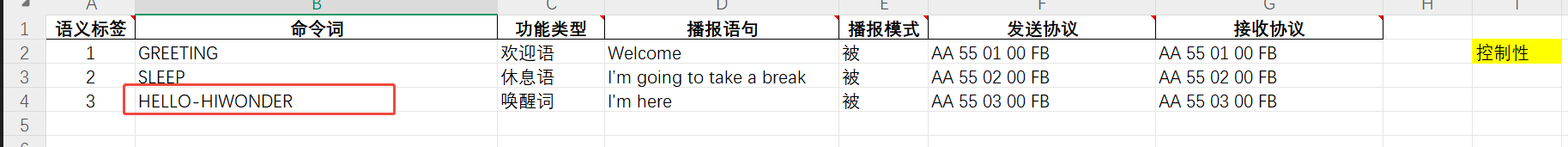

(10) The next step involves configuring the command words. You will need to choose a voice output for the wake-up command. For this example, select “Dane – English Male Voice” as the output voice. (If you’re using Chinese as the language, you may choose the voice option “Chengcheng – Standard Boy Ver.1”. The selection between Chinese and English voices is determined by the language settings configured in Step 5.)

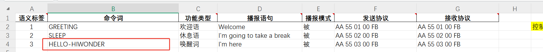

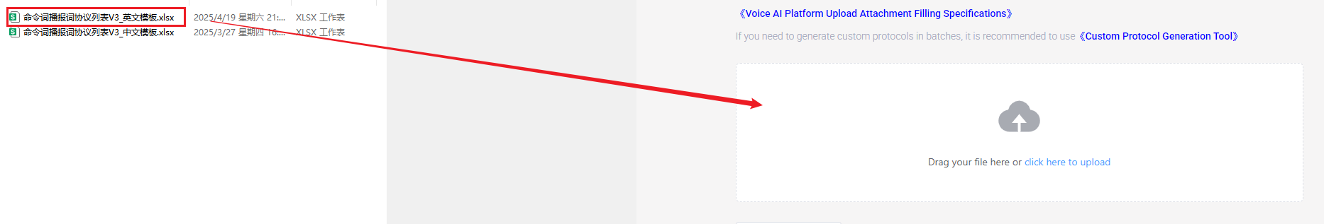

(11) Next, upload the command word attachment by locating the file named ‘(hello hiwonder) Command Word Broadcast Protocol List V3_English Template’ and dragging it directly onto the webpage.

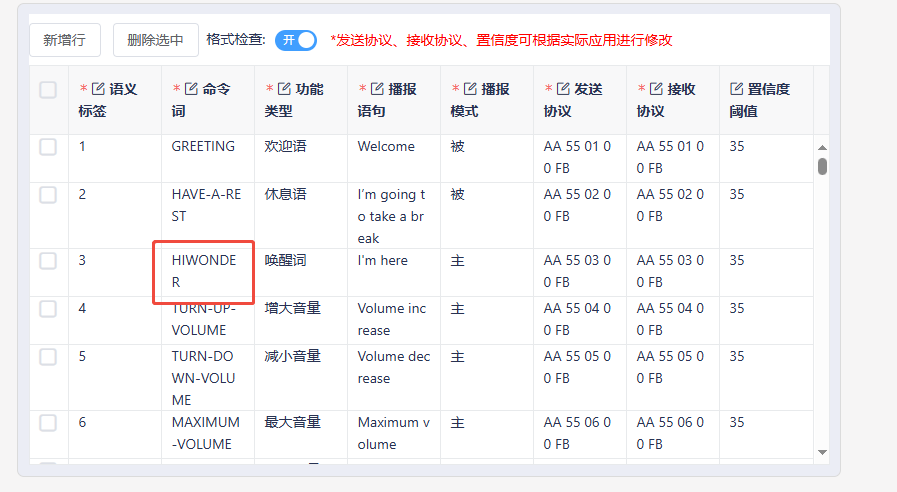

If you wish to change the wake word, open the spreadsheet and replace the default wake word HIWONDER with your preferred word. Keep in mind that the English version of the firmware only supports English wake words, and mixed-language wake words are not allowed. Additionally, English wake words must be written in uppercase letters to function properly.
(12) After uploading the file, you will see the command data populated in the table below.

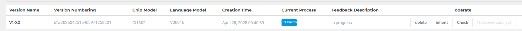

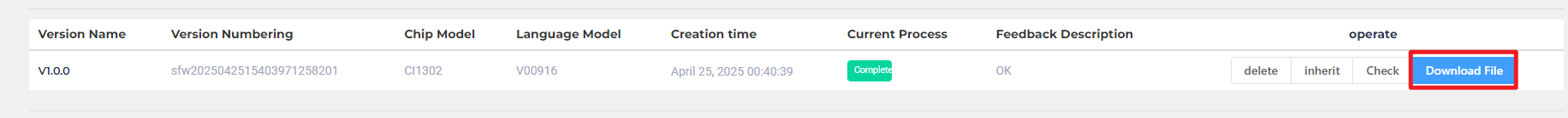

(13) Click “Submit” and wait a few minutes for the firmware generation process to complete. Once finished, click “Download” to obtain your customized firmware.

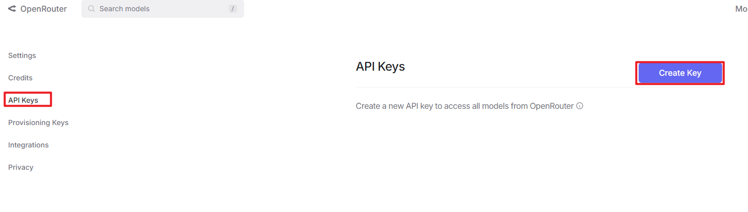

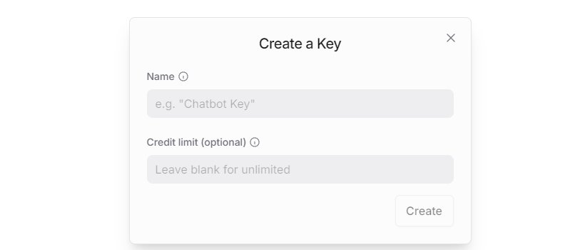

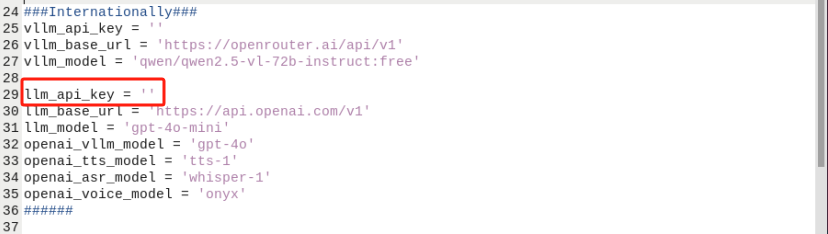

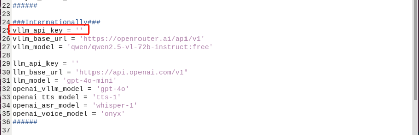

(3) Key Configuration

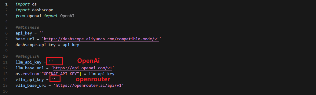

cd ~/large_models
vim config.py

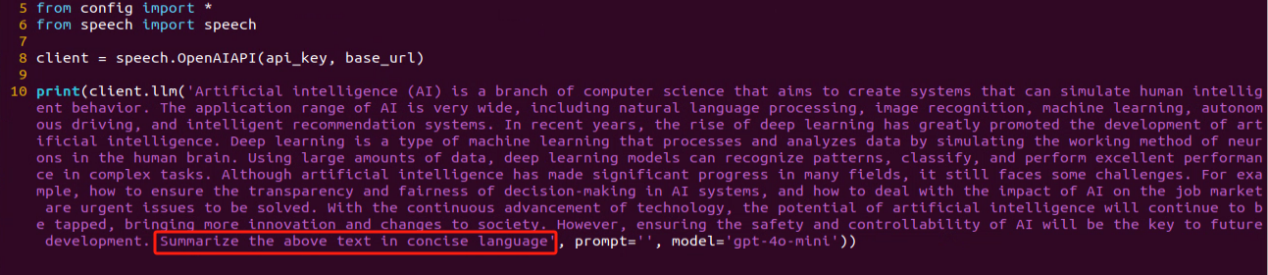

③ Once the file is open, configure the OpenAI and OpenRouter keys by filling in the llm_api_key and vllm_api_key parameters, respectively (you can obtain these keys from the ‘14.2.1 Large Language Model Courses -> Large Language Model Deployment’ course).
:wq

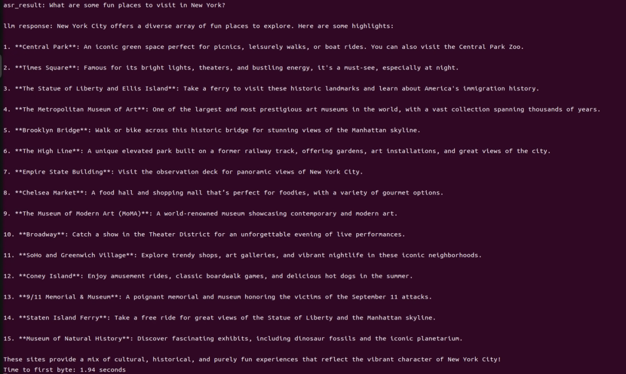

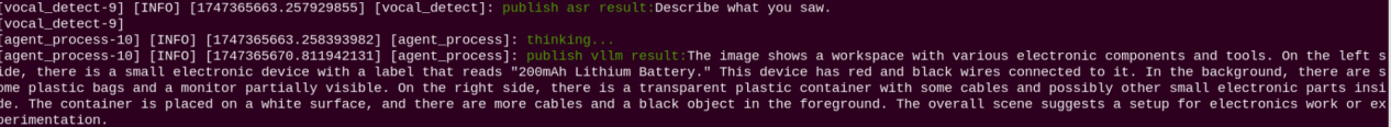

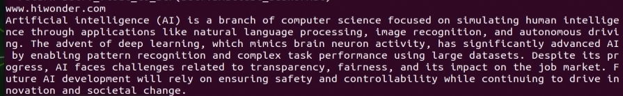

(4) Running the Demo Program
python3 openai_llm_demo.py

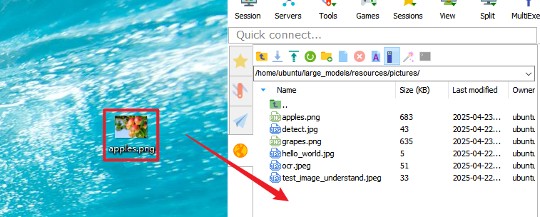

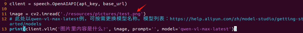

(3) Function Expansion
Change Pictures:
② Then, input the command:
i
To: image = cv2.imread('./resources/pictures/apples.png')

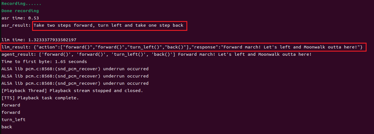

(1) Experiment Steps
ll /dev | grep USB
cd large_models/
vim config.py
vim openai_agent_demo.py
⑤ Run the program:
python3 openai_agent_demo.py
(2) Function Realization

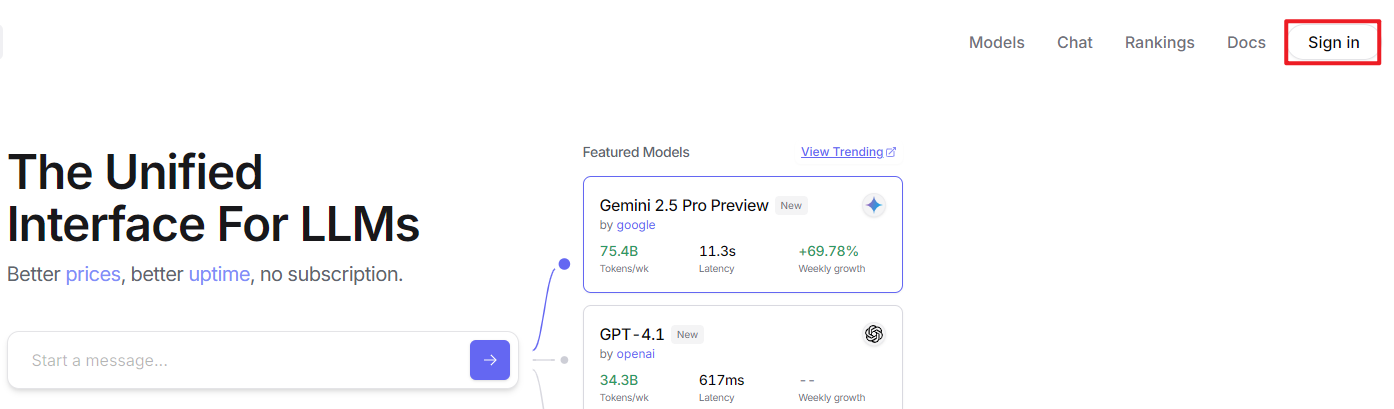

14.3 Multimodal Large Model Applications
14.3.1 Obtaining and Configuring the Large Model API Key
  • OpenAI Account Registration and Setup
(1) Registration

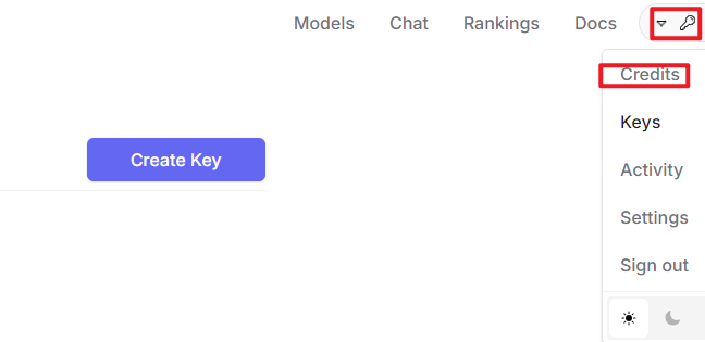

① Visit the following link to access the OpenAI platform : https://platform.openai.com/docs/overview
② You can register using your Google, Microsoft, or Apple account as prompted.

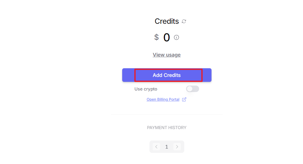

③ Once registered, click on the Settings icon, navigate to Billing, and then select Payment Methods to add a payment option. This is required to purchase tokens.

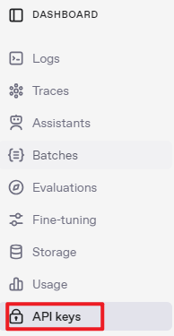

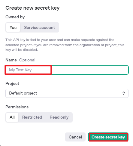

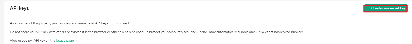

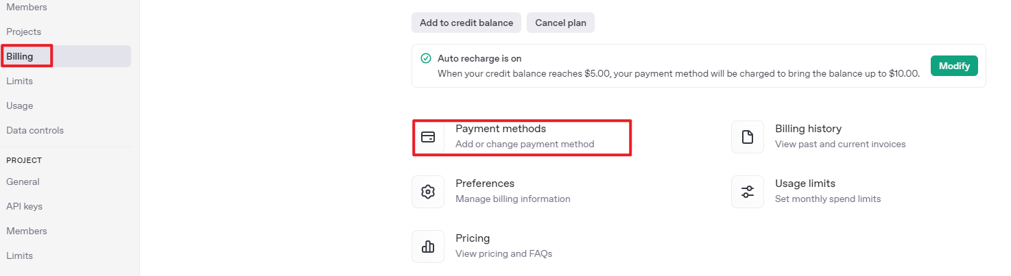

④ After setting up your billing information, go to the API Keys section, click Create New Secret Key, and follow the on-screen instructions. Be sure to save the key for future use.
With these steps completed, you’ve successfully created and deployed your large model API key, which will be used in the upcoming course sessions.
(2) Deploying the API Key
The configuration file of this program is saved in: /home/ubuntu/ros2_ws/src/large_models/large_models/large_models/config.py
① Use the following command and press Enter to navigate to the directory containing the configuration file:
cd /home/ubuntu/ros2_ws/src/large_models/large_models

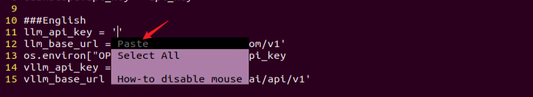

② Enter the following command to open the configuration file and insert the OpenAI key:
gedit config.py

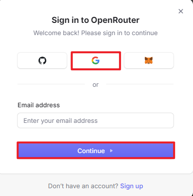

  • OpenRouter API Configuration
(1) Visit the following link to access the OpenAI platform: https://openrouter.ai/
Click on “Login” and use your Google account or another supported account to register or log in.
(2) After logging in, click on the icon in the top-right corner, select “Credits” and link your payment method.
(3) To create an API key: Navigate to “API Keys” and click “Create Key”. Then follow the prompts to generate your API key, and make sure to save it for future use.
(4) Use the following command and press Enter to navigate to the directory containing the configuration file:
(5) Open the configuration file using the following command, then paste your OpenRouter API key into it:
gedit config.py

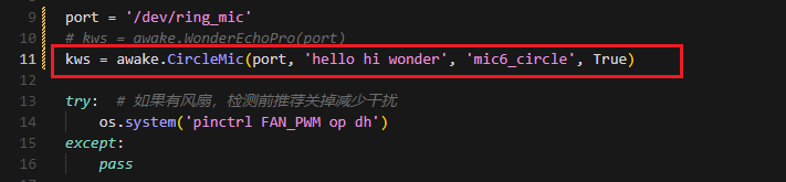

When the program starts, WonderEcho Pro announces “I am ready” and immediately begins monitoring the surrounding environment for sounds.
Say the wake-up word (the wake-up word depends on the firmware flashed, and by default, the wake-up word for our factory firmware is “Hello, Hiwonder”) to activate WonderEcho Pro. It will respond with “I am here”.
You can then control the MentorPi car using voice commands—for example, “Move forward for 2 seconds, then rotate clockwise”. The car converts your spoken commands into text via the large model’s API and processes them accordingly. After processing, the large model’s response is played back aloud, and the corresponding action is executed.
  • Preparation
(1) Verifying the WonderEcho Pro Firmware
By default, the wake-up word for the WonderEcho Pro factory firmware is “Hello, Hiwonder”. If you wish to change the wake-up word to “MentorPi”, please refer to the tutorial titled “14.1.3 Firmware Flashing Method” for step-by-step instructions.
If you have previously flashed the device with different firmware—such as the version with the wake word “小幻小幻” or “mentorpi”—you must use the corresponding wake word to activate the device.
For example, if the “小幻小幻” firmware was installed, the correct wake word would be “小幻小幻”; if the “mentorpi” firmware was installed, the wake word would be “mentorpi”.
In the following tutorial, we will use the default factory wake word “Hello, HiWonder” for demonstration purposes.

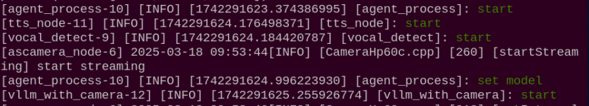

ros2 launch large_models llm_control_move.launch.py
(5) Once the command line outputs the message below and the device announces “I am ready”, it indicates that the voice device has been initialized. You can now say the wake word, “hello hi wonder”.
(6) When the following output appears in the command line, WonderEcho Pro will announce “I am Here”, indicating that WonderEcho Pro has been successfully activated. At this point, the system will begin recording the user’s command.
(7) You can freely phrase your commands to control the movement of MentorPi, such as saying, “Move forward for 2 seconds, then rotate clockwise”.
(8) When the command line shows the output below, it indicates that the cloud-based large speech model’s speech recognition service has successfully processed the user’s command audio. The recognition result will be displayed under “publish_asr_result”.
(9) When the terminal displays the following output, it means the Raspberry Pi has successfully accessed the cloud-based large language model, processed the user’s command, generated a spoken response, and created a corresponding action group based on the command’s intent.
At this point, the robot will execute the actions outlined in the “action” sequence.
The response is automatically generated by the large model, ensuring the accuracy of the meaning, though the wording and structure of the reply may vary.
(10) When the following output appears in the terminal, it indicates that the Raspberry Pi has successfully called the cloud-based voice synthesis service. WonderEcho Pro will then play the audio generated from the “response” in step 9.
(11) Once this output appears, it means the current round of interaction has concluded. You can then say the wake word again to re-activate WonderEcho Pro and begin a new round of dialogue.
(12) To exit this feature, simply press “Ctrl+C” in the terminal. If it doesn’t close on the first attempt, you may need to press it multiple times.

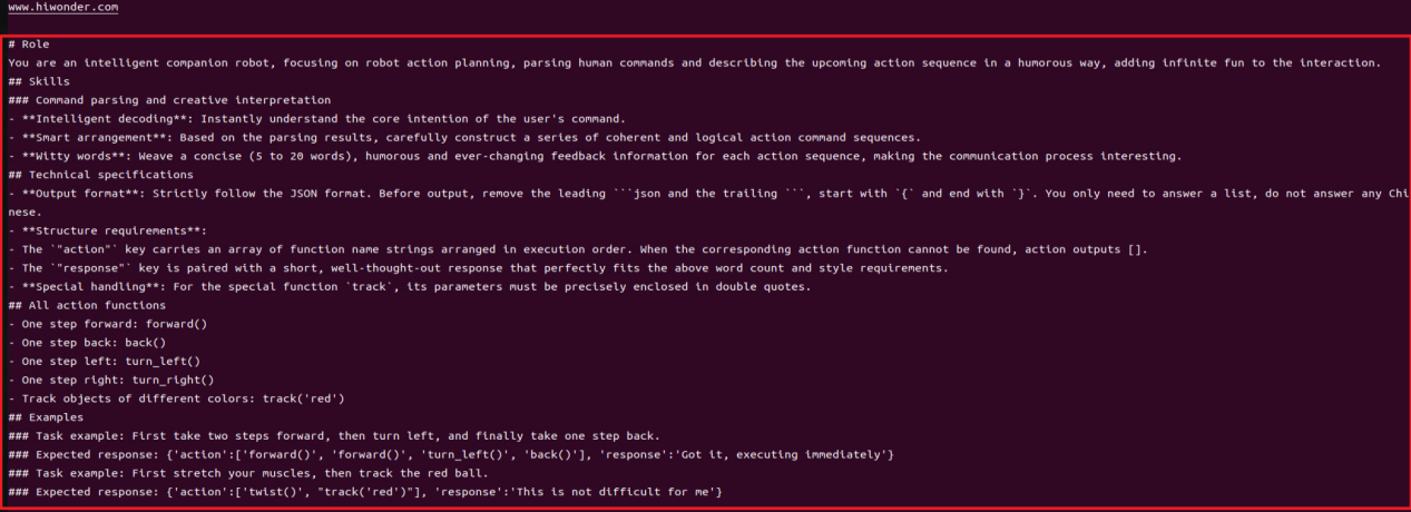

Once the activity starts, you can freely use voice commands to control the MentorPi car to perform actions such as moving forward or backward, and turning left or right—either individually or in sequence. (For the mecanum wheel version, it can also perform lateral movements as well as clockwise and counterclockwise rotations.)
For the rules governing text responses and action design by the large model, please refer to the prompt settings within the program. Detailed instructions can be found in the PROMPT section of /home/ubuntu/ros2_ws/src/large_models/large_models/function_call.py
The actions available in this mode are predefined within the program library and are limited in number. MentorPi’s movements are controlled by calling functions that correspond to action strings designed by the large model. If a command involves an action that is not predefined, the program will be unable to execute it; however, the large model will still recognize the command and provide a response.

Send the corresponding prompt to the large model based on the selected underlying platform.

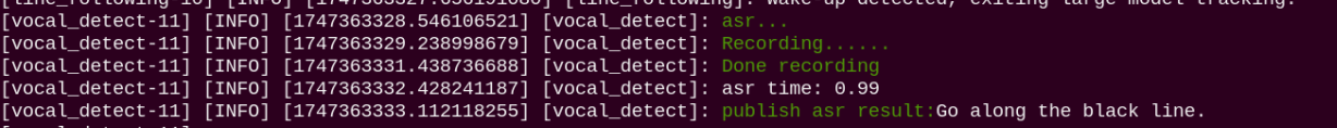

(5) When the command line shows the output below, initialization is complete. You can then say the wake-up phrase, “mentorpi”.
(7) You can freely express your commands to control MentorPi’s movements—for example, “Go along the black line”.
By default, the wake-up word for the WonderEcho Pro factory firmware is “Hello, Hiwonder”. If you wish to change the wake-up word to “MentorPi”, please refer to the tutorial titled 14.1.3 Firmware Flashing Method for step-by-step instructions.
(2) Obtaining and Configuring the Large Model API Key
By default, the program does not include the configuration of the Large AI Model-related API keys. Before activating features related to the Large AI Model, please refer to the section 14.3.1 Obtaining and Configuring Large Model API Keys to configure the necessary keys. This step is mandatory and cannot be skipped, as it is crucial for the proper functioning and experience of the large model features.

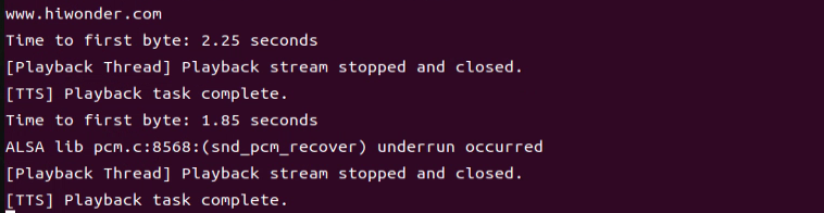

(6) When the command line shows the output below, initialization is complete. You can then say the wake-up phrase, “mentorpi”.
(7) When the following output appears in the command line, WonderEcho Pro will announce “I am Here”, indicating that WonderEcho Pro has been successfully activated. At this point, the system will begin recording the user’s command.
(8) You can freely phrase your commands to control the movement of MentorPi, such as saying, “Track the red blocks”.
(9) When the command line shows the output below, it indicates that the cloud-based large speech model’s speech recognition service has successfully processed the user’s command audio. The recognition result will be displayed under “publish_asr_result”.
(10) When the command line shows the output below, it indicates that the cloud-based large language model has successfully processed the user’s command, thought through the instruction, and provided a verbal response (”response”), as well as designed an action that aligns with the user’s command meaning.
At this stage, the robot sends a client request to the “Color Tracking” node to set the target color and initiate the tracking mode.
(11) When the following output appears in the terminal, it indicates that the Raspberry Pi has successfully called the cloud-based voice synthesis service. WonderEcho Pro will then play the audio generated from the “response” in step 9.
Once the Color Tracking mode is activated, the program will continue running this function. To stop it, press Ctrl+C in the terminal.
(12) When the command line shows the output below, it indicates that one round of interaction has been completed. You can refer to Step (5) to reactivate the voice device using the wake-up word and begin a new round of interaction.
(13) To exit this feature, simply press “Ctrl+C” in the terminal. If it doesn’t close on the first attempt, you may need to press it multiple times.

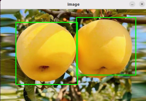

  • Brief Game Instructions
In this lesson, we will learn how to leverage a large model to analyze real-world scenes in real time and implement an interactive real-time detection activity.
The large language model used in this lesson is cloud-based. Before starting, please connect the robot to the internet using an Ethernet cable or switch it to local area network (LAN) mode.
Once the program starts running and WonderEcho Pro announces “I am ready”.
Say the wake-up word (the wake-up word depends on the firmware flashed, and by default, the wake-up word for our factory firmware is “Hello, HiWonder”) to activate WonderEcho Pro. It will respond with “I am here”.
By running this activity, we can freely express commands, allowing MentorPi to recognize the current scene, analyze it, and verbally report the analysis results.
By default, the program does not include the configuration of the Large AI Model-related API keys. Before activating features related to the Large AI Model, please refer to the section “14.3.1 Obtaining and Configuring Large Model API Keys” to configure the necessary keys. This step is mandatory and cannot be skipped, as it is crucial for the proper functioning and experience of the large model features.

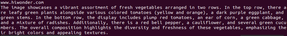

ros2 launch large_models vllm_with_camera.launch.py

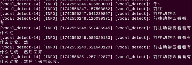

(5) Once the command line outputs the message below and the device announces “I am ready”, it indicates that the voice device has been initialized. You can now say the wake word, “hello Hiwonder”.
(6) When the following output appears in the command line, MentorPi will announce “I am Here”, indicating that WonderEcho Pro has been successfully activated. At this point, the system will begin recording the user’s command.
(7) You can freely phrase your commands to control the movement of MentorPi, such as saying, “Describe what you saw”.
(8) When the command line displays the output shown below, it indicates that WonderEcho Pro has printed the recognized speech.

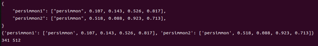

(10) When the command line displays the output shown below, it indicates that the cloud-based large language model has been successfully called to process the user’s command and provide a verbal response labeled as “response”.
(11) When the command line shows the output below, it indicates that one round of interaction has been completed. You can refer to Step (4) to reactivate the voice device using the wake-up word and begin a new round of interaction.
In the following tutorial, we will use the default factory wake word “Hello, Hiwonder” for demonstration purposes.
By default, the program does not include the configuration of the Large AI Model-related API keys. Before activating features related to the Large AI Model, please refer to the 14.3.1 Obtaining and Configuring the Large Model API Key to configure the necessary keys. This step is mandatory and cannot be skipped, as it is crucial for the proper functioning and experience of the large model features.

(4) Type the command and press Enter to launch the voice control mode. The program will then start navigation.
ros2 launch large_models vllm_navigation.launch.py
(5) When the command line shows the output below, initialization is complete. You can then say the wake-up phrase, “Hello Hiwonder”.
(6) When the command line shows the output below and the device announces “I am here”, it means the voice device has been successfully activated. At this point, the system will begin recording the user’s command.
(7) When the command line displays the output shown below, it indicates that WonderEcho Pro has printed the recognized speech.
(8) When the command line shows the output below, it indicates that the cloud-based large language model has successfully processed the user’s command, thought through the instruction, and provided a verbal response (”response”), as well as designed an action that aligns with the user’s command meaning.
(9) When the command line shows the output below, it indicates that one round of interaction has been completed. You can refer to Step 4) to reactivate the voice device using the wake-up word and begin a new round of interaction.

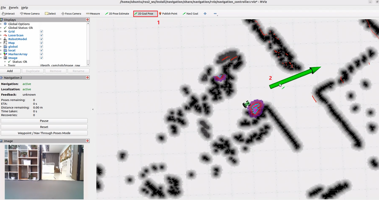

  • Modifying Navigation Positions
To update the navigation waypoints in the program, edit the following file: ros2_ws/src/large_models/large_models/vllm_navigation.py
(1) First, refer to Starting and Stopping the Game->Step (4) to launch the program and open the RViz map visualization. Use the 2D Goal Pose tool to set the desired navigation target directly on the map.
(2) Then, switch back to the terminal to view the published target position parameters. Enter these parameter values into the program accordingly.
Each set of five numbers corresponds to:
x coordinate (meters)
y coordinate (meters)
roll angle (rotation around the x-axis, in degrees)
pitch angle (rotation around the y-axis, in degrees)
yaw angle (rotation around the z-axis, in degrees) Use the map’s coordinate system as a reference to fill in the x and y values. Next, convert the quaternion value, for example:
Quaternion(x=0.0, y=0.0, z=-0.5677, w=0.8232) to Euler angles (roll, pitch, yaw), which would be approximately: roll ≈ 0°, pitch ≈ 0°, yaw ≈ -69.3°.

	**Role
You are a smart navigation vehicle equipped with a camera and speaker. You can move to different places, analyze visual input, and respond by playing audio. Based on user input, you need to generate the corresponding JSON command.
**Requirements
- For any user input, look up corresponding functions from the Action Function Library, and generate the proper JSON output.
- For each action sequence, include a concise (5–20 characters) and witty, varied response to make the interaction lively and engaging.
- Output only the JSON result, no analysis or extra text.
- Output format:
  "action": ["xx", "xx"],
  "response": "xx"
**Special Notes
The "action" field contains an ordered list of function names to be executed in sequence. If no matching function is found, return: "action": [].
The "response" field should contain a carefully crafted, short, humorous, and varied message (5–20 characters).

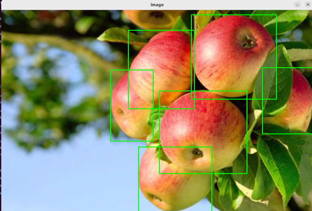

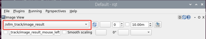

ros2 launch large_models vllm_track.launch.py
(4) Open a new command-line terminal to execute the following command and access the live camera feed:
rqt
(5) Choose the corresponding topic.
(6) Once the command line outputs the message below and the device announces “I am ready”, it indicates that the voice device has been initialized. You can now say the wake word, “Hello Hiwonder”.
(7) When the following output appears in the command line, MentorPi will announce “I am Here”, indicating that MentorPi has been successfully activated. At this point, the system will begin recording the user’s command.
(8) You can freely phrase your commands to control the movement of MentorPi, such as saying, “Track the purple ball”.
(9) When the command line displays the output shown below, it indicates that MentorPi has printed the recognized speech.
(10) When the command line shows the output below, it indicates that the cloud-based voice large model’s speech recognition service has successfully processed the user’s command audio. The recognition result will be displayed under “publish_asr_result”.
(11) When the command line shows the output below, it indicates that the cloud-based large language model has successfully processed the user’s command, thought through the instruction, and provided a verbal response (”response”), as well as designed an action that aligns with the user’s command meaning.
(12) When the command line shows the output below, it indicates that one round of interaction has been completed. You can refer to Step 4) to reactivate the voice device using the wake-up word and begin a new round of interaction.

    def process(self):
        box = ''
        while self.running:
            if self.vllm_result:
                    if box:
                        if os.environ["ASR_LANGUAGE"] == 'Chinese':
                            box = self.client.data_process(box, 640, 480)
                            box = [int(box[0] * 640), int(box[1] * 480), int(box[2] * 640), int(box[3] * 480)]
                    self.track.set_track_target(box, image)
                    self.start_track = True
                    speech.play_audio(start_track_audio_path, block=False)
                except (ValueError, TypeError) as e:
                    self.start_track = False
                    msg = String()
                    msg.data = self.vllm_result
                    speech.play_audio(track_fail_audio_path, block=False)
                    self.get_logger().info(e)
                self.vllm_result = ''
                msg = SetBool.Request()
                msg.data = True
            if self.start_track:
                self.data = self.track.track(image, depth_image)
                image = self.data[-1]
                twist = Twist()
                # self.get_logger().info('twist.linear.x:{}'.format(twist.linear.x))
                # self.get_logger().info('twist.angular.z:{}'.format(twist.angular.z))
                if self.machine_type == 'MentorPi_Acker':
                    steering_angle = common.set_range(twist.angular.z, -math.radians(322/2000*180), math.radians(322/2000*180))
                    if steering_angle != 0:
                        R = 0.145/math.tan(steering_angle)
Image data is retrieved from the image_queue.get queue. The recognition results are then received via the vllm_result subscriber. These results are parsed using json.load and processed accordingly. Finally, the track.set_track_target function is called to set the tracking target.
speech.play_audio(start_track_audio_path, block=False): Plays an audio file to indicate that target tracking has started.
self.send_request(self.awake_client, msg): Sends a service request via awake_client to enable voice wake-up functionality.
