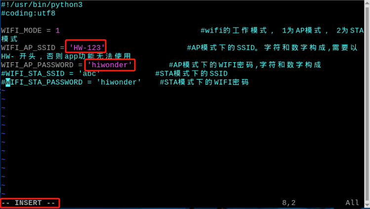

(3) Open the Wi-Fi configuration file using the Vim editor:
sudo vim wifi_conf.py
(4) Press the i key to enter edit mode. Locate the two lines of code related to the hotspot password (as shown in the reference image), and update the password as needed.
(5) After making the changes, press Esc to exit edit mode, then type :wq and press Enter to save and exit the file:
:wq

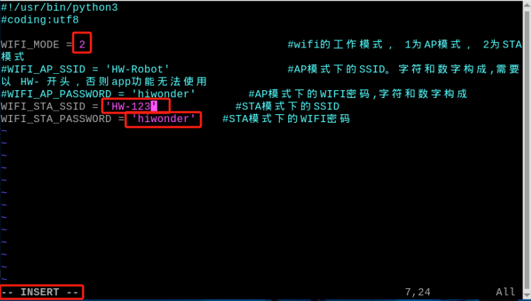

(3) Use the Vim editor to open the Wi-Fi configuration file:
(4) Press i to enter “edit mode”. Locate the three lines of code shown in the reference image and modify the Wi-Fi name and password as indicated.
Located the indicated codes.
Set the network mode to “2” to enable “LAN mode”. Use “HW-123” as the Wi-Fi name and “hiwonder” as the password—these should match the hotspot settings configured on the master device in 12.1.3 Network Configuration.
(5) Once editing is complete, press Esc to exit edit mode, then type :wq and press Enter to save and close the file:
:wq
(6) Reboot the device by entering the following command (this step is required):
sudo reboot

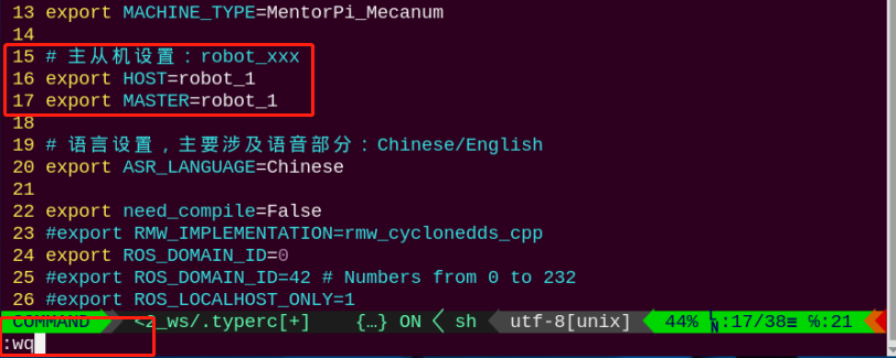

(5) Open the .typerc file to configure environment variables for the master device by entering:
vim /home/ubuntu/ros2_ws/.typerc
(6) Press the i key to enter edit mode. Enable the master-slave settings by setting the master to robot_1/.
(7) After making the changes, press Esc, then type :wq and press Enter to save and exit.

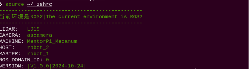

(8) Finally, enter the following command to apply the master configuration:
source ~/.zshrc

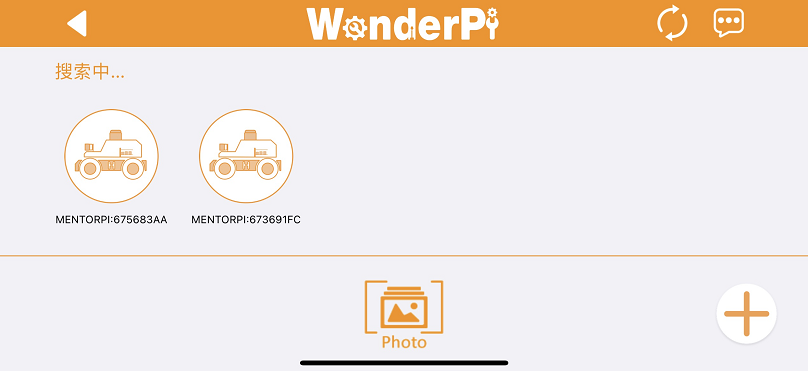

(1) Connect your mobile app to the Wi-Fi network generated by the master device. Perform a search, and you will see two car icons displayed. Long-press the icon representing the slave device to reveal its IP address. Use this IP to follow the instructions in “2. Set Development Environment -> 2.1 VNC Installation and Connection”.

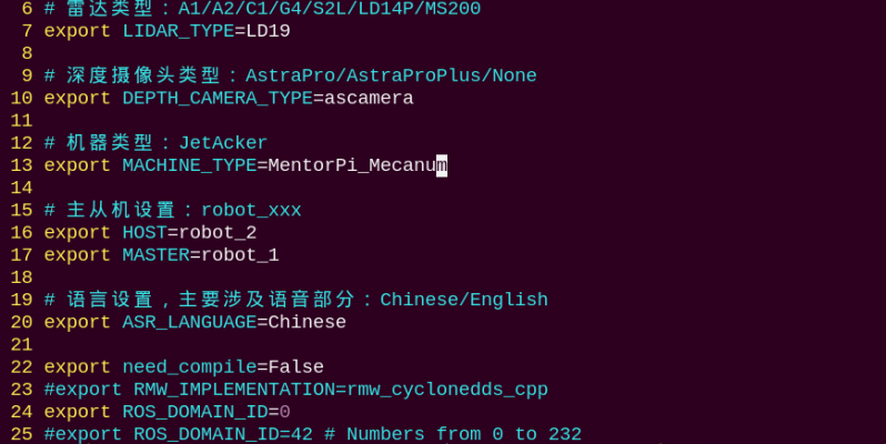

(2) After accessing the device, follow the steps in 12.1.4 Configure Environment Variable-> Configuring Environment Variables on the Master Device First, open the .typerc file and set the slave device’s environment variable HOST to robot_2. Then save and exit the file. Finally, run the command source ~/.zshrc to refresh the environment variables.
