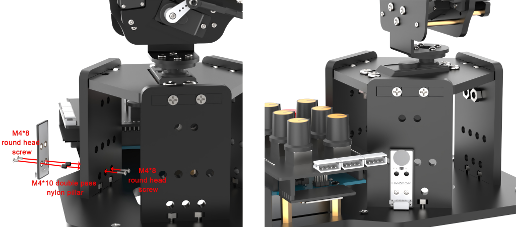

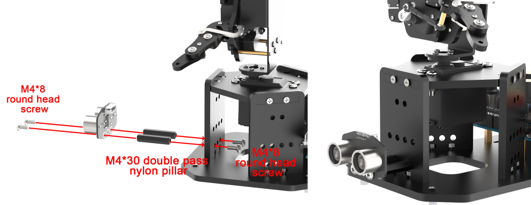

7.1 Sensor Installation and Wiring Installation

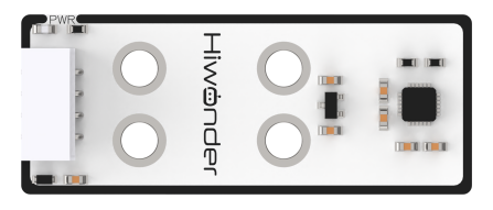

7.3 Ultrasonic Ranging
In this section, you can learn to detect the distance of obstacle through glowing ultrasonic module. To control the opening and closing of the robotic hand, and the color changing of RGB light.

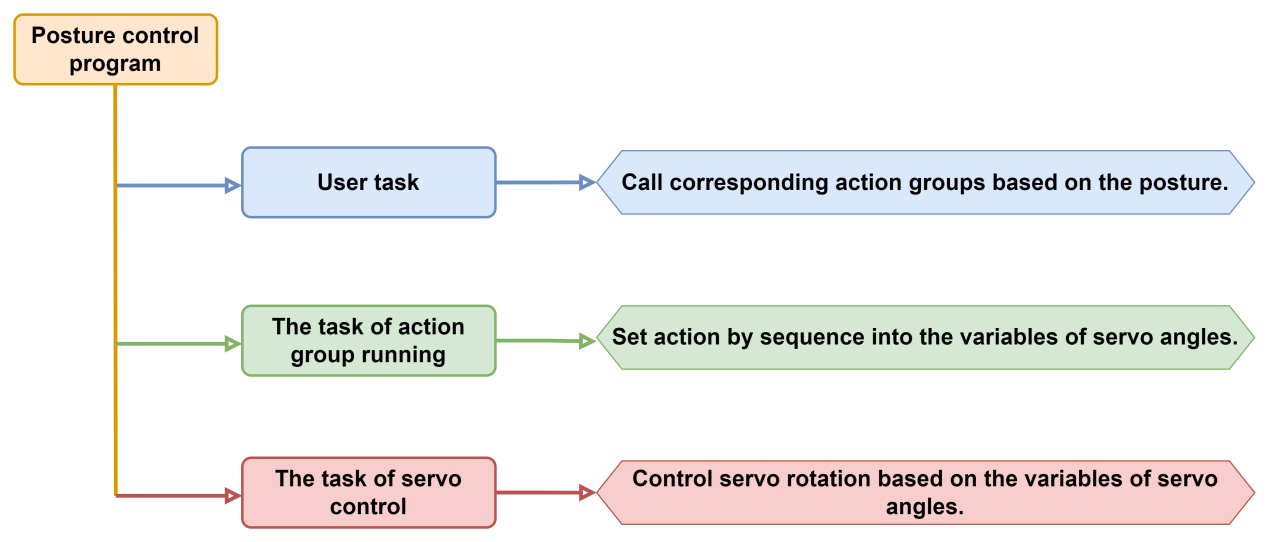

7.3.1 Program Flowchart

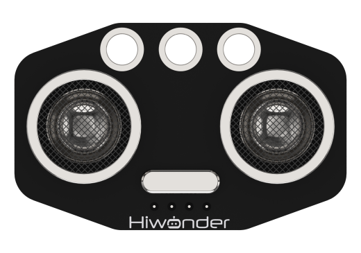

7.3.2 Ultrasonic Sensor

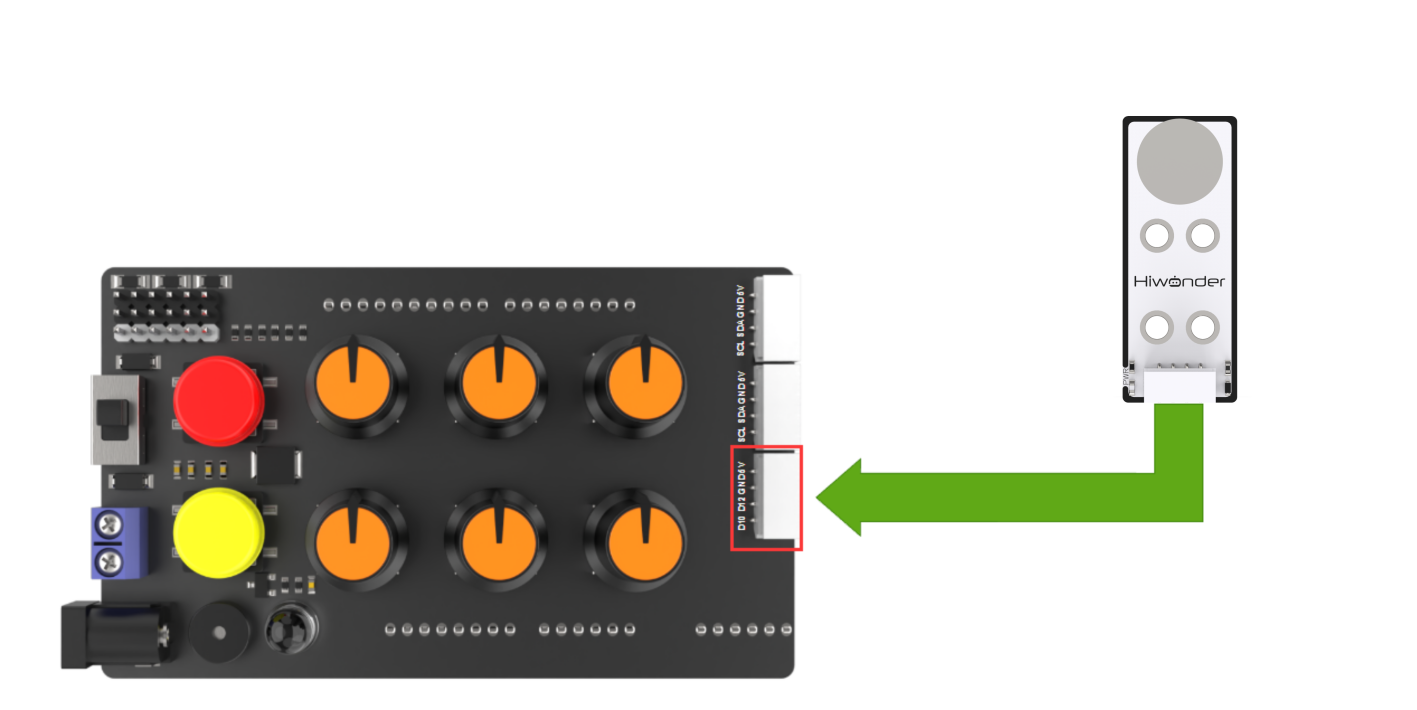

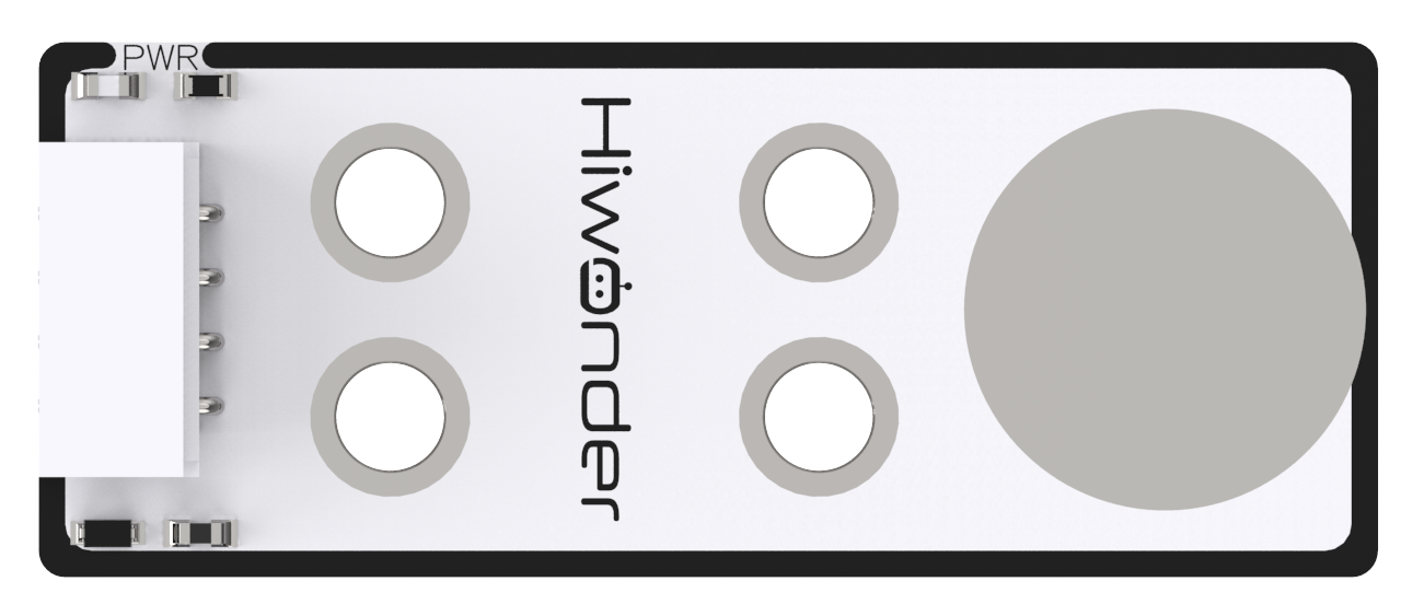

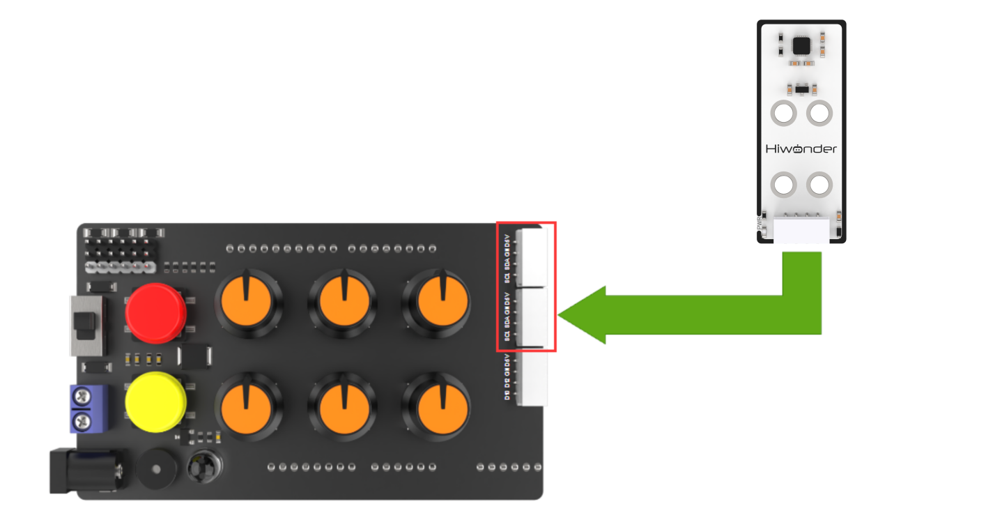

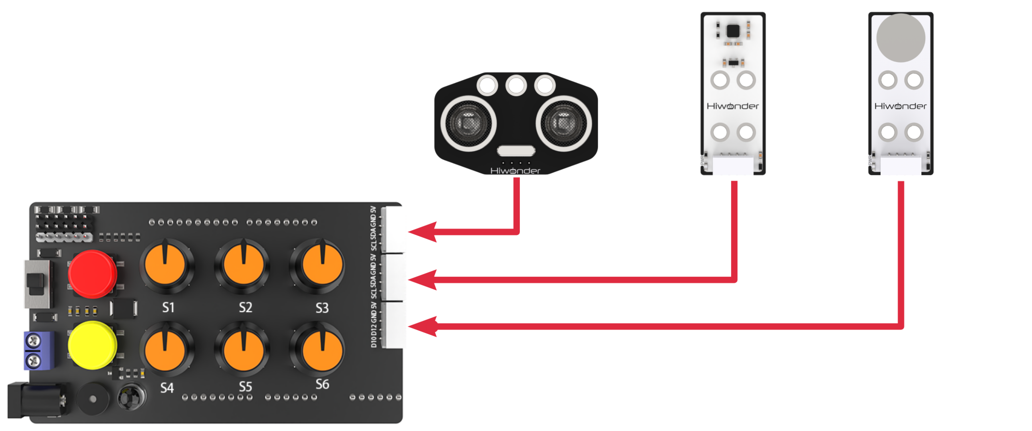

This is a glowing ultrasonic ranging module. It adopts an I2C communication interface, which can read the range measured by an ultrasonic sensor through I2C communication.
  • Wiring
Connect the ultrasonic module to an I2C interface on the expansion board with the 4Pin wire.

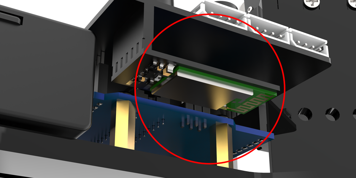

  • Remove the Bluetooth module before downloading the program. Or the program will fail to download because of the serial port conflict.

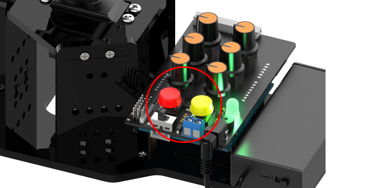

  • Please switch the battery box to the ‘OFF’ when connecting the Type-B download cable. This action prevents the download cable from accidentally touching the power pins of the expansion board, which may cause a short circuit.

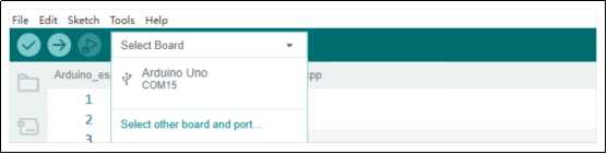

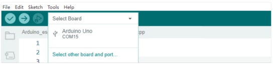

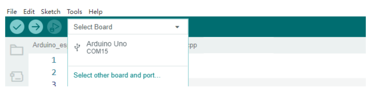

(1) Locate and open uhand_ultrasonic_ranging.ino program file in the same directory of this section.
(2) Connect Arduino to the computer with the UNO data cable (Type-B) .
(3) Click “Select Board”, and the software will automatically detect the current Arduino serial port. Next, click to connect.
(4) Click to download the program into Arduino. Then just wait for it to complete.

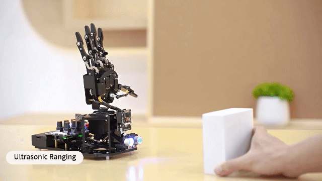

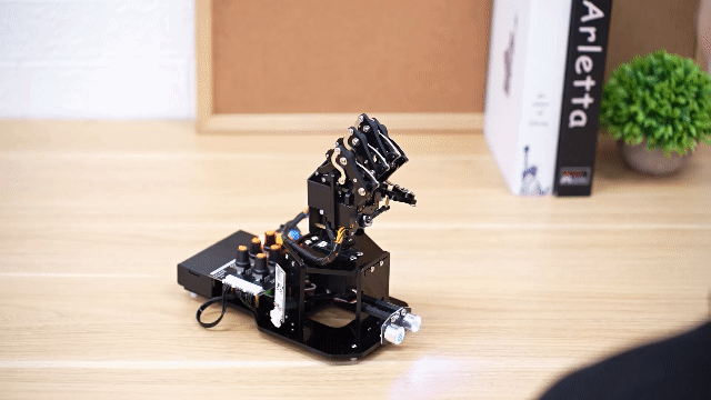

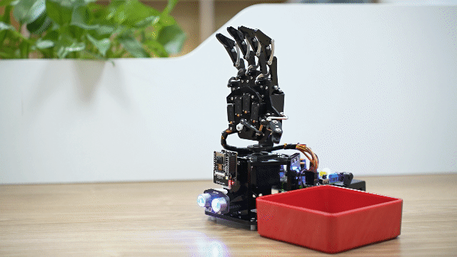

7.3.4 Program Outcome
When powered on, the robotic hand will return to the neutral position first. At the same time, the RGB lights on light-emitting ultrasonic module and the expansion board will turn blue.
Put the obstacle directly in front of the ultrasonic module and move it slowly towards the module.
(1) When the distance is more than 20cm, five fingers of the hand will open. At this time, the RGB lights on the ultrasonic module and the expansion board will turn blue;
(2) When the distance is 10cm to 20cm, the hand will close slowly as the obstacle get closer. At the same time, the RGB lights on the ultrasonic module and the expansion board will turn purple gradually;
(3) When the distance is less than 10 cm, the hand will close. At the same time, the RGB lights on the ultrasonic module and expansion board will turn red.

7.4 Ultrasonic Ball Grasping
In this section, you can learn how to use a glowing ultrasonic module to detect obstacle’s distance, and control the robotic hand to grasp and release a ball.
7.4.1 Program Flowchart
7.4.2 Ultrasonic Sensor
  • Wiring
7.4.3 Program Download
uhand_ultrasonic_grasp
  • Please switch the battery box to the “OFF” when connecting the Type-B download cable. This action prevents the download cable from accidentally touching the power pins of the expansion board, which may cause a short circuit.
(1) Locate and open “uhand_ultrasonic_grasp.ino” program file in the same directory of this section.
(2) Connect Arduino to the computer with the UNO cable (Type-B) .
7.4.4 Program Outcome
(1) When the glowing ultrasonic module does not detect an obstacle, the pan-tilt of the robotic hand remains in the neutral position mode.
(2) The buzzer on the expansion board makes a sound when the obstacle is recognized, while the RGB lights on the ultrasonic module and the expansion board turn green. At this time, if you put the ball in the center of the robotic hand, it will close to grasp the ball and rotate to the left side releasing the ball (from the robotic hand’s perspective). Next, it will return to the neutral position mode.
Note: After putting the ball, you need to move the ball out of the detection range of the glowing ultrasonic module. Or the robotic hand can not return to the neutral position mode.

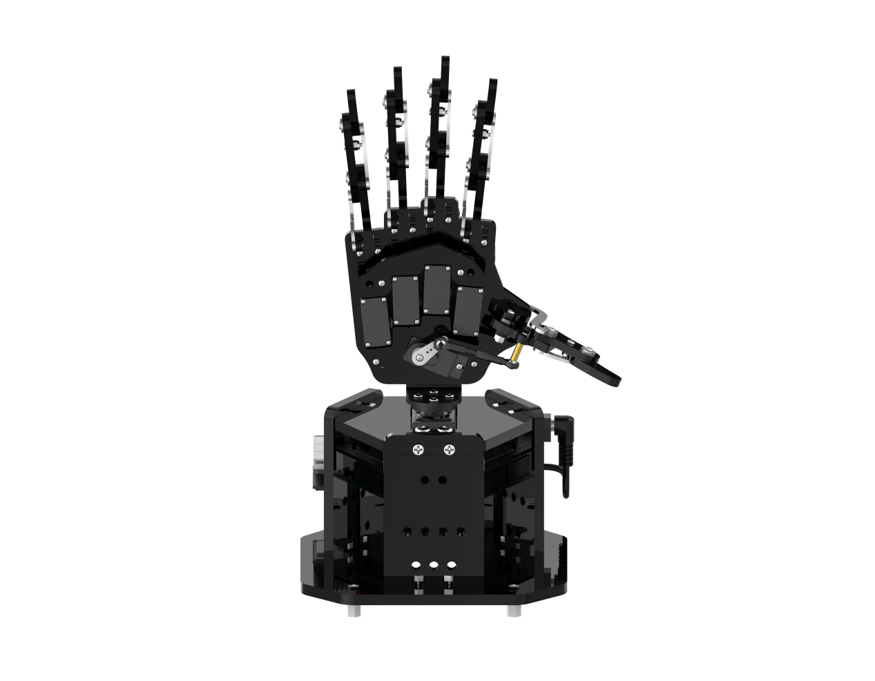

In this section, you will know how to control the number of fingers opened on the robotic hand by counting the number of times the touch sensor is pressed.
7.5.1 Program Flowchart
7.5.2 Touch Sensor
Based on the capacitive sensing principle, the touch sensor senses the touch from the human body or metal via its gold-plated contact surface.
  • Wiring
Connect the touch sensor to the D10 and D12 interfaces on the expansion board with the 4Pin wire, as shown below:

(1) Locate and open uhand_count_finger.ino at the same directory of this section.
(2) Connect Arduino to the computer with the UNO data cable(Type-B).

7.6 Posture Control
In this section, you will know how to control a robotic hand to grab and place items by reading the state of the X and Y axes of the acceleration sensor.
7.6.1 Program Flowchart

  • Wiring
Connect the acceleration sensor to any I2C interface on the expansion board with the 4Pin wire.

  • Call Subfunction in a Loop
After initialization, enter the loop main function, call the “user_task” function in turn, test the state of acceleration sensor and perform grasp and placement. Then call the tune_task function to perform buzzer task; call the servo_control function to control servo; call the action_ctl.action_taskfunction to call action group; call the update_mpu6050 function to update inclination data of acceleration sensor.
103
104
105
106
107
108
109
110
111
112
113
114
void loop() {
  // 用户任务(user task)
  user_task();
  // 蜂鸣器鸣响任务(buzzer sound task)
  tune_task();
  // 舵机控制(servo control)
  servo_control();
  // 动作组运动任务(action group running task)
  action_ctl.action_task();
  update_mpu6050();

    if (millis() - last_tick < 150) {
      return;
    last_tick = millis();
Case 0: represents that an action needs to be executed. Take the joint angle data of the current action (specified by “num”) of the current action group from “action” array and store it to “extended_func_angles” array.
If the joint angle data of current action is not 0 at all (that means the action has not been completed), set “step” to 1, which indicates the next step needs to wait for the execution of the action.
        if(action[action_num-1][num][0] != 0)
          extended_func_angles[0] = action[action_num-1][num][1];
          extended_func_angles[1] = action[action_num-1][num][2];
          extended_func_angles[2] = action[action_num-1][num][3];
          extended_func_angles[3] = action[action_num-1][num][4];
          extended_func_angles[4] = action[action_num-1][num][5];
          extended_func_angles[5] = action[action_num-1][num][6];
          step = 1;
If the joint angle data of current action is 0, this action group has finished execution. Reset num and action_num to 0, which means no action group needs to be executed.
        }else{ //若运行完毕(if the running is completed)
          num = 0;
          // 清空动作组变量(clear action group variable)
          action_num = 0;
Case 1: means that you need to wait for current action to complete.
Use delay_count for simple delay, with an increment of 1 each time. When “delay_count” is greater than 2, increase “num” by 1 to indicate the next action. Reset delay_count to 0 and reset “step” to 0, which are indicated that new actions can be executed.
      case 1: //等待动作运行(wait for the action to be executed)
        delay_count++;
        if(delay_count > 2)
          num++;
          delay_count = 0;
          step = 0;
        break;
Reset the value of step to 0 if it is not 0 or 1.
{lineno-start=}
      default:
        step = 0;
        break;
  • Servo Control

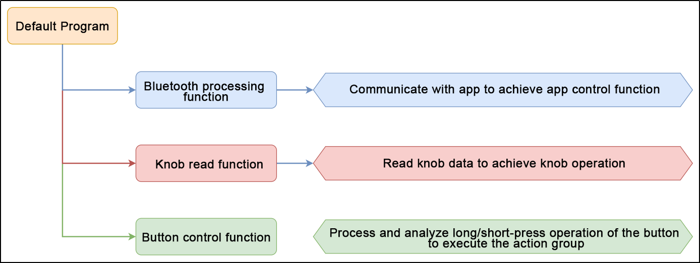

7.7 APP Remote Control
This section mainly explains the function realization for the control program of the robotic hand. Therefore, you can better understand and write the program.
7.7.1 Program Flowchart

(1) Locate and open uHand/uHand.ino program file in the same directory as this section.
(2) Connect Arduino to the computer with the UNO data cable (Type-B).

(1) When powered on, the robotic hand open and its pan-tilt returns to the initial position. At the same time, the RGB light on the expansion board turns white, which is the neutral position program.
(2) Press both buttons simultaneously for 1 second until RGB light turns green. This indicates that uHand UNO has unlocked the neutral position function and entered the knob control game.
(3) Long press K1 to clear the previous action group first and enter the action group editing mode. Then use the knob to control the position of the robotic hand and press K1 to record the current position into action group. Next, long press K1 to exit the action group editing mode and save the edited action group into “Falsh”. Then short press K2 to execute the action group.
The button instructions are shown below:
Mode Button Outcome
Neutral position (white light is steady on) Automatically enter the mode after powered on. Simultaneously hold down "K1, K2" to exit. ID1-6 servos are at 90 ° position.
Normal mode (green light is steady on) Long press the red "K1". Enter the editing action group mode to clear the original action group.
Short press the yellow "K2". Enter the running action group mode to run the saved action group once.
Long press the yellow "K2". Enter the running action group mode and loop run the saved action group.
Editing action group mode (red light is steady on) Short press the red "K1". Save action.
Long press the red "K1". Save the editing action group and exit to switch to the normal mode.
Running action group mode (yellow light is steady on) Short press the red "K1". Stop the running action group and switch to the normal mode.

7.7.4 Brief Program Analysis
uhand
  • Servo Neutral Position Function “servos_middle( )”
