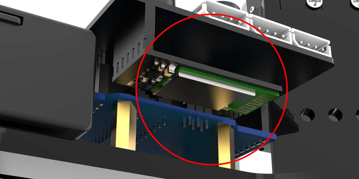

Step 1: Make sure the Bluetooth module is installed correctly on the uHand UNO 6 channel knob expansion board by aligning pins one by one, as shown below:

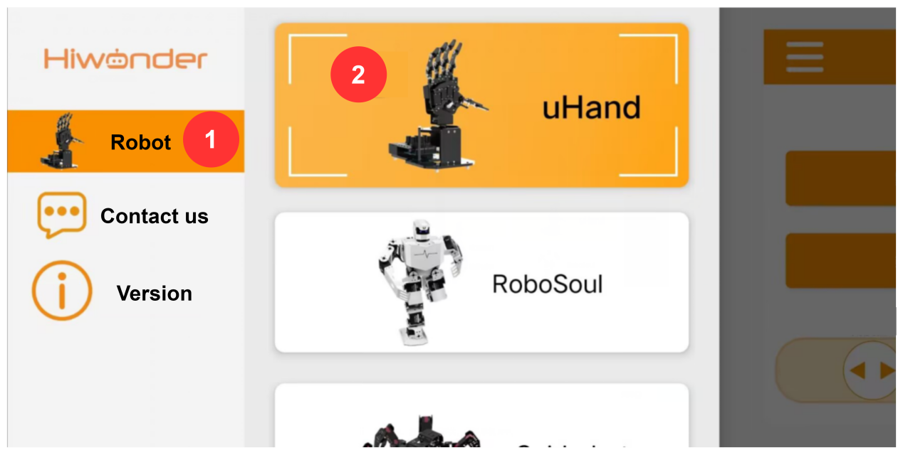

Step 3: Open the APP “Wonderbot”, and tap on the icon
at the top left corner to select “uHand”.

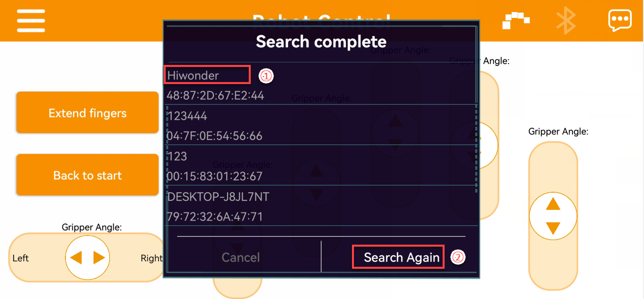

Step 4: In uHand interface, tap on
at the top right corner, and find “Hiwonder” in Bluetooth list. Click on the link.
If the “Hiwonder” does not appear immediately after clicking on the Bluetooth icon, you can click “Search again” to search it again.
Step 5: After successfully connecting, the Bluetooth icon at the top right corner will switch to a steady mode, and the robotic hand will return to its neutral mode.

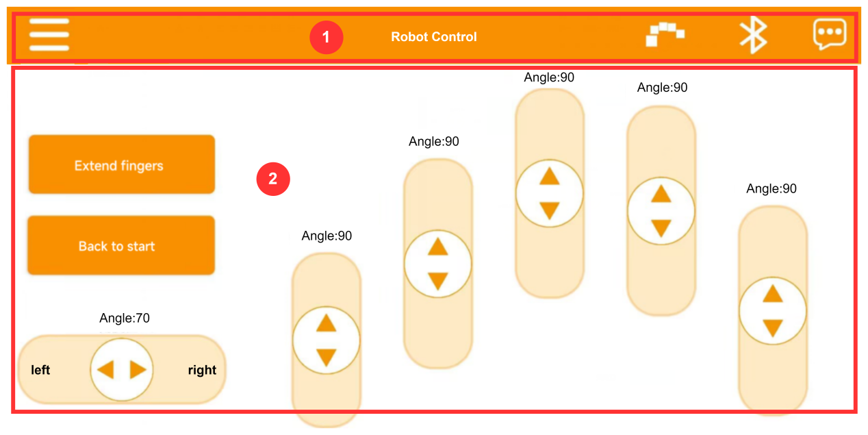

There are two control modes for the app. The default mode is the slider control mode, where you can drag the slider to control the rotation angle of each servo. And the other is the fingertip control mode. You can open and close the robot hand by pressing buttons.

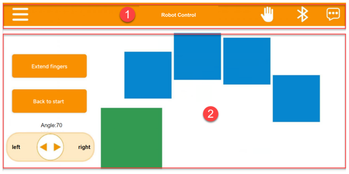

5.3.1 Slider Control
The app interface consists of two parts as shown below:
①:Menu Bar
Go back to the home screen to select the robot |
Switch to fingertip control mode |
Bluetooth connection |
More information |
②:Control Area
The control pan-tilt (No.6 servo) rotates from 0 ° to 180 ° |
Control the opening and closing of the robotic hand (No.1 ~ 5 servo), the angle range is 0 ~ 180 ° |
Control the opening of the hand, that is the angle of No.1 ~ 5 servo should be 180 ° |
Control all servos back to neutral position |
