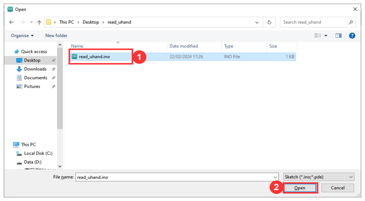

(1) Double click to open it.
(2) Click “File -> Open”.
(3) Select read_uhand.ino program and click “Open”.

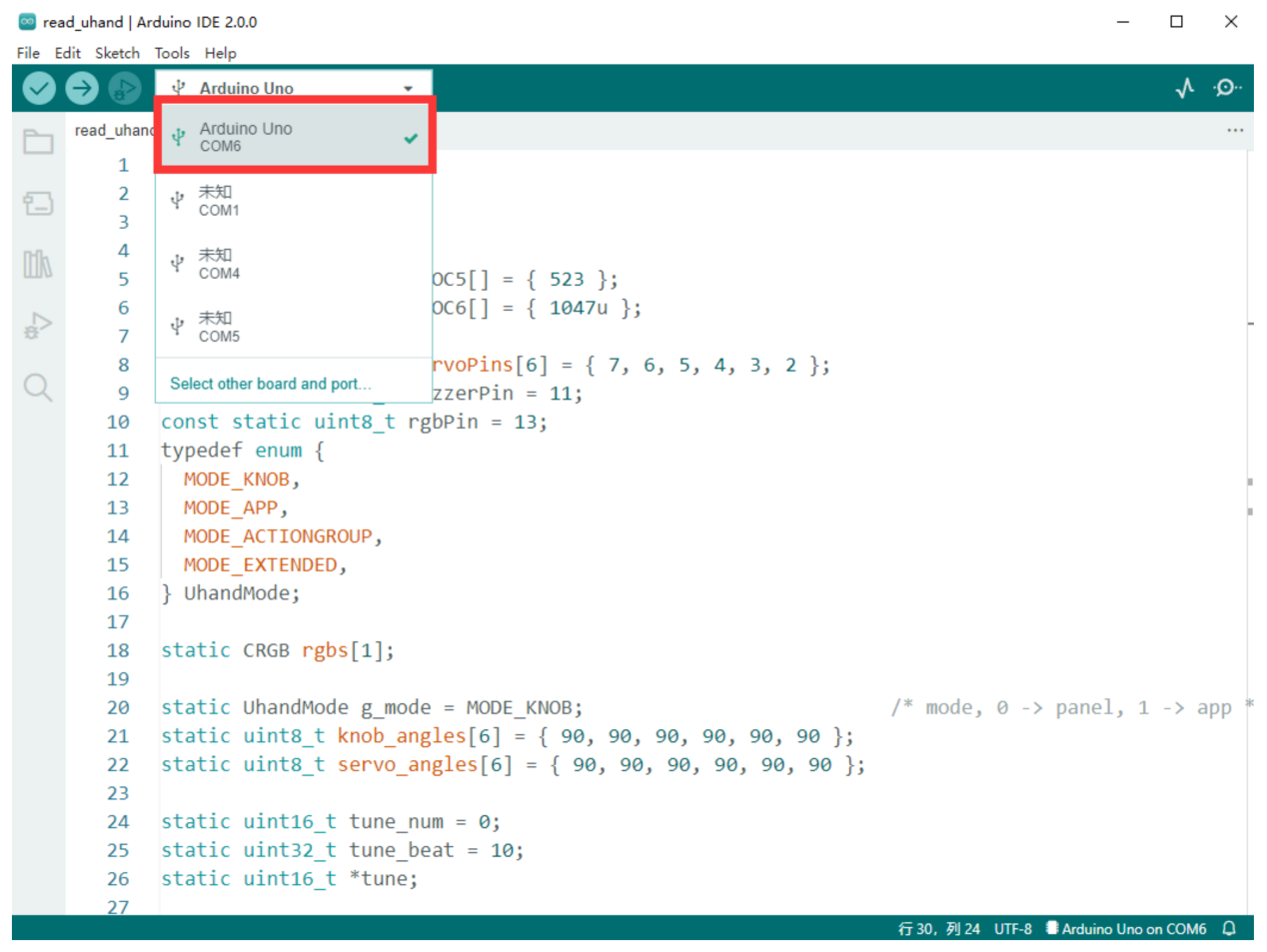

(4) Locate Arduino development board in “Select Board”. (Take Arduino Uno as an example. COM ports are not unique, and their numbers can be checked in computer’s device management. Take COM6 as an example.)

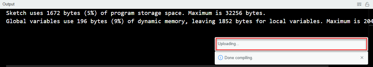

(6) After successful compilation, click to upload the program to the development board. The status area shows “Compiling Project-> Uploading-> Upload successfully” in turn. After that, the status area stops printing and uploading information.

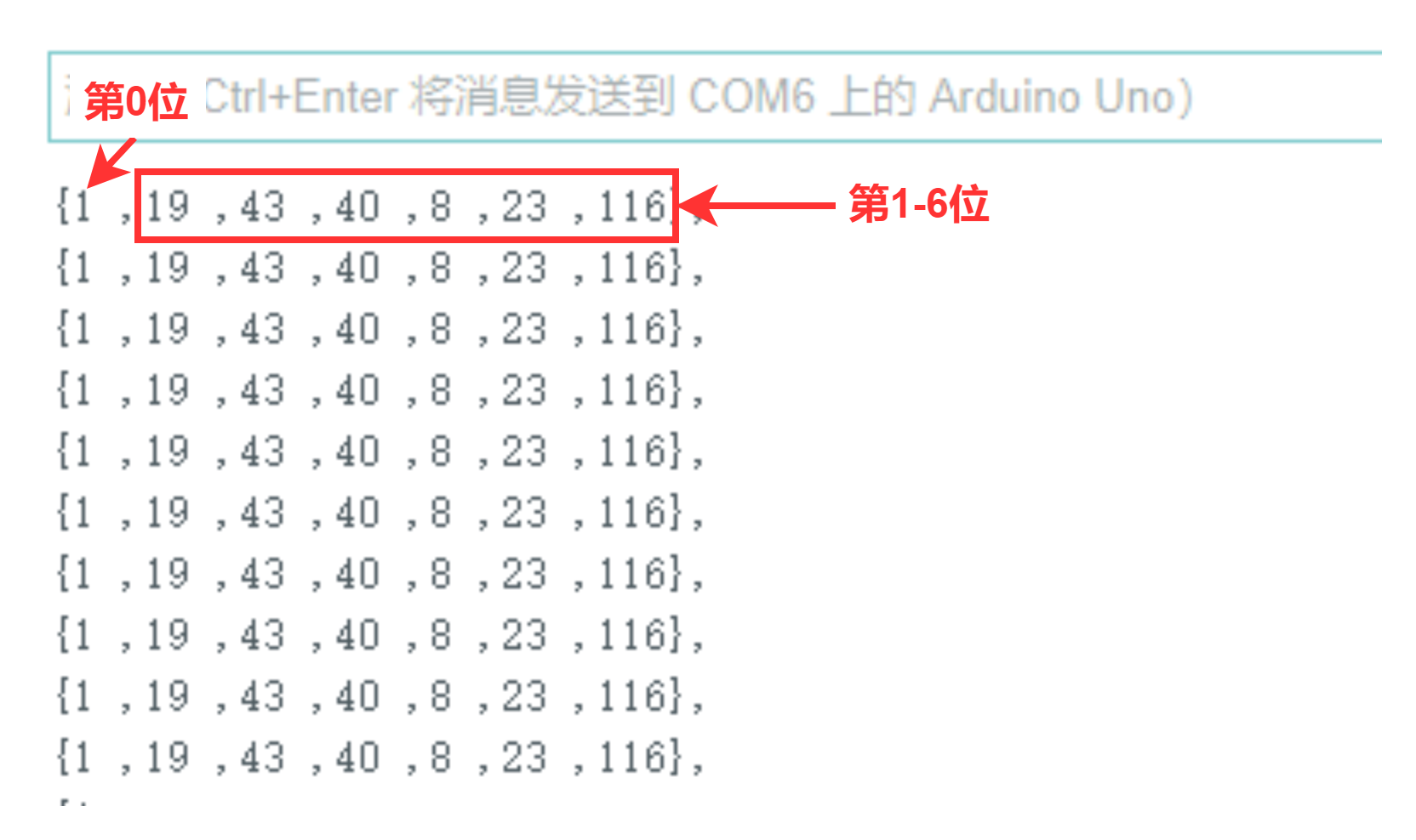

(1) Keep the Type-B cable connected to the computer. Do not unplug it, as it will hinder communication. Power on the robotic hand. Then click in the upper right corner and select a baud rate of “115200”.
(2) Press “Ctrl+Shift+M” to open the serial monitor to view real-time servo data. The 0th bit in the data tells whether the current action group is a valid data or not. “1” is a valid data. “0” is an invalid data, which is a stop action. The following six bits correspond to the angles of the six servos, ranging from 0° to 180°.
(3) Rotate the knobs S1 to S6 on the uHand UNO to adjust the rotation angles of the corresponding six servos, controlling the robotic hand to move to the desired posture. Then copy the entire row of servo data displayed on the serial port.

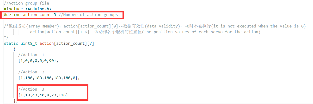

(1) Add the acquired action data into Action Running Program/uhand_actions/actions.h.
(2) The macro definition “action_count” represents the number of current actions. If a new action needs to be added, please add 1 to the original data.
 2
//Action group file
#include <Arduino.h>
#define action_count 3 //Number of action groups
/*数组成员(array member):action[action_count][0]--数据有效性(data validity),=0时不被执行(it is not executed when the value is 0)
           action[action_count][1-6]--该动作各个舵机的位置值(the position values of each servo for the action)
static uint8_t action[action_count][7] =
      //Action  1
      {1,0,0,0,0,0,90},
      //Action  2
      {1,180,180,180,180,180,0},
      //Action  3
      {1,19,43,40,8,23,116}
Please make sure that the current action data is a one-dimensional array when adding new action data. In the action data, the 0th bit in the data tells whether the current action is a valid data or not. “1” is a valid data. “0” indicated that the running is completed. The 1st to 6th bits correspond to the angles of the servos 1 to 6 respectively.
Please ensure that the 0th bit of the action data you add is 1. Otherwise, the action cannot be executed.
If the new action is successfully added, it will be displayed as follows:

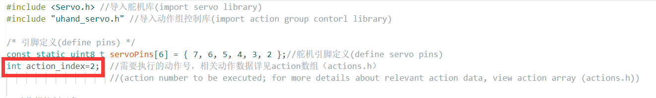

Open the “uhand_actions.ino” file located in the same directory. Modify the “action_index” variable representing the action number to the corresponding number of the newly added action.

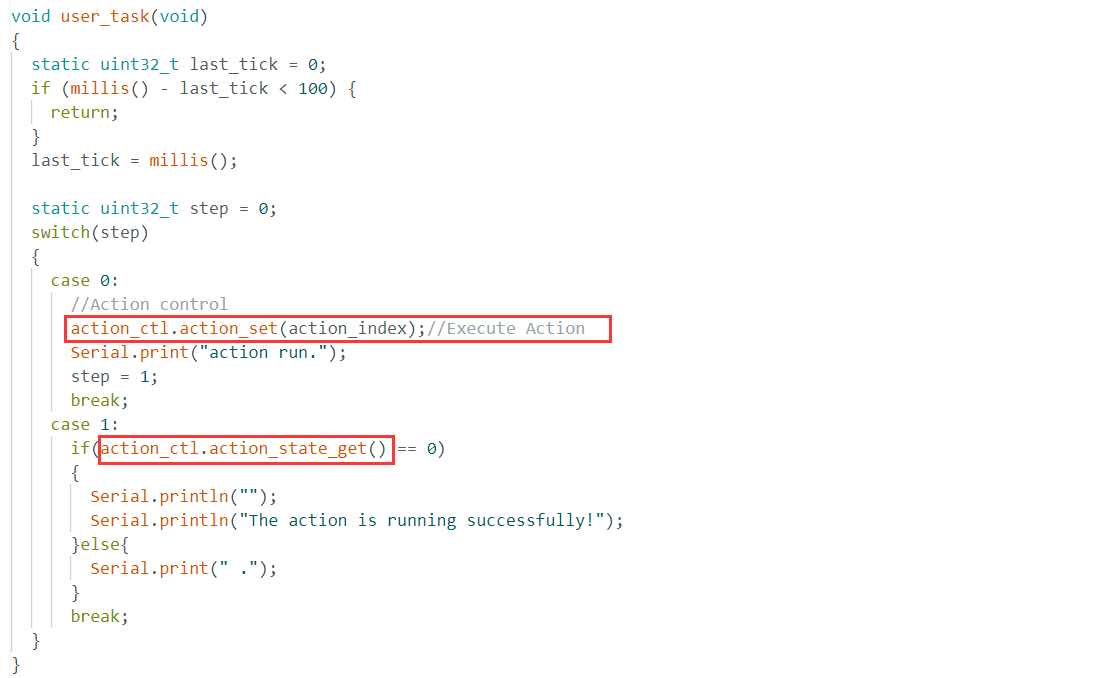

(2) In the user_task() function, set the current action number to be executed using the action_ctl.action_set() function. For example, the code action_ctl.action_set(1) sets the current action number to be executed as 1. Use the action_state_get() function to obtain the current action being executed. The return value is the current action number being executed, or 0 if it has already been completed.

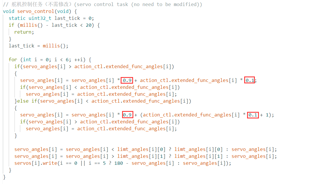

(4) Call the servo_control() function to control the servo to turn to the corresponding angle and achieve the corresponding action. If you want to modify the rotation speed of the servos, make sure the sum of the coefficients of the two items adds up to 1. For example, if you change the coefficient of the actual value to 0.5, then the corresponding actual value of the expected value needs to be changed to 0.5 as well. After modifying the values, download the program, and the subsequent servo speed of the robotic hand will increase significantly.

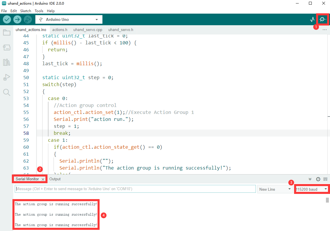

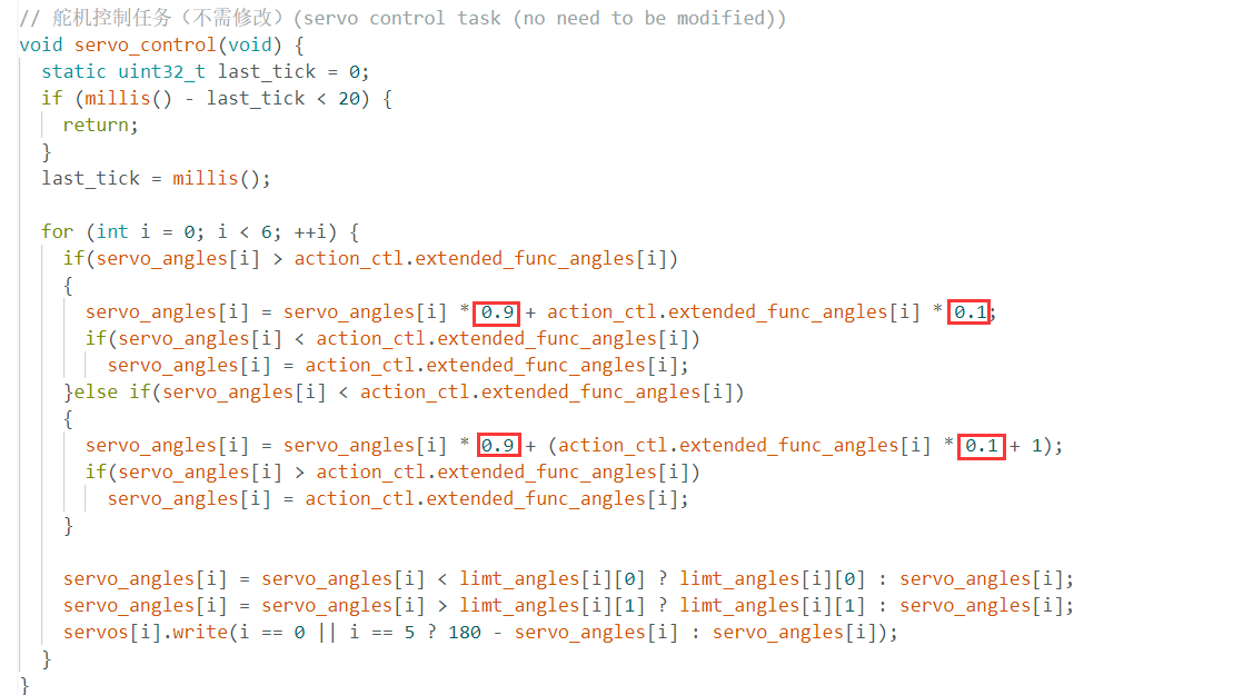

  • Get Action Group Data
(3) Rotate the knobs S1 to S6 on the uHand UNO to adjust the current rotation angles of the servos. And then save these actions in series to create a new action group.

  • Program Outcome
Power on the robotic hand. Keep the Type-B cable connected to the computer. Turn on the serial monitor, and select a baud rate of “115200”.
Once the action group is completed, the serial port monitor displays “The action group is running successfully!”, indicating successful execution of the action group.

(2) In the user_task() function, set the current action group number to be executed using the action_ctl.action_set() function. For example, the code action_ctl.action_set(1) sets the current action group number to be executed as 1. Use the action_state_get() function to obtain the current action group being executed. The return value is the current action group number being executed, or 0 if it has already been completed.
