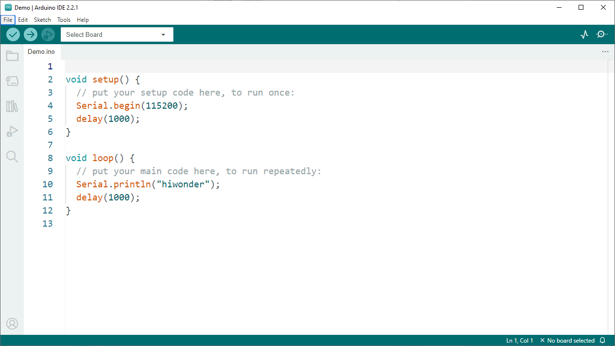

2.2.2 Arduino Download Program
(1) In this case, we will use an example that prints “Hiwonder” to illustrate. Open the example program Demo.ino .
(2) Connect Arduino board to the computer using Type-B cable.
(3) In the “Select board” option, find the corresponding Arduino development board. (Take “Arduino Uno” and “COM5” as en example to demonstrate. The COM port is not unique. You can can check the COM port number in the computer’s device manager. )
(4) Click
button to compile the program, which can check if the program has syntax errors and other issues.
(5) After the compilation is complete, click
to upload the program into the Arduino development board.
(6) When the upload is done, click
to open the serial monitor. The word “hiwonder” is printed on the serial monitor.

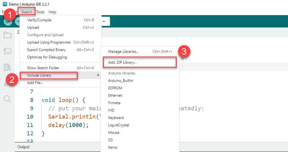

Local Importing
This method is usually used for downloading library file or customizing the library file importing. Here will take the “FastLED” library file as an example to illustrate.
(1) Select “Sketch -> Include library-> Add .ZIP library”.
(2) Search for the “FastLED.zip” file and open it.
(3) The prompt shown in the below red box indicates that the library file has been installed already.
