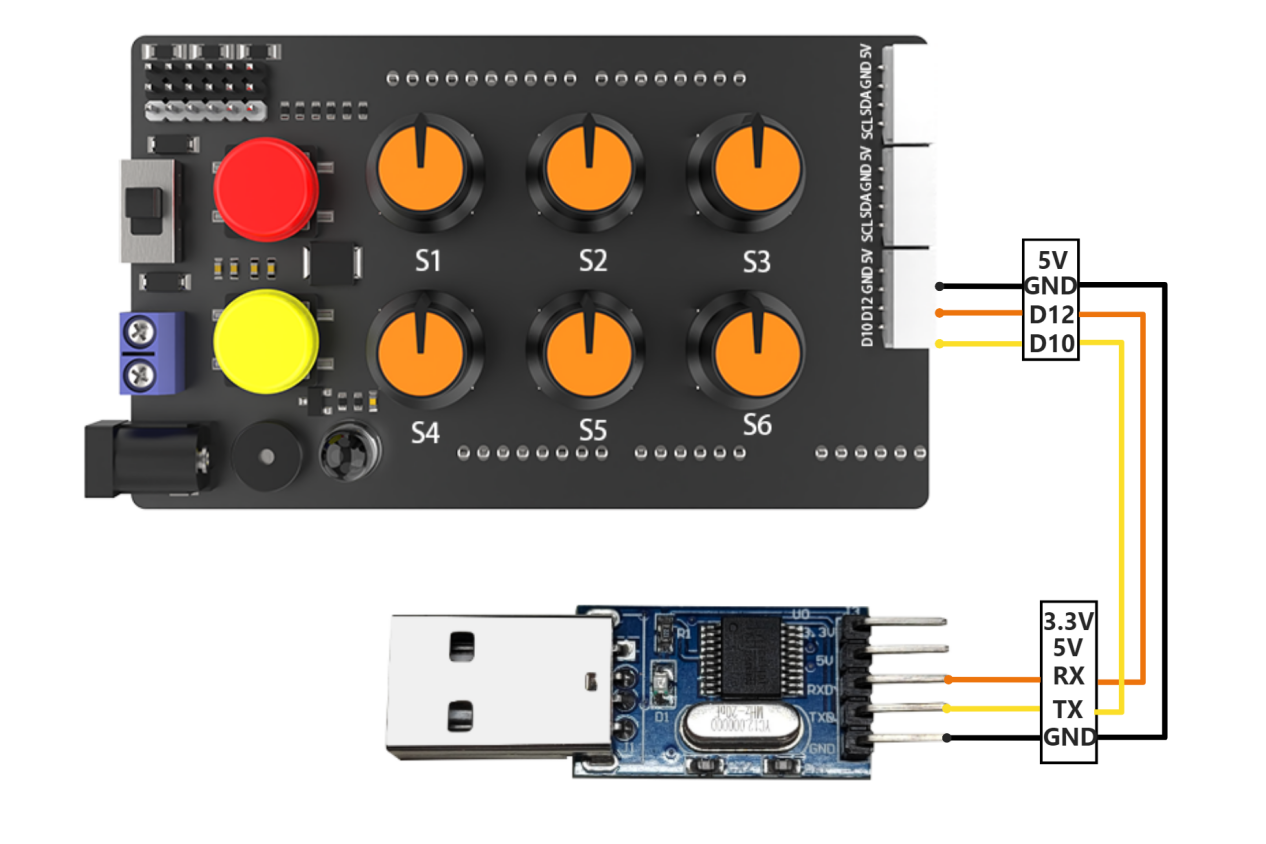

(1) Use DuPont wires to respectively connect the RXD, TXD, and GND of the USB adapter to the IO12, IO10, and GND interfaces on the Arduino UNO. Connect the USB adaptor to the PC.

(1) The host device and the uHand UNO can have different power sources, but they must share a common ground when connected to ensure stable communication voltage.
(2) When you wire the devices, ensure that the TX and RX pins of the UART serial port are crossed, otherwise communication will not be possible.

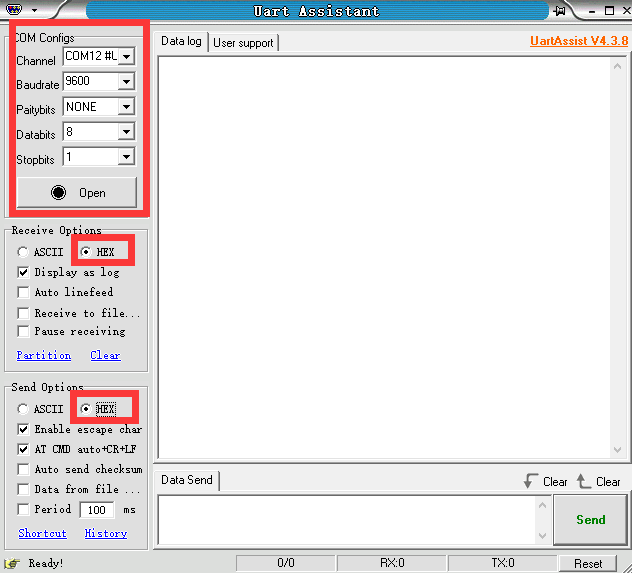

Make sure the baud rate is set to 9600, parity to NONE, data bits to 8 and the stop bits to 1 in the debugging assistant. Then check the “hex” to send. The configuration is shown below:

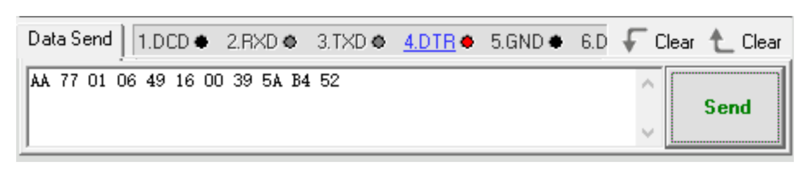

Command name: “FUNC_SET_SERVO” command value 0x01, data length 6:
Instruction: control servo rotation of the uHand UNO. The rotation angle is 0-180 degrees.
Data information: six angles required to be set by servo, a total of six values. Each value corresponds to a servo, with a byte each to indicate the required rotation angle.
Take sending the hex “AA 77 01 06 49 16 00 39 5A B4 52” as an example. The data message is “49 16 00 39 5A B4”, where 49 means rotate the thumb of the servo NO.1 to 73 degrees, 16 means rotate the index finger of the servo NO.2 to 10 degrees, 00 means rotate the middle finger of the servo NO3. to 0 degree, 39 means rotate the ring finger of servo NO.4 to 57 degrees, 5A means rotate the servo NO.5 to 90 degrees, and B4 means rotate the pan-tilt of the servo NO.6 to 180 degrees.

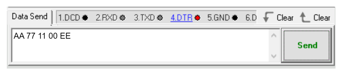

Command name: “FUNC_READ_ANGLE” command value 0x11, data length 0.
Instruction: read the current uHand UNO servo angle.
Data information: no data message available since the read operation.
For example: take sending the hex “AA 77 11 00 EE” as an example. The uHand UNO returns to the current six servo angles respectively after sending the data. Take received data “AA 77 11 06 5A 5A 5A 5A 5A 5A CC” as an example. The data message is “5A 5A 5A 5A 5A 5A”, where the 1st to 6th 5A each means the current angle of the 1st and 6th servo is 90 degrees.

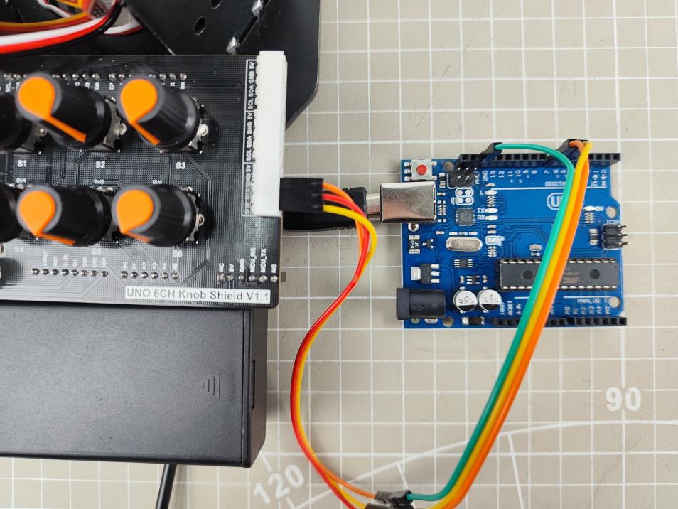

The interface for uHand UNO serial communication is a 4-pin. It is suitable for devices with pin interfaces for UART communication such as Arduino. Now you need to connect the uHand UNO’s 4-pin to its corresponding pin interfaces for communication.
The connection of the 4-pin interface communication is as follows:
The detailed connection is as follows:
Connect the IO12 pin of uHand UNO used as the TX signal pin to the No.6 pin of Arduino.
Connect the IO10 pin of uHand UNO used as the RX signal pin to the No.7 pin of Arduino.
Connect the GND pins of uHand UNO and Arduino.

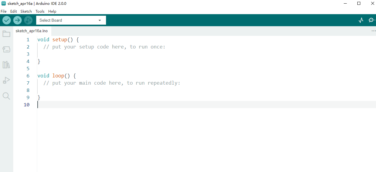

Please refer to the instructions in “2. Set Arduino Environment” to establish the connection between uHand UNO and Arduino editor.

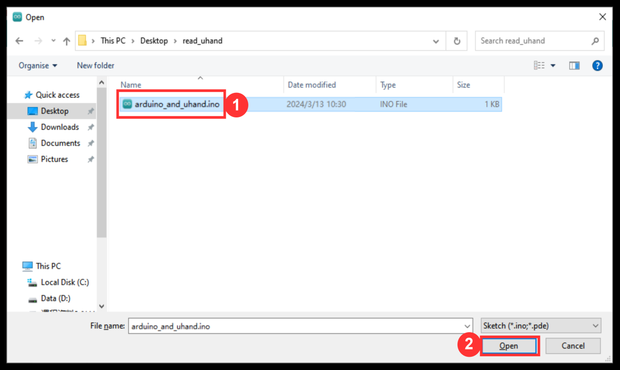

(1) Double-click to open it.
(2) Click “File -> Open”.
(3) Open the source code path in “1. Implementation Principles” to click “Open”.

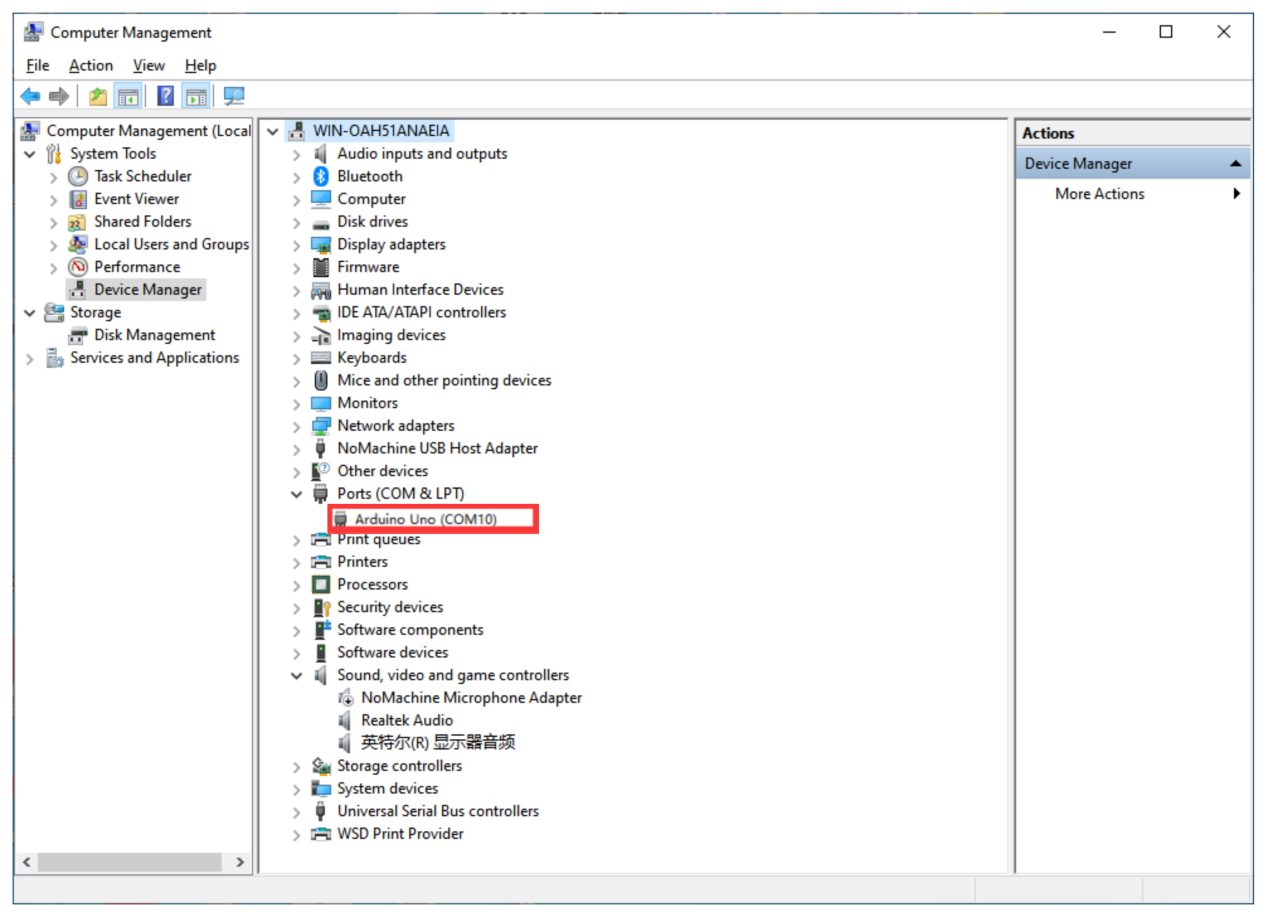

(4) Click “Tools -> Development Board” to select “Arduino UNO”. Take COM10 as an example. (If you have already configured the development board model and port number during the setup of the development environment, you can skip this step.)
(5) If you are unsure about the port number, you can right-click “This PC” and click “Properties -> Device Manager” to view the port number corresponding to the master (the device with CH340 is ours). Once you have found it, you can reselect it in the Arduino.

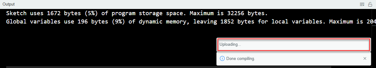

(6) After confirming that everything is correct, click to verify the program. If the program is correct, the status area shows “Compiling Project -> Completed” in turn. Then it displays the number of bytes used by the current project, the program storage space, and etc.
(7) After successful compilation, click to upload the program to the development board. The status area shows “Compiling Project -> Uploading -> Upload successfully” in turn. After that, the status area stops printing and uploading information.
