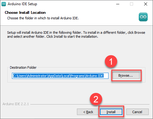

(4) Click “Browse” to choose the installation path, and then click “Install”.

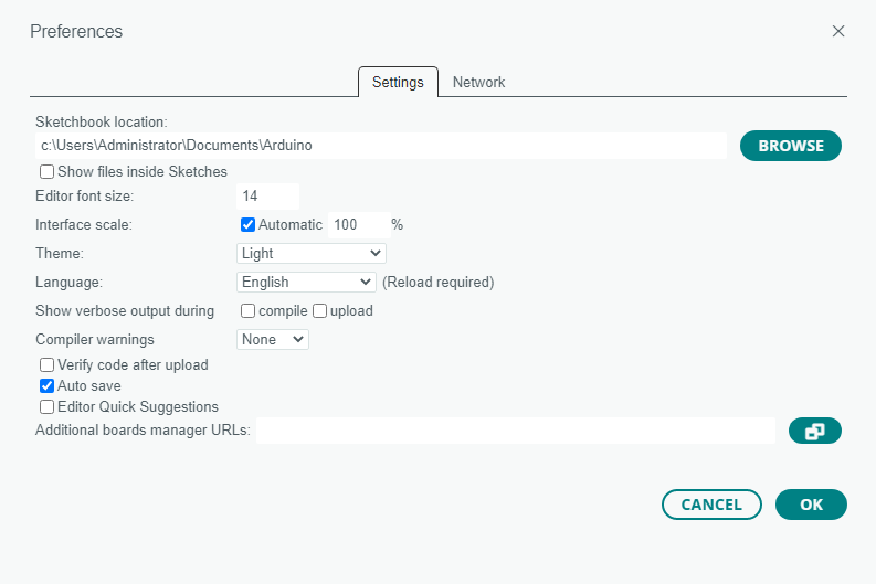

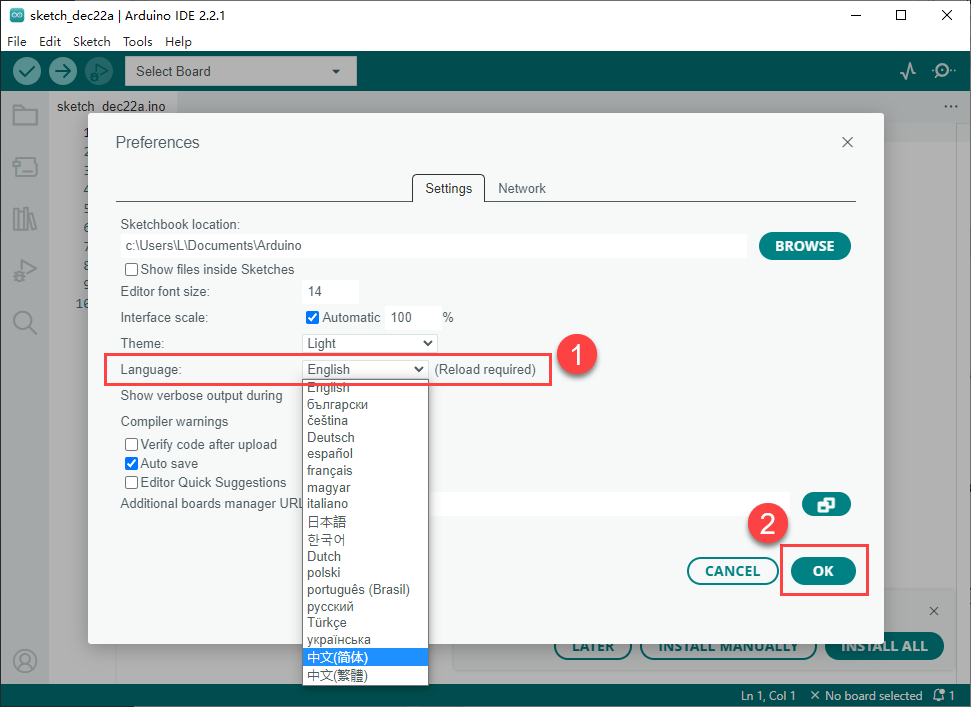

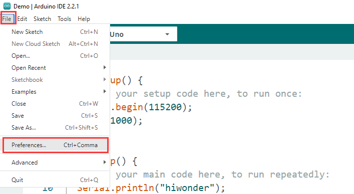

(1) Modify the Chinese interface: select “File -> Preferences” on the Arduino IDE interface. Then, choose Chinese from the “Language”, and click “OK”.
(2) You can modify the project file path, editor text size, color themes, etc by selecting “File -> Preferences” in the pop-up window.

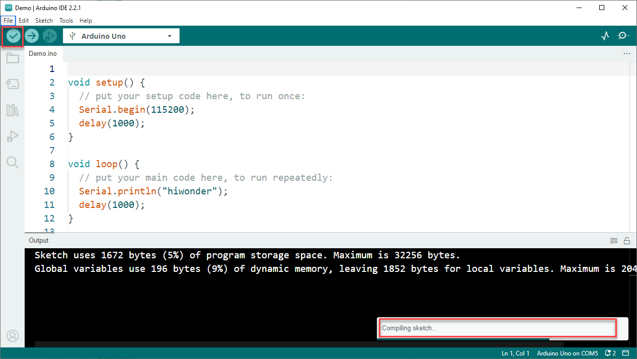

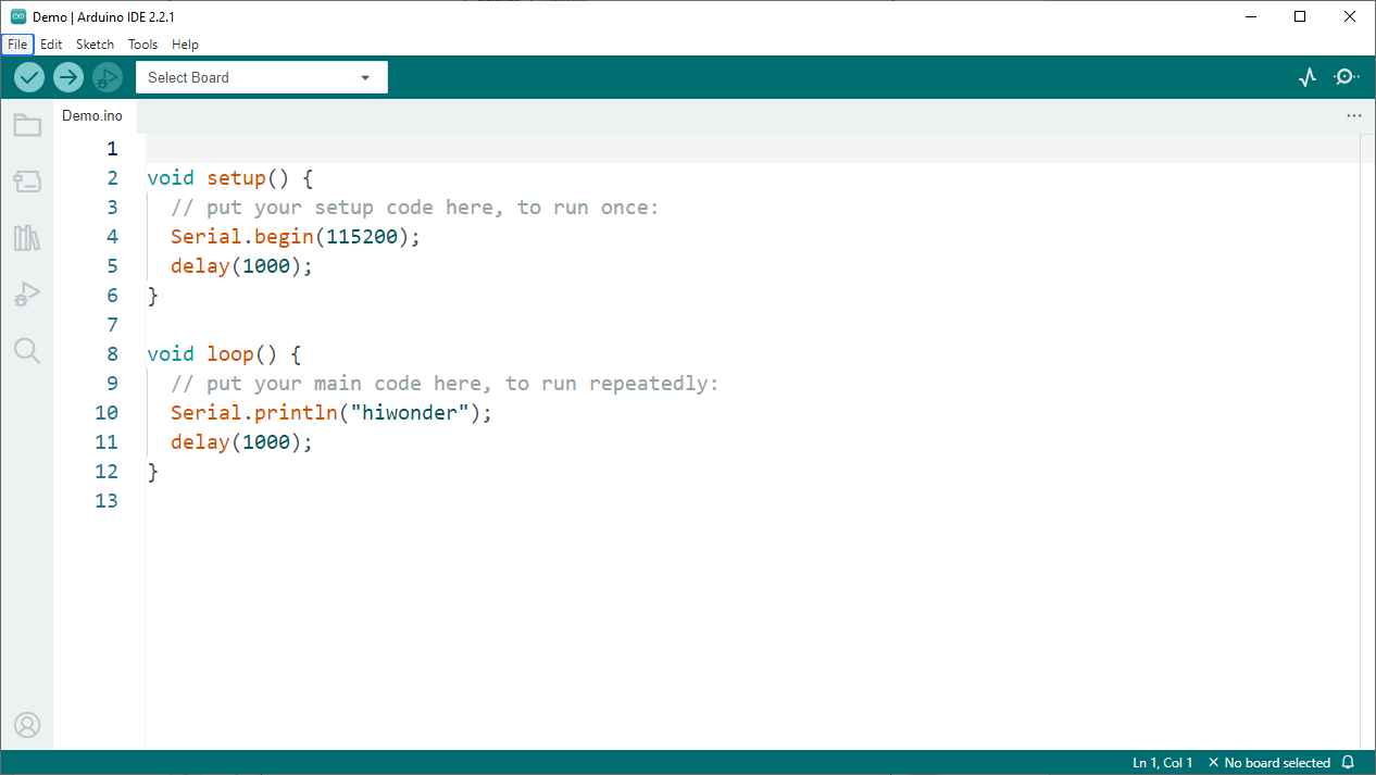

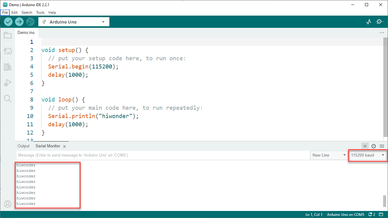

(1) In this case, we will use an example that prints “Hiwonder” to illustrate. Open the example program Demo.ino .
(2) Connect Arduino board to the computer using Type-B cable.

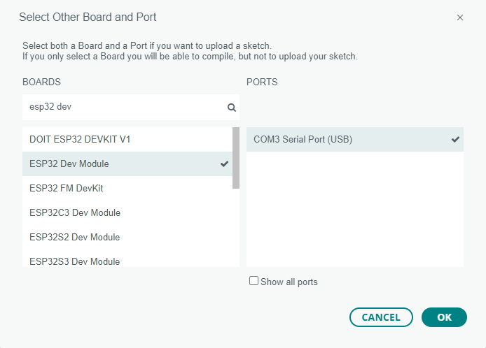

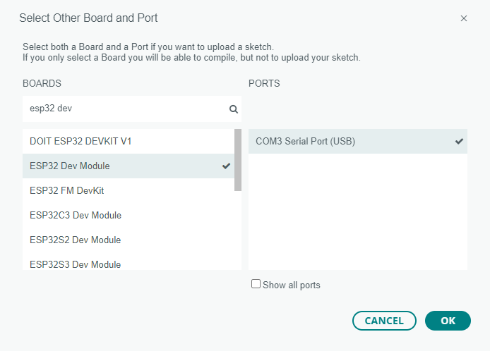

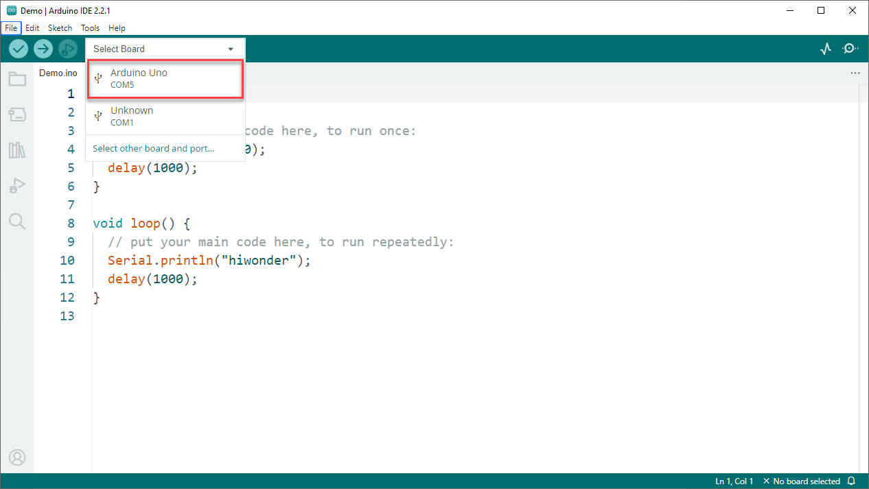

(3) In the “Select board” option, find the corresponding Arduino development board. (Take “Arduino Uno” and “COM5” as en example to demonstrate. The COM port is not unique. You can can check the COM port number in the computer’s device manager. )
(4) Click button to compile the program, which can check if the program has syntax errors and other issues.
(5) After the compilation is complete, click to upload the program into the Arduino development board.
(6) When the upload is done, click to open the serial monitor. The word “hiwonder” is printed on the serial monitor.

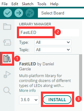

Take the library file for driving the RGB light (FastLED) as an example to illustrate:
(1) Click at the sidebar of Arduino IDE interface.
(2) In the pop-up library management bar, enter “FastLED” to automatically search for the library files, then click “install”.
(3) The prompt shown in the red box indicates the successful installation.

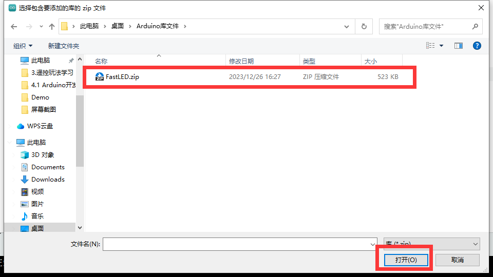

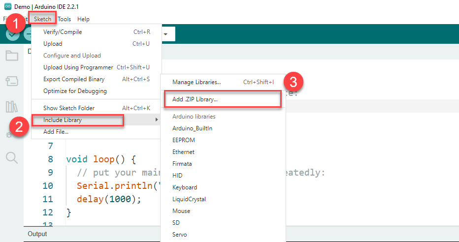

(1) Select “Sketch -> Include library -> Add .ZIP library”.
(2) Search for the “FastLED.zip” file and open it.
(3) The prompt shown in the below red box indicates that the library file has been installed already.

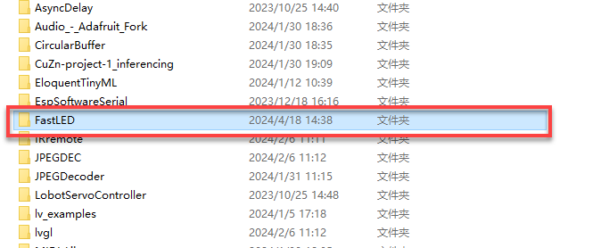

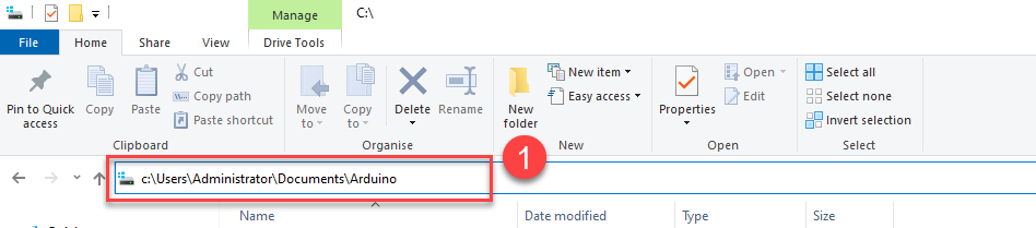

Take the library file “FastLED” as example to illustrate. In Arduino IDE versions 1.8.5 and above, the error above may arise when importing this library file. You can solve this problem by extracting the library file and placing it directly into the ‘libraries’ folder in the path of the project. The specific solution is as follows:
(1) At first, extract the library file “FastLED”.

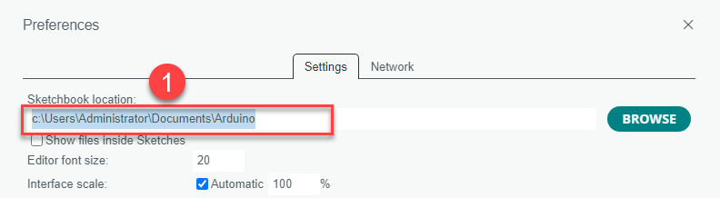

(2) Click “File->Preferences” in sequence.
(3) In the opening preferences, copy the path.
(4) Paste it in my computer, and then press “Enter” to access the path.
(5) Place the previously extracted library file into the “libraries” folder.
(6) Restart Arduino IDE. The library file has been located in the library of Arduino IDE.

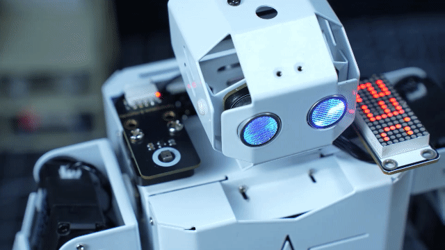

In this lesson, we will make the RGB LED on the ultrasonic sensor blink.
  • Program Implementation Process

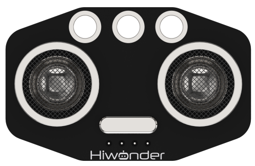

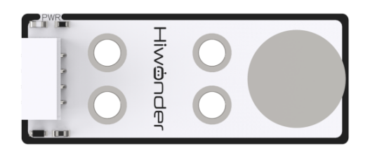

  • Introduction to Glowy Ultrasonic Sensor
This is a glowy ultrasonic distance sensor module that communicates via I2C. It reads the distance measured by the ultrasonic sensor using the I2C protocol.
When measuring distance, the module sends out 8 pulses of 40kHz square waves and checks for any returning signals. If a signal is detected, the module outputs a high-level signal, and the duration of this high signal corresponds to the time taken for the ultrasonic waves to travel to the target and back.
The ultrasonic sensor is pre-installed on the robot when it leaves the factory.

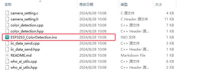

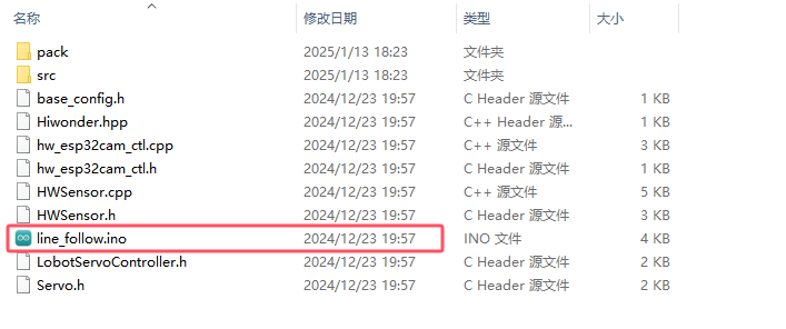

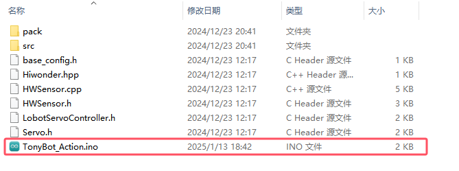

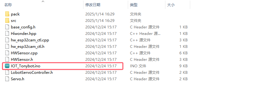

(1) Locate and open the program file “Breathing Light Program\Breathing\Breathing.ino” in the directory corresponding to this section.

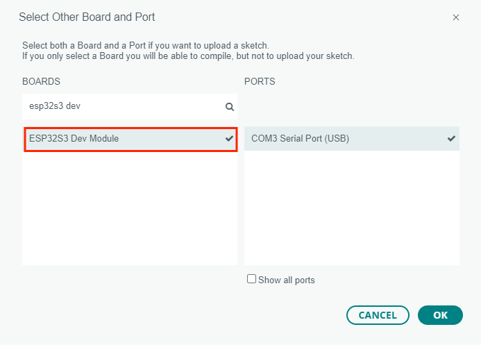

(2) Connect the ESP32 to the computer using a data cable.
(3) Select the “Select Board” option. The software will automatically detect the serial port of the connected ESP32. Click to establish the connection.
(4) Click to upload the program to the ESP32. Wait for the upload to complete.
  • Expected Results
It is recommended to perform this activity in a dark environment for a better experience.
The RGB LED on the ultrasonic sensor will emit blue light and blink every 2 seconds.

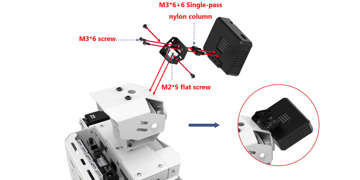

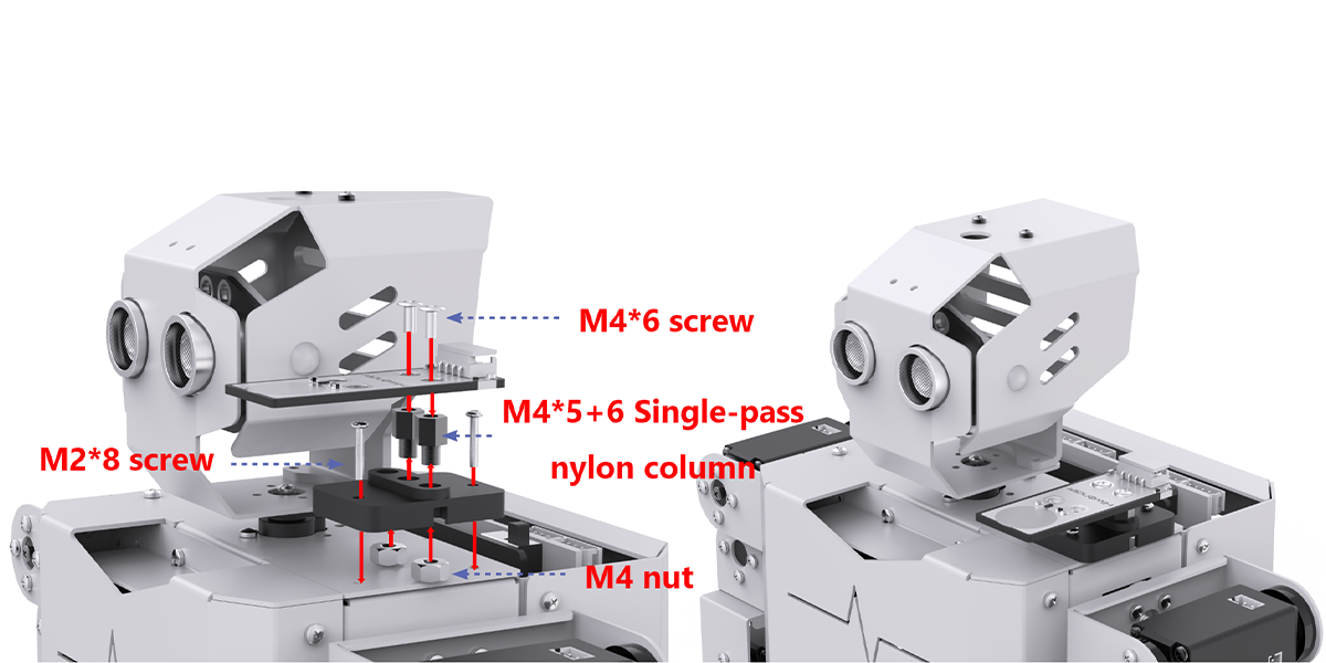

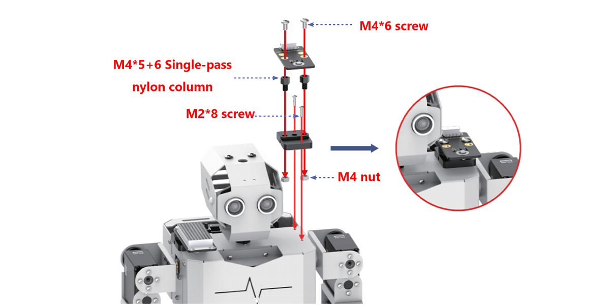

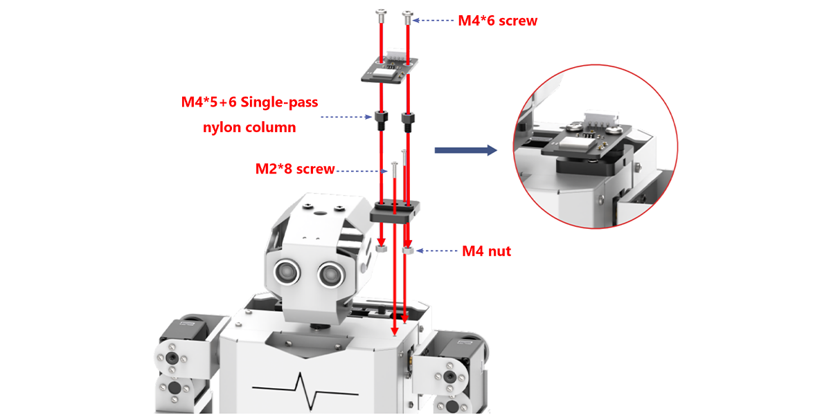

  • Assembly
  • Project Introduction
This section utilizes the ultrasonic module to measure the distance to an obstacle. The measured distance is displayed on the LED dot matrix, and the RGB light color of the ultrasonic module is adjusted accordingly.
  • Sensor Introduction
(1) Glowy Ultrasonic Sensor
This is a light-emitting ultrasonic distance sensor module that communicates via I2C. It reads the distance measured by the ultrasonic sensor using the I2C protocol.

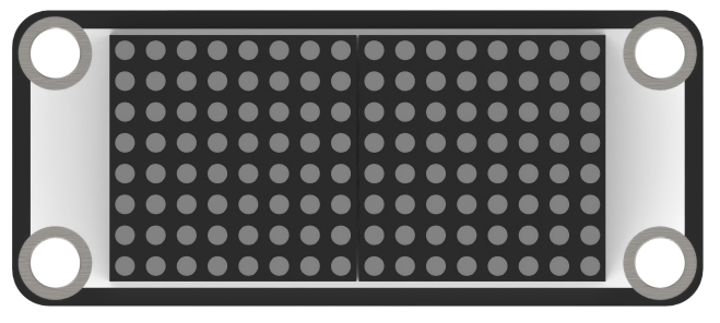

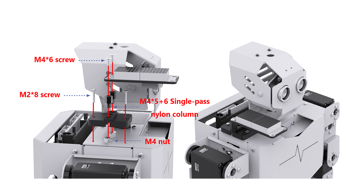

(2) LED Dot Matrix Display
The LED dot matrix module utilizes an LED display screen that offers high brightness, flicker-free performance, and easy wiring. It is capable of displaying numbers, text, patterns, and other content. The module consists of two red 8x8 LED matrices and is controlled by the TM640B driver chip, which enables efficient control of the dot matrix screen.
For a detailed introduction to the installation and assembly process, please refer to the tutorial video.

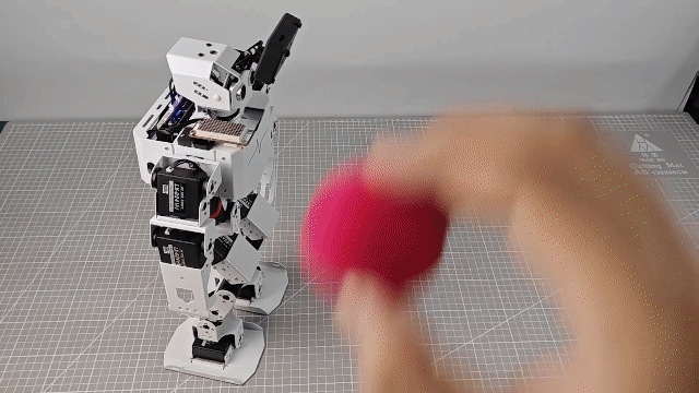

  • Achieved Effect
Slowly bring the object closer to the glowy ultrasonic sensor. As the distance decreases, the ultrasonic light will shift towards red, and as the distance increases, it will become greener. The LED dot matrix display will update in real-time to show the measured distance.

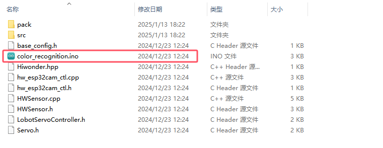

(1) Locate and open the program file “Distance-Controlled Walking Program/Follow/Follow.ino” in the directory corresponding to this section.

(1) Locate and open the program file “01 Low-Altitude Navigation/Cross/Cross.ino” in the directory corresponding to this section.

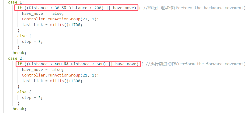

Entering the Function:
① The first step is to call Controller.isRunning() to check the execution status of the previous instruction. If the function returns TRUE, it means the previous instruction is still being processed, so the next movement command cannot be issued, and the function exits immediately.
② If the function returns FALSE, it means the servo controller is idle and ready to accept the next command.
First Round of Execution:
① First, execute the instructions in case 0. If the measured distance is greater than the specified threshold (indicating no obstacle in front, distance = 0), the robot will perform an action group, turn on the green light, and proceed to the second round of execution logic in the next function call.
② If the measured distance is smaller than the specified threshold, the robot will stay in the first round of execution logic for the next function call.
Second Round of Execution:
① First, execute the instructions in case 1. If, during the time between the last execution and this round, the newly measured distance is smaller than the specified threshold, the robot will perform two action groups, turn on the red light, and activate the buzzer for a warning. The robot will then assume a crouching stance and stay in place. On the next function call, the logic will proceed to the third round.
② If the newly measured distance is still greater than the specified threshold, the robot will execute a high stance walking action. The next function call will remain in the second round of logic.
Third Round of Execution:
① First, execute the instructions in case 2. If the newly measured distance is still smaller than the specified threshold, the robot will perform two action groups, turn on the blue light, and transition from the crouching stance to low forward movement.
② If the newly measured distance is greater than the specified threshold, the robot will maintain the low stance and remain stationary. The next function call will stay in the third round of execution logic.

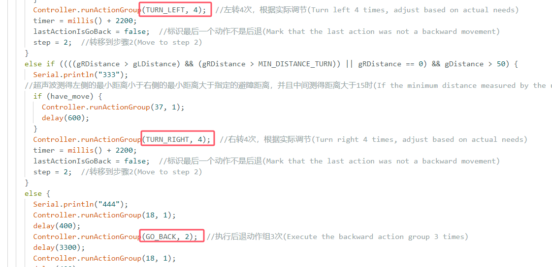

    case 3:  //步骤3(Step 3)
      static bool lastActionIsGoBack = false;   //静态变量,记录最后的动作是不是后退(Static variable to track if the last action was to move backward)
      hwsensor.ultrasoundColor(0, 0, 50, 0, 0, 50); //蓝(Blue)
      if (((gDistance > MIN_DISTANCE_TURN) || (gDistance == 0)) && lastActionIsGoBack == false) {
        Serial.println("111");
        //中间距离大于指定避障距离且最后的一个动作不是后退,那么就回到步骤0,(If the middle distance is greater than the specified obstacle avoidance distance and the last action was not a move backward, move back to step 0)
        //此处判断最后一个动作是不是后退,是避免程序陷入后退-》前进-》后退-》前进...这样的死循环(This check is to avoid the program getting stuck in a back-and-forth loop of "backward -> forward -> backward -> forward...")
        //当最后一步是后退是就不执行前进(When the last action was backward, do not execute forward)
        step = 0;
      else if ((((gLDistance > gRDistance) && (gLDistance > MIN_DISTANCE_TURN)) || gLDistance == 0) && gDistance > 50) {
        Serial.println("222");
      //超声波测得左侧的最小距离大于右侧的最小距离大于指定的避障距离,并且中间测得距离大于50mm时(If the minimum distance measured by the ultrasonic sensor on the left side is greater than the right side,)
      //检测中间的距离目的是避免有物体处于机器人两个前腿之间,导致机器人无法转向(greater than the specified obstacle avoidance distance, and the middle distance is greater than 50mm)
        if (have_move) {
          Controller.runActionGroup(36, 1);
          delay(600);
        Controller.runActionGroup(TURN_LEFT, 4);  //左转4次,根据实际调节(Turn left 4 times, adjust based on actual needs)
        timer = millis() + 2200;
        lastActionIsGoBack = false;  //标识最后一个动作不是后退(Mark that the last action was not a backward movement)
        step = 2;  //转移到步骤2(Move to step 2)
      else if ((((gRDistance > gLDistance) && (gRDistance > MIN_DISTANCE_TURN)) || gRDistance == 0) && gDistance > 50) {
        Serial.println("333");
      //超声波测得左侧的最小距离小于右侧的最小距离大于指定的避障距离,并且中间测得距离大于15时(If the minimum distance measured by the ultrasonic sensor on the left side is less than the right side, greater than the specified obstacle avoidance distance, and the middle distance is greater than 15mm)
        if (have_move) {
          Controller.runActionGroup(37, 1);
          delay(600);
        Controller.runActionGroup(TURN_RIGHT, 4);  //右转4次,根据实际调节(Turn right 4 times, adjust based on actual needs)
In the fourth round of executing subsequent statements:
① We execute the statements in case 4. First, we check if, after the second round, the measured obstacle distance was smaller than the set threshold. In the current fourth round, we verify if the obstacle has moved (or disappeared), causing the measured distance to become greater than the threshold (or zero). If so, the program will return to the first round and control the robot to continue moving forward.
② It is necessary to add a condition inside the if statement to avoid a situation where the robot is instructed to move backward just enough to reach the threshold, causing a repetitive forward-backward loop.
③ If the current distance is still smaller than the set threshold, and if the left front distance (greater than the threshold) is farther from the obstacle, the robot will turn left. The next time the function is called, the program will return to the third round. After completing the left turn, the robot will treat the new direction as its front and measure the obstacle distances in three directions.
To prevent the robot from being too close to the obstacle with no space to turn or maneuver, we also need to check the distance to the obstacle in front of the robot. If the obstacle is too close, this branch will not be executed, and the program will proceed with the subsequent branches.
If the current distance is still smaller than the set threshold, and if the right front distance (greater than the threshold) is farther from the obstacle, the robot will turn right, and the same operation will be carried out as before.
If the current distance is still smaller than the threshold, and none of the previous conditions are met, the robot will be instructed to move backward to create space for turning. The next time the function is executed, the program will return to the third round.
(5) Distance Measurement Function getDistance
int getDistance() {       //获得距离(Get distance)
  uint16_t Distance, distance1, distance2, distance3;
  distance1 = hwsensor.ultrasoundGetDistance();
  distance2 = hwsensor.ultrasoundGetDistance();
  distance3 = hwsensor.ultrasoundGetDistance();
  Distance = (distance1 + distance2 + distance3)/3;
  return Distance;
① Due to the complexity of the environment, the sensor’s performance may be unstable, and sometimes the measured data may have deviations. To address this, we use the method of multiple measurements and calculate the average value to increase the reliability of the data, making the distance values more stable and smooth.
② We take the average of three distance measurements as the final value for each round of the getDistance function.

void getAllDistance()//获得前及左右三个方向的距离(Get distances for the front, left, and right directions)
  uint16_t tDistance;     //用于暂存测得距离(Temporary variable to store the measured distance)
  hwsensor.ultrasoundColor(0, 50, 50, 0, 50, 50); //蓝绿混(Blue-green mix)
  sonarServo.write(90 + BIAS);   //超声波云台舵机转到90度即中间位置(Move the ultrasonic pan-tilt servo to the 90-degree position (center))
  delay(100);                    //等待100ms,等待舵机转动到位(Wait for 100ms to allow the servo to position)
  delay(100);
  gDistance = getDistance();     //测量距离,保存到全局变脸gDistance(Measure distance and store it in the global variable gDistance)
  sonarServo.write(145 + BIAS);  //超声波云台舵机转到130度位置即机器人左面40度位置(Move the ultrasonic pan-tilt servo to the 130-degree position (robot's left side, 40 degrees))
  delay(400);
  delay(100);//延时,等待舵机转动到位(Wait for the servo to position)
  tDistance = getDistance();     //测量距离,保存到 tDistance(Measure the distance and store it in tDistance)
  sonarServo.write(180 + BIAS);  //转动到170度,即机器人左侧80度位置(Move the ultrasonic pan-tilt servo to the 170-degree position (robot's left side, 80 degrees))
  delay(400);
  gLDistance = getDistance();    //测量距离,保存到gLDistance(Measure the distance and store it in gLDistance)
  if(tDistance < gLDistance)     //比较两个距离,将较小的一个保存到gLDistance(Compare the two distances and store the smaller one in gLDistance)
    gLDistance = tDistance;
  sonarServo.write(45 + BIAS);   //超声波云台舵机转到50度位置即机器人右面40度位置 (Move the ultrasonic pan-tilt servo to the 50-degree position, which is the robot's right side at a 40-degree angle)
  delay(600);                    //延时,等待舵机转动到位(Wait for the servo to position)
  delay(100);
  tDistance = getDistance();     //测量距离,保存到tDistance(Measure the distance and store it in tDistance)
This function first controls the servo to measure the obstacle distance in the forward direction and stores the result in gDistance. Then, it measures the obstacle distances in the left-front and left directions, and the smaller value is stored in the variable gLDistance as the final adopted distance for the left side. The same procedure is applied for the right side.

(1) Locate and open the program file “02 Fall and Recover Program/up/up.ino” in the directory corresponding to this section.

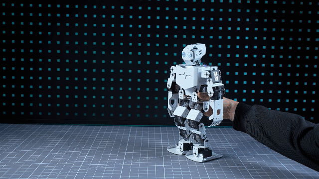

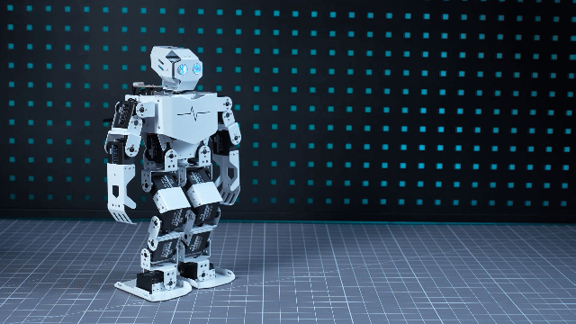

  • Achieved Effect
Place the robot on a hard surface. It can be placed either face up or face down, but do not place it on its side. When the robot is powered on or restarted, the IMU will initialize. Wait for a “beep” sound, which indicates the initialization is complete.
After turning on the robot, place it face up or face down. After a short wait, the robot will automatically perform a standing action. (The standing action differs depending on whether it’s face up or face down.)

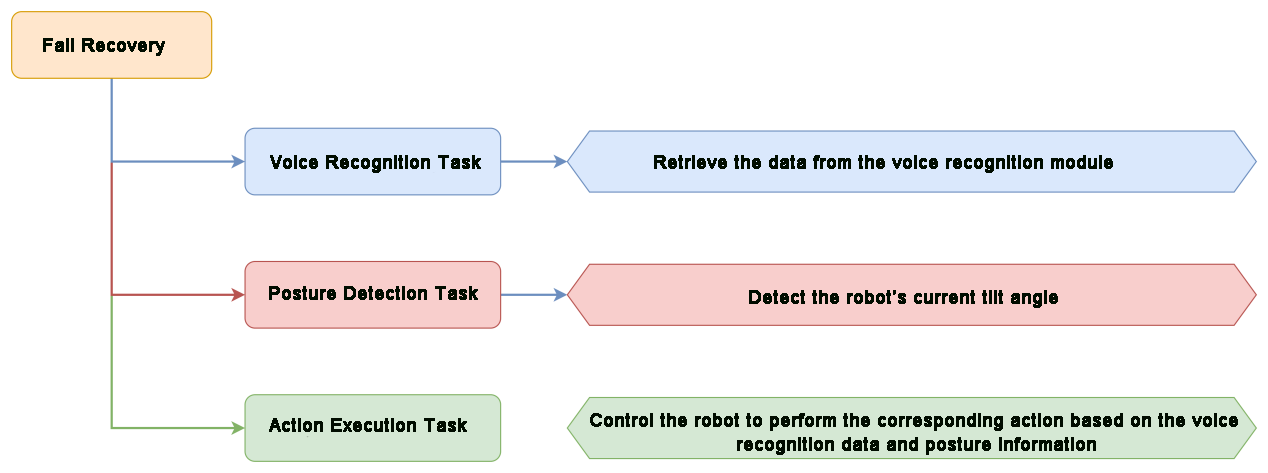

In the loop function, the ESP32 continuously calls the update_mpu6050 function to measure acceleration and angular velocity. The data is then processed in the tumble function for decision-making. Additionally, the Controller.receiveHandle function is called to monitor the execution status of commands sent to the servo controller in the Distancewalking function.

5.7 Action and Posture Adjustment Decision Function tumble
61
void tumble(void)
  static uint32_t Time;  //定义静态变量Time, 用于计时(Define static variable Time for timing)
  static uint8_t step = 0;
  static uint8_t count1 = 0;
  static uint8_t count2 = 0;
  if (Time > millis())       //Timer 大于 millis()(运行的总毫秒数)时返回,(If the timer is greater than millis() (total elapsed time), return)
    return;
  switch (step)
    case 0:
      // 获取IMU数据,判断是前倒还是后倒(Get IMU data to determine if it is a forward or backward fall)
      imu.get_angle(&radianX , &radianY);
      // Serial.printf("r:%d , p:%d\r\n",(int)radianX , (int)radianY);
      // 若为前倒(If it is a forward fall)
      if (radianX < 60 && radianX > -30)
        count1 += 1;
        Time = millis() + 50;
        if (count1 > 50) {
          count1 = 0;
          step = 1;
          buzzer_obj.blink(1500 , 100 , 100 , 1);
          Time = millis() + 1000;
      // 若为后倒(If it is a backward fall)
      else if (radianX > 120 || radianX < -140)
        count2 += 1;
        if (count2 > 50) {
          count2 = 0;
          step = 2;
      // 若没倒 (If it doesn't fall)
      else {
        count1 = 0;
        count2 = 0;
      break;
① The program first simulates a delay to ensure that each function execution is spaced by a set time interval before proceeding.
② It then calls Controller.isRunning() to check the execution status of the previous command. If this function returns “TRUE”, it means the previous command is still running, and no new movement commands can be issued. The program will skip the following statements.
③ If the function returns “FALSE”, it means the servo controller is idle and can accept the next command. The program will proceed to the next set of statements.
④ The first step is to execute case 0, where the robot’s tilt angle along the X-axis (with the positive X direction being the front of the robot) is checked.
⑤ If the tilt angle is less than 60°, the program will set the next entry time to 10ms later and exit. If the tilt angle is continuously detected to be less than 60° for 100 cycles, it will be considered a forward tilt (falling forward), and the program will execute case 1’s statements 1000ms after the current time. For angles greater than 120°, similar logic is applied.
⑥ If no tilt angles below 60° or above 120° are detected for 100 consecutive cycles, the relevant counters will be reset to prevent false detection.

6.2.9 Smart Fan Project
  • Sensor Installation & Wiring
This section utilizes a glowy ultrasonic sensor to measure the distance to obstacles. Based on the detected distance, the arm is raised, the fan is activated, and the color of the ultrasonic RGB LED changes accordingly.

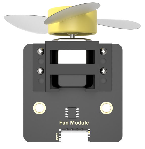

(2) Fan Module
The fan module is a sensor that operates without the need for an external motor driver board, utilizing PWM (pulse-width modulation) to control its movement. The direction of the fan’s rotation is managed by PWM pulse waveforms in both directions, while the fan speed is adjustable by modifying the duty cycle of the PWM signal.
For module installation and wiring, please refer to the section 1 in the same folder.
  • Program Download
Smart Fan Program
(1) Locate and open the program file “ Smart Fan Program/ultrasonic_fan/ultrasonic_fan.ino” in the directory corresponding to this section.
  • Achieved Effect
Slowly move the object closer to the glowy ultrasonic sensor. If the distance is less than 300mm, the robot will extend its right hand and activate the fan. If the distance exceeds 300mm, the right hand will lower, and the fan will be deactivated.
  • Program Analysis
Smart Fan Program
(1) Library Import
Import the necessary libraries for servo control, sensor operations, software serial communication, and other required communication libraries for the project.
#include "base_config.h"
#include "HardwareSerial.h" //串口库(Serial library)
#include "LobotServoController.h" //舵机控制器库(Servo controller library)
#include "Arduino.h"
#include "Servo.h"
#include "HWSensor.h" //传感器库(Sensor library)
#include "Hiwonder.hpp"
(2) Pin Definition and Object Creation
Instantiate sensor classes, software serial classes, and custom communication classes.
LobotServoController Controller(Serial2); //实例化二次开发通信库(Instantiate communication library for secondary development)
HWSensor hwsensor;  //实例化传感器类(Instantiate sensor class)
Servo sonarServo; //超声波云台舵机控制类实例(Instantiate ultrasonic gimbal servo control class)
(3) Initialization Setting
61
void setup() {
  // 初始化串口通信(Initialize serial communication)
  Serial.begin(115200);
  // 初始化与底板通信的串口(Initialize serial communication with the baseboard)
  Serial2.begin(9600 , SERIAL_8N1 , IO_BaseRX , IO_BaseTX);
  sonarServo.attach(IO_Servo);         //设定舵机控制io口(Set the servo control IO pin)
  sonarServo.write(90);
  delay(200); //等待底板初始化完毕(Wait for the baseboard initialization to complete)
  sonarServo.detach();
  // 初始化风扇接口(Initialize fan port)
  pinMode(IO_32, OUTPUT);
  pinMode(IO_33, OUTPUT);
  // 初始化机器人姿态(Initialize the robot's pose)
  Controller.runActionGroup(0 , 1);
  delay(1500);
  Serial.println("start.");
① Serial.begin(115200); initializes the main serial port (typically used for communication with a computer) with a baud rate of 115200, enabling data transmission.
② Next, sonarServo.write is used to communicate with a baseboard, setting the baud rate to 9600 with 8 data bits, no parity, and 1 stop bit. The pins for receiving and transmitting data (IO_BaseRX and IO_BaseTX) are also specified.
③ sonarServo.attach(IO_Servo); binds the sonarServo object to the specified pin (IO_Servo), allowing the servo to be controlled through this object.
④ sonarServo.write(90); delay(200); rotates the servo to a 90-degree position and waits for 200 milliseconds to ensure the servo has enough time to complete the movement. This is done to set a reasonable initial position before the ultrasonic sensor operates.
⑤ sonarServo.detach(); detaches the servo from the Arduino control after setting its initial position. This is typically done to save power or because further movement of the servo is not needed.
⑥ Controller.runActionGroup(0, 1); delay(1500); calls the Controller object’s method to execute action group 0 for 1 second, followed by a 1500-millisecond delay to allow the process to complete.
⑦ Serial.println(”start.”); outputs “start.” to the serial monitor after the setup process is complete, allowing for debugging and status monitoring of the program.
(4) Main Function
70
71
72
73
74
75
76
77
78
79
80
81
82
83
84
85
86
87
88
89
90
void loop() {
  if(getDistance() < 300) //若距离<300mm(If the distance is greater than 300m)
    hwsensor.ultrasoundColor(0,250,0,0,250,0);
    Controller.moveServo(16, 670, 500);
    delay(500);
    //风扇开启(Fan is turned on)
    set_fan(1);
    while(true)
      delay(50);
      if(getDistance() > 300)
        hwsensor.ultrasoundColor(0,0,250,0,0,250);
        // 风扇关闭(Fan is turned off)
        set_fan(0);
        delay(500);
        Controller.moveServo(16, 275, 500);
        delay(500);
        break;
  delay(100);  //注意需要给相应的延时(Make sure to provide the appropriate delay)
After initialization, the program enters the loop function. In the main function, the Controller.receiveHandle() function is used to receive data from the controller, and the getDistance() function is called to obtain ultrasonic distance data and make a distance judgment. If the distance is less than 300mm, the program sets the color of the ultrasonic light to green by calling hwsensor.ultrasoundColor(0,250,0,0,250,0). Then, it uses Controller.moveServo(16,670,500) to control the arm to extend. After waiting for 500ms, the set_fan(1) function is called to turn on the fan.
(5) Ultrasonic Detection Function
In this function, three variables are defined to store the ultrasonic distance data. The hwsensor.ultrasoundGetDistance() function is used to obtain the measured distance data from the ultrasonic sensor. Finally, the average value of the three measured distances is returned.
uint16_t getDistance() {       //获得距离(Get distance)
  uint16_t Distance = 0;
  uint16_t distance1, distance2, distance3;
  return Distance;
(6) Fan Control Function
This function controls the fan’s operation (stop, forward, or reverse) using the flag parameter to manage the high and low levels of the pins.
① When flag is 0, both IO_32 and IO_33 are set to LOW, indicating the fan is stopped.
//风扇停:0 风扇正转:1  风扇反转:2(Fan off: 0, Fan forward: 1, Fan reverse: 2)
void set_fan(int flag)
  switch(flag)
    case 0:
      digitalWrite(IO_32, LOW);
      digitalWrite(IO_33, LOW);
      break;
    case 1:
      digitalWrite(IO_33, HIGH);
      break;
    case 2:
      digitalWrite(IO_32, HIGH);
      break;
② When flag is 1, IO_32 is set to LOW and IO_33 to HIGH, indicating the fan is rotating forward.
③ When flag is 2, IO_32 is set to HIGH and IO_33 to LOW, indicating the fan is rotating in reverse.
  • Achieved Effect

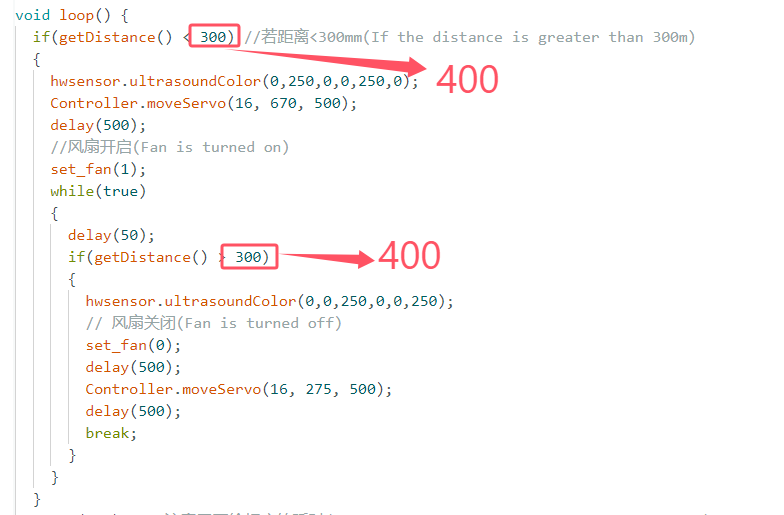

Here is an example of modifying the distance threshold for turning on the fan from 300mm to 400mm:
In the main function, locate the ultrasonic distance threshold and change it to 400. After this modification, when the distance is less than 400mm, the arm will lift and the fan will turn on. When the distance exceeds 400mm, the arm will lower and the fan will turn off.
  • FAQ
Q1: Why doesn’t the fan turn on after the ultrasonic sensor detects an obstacle?
A1: Please verify that the 4-pin wire is connected to the correct IO port. Refer to Section 2.3 for proper wiring.
Q2: Why is the ultrasonic distance measurement sometimes inaccurate?
A2: Ensure that the surface being measured is smooth and flat. Additionally, avoid prolonged close-range measurements of obstacles.
6.2.10 Touch Control Project
Touch the capacitive pad on the touch sensor, and Tonybot will perform a bowing motion.
The touch sensor operates based on capacitive sensing technology, detecting the presence of human skin or metal through its gold-plated contact surface.
When no human or metal is in contact with the surface, the signal output is high. Upon contact with a human or metal, the signal output becomes low. Additionally, the sensor can detect contact through materials such as plastic or paper. The sensitivity of detection is influenced by the size of the contact surface and the thickness of the covering material.
For module installation and wiring, please refer to the section 1 in the same directory.
  • Program Download
(1) Locate and open the program file “03 Touch Control Program/touch_action/touch_action.ino” in the directory corresponding to this section.
  • Achieved Effect
Tap the capacitive pad on the touch sensor, and Tonybot will perform a bowing motion.

Once the mode is activated, Tonybot will monitor the temperature and humidity, and display the data on the matrix module.

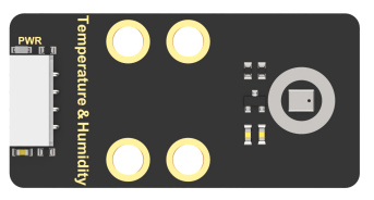

(1) Temperature and Humidity Sensor
This sensor detects the temperature and humidity of the environment and provides accurate readings.
The AHT10 module converts the air’s temperature and humidity into digital signals, which are then sent to the control board via I2C communication.
(2) LED Dot Matrix Module
The LED dot matrix module uses an 8x8 LED display, known for its high brightness, flicker-free display, and easy wiring. It can display numbers, text, patterns, and more. The module consists of two red 8x8 LED arrays and is controlled by the driver chip TM640B, enabling full control of the dot matrix screen.
For installation and wiring details, refer to the section “01 Sensor Assembly and Wiring” in this directory.
  • Program Download
(1) Locate and open the program file “03 Temperature and Humidity Detection Program/temperature_humidity/temperature_humidity” in the directory corresponding to this section.

Once the temperature and humidity are detected, the dot matrix module will display them individually.

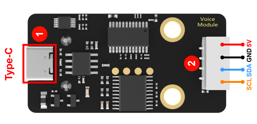

  • Interface Description
For detailed specifications and chip diagrams, please refer to the “3. Chip Manual”.
Type-C Interface: Used for powering the module and for firmware programming.
I2C Interface: Used for communication with host devices.
PIN Function Description
5V Power input
GND Power ground
SDA I2C data cable
SCL I2C clock cable

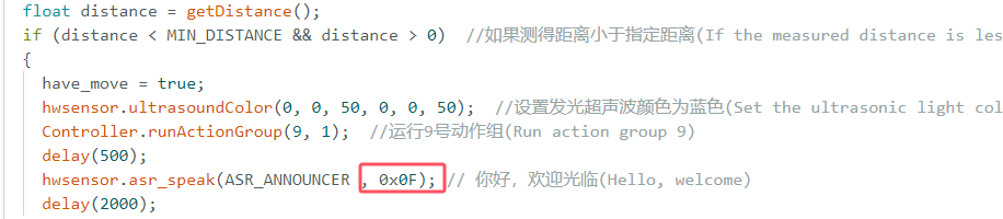

6.3.3 Distance Ranging & Announcement Project
This section utilizes the glowy ultrasonic module to measure the distance to an obstacle. Based on the detected distance, it controls the voice interaction module to announce messages and triggers the robot to perform specific action groups.
(2) Voice Interaction Module
The voice interaction module is built on embedded voice recognition technology. It consists of a voice recognition chip and supporting circuits, designed for seamless communication with the main control chip. This module enables both voice recognition and voice playback functionalities. Developers can easily integrate it into their products to enable voice interaction capabilities.
For instructions on module installation and wiring, please refer to assembly guide saved in the same directory.
  • Program Download
Distance Ranging & Announcement Program
(1) Locate and open the program file “02 Distance Ranging & Announcement Program/say_hello/say_hello.ino” in the directory corresponding to this section.
  • Expected Results
After powering on the Tonybot, slowly bring an object close to the glowy ultrasonic sensor. When the distance is less than 200mm, action group 9 will be executed, and the message ‘Hello, welcome’ will be announced.
  • Program Analysis
(1) Libraries Importing
Import the necessary libraries for servo control, sensor management, software serial communication, and other communication protocols required for the application.
#include "Servo.h"
(2) Define Pins and Instantiate Objects
Instantiate objects for the servo control class, sensor class, software serial class, and any additional communication classes needed for secondary development.
LobotServoController Controller(Serial2); //实例化二次开发通信库(Instantiate the secondary development communication library)
HWSensor hwsensor;  //实例化传感器类(Instantiate the sensor class)
Servo sonarServo; //超声波云台舵机控制类实例(Instantiate the ultrasonic pan-tilt servo controller class)
(3) Initialize Settings
61
void setup() {
  // 初始化机器人姿态(Initialize robot posture)
  delay(1500);
① Serial.begin(115200); initializes the main serial port (typically used for serial communication with a computer), setting the baud rate to 115200 and enabling data transmission.
② Next, sonarServo.write is used to communicate with a certain board, setting the baud rate to 9600, data format to 8 data bits, no parity bit, and 1 stop bit. Additionally, the pins for receiving and transmitting data (IO_BaseRX and IO_BaseTX) are specified.
③ sonarServo.attach(IO_Servo); binds the servo object sonarServo to the specified pin (IO_Servo), allowing subsequent control of the servo through the sonarServo object.
④ sonarServo.write(90); delay(200); rotates the servo to 90 degrees and waits for 200 milliseconds to ensure the servo has enough time to complete the movement. This is generally done to set a reasonable initial position for the servo before the ultrasonic sensor begins working.
⑤ sonarServo.detach(); after setting the servo’s initial position, the detach() function is called, so the servo is no longer controlled by the Arduino. This may be done to save power or because further movement of the servo is not required.
⑥ Controller.runActionGroup(0, 1); delay(1500); calls the runActionGroup method on the Controller object, instructing the robot to execute action group 0 for 1 second. Afterward, the program pauses for 1500 milliseconds with delay(1500) to allow the entire process to complete.
⑦ Serial.println(”start.”); prints “start.” to the serial monitor once the setup is complete, enabling you to monitor the program’s execution status during debugging.
(4) Main Function
Once initialization is complete, the program enters the main loop() function. In this function, the Controller.receiveHandle() method is called to receive data from the controller. The sonar() function is then invoked to measure the ultrasonic distance and trigger the speech output.
70
void loop() {
  sonar(); //用户函数(User-defined function)
  delay(50);  //注意需要给相应的延时(Please provide an appropriate delay)
The periodic reading of ultrasonic sensor data is achieved by calling the custom sonar() function, along with a delay(50) to manage timing.
In the function, three variables are defined to store the distance data measured by the ultrasonic sensor. The hwsensor.ultrasoundGetDistance() function is called to obtain the distance measurements from the ultrasonic sensor, and the average of these three distance values is then returned.
int getDistance() {  //获得超声波距离(Get ultrasonic distance)
