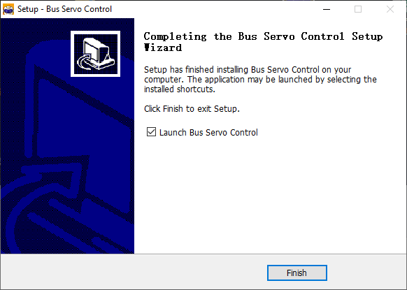

3.1.1 Software Installation
(1) Open the installation file located in this folder.
(2) In the pop-up window, choose your preferred installation language and click “OK”.
(3) The option to “Create a desktop shortcut” is selected by default. Click “Next” to proceed.
(4) Once the installation begins, wait for the completion prompt. When it appears, click “Finish” to complete the installation.

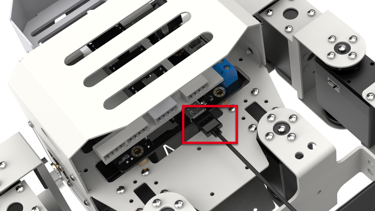

(2) Connect the robot controller to the computer using a Type-C cable.

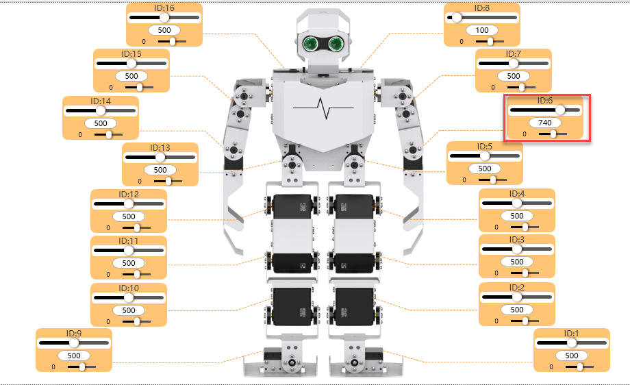

② Servo Control Zone
The servo control area displays the icon of the selected servo. You can adjust the servo’s position by modifying the corresponding slider value.
| Icon | Function Description |
This represents the servo's ID number, with 1 shown as an example. |
Position Adjustment: The value can be set between 0 (minimum) and 1000 (maximum). |
Deviation Adjustment: The value can range from -100 (minimum) to 100 (maximum). |

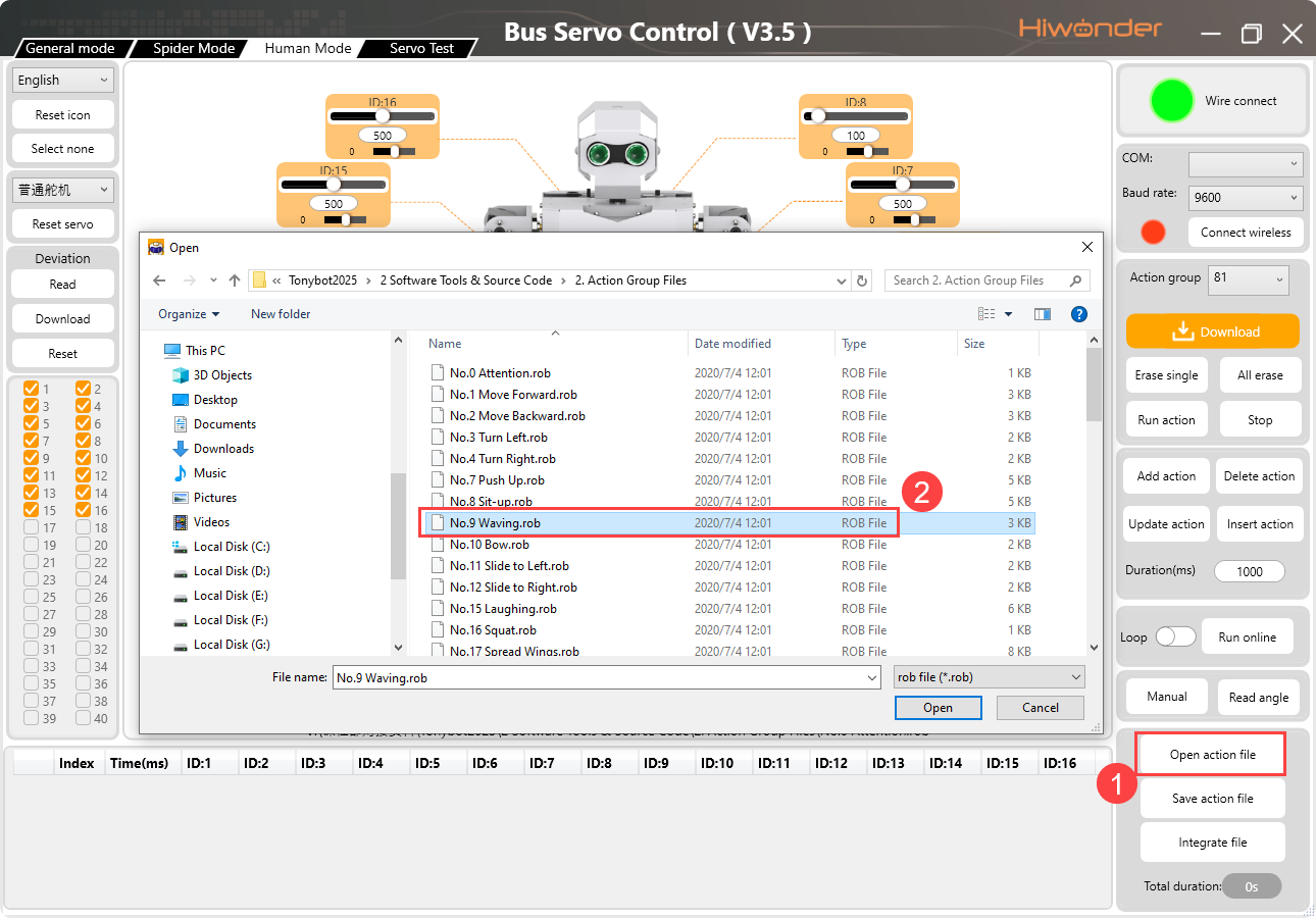

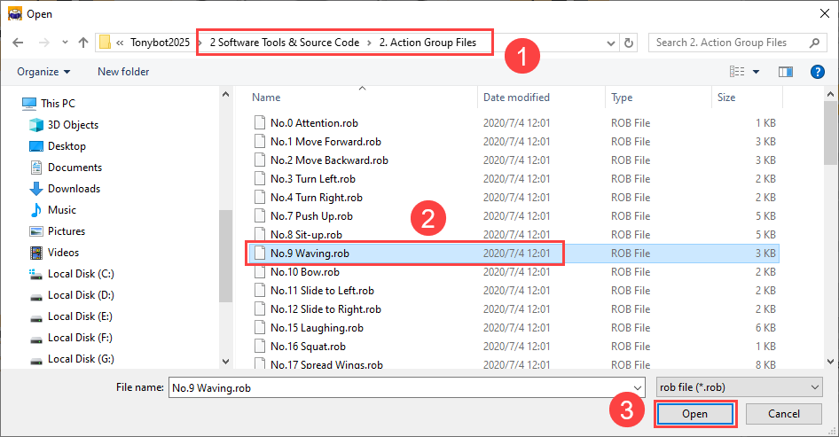

(3) Click on “Open Action File.”
(4) Navigate to the folder path Appendix ->2. Action Group Files and locate the action group titled “Wave No. 9.” Click “Open.”
(5) The opened action file will now appear in the action list.

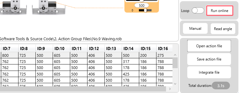

3.2.2 Run Action Groups Online
Click “Run Online” to initiate the execution of the action group.

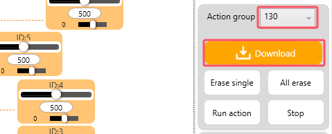

To run the action group offline or call it in future programs, you can download it to an action group slot.
(1) Click the dropdown menu next to the action group number and choose a number (Note: Some numbers between 0 and 110 are already assigned. To avoid overwriting existing action groups, select a number greater than 110. For example, 130 is used here). Then, click “Download”.
(2) After the download is complete, a “Download Complete” window will appear. Click “OK” to confirm.
(3) Choose the action group number and click “Run Action Group” to execute it.

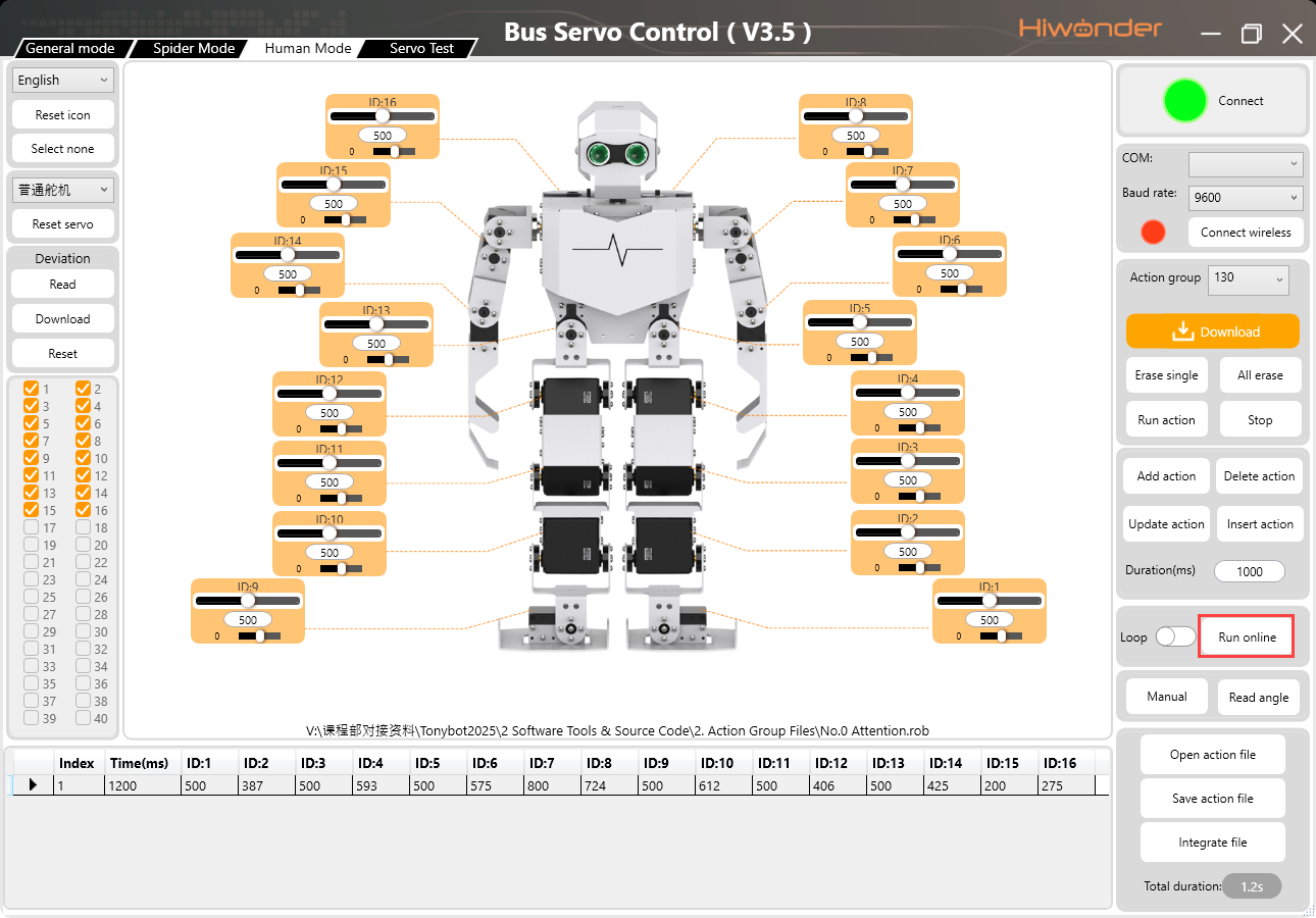

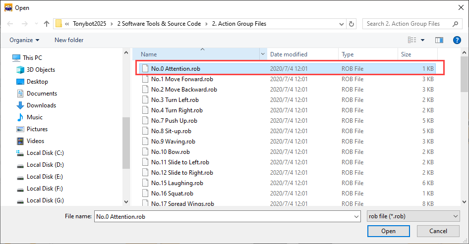

(2) In the action group settings area, click the “Open Action File” button to open action group 0 from the path “Appendix -> 2. Action Group Files”
Action groups 1-4 are basic robot movements and are encrypted; they can only be downloaded, not edited or run online.
(3) Once the first action is loaded, click the “Run Online” button to update the servo values in the corresponding control area.
(4) Next, edit the second action. Based on the servo ID distribution on the left, slide the servo 8 slider to the left, which will raise the robot’s left arm.
Hold down the left mouse button and click the slider quickly for fine adjustments.

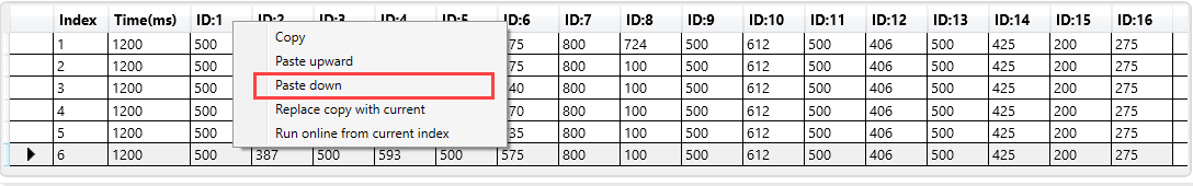

(5) Click “Add Action” to add the raised left arm action to the action list on the right.

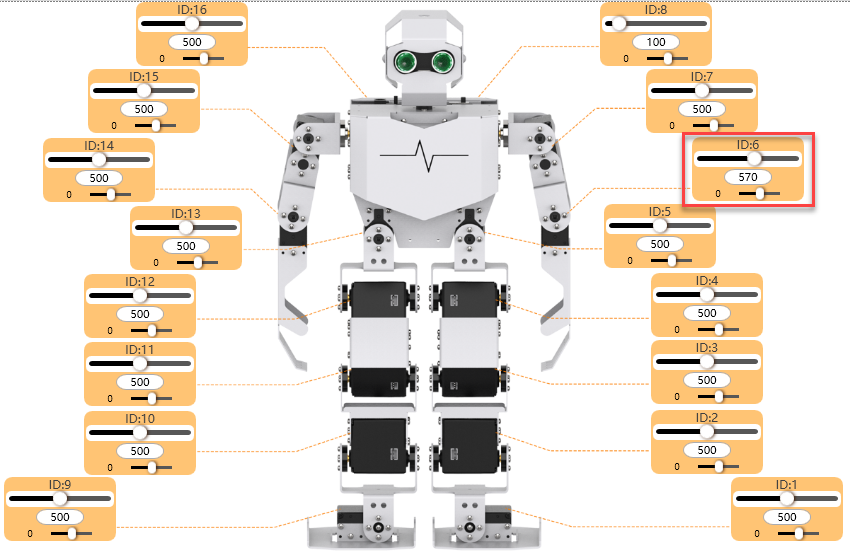

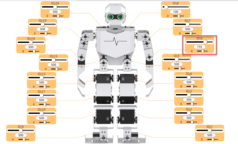

(6) Now, let’s slightly bend the left arm. Slide the servo 6 slider to the 740 position and click “Add Action” to include this action.
(7) To make the arm swing, move the servo 6 slider to the 570 position and add the action as before.
(8) After the arm swings, slide servo 6 to the 735 position and add it as the fifth action.
(9) Then, move servo 6 to the 575 position, completing the second swing, and add it as the sixth action.
(10) After the arm completes its swings, lower the arm and return the robot to a standing position. Right-click action 1 and select “Copy,” then right-click on action 6 and choose “Paste Down” to successfully copy action 1.
(11) The action group list is now complete, recording the necessary servo rotation parameters for each action.

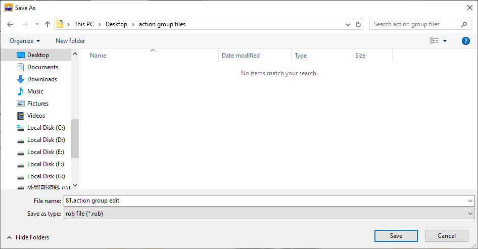

(1) After editing the action, save it locally for future debugging. Click the “Save Action File” button. In the pop-up window, enter a file name and serial number (e.g., “Action Group 81”), then click “Save” as shown in the image below.

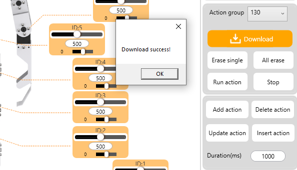

(2) Once saved, download the action to the designated action group. On the right side of the interface, select action group number 81, then click the “Download” button.
(3) When the download is complete, the robot will emit a “beep” sound as a reminder, and a “Download Complete” message will appear. Click “OK” to close the prompt.

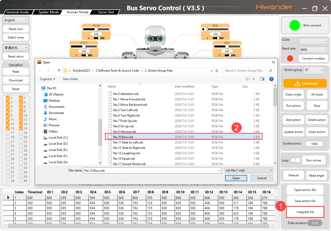

3.4 Integrate Action Files
In this lesson, we will introduce the function of integrating action files on the robot, enabling the merging of multiple action groups.
(1) Launch the PC software and connect to the serial port. Then, click the “Integrate Action Files” button in the action group settings section and open action group 9 from the “Appendix -> 2. Action Group Files” directory.
(2) You’ll see the details of action group 9 displayed in the action group list.
(3) Click the “Integrate Action Files” button again and select action group 10 to link it.
(4) To see the results, you can click “Run Online” to execute the newly chained action group.

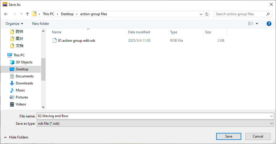

(5) Click the “Save” button to save the newly created action group for future use. We’ll call it “82-Wave and Bow.”

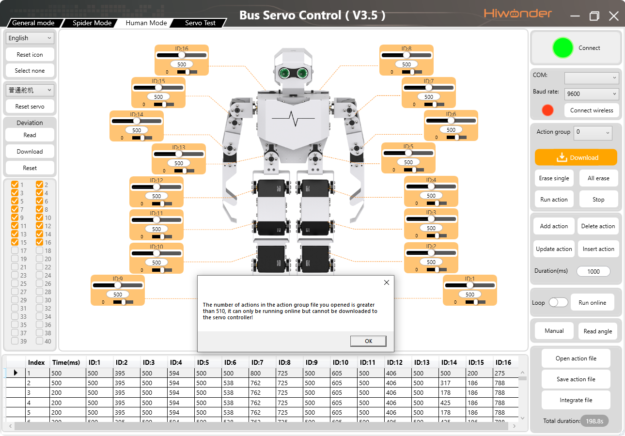

If the action list exceeds 510 actions, the software will warn you that the limit has been exceeded. In such cases, the action group can only be run online, not downloaded to the control board.

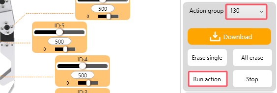

(1) Open an action group file from the directory Appendix -> 2. Action Group Files, such as action group 7, “Push-up”.
(2) On the right side, select action group number 100 and click “Download”.
The robot is pre-configured with action group 100 as the starting action group for offline mode. Other action group numbers, such as 98, will not work as the starting number for offline actions.
(3) After the action is downloaded, a success message will appear on the host computer. Click “OK” to close the message.

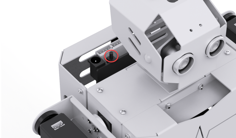

(4) Place the robot on a flat surface, turn on the power, and briefly press the black elastic button at the back of the robot’s head to run action group 100 offline.
To make the action group loop continuously, press and hold the elastic button for 3 seconds.
