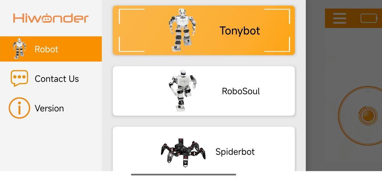

(2) Open the Wonderbot app and tap-on
and select Tonybot from the available robot models.

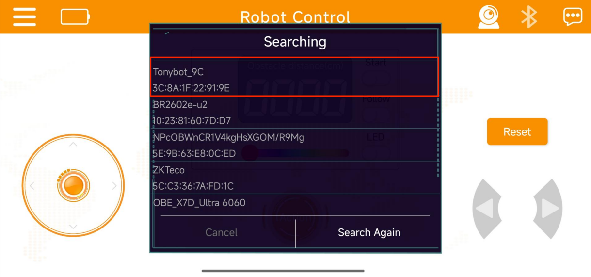

(3) Once you’re in the game control interface, tap the flashing Bluetooth icon
and select Tonybot from the list to complete the connection.
If you can’t find the device, tap the Search button to locate it.
(4) Once the connection is successful, the Bluetooth icon will stay lit, and the battery level will be shown on the left side.

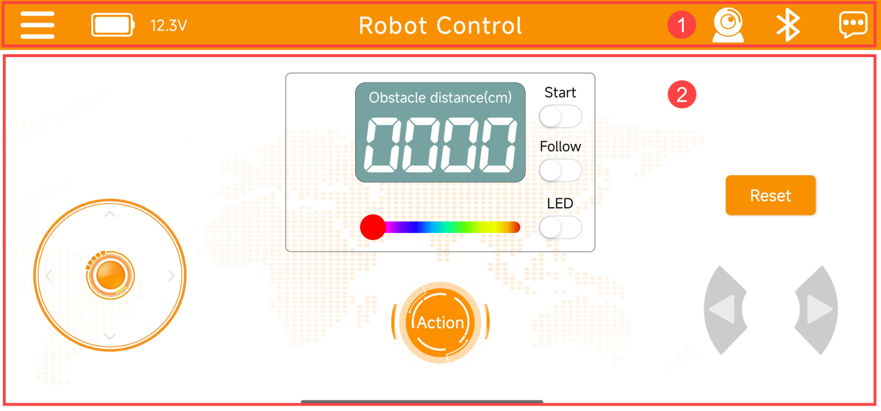

The app enables you to control Tonybot’s movements, ultrasonic obstacle avoidance, ultrasonic following, action groups, and the “Reset” function, all with a simple tap of a button.
The interface is organized into two sections, as illustrated in the image below:
(1) Menu Bar
| Icon | Description |
Return to the main interface to select the robot model |

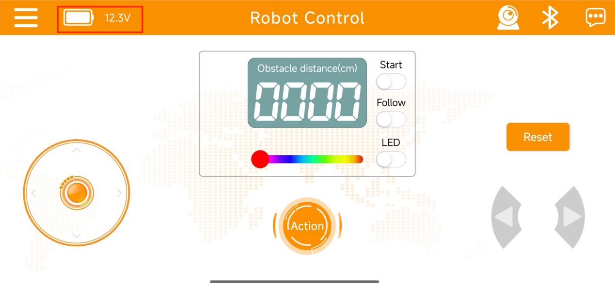

Displays Tonybot's current battery level in real-time |
Camera feed: View the live video stream from the ESP32 camera. |
Bluetooth connection: The icon flashes when disconnected and stays solid once connected. |
More information |
(2) Control Zone
Control Tonybot's movement |
View ultrasonic distance while in obstacle avoidance mode |
Turn the ultrasonic obstacle avoidance feature on or off |
Enable or disable the ultrasonic following feature |
Switch the ultrasonic RGB lights on or off |
Adjust the color of the ultrasonic RGB lights |
Tap to trigger an action group on Tonybot. (This includes both preset and custom action groups.) |
Control Tonybot's rotation in place |
Reset Tonybot's pose |

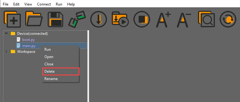

2.4 App Control Program Download (Optional)
Tonybot comes pre-installed with the app control program. If you download other custom programs, the app control functionality will be overwritten. To restore the app control feature, you can use one of the following methods:
2.4.1 Restore Program
The default factory program includes a self-recovery feature. To restore the app control, simply use the Python editor to connect to the device, delete the “main.py” program, and restart the device. Follow these steps:

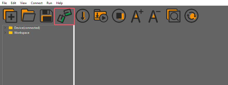

(1) Open the Hiwonder Python Editor software.
(2) Click the Connect button
in the menu. Once the connection is established, the icon will turn green
(3) In the “Device (Connected)” section, right-click the “main.py” file and select Delete. Afterward, restart the device to complete the process.

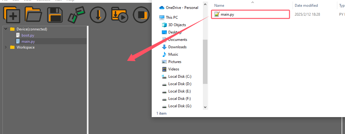

2.4.2 Redownload the App Control Program
in the menu. The icon will turn green once the connection is successfully established
(3) Drag the “main.py” file into the Python editor.
(4) Click
to download the program to the device. After the download is complete, restart the device to finalize the process.
