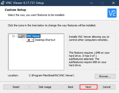

(1) Double-click the installation program “VNC-Viewer-6.17.731-Windows” in the same directory as this section. Select the installation language as “English” and lick “OK”.

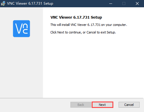

(2) Click “Next”.

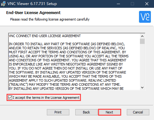

(3) Tick “I accept the terms in the License Agreement”. Then click “Next”.
(4) Remain default location where the software is installed. Click “Next” to proceed next interface. Then directly click “Install”.

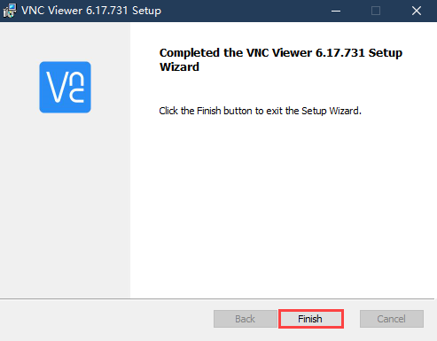

(5) When the installation completes, click “Finish”.

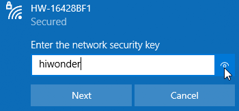

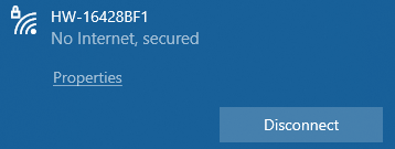

(1) After turning Robot on successfully, the default mode is AP direct connection mode. Robot generates a WiFi starting with HW. Connect your computer to this WiFi.
(2) Input password. The password is “hiwonder”.

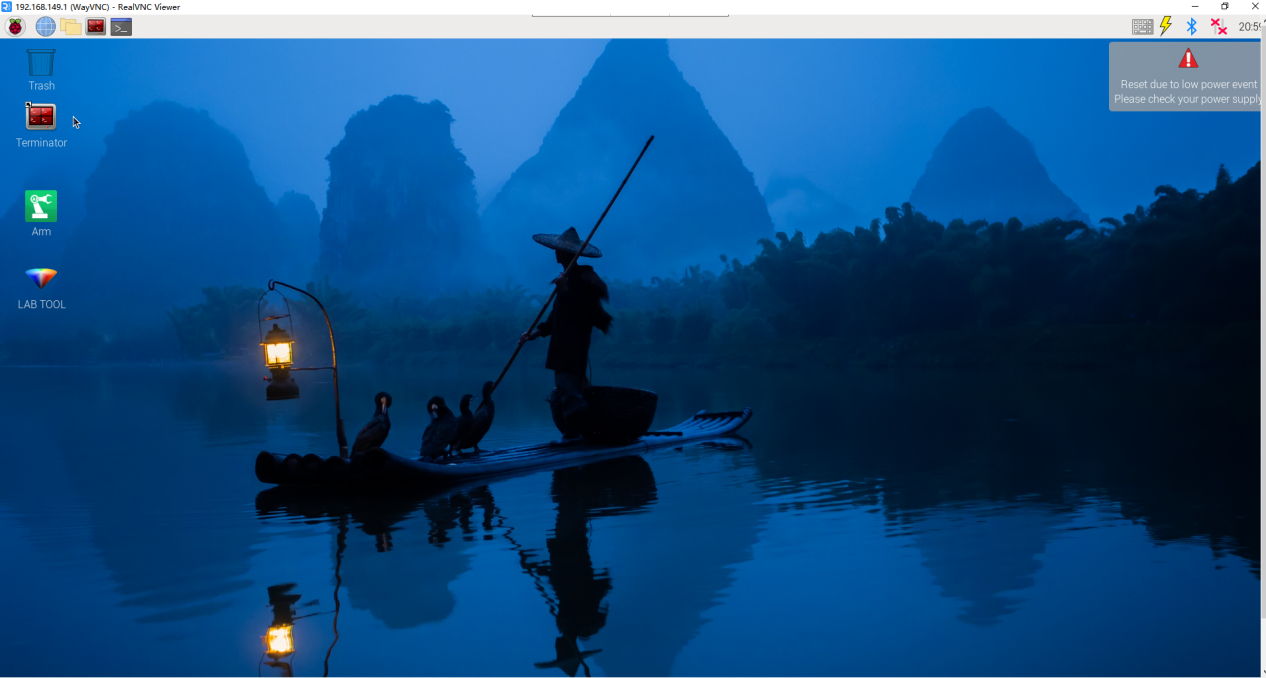

(3) After connection, open VNC Viewer. Input the default IP address of Raspberry Pi, 192.168.149.1, and then press Enter. If you receive security warning, select “Continue”.
(4) Input username and password. (Username: pi;Password: raspberrypi). Click “OK” to enter Raspberry Pi desktop.

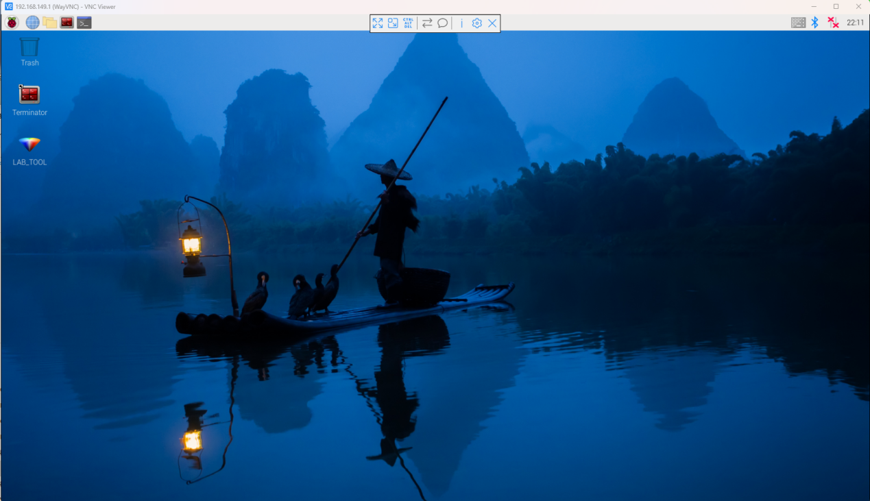

(5) The desktop is as pictured. If black screen occurs or only cursor leaves on the screen, restart Raspberry Pi.

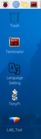

3.1.3 Introduction to Desktop
The desktop is as pictured after connecting Robot through VNC successfully.
The following table demonstrates common functions:
| Icon | Function |

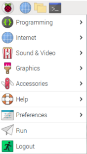

Application menu. Click to select different applications.
Browser. |
File manager. |
LX terminal. Click to input command line in the opened interface. |
Trash. You can find the files deleted here. |
PC software. You can adjust pan tilt and adjust color threshold on it. |
Full screen or exit full screen. |
Exit full screen. |
Shut down, reboot and logout

After remote connection via VNC, the Raspberry Pi system desktop is as shown in the figure below:
| Directory | Function |
TonyPi PC software which includes action programming, debugging etc. |
Chinese-English switching tool. |
Color model parameter adjustment tool. |
Terminator terminal, which is used to input command to proceed operation. |
File manager is a visual file directory interface.Recommended for beginner users who are not familiar with the command line. |

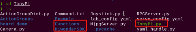

(2) Enter cd TonyPi to open all the games and program source code. In the TonyPi, enter “ls” command in the following three main directories. As shown below:
cd TonyPi
ls
| Functions | The directory where the AI vision game program is located. |
| TonyPi.py | Main program for running the games (auto-start has been set) |
| HiwonderSDK | Underlying file path (for hardware control) |
