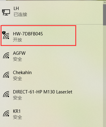

(1) Turn on the switch to start TonyPi.
(2) After turning on, Raspberry Pi will be in a AP hotspot mode and launch a Wi-Fi hotspot with a network named with the first letters “HW”.
(3) Open PC software, click “Scan” and wait for a moment to receive the data as below picture.
(4) Click “Connect” after scanning.

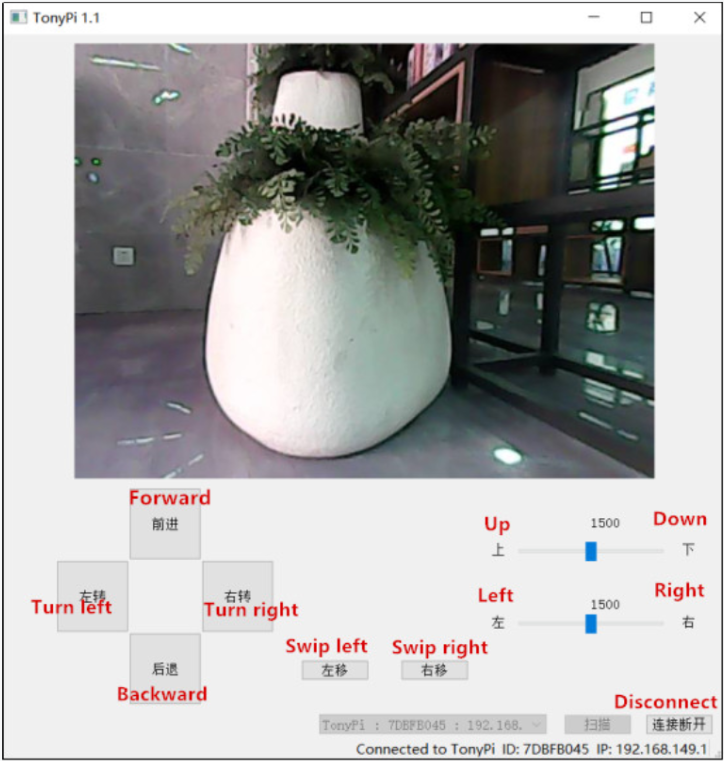

7.2 Start TonyPi with PC Software
(1) After successful scanning, let’s move to the device connection. Then the real-time returned screen will appear at the software.
(2) Next, you can control the movement of the robot by clicking the motion buttons on the left side of the interface. The layout and functions of the main interface are as follows:
(3) The functions of each area are as shown in the following table:
| Icon | Function area | Function |
Image feedback area | Display the returned image |
Body control area | TonyPi operation |
Rotation operation area | Rotation operation |
Connection state area | Scan, connect or turn off the launched hotspot |
