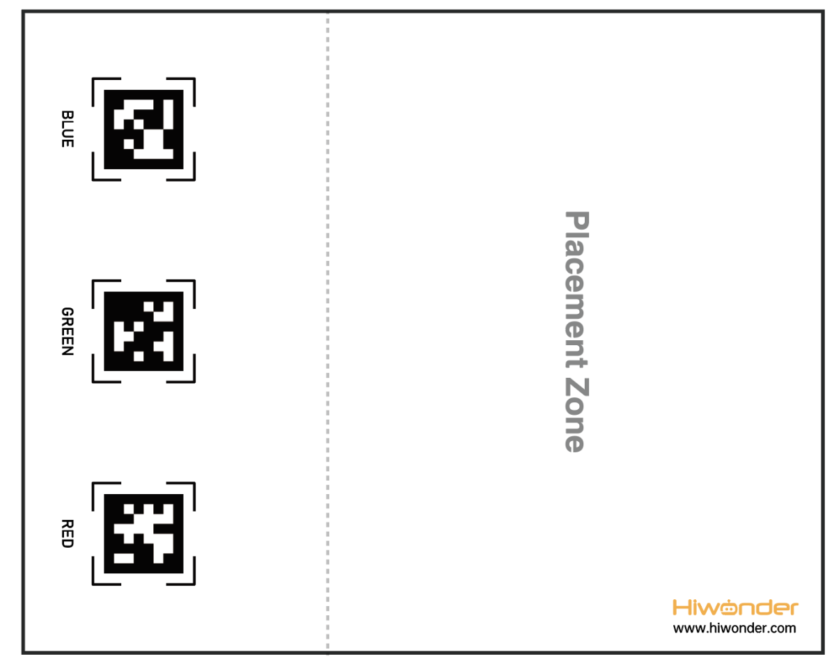

6.1.3 Preparation
(1) The function of this section should be operated on the provided map. The right side is the items placement zone and the left side is the receiving space.
(2) Place the map on the smooth floor. Place the TonyPi and color blocks in the placement zone.

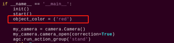

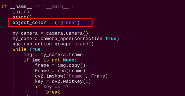

(3) Find the code object_color = ('red').
After entering the code position number on the keyboard, press “Shift+G” to directly locate to the corresponding location. This section aims to introduce quick location methods, so the code position number is for reference only. Please rely on actual positions.
(4) Press “i” to enter the editing mode, then modify red in “_target_color = (‘red’)” to green.

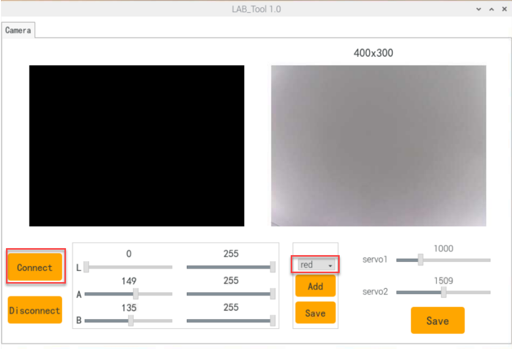

(2) Click the debugging tool icon in the system desktop. Choose “Run” in the pop-up window.
(3) Click “Connect” button in the lower left hand. When the interface display the camera returned image, the connection is successful. Select “red” in the right box first.

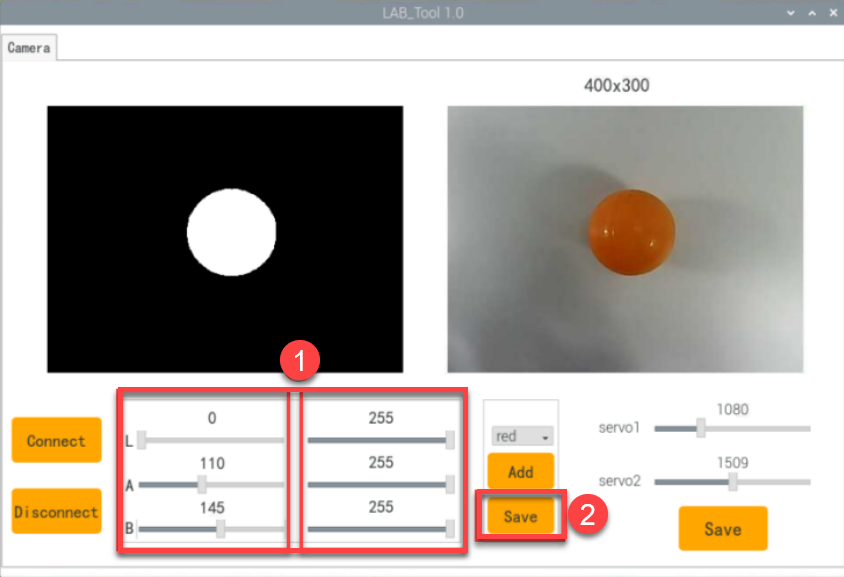

(4) Drag the corresponding sliders of L, A, and B until the color area to be recognized in the left screen becomes white and other areas become black.
For example, if you want to recognize orange, you can put the orange ball in the camera’s field of view. Adjust the corresponding sliders of L, A, and B
until the blue part of the left screen becomes white and other colors become black, and then click “Save” button to keep the modified data.
For the game’s performance, it’s recommended to use the LAB_Tool tool to modify the value back to the initial value after the modification is completed.

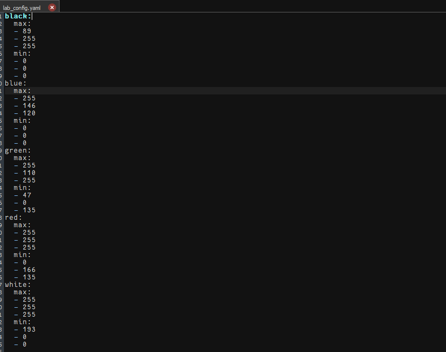

(5) After the modification is completed, check whether the modified data was successfully written in. Enter the command again “vim TonyPi/lab_config.yaml” to check the color setting parameters.
vim lab_config.yaml
(6) Check the data in red frame. If the edited value was written in the program, press “Esc” and enter “:wq” to save it and exit.
:wq
