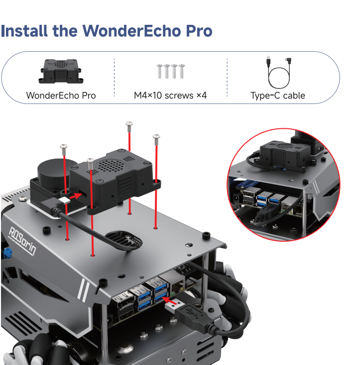

8.1.1 Install the WonderEcho Pro

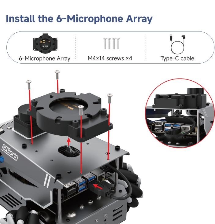

8.1.2 Install the 6-Microphone Array

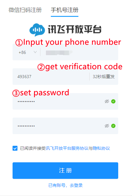

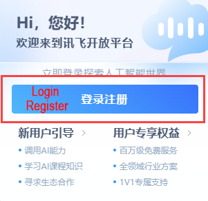

  1. Visit the iFlytek Open Platform at https://www.xfyun.cn/, and create a new account.
  2. Choose Login with phone number and fill in the required information. International users may select their appropriate country code.

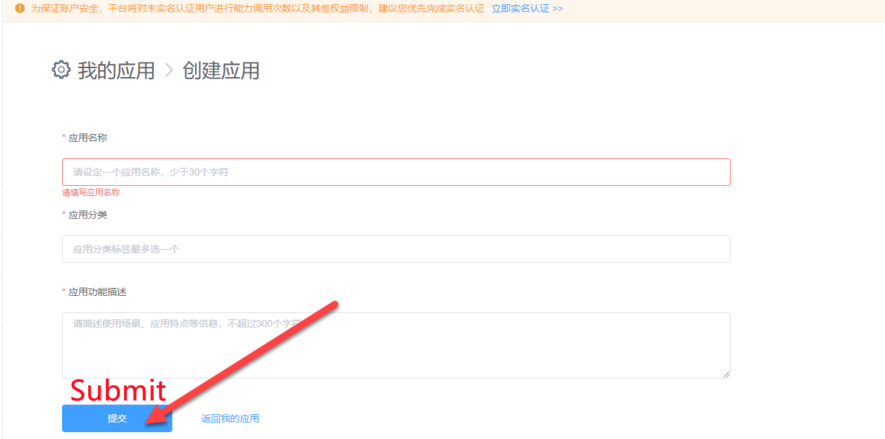

  3. Once registered, go to console > My Application to create a new application.
  1. Fill in the required fields and click Submit.

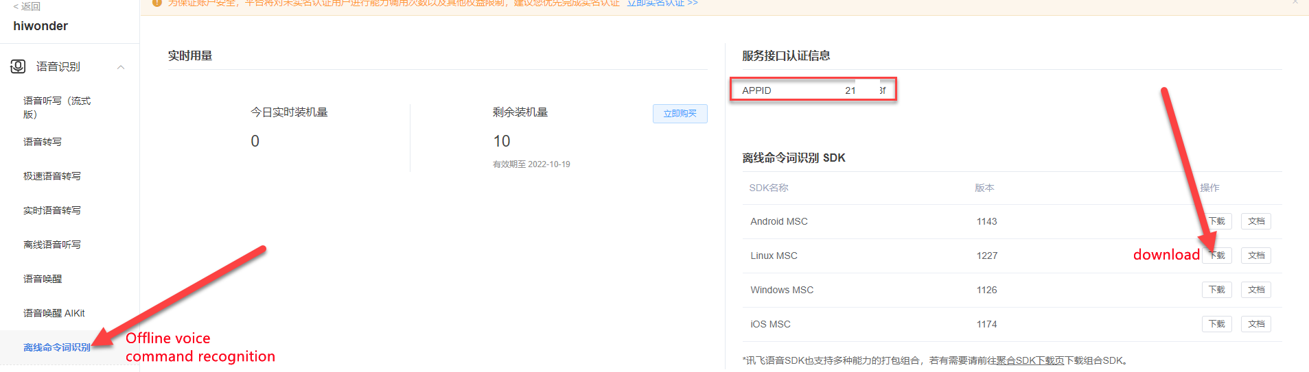

  1. Open the newly created application.
  1. Click on Offline Voice Command Recognition, locate the corresponding APPID in the red box shown below. Then navigate to Offline Wake Word Recognition SDKLinux MSC and click to download.
Each newly registered application can be used for free for 90 days. After the free period expires, continued use requires a paid plan. When an application expires, a new one can be registered, with a maximum of five applications per account. The process for creating a new app is the same.

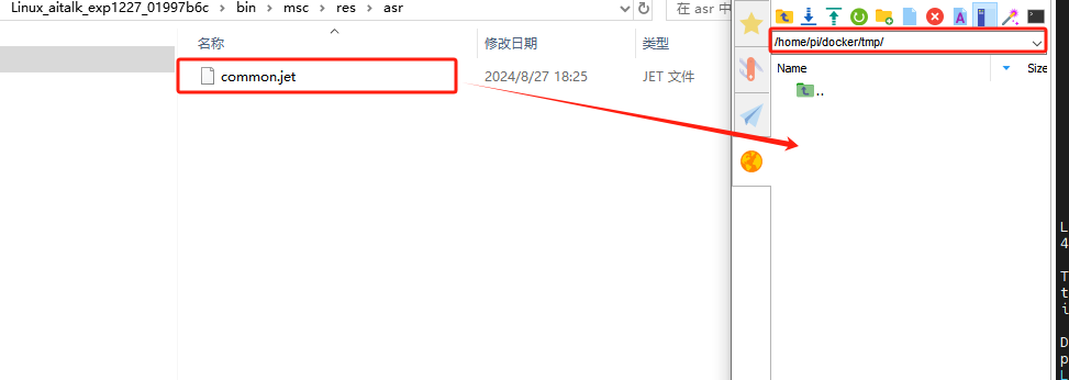

  1. Extract the compressed package from the provided materials.
Locate the extracted files according to the chosen download path.
Open the folder named Linux_aitalk_exp1227_01997b6c. The version ID, such as 1227_01997b6c, may vary depending on the official release. Navigate to the bin/msc/res/asr directory and locate the common.jet file. Use the SSH remote connection tool MobaXterm to drag files onto the image desktop, placing them in /home/pi/docker/tmp.
For detailed instructions on connecting with the SSH remote tool, refer to Section 1.7.2 AP Mode Connection Steps.
  1. Click the terminal icon in the system desktop to open a command-line window.
  2. Run the following command to replace the common.jet file:
cp /home/ubuntu/share/tmp/common.jet /home/ubuntu/ros2_ws/src/xf_mic_asr_offline/config/msc/res/asr/

  1. Before starting, install the voice module onto the robot and connect it to the hub via the USB port. Skip if already installed.

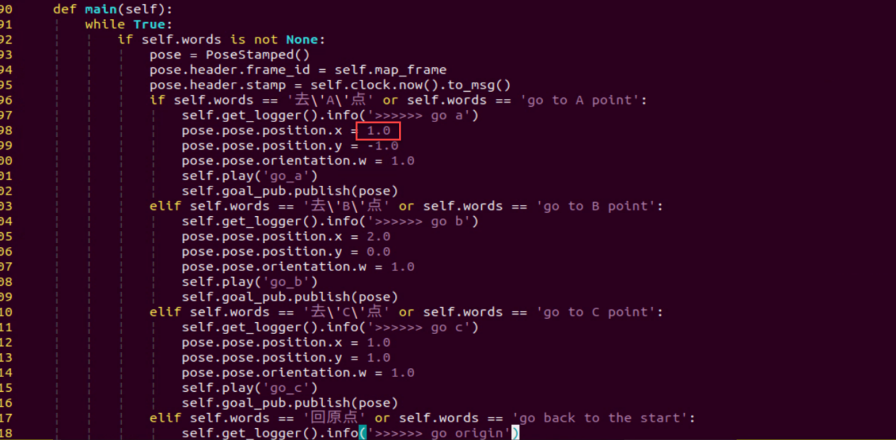

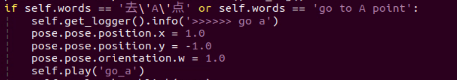

words_callback:
    def words_callback(self, msg):
        self.words = json.dumps(msg.data, ensure_ascii=False)[1:-1]
        if self.language == 'Chinese':
            self.words = self.words.replace(' ', '')
        self.get_logger().info('words:%s' % self.words)

                if self.words == '去\'A\'点' or self.words == 'go to A point':
                    self.get_logger().info('>>>>>> go a')
                    pose.pose.position.x = 1.0
                    pose.pose.position.y = -1.0
                    pose.pose.orientation.w = 1.0
                    self.play('go_a')
                    self.goal_pub.publish(pose)

8.6.5 Extensions
The default position of Point A is at the top-right corner of the robot’s starting position on the map, with coordinates (1, -1) in meters. To change the location of Point A, modify the coordinate values. For example, to place Point A at the bottom-right corner of the starting position, follow these steps:
  • The positions of points B and C can be adjusted according to the procedures in this section.
  • Commands must be entered with correct capitalization. The Tab key can be used to auto-complete keywords.
  1. Power on the robot and connect it via the VNC remote control software.
  3. Enter the command to disable the app auto-start service.
  1. Open the program file by entering the following command.
vim ./ros2_ws/src/xf_mic_asr_offline/scripts/voice_control_navigation.py
  1. Locate the code shown in the figure below.
  1. Press the i key to enter edit mode. Change the value 1 to -1.
The positive direction of the X-axis is considered the front, while the positive direction of the Y-axis is to the left. To place Point A in the bottom-right corner of the robot’s starting position, change the X-axis coordinate of Point A from positive to negative.
  1. Once the modification is complete, press the Esc key, type :wq, and press Enter to save and exit the file.
:wq
  1. Refer to 8.6.3 Operation Steps to restart the feature and verify that the wake word has been updated.
