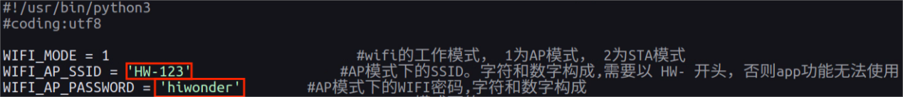

  • Configuring the Leader Robot Network
  1. First, select one robot as the leader, power it on, and then remotely connect to its system desktop.
  1. Open a terminal and input the following command to navigate to the directory where the file is located.
cd wifi_manager
  1. Next, input the command below to open the Wi-Fi configuration file using the vim editor.
vim wifi_conf.py
  1. Press the i key to enter the edit mode. Locate the two lines of code highlighted in the image below and modify the leader hotspot password.
  1. Once the changes are complete, press the Esc key to exit the edit mode. Then input :wq to save the changes and exit.
:wq
  1. Finally, input the command to reboot the leader robot.
sudo reboot
  1. After the leader robot restarts, when reconnecting to the Wi-Fi, enter the Wi-Fi password hiwonder.

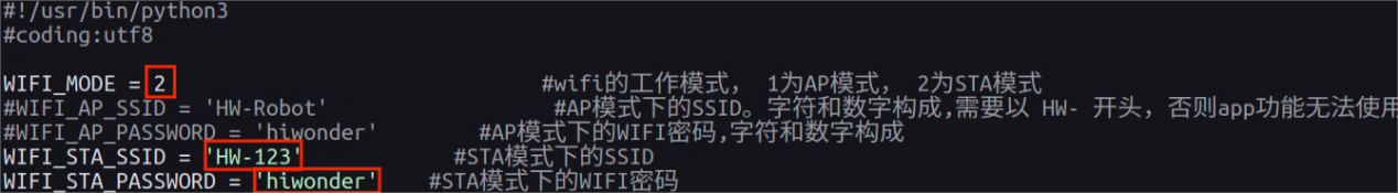

  • Configuring the Follower Robot Network
  1. Power on the follower robot and remotely connect to its system desktop.
cd wifi_manager
vim wifi_conf.py
  1. Press the i key to enter the edit mode, then modify the Wi-Fi name and password lines as shown in the image below. Locate the three highlighted lines of code.
Set the follower robot’s network mode to 2 for LAN mode. HW-123 and hiwonder are the Wi-Fi name and password configured for the leader robot network.
  1. Once the changes are complete, press the Esc key to exit the edit mode. Then, input the command to save and exit.
:wq
  1. Finally, input the command to reboot the robot. This step cannot be skipped!
sudo reboot
  • When ROSOrin starts up in LAN mode, it will automatically search for the pre-configured network. During this process, LED2 on the expansion board will blink rapidly, indicating that the system is looking for the network. If no network is found after three consecutive search attempts, ROSOrin will automatically switch to direct connection mode, with LED2 blinking slowly.
  • In the event that ROSOrin cannot find the network in LAN mode and switches to direct connection mode, the wifi_conf.py file will not be updated automatically. It will still contain the LAN configuration, and if not manually adjusted, ROSOrin will attempt to connect in LAN mode again on the next boot.
  • Once the follower robot is set to LAN mode, ensure that the leader robot is powered on and its network is properly configured, so that its hotspot can be detected before the follower starts up. If the follower robot fails to detect the leader’s hotspot within a certain time frame, it will automatically switch to direct connection mode, which may prevent the leader and follower robots from establishing a network connection.

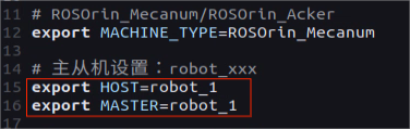

  1. Input the command to open the file and configure the environment variables for the leader robot.
vim /home/ubuntu/ros2_ws/.typerc
  1. Press the i key to enter edit mode, then set both the leader and follower configurations, setting the leader robot as robot_1.
:wq
  1. Finally, input the following command to complete the leader robot configuration.
source ~/.zshrc

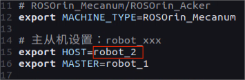

  1. Input the command to open the file and configure the environment variables for the follower robot.
  1. Press the i key to enter edit mode, then open the leader-follower settings and set the follower robot’s HOST variable to robot_2.
:wq
  1. Finally, run the command to refresh the environment variables.
source ~/.zshrc
