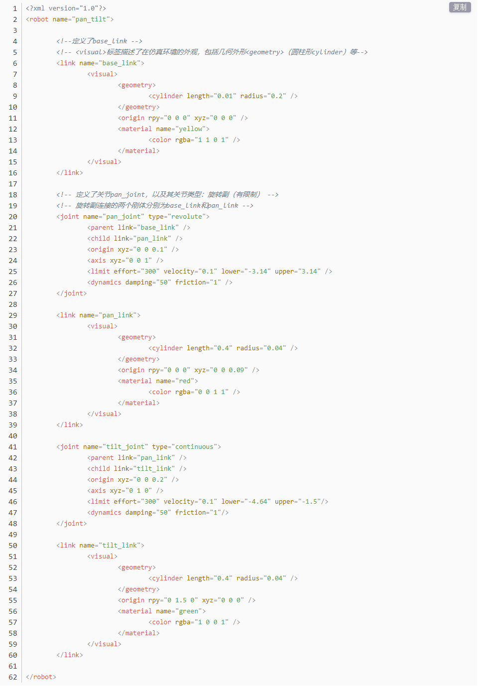

  • Create a simple URDF model
  1. Set the robot model name
At the beginning of a URDF model, set the robot’s name: <robot name=”robot_model_name”>. At the end of the model, enter </robot> to indicate the completion of the robot model.
  1. Sett a Link
(1) Define the first link. Use indentation to indicate that this link belongs to the current model. Set the link name: <link name=”link_name”>. At the end of the link definition, enter </link> to indicate the link is complete.
(2) Define the link’s visual description. Use indentation to indicate that this description belongs to the current link. Start with <visual> and end with </visual>.
(3) <geometry> describes the shape of the link. Close it with </geometry>. Use indentation to indicate that its content provides the detailed description of the link’s shape. The example below describes a link shape: <cylinder length=”0.01” radius=”0.2”/>, where length=”0.01” indicates the link’s length is 0.01 meters, and radius=”0.2” indicates the link’s radius is 0.2 meters, forming a cylinder.
(4) <origin> describes the position of the link. Use indentation to indicate the detailed description of the link’s position. The example below describes a link’s position: <origin rpy=”0 0 0” xyz=”0 0 0”/>, where rpy defines the link’s angles, and xyz defines the link’s coordinates. This indicates that the link is positioned at the origin of the coordinate system.
(5) <material> describes the link’s appearance. Use indentation to indicate the detailed description of the link’s color. Start with <material> and end with </material>. The example below sets the link color to yellow: <color rgba=”1 1 0 1”/>, where rgba=”1 1 0 1” specifies the color values.
  1. Set a Joint
(1) Define the first joint. Use indentation to indicate that this joint belongs to the current model. Set the joint name and type: <joint name=”joint_name” type=”joint_type”>. At the end of the joint definition, enter </joint> to indicate the joint is complete.
(2) Define the joint’s connected links. Use indentation to indicate that this description belongs to the current joint. Set the parent and child parameters. They can be set as follows: <parent link=”parent_link”/>, <child link=”child_link”/>. When the joint rotates, the parent link serves as the pivot, and the child link rotates accordingly.
(3) <origin> describes the joint’s position. Use indentation to indicate the detailed description of the joint’s position. The example below describes a joint position: <origin xyz=”0 0 0.1”/>, where xyz specifies the joint coordinates, indicating that the joint is located at x=0, y=0, z=0.1 in the coordinate system.
(4) <axis> describes the joint’s orientation. Use indentation to indicate the detailed description of the joint’s pose. The example below describes a joint orientation: <axis xyz=”0 0 1”/>, where xyz specifies the joint’s orientation.
(5) <limit> constrains the joint’s movement. Use indentation to indicate the detailed description of the joint’s angular limits. The example below shows a joint limited to a maximum effort of 300 N, an upper rotation limit of 3.14 radians, and a lower rotation limit of -3.14 radians. It is set as follows: effort=”joint effort (N)”, velocity=”joint speed”, lower=”lower rotation limit (rad)”, upper=”upper rotation limit (rad)”.
(6) <dynamics> describes the joint’s dynamics. Use indentation to indicate the detailed description of the joint’s properties. The example below shows a joint’s dynamic parameters: <dynamics damping=”50” friction=”1”/>, where damping=”damping value” and friction=”friction force”.

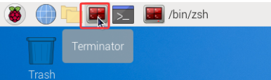

  2. Click the terminal icon in the system desktop to open a new command-line window.

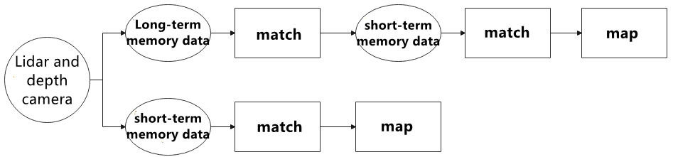

  1. Preprocessing: Optimize the raw point cloud data from the Lidar, remove problematic data, or apply filtering.
Using laser as the signal source, pulses emitted by the Lidar hit surrounding obstacles, causing scattering.
Part of the reflected light returns to the Lidar receiver. Using the laser ranging principle, the distance from the Lidar to the target point can be calculated.
Regarding point clouds: Simply put, the information captured by the Lidar about the surrounding environment is called the point cloud. It represents the part of the environment that the robot’s “eyes” can see. The captured object information is presented as a series of discrete points with precise angles and distances.
  1. Matching: Match the current local point cloud data to the existing map to find the corresponding position.
Typically, a Lidar SLAM system compares point clouds captured at different times to calculate the Lidar’s relative movement and pose change, thereby completing the robot’s localization.
  1. Map fusion: Merge the new data from the Lidar into the existing map, updating the map continuously.

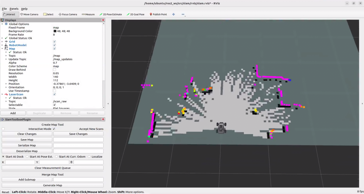

  1. Entering the following command to start mapping.
  1. Click the system command-line terminal icon to open a new terminal window.
  1. Enter the command to start the RVIZ tool to display mapping results:

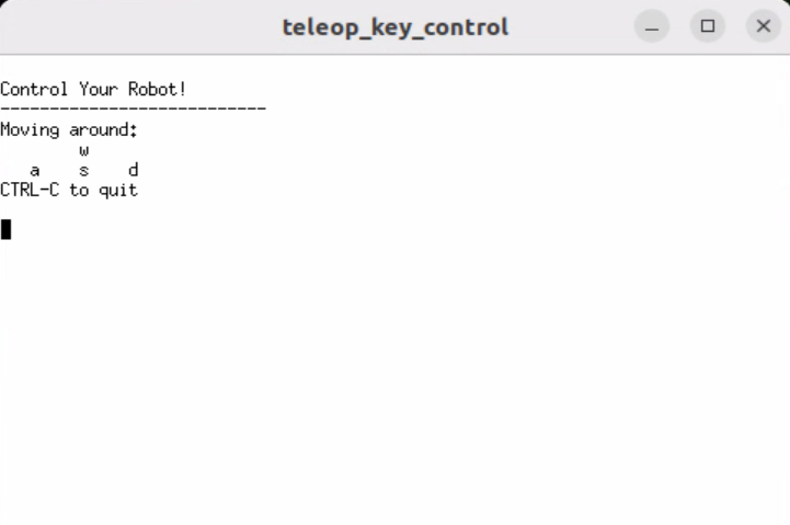

  1. Then enter the command to start the keyboard control node and press Enter:
If the prompt shown below appears, the keyboard control service has started successfully.
  1. Control the robot to move within the current space to build a more complete map. Table of keyboard keys and the robot action functions.

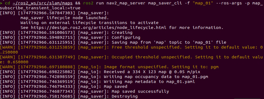

5.1.4.3 Save Map
  2. Enter the command to save the map and press Enter:
If the prompt shown above appears, the map has been saved successfully.
5.1.4.4 Exit Mapping
  1. Right-click the system command-line terminal icon and select New Window to open another command-line terminal.
  2. Then enter the command and press Enter to execute the program for all ROS nodes in the current system environment. If it does not close successfully, repeat the command as needed.
5.1.4.5 Effect Optimization
To achieve more accurate mapping results, optimize the odometer. The odometer is required for robot mapping, and it depends on the IMU.
The robot is preloaded with calibrated IMU data, which allows it to perform mapping and navigation normally. However, the IMU can still be recalibrated to achieve higher precision. For IMU calibration methods and procedures, refer to the section 2.1.1 IMU Calibration of 2. Chassis Motion Control Course.
5.1.4.6 Parameter Description
The parameter file can be found at: ~/ros2_ws/src/slam/config/slam.yaml
For detailed parameter information, refer to the official documentation at: https://wiki.ros.org/slam_toolbox

RTAB-VSLAM is a real-time, appearance-based 3D mapping system. It is an open-source library that implements loop closure detection through memory management methods. By limiting map size, it ensures that loop closure detection is always processed within a fixed time frame, thereby meeting the requirements for long-term and large-scale online mapping.
5.1.5.2 RTAB-VSLAM Working Principle
RTAB-VSLAM 3D mapping uses a feature-based mapping method. Its advantage lies in the abundance of feature points available in most environments, providing good scene adaptability and enabling relocalization using feature points. However, it has several drawbacks: feature point extraction is time-consuming; feature points utilize limited information, losing most of the image details; the method becomes ineffective in weak-texture areas; and feature matching is prone to mismatches, which can significantly affect the results.
After extracting image features, features from different time frames are matched to form loop closure detection. Once matching is completed, data are categorized into two types — long-term memory data and short-term memory data. Long-term memory data are used for matching future data, while short-term memory data are used for matching temporally continuous data.
During operation, the RTAB-VSLAM algorithm first uses short-term memory data to update pose estimation and mapping. When future data can be matched with long-term memory data, the corresponding long-term memory data are incorporated into short-term memory to further update pose and mapping.
RTAB-VSLAM package link: https://github.com/introlab/rtabmap

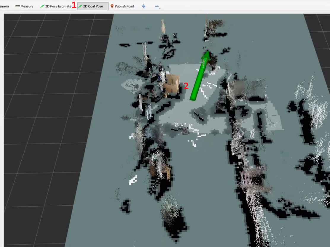

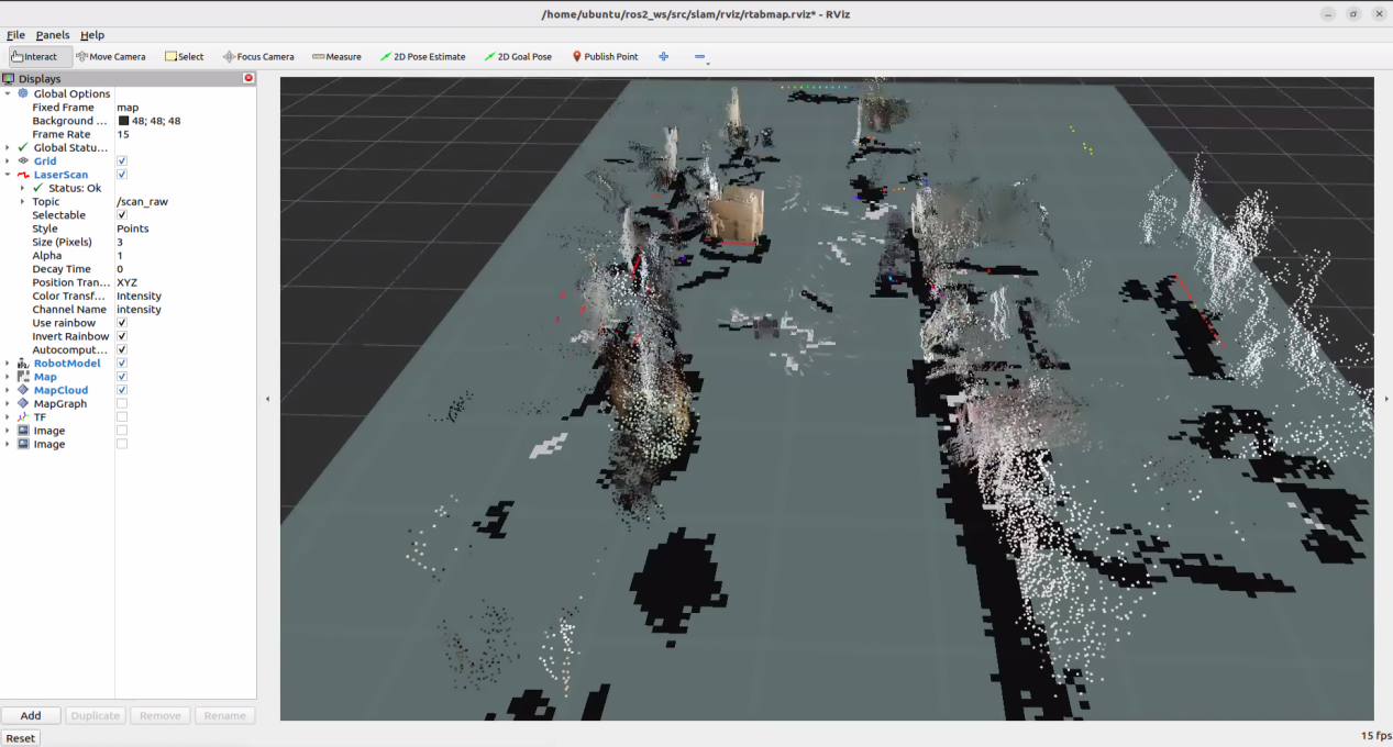

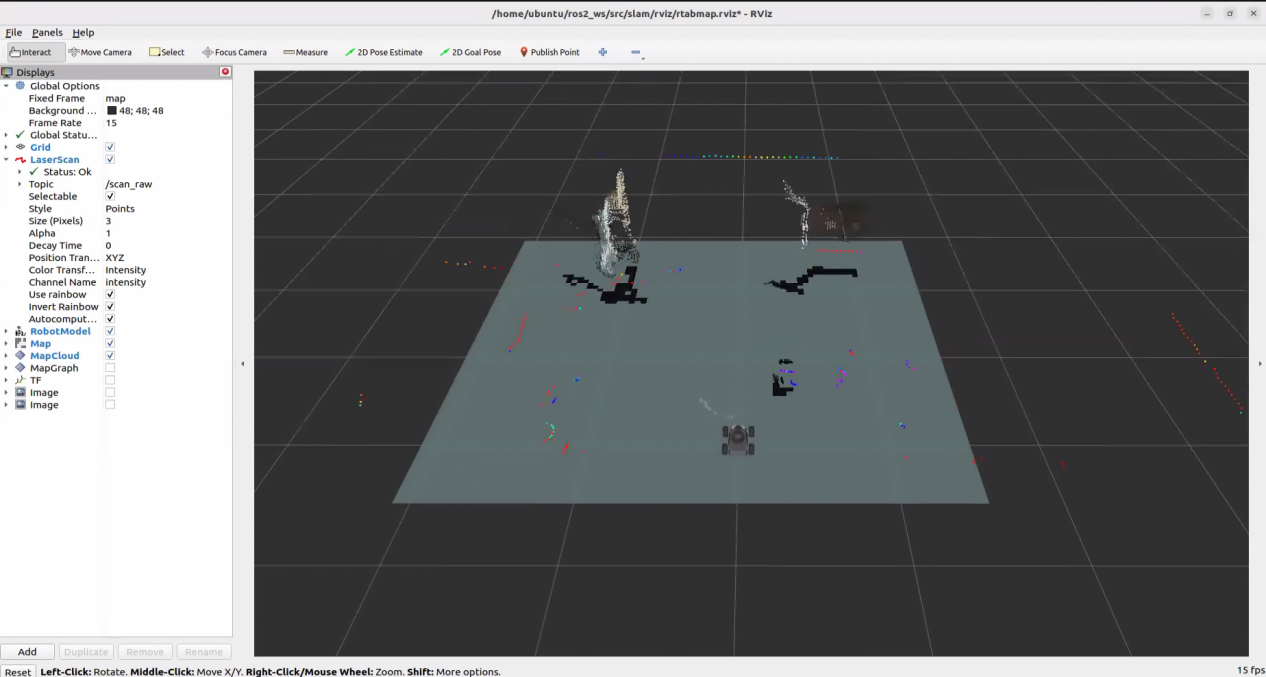

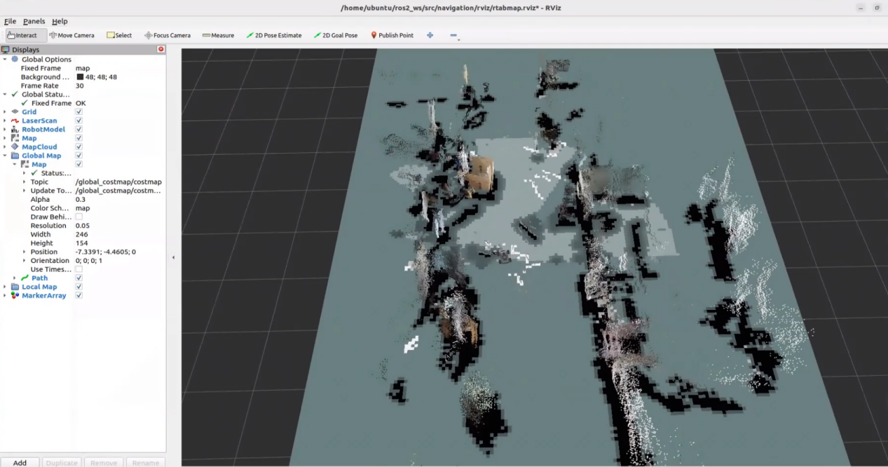

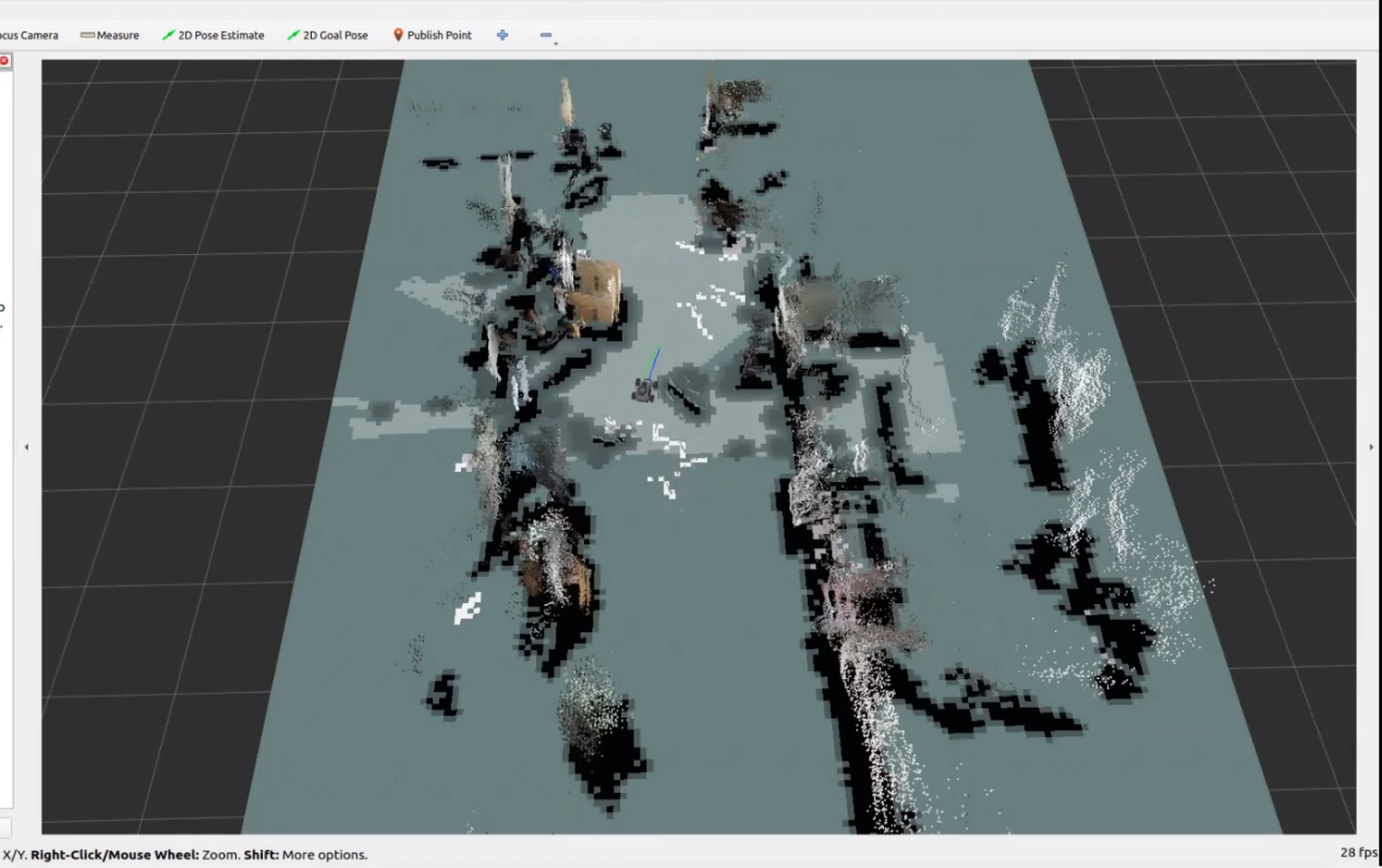

5.1.5.3 3D Mapping Steps
  1. Start the robot and connect it to the remote control software VNC. For connection instructions, please refer to the section 1.7.2 AP Mode Connection Steps in the user manual.
  2. Click the terminal icon in the system desktop to open a ROS2 command-line window. Enter the command to disable the app auto-start service.
  1. Press the Ctrl+Shift+E key combination to open a new command-line terminal, then enter the command to launch RViz and display the mapping result.
  1. Press Ctrl+Shift+O to open another command-line terminal, then enter the command to start the keyboard control node and press Enter.
Keyboard Key Robot Action
W Short press to switch to forward mode, keep moving forward.
S Short press to switch to backward mode, keep moving backward.
A Long press to interrupt forward or backward movement and turn left.
D Long press to interrupt forward or backward movement and turn right.
When controlling the robot via keyboard for mapping, it is recommended to reduce the robot’s movement speed appropriately. The lower the movement speed, the smaller the odometry error, resulting in better mapping performance. As the robot moves, the map displayed in RVIZ will continue to expand until the entire environment is fully mapped.
5.1.5.4 Save Map
After completing the mapping, press Ctrl + C in each command-line terminal window to stop the currently running program.
For 3D mapping, manual map saving is not required. When the mapping command is stopped using Ctrl + C, the map is automatically saved.
