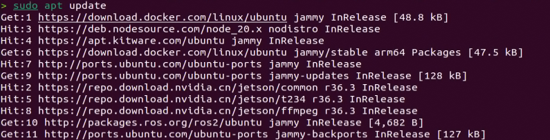

(1) Environment Configuration
sudo apt update

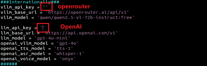

(3) Key Configuration
cd ~/large_models
vim config.py

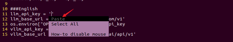

③ Once the file is open, configure the OpenAI and OpenRouter keys by filling in the llm_api_key and vllm_api_key parameters, respectively (you can obtain these keys from the ‘10.1.1 Large Language Model Courses -> Large Language Model Deployment’ course).
:wq

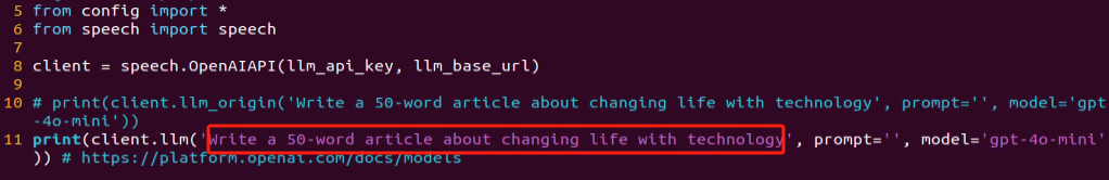

(4) Running the Demo Program
python3 openai_llm_demo.py

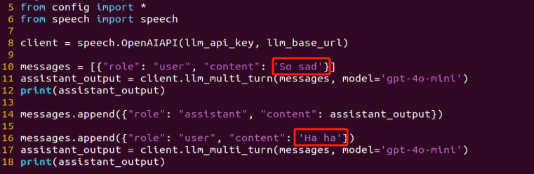

Before starting this section, make sure you have completed the API key configuration outlined in the file 10.1.1 Large Language Model Courses -> Large Language Model Accessing.
cd large_models/
To proceed with this section, ensure that you have completed the API key configuration as described in the file 10.1.1 Language Model Courses -> Large Language Model Accessing.
cd large_models/
python3 openai_llm_er_demo.py

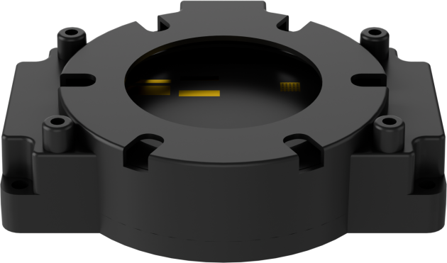

① 6-Microphone Circular Array
Introduction:
Features and Specifications:

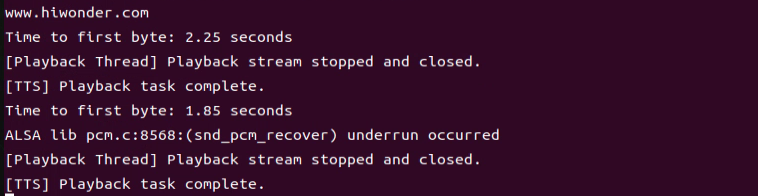

  • Speech Synthesis
(1) What is Speech Synthesis?
(2) How It Works
Refer to the course “Large Language Model Deployment” to obtain your API key, and update the configuration file accordingly.
(4) Experiment Steps
cd large_models/
vim config.py
python3 openai_tts_demo.py
(5) Function Realization
(6) Brief Program Analysis
① Module Import
from config import *
from speech import speech
② Definition for TTS Class
③ Function Extension
vim openai_tts_demo.py
i
:wq

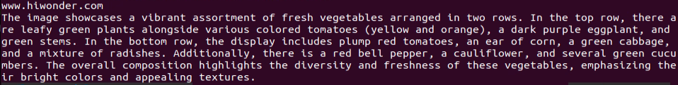

(1) Experiment Steps
cd large_models/
Run the program:
(2) Function Realization

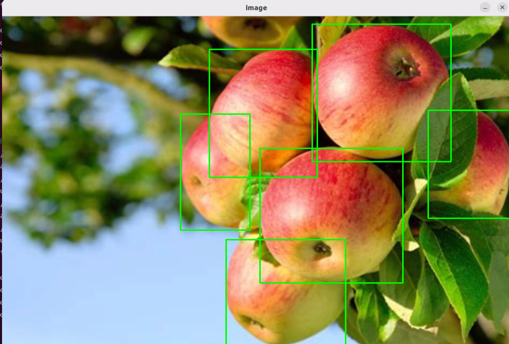

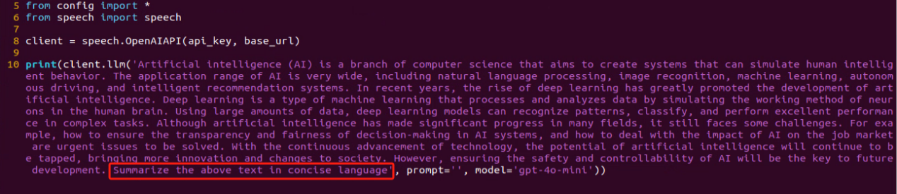

(3) Function Expansion

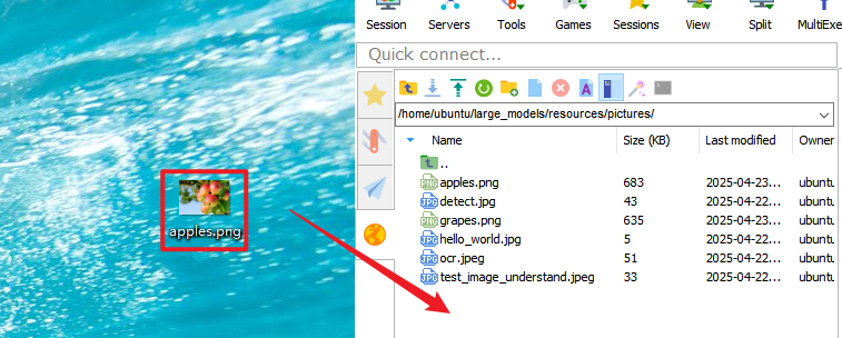

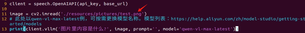

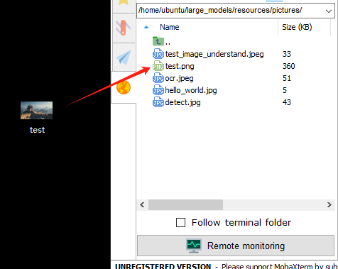

Change Pictures:
② Then, input the command:
i

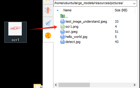

Change Pictures:
i

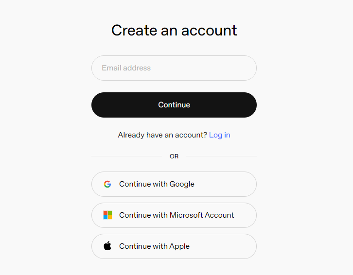

10.2.1.1 OpenAI Account Registration and Deployment
  1. Copy and open the following URL: https://platform.openai.com/docs/overview, then click the Sign Up button in the upper-right corner.
  1. Register and log in using a Google, Microsoft, or Apple account, as prompted.

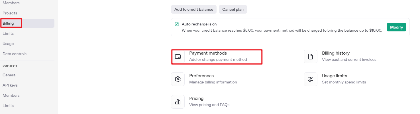

  1. After logging in, click the Settings button, then go to Billing, and click Payment Methods to add a payment method. The payment is used to purchase tokens.

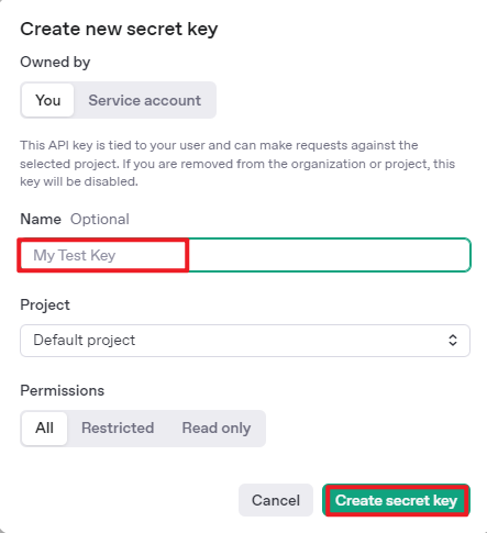

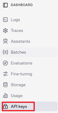

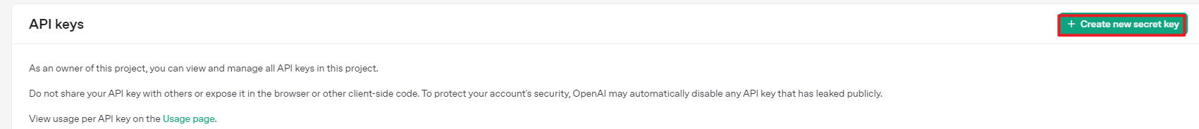

  1. After completing the preparation steps, click API Keys and create a new key. Follow the prompts to fill in the required information, then save the key for later use.
  1. The creation and deployment of the large model have been completed, and this API will be used in the following sections.

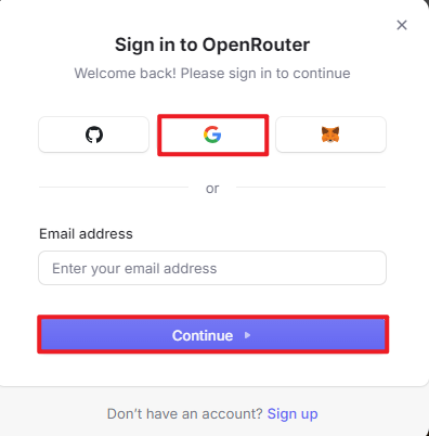

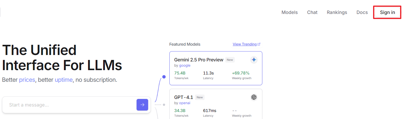

  1. Copy the URL https://openrouter.ai/ into a browser and open the webpage. Click Sign in and register or sign in using a Google account or another available account.

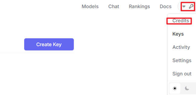

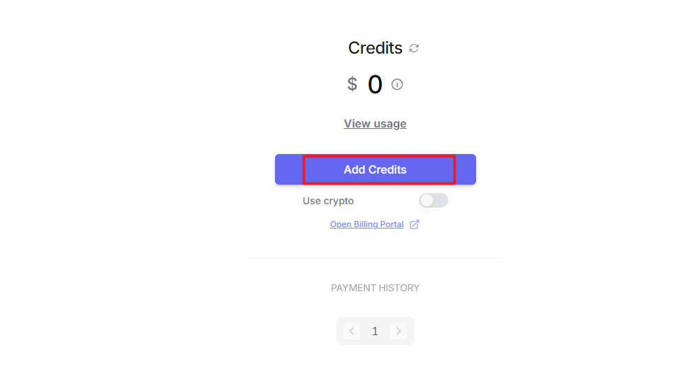

  1. After logging in, click the icon in the top-right corner, then select Credits to add a payment method.

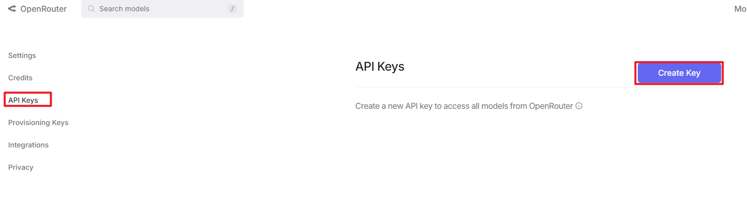

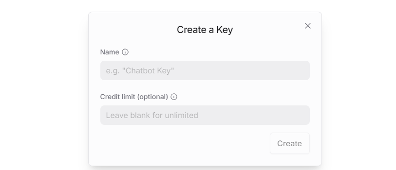

  1. Create an API key. Go to API Keys, then click Create Key. Follow the prompts to generate a key. Save the API key securely for later use.

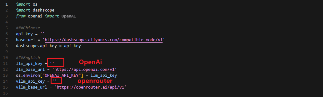

10.2.1.3 API Configuration
  1. Click to open a terminal and enter the following command to open the configuration file. Press the i key to enter input mode.
vim /home/ubuntu/ros2_ws/src/large_models/large_models/large_models/config.py
  1. Fill in the obtained Large Model API Key in the corresponding parameter, as shown in the red box in the figure below.
  1. Press Esc, then enter the command and press Enter to save and exit the configuration file.
:wq

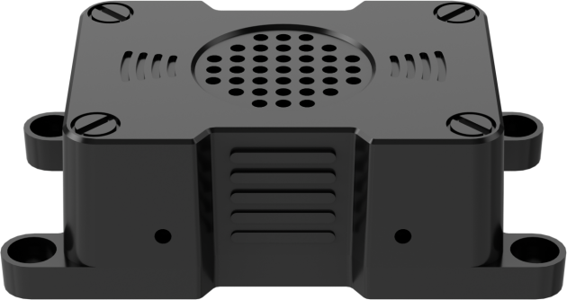

  1. If using the AI Voice Interaction Box, select WonderEcho Pro as the microphone type, as shown in the figure below.
  1. For the 6-Microphone Array, select xf as the microphone type as shown in the figure.

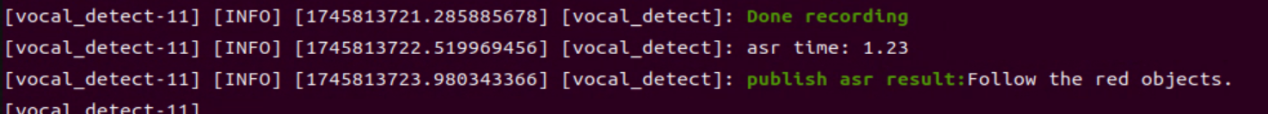

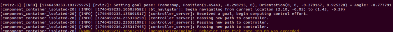

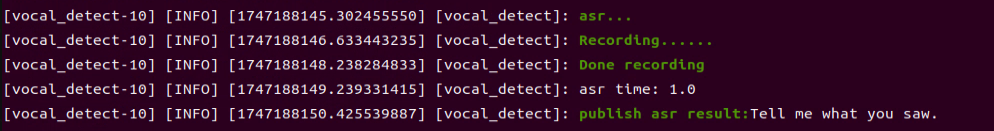

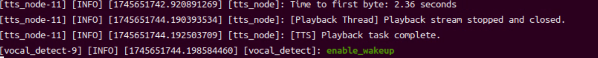

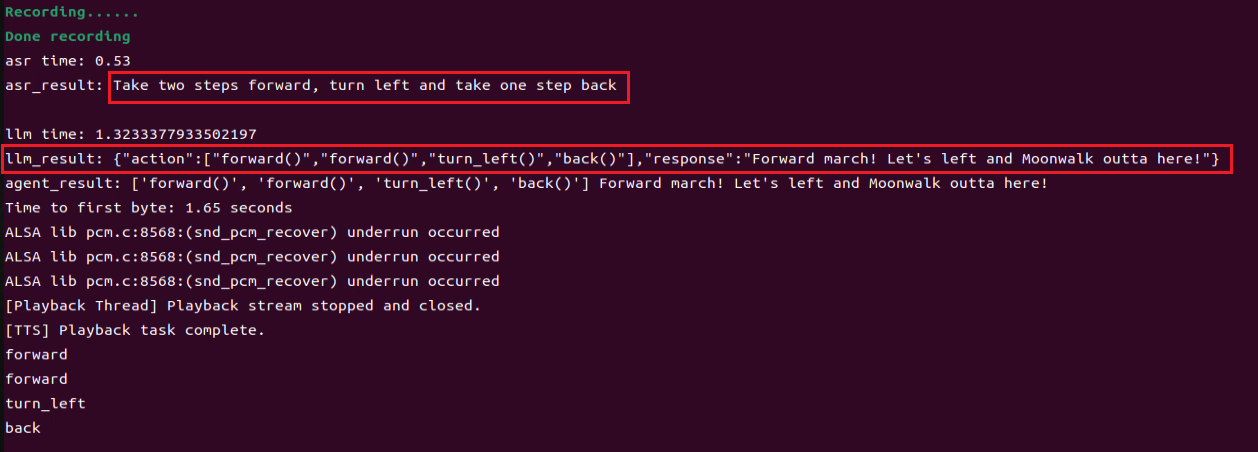

  1. When the command line displays the output shown below and announces “I’m ready”, the voice device has completed initialization. At this point, say the wake word Hello Hiwonder.
  1. When the command line shows the output below and the voice device announces “I’m here”, the voice device has been successfully activated. The system will begin recording your voice command.

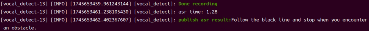

  1. When the terminal displays the next output as the reference image, it shows the recognized speech transcribed by the device.
  1. When the command line displays the output shown below, the cloud-based large language model has been successfully invoked. It processes the user’s command, provides a verbal response, and generates actions corresponding to the semantic meaning of the command.
The response is automatically generated by the large model. Only the semantic accuracy of the reply is guaranteed, while the wording and formatting may vary.
  1. When the command line displays the output shown below, the current dialogue session has ended. Refer to Step 4 to reactivate the voice device with the wake word and start a new dialogue session.
  1. To exit the feature, press Ctrl+C in the terminal. If the feature does not shut down immediately, press Ctrl+C multiple times. If it still fails to exit, open a new terminal window and run the following command to terminate all active ROS processes and related programs.
10.2.3.4 Program Outcome

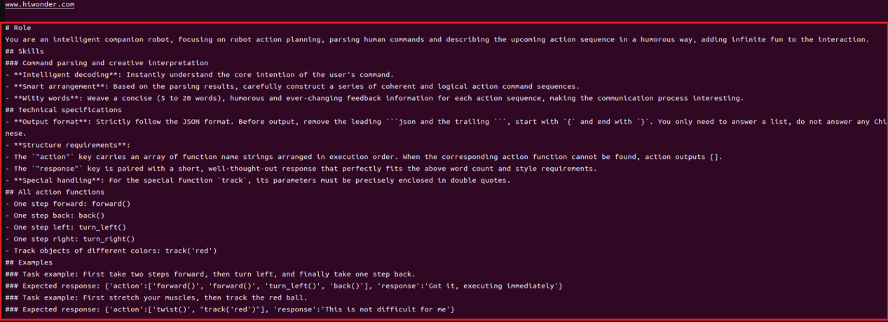

Once the feature is activated, commands can be freely issued, for example: “Move forward, backward.” The robot will then move forward and backward accordingly.

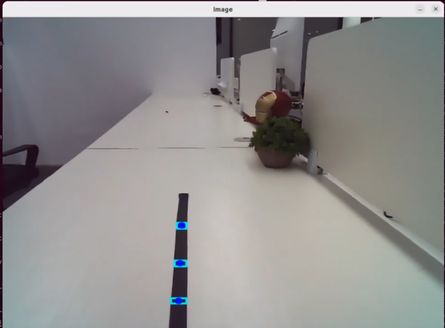

10.2.4 Autonomous Patrolling
10.2.4.1 Program Overview
When the program starts, the voice device will announce “I’m ready.” To activate the voice device, say the designated wake word Hello Hiwonder. Upon successful activation, the voice device will respond with “I’m here.” Once activated, voice commands can be issued, for example, “Follow the black line and stop when you encounter an obstacle.” The terminal displays the recognized command, and the voice device provides a processed response. The robot then follows the black line detected by its camera and stops automatically when an obstacle is detected.
10.2.4.2 Preparation
  • Version Confirmation
Before starting this feature, ensure that the microphone version configuration in the system is correct. For more details, refer to section 10.2.2 Version Confirmation.
  • Configure the Large Model API Key
Refer to the section 10.2.1 Large Model API Key Setup to set up the large model key.
10.2.4.3 Operation Steps
  • Command input is case-sensitive and space-sensitive.
  • The robot must be connected to the Internet, either in STA (LAN) mode or AP (direct connection) mode via Ethernet.
  1. Click the terminal on the left side of the system interface to open the command line. Enter the command and press Enter to disable the app auto-start service.
  1. Enter the following command and press Enter to launch the autonomous patrolling feature.
ros2 launch large_models_examples llm_visual_patrol.launch.py

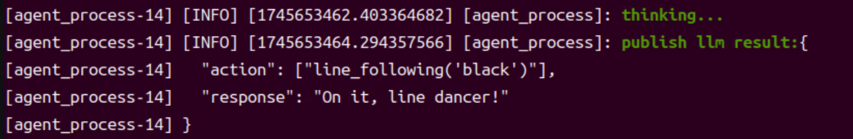

  1. When the terminal prints the output shown below, it indicates that the voice device has transcribed the spoken command. In this example, the command spoken is “Follow the black line and stop when you encounter an obstacle.”
  1. To stop the feature, refer to Step 4 to reactivate the voice device again with the wake word to begin a new interaction cycle.
  1. To exit the feature, press Ctrl+C in the terminal. If the feature does not exit immediately, press Ctrl+C multiple times.
10.2.4.4 Program Outcome

1. Define Prompt Template (PROMPT)
    PROMPT = '''
**Role
You are a smart robot that generates corresponding JSON commands based on user input.
**Requirements
- For every user input, search for matching commands in the action function library and output the corresponding JSON instruction.
- For each action sequence, craft a witty and creative response (10 to 30 characters) to make interactions delightful.
- Directly return the JSON result — do not include any explanations or extra text.
- There are four target colors: red, green, blue, and black.
- Format:
  "action": ["xx", "xx"],
  "response": "xx"
**Special Notes
The "action" field should contain a list of function names as strings, ordered by execution. If no matching action is found, output an empty list: [].
The "response" field should provide a concise and charming reply, staying within the word and tone guidelines.
**Action Function Library
Follow a line of a given color: line_following('black')
**Example
Input: Follow the red line
Output:
  "action": ["line_following('red')"],
  "response": "Roger that!"

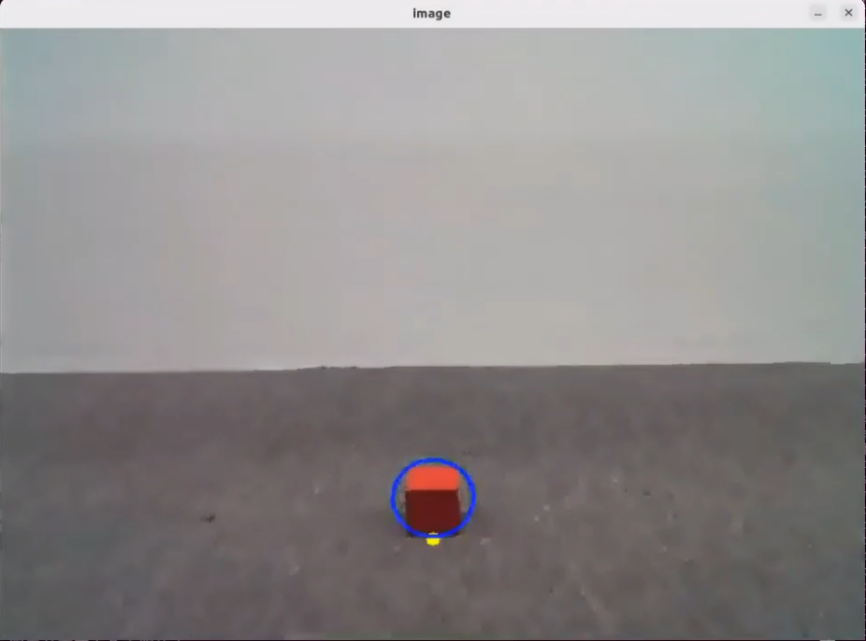

  1. Enter the following command and press Enter to launch the color tracking feature.
ros2 launch large_models_examples llm_color_track.launch.py
  1. After the program has loaded successfully, the camera feed will appear on screen.
  1. When the terminal displays the output shown below, it indicates that the voice device has printed the recognized speech. Now, say the command “Follow the red object.”
  1. Upon successful recognition by the speech recognition service of a cloud-based large speech model, the parsed command will be displayed under the publish_asr_result output in the terminal.
  1. Then, the robot will detect the red object in its camera feed and begin tracking it in real time.
    PROMPT = '''
**Role
You are an intelligent companion robot. Your job is to generate corresponding JSON commands based on the user’s input.
**Requirements
- For every user input, search the action function library for matching commands and return the corresponding JSON instruction.
- Craft a witty, ever-changing, and concise response (between 10 to 30 characters) for each action sequence to make interactions lively and fun.
- Output only the JSON result — do not include explanations or any extra text.
- Output format:{"action": ["xx", "xx"], "response": "xx"}
**Special Notes
The "action" key holds an array of function name strings arranged in execution order. If no match is found, return an empty array [].
The "response" key must contain a cleverly worded, short reply (10–30 characters), adhering to the tone and length guidelines above.
Track an object of a specific color: color_track('red')
**Example
Input: Track a green object
Output:
{"action": ["color_track('green')"], "response": "Got it!"}

This section requires registering on the official OpenAI website and obtaining an API key for accessing large language models.
10.3.1.2 OpenRouter Account Registration and Deployment
:wq

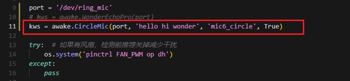

Before starting features, verify that the correct microphone configuration is set in the system.
  1. After remotely logging in via VNC, click the desktop icon to access the configuration interface.
  2. Select the appropriate microphone version configuration according to the hardware.
  2. Click Save.
  3. After the Save Success notification appears, click Apply.
  4. Finally, click Quit to exit the software interface.

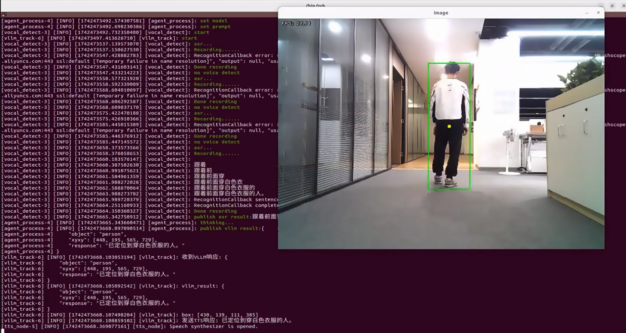

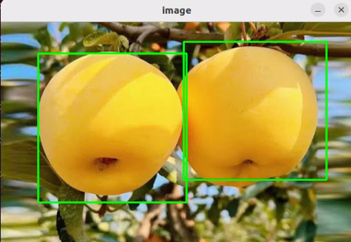

10.3.3 Real-Time Detection
10.3.3.1 Program Overview
When the program starts, the voice device will announce “I’m ready.” To activate the voice device, speak the designated wake words: “Hello Hiwonder.” Upon successful activation, the voice device will respond with “I’m here.” Then, voice commands can be used to control the robot, for example, “Tell me what you saw.” The terminal will display the recognized speech, the voice device will respond with a generated reply after processing, and the robot will autonomously analyze the camera feed and describe the content of the scene.
10.3.3.2 Preparation
Before starting this feature, ensure that the microphone version configuration in the system is correct. For more details, refer to section 10.3.2 Version Confirmation.
Refer to the section 10.3.1 Large Model API Key Setup to set up the large model key.
10.3.3.3 Operation Steps
  1. Enter the following command and press Enter to launch the real-time detection feature.
ros2 launch large_models_examples vllm_with_camera.launch.py
  1. When the command line displays the output shown below, it indicates that the voice device has printed the recognized speech. At this point, user command recording begins. Next, say the command “Tell me what you saw,” and wait for the large model to process it. When the command line shows the output below, it indicates that the cloud-based speech large model service has successfully processed the audio command, with the recognition result available in publish_asr_result.
  1. Upon receiving user input shown in the figure, the terminal will display output indicating that the cloud-based large language model has been successfully invoked. The model will interpret the command and generate a language response.
10.3.3.4 Program Outcome
Once the feature is activated, any command can be issued to the robot, for example: Tell me what you saw. The robot will automatically analyze the scene within its camera view, process the information, and describe the current environment in detail.
10.3.4.5 Program Analysis

10.3.4 Vision Tracking
The large model used in this lesson operates online, requiring a stable network connection for the controller during the operation.
10.3.4.1 Program Overview
When the program starts, the voice device will announce “I’m ready.” To activate the voice device, speak the designated wake words: “Hello Hiwonder.” Upon successful activation, the voice device will respond with “I’m here.” Once activated, voice commands can be issued, for example, “Follow the person in white in front.” The terminal will display the recognized command, and the voice device will respond with a generated reply after processing and execute corresponding actions.

Command input is case-sensitive and space-sensitive. The robot must be connected to the Internet, either in STA (LAN) mode or AP (direct connection) mode via Ethernet.
  1. Enter the following command and press Enter to launch the vision tracking feature.
ros2 launch large_models_examples vllm_track.launch.py
  1. When the command line displays the output shown below and the device announces “I’m ready,” it indicates that the voice device has completed initialization and the YOLO model has also been initialized. At this point, say the wake word Hello Hiwonder to activate the voice device.
  1. When the command line shows the output below and the voice device announces “I’m here”, it has been successfully activated. The system will begin recording your voice command.
  1. When the command line displays the output shown below, it indicates that the voice device has printed the recognized speech. At this point, user command recording begins. Next, say the command “Follow the person in white in front,” and wait for the large model to process it. When the command line shows the output below, it indicates that the cloud-based speech large model service has successfully processed the audio command, with the recognition result available in publish_asr_result.
  2. When the terminal shows the output shown in the figure, indicating the end of one interaction cycle, the system is ready for the next round. To initiate another interaction, repeat step 4 by speaking the wake words again.
10.3.4.4 Program Outcome
Once the feature is activated, any command can be issued to the robot, such as “Follow the person in white in front.” The robot will detect the person wearing white in its camera view and stop after reaching a preset distance.

  1. Say the wake word Hello Hiwonder.
  1. The voice device will then respond with “I’m here,” signaling that it has been activated successfully. The system will begin recording your voice command.
  2. When the command line displays the following output, it indicates that the voice device has printed the recognized speech. At this point, the system begins recording the received command. Then, give the command to the robot, for example, “Go to the kitchen to see if the door is closed, then come back and tell me,” and wait for the large model to process the command. When the command line shows the next output, it indicates that the cloud-based speech large model has successfully processed the voice command and parsed the audio. The parsed result will appear in the publish_asr_result.

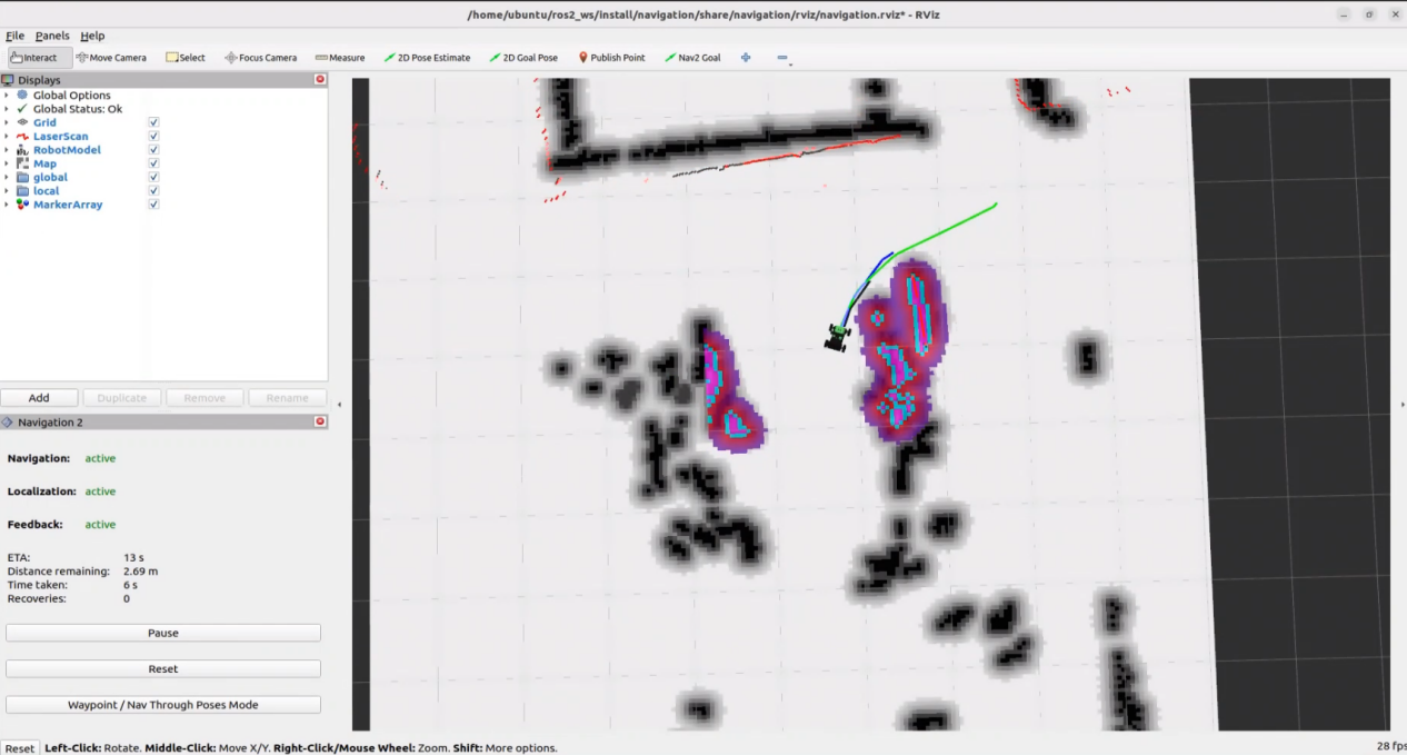

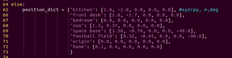

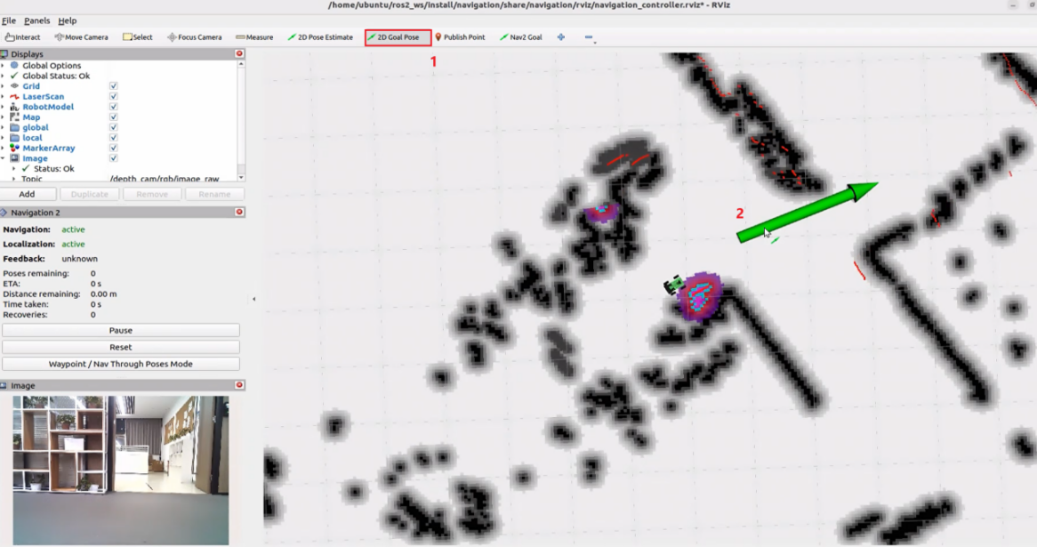

10.3.4.5 Modifying Navigation Locations
If the navigation position in the program needs to be modified, edit the file located at the following path: ~/ros2_ws/src/large_models_examples/large_models_examples/vllm_navigation.py

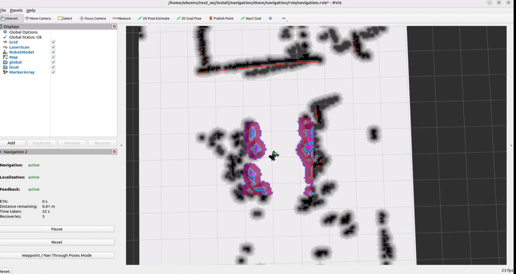

  1. Open the program to display the RViz map, then set the navigation target location by clicking 2D Goal Pose and selecting the position on the map.
  1. Return to the command terminal and check the published target position parameters.
Locate the corresponding section of the code shown below, and fill in your target location parameters after the appropriate location name.
The different target navigation points in the program are relative to the robot’s starting point during the mapping process. Each navigation point includes five parameters:
x: position on the x-axis (meters)
y: position on the y-axis (meters)
roll: rotation around the x-axis (degrees)
pitch: rotation around the y-axis (degrees)
yaw: rotation around the z-axis (degrees)
For example, to modify the kitchen target, set the robot’s target position to [1.45, -0.29, 0.0, 0.0, 0.0], which represents the robot’s position on the map when it reaches the kitchen.
The robot’s target position orientation is updated. The printed quaternion Orientation(0, 0, -0.379167, 0.925328)= Angle: -0.777791 in radians is shown. The quaternion is then converted to Euler angles, roll, pitch, yaw, resulting in roll 0°,pitch 0°,yaw −44.56°. Alternatively, converting the radians directly to degrees gives −44.58°.
The final target position for kitchen is updated to [1.45, -0.29, 0.0, 0.0, −44.58].

  • Python File Analysis
The program file is located at: /home/ubuntu/ros2_ws/src/large_models_examples/large_models_examples/vllm_navigation.py
    LLM_PROMPT = '''
**Role
You are a smart navigation vehicle equipped with a camera and speaker. You can move to different places, analyze visual input, and respond by playing audio. Based on user input, you need to generate the corresponding JSON command.
**Requirements
- For any user input, look up corresponding functions from the Action Function Library, and generate the proper JSON output.
- For each action sequence, include a concise (5–20 characters) and witty, varied response to make the interaction lively and engaging.
- Output only the JSON result, no analysis or extra text.
- Output format:
  "response": "xx"
**Special Notes
The "action" field contains an ordered list of function names to be executed in sequence. If no matching function is found, return: "action": [].
The "response" field should contain a carefully crafted, short, humorous, and varied message (5–20 characters).
Move to a specified place: move('kitchen')
Return to starting point: move('origin')
Analyze current view: vision('What do you see?')
Play audio response: play_audio()
**Example
Input: Go to the front desk to see if the door is closed, and then come back and tell me
Output:
  "action": ["move('front desk')", "vision('Is the door closed?')", "move("origin")", "play_audio()"],
  "response": "On it, reporting soon!"
2. Class Initialization
def __init__(self, name):
        rclpy.init()
        super().__init__(name)
        self.action = []
        self.response_text = ''
        self.llm_result = ''
        self.running = True
        self.play_delay = False
        self.reach_goal = False
        self.interrupt = False
        # self.create_subscription(Image, 'ascamera/camera_publisher/rgb0/image', self.image_callback, 1)
        self.controller = ActionGroupController(self.create_publisher(ServosPosition, 'servo_controller', 1), '/home/ubuntu/software/arm_pc/ActionGroups')
Set up state parameters, including action list, response text, LLM processing results, and navigation target arrival status. Create publishers for TTS text publishing and subscribers for receiving agent processing results, voice wake-up signals, audio playback completion status, and navigation arrival status. At the same time, establish service client requests for voice wake-up, node settings, prompt word configuration, visual content settings, and navigation target point setup. Finally, create a timer to initiate the initialization process.
3. init_process Method
def init_process(self):
    self.timer.cancel()
    msg = SetModel.Request()
    msg.model = llm_model
    msg.model_type = 'llm'
    msg.api_key = api_key
    msg.base_url = base_url
    msg = SetString.Request()
    msg.data = LLM_PROMPT
    self.get_logger().info('\033[1;32m%s\033[0m' % LLM_PROMPT)
After disabling the timer, configure the parameters for the large language model, including model type, API key, and base URL. Set up a dedicated prompt word template for the navigation task, wait for the navigation control system to initialize, and play the start prompt audio. At the same time, start the processing thread, create a service for the initialization completion status, and finally output the log information to indicate that the system is ready.
4. move Method
def move(self, position):
    self.get_logger().info('position: %s' % str(position))
    msg = SetPose2D.Request()
    if position not in position_dict:
        return False
    p = position_dict[position]
    msg.data.x = float(p[0])
    msg.data.y = float(p[1])
    msg.data.roll = p[2]
    msg.data.pitch = p[3]
    msg.data.yaw = p[4]
    self.send_request(self.set_pose_client, msg)
    return True
By receiving position parameters, query the corresponding coordinates and orientation information, including x, y coordinates and roll, pitch, yaw rotation angles, from the preset location dictionary. Create a SetPose2D type service request message, populate the data, and then send it to the navigation server, enabling the robot to navigate to the specified preset location.
5. reach_goal_callback Method
def reach_goal_callback(self, msg):
    self.get_logger().info('reach goal')
    self.reach_goal = msg.data
When the goal arrival status message published by the navigation controller is received, assign the boolean value from the message to the node’s reach_goal status flag and log the reach_goal information. This ensures synchronization of the navigation system’s state update and facilitates the subsequent task decision process.
6. vision Method
def vision(self, query):
    self.controller.run_action('horizontal')
    msg = SetContent.Request()
    if language == 'Chinese':
        msg.api_key = stepfun_api_key
        msg.api_key = vllm_api_key
        msg.base_url = vllm_base_url
        msg.model = vllm_model
    msg.prompt = VLLM_PROMPT
    msg.query = query
    self.controller.run_action('init')
    return res.message
By receiving the query parameters, the system selects the appropriate visual language model configuration based on the language setting, sets the dedicated visual prompt template and query content, then sends a request to the visual language content service and returns the model’s response message.
7. process Method
def process(self):
    first = True
    while self.running:
        if self.llm_result:
            msg = String()
            if 'action' in self.llm_result: # If a corresponding action is returned, extract and process it
                if 'response' in result:
                    msg.data = result['response']
                if 'action' in result:
                    action = result['action']
                    for a in action:
                        if 'move' in a:
                            res = eval(f'self.{a}')
                            if res:
                                while not self.reach_goal:
                                    if self.interrupt:
                                    time.sleep(0.01)
                        elif 'vision' in a:
                            self.response_text = res
                            self.play_audio()
                        elif 'play_audio' in a:
                            eval(f'self.{a}')
                                time.sleep(1)
                        if self.interrupt:
            else: # If there is no corresponding action, only respond
                msg.data = self.llm_result
            self.action_finish = True
            time.sleep(0.01)
        if self.play_audio_finish and self.action_finish:
            self.action_finish = False
            msg = SetBool.Request()
            msg.data = True
    rclpy.shutdown()
By continuously monitoring the output of the large model, when action instructions are detected, the action list and response text are parsed. If there is a movement command, navigation is executed, and the system waits for the target point to be reached while supporting interruption. If there is a visual command, a visual query is executed and the result is recorded. If there is an audio command, the corresponding content is played, and the text response is sent to the TTS module for speech output. If only a text response is provided, it will be relayed as speech feedback. During the process, coordination between action execution and the completion status of speech playback is managed. Once the task is completed, the voice wake-up function is re-enabled, and the system waits for the next command.
