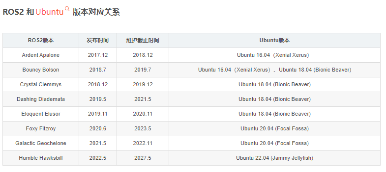

5.1.1 Version Options
Different versions of ROS2 are installed on different versions of Ubuntu. In this section, we will use the virtual machine with Ubuntu 20.04, which corresponds to ROS2 Foxy.

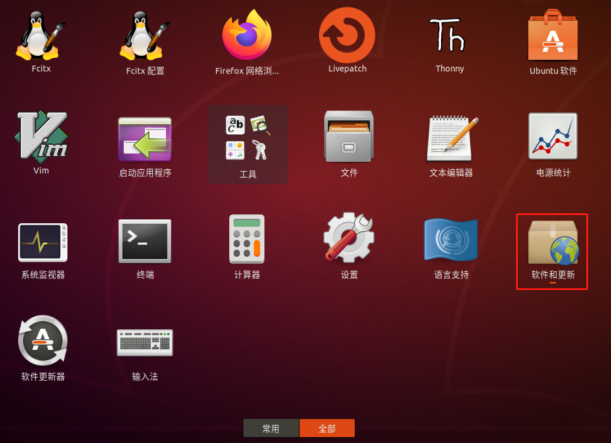

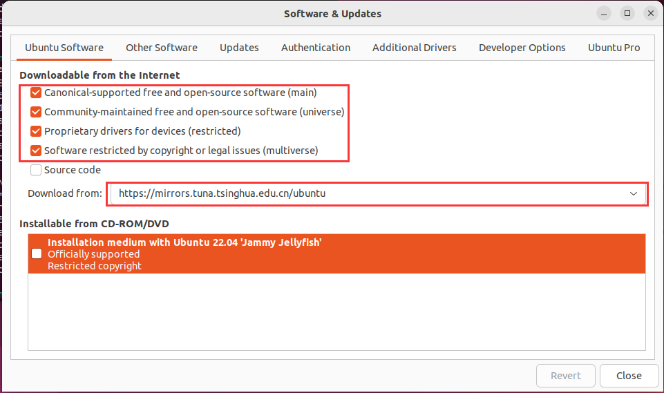

5.1.2 Check Ubuntu’s Software and Update Sources
(1) Locate ‘System&Update’.
(2) Make sure to check the option for internet downloads and change the download source to the local region’s source.

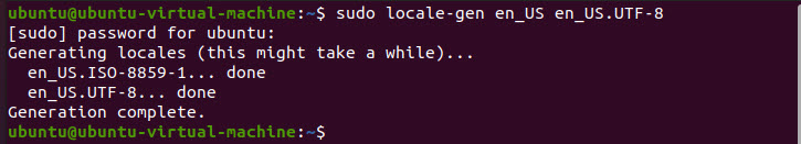

(1) Enable the virtual machine, and press “Ctrl+Alt+T” to open the terminal.
(2) Input
sudo locale-gen en_US en_US.UTF-8
Set the Ubuntu locale to en_US.UTF-8. After entering the command, press Enter, then enter the virtual machine’s password, “hiwonder” (users should enter the password they have set for their own virtual machine; in our case, the password is “hiwonder”).
(3) Run the command below and press Enter key to update the language environment.
sudo update-locale LC_ALL=en_US.UTF-8 LANG=en_US.UTF-8
(4) Enter the command, press Enter, and export the environment variables to take effect immediately.
export LANG=en_US.UTF-8

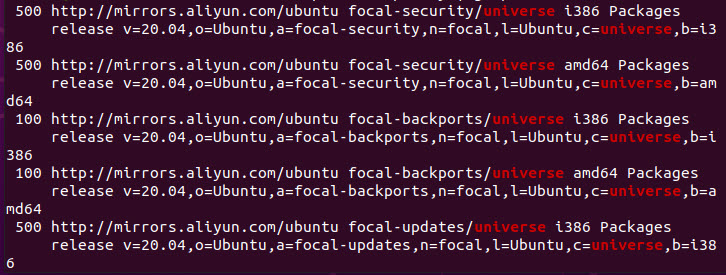

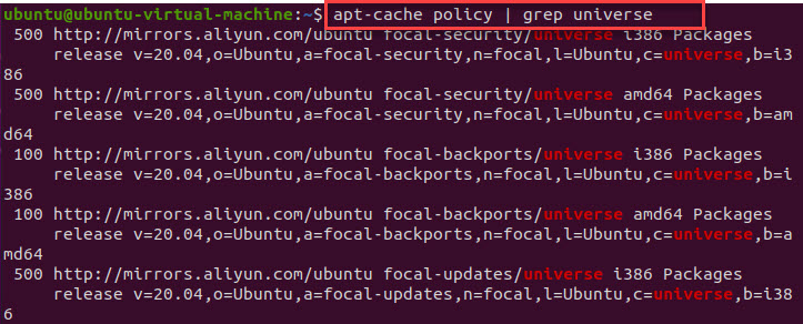

(1) Enter the command to check if the Universe repository is enabled:
apt-cache policy | grep universe
(2) If the output is as follows, it indicates that it has been enabled, and you can proceed to configure it further in section 1.4.1.
(3) If you see the following prompt, it means it has not been enabled.

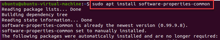

(4) Enter the command to install the software package “software-properties-common”:
sudo apt install software-properties-common

(6) You can enter the command again to check if it has been enabled:

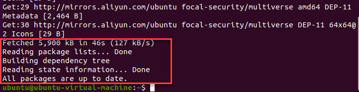

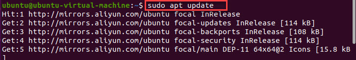

(1) Enter the command to update the software installation packages:
sudo apt update
(2) After the update is complete, it will appear as shown in the following image.

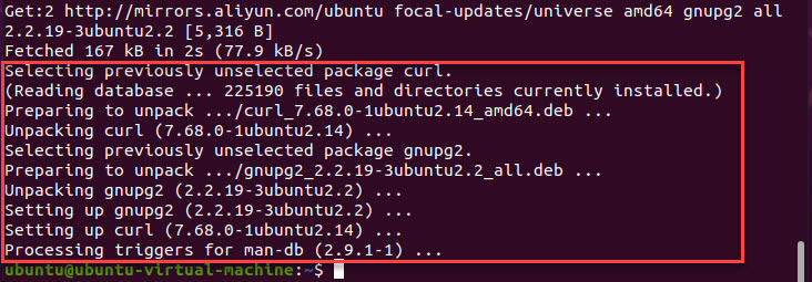

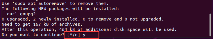

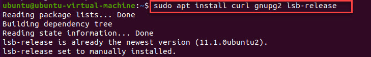

(3) Enter the command to install the curl and gnupg tools:
sudo apt install curl gnupg2 lsb-release
(4) During the installation process, if you see the prompt as shown in the following image, simply enter “y” and press Enter.
(5) After the installation is complete, it will appear as shown in the following image:

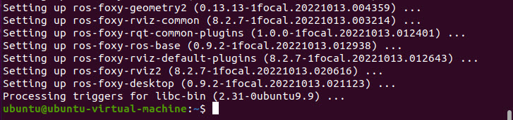

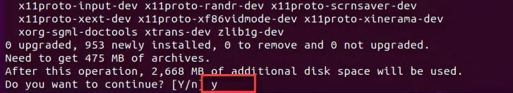

(3) Run the below command:
sudo apt install ros-foxy-desktop
Press Enter. When prompted whether to install, type “y” and press Enter again. Wait for the download and installation to complete. Depending on your network conditions, this process may take about 10 minutes, so please be patient.
(4) After the installation is complete, it will appear as shown below.

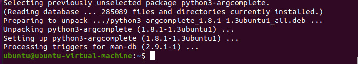

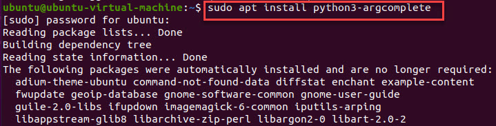

sudo apt install python3-argcomplete
(2) After the installation is complete, it will appear as shown below.

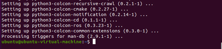

(3) Input the following command and hit Enter key to install the compilation tool. Then enter ‘y’ to confirm the installation.
sudo apt install python3-colcon-common-extensions

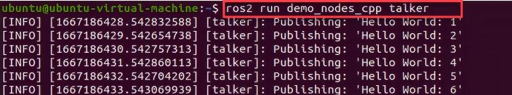

(1) Enter the command to run a talker.
ros2 run demo_nodes_cpp talker

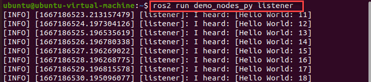

(2) Press “Ctrl+Alt+T” to open a new terminal, then enter the command to run a listener.
ros2 run demo_nodes_py listener
(3) Press “Ctrl+C” to stop the execution. If stopping fails, you can repeat pressing “Ctrl+C” multiple times until it stops.

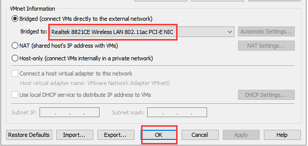

5.2.2 Network Configuration
(1) Open virtual machine .
(2) Click-on “Edit” and choose “Virtual Network Editor”.
(3) Tick “Bridged”, and choose the corresponding wireless network card.
(4) Select the imported virtual machine, then click on “Power on this virtual machine”.

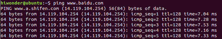

(6) Enter the command to check whether the network connection is successful.
ping www.baidu.com
If the terminal prints following content, that means network connection is successful.

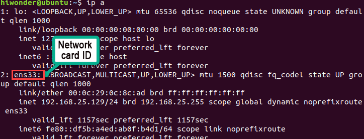

(7) Execute this step only when network connection is failed. Enter command “ip a” to check the ID of network card.
ip a
(8) Execute this step only when network connection is failed. Enter command and press Enter. “ens33” is the ID of network card. You need to modify the entered command based to suit the specific case at hand.
sudo dhclient ens33

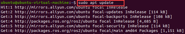

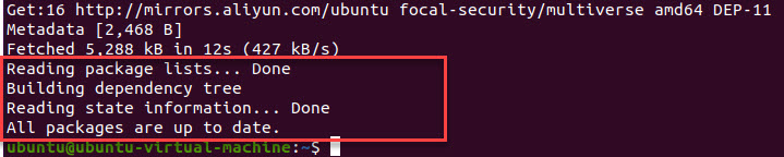

(1) Run the command to update apt library.
sudo apt update
After update, the following messages will occur.

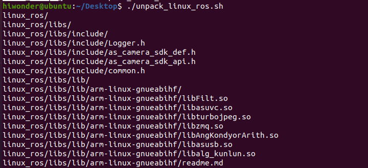

(1) Copy the “linux_ros.pkg” and “unpack_linux_ros” under the directory of “linux_ros” to the virtual machine.
The virtual machine account username is “hiwonder” and the password is also “hiwonder”.

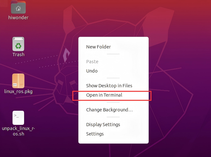

(2) Right-click the mouse to open the terminal.
(3) Enter the command to compress the “linux_ros.pkg” package.
./unpack_linux_ros.sh

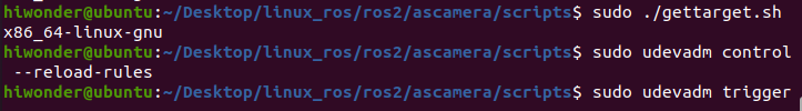

(8) Enter the command to obtain the target platform for the local GCC compiler. Input the command to make it effective.
sudo ./gettarget.sh
sudo udevadm control --reload-rules
sudo udevadm trigger

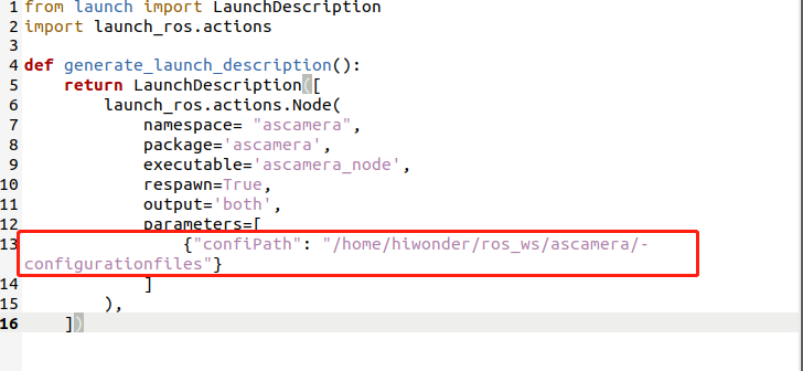

(9) Enter the command to modify the path of the configuration file.
gedit ..//launch/ascamera.launch.py
/home/hiwonder/ros_ws/ascamera/configurationfiles

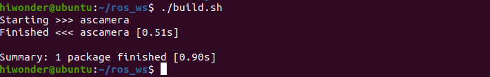

(11) Enter the command to recompile the workspace.
./build.sh

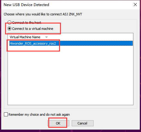

(1) Attach the depth camera to the computer and establish its connection with the virtual machine.
(2) Run the command to start the camera.

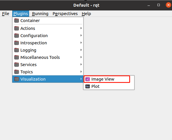

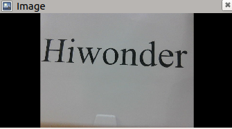

We offer two approaches for image visualization. One option involves utilizing rqt_image_view to observe 2D images, while the alternative is to employ rviz for visualizing 3D images. You are free to select the method that aligns with your particular needs. It is crucial to emphasize that during image viewing, the camera service should remain active and not be closed.

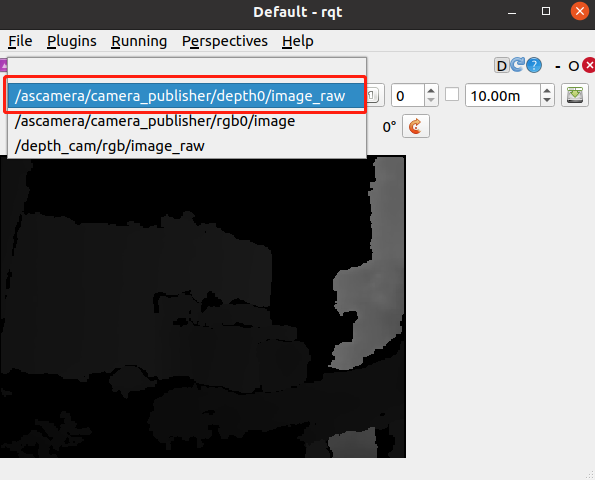

  • View Image Using rqt_image_view Tool
(1) Open a new terminal, and execute the command to start the image viewing tool.
rqt
When the below interface appears, it means that the tool is started successfully.
Select “Plugins > Visualization > Image View”.

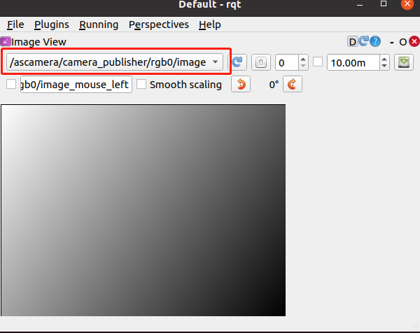

(2) To view the infrared image, please select the corresponding topic.
(3) When viewing the depth map, the red box position needs to be set as shown in the following figure:

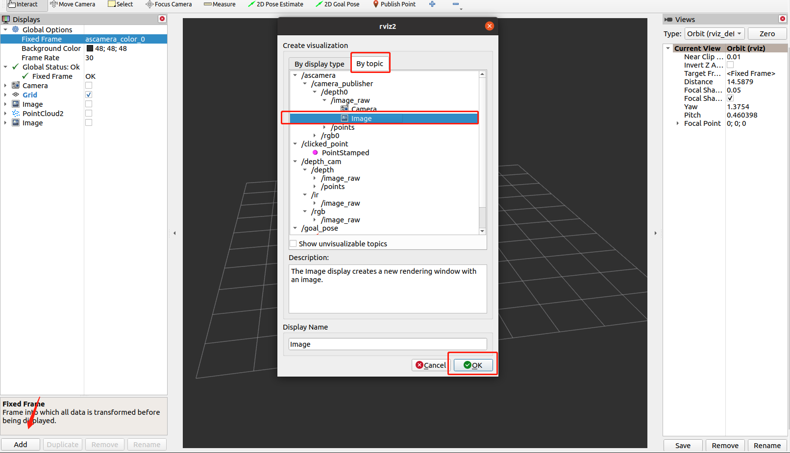

  • View Image Using rviz
(1) Execute the command to initiate the tool.
ros2 runrviz2rviz2

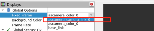

(2) To access the camera feed, start by configuring the “Fixed Frame” to “camera_link.” Then, click on “Add”, select “By topic -> camera -> color -> Image_raw -> Image”, and finally, click “OK”.
When the interface below appears, it indicates that the tool has been successfully launched.
(3) To view the depth map, set ‘Fixed Frame’ as ‘camera_link’, then click-on ‘Add’ to select ‘By topic ->camera->depth->Image_raw->Image’, and click-on ‘OK’.

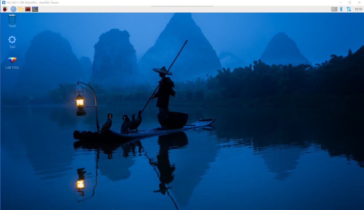

(1) Start the robot and connect to the system desktop remotely using VNC.

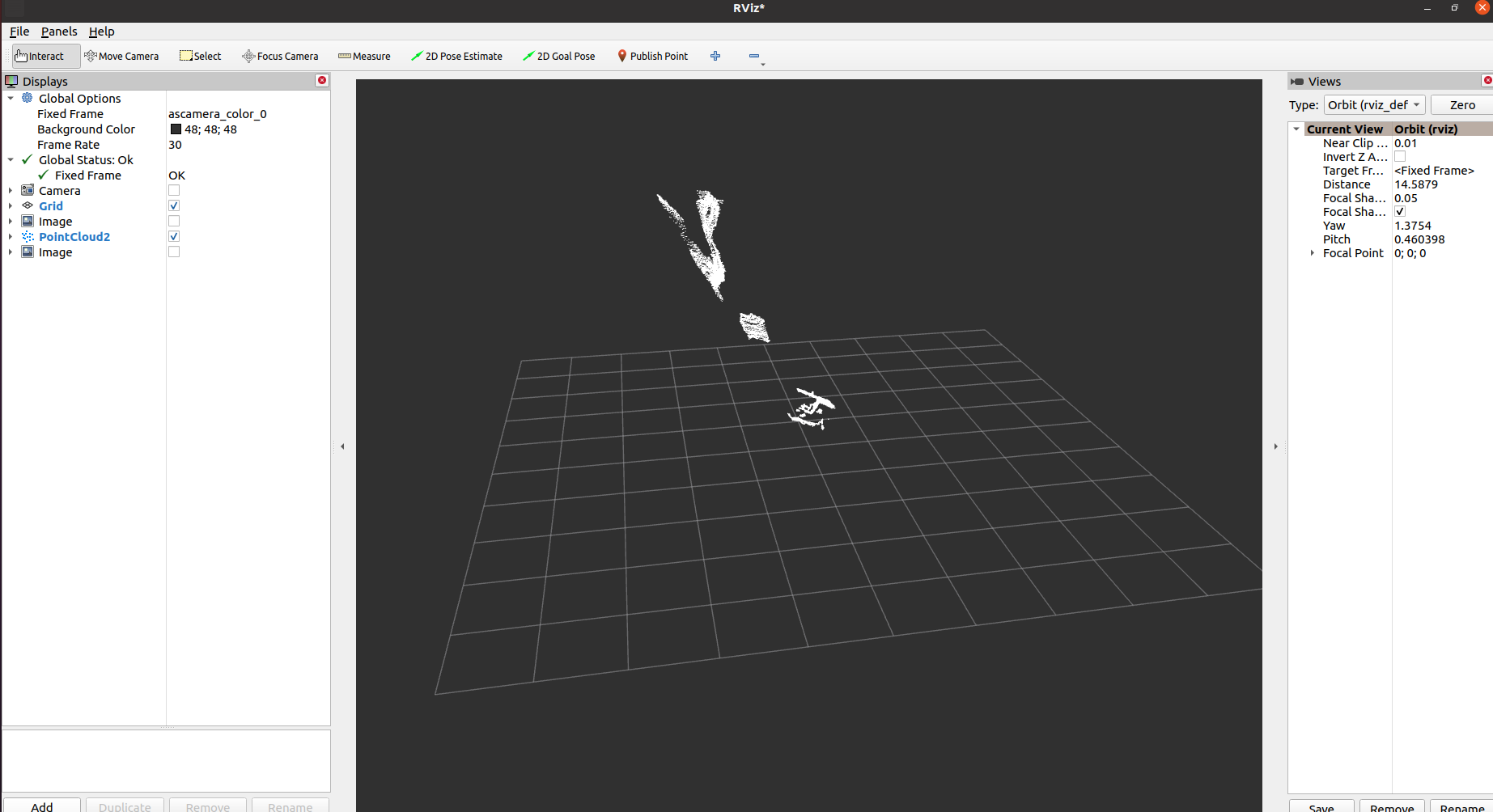

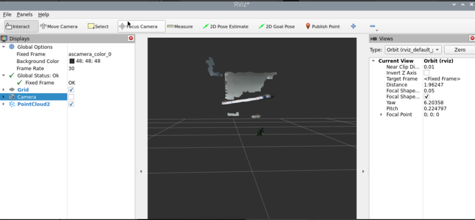

(4) Open a new command-line terminal, and run the following command to open the depth camera service.
(5) Open a new command-line terminal and execute the below command to initiate rviz.
rviz2

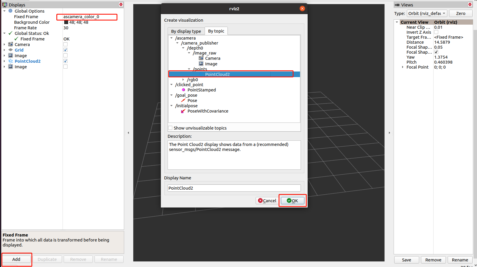

(6) Choose “ascamera_color_0”.

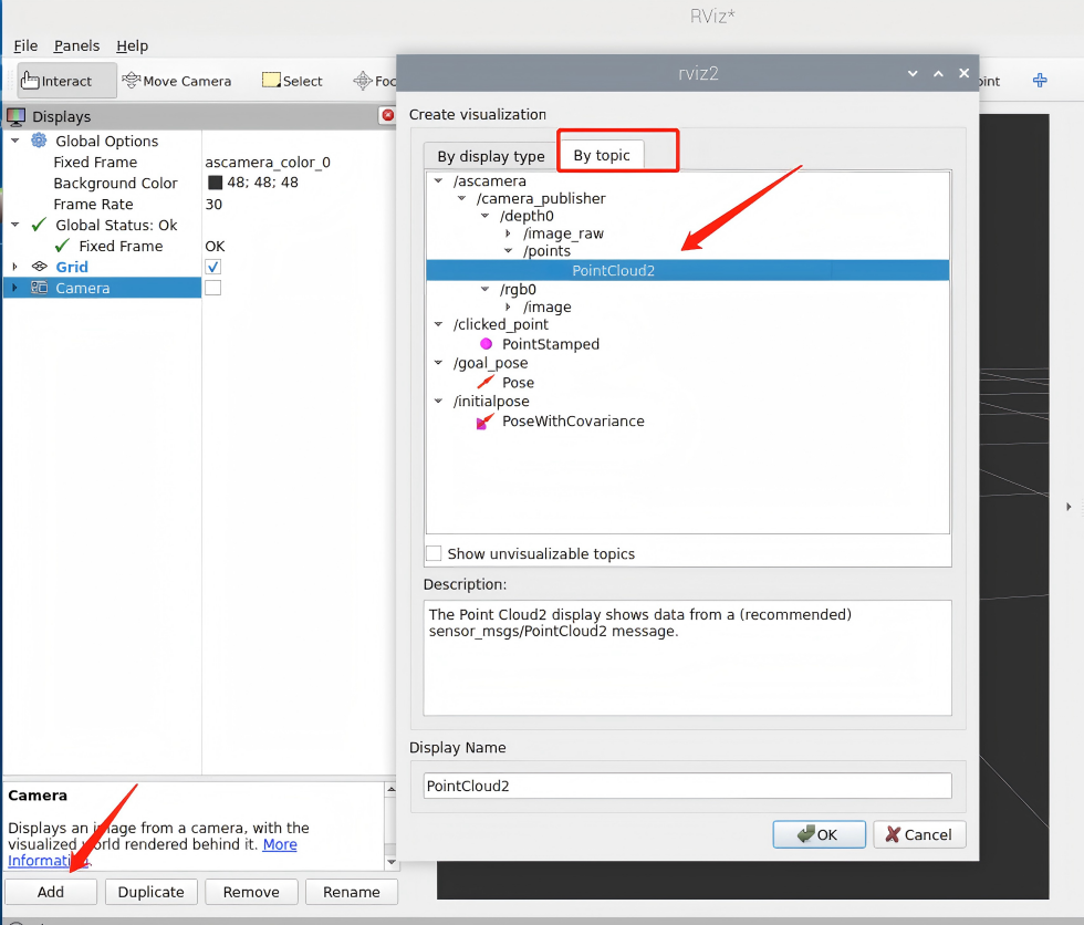

(7) Click on “Add” as shown below, then select “By topic” -> “ascamera” -> “ascamera_publisher” -> “depth0” -> “points” -> “pointCloud2”, and finally click “OK”.
Once you’ve completed the previous settings, the point cloud will become visible.
(8) If you need to terminate the program, press short-cut “Ctrl+C” on the terminal.

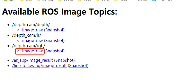

After obtaining the camera information, the live camera feed can be transmitted to the local area network. The real-time monitoring can be achieved by viewing the robot’s live feedback images through the webpage.

① Start MentorPi and connect it to the VNC.
② Click to open the command line terminal.
③ Enter the command. Press “Enter” to start the robot’s auto-start service. When the buzzer sounds a beep, the service restarts successfully.
④ Then, you can proceed to “5.6.2 Enable Robot Auto-start Service -> Access Live Camera Feed Through Web” to view the live camera feed through the browser.
  • Access Live Camera Feed Through Web
(1) Open any web browser, and input the IP address “http://192.168.149.1:8080/”, then hit “Enter”.
If the prompt “This site can’t be reached” occurs, please restart the app auto-start service.
(2) Click-on “image_raw(Snapshot)” to access the live camera feed. The program currently only supports viewing RGB images.
