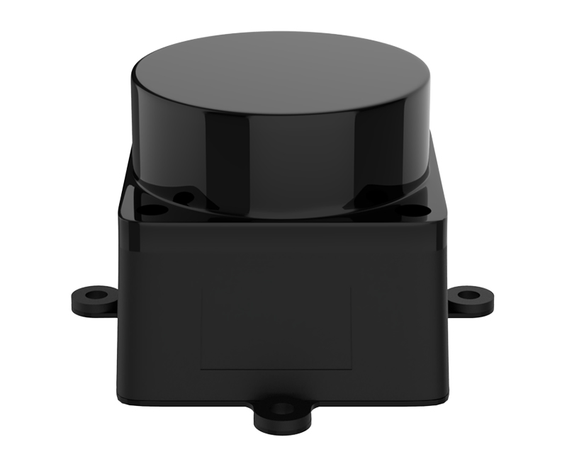

4.1.3 Lidar Parameter
The specifications of the Lidar used by MentorPi are as follows:
  • Electrical and Mechanical Parameter
Parameter Unit Minimum value Typical value Maximum value Note
Input voltage V 4.5V 5V 5V
PWM control frequency KHz 20 30 50 Square signal
PWM high level V 3 3 5
PWM low level V -0.3 0 0.5
PWM duty ratio % 0 40 100 40% duty cycle with scanning frequency of 10Hz
Start-up current mA - 300 -
Working current mA - 180 -
Size mm
54 * 46.29 * 34.8 (length * width * height)
Wight g - 47 - Connection cables are not included
Communication interface - UART@230400
UART high level V 2.9 3.3 3.5
UART low level V -0.3 0 0.4
Drive motor - BLDC BLDC
Working temperature ℃ -10 25 40
Storage temperature ℃ -30 25 70
  • Optical Parameter
Laser wavelength nm 895 905 915 Infrared wavelength
Laser power W - 25 - Peak power of laser diode; the actual power used is much lower than this value
Laser pulse width ns - 1 -
Laser safety class - IEC-60825 Class 1
Pitch angle ° 0 0.5 2
  • Performance Parameter
Measuring range m 0.02 - 12 70% target reflection coefficient
Scanning frequency Hz 5 10 13 External PWM speed control
Ranging frequency Hz - 4500 - Fixed frequency
Ranging accuracy mm - - -
When the ranging is less than 0.3m, there is output data.
The trend of distance measurement data changes consistent with the trend of actual distance changes.
mm - 45 - 45
When the measuring range is between 300mm and 12000mm, the average of 100 measurements
(70% diffuse surface).
Ranging standard deviation mm - 10 - When the measuring range is between 300mm and 12000mm
Measurement resolution mm - 15 -
Angle error ° - - 2
Angle resolution ° - 1 -
Anti-environmental light interference KLux - - 30
Service life of the device h 10000 - -
  • Interface Instruction and Communication Protocol
LD19 uses ZH1.5T-4P 1.5mm connector to connect with external systems for power supply and data reception. The specific interface definition and parameter are shown in the table below:
No. Signal Type Description
Minimum
value
Typical
value
Maximum
value
1 Tx Output Lidar data output 0V 3.3V 3.5V
2 PWM Input Motor control signal 0V - 3.3V
3 GND Power supply Power supply negative terminal - 0V -
4 P5V Power supply Power supply positive terminal 4.5V 5V 5.5V
  • Serial Specification
You can connect the Lidar to external systems through its physical interface. By following the communication protocol of the system, you can obtain real-time point cloud data, device information and device status from the laser scanning, and can also set the device working mode.
Baud Rate Data Length Stop Bit Parity Bit Flow Control
230400 8 Bits 1 None None

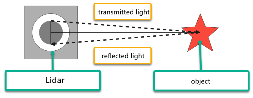

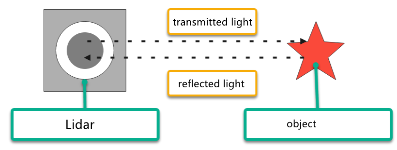

Two common methods are employed by Lidar to determine the distance to a target: triangulation and Time of Flight (TOF).
In the case of TOF, as depicted in the diagram, the Lidar initially projects light onto the object. The object reflects the light directly back to the Lidar, which calculates the time it takes for the light to return. The distance between the object and the Lidar is then obtained by multiplying this time by the speed of light.

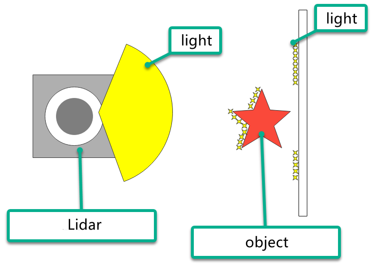

In triangulation, as illustrated in the diagram, the Lidar undergoes adjustments during manufacturing to ensure that the light does not directly strike the object. Instead, it is projected at a specific angle, a pre-set value that remains constant during operation. The distance from the object to the Lidar can be calculated by incorporating this angle into trigonometric functions.
4.2.2 Lidar Working Result
Its working result is as follows. Lidar will emit light and shine it on the object surface. When receiving the light reflected by the object, Lidar will mark the contour of the object at the position where the light is reflected.

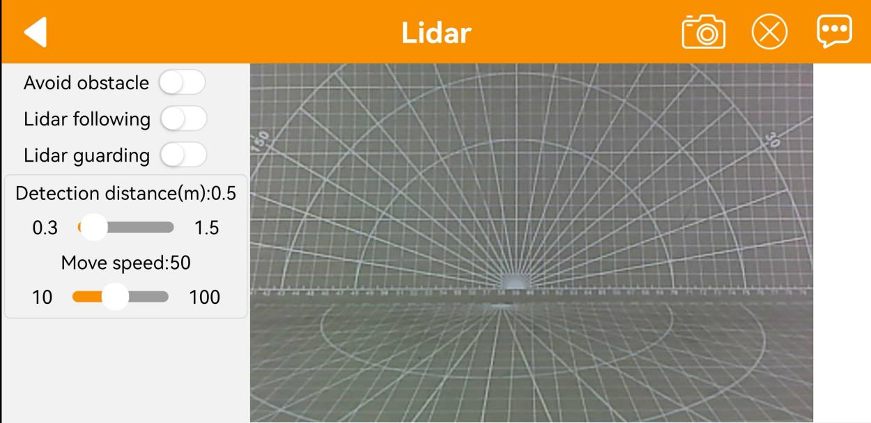

  • Initiate Lidar Game through App

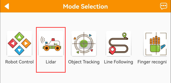

(1) Connect the robot to “WonderPi” app.
(2) Click-on Lidar to navigate to the game interface.
(3) Switch on “Avoid obstacle” button to start the game.

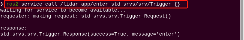

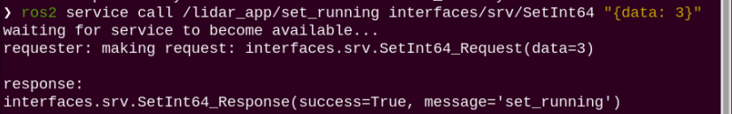

(5) Open a new terminal, and execute the command. Then, press Enter to start the Lidar game.
ros2 service call /lidar_app/enter std_srvs/srv/Trigger {}
The robot’s performance initiated by the app and command is identical.

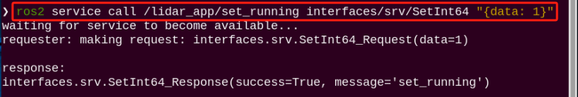

(6) Enter the command and hit Enter to launch Lidar obstacle avoidance game.
ros2 service call /lidar_app/set_running interfaces/srv/SetInt64 "{data: 1}"

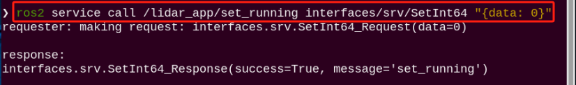

(7) If you want to exit the game, enter the command and press “Enter”.
ros2 service call /lidar_app/set_running interfaces/srv/SetInt64 "{data: 0}"

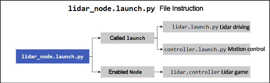

  • Launch File
The launch file is located in: /home/ubuntu/ros2_ws/src/app/launch/lidar_node.launch.py
(1) Set the storage path
Retrieve the paths for the two packages: peripherals and controller.
(2) Initiate other Launch files
    lidar_controller_node = GroupAction([
        IncludeLaunchDescription(
            condition=IfCondition(debug),
lidar.launch.py Lidar launch
controller.launch.py Motion control launch
(3) Initiate Node
        Node(
            package='app',
            executable='lidar_controller',
Enable Lidar game node.

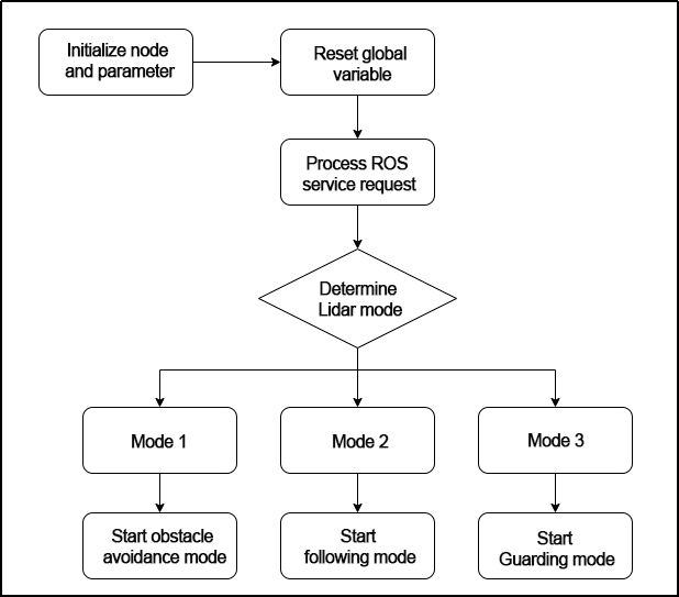

The process logic of the program based on the implemented effect is shown in the diagram:

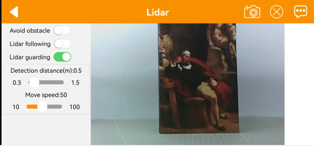

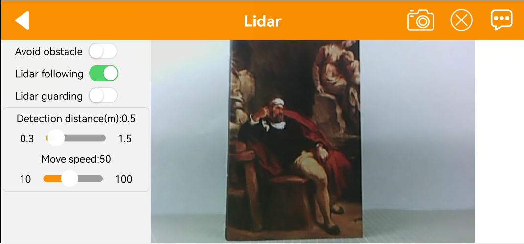

(1) Connect the robot to “WondePi” app.
(3) Switch on “Lidar following” button to start the game.

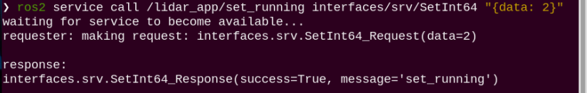

(6) Enter the command and hit Enter to launch Lidar following game.
ros2 service call /lidar_app/set_running interfaces/srv/SetInt64 "{data: 2}"

4.4.2 Program Outcome
Let’s use a book as the object to be detected. When using the Lidar following function, it’s important to ensure that the object to be detected is higher than the scanning height of the Lidar mounted on the MentorPi. This will enable the Lidar to effectively scan the position information of the object. Once the position information is obtained, the MentorPi will adjust its position to maintain a distance of around 0.35m between itself and the obstacle.

  • Launch File
(3) Initiate Node
        Node(
            package='app',
(3) Switch on “Lidar guarding” button to start the game.
5.1.2 Initiate Lidar Game Using Command
(1) Start the robot, and access the robot system desktop using VNC according to the tutorial saved in “Set Development Environment/1.VNC Installation and Connection”.
(2) Click-on to open the command line terminal.
(3) Execute the command and press Enter to deactivate the automatic start service for the app.
(4) Run the command to enable the local services for app-related game and chassis control services.
ros2 launch app lidar_node.launch.py debug:=true
(6) Enter the command and hit Enter to launch Lidar guarding game.
ros2 service call /lidar_app/set_running interfaces/srv/SetInt64 "{data: 3}"
The game will continue to run under the current Raspberry Pi power-on state if not exited. To avoid excessive use of the Raspberry Pi’s operating memory, please follow the above instructions to close the current game before executing other games.
(8) If you need to terminate the program, press short-cut “Ctrl+C” on the terminal opened in steps (4) and (5).

4.5.2 Program Outcome
Let’s use a book as the object to be detected. When using the Lidar following function, it’s important to ensure that the object to be detected is higher than the scanning height of the Lidar mounted on the MentorPi. This will enable the Lidar to effectively scan the position information of the object. Once the position information is obtained, the MentorPi will adjust its orientation to face towards the obstacle. It means that the camera will face directly towards the obstacle.

  • Launch File
(3) Initiate Node
        Node(
            package='app',
