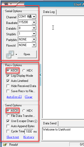

Software Preparation
(1) Open the Serial Port Debug Tool included in the same folder as this section.
(2) Set the tool to use a baud rate of 9600, parity of NONE, 8 data bits, 1 stop bit, and ensure data is sent as ASCII characters.
