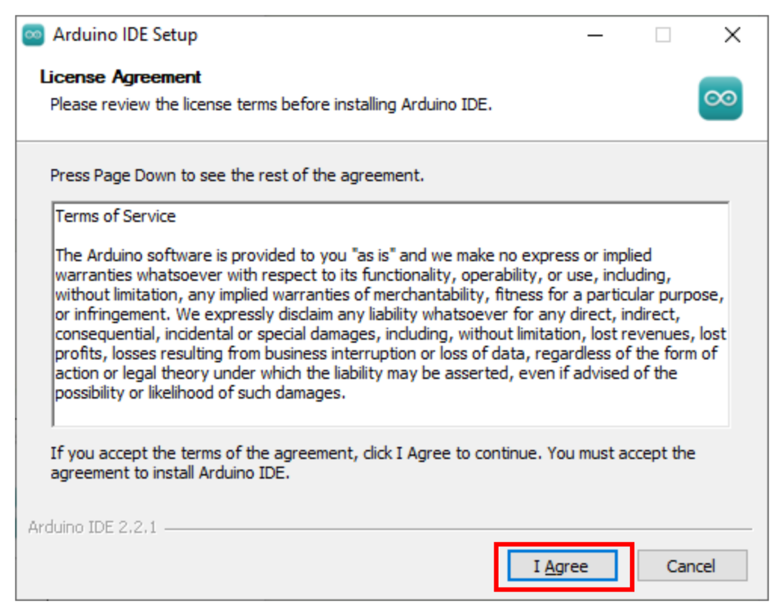

(2) Click “I Agree” to accept the license agreement to proceed with the installation.

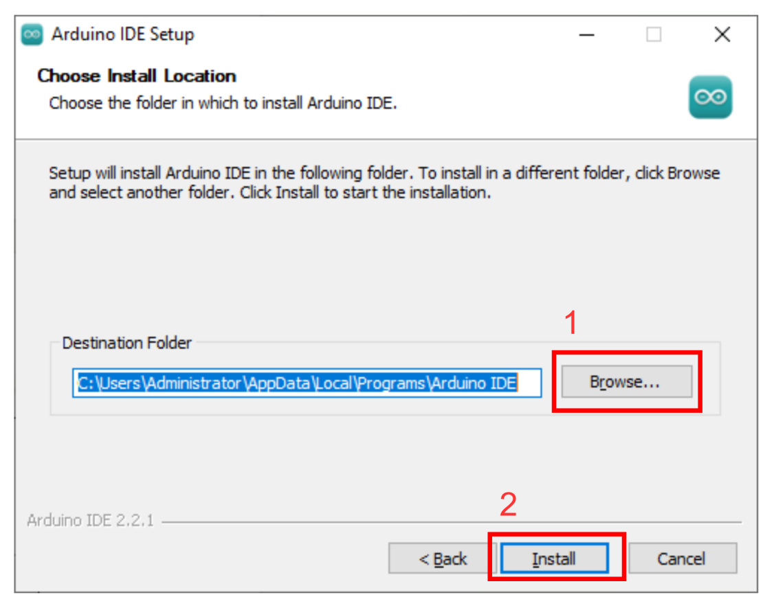

(4) Choose the desired installation path by clicking “Browse”, then click “Install” to begin installation.

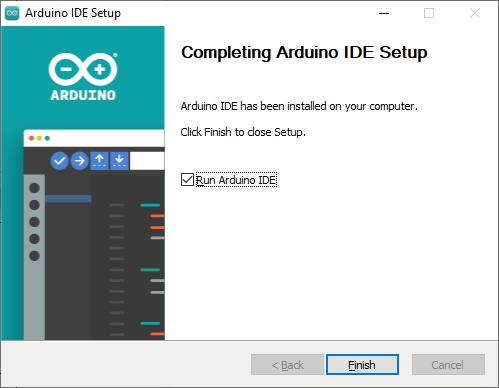

(5) Wait for the installation process to complete.
If prompted to install USB drivers during the installation, select “Always trust software from Arduino LLC” and click “Install.”
(6) Once installation is complete, click “Finish” to exit the installer.

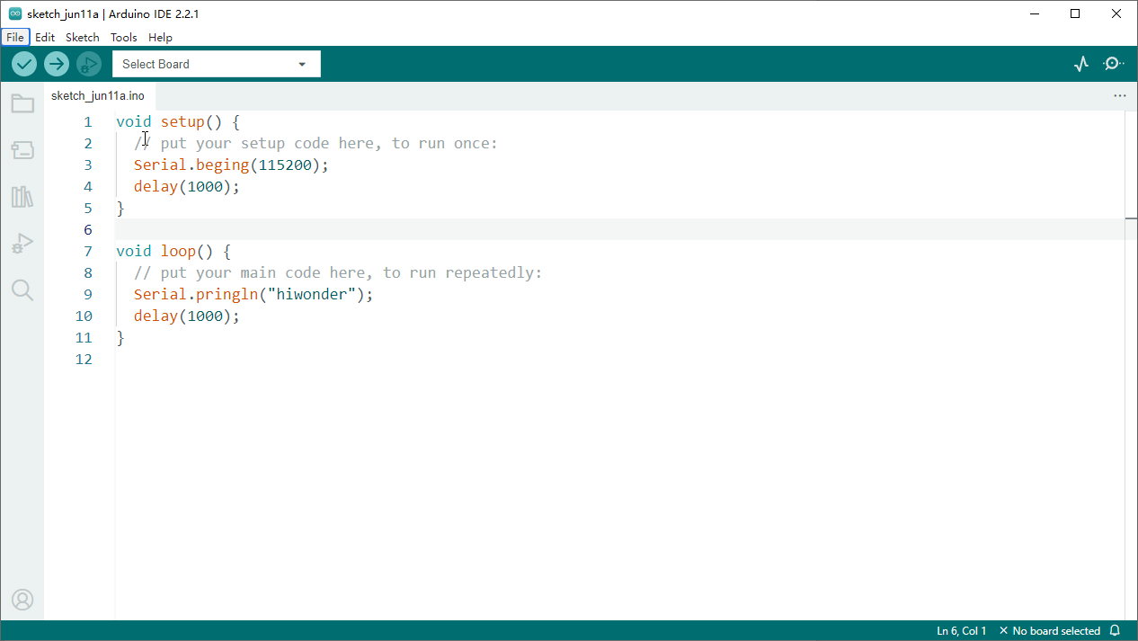

4.1.2 Interface Overview

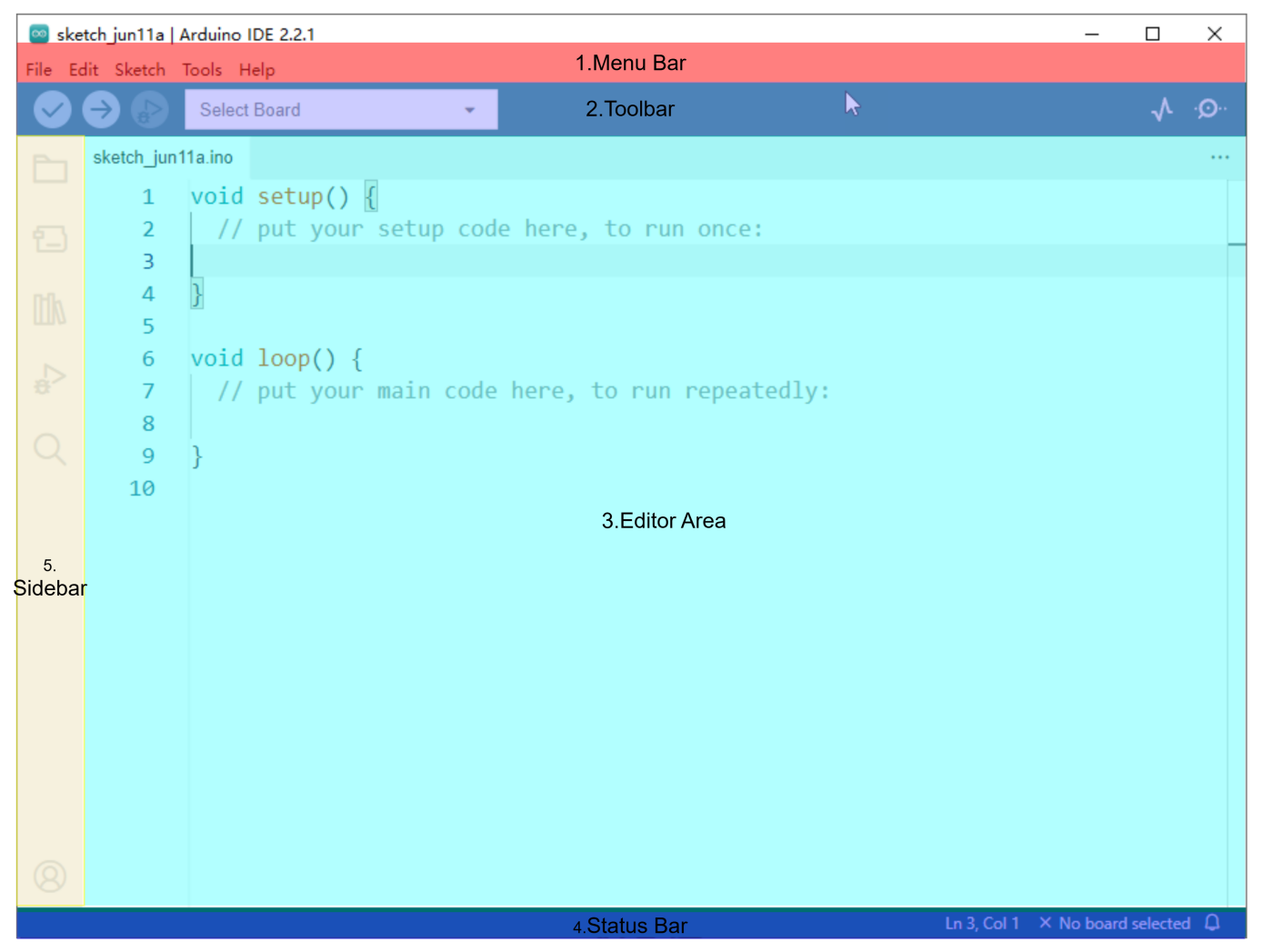

(1) The main interface of the Arduino IDE is divided into five primary sections:
(2) Menu Bar provides access to key settings and configuration options for the Arduino IDE.

(3) Toolbar contains essential tools for project development, including program compilation, uploading, and serial monitoring.

(3) Editor Area: The primary area for writing and editing code.
(4) Status Bar: Displays relevant editor and project information, such as cursor position, controller selection, and other status indicators.
(5) Sidebar: A key component of the Arduino IDE, providing tools for file management, code debugging, and library installation.

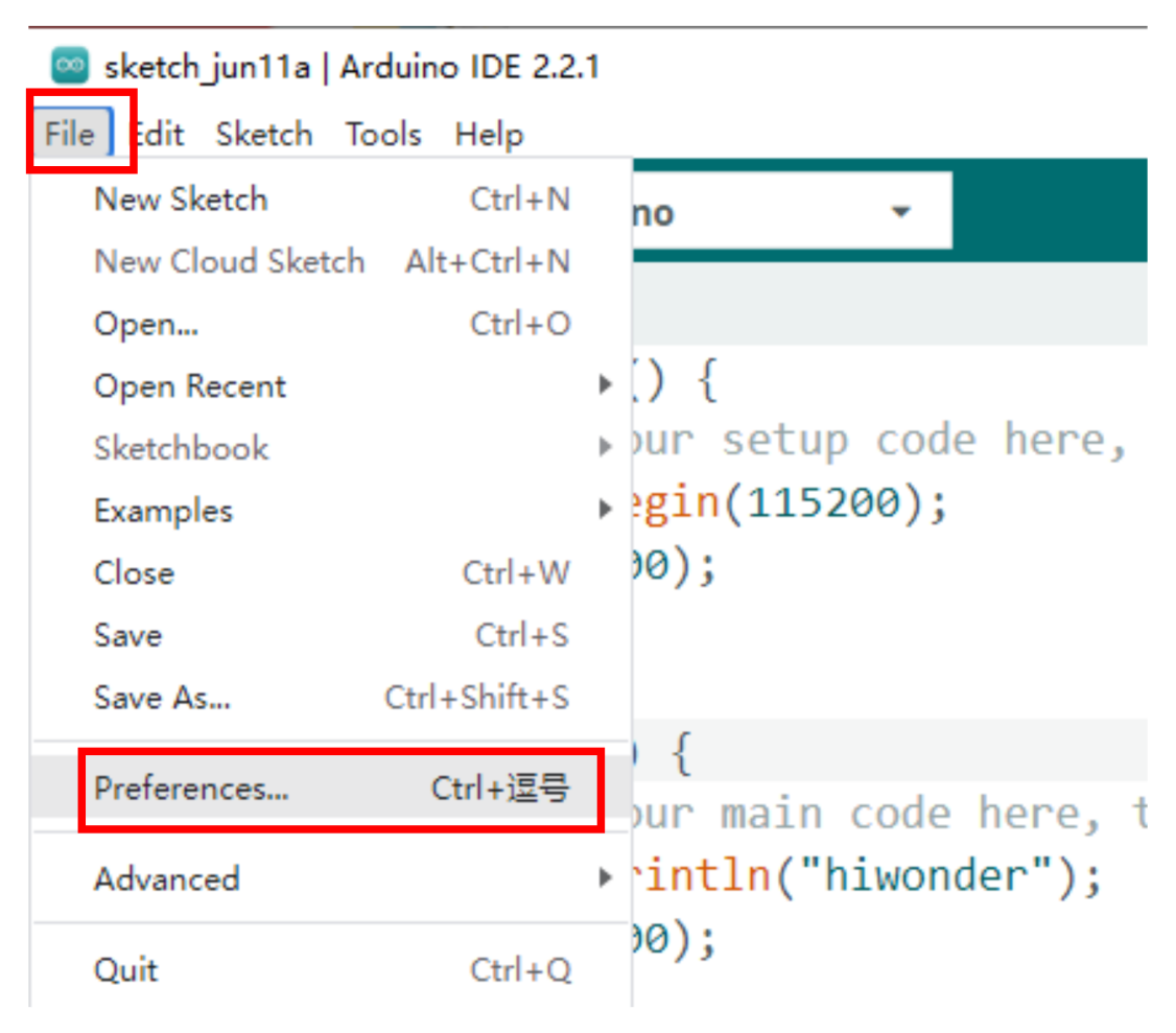

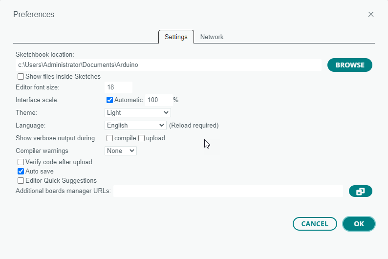

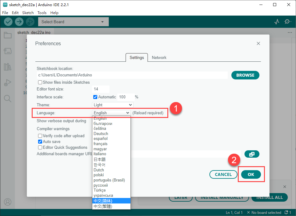

(1) To switch the interface language to English, navigate to File > Preferences, then locate the Language setting in the pop-up window. Select “English” from the list and click “OK” to apply the changes.
(2) Additional preferences such as project file location, editor font size, and color theme can also be configured from this menu.

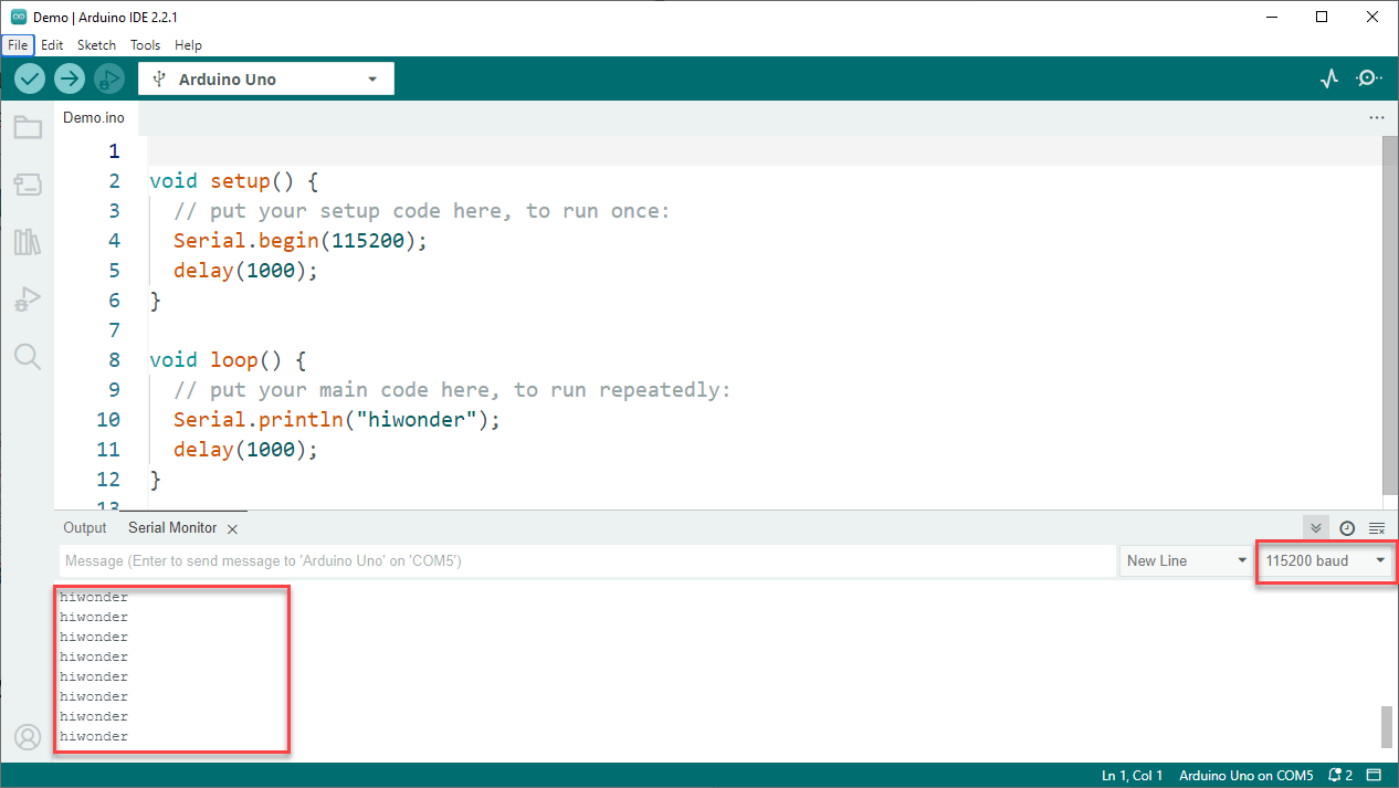

(1) This section demonstrates how to upload a simple program that prints the text “hiwonder”. Locate and open the sample sketch file Demo.ino found in the _Demo folder under the same directory as this document.
(2) Connect the Arduino controller to the computer using a USB Type-B cable.

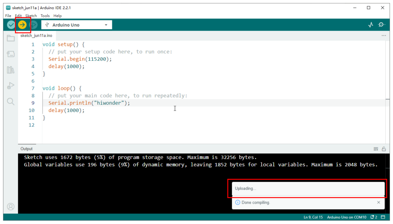

(3) From the “Select Board” menu, choose the appropriate controller. For example, when using an Arduino Uno, select it accordingly. The COM port may vary, but you can refer to the “Device Manager” on the computer to identify the correct COM number, COM6 is taken as the port in this section.

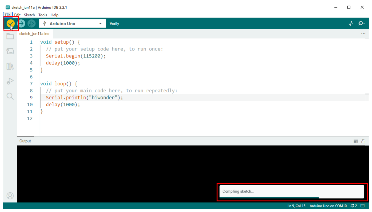

(4) Click the
button to compile the sketch and check for syntax errors or other issues.
(5) Once compiled successfully, click
button to transfer the program to the Arduino controller.
(6) After uploading, open the Serial Monitor
. The text “hiwonder” should appear, confirming that the program is running correctly.

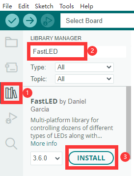

(1) Click the Library Manager icon
in the left sidebar of the Ardu ino IDE.
(2) In the search bar, type “FastLED”. The library will appear in the search results, and click “Install”.
(3) A confirmation message will appear upon successful installation.

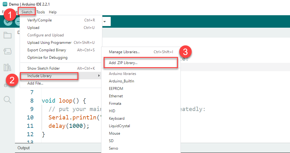

Local Import
This method is used for importing downloaded or custom library files. Using FastLED as an example:

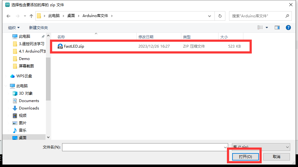

(1) Go to Sketch > Include Library > Add.ZIP Library in the Arduino IDE.
(2) In the dialog box, locate the FastLED.zip file, which can be found in: _Demo, Select the file and click “Open”.
(3) A confirmation message will indicate successful installation.

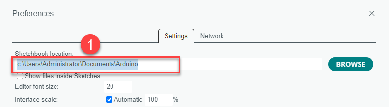

② Open File > Preferences in the Arduino IDE.
③ Copy the Sketchbook location path shown in the preferences window.

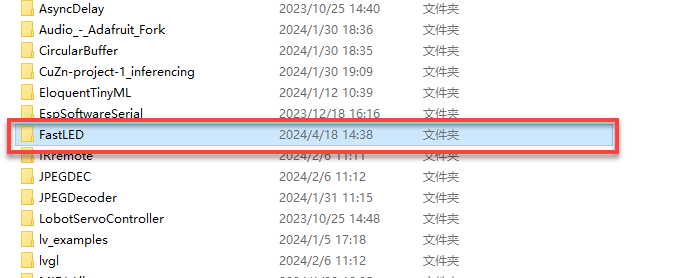

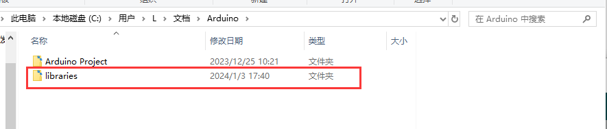

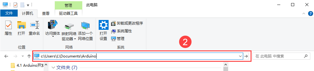

④ Paste the path into the file explorer and press Enter to open the directory.
⑤ Move the extracted FastLED folder into the libraries folder within this path.
