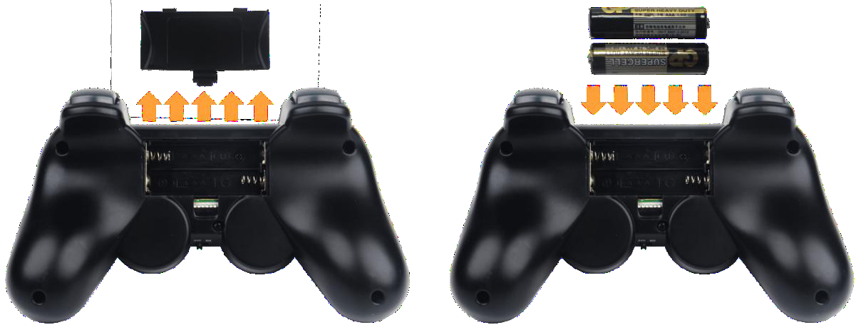

The wireless receiver for the controller is pre-installed in the robot at the time of shipment. To power the controller, insert two AAA batteries into the battery compartment on the back of the controller.
Be sure to match the positive (+) and negative (–) terminals correctly to avoid damage.

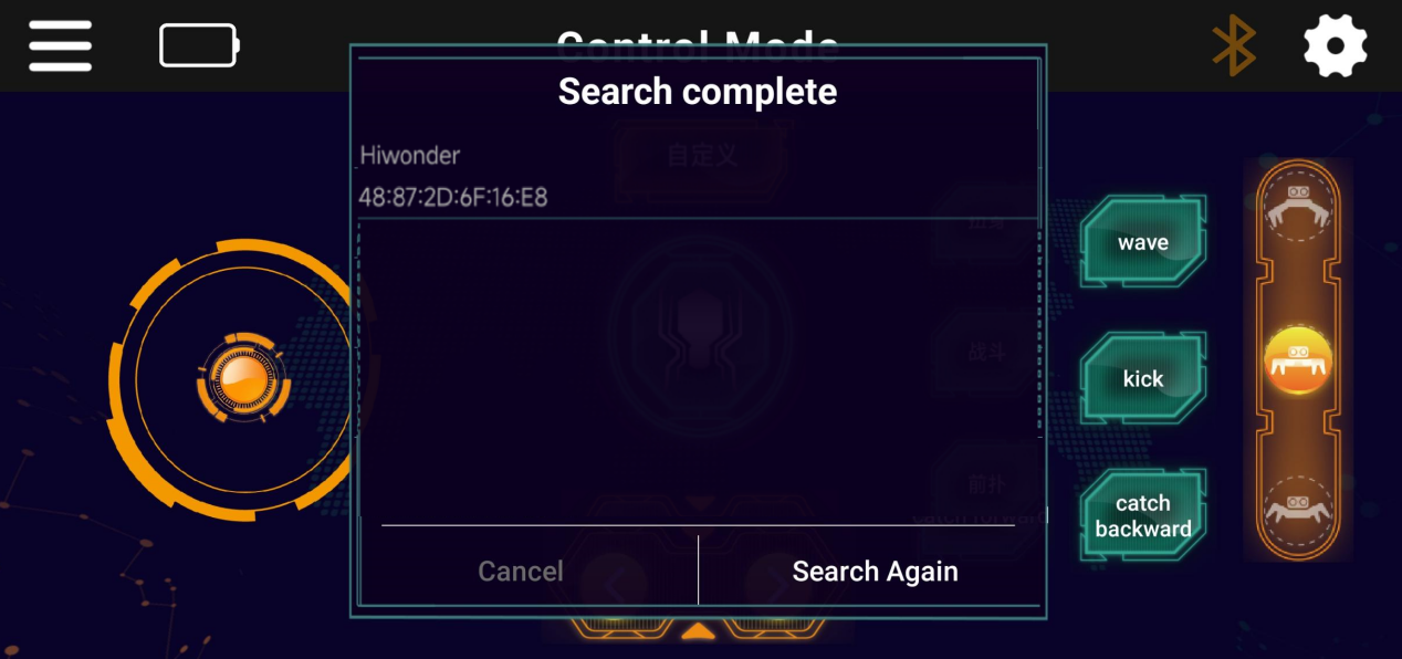

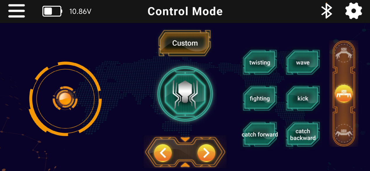

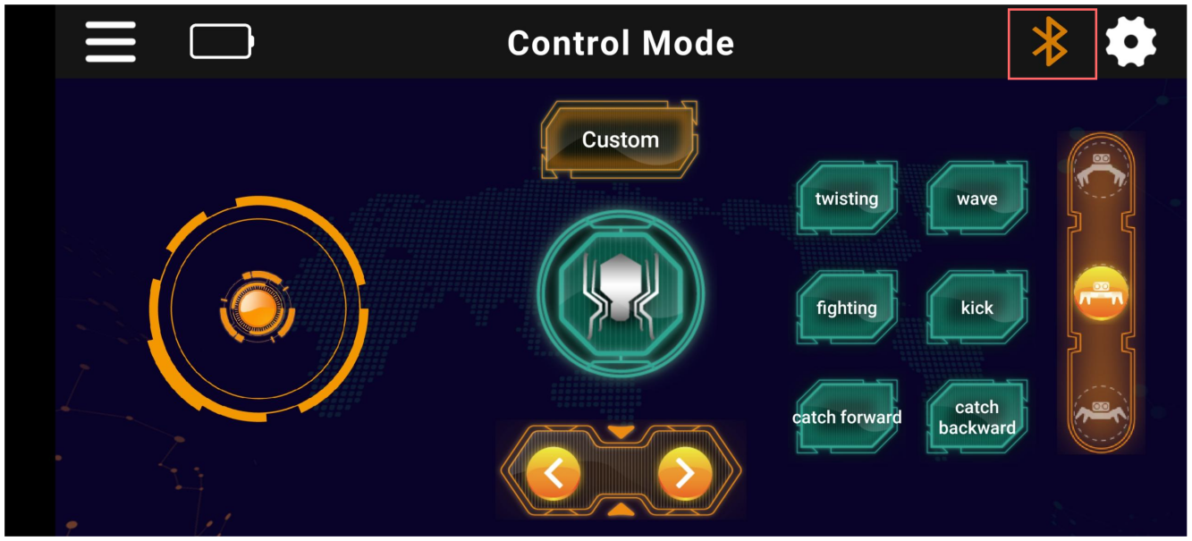

(1) Launch the Wonderbot app on your phone.
(2) On the main interface, tap the flashing Bluetooth icon to enter device search mode. After a short wait, select the device named “Hiwonder” from the list.
(3) Once connected successfully, the Bluetooth icon will remain solid and the robot’s battery level will be displayed in the top-left corner of the screen.
