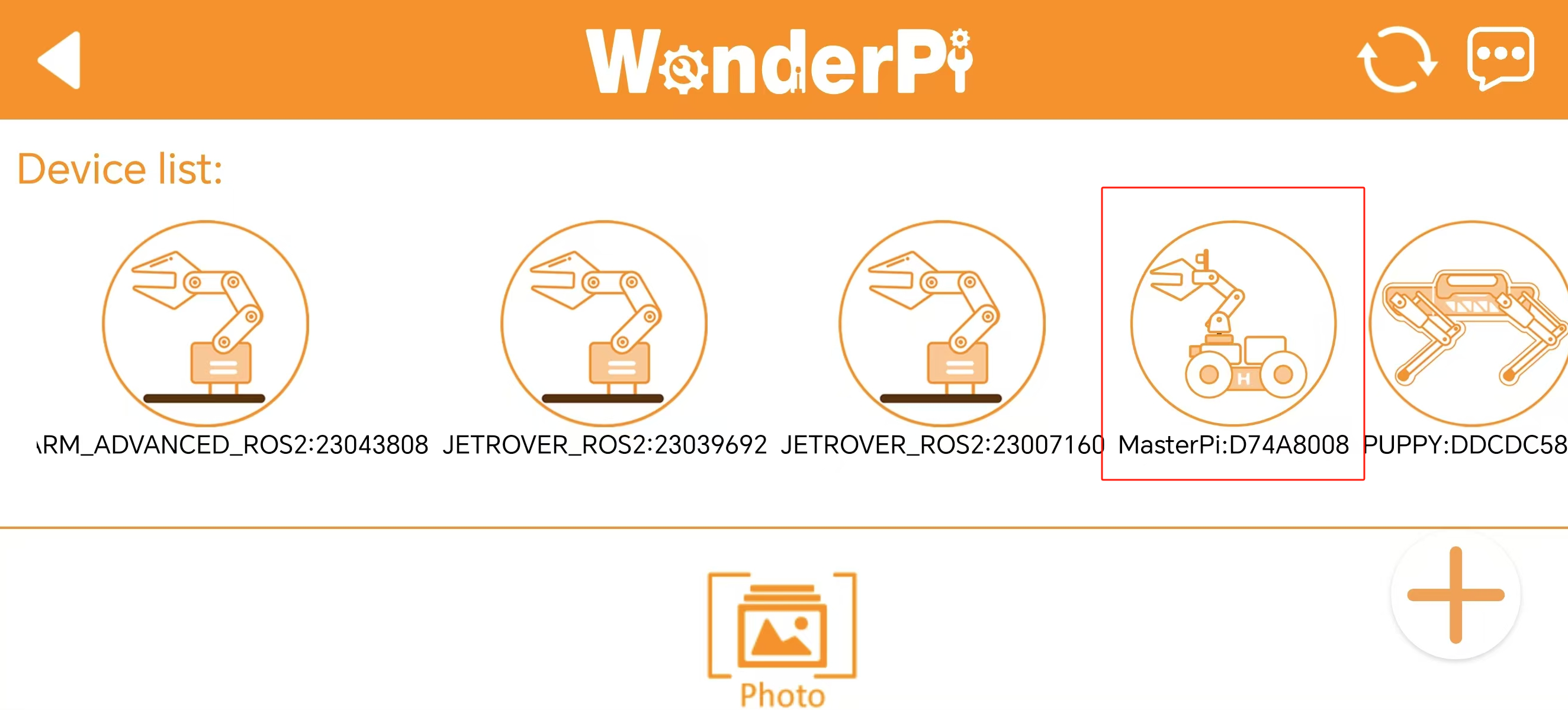

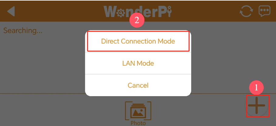

(1) Open the “WonderPi” app on your phone. Then, go to “Basic” and select “MasterPi”.
(2) Tap the “+” button in the bottom right corner of the screen, and choose “Direct Connection Mode”.
If you prefer to connect in LAN mode, refer to 6.3 Connecting in LAN Mode (optional).

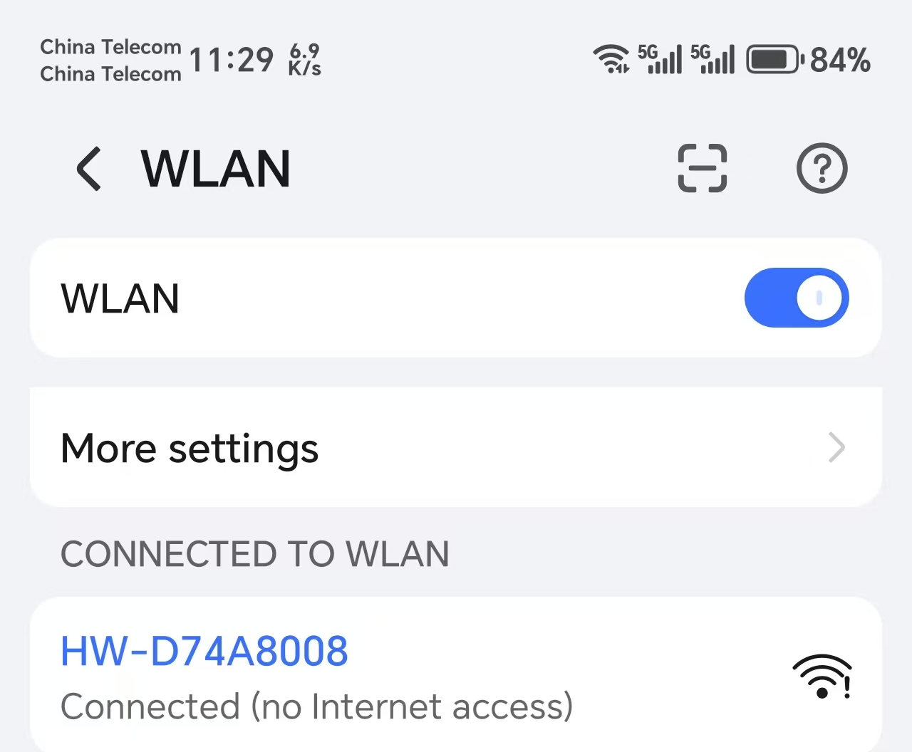

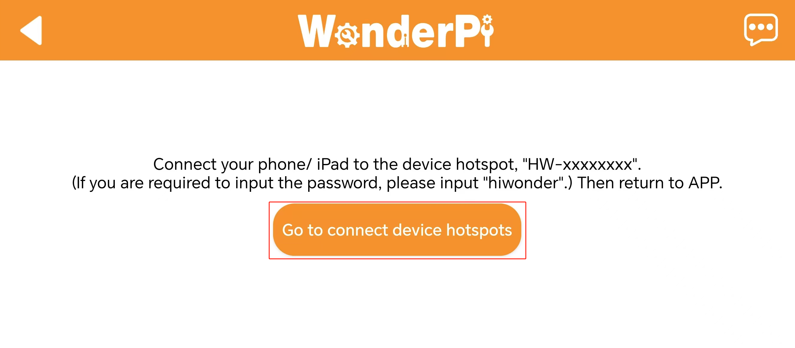

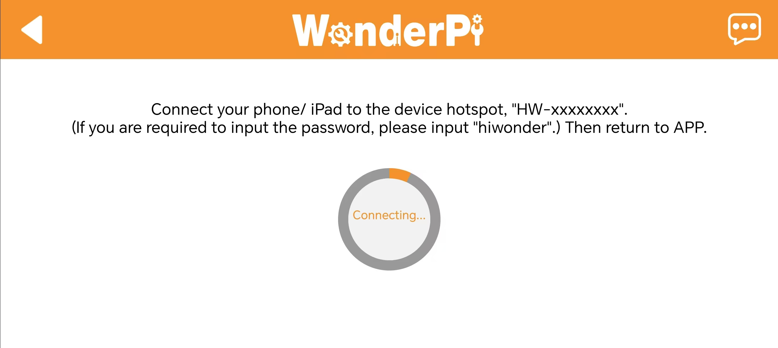

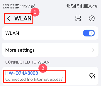

(3) Tap “Connect to Device Hotspot”. This will take you to your phone’s settings to connect to the hotspot created by the robot.
(4) Look for a hotspot name starting with “HW”. The password is “hiwonder”.
For iOS: Wait until the Wi-Fi icon appears in your phone’s status bar before returning to the app. If you don’t see the device listed, you can refresh by tapping the refresh icon in the upper-right corner of the app.

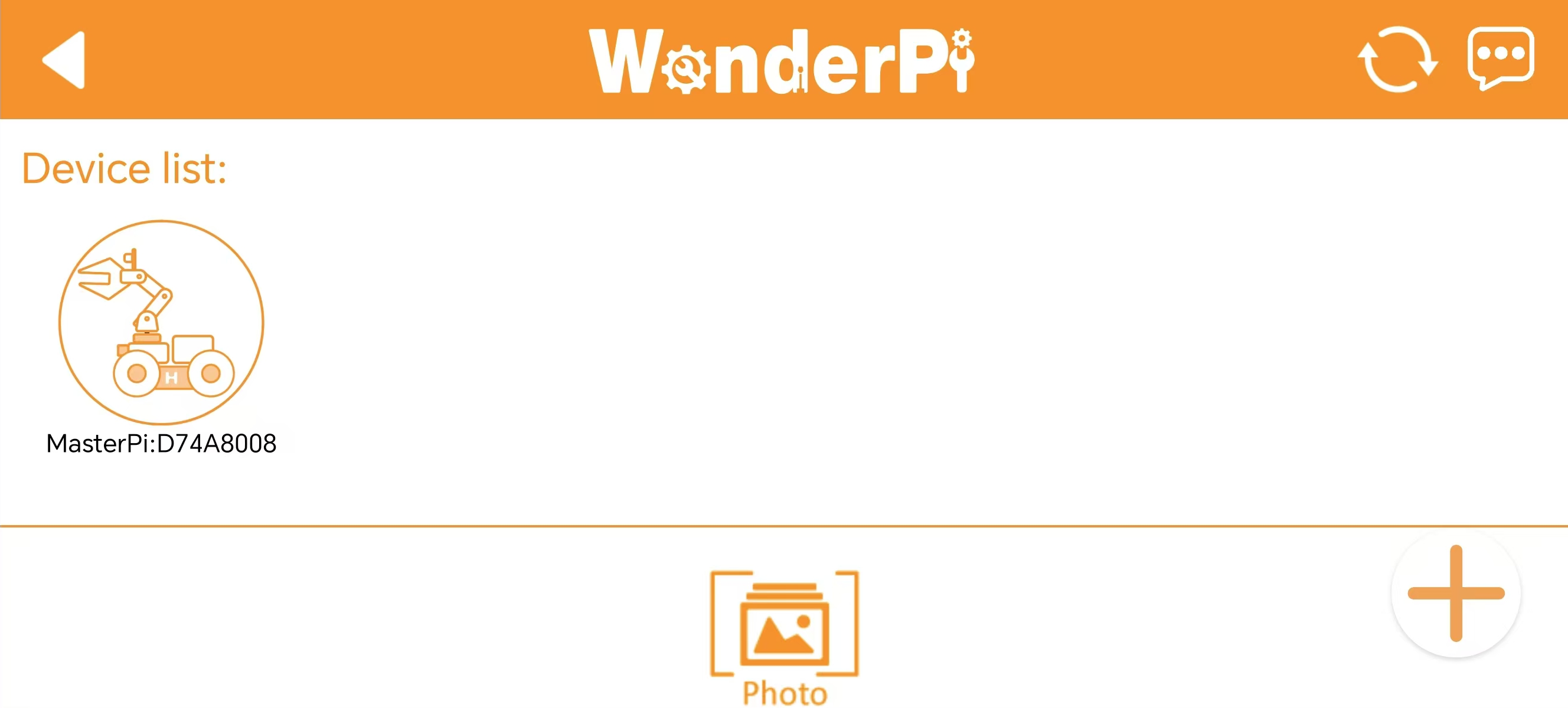

(5) Return to the app, and tap the robot icon to enter the mode selection screen.
If a pop-up message appears saying “Network Unavailable, Continue Connection?”, simply tap “Keep Connection”.

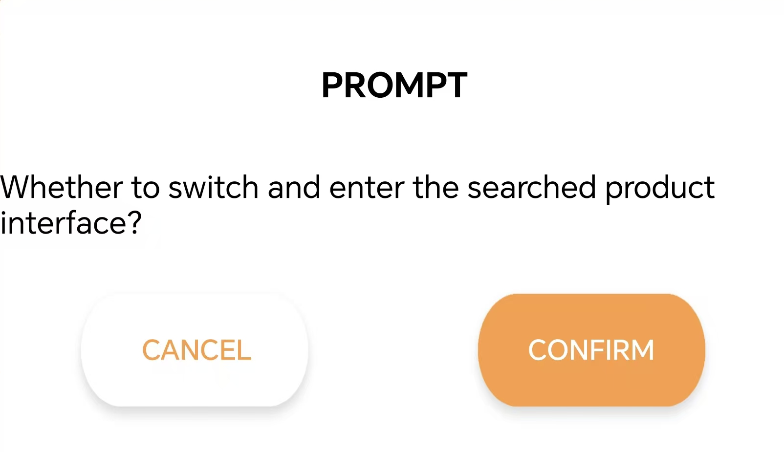

(6) If you see a prompt asking “Switch to and Enter Found Device Screen?”, it indicates that an incorrect product version was selected in Step 1. Tap “OK” to switch directly to the correct version’s mode selection screen.

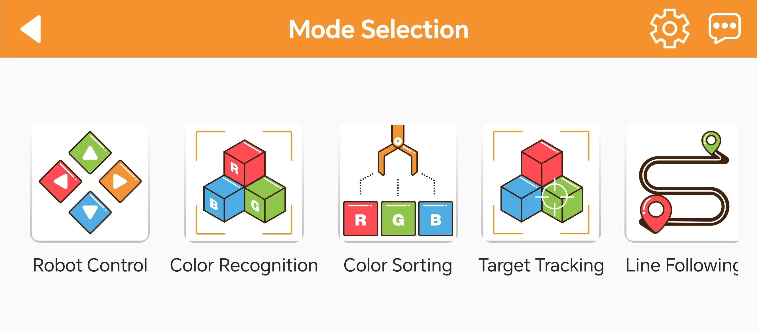

(7) The mode selection screen appears as shown below:
For details on each mode, refer to the documentation provided earlier.

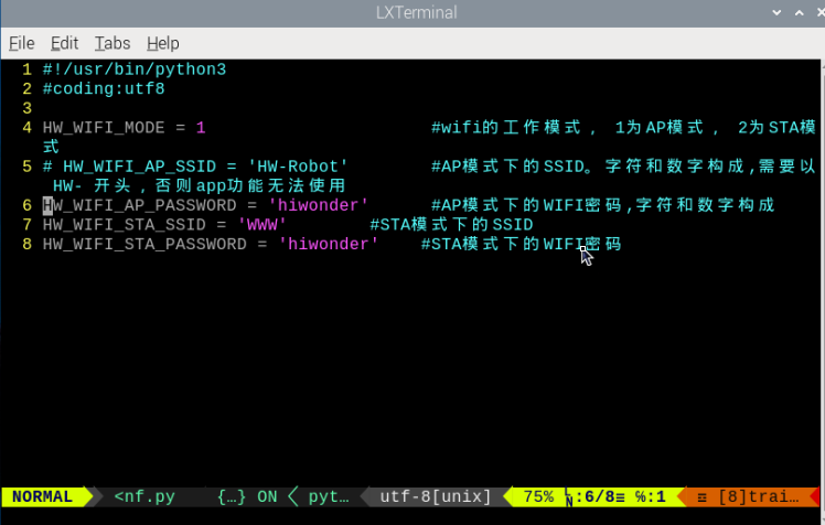

The configuration file defaults to AP Direct Connection Mode. If all code lines are commented out, it will be set to AP Direct Connection Mode.

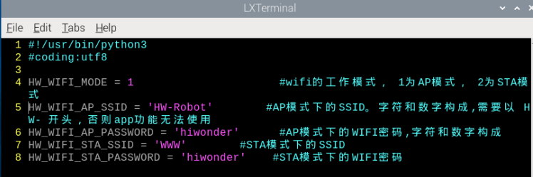

(5) If there are multiple devices nearby, you can modify “HW_WIFI_AP_SSID” and “HW_WIFI_AP_PASSWORD” to set a unique name and password for each device. For example, use “HW-Robot” as the name and “hiwonder” as the password, as shown below.
(6) After verifying the entries, press the ESC key, then type :wq to save and exit the file.

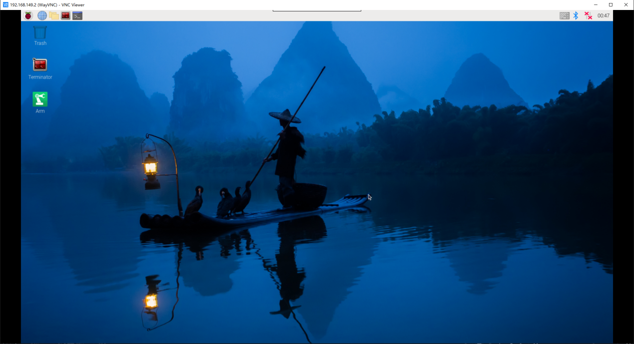

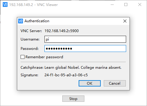

(12) To connect using VNC, enter the new IP address in the search bar, and click on the connection icon that appears. Log in with the username “pi” and password “raspberry”, then click “OK” to access the system desktop. (For the Pi5 version, the username is the same as the 4B version, but the password is “raspberrypi”.)

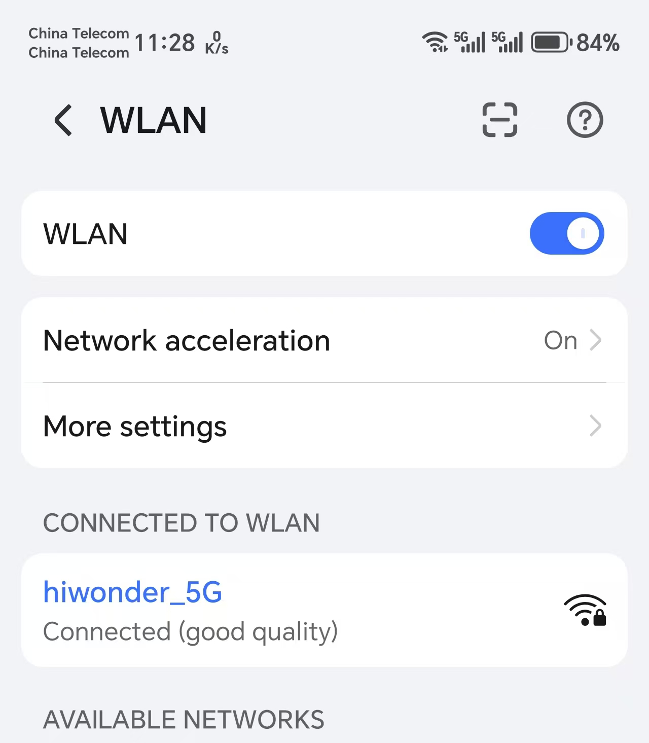

(1) First, connect your phone to Wi-Fi. In this example, we connect to “Hiwonder_5G” Wi-Fi. (For dual-band routers with separated frequencies, the Wi-Fi names may differ, such as “Hiwonder” for the 2.4G band and “Hiwonder_5G” for the 5G band.)

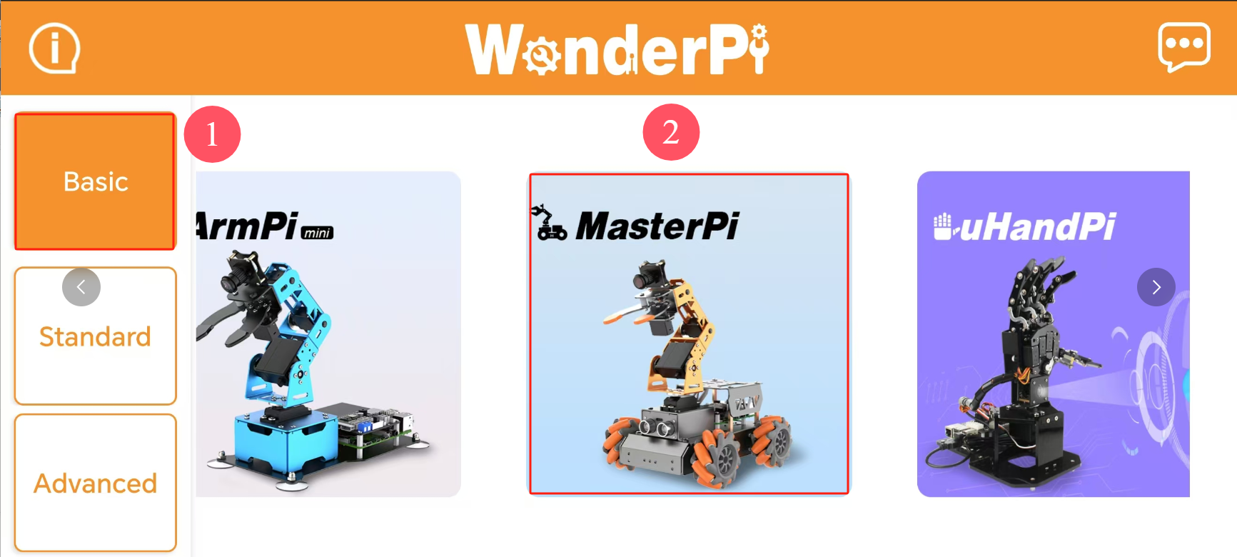

(2) Open the “WonderPi” app on your phone, then select “Basic” and “MasterPi”.

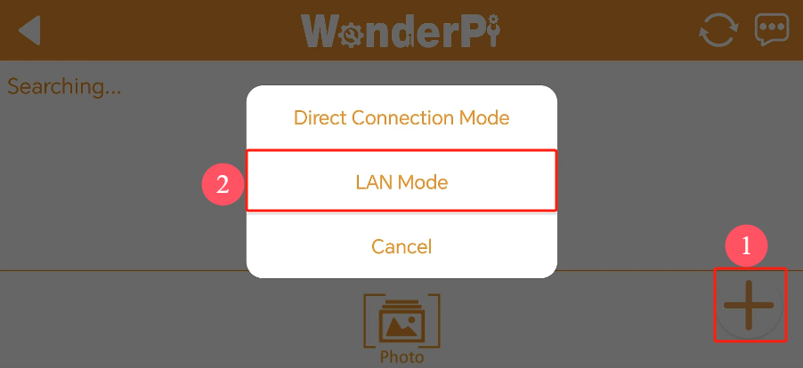

(3) Tap the “+” button in the bottom right corner, and choose “LAN Mode”.

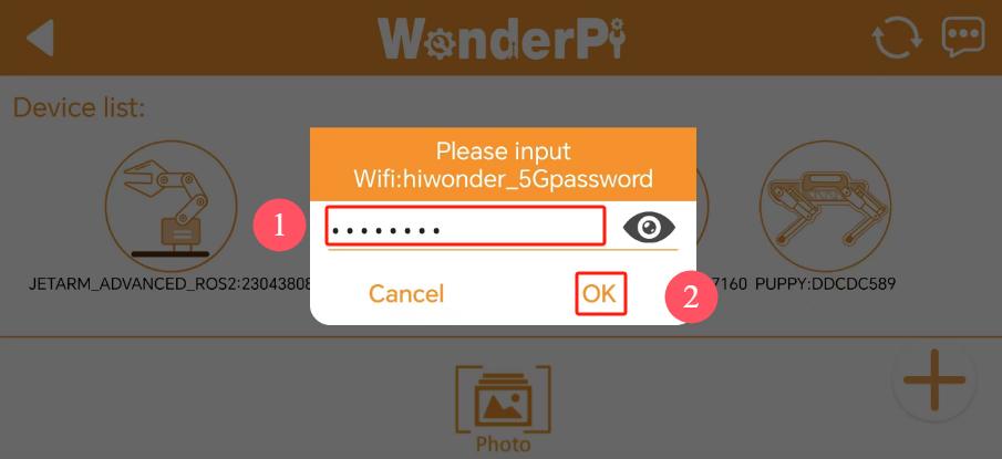

(4) The app will prompt you to enter the password for the connected Wi-Fi network. (Please ensure the password is correct, as an incorrect password will result in connection failure.) After entering the password, tap “OK”.

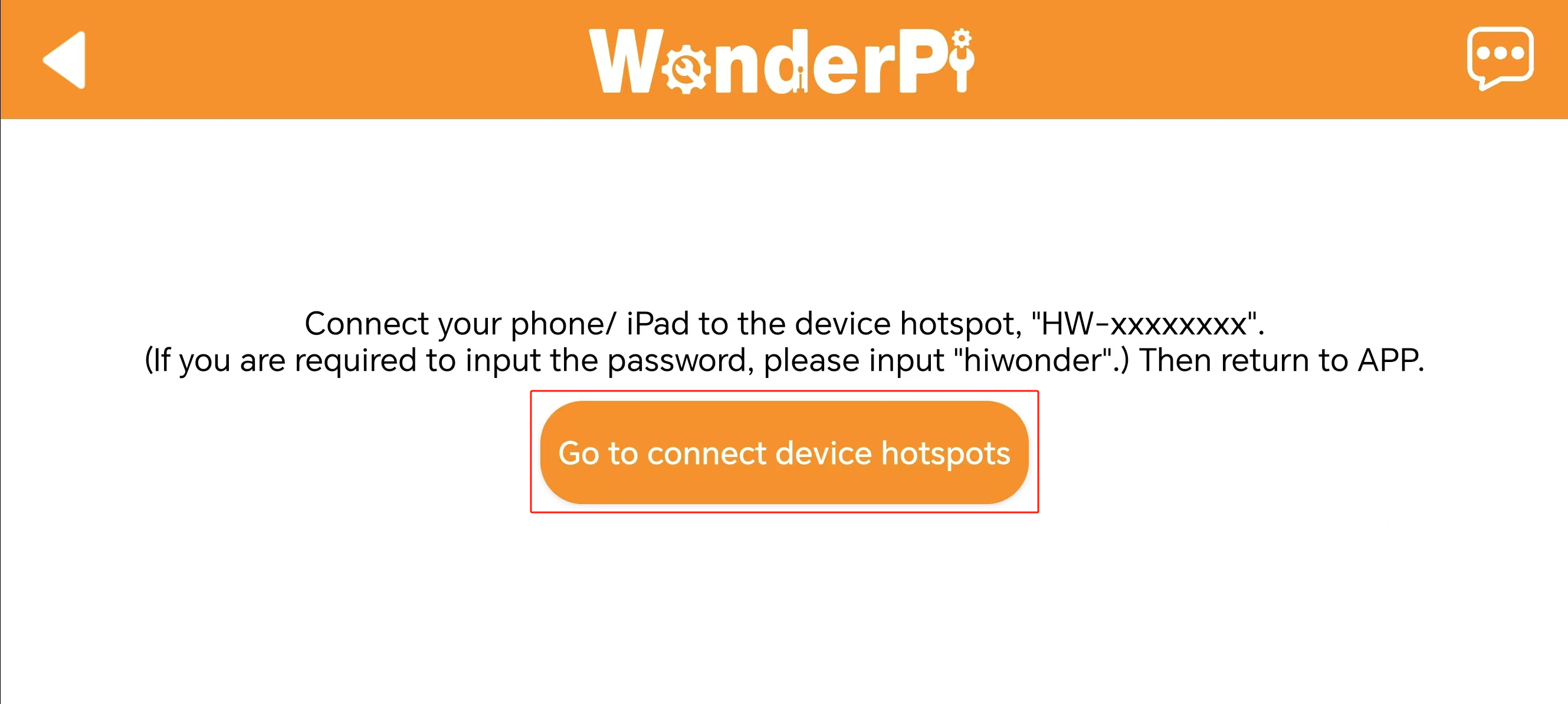

(5) Tap “Connect to Device Hotspot”.
(6) Your phone will automatically navigate to the Wi-Fi settings page. Find the hotspot starting with “HW” and enter the password “hiwonder”. Once connected, tap the “Return” button.

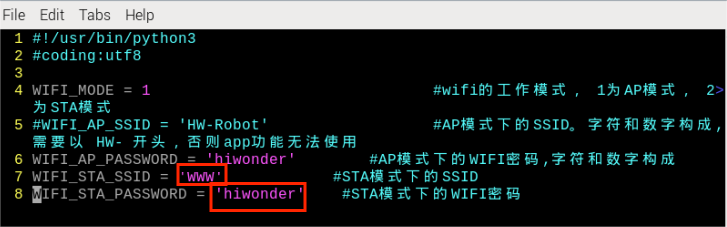

(5) First, change the value of “HW_WIFI_MODE” to 2:
① 1 represents Direct Connection Mode
② 2 represents LAN Mode
③ 3 represents Direct Sharing Mode
HW_WIFI_MODE = 2    #wifi的工作模式,1为AP模式,2为STA模式
(6) Next, modify “HW_WIFI_STA_SSID” and “HW_WIFI_STA_PASSWORD” to match your router’s Wi-Fi name and password.

(7) After confirming the entries are correct, press the ESC key, then type “:wq” to save and exit the file.
(8) Enter the command to restart the robot’s Wi-Fi service.
(9) To switch back to Direct Connection Mode, edit the configuration file again, comment out all lines, save, and restart.
