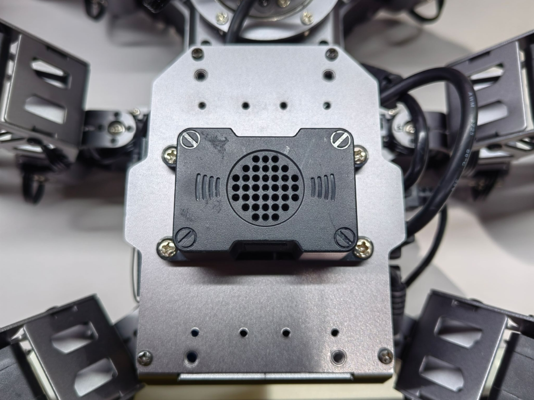

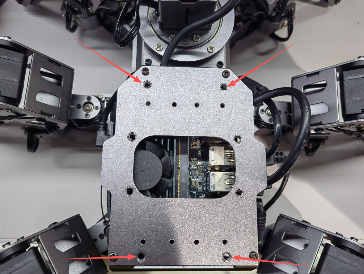

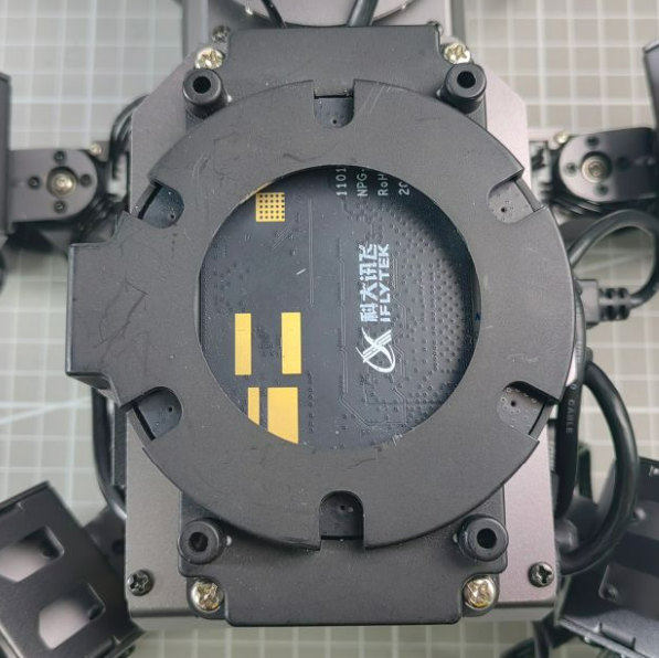

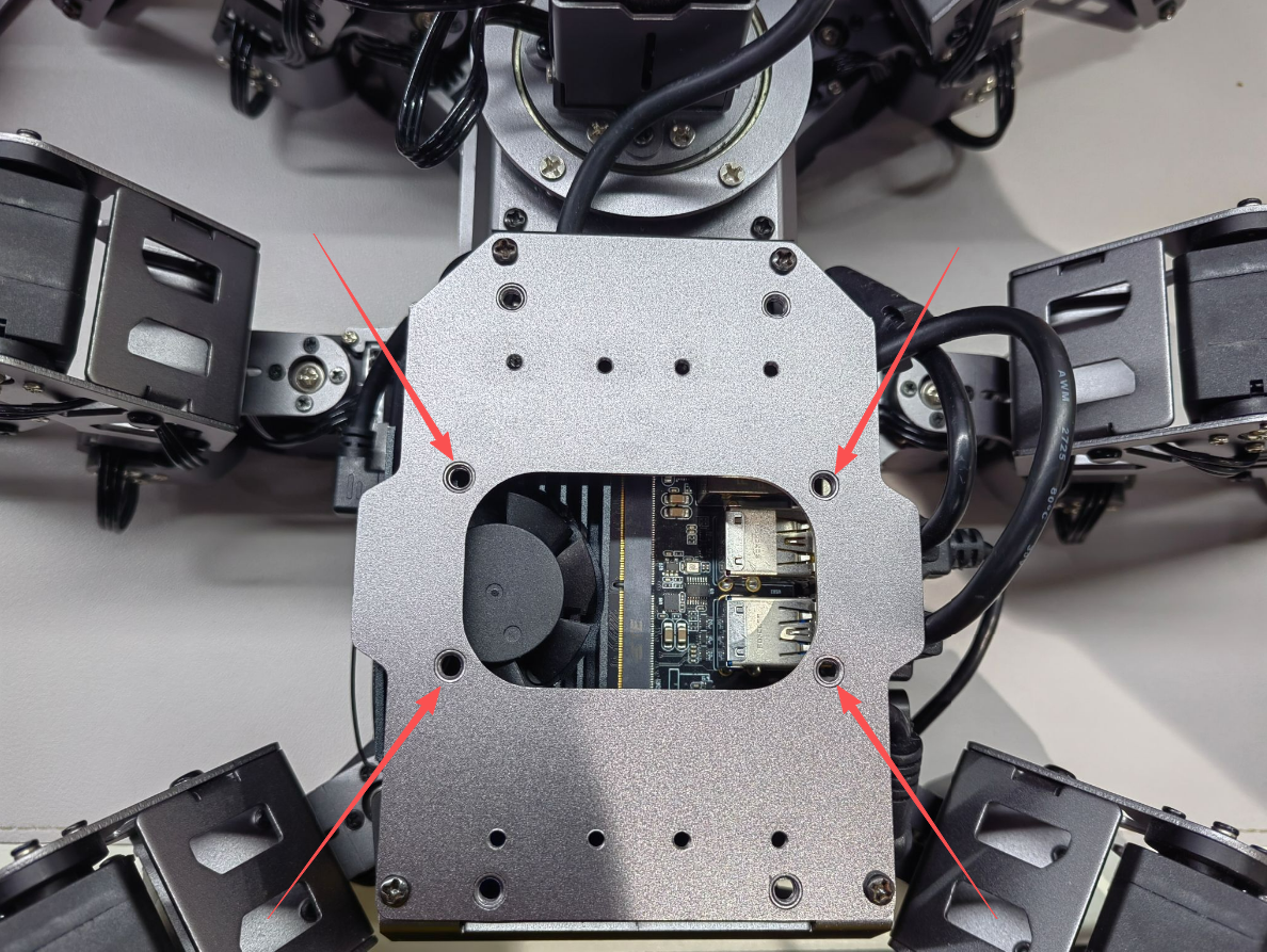

  • 6-Microphone Array Installation
First, connect the data cable to the interface at the bottom of the microphone. Then, align the four empty slots of the microphone with the four holes on the top bracket of the robot. Use a screwdriver and four M4 screws to secure the microphone to the bracket.
  • WonderEcho Pro Installation
First, connect the data cable to the port of WonderEcho Pro. Then align the four mounting holes on the voice box with the four holes in the center of the top bracket on the robot, and use a screwdriver and four M4 screws to secure the voice box to the bracket.

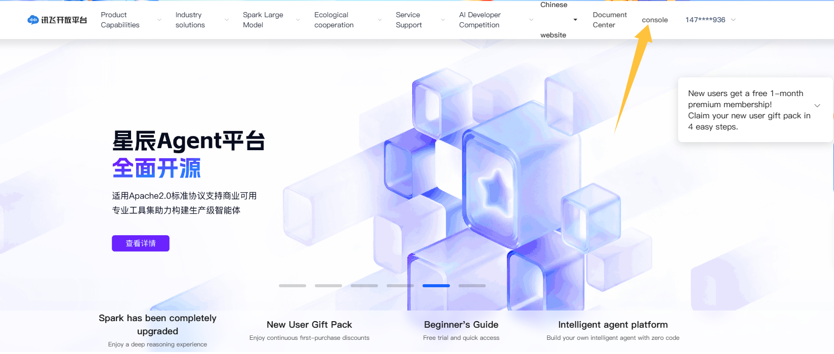

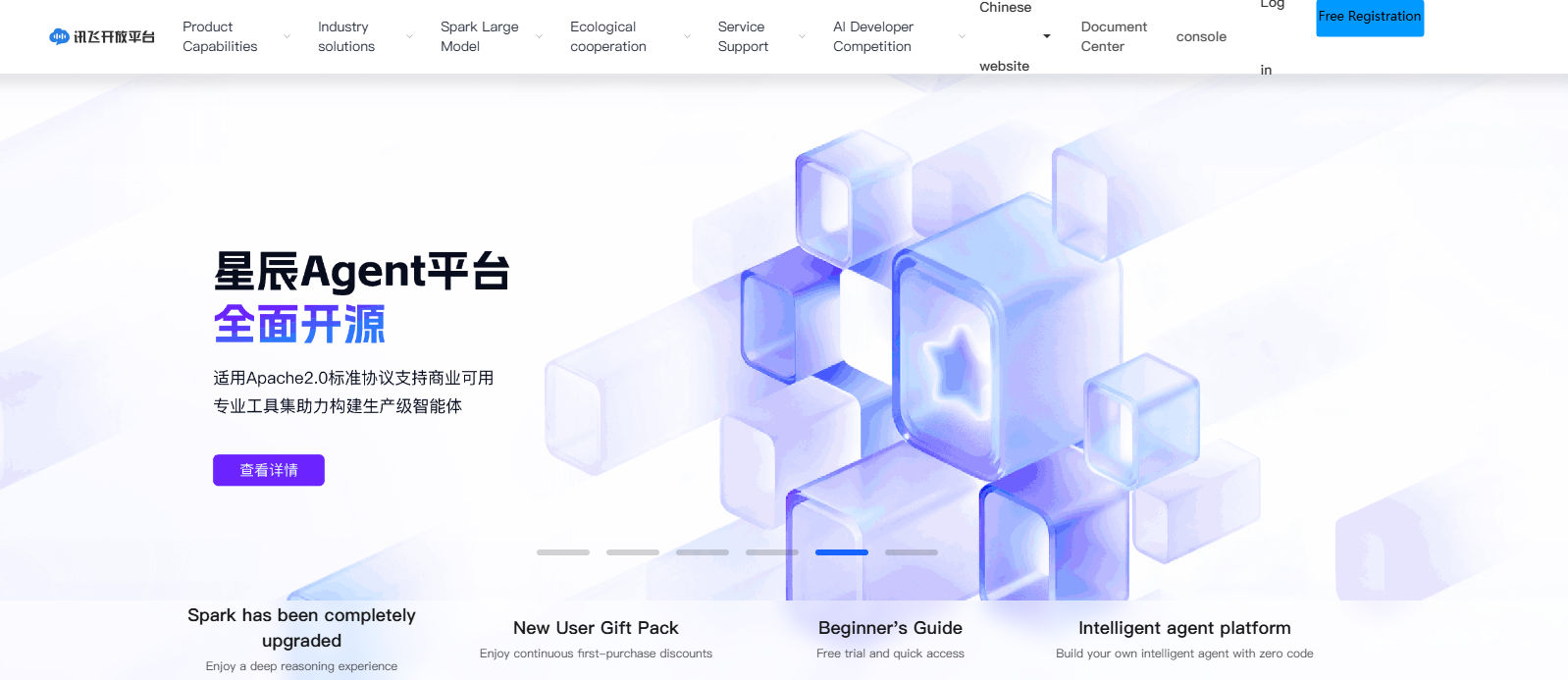

  1. Visit the iFlytek Open Platform at https://www.xfyun.cn/, and create a new account.

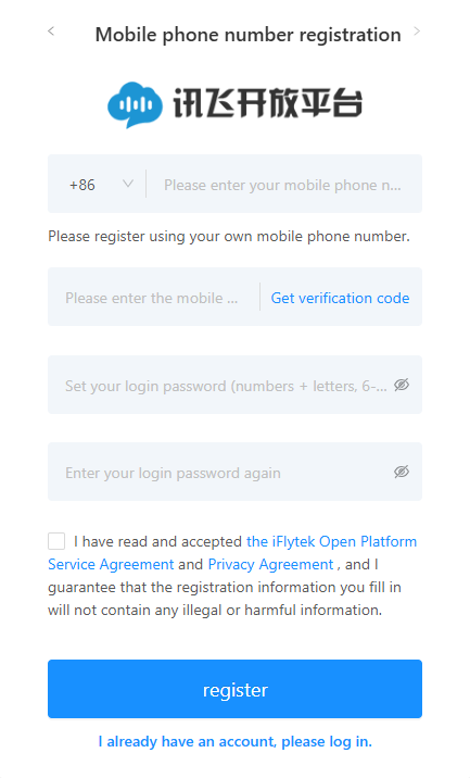

  1. Choose Login with phone number and fill in the required information. For international access, the corresponding country code should be selected.

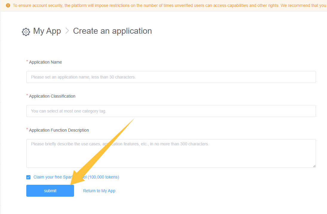

  1. Once registered, click console to create a new application.
  1. Fill in the required fields and click Submit.

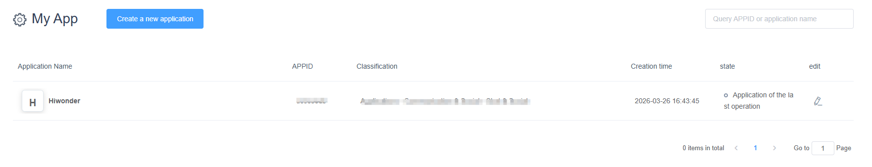

  1. Open the newly created application.

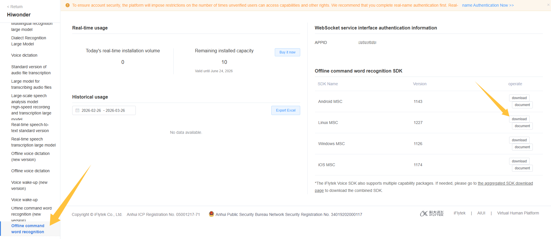

  1. Click on Offline Voice Command Recognition, locate the corresponding APPID in the red box shown below. Then navigate to Offline command word recognition SDKLinux MSC and click the download button.

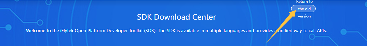

  1. Click Return to the old version.

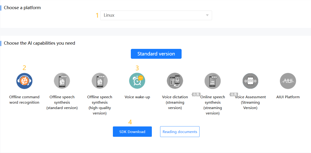

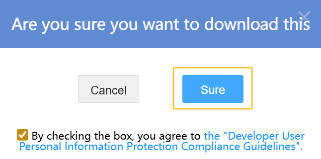

  2. Select Linux, choose the required features, click SDK Download, and click Sure to begin the download.

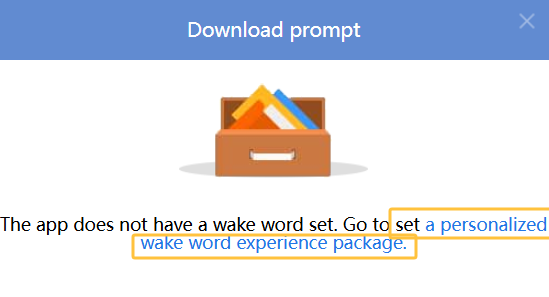

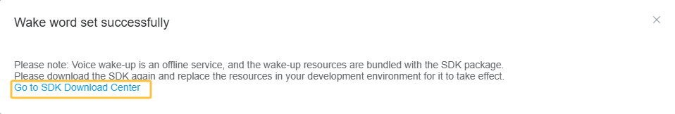

  1. Then, click Go to set a personalized wake word experience package to set the wake word and submit.
  1. In the pop-up window, click Go to SDK Download Center to download the file by repeating Step 8.

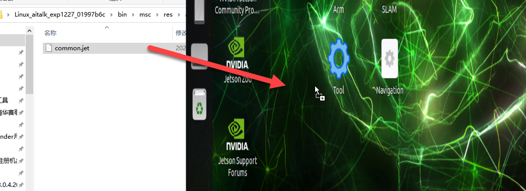

  1. Extract the compressed package from the provided materials.
Open the folder named Linux_aitalk_exp1227_01997b6c. The version ID, such as 1227_01997b6c, may vary depending on the official release. Navigate to the bin/msc/res/asr directory and locate the common.jet file. Drag this file onto the desktop of the robot’s system image.
  1. Click the icon on the system desktop to open the command line terminal.
  2. Enter the command and press Enter to replace the common.jet file.
cp /home/ubuntu/Desktop/common.jet /home/ubuntu/ros2_ws/src/xf_mic_asr_offline/config/msc/res/asr/
