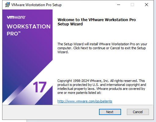

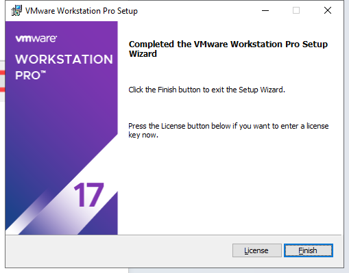

  • VMware Installation
A virtual machine is software that allows one operating system to run another operating system inside it. Here, VMware Workstation is used as an example. The installation steps are as follows:
  1. Extract the virtual machine software package located in Resources\1. Virtual Machine Software in the same folder as this document.
  2. Locate the extracted folder and double-click the virtual machine executable file with the .exe extension.

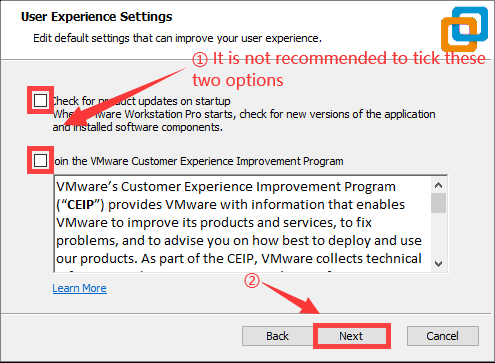

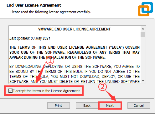

  1. Follow the on-screen instructions to complete the installation.
  1. When starting the virtual machine for the first time, enter the product key and click Continue.

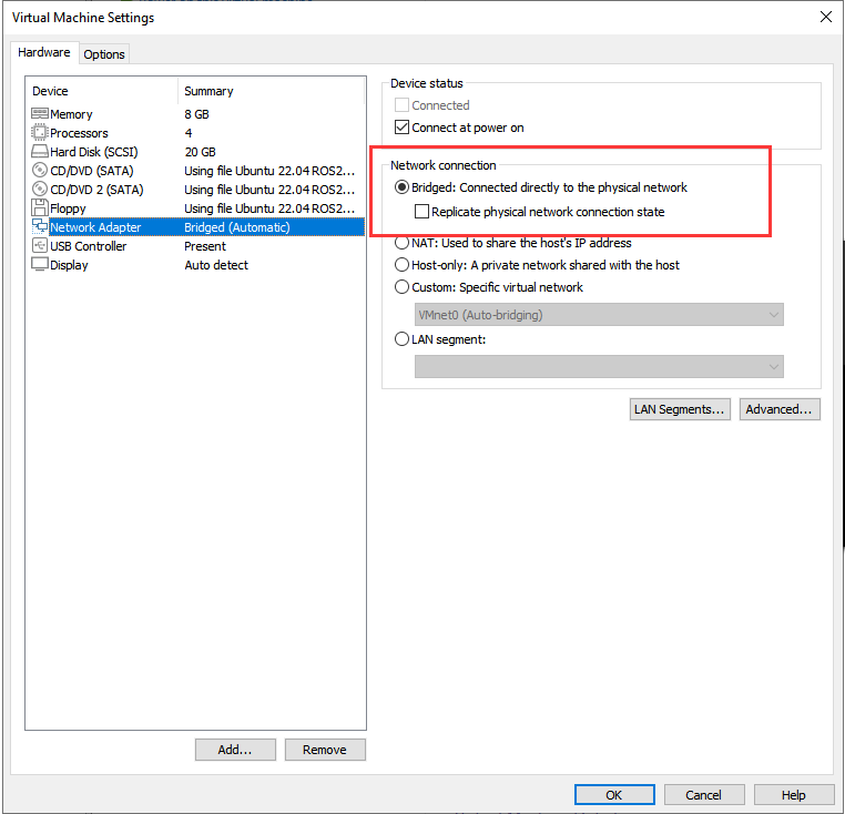

  1. Locate the virtual machine that was imported and click Edit virtual machine settings.
  1. Click on Network Adapter and select Bridged.

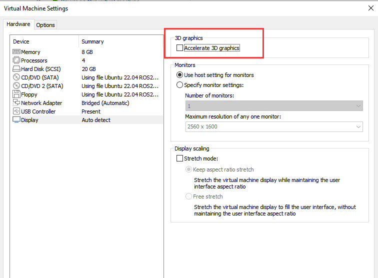

  1. Click on Display and uncheck the Accelerate 3D graphics option.

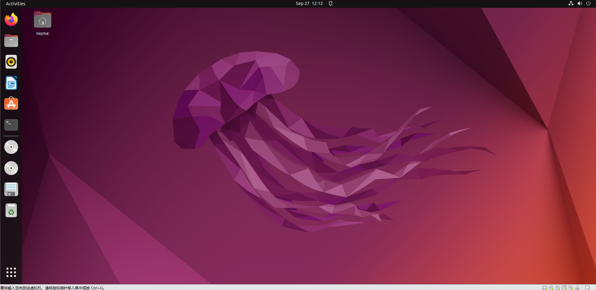

It’s normal for the virtual machine to take longer than usual during the first startup.
The virtual machine interface is as follows:

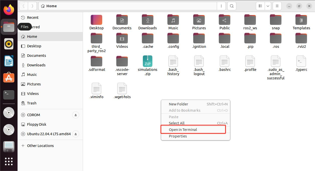

  4. Right-click in the Home directory and select Open in terminal to open the terminal.

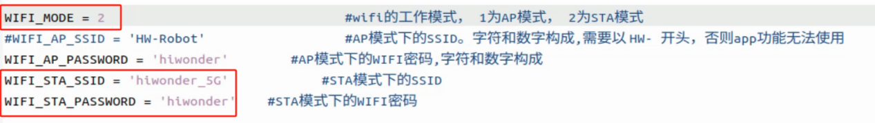

  2. Enter the following command to configure the WiFi file.
cd wifi_manager && gedit wifi_conf.py
  1. Modify the configuration to Local Area Network mode and enter the WiFi name and password. A self-provided WiFi router or a mobile phone hotspot is required for subsequent connections.
  1. Press Ctrl + S to save and close the file.

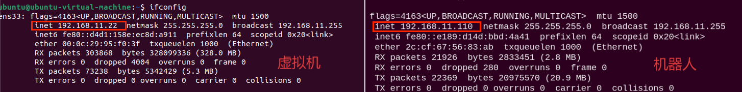

  2. For subsequent connections, it is necessary to ensure that the device and the virtual machine are on the same network segment. Enter the following command in the terminal to check.
ifconfig
In this case, the virtual machine and the robot are both on the 192.168.11 network segment, enabling normal communication.

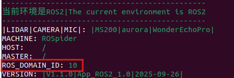

  1. Start the robot and open a command terminal.
  2. The terminal will display the DOMAIN_ID of the device as shown in the following figure. The following information is for reference only and needs to be modified according to the actual situation.

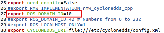

  1. Start the virtual machine, click the icon on the system desktop, and open a command terminal.
  2. Enter the following command to open the configuration file.
gedit ~/ros2_ws/.typerc
  1. Modify the ID shown in the following figure to 10.
  2. Close the previous terminal and restart a new one to observe that the ID number has been successfully modified to 10.

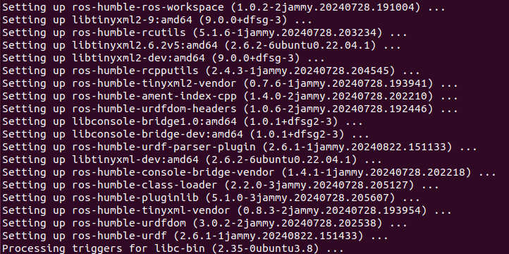

  1. Run the following command and press Enter to update the package information:
sudo apt update
  1. Run the following command and press Enter to install the URDF dependencies:
sudo apt-get install ros-humble-urdf
When the output matches the image below, the installation is successful:

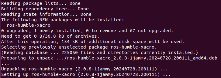

  1. Run the following command and press Enter to install the Xacro model extension for URDF:
sudo apt-get install ros-humble-xacro

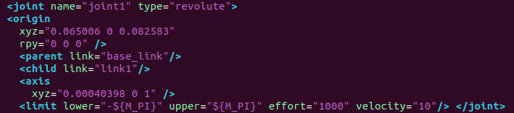

  1. Joint
In a URDF model, a joint is represented by the <joint> tag. It describes the kinematic and dynamic properties of the robot joint, including motion type, as well as position and velocity limits. According to the type of motion, joints in a URDF model can be categorized into six types:
Type & Description Label
Rotational joint: can rotate infinitely around a single axis continuous
Rotational joint: similar to continuous, but with rotation angle limits revolute
Prismatic joint: moves along an axis with position limits prismatic
Planar joint: allows translation or rotation in orthogonal plane directions planar
Floating joint: allows both translation and rotation floating
Fixed joint: a special joint that does not allow movement fixed
When defining joint behavior, the following tags are commonly used:
<parent_link>: Specifies the parent link.
<child_link>: Specifies the child link.
<calibration>: Used to calibrate the joint angle.
<dynamics>: Describes certain physical properties of the motion.
<limit>: Defines motion constraints.
Each tag contains its own child elements and serves different purposes. Refer to the table below for details.
Label Function
origin Describes the pose of the parent link. It contains two parameters: xyz specifies the link's position in the simulation map, and rpy specifies the link's orientation in the simulation map.
axis Sets the child link to rotate around any of the XYZ axes relative to the parent link.
limit Restricts the child link. The lower and upper attributes define the rotation range in radians, the effort attribute limits the force during rotation with a positive or negative value, in Newtons or N, and the velocity attribute limits the rotational speed in meters per second or m/s.
mimic Describes the relationship of this joint with other joints.
safety_controller Defines safety control parameters to protect the robot's joint movement.

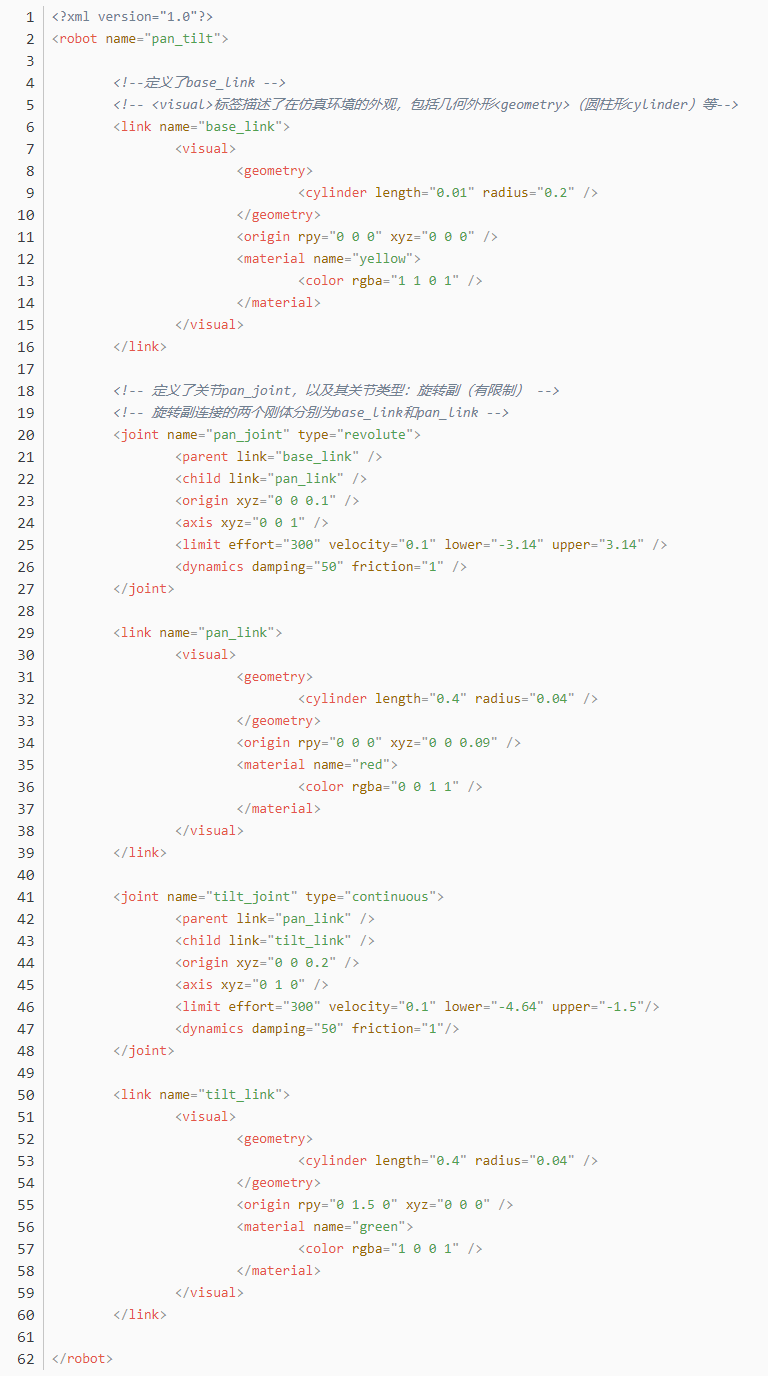

  1. Creating a Simple URDF Model
(1) Set the Robot Model Name
At the beginning of the URDF model, set the robot’s name using: <robot name=”Robot_Model_Name”> At the end of the model, enter </robot> to indicate that the robot model definition is complete.
(2) Define Links
① To write the first link and use indentation to indicate that it is part of the currently set model. Set the name of the link using the following format: <link name=”Link_Name”>. At the end of the link definition, enter </link> to indicate that the link definition is complete.
② When writing the link description, use indentation to indicate that the description belongs to the current link. Start the description with <visual> and end it with </visual>.
③ The <geometry> tag is employed to define the shape of a link. Once the description is complete, end it with </geometry>. Within the <geometry> tag, indentation is used to specify the detailed description of the link’s shape. The code below shows the shape of a link: <cylinder length=“0.01” radius=“0.2”/>. Here, length=”0.01” indicates that the link is 0.01 meters long, and radius=”0.2” indicates that the link has a radius of 0.2 meters, forming a cylinder.
④ The <origin> tag is utilized to specify the position of a link, with indentation used to indicate the detailed description of the link’s position. The following example demonstrates the position of a link: <origin rpy=”0 0 0” xyz=”0 0 0” />. In this example, rpy represents the angles of the link, while xyz represents the coordinates of the link’s position. This example places the link at the origin of the coordinate system.
⑤ The <material> tag is used to define the visual appearance of a link, with indentation used to specify the detailed description of the link’s color. To start describing the color, include <material>, and end with </material> when the description is complete. The following example demonstrates setting a link color to yellow: <color rgba=”1 1 0 1” />. In this example, rgba=”1 1 0 1” represents the color threshold for achieving a yellow color.
(3) Define Joints
① To define the first joint, use indentation to indicate that the joint belongs to the current model being set. Then, specify the name and type of the joint as follows: <joint name=”Joint_Name” type=”Joint_Type”>. At the end of the joint definition, enter </joint> to indicate that the joint definition is complete.
② Define the parent and child links of the joint. Indent the contents to show that this description belongs to the current joint. Set the parent and child parameters as follows: Format: **<parent link=”Parent_Link”/>
<child link=”Child_Link”/>** When the joint rotates, the parent link serves as the pivot, and the child link rotates relative to it.
③ <origin> describes the position of the joint, with indentation used to specify the detailed coordinates of the joint. The code below describes the position of the joint: <origin xyz=“0 0 0.1” />. Here, xyz specifies the coordinates of the joint, placing it at x=0, y=0, z=0.1 in the coordinate system.
④ <axis> specifies the joint’s orientation. Indent its contents to define the joint’s axis and rotation direction. The code below shows a joint’s orientation: <axis xyz=“0 0 1” />. Here, xyz specifies the orientation of the joint.
⑤ <limit> defines motion constraints for the joint. Indent its contents to provide detailed limits on the joint’s angle. The code below shows a joint whose maximum torque does not exceed 300 N, with an upper rotation limit of 3.14 radians and a lower limit of -3.14 radians. These limits are defined according to the following formula: effort = joint torque (N), velocity = joint movement speed, lower = lower rotation limit (rad), upper = upper rotation limit (rad).
⑥ <dynamics> describes the joint’s dynamics, with indentation used to define the joint’s dynamic properties. The code below shows an example of a joint’s dynamics parameters: <dynamics damping=”50” friction=”1” />, where damping specifies the damping value, and friction specifies the friction coefficient.

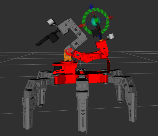

10.3.2 Robot URDF Model Instructions
  • Preparation
To understand the URDF model, refer to section 10.3.1 Overview and Basics of URDF Models in this file for related syntax. This section provides a brief analysis of the robot model code and component models.
  • Viewing the Robot Model Code

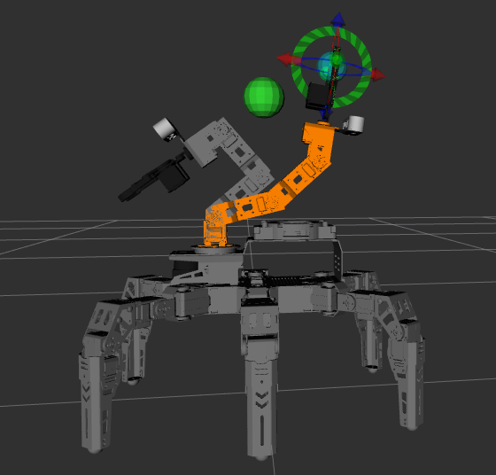

  1. Launch the virtual machine. Click the terminal icon on the left of the system desktop to open a command-line window.
  2. Enter the command and press Enter to navigate to the program’s startup directory.
cd ros2_ws/src/simulations/rospider_description/urdf
  1. Enter the following command to open the robot simulation model file.
vim rospider.xacro
Multiple URDF models are invoked to assemble the complete robot:
File Name Device
materials Color
inertial_matrix Inertial Matrix
base Base
lidar LiDAR
imu Inertial Measurement Unit
depth_camera Depth Camera
arm Robotic Arm
gripper Robotic Gripper

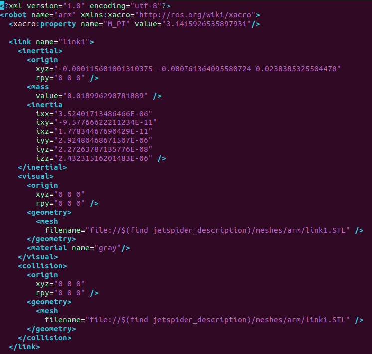

  • Brief Robot Model Analysis
Open a new command terminal and enter the command to open the robot model file.
vim arm.urdf.xacro
The beginning of the URDF file specifies the XML version and encoding and defines a robot model named arm. The xmlns:xacro namespace is used to generate the URDF using Xacro macro definitions. The constant M_PI defines the ratio of a circle’s circumference to its diameter with a value of 3.14159… and is utilized for joint angle calculations.
The following provides an analysis of the link named link1:
Sub-tag Function and Parameter Description
<inertial> Defines the physical inertial properties of the link. These properties affect the mechanical behavior during simulation.
origin:The pose of the inertial coordinate system relative to the link coordinate system. Here, xyz represents the position and rpy represents the orientation. mass: The mass of the link with a value of 0.018996290781889 kg. inertia: The inertial matrix contains 6 parameters. This describes the rotational inertia around each axis.
<visual> Defines the visual model of the link. This is used for display in tools like RViz. origin: The pose of the visual model relative to the link. This coincides with the link coordinate system in this instance. geometry: Loads the STL model file via mesh. The path is link1.STL under the jetspider_description package. material: Specifies the color as gray.
<collision> Defines the collision detection model. This is utilized for collision judgment during simulation. It shares the same STL model with the <visual> tag to ensure the visual and collision ranges are identical. The origin coincides with the link coordinate system so the collision detection range perfectly matches the appearance model.
The following details the analysis of the joint named joint1:
name Joint name is joint1.
type Joint type is revolute. This signifies a rotating joint.
origin The pose of the joint coordinate system relative to the parent link. The position is 0.065006, 0, 0.082583 meters and the orientation is 0.
parent Parent link is base_link. This is the robotic arm base.
child Child link is link1. This represents the first arm segment.
axis The rotation axis is 0.00040398, 0, 1. This is approximately the vertical Z axis.
limit Motion limits. The angle range is -π to π which means -180 degrees to 180 degrees allowing omnidirectional rotation. The maximum effort is 1000N. The maximum velocity is 10m/s.
This tutorial uses a virtual machine as an example for configuration and learning. If a virtual machine is not yet installed, proceed with the installation according to the relevant content in section 10.1 Virtual Machine Installation and Import before continuing the study.

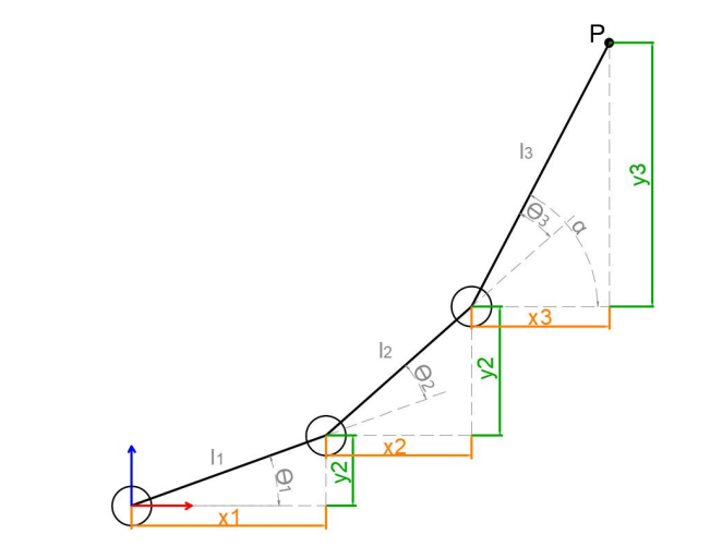

  • Inverse Kinematics Analysis
1. Geometry
For a robotic arm, inverse kinematics involves determining the rotation angles of each joint given the position and orientation of the gripper. The three-dimensional motion of a robotic arm can be quite complex. To simplify the model, we eliminate the rotation joint at the base, allowing us to perform kinematic analysis in a two-dimensional plane.
Inverse kinematic analysis typically involves extensive matrix computations, and the process is complex with significant computational requirements, making implementation challenging. To better suit our needs, we use a geometric approach to analyze the robotic arm.
We simplify the model of the robotic arm by removing the base pan-tilt and the end effector, focusing on the main body of the arm. From the diagram, we can see the coordinates (x, y) of the endpoint P of the robotic arm. Ultimately, it is composed of three parts (x1 + x2 + x3, y1 + y2 + y3).
In the diagram, θ1, θ2, and θ3 are the angles of the servos that we need to solve, and α is the angle between the gripper and the horizontal plane. From the diagram, it’s evident that the top-down angle of the gripper α = θ1 + θ2 + θ3. Based on this observation, we can formulate the following equation:
The values of x and y are provided by the user, while l1, l2, and l3 represent the inherent mechanical properties of the robotic arm’s structure.
For ease of calculation, we will preprocess the known components for a holistic consideration:
Substituting m and n into the existing equation and simplifying further, we can obtain:
Through calculation, we have:
We observe that the above expression is the quadratic formula for a single variable, where:
With this information, we can determine the angles θ1 and, similarly, calculate θ2. Consequently, we can determine the angles for all three servos. By controlling the servos based on these angles, we can achieve control over the coordinate position.

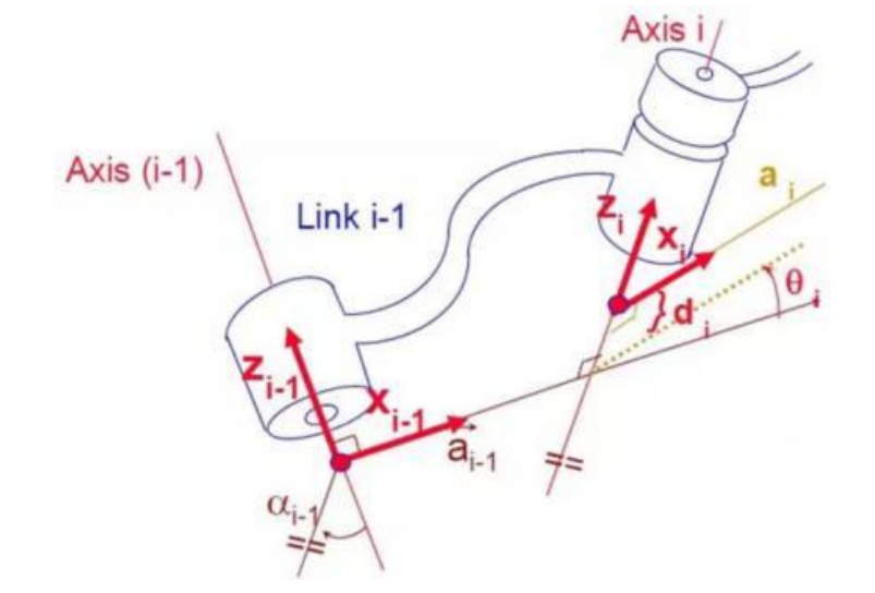

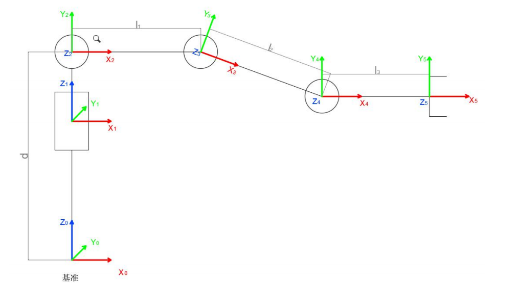

2. DH Modeling
The DH Parameter Table (Denavit-Hartenberg Parameter Table) is a standardized method used to describe the relative position and orientation of robotic arm joints and links. It uses four parameters to represent the relationship between each pair of adjacent joints. These four DH parameters have very clear physical meanings, as described below:
(1) Link Length: The length of the common normal between the axes of two adjacent joints, the rotation axis for rotational joints, and the translation axis for prismatic joints.
(2) Link Twist: The angle by which the axis of one joint is rotated around the common normal relative to the axis of the adjacent joint.
(3) Link Offset: The distance along the axis of a joint between the common normal of the current joint and the common normal of the next joint.
(4) Joint Angle: The angle of rotation around the joint axis between the common normal of the current joint and the common normal of the next joint.
While these definitions might seem complex, they become much clearer when viewed in the context of coordinate systems.
First, you should focus on the two most important “lines”: - The axis of a joint (axis). - The common normal between the axis of one joint and the axis of the adjacent joint.
In the DH parameter system, we define the axis as the z-axis, and the common normal as the x-axis, where the direction of the x-axis is from the current joint to the next joint.
However, these two rules alone are not enough to fully determine the coordinate system of each joint. Let’s now go over the detailed steps for determining the coordinate system.
In applications such as robotic arm simulations, we may use other methods to establish coordinate systems. However, understanding the method described here is crucial for grasping the mathematical expressions of robotic arms and for understanding the subsequent analyses.
The diagram below shows two typical robot joints. Although these joints and links may not resemble any specific joints or links from real robots, they are quite common and can easily represent any joint in a real robot.
  • Determine Coordinate System
There are generally several steps involved in determining the coordinate system:
(1) To model a robot using the DH notation, the first step is to assign a reference coordinate system to each joint. For each joint, both the Z-axis and the X-axis must be specified.
(2) Defining the Z-axis: For a rotational joint, the Z-axis is aligned with the direction of rotation according to the right-hand rule. The joint variable is the rotation angle around the Z-axis. For a prismatic joint (sliding joint), the Z-axis aligns with the direction of linear motion. The link length d along the Z-axis is the joint variable.
(3) Defining the X-axis: When two joints are neither parallel nor intersecting, the Z-axes are usually skew lines, but there always exists a common perpendicular that is the shortest distance between them. This perpendicular is orthogonal to both skew lines. Define the local reference frame’s X-axis along the direction of the common perpendicular. If a n represents the common normal between the Z-axes of joint n and joint n+1, then the direction of the X-axis, Xn, will be along an.
Special Cases: When the Z-axes of two joints are parallel, there are infinitely many common normal lines. In this case, one can choose the common normal that is collinear with the common normal of the previous joint, simplifying the model. When the Z-axes of two joints intersect, there is no common normal. In this case, the X-axis can be defined along the line perpendicular to the plane formed by the two axes, simplifying the model.
Once the coordinate system is assigned to each joint, the model can be represented as shown in the diagram below:
After determining the coordinate system, we can represent the four parameters more simply:
Link Length li: Defined as the distance along the positive Xi - 1 axis from Zi - 1 axis to Zi axis.
Link Twist αi: Defined as the angle of rotation along the positive direction Xi - 1 using the left-hand or right-hand rule between Zi - 1 axis and Zi axis.
Joint distance di: Defined as the distance measured along the positive direction of Zi - 1, from the Xi - 1 axis to the Xi axis.
Joint angle θi: Defined as the rotation angle measured around the positive direction of Zi - 1, from the Xi - 1 axis to the Xi axis.

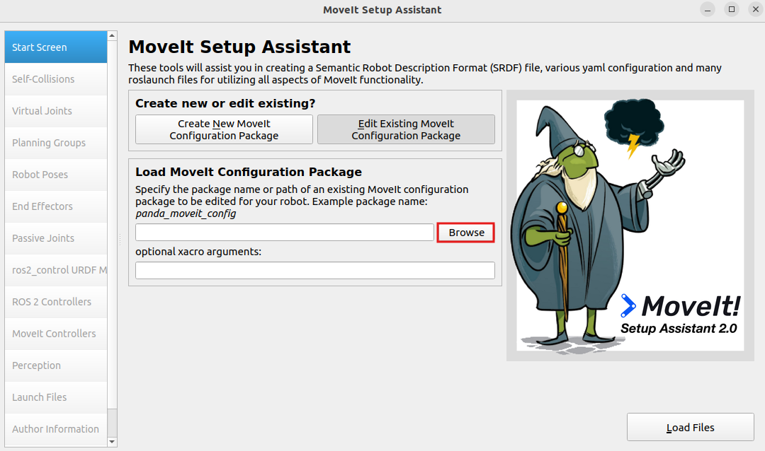

  1. Launch the virtual machine. Click the terminal icon in the system desktop to open a command-line window.

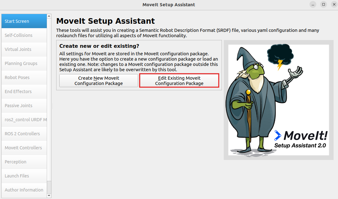

  2. Entering the following command to launch the MoveIt2 configuration tool.
ros2 launch moveit_setup_assistant setup_assistant.launch.py

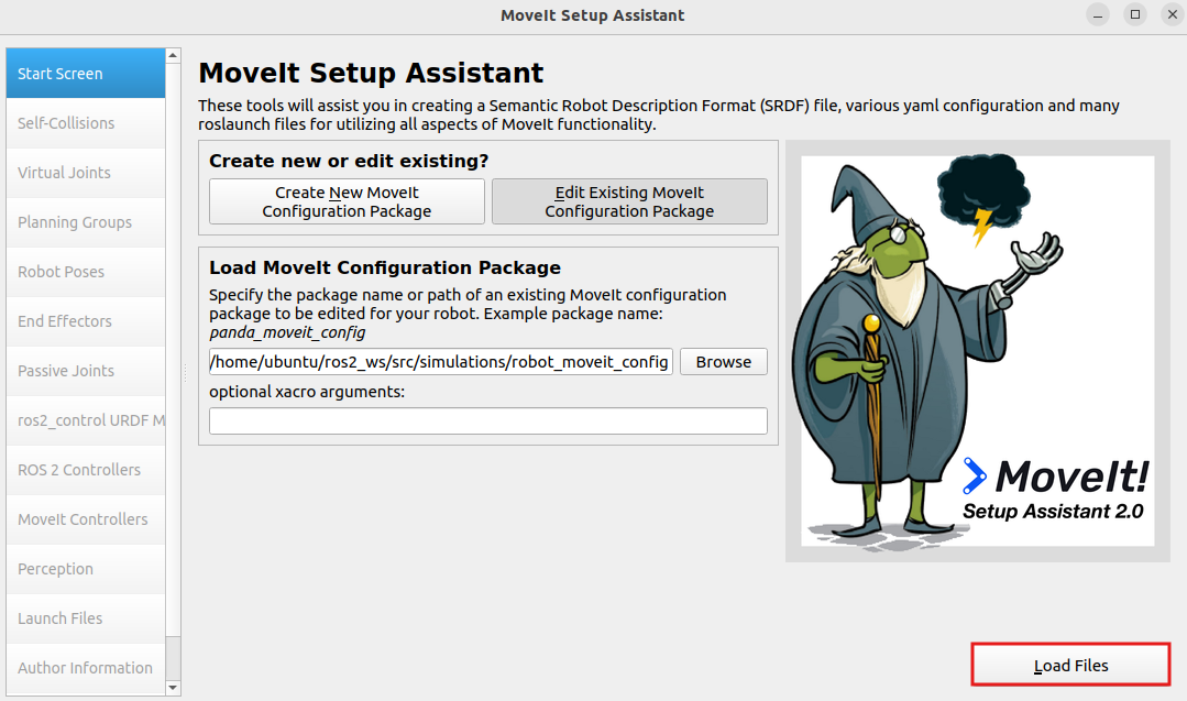

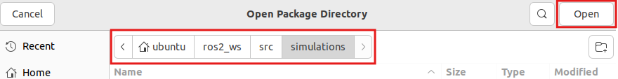

  1. Click Edit Existing MoveIt2 Configuration Package to begin editing an existing configuration package.
  1. Click Browse and navigate to the robot_moveit_config folder under the directory home/ubuntu/ros2_ws/src/simulations, then click Open.
  1. Click Load Files and wait for the files to load.
Once the progress reaches 100%, the robot model will appear on the right side, indicating a successful load.
Reconfiguring will overwrite previous settings. Errors during this process may result in functionality issues. The system comes pre-configured from the factory and requires no reconfiguration. This information is provided strictly for reference purposes.

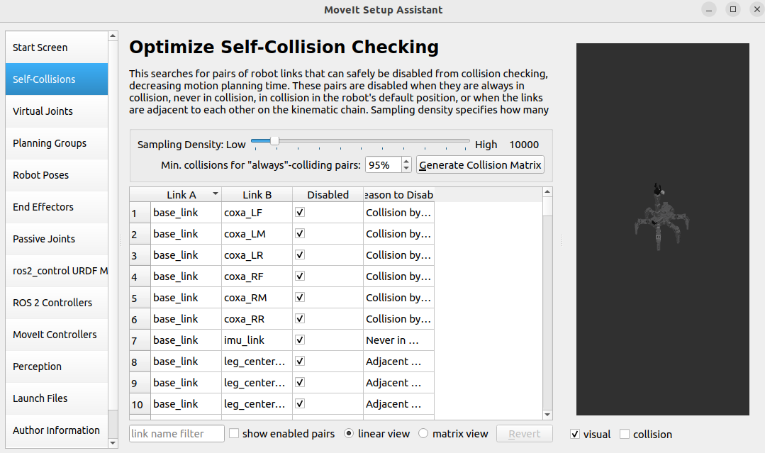

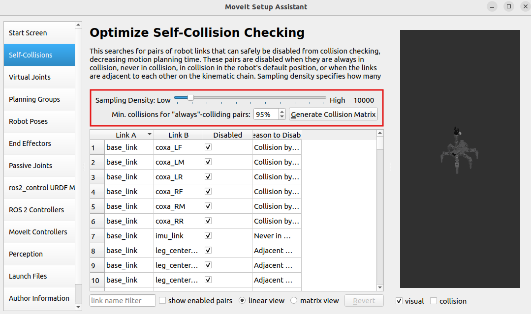

1. Self-Collisions
Generate a custom collision matrix. The default collision matrix generator scans all joints of the robot. This custom collision matrix can safely disable specific collision checks, thereby reducing the processing time for motion planning.
Sampling density refers to the number of random joint configurations sampled to check for collisions. Higher density increases computation time. The default value is 10,000 collision checks.

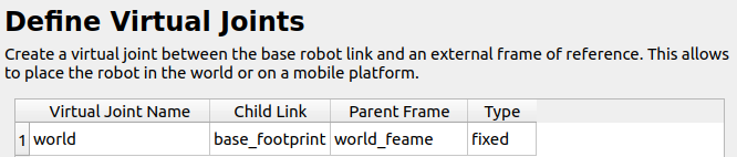

2. Virtual joints
Add virtual joints, which are primarily used to connect the robot to a simulation environment. In this step, a virtual joint is defined to link the base_footprint frame to the world_frame.

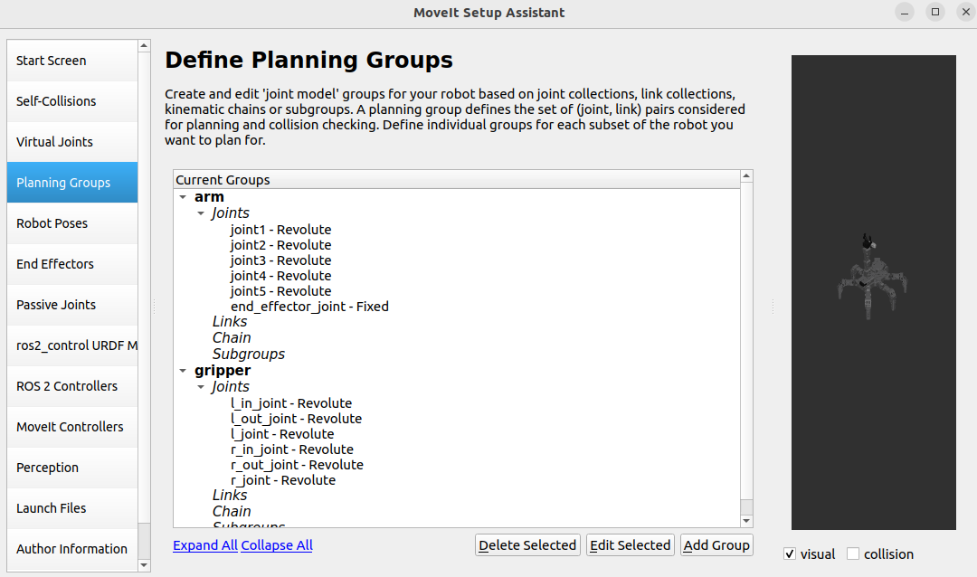

3. Planning Groups
Add joint groups, which are used to define the various joint components required to assemble the robot.

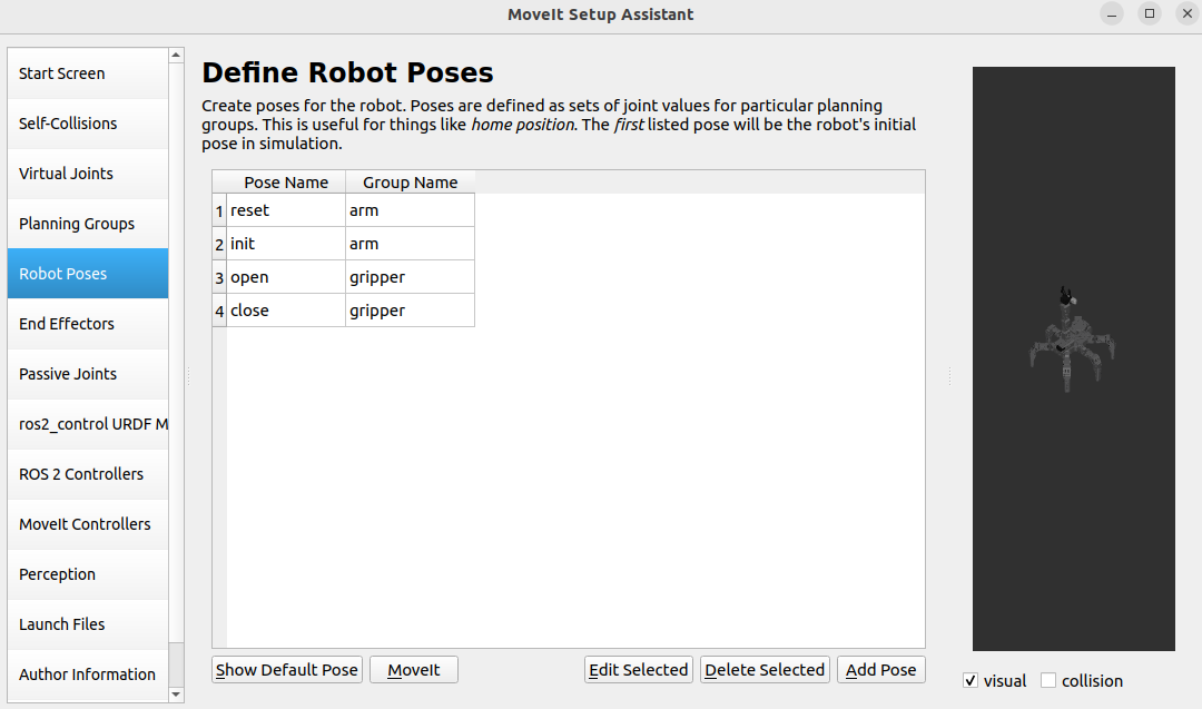

4. Robot Poses
Define robot pose and custom pose names for the robot and specify the joint groups involved in achieving each pose.

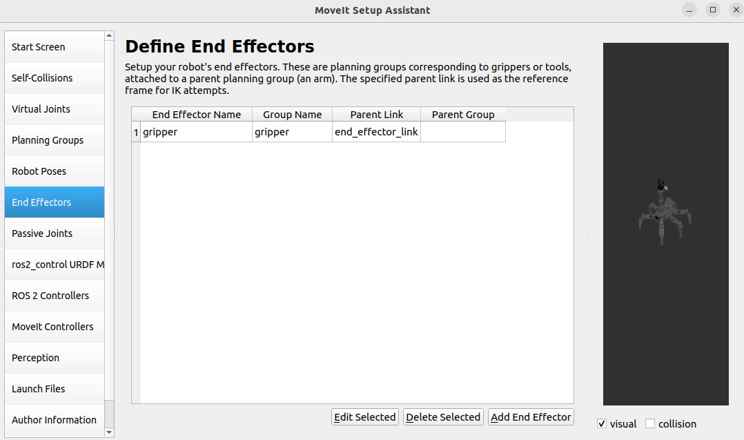

5. End Effectors
End effector, the gripper of the robotic arm.

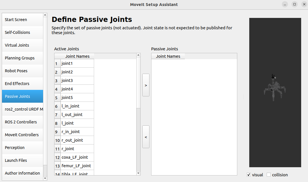

6. Passive Joints
Define unused joints, specify which joints are available and which are disabled.

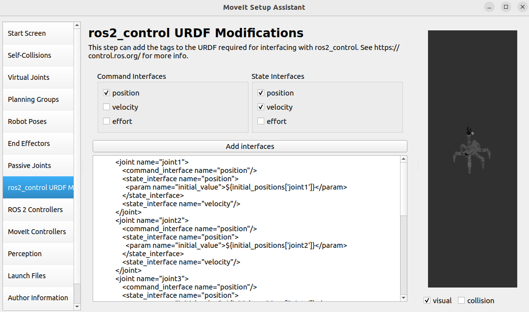

7. ros2_control URDF Modifications
Configure the URDF file required for the simulation.

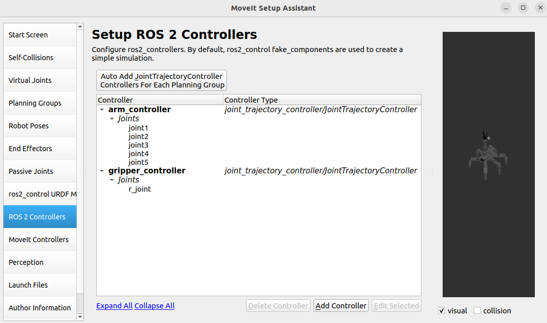

8. ROS2 Controllers
Using the ROS2 Controllers panel, you can add simulated controllers for the joints. This enables MoveIt2 to simulate the motion of the robotic arm.

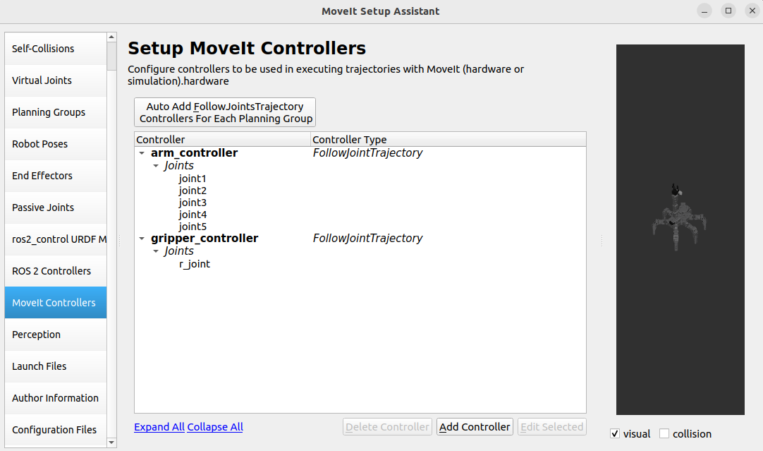

9. MoveIt Controllers
Configure the controller for trajectory execution in MoveIt.

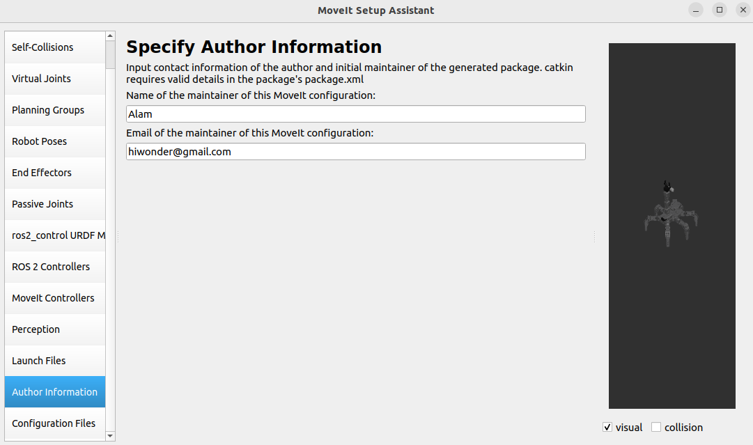

10. Author Information
Provide the author’s details.

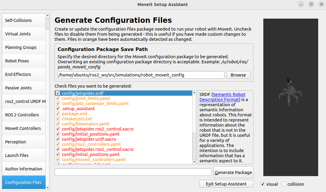

11. Configuration Files
Generate configuration files, after confirming the file path, click Generate Package to generate the configuration package.

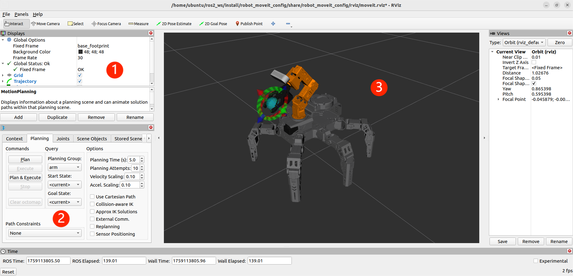

  • Start MoveIt2 Tool
  1. Start a new command-line terminal, and run the following command to launch the MoveIt2 tool.
    ros2 launch robot_moveit_config demo.launch.py
The program interface is shown in the image below:

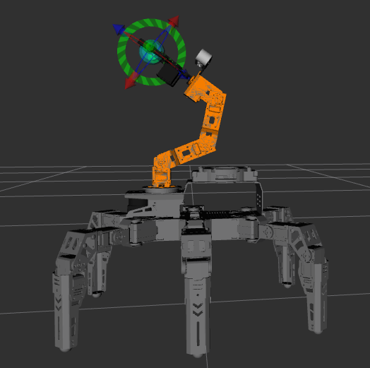

Position 1: RViz Toolbar. Position 2: MoveIt Debugging Area. Position 3: Simulation Model Adjustment Area.
  • Control Instructions

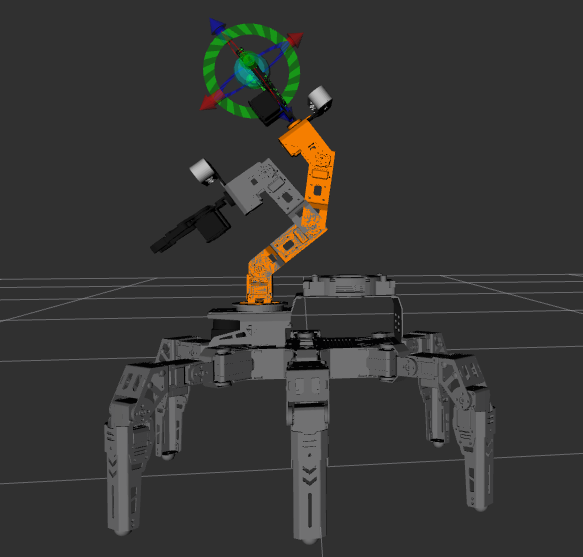

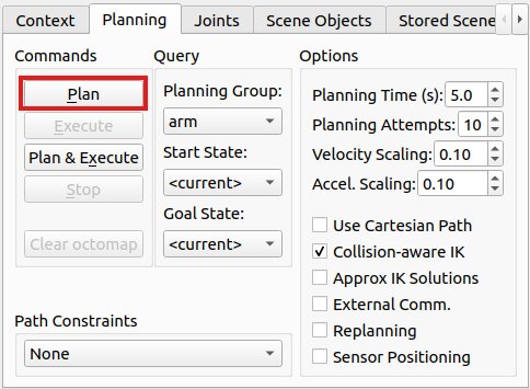

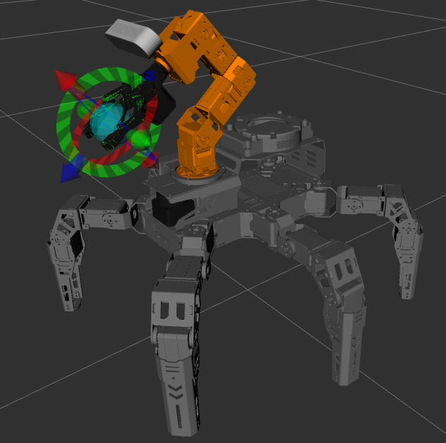

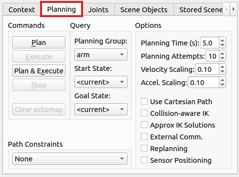

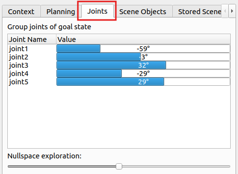

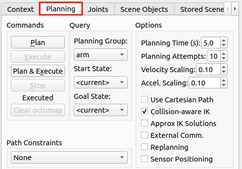

  1. In the MoveIt2 Debugging Area, find and click the Planning section.

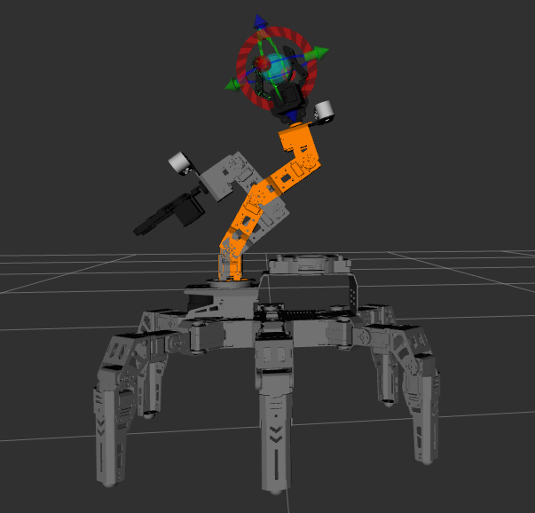

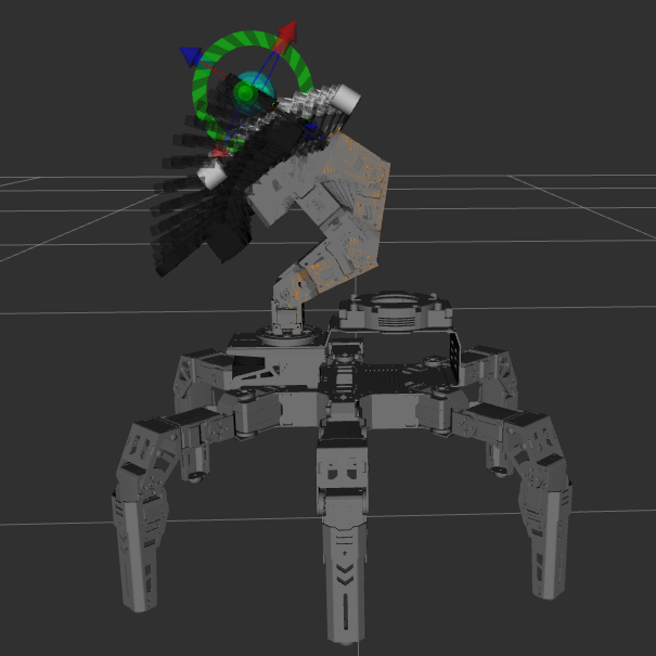

  2. In the Simulation Model Adjustment Area, you will see arrows in red, green, and blue colors. Click and drag the arrows to adjust the robotic arm’s pose. In the robot’s first-person view: Green represents the X-axis, with the positive direction pointing to the robot’s left. Red represents the Y-axis, with the positive direction pointing to the robot’s front. Blue represents the Z-axis, with the positive direction pointing upwards from the robot.

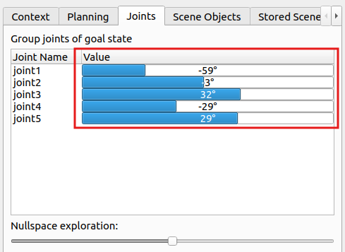

  3. Besides adjusting the pose using the arrows, you can also adjust individual joints directly. Click the triangle icon on the right, then locate and open the Joints panel.
  4. Drag the sliders for the corresponding joints to adjust their angles individually.
  5. After successfully planning the robotic arm’s motion path, the new position will be highlighted in orange. If the new position causes a collision with other parts of the robot, it will be marked in red. You must adjust the configuration to avoid collisions. Otherwise, the motion cannot be executed.
    Orange Executable State is shown in the following image.
For example, if the robotic arm is planned to be in the position shown in the image, it will collide with the depth camera. Turn the state red to non-executable, as shown in the figure below:

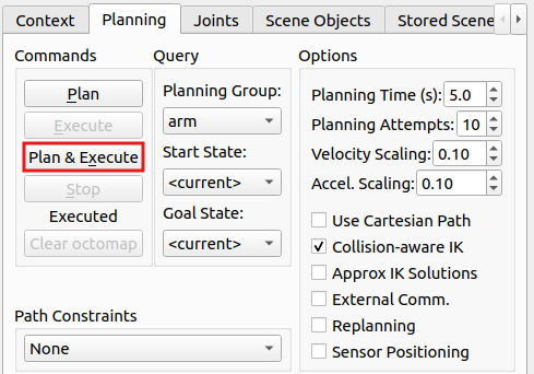

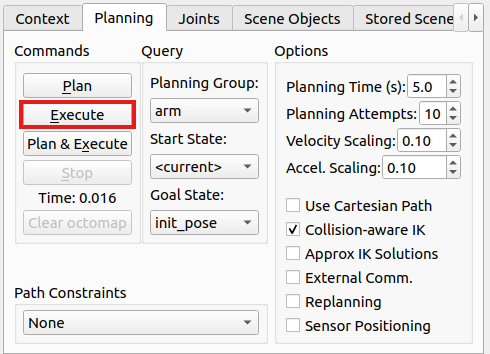

  1. After planning the path, return to the Planning section and click the Plan option. The simulation model will display the motion path from the original position to the newly planned position.
  2. Then, click the Execute option to make both the simulation model and robotic arm follow the planned motion path.
  3. Alternatively, you can click Plan & Execute, where the robotic arm will first display the new planned motion path and then execute the movement.
  1. To exit the feature, press Ctrl+C in the terminal. If the program does not close successfully, try pressing Ctrl + C again.

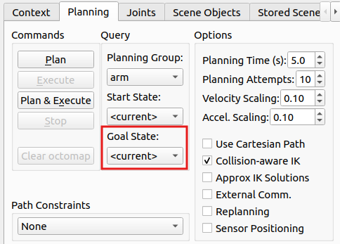

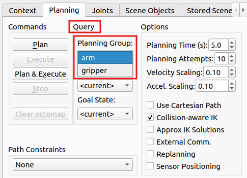

  2. In the simulation model adjustment area, there are arrows in red, green, and blue colors. In the robot’s first-person view: Green represents the X-axis, with the positive direction pointing to the robot’s left. Red represents the Y-axis, with the positive direction pointing to the robot’s front. Blue represents the Z-axis, with the positive direction pointing upwards from the robot.
  3. In the Query category, click the dropdown menu under Planning Group and select the joint group, which is also servo group, you wish to control. For example, the default selection is the arm group.
  4. Click the dropdown menu under Goal State and choose the desired target position.

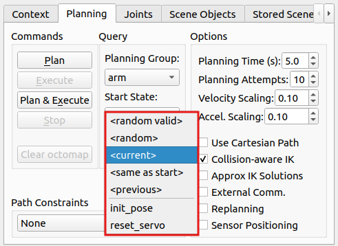

  5. The parameter list in the dropdown menu is as follows:
    The description of the parameters are as follows:
    random valid: A valid random position where no collisions will occur.
    random: A random position that may potentially result in a collision.
    current: The current position.
    same as start: The same as the starting position.
    previous: The previous target position.
    The positions home and p1 are the default preset positions in the program.
  6. To avoid the possibility of collisions, select random valid to randomly generate a valid target position. Each time you click this option, a new target position will be randomly generated and displayed in the simulation model.
  7. Click Plan & Execute, and both the simulation model and robotic arm will perform the motion simultaneously. The simulation model will show the newly planned movement path, and the robotic arm will execute the motion.
  8. To exit the feature, press Ctrl + C in the terminal. If the program does not close successfully, try pressing Ctrl + C again.

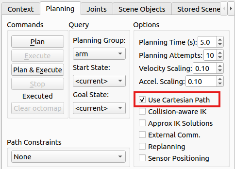

  1. Locate the Planning section, and tick Use Cartesian Path to enable Cartesian path planning.
  2. Next, use the mouse to drag the arrows in the Simulation Model Adjustment Area to plan the robotic arm’s path. In the robot’s first-person view: Green represents the X-axis, with the positive direction pointing to the robot’s left. Red represents the Y-axis, with the positive direction pointing to the robot’s front. Blue represents the Z-axis, with the positive direction pointing upwards from the robot.
  3. Once the planning is complete, click Plan & Execute. The simulation model will execute the action and attempt to linearly move the end effector in Cartesian space. If the action cannot be performed within the Cartesian path constraints, it will display a failure message.
  4. To exit the feature, press Ctrl + C in the terminal. If the program does not close successfully, try pressing Ctrl + C again.

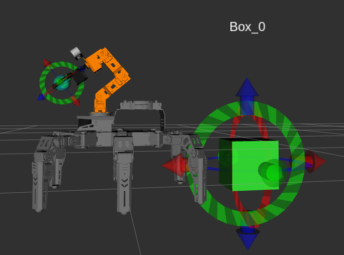

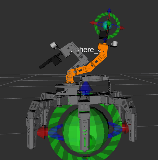

10.4.6 MoveIt2 Collision Detection
  • MoveIt2 Collision Detection Explanation
MoveIt2’s collision detection is a critical feature that uses the robot’s motion planning path and information about surrounding objects to detect potential collisions. This ensures that the robot does not collide with any objects in its environment while performing its movements.

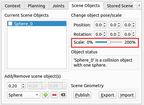

  1. Collision Detection Configuration Overview
In MoveIt2, collision detection is configured using the CollisionWorld object in the planning scene. The collision detection in this configuration primarily uses the FCL (Flexible Collision Library) package, which is a key CC library in MoveIt2.

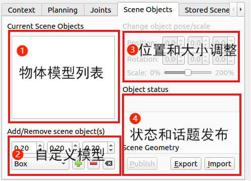

  1. Collision Object Introduction
MoveIt2 supports collision detection for various types of objects, including:
(1) Meshes.
(2) Basic Shapes – such as cuboids, cylinders, cones, spheres, and planes.
(3) Octomap – Octomap objects can be directly used for collision detection.
  1. Allowed Collision Matrix (ACM)
The Allowed Collision Matrix (ACM) encodes a binary value indicating whether collision detection is required between objects, which may be on the robot or in the robot’s environment.
If the value corresponding to two objects in the ACM is set to 1, it means collision detection between these objects is not required. Otherwise, collision detection will be performed.
  1. Collision Detection Steps
(1) Robot Description: First, provide a geometric and kinematic description of the robot, typically using a URDF (Unified Robot Description Format) file to describe the robot’s structure and connectivity. This description includes information about the robot’s joints, links, collision bodies, and sensors.
(2) Environment Modeling: Model the environment surrounding the robot, including the geometric shape and location of obstacles. These obstacles can be either static or dynamic.
(3) Motion Planning: Using MoveIt2’s motion planner, specify the robot’s starting and target poses, and generate the robot’s motion trajectory.
(4) Collision Detection: MoveIt2 will perform collision detection for each pose along the generated trajectory. It uses both the robot model and the environment model to check for potential collisions between the robot and obstacles.
(5) Collision Avoidance: If collisions are detected, MoveIt2 will adjust the robot’s pose or path to avoid them. The system will re-plan the robot’s motion trajectory until it finds a collision-free path.

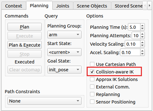

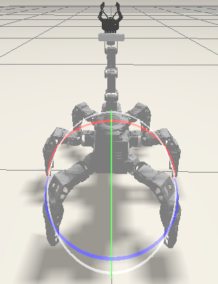

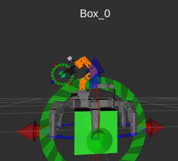

  1. In the Simulation Model Adjustment Area, you will see arrows in red, green, and blue colors. Click and drag the arrows to adjust the robotic arm’s pose. In the robot’s first-person view: Green represents the X-axis, with the positive direction pointing to the robot’s left. Red represents the Y-axis, with the positive direction pointing to the robot’s front. Blue represents the Z-axis, with the positive direction pointing upwards from the robot.

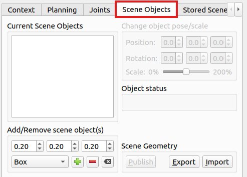

  2. Once the robotic arm’s path is planned, click the Scene Objects section to add a collision model.
  3. The section is divided into 4 areas, as described below:

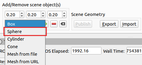

  4. Click the Box dropdown menu and select a collision model. Here, we will use the Sphere model as an example.

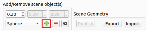

  5. Click the + icon to add the currently selected collision model.
    The model will be placed at the robot’s base by default, as shown in the image below:
  6. Use the slider to adjust the size of the collision model. It is recommended to shrink it to about 50% of the original size.
  7. Drag the 3D arrows on the sphere to move the collision model between the start and target positions to test the collision detection effect.
  8. Click the Planning section and check the Collision-aware IK option to enable the collision detection for the model.
  9. Next, click Plan & Execute to begin moving along the planned path. When the following prompt appears, select Yes.
  10. After confirming, the robot arm will plan the movement path, avoiding any obstacles along the way to prevent collisions.
  11. To exit the feature, press Ctrl+C in the terminal. If the program does not close successfully, try pressing Ctrl + C again.
  1. Open a new command-line terminal, and run the following command to launch the MoveIt2 tool.
  1. The program interface is shown in the image below:
  1. In the debugging area, locate the Scene Objects section to add scene object models.
  1. The section is divided into 4 areas, as described below:
  1. In the Custom Model section, select the required basic model. Here, we use the cube model as an example.
  1. Above the model selection, adjust the initial size of the object model in meters. As shown below:
  1. After adjusting, click the + button to add the currently configured object model to the scene.
  1. Once added, the model list will be updated with the newly added model, which will appear at the center of the scene, which is the robot’s center.
  1. In addition to using arrow dragging, you can also make adjustments in the position and scale adjustment area.
Position: Adjust the object’s position on the X, Y, and Z axes.
Rotation: Adjust the object’s angle along the X, Y, and Z axes.
Scale: Adjust the object’s size by dragging the slider.

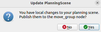

  1. After making adjustments, click Publish to send the model’s topic message. MoveIt2 will automatically subscribe to this message.
  1. To prevent object models from colliding, go to the Planning section and check the Collision-aware IK box to enable collision detection for the model.
  1. Besides adjusting the pose using the arrows, you can also adjust individual joints directly. Find and click the Joints panel.
  1. Drag the sliders for the corresponding joints to adjust their angles individually.
  1. After successfully planning the robotic arm’s motion path, the new position will be highlighted in orange. If the new position causes a collision with other parts of the robot, it will be marked in red. You must adjust the configuration to avoid collisions. Otherwise, the motion cannot be executed.

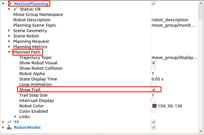

  1. In the RVIZ toolbar, click Motion Planning and Planned Path, then check the Show Trail option. This will display the visual trail of each frame of the robotic arm’s movement.
  1. Return to the Planning section and click the Plan option. The simulation model will display the motion path from the original position to the newly planned position.
  1. After observing the demonstration, uncheck the Show Trail option. Then, click the Execute button. The simulation model and the robot will simultaneously execute the planned motion.
  1. To exit the feature, press Ctrl + C in the terminal. If the program does not close successfully, try pressing Ctrl + C again.

  • The virtual machine and the robot must be on the same network segment and able to communicate with each other in order to control the robot. Otherwise, only simulation is possible, and the robot will not execute the planned movements. Refer to 10.2 Configuration to configure the network for the robot and the virtual machine.

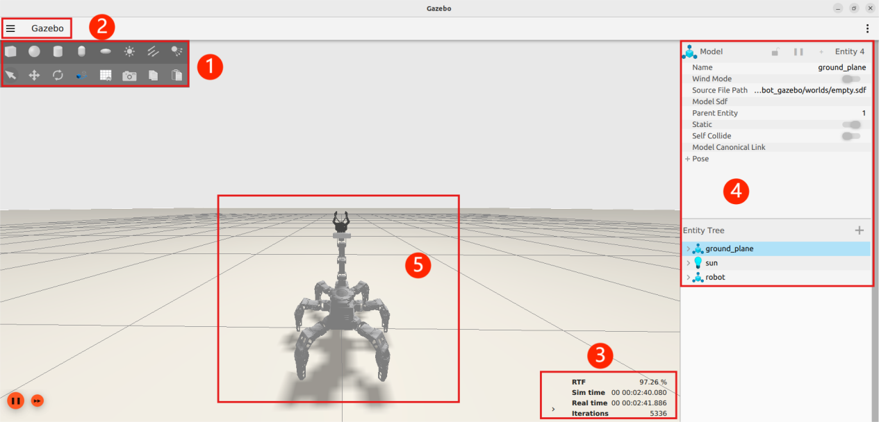

  • Gazebo GUI Introduction
The Gazebo simulation interface is shown below.
The functions of each section are described in the table below:
Name Function
Area 1: Toolbar Provides the most commonly used options for interacting with the simulator.
Area 2: Menu Bar Configures or modifies simulation software parameters, as well as some interactive functions.
Area 3: Timestamp Allows manipulation of time within the virtual space.
Area 4: Action Bar Operates on models and allows parameter modifications.
Area 5: Scene The main area of the simulator where simulation models are displayed.
For more information about Gazebo, please visit the official website: http://gazebosim.org/.

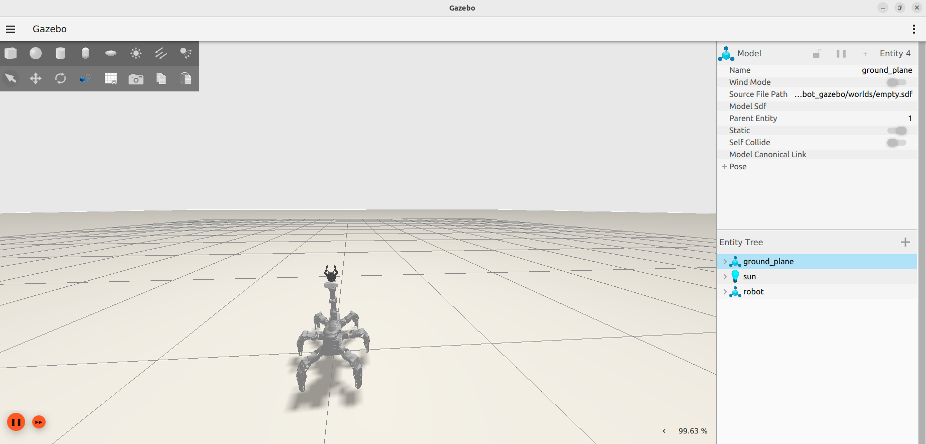

  • Start the Simulation

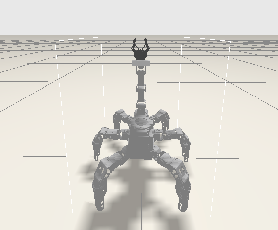

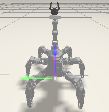

  2. Enter the following command to open the Gazebo simulation model:
ros2 launch robot_gazebo worlds.launch.py
If the interface shown below appears, the tool has launched successfully:
  1. To close the currently running program in the terminal window, press the shortcut Ctrl + C.
  • Introduction to Shortcuts and Tools
This section introduces some commonly used shortcuts and tools in Gazebo, using mouse controls as examples:
Left Mouse Button: In Gazebo simulation, the left mouse button is used for dragging the map and selecting objects. Press and hold the left mouse button on the map to drag it, or click on a model to select it.
Middle Mouse Button or Shift + Left Mouse Button:
Press and hold while moving the mouse to rotate the view around the current target position.
Right Mouse Button or Mouse Wheel: Hold the right mouse button or scroll the wheel to zoom in and out, focusing on the point under the cursor.
For the toolbar tools, the following three will be used as examples for explanation.
1. Selection Tool : The default tool in Gazebo, used to select models.
2. Move Tool : After selecting a model with this tool, drag along the three axes to move the model.
3. Rotate Tool : After selecting a model with this tool, drag along the three axes to rotate the model.
