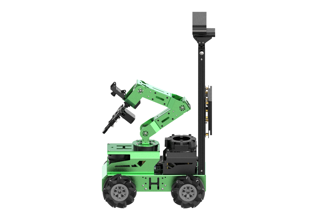

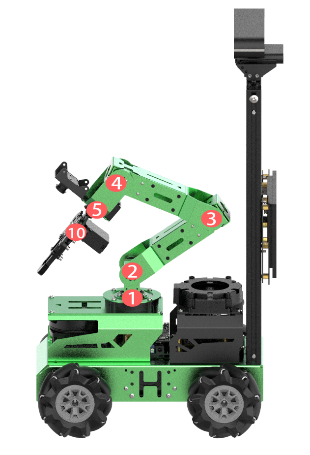

This small vehicle is a 6-degree-of-freedom robotic arm composed of intelligent bus servos and metal sheet metal connections, enabling it to move to any feasible position in space. It consists of six degrees of freedom: X-axis movement, Y-axis movement, Z-axis movement, X-axis rotation, Y-axis rotation, and Z-axis rotation. It performs actions such as extension, rotation, and lifting. Additionally, it is equipped with a monocular camera for tasks such as hand-following, color block recognition and sorting, color block tracking, line patrolling and obstacle clearance, garbage classification, and precise navigation and handling.
The below table illustrates the relevant parameters of the robotic arm:
Name Instruction Name Instruction
Servo Composition HTD-35H*3(robot) + HTS-20H*1(pan-tilt) + HTS-21H*1(gripper)+HX-12H serial bus servo(wrist) Servo Accuracy
HTD-45H bus servos (3 units), HTS-20H bus servo, and HTS-21H bus servo have a precision of 0.2°;
HX-12H bus servo has a precision of 0.3°
Material Anodized aluminium alloy Control Method UART serial port command
Degree of Freedom 6DOF Communication Baud Rate 115200
Load 500g (gripping and transporting weight) Servo Memory User settings Power-off protection
Wingspan 410mm Read-back Function Support angle value read-back
Effective Gripping Range Radius≤30cm Servo Protection Locked protection/ over-heat protection
Camera Name GC0308 HD camera Parameter feedback Temperature, voltage, position
Pixel 2 megapixel System Support windows, Linux and Openwrt
Resolution 1920×1080 Frame Rate 60FPS
Connection USB driver-free Focusing Method Auto-focusing
  • Prior to shipment, our company has completed the debugging of the robotic arm, eliminating the need for users to adjust.
  • This instruction facilitates users in restoring the robotic arm’s status after make modification.

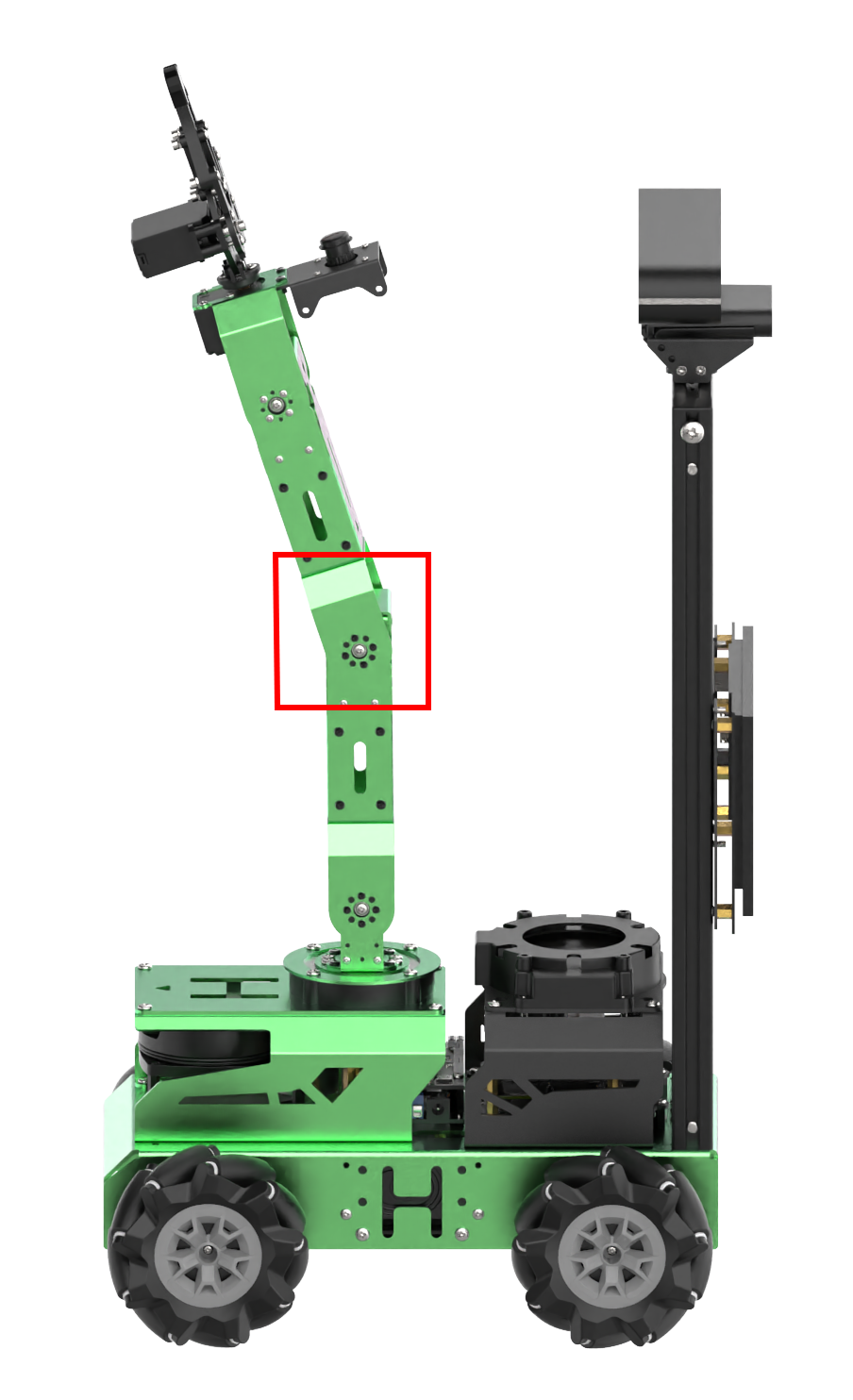

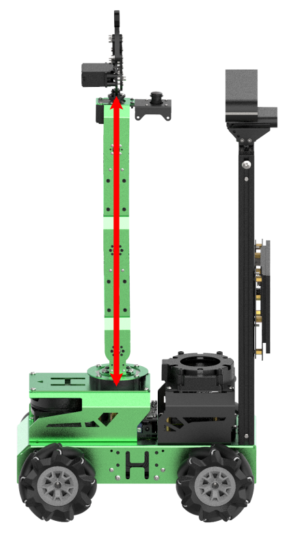

  • The robotic arm is equipped with 6 joints, where the first joint controls the overall horizontal rotation of the robotic arm. During adjustment, it should be ensured that the robotic arm faces forward in relation to the vehicle, avoiding left or right deviation as much as possible.
  • Whether there is deviation in the robotic arm servo can be referenced from the side view and top view diagrams provided in this document.

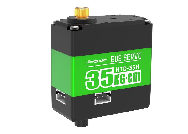

The servo is the main control component of the robotic arm in this product. We primarily use the HTD-35H serial bus servo, a commonly used serial bus servo controlled via serial commands at a baud rate of 115200. Users can control the servo’s rotation or read its information by sending corresponding commands according to our communication protocol. Before controlling the servo, it’s necessary to set its parameters and ID.
This servo features a half-duplex UART asynchronous serial interface, where the signal line can both transmit and receive signals. Depending on the ID, different commands can be sent via the serial port to independently control the servo. Widely applied, this servo is primarily used in joint designs for various types of biomimetic robots.

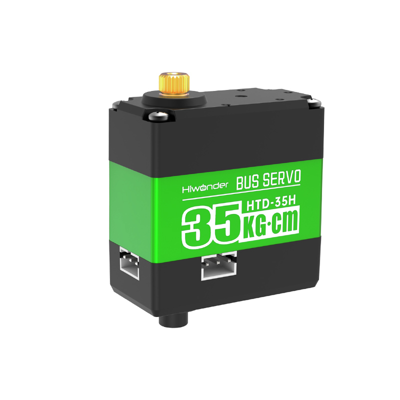

  • Structure & Specification Parameters

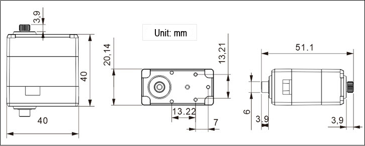

The structural dimensions of the HTD-35H bus serial servo are shown in the figure below:
Operating Voltage DC 9-12.6V
Rotation Speed 0.18sec/60°(DC 11.1V)
Torque 35kg.cm(DC 11.1V)
Static Maximum Torque 35kg.cm(DC 11.1V)
Rotation Range 0~ 240°
No-load Current 100mA
Stall Current 3A
Servo Accuracy 0.2°
Control Angle Range 0-1000, corresponding to 0~ 240°
Control Method UART serial command
Communication Baud Rate 115200 Baud Rate
Storage Capacity Power-off User Settings Retention
Servo ID User-configurable from 0-253, default is 1
Feedback Function Supports Angle Feedback
Protection Function Stall Protection/Overheat Protection
Parameter Feedback Temperature, Voltage, and Position Feedback
Operating Mode Servo Mode and Gear Motor Mode
Gear Type Metal Gears
Wire Length 20cm, other lengths available
Plug Model PH2.0-3P Plug
Product Weight 64g
Size 54.38mm*20.14mm*45.5mm
Applicable to Various bionic robot joints

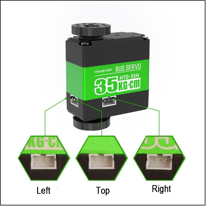

  • Installation

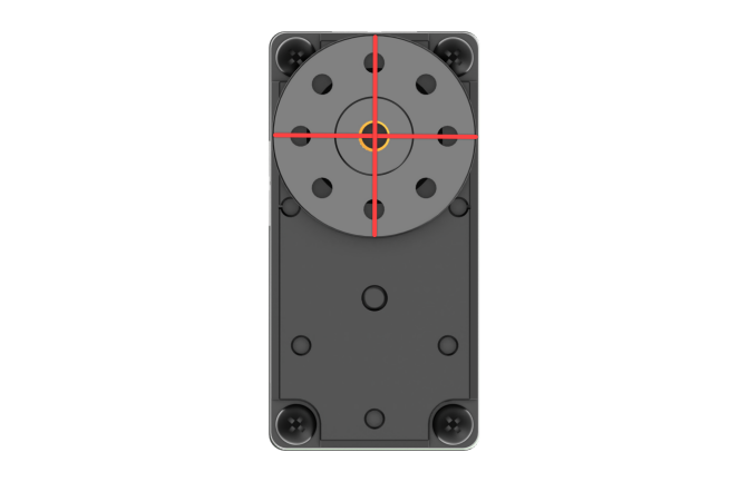

Servo horn aims red “+” to install, please refer to the following picture.
The interface distribution and instruction refer to the below diagram and table:
PIN PIN Instruction
GND GND
VIN Power input
SIG Signal terminal, half-duplex UART asynchronous serial interface

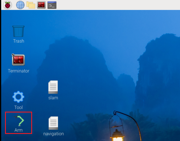

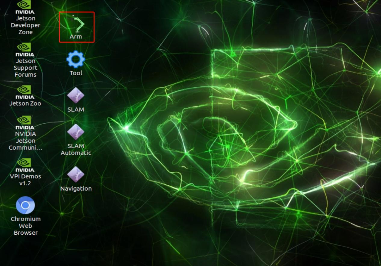

(1) Open through Robotic Icon
① Double-click to open the command line terminal. To adjust the deviation and the position of the robotic arm, first stop the app’s auto-start service.
② Click-on to launch the PC software.

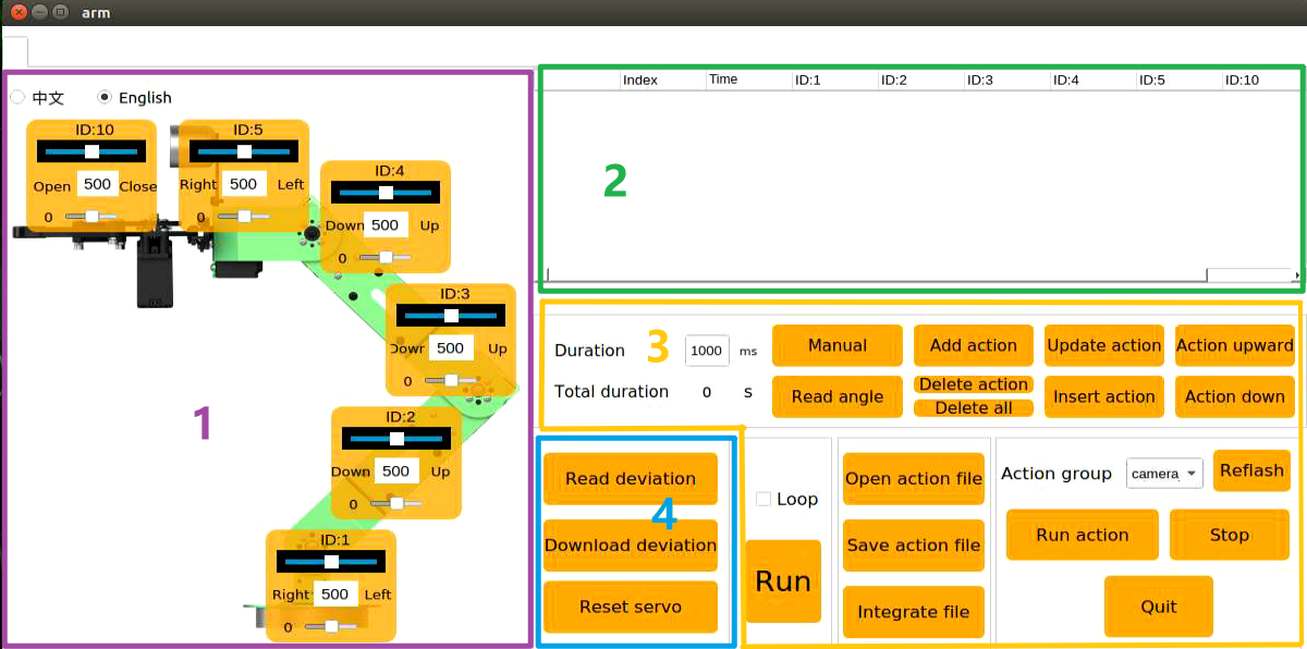

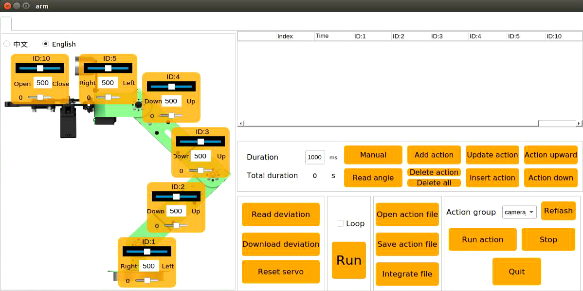

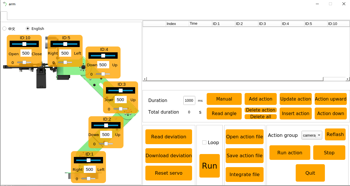

(3) PC Software Interface Layout
The interface under “normal mode” is as follow.
You can switch to “Servo Debug Tool” through the options on the upper left corner. Prior to the shipment, all the robots have been debugged, eliminating the need for the user to debug. If any issues require the use of this tool, it is mandatory to operate under the guidance of our support team, as improper use may result in robotic arm malfunctions.
The interface of the normal mode is divided into below areas:

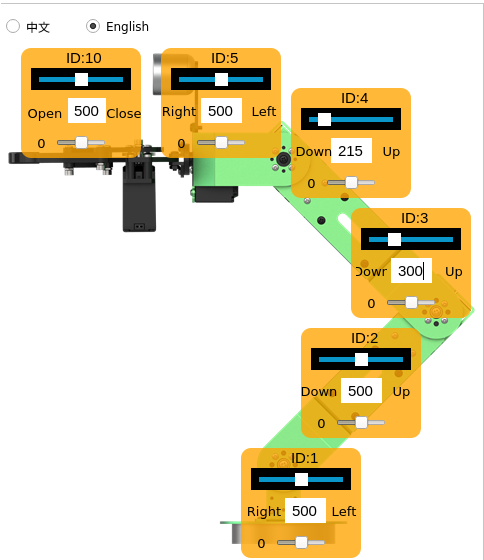

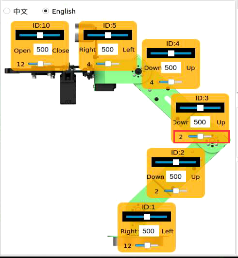

①:Servo control area
Servo control area displays the icon of the selected servo. You can adjust the servo value by dragging the corresponding slider.
Icon Function
ID number of servo
Adjust servo position from 0 to 1000.
Adjust servo deviation from -125 to 125.
After setting the robot's position and orientation information for x, y, z, and pitch, execute the movement.
②:Action list
The running time and servo data of the current action are displayed on the action list.
Icon Function
Action group number
Running time of the action that is time taken to complete this action
Servo value. Double click the figure below to revise.
③: Action group setting
Icon Function
Action running duration time. Directly click to modify.
Total running time taking for all the actions in an action group
If you click this button, joints of robot become loose, and you can drag servos to design any posture
Read the servo angle you have designed before. This button should be used with
Add the servo value as a action to the last line of the action list
Delete action: delete the action selected in the action list
Delete all: delete all the action in action list
Replace the angle value of the action selected in the action list with the servo value in the servo control area. And update the running time as the time set in "Time"
Insert a new action above the selected action. The running time of this new action is the time set in "Time" and angle value is the current value in servo control area.
Move the selected action up one line
Move the selected action down one line
Click to run all the actions on the action list once
(If "Loop" is ticked, JetAuto Pro will repeat the action.)
Load the data of the saved action group to the action list
Save the current actions in the action list into the designated path.

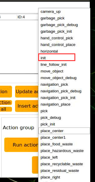

Firstly, open one action group, then click this button, and then open other action group. And these two action groups will be integrated into one.
Display the saved action groups. You can select the action to run.
Refresh action group drop-down menu.
Run the selected action group once.
Stop running the action group.
Exit PC software interface

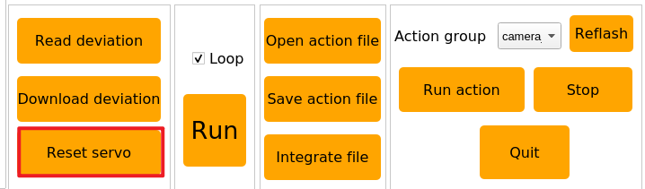

④:Servo deviation setting area
Icon Function
Click to read the saved servo deviation.
Click to download the adjusted deviation to the robot.
Click to return all the servos to the mid point(500).

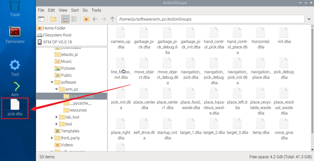

8.1.4 Action Calling
  • What is “Action Calling”?
Action calling is to directly call the edited action group via PC software to let robot perform this action.

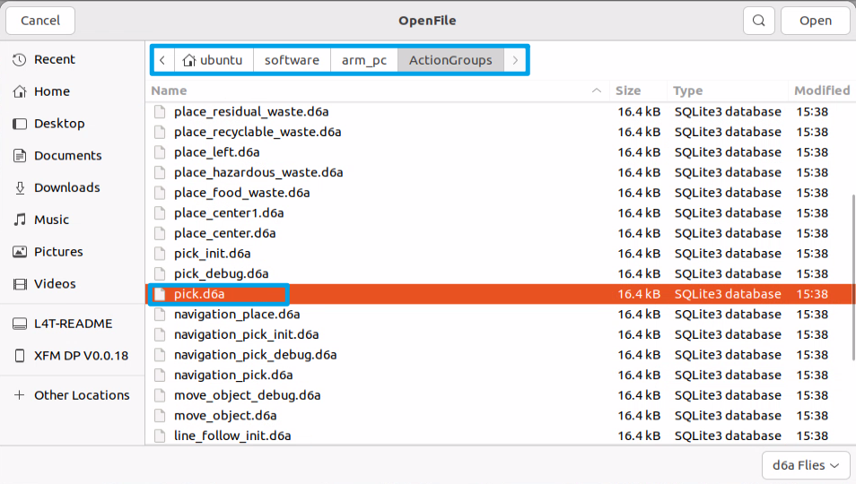

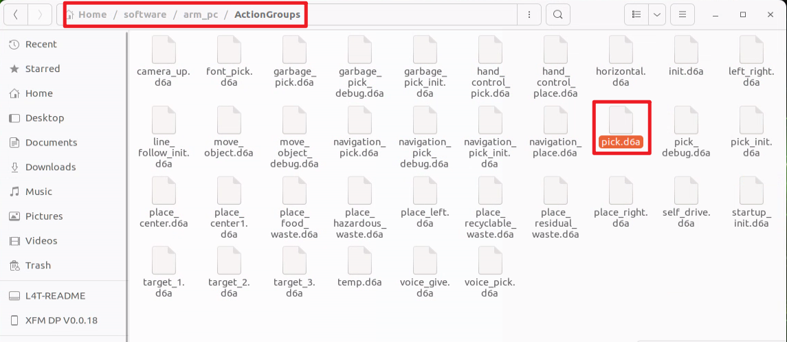

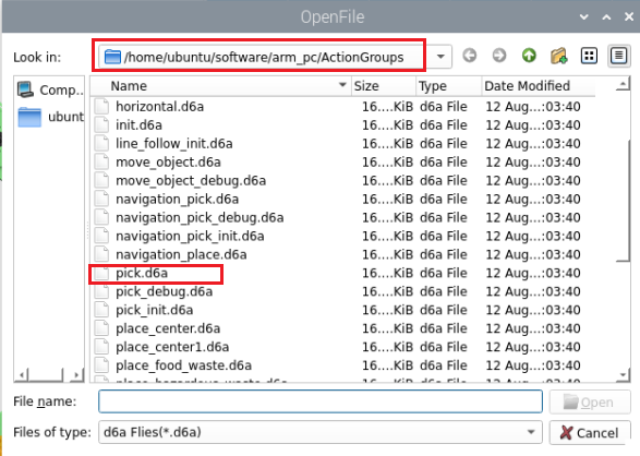

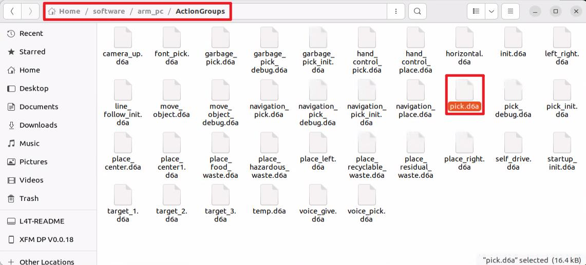

JetAuto has built-in action groups, and its action group files are stored in “ubuntu/software/arm_pc/ActionGroups”. You can check and call built-in actions via PC software or command.
The specific operation steps are as follow:

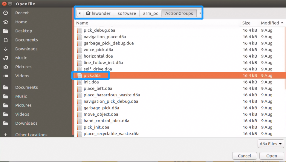

Only if action files are saved in “ubuntu/software/arm_pc/ActionGroups”, can the files be called.
  • Operation Steps

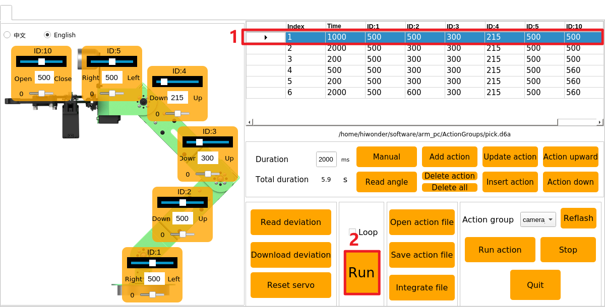

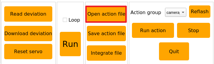

(1) Double click to enter PC software interface.
(2) Click “Open action file” button.
(3) Select action group you want, then click “Open”.

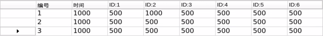

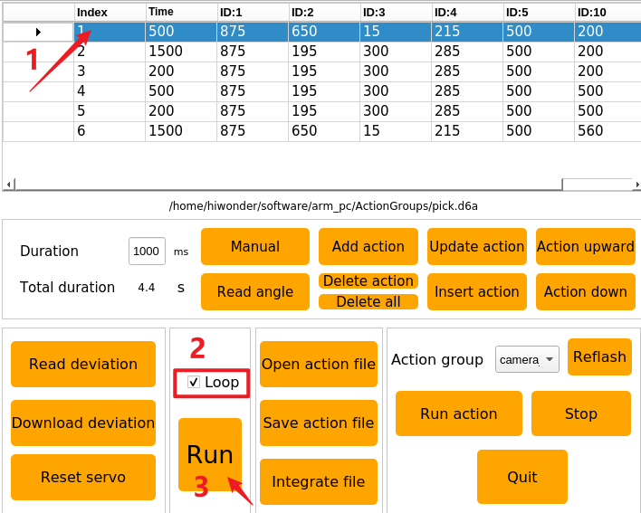

(4) Running time of each action and servo values are displayed on the action list

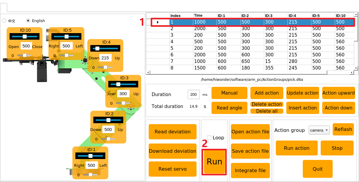

(5) You can first select number “1” and click “Run” button to run the selected action in action list. If you want to make robot repeat this action group, you can tick “Loop” and click “Run”.

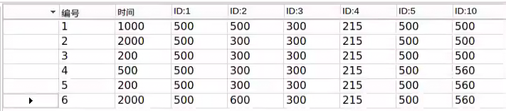

(1) Design Action

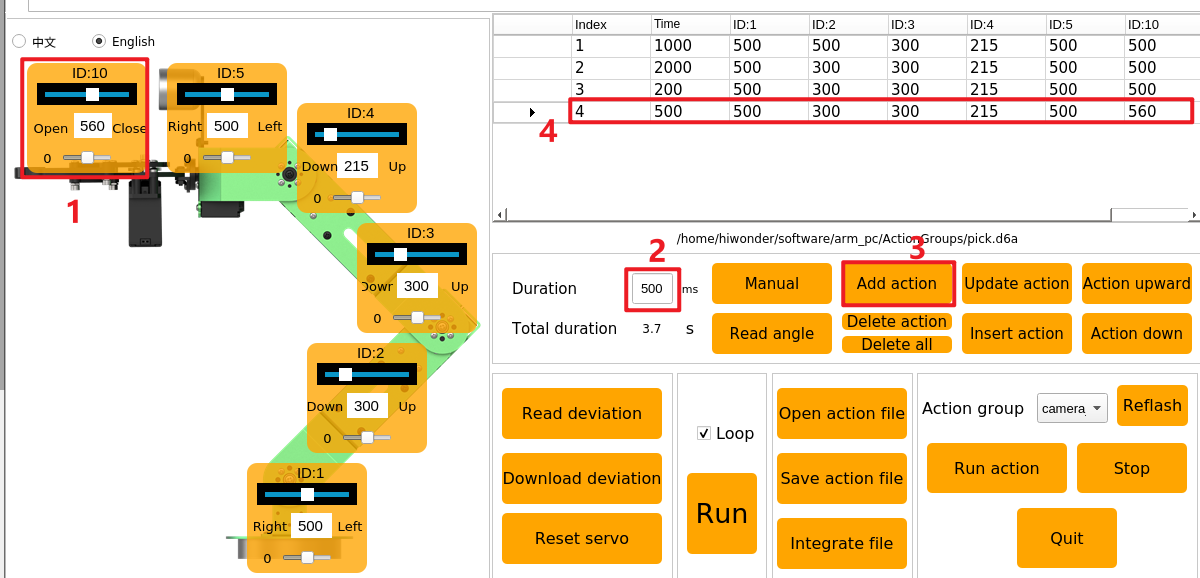

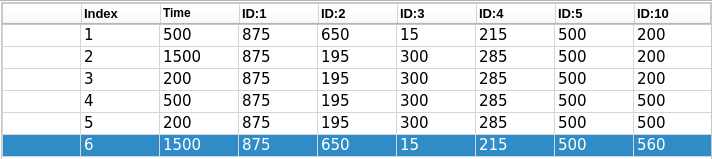

① Double-click to open the normal mode of the upper computer editing interface.
② Click “Reset servo” to make servo return back to mid-point.

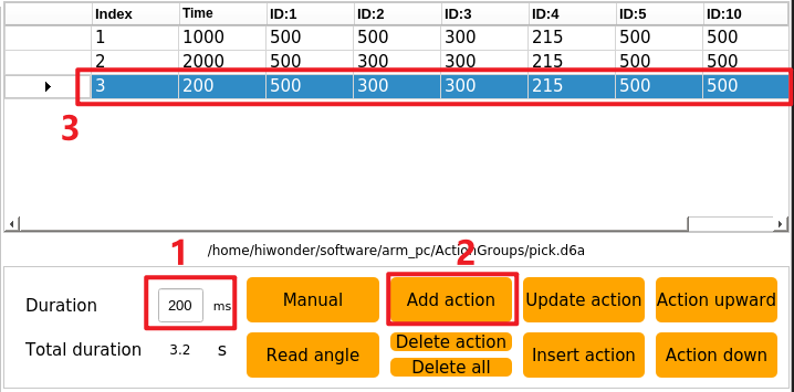

③ Drag the slider to set servo values as pictured to make robot arm bend to left.

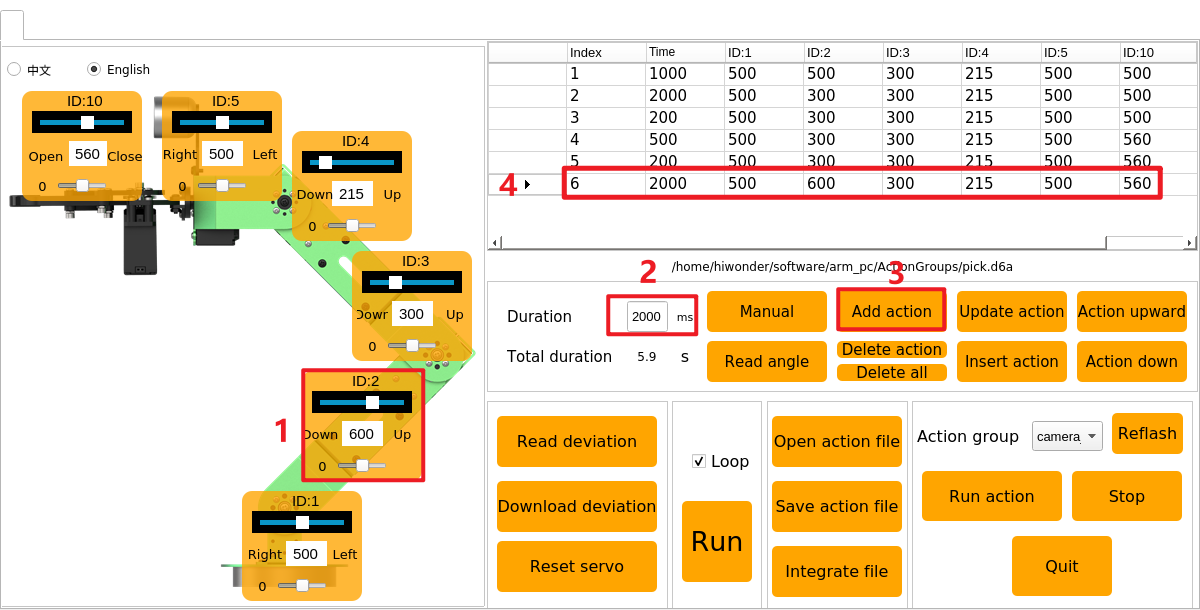

④ Click “Add Action” to add current action to action list.
⑤ Align robot arm with the block. Adjust value of corresponding servos as follow.

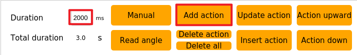

⑥ Set the time as “2000ms”. Click “Add Action” to update NO.2 action.
⑦ Add another transitional action. Set the time as 200ms and click “Add Action”.

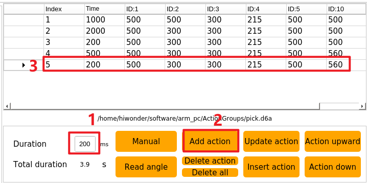

⑧ Adjust NO.10 servo to let robot arm pick the block. Set times as 500ms, then click “Add Action
⑨ Add a transitional action again. Set the time as “200ms”, and click “Add action” to form NO.5 action.

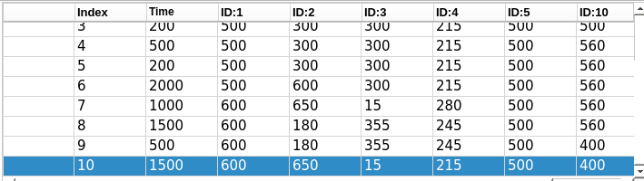

⑩ Adjust servo value to make robot arm pick the block to specific height. Set the time as 2000 ms, and click “Add action”.
⑪ After NO.6 action is edited, action group of “picking block at left” is complete.
⑫ Next, let robot arm run the whole action group. Select NO.1 action, then click “Run”. If you want to repeat this action, tick “Loop” box.

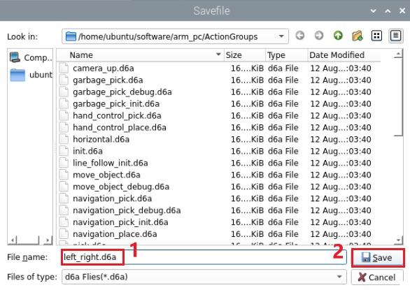

(2) Save Action
The name of action group cannot contain “Space”, otherwise the file cannot be saved in later debugging.
In case of future debugging and management, save the edited action group. Click “Save action file” and select this path, ubuntu/software/arm_pc/ActionGroups.
Here takes the name of “font_pick” as example, and then click “Save” to save the action group.

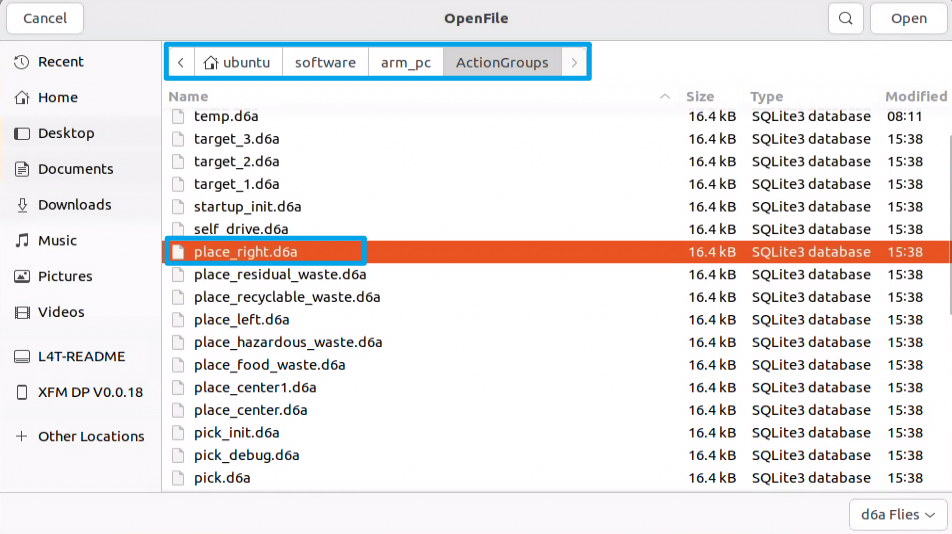

(1) Double-click to open the editing interface in normal mode.

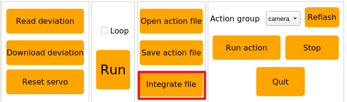

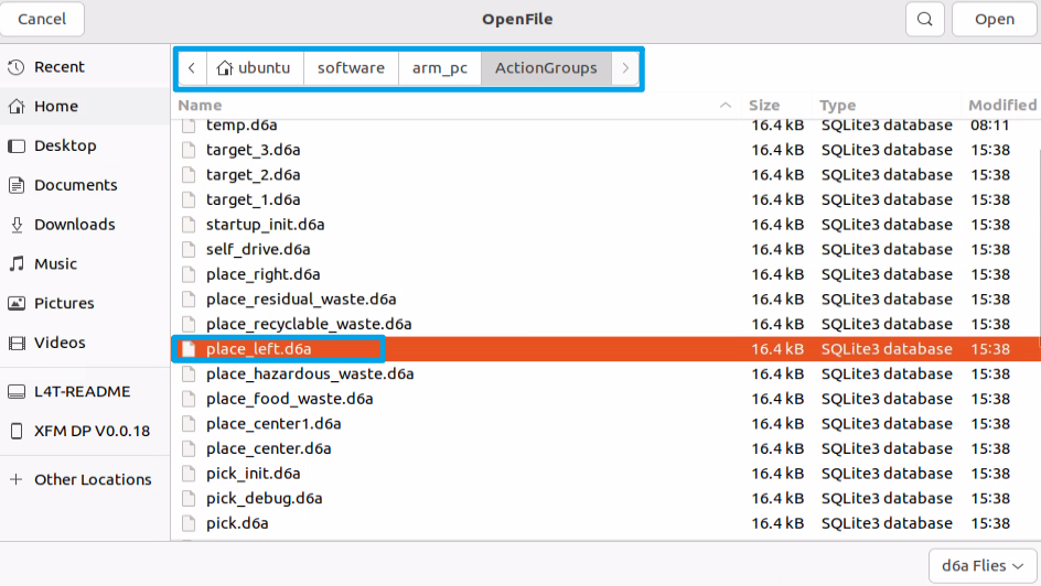

(2) Click “Integrate file” button, and select the following path.
(3) Select and open “place_left.d6a” on the pop-up window.
(4) This action group is added to the action list.
(5) Click “Integrate action files” button again. Select and open “place_right.d6a”. After that, this action group is added to the end of the first action group.
(6) Click NO.1 action, then click “Run” to let robot arm perform this integrated action.
(7) Click “Save action files” button to save this new action group in case of future debugging.
(8) Name this new action group, for example “left_right”.

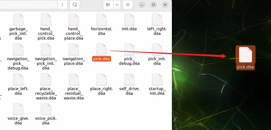

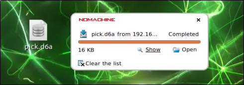

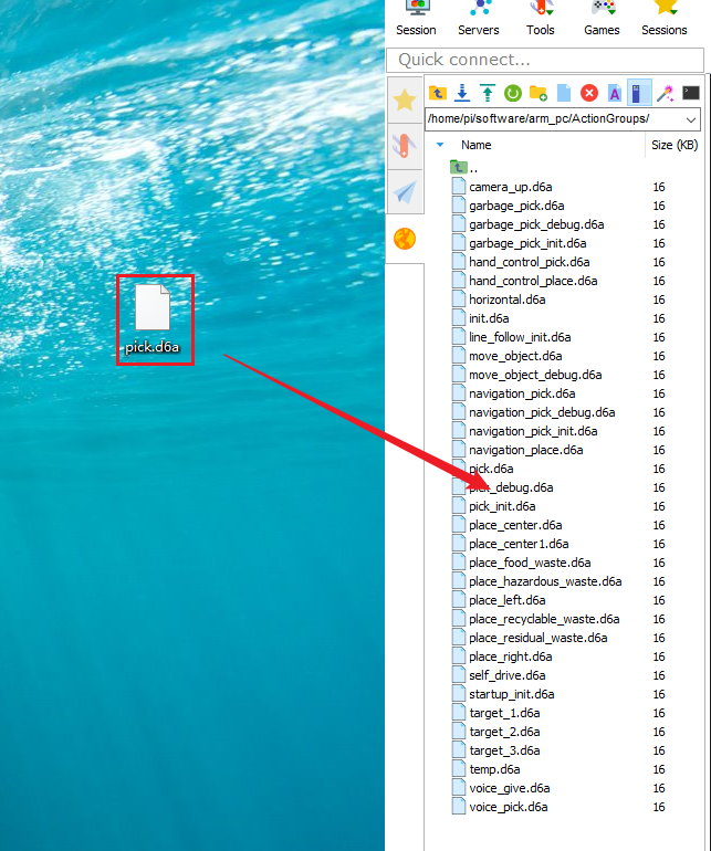

8.1.7 Export and Import Action Files
  • Introduction
This section explains how to export action group files edited on the PC software and import them into similar devices. This allows you to transfer action files between different devices.

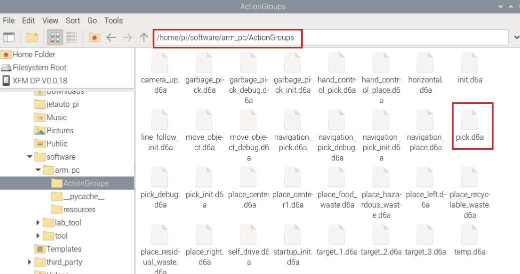

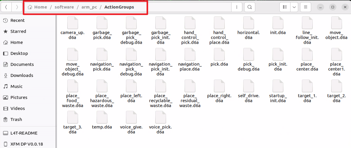

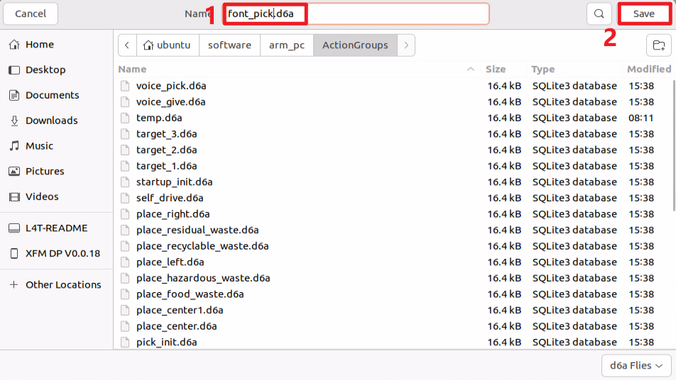

  • Export Action
This section illustrates the export and import of the “pick.d6a” action group file as an example.
(1) Click
(2) Find “pick.d6a” file.
(3) Directly drag the action file to the computer desktop to export this file.
  • Import Action
Importing and exporting actions follow the same steps: simply drag and drop the action group file into the designated path.
(1) Drag and drop the ‘pick.d6a’ action group file onto your desktop.
(2) Use the SSH remote connection tool MobaXterm to drag and drop or copy and paste the ‘pick.d6a’ file into the specified directory. For detailed instructions on using MobaXterm, please refer to 1. Quick Start Guide(JetAuto User Manual)/1.6 Development Environment Setup and Configuration.
(3) Double click to enter PC software interface.
(4) Click “Open action files” button. Find the file you just import, and open it.
(5) Next, select the action group you want to execute from the list, and then click ‘Open’.
Or directly select the imported action group in this drop-down menu.
(6) Click “Run” button to let robot arm execute this action group.

This car features a 6-degree-of-freedom robotic arm, constructed with intelligent bus servos and metal sheet components, allowing it to move to any position within its operational space. It has six degrees of freedom: X movement, Y movement, Z movement, X rotation, Y rotation, and Z rotation, enabling it to perform actions such as extension, rotation, and lifting. Additionally, it is equipped with a camera that can be used in conjunction with the robotic arm for various functions, including hand-following color block recognition and sorting, color tracking, line-following obstacle clearance, waste sorting, and fixed-point navigation and transport.
zhi.2 wan.3
The robot arm features 6-degree-of-freedom, composed of intelligent bus servos and metal sheet components.
The robot’s 6-degree-of-freedom robotic arm consists of six intelligent bus servos: HTD-35H*3 (body), HTS-20H*1 (pan-tilt), HTS-21H*1 (claw), and HX-12H bus servo (wrist).
The bus servos use serial communication to connect multiple servos through a single bus control system. This allows multiple servos to be connected through a single I/O port, providing higher precision compared to digital servos, albeit at a slightly higher cost.
The interface distribution and description are exemplified by one of the HTD-35H servos, as shown below:
PIN Description
GND Power Ground
VIN Power Input
SIG Signal End (Half-Duplex UART Asynchronous Serial Interface)

  • Adjustment Standard
Before adjusting the servo offsets, it’s important to understand and identify the function of each servo on the robotic arm, specifically their ID numbers, which will be used during the adjustment process.
Servo 1 controls the gimbal, servos 2, 3, and 4 control the robotic arm joints, servo 5 controls the wrist, and servo 10 controls the gripper. Altogether, six servos manage the robotic arm’s movements. Over time, these servos may develop slight offsets, so they should be adjusted according to the standard center positions of the robotic arm.
When adjusting servo offsets, refer to the standard adjustment diagram. The robotic arm can only be considered correctly calibrated if both of the following conditions are met:
Standard (1): Servos 1, 2, 3, 4, and 5 on the robotic arm should be aligned horizontally and vertically relative to the chassis when in the neutral position. As shown in the diagram, the servos are positioned on the central servo plate, and the reference line connecting the screws in the center of the servo plate should pass vertically through these servos.

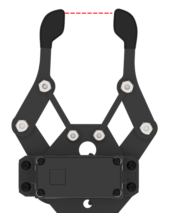

Standard 2: The claw on the robotic arm must maintain an opening distance of 2-3 cm (this represents the mid-position standard for the claw servo). This can be measured using two fingers (index and middle), which should fit snugly within the gap.

(3) Double-click the “arm” icon on the desktop to enter the interface of the robotic arm’s PC software, as shown in the following image:
For details about the interface and related content of the “arm” software, please refer to the “Basic Control” document. This document focuses specifically on adjusting servo deviations.

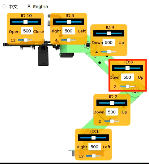

(4) Clicking the “Reset Servo” button, it was found that Servo 3 of the robotic arm has a deviation.
(5) Click the “Read Deviation” button to obtain the current deviation values for the servos installed on the robotic arm.
(6) After the “Read Deviation Successful” popup appears, click the “OK” button.
(7) Check the deviation value for Servo ID: 3, as shown in the diagram below. In this diagram, each servo is identified by its respective ID number. The slider above indicates the current position, the middle number displays its position value, and the bottom slider represents the set deviation value for the servo.
IMG_256
(8) You can see that the deviation value for Servo ID: 3 is -18. When Servo 3 has such a deviation, adjustment should be made in the opposite direction until it reaches the “Standard (1)” state specified in the “8.2.2 Adjustment Steps->Adjustment Standard.”
Now you can see that the deviation value for Servo ID: 3 has been adjusted to “2”, bringing the robotic arm’s status to the “Standard (1)” state as specified in the “8.2.2 Adjustment Steps->Adjustment Standard”. This completes the setting for adjusting the deviation of Servo 3. Next, you need to save the current value to the local computer of the robot. After the robot is restarted, it will use these saved values for servo control. The procedure for reading other servo IDs is the same.
(9) Click-on ‘Download Deviation’ button.
(10) Wait for the prompt “Download Deviation Successful” to appear, then click “OK” to exit the window.
This completes the adjustment of Servo 3’s deviation.
(11) When we need the robotic arm to return to its initial state, we can select “camera” within the action group range.
(12) Choose ‘init’.
(13) Click “Execute Action” to have the robotic arm perform the “init” action group.
After clicking, the robot’s status is as shown in the following image:
After completing the above steps, Servo 3 of the robot’s arm has been adjusted. If other bus servos on the robot show deviations that do not meet the judgment criteria, you will need to repeat the 2.2 adjustment steps to adjust the corresponding servo deviations. It is important to note that during adjustment, you should adjust the lower slider and then download the deviation for it to take effect. The specific position is indicated by the green box in the following image:

(1) When adjusting the position of the gripper, I found that no matter how much I adjusted it beyond a certain point, the gripper on the robotic arm did not respond?
Ans:Our company has implemented mechanical limits on the gripper of the robotic arm, specifically Servo 10 corresponding to the mechanical gripper. When the position set through the PC software exceeds 700, it reaches the mechanical limit of the gripper, preventing it from further tightening. Exceeding this limit may risk damaging the servo. In such cases, simply adjust in the opposite direction.
It is recommended to adjust Servo 10 within the range of [200, 700] during this adjustment.

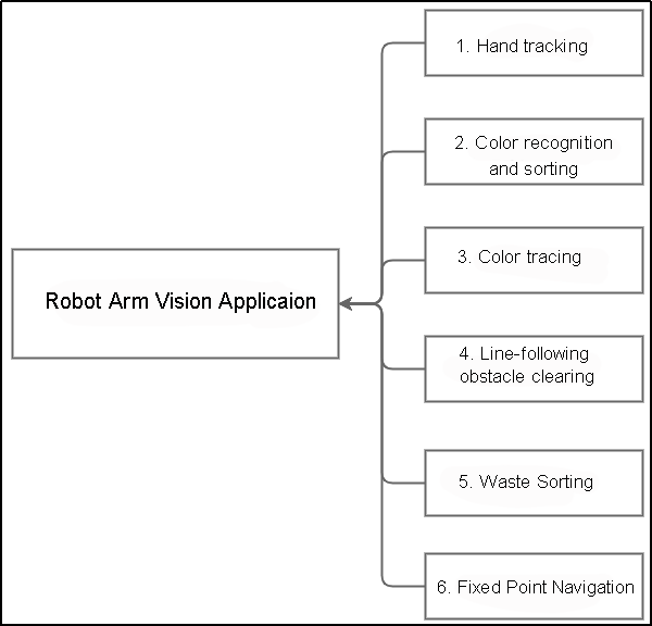

8.3 Vision Application
8.3.1 Application Overview
The diagram above illustrates the structure of “Robotic Arm Vision Applications” functionality, including hand tracking, color recognition and sorting, color tracking, line-following clearance, waste sorting, navigation and transportation. The following content will be written based on this diagram.

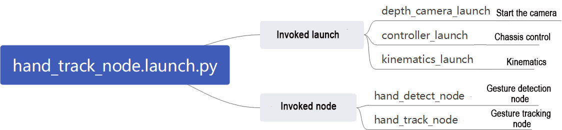

(1) Launch Analysis:
The program is saved in: ros2_ws/src/example/example/hand_track/hand_track_node.launch.py
 2
from launch.conditions import IfCondition, UnlessCondition
from launch.actions import IncludeLaunchDescription, OpaqueFunction, GroupAction, DeclareLaunchArgument
def launch_setup(context):
    use_depth_cam = LaunchConfiguration('use_depth_cam', default='true')
    use_depth_cam_arg = DeclareLaunchArgument('use_depth_cam', default_value=use_depth_cam)
    if compiled == 'True':
        kinematics_package_path = get_package_share_directory('kinematics')
        kinematics_package_path = '/home/ubuntu/ros2_ws/src/driver/kinematics'
① Read the package path
Read the paths of the peripherals, controller, and kinematics packages.
② Initiate other Launch files
depth_camera_launch: Used to initiate the depth camera.
usb_cam.launch.py : Used to initiate the Monocular camera.
controller_launch: Used to initiate base control, servo control, etc.
kinematics_launch: Used to initiate kinematic algorithms.

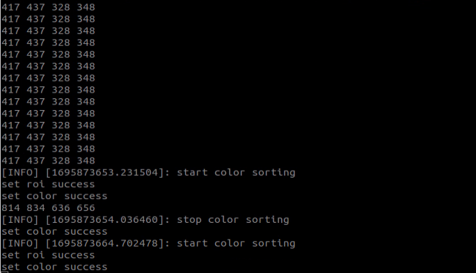

(4) Input the command and press Enter to start the program.
ros2 launch example color_sorting_node.launch.py

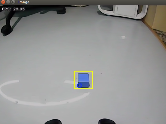

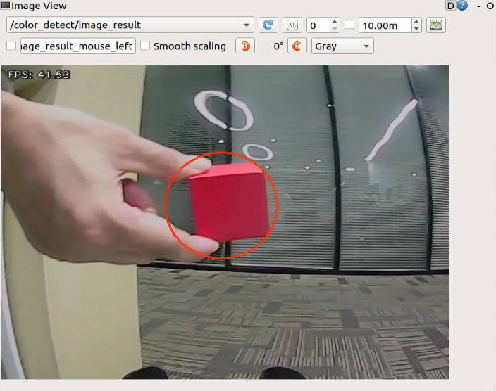

(5) The image interface of the camera when the program starts is as follows.
(6) To exit this mode, press ‘Ctrl+C’ in the terminal. If that doesn’t work, open a new terminal and run the command to stop all active ROS processes.
  • Outcome
After activating the mode, the robotic arm turns to its left and enters a standby state, ready for sorting. The screen will show a live feed with a prominent yellow box in the center, marking the area where blocks should be placed for sorting. Simply position the block within this yellow box, and the robot will start identifying and picking it up.
The robotic arm will then handle the blocks as follows:
Red block: Moves it to the center directly in front of the robot.
Green block: Places it slightly to the left in front of the robot.
Blue block: Moves it to the right in front of the robot.

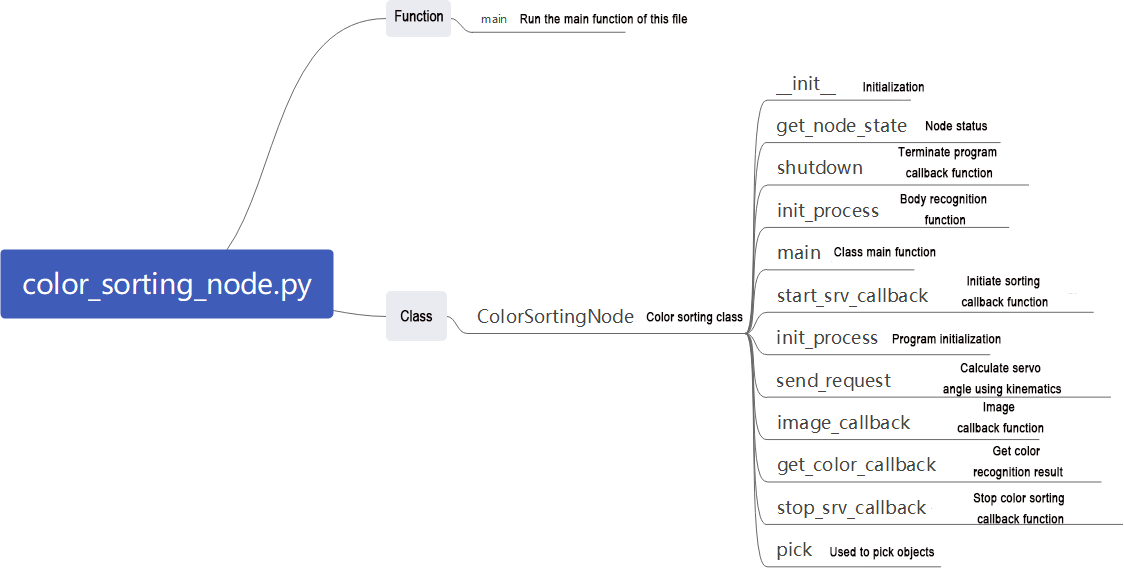

(2) Code analysis:
Program path:ros2_ws/src/example/example/color_sorting/color_sorting_node.py
① Main Function
233
234
235
236
237
238
def main():
    node = ColorSortingNode('color_sorting')
    executor.add_node(node)
    executor.spin()
    node.destroy_node()
The main function calls the hand recognition class to start the node.
② ColorSortingNode
init_process:
70
71
72
73
74
75
76
77
78
79
    def init_process(self):
        self.timer.cancel()
        if self.debug:
            self.pick_roi = [20, 460, 20, 620]
            self.controller.run_action('pick_debug')
            time.sleep(5)
            self.controller.run_action('pick_init')
            time.sleep(2)
        threading.Thread(target=self.pick, daemon=True).start()
Initializes arm movements and starts the pick function and main function in multiple threads, then publishes the current node state.
get_node_state:
81
82
83
        response.success = True
        return response
Works in conjunction with init_process to initialize the node state.
shutdown:
85
86
        self.running = False
Callback function to shut down the program; sets the running parameter to false and terminates the program.
send_request:
88
89
90
91
92
        while rclpy.ok():
                return future.result()
Publishes the recognized hand position to the kinematics node and receives servo angle feedback from kinematics.
start_srv_callback:
 94
 95
 96
 97
 98
 99
100
101
102
103
104
105
106
107
108
109
110
111
112
113
114
115
116
117
118
119
120
121
122
123
124
125
126
127
128
129
130
        self.get_logger().info('\033[1;32m%s\033[0m' % "start color sorting")
        roi = ROI()
        roi.x_min = self.pick_roi[2] - 20
        roi.x_max = self.pick_roi[3] + 20
        roi.y_min = self.pick_roi[0] - 20
        roi.y_max = self.pick_roi[1] + 20
        msg = SetCircleROI.Request()
        msg.data = roi
        res = self.send_request(self.set_roi_client, msg)
        if res.success:
            self.get_logger().info('\033[1;32m%s\033[0m' % 'set roi success')
            self.get_logger().info('\033[1;32m%s\033[0m' % 'set roi fail')
        msg_red = ColorDetect()
        msg_red.color_name = 'red'
        msg_green = ColorDetect()
        msg_green.color_name = 'green'
        msg_green.detect_type = 'circle'
        msg_blue = ColorDetect()
        msg_blue.color_name = 'blue'
        msg_blue.detect_type = 'circle'
        msg.data = [msg_red, msg_green, msg_blue]
        if res.success:
            self.get_logger().info('\033[1;32m%s\033[0m' % 'set color success')
            self.get_logger().info('\033[1;32m%s\033[0m' % 'set color fail')
        self.start = True
        response.message = "start"
        return response
Upon invocation, reads ROI parameters, sets the desired color for picking, publishes color information to the color recognition node, and starts the sorting process.
stop_srv_callback:
132
133
134
135
136
137
138
139
140
141
142
143
    def stop_srv_callback(self, request, response):
        self.get_logger().info('\033[1;32m%s\033[0m' % "stop color sorting")
        self.start = False
        res = self.send_request(self.set_color_client, SetColorDetectParam.Request())
        if res.success:
        response.message = "stop"
        return response
Upon invocation, stops the current program and publishes empty information to the color recognition node to halt recognition.
get_color_callback:
145
146
147
148
149
150
151
152
153
154
    def get_color_callback(self, msg):
        data = msg.data
        if data != []:
            if data[0].radius > 10:
                self.center = data[0]
                self.color = data[0].color
                self.color = ''
            self.color = ''
Upon invocation, reads the color of the knife recognized by the color recognition node.
pick:
156
157
158
159
160
161
162
163
164
165
166
167
168
169
170
171
172
173
174
175
    def pick(self):
        while self.running:
            if self.start_pick:
                self.stop_srv_callback(Trigger.Request(), Trigger.Response())
                self.get_logger().info('\033[1;32mcolor: %s\033[0m' % self.target_color)
                if self.target_color == 'red':
                    self.controller.run_action('pick')
                    self.controller.run_action('place_center')
                elif self.target_color == 'green':
                    self.controller.run_action('place_left')
                elif self.target_color == 'blue':
                    self.controller.run_action('place_right')
                self.start_pick = False
                time.sleep(0.5)
                time.sleep(0.01)
Upon invocation, uses action groups for gripping, runs different action groups based on recognized colors, and places objects in three different positions.
main:
177
178
179
180
181
182
183
184
185
186
187
188
189
190
191
192
193
194
195
196
197
198
199
200
201
202
203
204
205
206
207
208
209
210
211
212
213
214
215
216
217
218
219
220
221
222
    def main(self):
        count = 0
        while self.running:
            except queue.Empty:
                if not self.running:
                    continue
            if self.color in ['red', 'green', 'blue'] and self.start:
                if self.pick_roi[2] < self.center.x < self.pick_roi[3] and self.pick_roi[0] < self.center.y < self.pick_roi[1] and not self.start_pick and not self.debug:
                    self.count += 1
                    if self.count > 30:
                        self.count = 0
                        self.target_color = self.color
                        self.start_pick = True
                elif self.debug:
                    count += 1
                    if count > 50:
                        count = 0
                        self.pick_roi = [self.center.y - 10, self.center.y + 10, self.center.x - 10, self.center.x + 10]
                        data = {'/**': {'ros__parameters': {'roi': {}}}}
                        roi = data['/**']['ros__parameters']['roi']
                        roi['x_min'] = self.pick_roi[2]
                        roi['x_max'] = self.pick_roi[3]
                        roi['y_min'] = self.pick_roi[0]
                        roi['y_max'] = self.pick_roi[1]
                        common.save_yaml_data(data, os.path.join(
                            os.path.abspath(os.path.join(os.path.split(os.path.realpath(__file__))[0], '../..')),
                            'config/color_sorting_roi.yaml'))
                        self.debug = False
                    self.get_logger().info(str([self.center.y - 10, self.center.y + 10, self.center.x - 10, self.center.x + 10]))
                    cv2.rectangle(image, (self.center.x - 25, self.center.y - 25,), (self.center.x + 25, self.center.y + 25), (0, 0, 255), 2)
                    count = 0
            if image is not None:
                if not self.start_pick and not self.debug:
                    cv2.rectangle(image, (self.pick_roi[2] - 25, self.pick_roi[0] - 25), (self.pick_roi[3] + 25, self.pick_roi[1] + 25), (0, 255, 255), 2)
                cv2.imshow('image', image)
                key = cv2.waitKey(1)
                if key == ord('q') or key == 27:  # 按q或者esc退出
        self.controller.run_action('init')
        rclpy.shutdown()
Upon invocation, determines whether sorting should begin based on required colors and ROI.
image_callback:
224
225
226
227
228
229
230
231
        if self.image_queue.full():
            # 如果队列已满,丢弃最旧的图像
            self.image_queue.get()
            # 将图像放入队列
Upon invocation, receives camera data and places it in a queue for easy access.
  • Gripping Calibration
The default recognition and gripping area of the program is located in the middle. In normal circumstances, no adjustment is necessary. However, due to differences in camera parameters, there may be situations where the robot arm cannot grip the blocks. This can be addressed by adjusting the position of this area through program instructions. The specific steps are as follow:
(1) Start JetAuto and access the robot system using VNC.
(2) Double click on to open the command line terminal.
(4) Execute the command to initiate the testing program.
ros2 launch example color_sorting_node.launch.py debug:=true
(5) After the robotic arm moves to the gripping position, place the color block at the center of the gripper. Wait for the arm to reset, marking the position of the recognized box. Then, wait for the arm to perform the gripping action, marking the grip position. Upon calibration completion, the pixel coordinates of the color block in the image and a completion message will be printed in the terminal.
(6) Run the program according to the instructions provided in 8.3.3 Color Recognition -> Operation Steps.
8.3.4 Color Tracking
  • Program Logic
The first-person view is the perspective of the robot itself. In this game, robot will take the first-person view to complete the color tracking task.
Before starting the game, prepare yourself the required colored blocks.
First of all, subscribe to the topic messages published by color recognition node to obtain the color information.
Subsequently, after matching the target color, obtain the center of the target image.
Finally, by using inverse kinematics, calculate the required angle to align the center position of the screen with the center of the target image. Publish the corresponding topic message, control the servo motion and make the robotic arm follow the movement of the target.
The source code of the program is stored in: /home/ubuntu/ros2_ws/src/example/example/color_track/color_track_node.py
  • Operation Steps
the input command should be case sensitive, and the “Tab” key can be used to complement the key words.
(2) Double click on to open the command-line terminal.
(3) Input the command and press Enter to disable the app service.
(4) Input the command to start the game.
(5) To deactivate this mode, you can press “Ctrl+C” in the terminal interface. If closing fails, you can open a new ROS2 command line terminal and enter a command to shut down all current ROS2 functionalities.
  • Outcome
After the game starts, place the red block in front of the camera. The recognized color will be displayed in the image and the robotic arm will follow the movement of the target block.

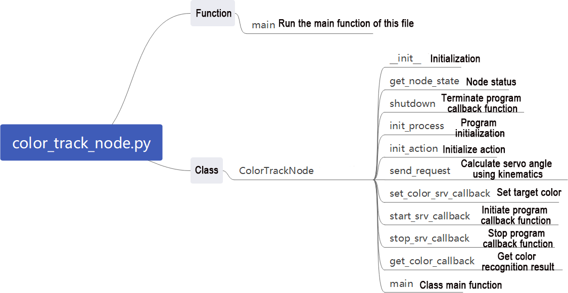

(2) Code analysis:
Program path:ros2_ws/src/example/example/color_track/color_track_node.py
(3) Main Function

(4) ColorTrackNode

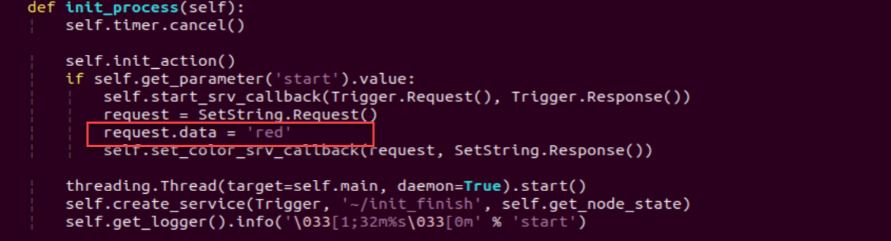

        self.timer.cancel()
        self.init_action()
            request = SetString.Request()
            request.data = 'red'
            self.set_color_srv_callback(request, SetString.Response())

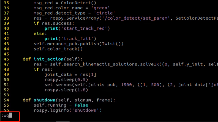

  • Extension Function
The program defaults to recognize red. However, you can change the recognition color to green or blue through modifying the codes in corresponding program. In this section, the default recognition color is changed to green as example. The specific operation steps area as follow:
(1) Start JetAuto and access the robot system desktop using VNC.
(2) Double click on to start the command line terminal.
(3) Input the command and press Enter to navigate to the program directory.
cd /home/ubuntu/ros2_ws/src/example/example/color_track/
(4) Input the command and hit Enter key to open the program file.
vim color_track_node.py
(5) Press the ‘I’ key to enter edit mode and change the value of the ‘request.data’ parameter to ‘green’.
(6) After the modification is completed, enter “:wq” to save and exit the program file.
(7) Operate the game based on “8.3.4 Color Tracking-> Operation Steps”.

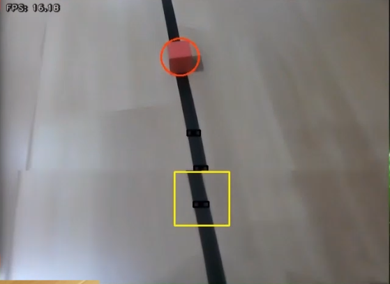

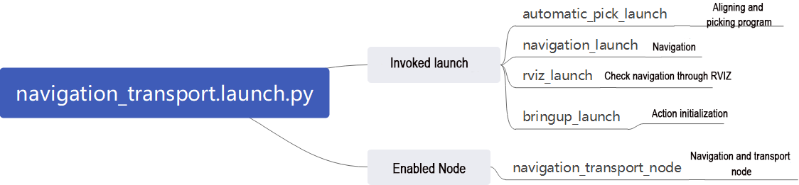

8.3.5 Line-Following Obstacle Clearance
  • Program Logic
Line following and obstacle clearing involves the robot moving along a black line while automatically removing color block obstacles on the line.
Before starting, place the black line track and position the robot at the beginning of the line. Ensure there are no other similar-colored objects nearby to avoid interference with recognition. Place color block obstacles along the black line.
First, subscribe to the color recognition and radar nodes to receive color information, images, and Lidar data.
Next, determine the center position of the line in the image, calculate the deviation from the image center, update the PID data, and correct the robot’s path.
Finally, when a color block obstacle is detected on the line, activate the obstacle removal action group to use the robotic arm to remove the obstacle.
The source code for this program can be found at: /home/ubuntu/ros2_ws/src/example/example/line_follow_clean/line_follow_clean_node.py
  • Operation Steps
The input command should be case sensitive, and the “Tab” key can be used to complement the key words.
(2) Double click on to initiate the command line terminal.
ros2 launch example line_follow_clean_node.launch.py
(5) The camera image interface when the program starts is shown below.
(6) To exit this mode, press ‘Ctrl+C’ in the terminal. If that doesn’t work, open a new command line terminal and enter the command to stop all currently running ROS processes.
  • Outcome
After the game starts, JetAuto moves alone the recognized black line. When it encounters the colored block obstacles along the way, it will pause, grip the obstacle and place it on the left side. Afterward, it will continue moving forward.

Launch Analysis:
Program path: ros2_ws/src/example/example/line_follow_clean/line_follow_clean_node.launch.py
  • Starting Other Launch Files
    lidar_launch = IncludeLaunchDescription(
            os.path.join(example_package_path, 'example/color_detect/color_detect_node.launch.py')),
        launch_arguments={
            'use_depth_cam': 'false',
        }.items()
color_detect_launch is used to start color recognition.
controller_launch is used to start control of the base, servos, and other components.
lidar_launch starts the lidar.
  • Initiate Node
{lineno-start=}
    line_follow_clean_node = Node(
        package='example',
        executable='line_follow_clean',
        output='screen',
        parameters=[os.path.join(example_package_path, 'config/line_follow_clean_roi.yaml'), {'debug': debug}]

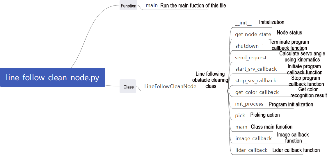

line_follow_clean_node is used to start the line-following sorting node.
Source code analysis:
Program path: /ros2_ws/src/example/example/line_follow_clean/line_follow_clean_node.py

  • LineFollowCleanNode
init_process:

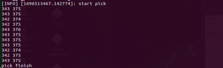

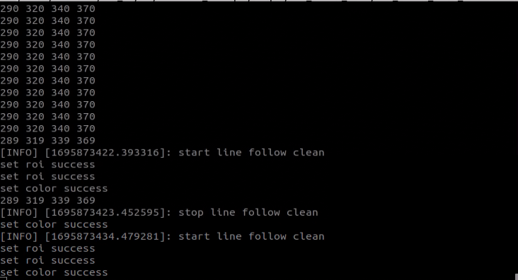

  • Gripping Adjustment
In the program, the recognition and gripping area are located in the middle of the image by default, no need for adjustment. However, due to the discrepancy in camera parameters, there might be cases where the robot arm cannot grip the color black. In such situations, you can adjust the position of this area using commands. Here are the specific steps:
(3) Run the following command to initiate the testing program.
ros2 launch example line_follow_clean_node.launch.py debug:=true
(4) In this mode, the robot will terminate line following but retain the block picking action. After JetAuto reaches the gripping position, place the block in the middle of the gripper and wait for robotic arm to restore its initial posture, mark the position of the recognition box, then wait for the robotic arm to perform the gripping action. Once the calibration is complete, it will print out the pixel coordinates of the block on the screen and a completion message in the terminal.
(5) Finally, run the program according to “8.3.5 Line-Following Obstacle Clearance -> Operation Steps”.

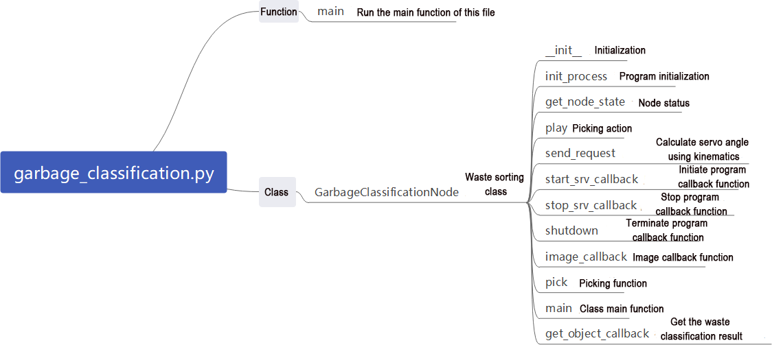

(2) Source Code Analysis:
Program path: /ros2_ws/src/example/example/garbage_classification/garbage_classification.py
① Main Function
223
224
225
226
227
228
229
def main():
    node = GarbageClassificationNode('garbage_classification')
    executor.spin()
    node.destroy_node()
    rclpy.shutdown()
② GarbageClassificationNode
init_process:
72
73

83
84
85
    automatic_pick_launch = IncludeLaunchDescription(
        PythonLaunchDescriptionSource(os.path.join(example_package_path, 'example/navigation_transport/automatic_pick.launch.py')),
        launch_arguments={
            'broadcast': broadcast,
            'debug': debug,
            'place_without_color': place_without_color,
            'place_position': place_position,
            'master_name': master_name,
            'robot_name': robot_name,
            'enable_display': 'false',
        }.items(),
        launch_arguments={
            'use_sim_time': 'false',
            'namespace': robot_name,
            'use_namespace': 'false',
            'autostart': 'true',
        }.items(),
    navigation_transport_node = Node(
        package='example',
        executable='navigation_transport',
        output='screen',
    rviz_node = ExecuteProcess(
            cmd=['rviz2', 'rviz2', '-d', os.path.join(navigation_package_path, 'rviz/navigation_transport.rviz')],
            output='screen'
    bringup_launch = GroupAction(
     actions=[
         PushRosNamespace(robot_name),
         automatic_pick_launch,
         TimerAction(
             period=10.0,  # 延时等待其它节点启动好
             actions=[navigation_launch],
automatic_pick_launch: Automatically picks up items based on color alignment.
navigation_launch: Launches navigation.
rviz_launch: Uses RVIZ to visualize navigation effects.
bringup_launch: Initializes actions.

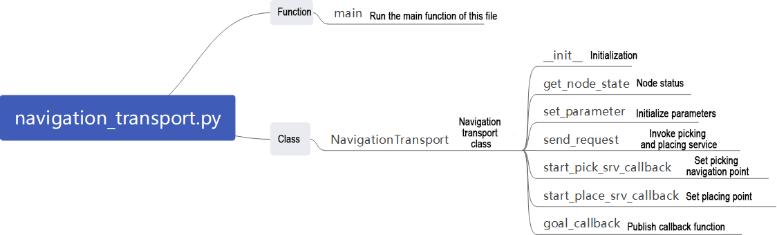

(4) Source Code Analysis
Program path:ros2_ws/src/example/example/navigation_transport/navigation_transport.py
(5) Main Function
244
245
246
247
248
249
def main():
    node = NavigationTransport('navigation_transport')

(6) NavigationTransport
get_node_state:
61
        return response
shutdown:
83
84
    def shutdown(self, signum, frame) :
send_request:
71
72
73
74
75
        while rclpy.ok():
Publishes certain recognized information to a specific service
start_pick_srv_callback:
77
78
79
80
81
82
83
84
85
86
87
88
89
90
91
92
93
94
95
96
    def start_pick_srv_callback(self, request, response):
        self.get_logger().info('start navigaiton pick')
        marker_Array = MarkerArray()
        marker = Marker()
        marker.header.frame_id = self.map_frame
        marker.action = Marker.DELETEALL
        marker_Array.markers.append(marker)
        self.mark_pub.publish(marker_Array)
        markerArray = MarkerArray()
        pose = PoseStamped()
        pose.header.stamp = self.navigator.get_clock().now().to_msg()
        data = request.data
        q = common.rpy2qua(math.radians(data.roll), math.radians(data.pitch), math.radians(data.yaw))
        pose.pose.position.x = data.x
        pose.pose.position.y = data.y
        pose.pose.orientation = q
Upon invocation, sets navigation points in RVIZ to begin picking up items based on their location.
start_place_srv_callback:
129
130
131
132
133
134
135
136
137
138
139
140
141
142
143
144
    def start_place_srv_callback(self, request, response):
        self.get_logger().info('start navigaiton place')
        data = request.data
        # 用数字标记来显示点(mark the point with number to display)
        marker = Marker()
Upon invocation, sets navigation points in RVIZ to begin placing items based on their location.
goal_callback:
173
174
175
176
177
178
179
180
181
182
183
184
185
186
187
188
189
190
191
192
193
194
195
196
197
    def goal_callback(self, msg):
        # 获取要发布的导航点
        self.get_logger().info('\033[1;32m%s\033[0m' % str(msg))
        get_parameters_request = GetParameters.Request()
        get_parameters_request.names = ['status']
        status = self.send_request(self.get_param_client, get_parameters_request).values[0].string_value
        self.get_logger().info('\033[1;32m%s\033[0m' % status)
        if status == 'start' or status == 'place_finish':  # 处于可以pick的状态
            self.pick = True
            self.place = False
            self.get_logger().info('\033[1;32m%s\033[0m' % 'nav pick')
            self.navigator.goToPose(msg)
            self.haved_publish_goal = True
        elif status == 'pick_finish':  # 处于可以place的状态
            self.pick = False
            self.place = True
            self.get_logger().info('\033[1;32m%s\033[0m' % 'nav place')
        if self.haved_publish_goal:
            i = 0
Callback function for navigation points; switches between pick and place modes based on the current set navigation points.

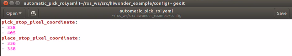

(7) Gripping Calibration
The default recognition and gripping area of the program is located in the center of the image. No adjustments are required for the normal circumstance. If the robotic arm fails to grip the colored blocks during the game, you can adjust the position of this area through the program command. The specific steps are as follow:
① Start JetAuto and connect it to VNC remote control software.
② Click on to open the command line terminal.
③ Input the command to disable the app auto-start service:
④ Enter the command to start calibrating the gripping position:
ros2 launch example automatic_pick.launch.py debug:=true
⑤ After the robotic arm reaches the gripping position, place the color block in the center of the gripper. Wait for the arm to return to its initial position and grasp the block again to complete the calibration. Once calibration is complete, the terminal will display the color block’s pixel coordinates in the image and a confirmation message.
The data after automatic calibration will be saved in the /home/ros_ws/src/hiwonder_example/config/automatic_pick_rol.yaml file.
pick_stop_pixel_coordinate refers to the pixel coordinates of the gripping position in the image. The first parameter represents the x-axis coordinate. Decreasing this value shifts the horizontal position to the left, while increasing it shifts the gripping horizontal position to the right. The second parameter represents the y-axis coordinate. Decreasing this value moves the gripping position closer, while increasing it moves the gripping position farther away. Generally, you can rely on automatic calibration results, but you can also adjust it according to your personal preference.
place_stop_pixel_coordinate refers the pixel coordinates of the placement position in the image. The first parameter represents the x-axis coordinate. Increasing this value shifts the placement position to the left, while decreasing it shifts the placement position to the right. The second parameter represents the y-axis coordinate. Decreasing this value adjusts the placement position closer, while increasing it moves the gripping position farther away.
Automatic calibration solely calibrates the coordinates of the gripping position. The coordinates of the placement position are not automatically calibrated. If a placement target is set and the placement effect is not satisfactory, manual adjustment is required.
⑥ Upon the completion of the modification, please start the game according to “8.3.7 Fixed Point Navigation->Operation Steps”.
