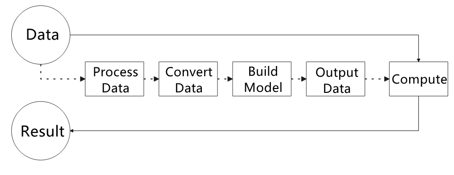

  • How to use MediaPipe
The figure below shows how to use MediaPipe. The solid line represents the part to coded, and the dotted line indicates the part not to coded. MediaPipe can offer the result and the function realization framework quickly.
(1) Dependency
MediaPipe utilizes OpenCV to process video, and uses FFMPEG to process audio data. Furthermore, it incorporates other essential dependencies, including OpenGL/Metal, Tensorflow, and Eigen.
For seamless usage of MediaPipe, we suggest gaining a basic understanding of OpenCV. To delve into OpenCV, you can find detailed information in “OpenCV Basic Courses”.
(2) MediaPipe Solutions
Solutions is based on the open-source pre-constructed sample of TensorFlow or TFLite. MediaPipe Solutions is built upon a framework, which provides 16 Solutions, including face detection, Face Mesh, iris, hand, posture, human body and so on.

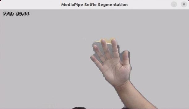

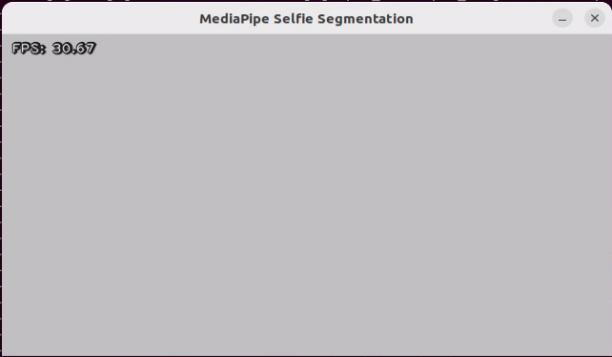

  • Program Outcome
Once the feature is activated, the screen changes to a gray virtual background, and when a hand enters the frame, it is automatically separated from the background.

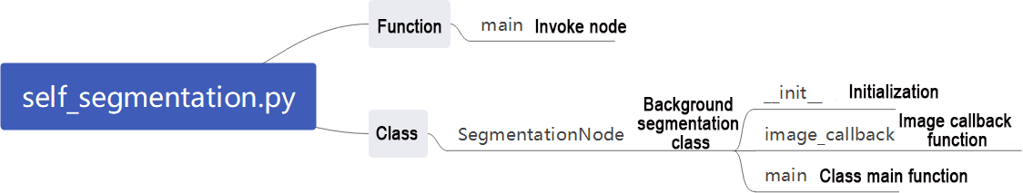

  • Program Analysis
The source code of this program locates in:/ros2_ws/src/example/example/mediapipe_example/self_segmentation.py
(1) Function
Main:
79
80
81
82
83
84
85
86
87
88
def main():
    node = SegmentationNode('self_segmentation')
        rclpy.spin(node)
    except KeyboardInterrupt:
        node.destroy_node()
        rclpy.shutdown()
        print('shutdown')
    finally:
        print('shutdown finish')
Used to start the background control node.
(2) Class
SegmentationNode:
class SegmentationNode(Node):
    def __init__(self, name):
        rclpy.init()
        super().__init__(name)
        self.running = True
        self.mp_selfie_segmentation = mp.solutions.selfie_segmentation
        self.mp_drawing = mp.solutions.drawing_utils
        self.fps = fps.FPS()
        self.BG_COLOR = (192, 192, 192)  # gray
Init:
        rclpy.init()
        self.running = True
Initialize the parameters required for background segmentation, call the image callback function, and start the model recognition function.
image_callback:
        rgb_image = np.ndarray(shape=(ros_image.height, ros_image.width, 3), dtype=np.uint8,
                               buffer=ros_image.data)  # 原始 RGB 画面
        if self.image_queue.full():
            # 如果队列已满,丢弃最旧的图像
            self.image_queue.get()
            # 将图像放入队列
Image callback function, used to read data from the camera node and enqueue it.
Main:
61
70
71
72
73
74
75
76
    def main(self):
        with self.mp_selfie_segmentation.SelfieSegmentation(
            model_selection=1) as selfie_segmentation:
            bg_image = None
            while self.running:
                except queue.Empty:
                    if not self.running:
                        continue
                # To improve performance, optionally mark the image as not writeable to
                # pass by reference.
                image.flags.writeable = False
                results = selfie_segmentation.process(image)
                image.flags.writeable = True
                image = cv2.cvtColor(image, cv2.COLOR_RGB2BGR)
                # Draw selfie segmentation on the background image.
                # To improve segmentation around boundaries, consider applying a joint
                # bilateral filter to "results.segmentation_mask" with "image".
                condition = np.stack(
                        (results.segmentation_mask,) * 3, axis=-1) > 0.1
                # The background can be customized.
                #   a) Load an image (with the same width and height of the input image) to
                #      be the background, e.g., bg_image = cv2.imread('/path/to/image/file')
                #   b) Blur the input image by applying image filtering, e.g.,
                #      bg_image = cv2.GaussianBlur(image,(55,55),0)
                if bg_image is None:
                  bg_image = np.zeros(image.shape, dtype=np.uint8)
                  bg_image[:] = self.BG_COLOR
                output_image = np.where(condition, image, bg_image)
                self.fps.update()
                result_image = self.fps.show_fps(output_image)
                cv2.imshow('MediaPipe Selfie Segmentation', result_image)
                key = cv2.waitKey(1)
                if key == ord('q') or key == 27:  # 按q或者esc退出
        cv2.destroyAllWindows()
        rclpy.shutdown()
Load the model from MediaPipe, input the image, and display the output image using OpenCV.

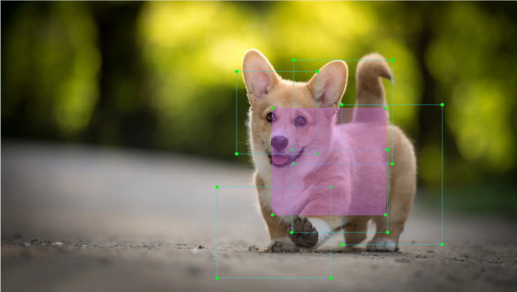

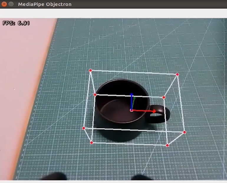

  • Program Outcome
Once the game starts, the 3D frame will be drawn around the boundary of the recognized object. The system can identify several objects, including a cup (with handle), shoe, chair, and camera.

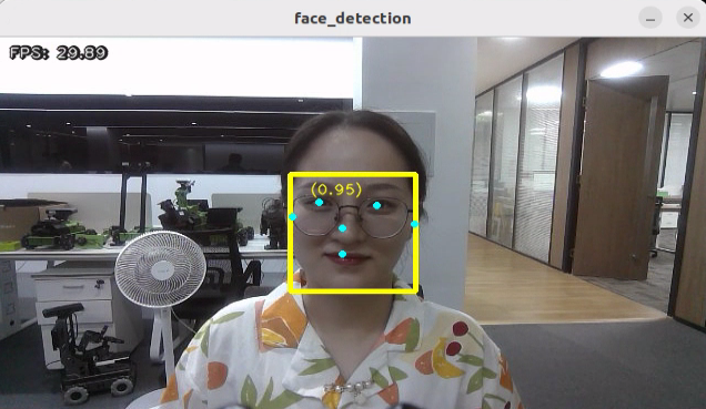

7.1.4 Face Detection
In this lesson, we’ll use MediaPipe’s face detection model to detect faces in the frame. MediaPipe’s face detection is an ultra-fast solution that supports multiple faces and identifies 6 key landmarks. It’s built on BlazeFace, a lightweight and highly efficient face detector optimized for mobile GPU inference.
  • Program Logic
To begin, import the human face detection model from MediaPipe and subscribe to the relevant topic message to obtain the live camera feed.
Next, utilize OpenCV to flip the image and convert the color space for further processing.
Then, using the face detection model’s minimum confidence threshold, determine whether a human face has been successfully detected. If a human face is recognized, proceed to collect the necessary information about each detected face, including the bounding frame and the 6 key points (right eye, left eye, nose tip, right ear, and left ear).
Finally, frame the human face and mark the 6 key points on each detected face for visual clarity and further analysis.
  • Operation Steps
(1) Start the robot, and enter the robot system desktop using VNC
(3) Run the command to disable app auto-start app service.
(4) Execute the command to enable the camera node.
(5) Open a new command-line terminal and execute the following command.
cd ~/ros2_ws/src/example/example/mediapipe_example && python3 face_detect.py
(6) If you need to close this game, you need to press the “Esc” key in the image interface to exit the camera image interface.
(7) Then press “Ctrl+C” in the command line terminal interface. If closing fails, please try again.
  • Program Outcome
After the game starts, depth camera will start detecting human face, and human face will framed on the live camera feed.

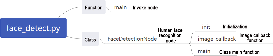

  • Program Analysis
The source code of this program is saved in /ros2_ws/src/example/example/mediapipe_example/face_detect.py
(1) Function
Main:
70
71
72
73
74
def main():
    node = FaceDetectionNode('face_detection')
        rclpy.spin(node)
        node.destroy_node()
        rclpy.shutdown()
        print('shutdown')

(2) Class
FaceDetectionNode:
class FaceDetectionNode(Node):
        rclpy.init()
        self.running = True
        model_path = os.path.join(os.path.abspath(os.path.split(os.path.realpath(__file__))[0]), 'model/detector.tflite')
        base_options = python.BaseOptions(model_asset_path=model_path)
        options = vision.FaceDetectorOptions(base_options=base_options)
        self.detector = vision.FaceDetector.create_from_options(options)
Init:
        self.running = True
Initialize the parameters required for face recognition, call the image callback function, and start the model recognition function.
image_callback:
            # 如果队列已满,丢弃最旧的图像
            # 将图像放入队列

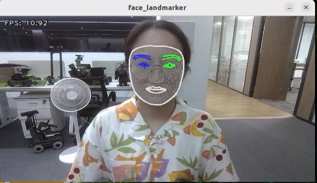

7.1.5 3D Face Detection
In this program, MediaPipe Face Mesh is utilized to detect human face within the camera image.
MediaPipe Face Mesh is a powerful model capable of estimating 468 3D facial features, even when deployed on a mobile device. It employs machine learning to infer the 3D face contour accurately. Additionally, this model ensures real-time detection by utilizing a lightweight model architecture and GPU acceleration.
Furthermore, this model is integrated with a face conversion module that compensates for any differences between face landmark estimation and AR (Augmented Reality) applications. It establishes a metric 3D space and utilizes the facial landmark screen positions to estimate facial conversion within this space. The facial conversion data consists of common 3D primitives, including facial gesture conversion matrices and triangle facial mesh information.
  • Program Logic
Firstly, you need to learn that machine learning pipeline is composed of two real-time deep neural network models. The system consists of two components: a face detector that processes the entire image and calculates the locations of faces, and a 3D face landmark model that uses these locations to predict an approximate 3D surface through regression.
To achieve 3D facial landmarks, we utilize transfer learning and train a network with multiple objectives: predicting 3D landmark coordinates on synthetic rendered data and 2D semantic contours on annotated real-world data simultaneously. This approach yields plausible 3D landmark predictions not only based on synthetic data but also on real-world data.
The 3D landmark network takes cropped video frames as input without requiring additional depth input. The model outputs the location of a 3D point and the probability that a face appears in the input and is properly aligned.
Once the face mesh model is imported, real-time images can be obtained from the camera by subscribing to topic messages.
Next, image preprocessing techniques like flipping the image and converting the color space are applied. The face detection model’s minimum confidence is then used to determine whether the face has been successfully detected.
Finally, the detected face on the screen is projected into a 3D grid for visualization and display.
  • Operation Steps
(1) Start the robot, and enter the robot system desktop using VNC.
(4) Run the following command to enable the camera node.
(5) Execute the command to enable the function program:
cd ~/ros2_ws/src/example/example/mediapipe_example && python3 face_mesh.py
  • Program Outcome
After starting the game, when the depth camera detects a face, it will outline the face in the feedback image.

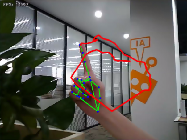

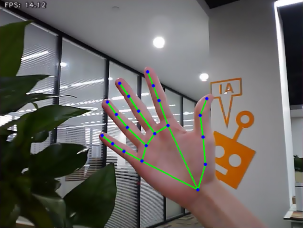

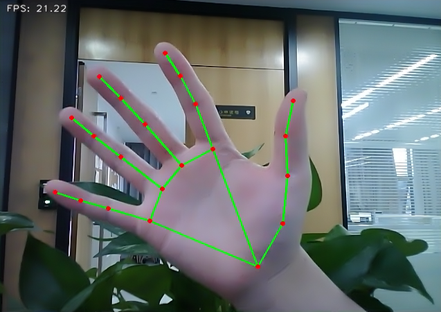

7.1.6 Hand Key Point Detection

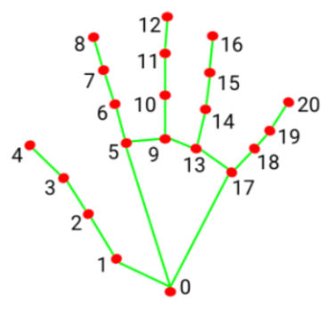

MediaPipe’s hand detection model is employed to showcase the key points of the hand and the connecting lines of these key points on the live camera feed.
MediaPipe Hands is an advanced hand and finger detection model that delivers high-fidelity results. Through the power of machine learning (ML), it accurately infers 21 3D landmarks of the hand from a single frame.
  • Program Logic
Firstly, it’s important to understand that MediaPipe’s palm detection model employs a machine learning pipeline consisting of multiple models (including a linear model). This model processes the entire image and returns an oriented hand bounding box. On the other hand, the hand landmark model operates on cropped image regions defined by the palm detectors and provides high-fidelity 3D hand keypoints.
To begin, after importing the palm detection model, we subscribe to the topic message to obtain real-time camera images.
Next, various image pre-processing steps, such as flipping the image and converting the color space, are applied. These steps significantly reduce the need for data augmentation for the hand landmark model.
Furthermore, our pipeline allows for generating crops based on hand landmarks identified in the previous frame. The palm detection is invoked only when the landmark model is unable to recognize the presence of the hand accurately.
Afterward, by comparing the minimum confidence level of the hand detection model, we determine whether the palm has been successfully detected.
Lastly, the hand keypoints are detected and drawn on the camera image to visualize the detected hand in real-time.
  • Operation Steps
(4) Execute the command to enable the camera node:
(5) In a new command line terminal, enter the command and press Enter to run the function program.
cd ~/ros2_ws/src/example/example/mediapipe_example && python3 hand.py
  • Program Outcome
Once the game starts, the depth camera will begin detecting the hand and display the hand key points on the camera image, with the key points connected.

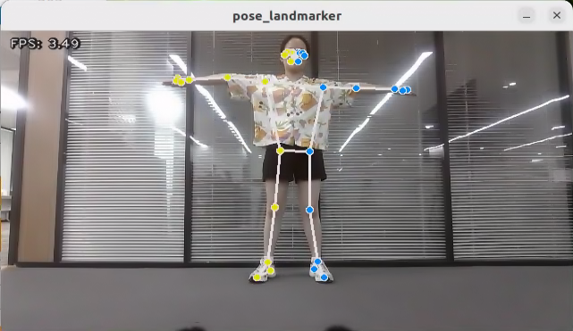

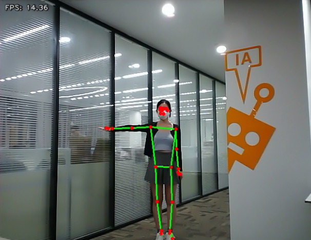

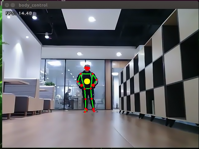

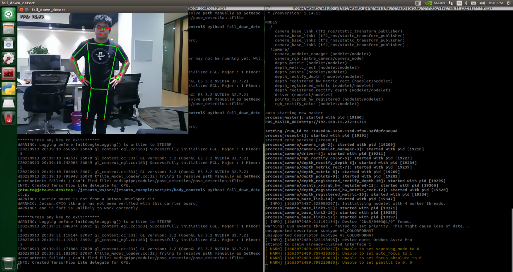

7.1.7 Body Key Points Detection
The MediaPipe body detection model is utilized to detect key points on the human body, which are then displayed on the live camera feed. This implementation incorporates MediaPipe Pose, a high-fidelity posture tracking model that leverages BlazePose to infer 33 3D key points. Additionally, this approach offers support for the ML Kit Pose Detection API.
  • Program Logic
Firstly, import body detection model.
Subsequently, flip over the image and convert the color space of the image. Check whether the human body is successfully detected based on the minimum confidence of the body detection model.
Next, define the tracked posture by comparing the minimum tracking confidence. If the confidence does not meet the minimum threshold, perform automatic human detection on the next input image.
In the pipeline, a detector is employed to initially localize the region of interest (ROI) corresponding to a person’s pose within a frame. Subsequently, a tracker utilizes the cropped ROI frame as input to predict pose landmarks and segmentation masks within the ROI.
For video applications, the detector is invoked selectively, only when necessary. Specifically, it is used for the first frame or when the tracker fails to recognize the body pose in the preceding frame. In all other frames, the pipeline derives ROIs based on the pose landmarks detected in the previous frame.
After MediaPipe body detection model is imported, access the live camera feed through subscribing the related topic message.
Lastly, draw the key points representing the human body.
  • Operation Steps
(5) In a new command line terminal, enter the command and press Enter to execute the program
cd ~/ros2_ws/src/example/example/mediapipe_example && python3 pose.py
  • Program Outcome
After the game starts, depth camera will begin detecting human pose, and body key points can be displayed and connected on the live camera feed.
  • Program Analysis
The program file is saved in:/ros2_ws/src/example/example/mediapipe_example/pose.py
(1) Function
Main:
70
71
72
73
74
def main():
    node = PoseNode('pose_landmarker')
        rclpy.spin(node)
        node.destroy_node()
        rclpy.shutdown()
        print('shutdown')
    finally:
Used to initiate the 3D face detection node.
(2) Class
PoseNode:
class PoseNode(Node):
        rclpy.init()
        self.running = True
        model_path = os.path.join(os.path.abspath(os.path.split(os.path.realpath(__file__))[0]), 'model/pose_landmarker.task')
        options = vision.PoseLandmarkerOptions(
            base_options=base_options,
            output_segmentation_masks=True)
        self.detector = vision.PoseLandmarker.create_from_options(options)
Init:
        rclpy.init()
        self.running = True
Initialize the parameters required for limb detection, call the image callback function, and start the model recognition process.
image_callback:
            # 如果队列已满,丢弃最旧的图像
            # 将图像放入队列
Main:
61
    def main(self):
        while self.running:
            except queue.Empty:
                    continue
            image = cv2.flip(image, 1)
            detection_result = self.detector.detect(mp_image)
            annotated_image = draw_pose_landmarks_on_image(image, detection_result)
            self.fps.update()
            result_image = self.fps.show_fps(cv2.cvtColor(annotated_image, cv2.COLOR_RGB2BGR))
            cv2.imshow('pose_landmarker', result_image)

cd ~/ros2_ws/src/example/example/mediapipe_example && python3 hand_gesture.py
(6) The program will launch the camera’s image interface. For detailed recognition steps, please refer to 7.1.8 Fingertip Trajectory Recognition->Program Outcome. (7) To close this function, press the “Esc” key in the image interface to exit the camera view. (8) Then press “Ctrl+C” in the command line terminal interface. If closing fails, please try again.
  • Program Outcome
Once the game starts, position your hand within the camera’s field of view. Upon recognition, the hand keypoints will be highlighted on the camera feed.
If the robot detects the “1” gesture, the trajectory of your fingertip motion will begin to be recorded on the camera feed. If it detects the “5” gesture, the recorded fingertip trajectory will be cleared.

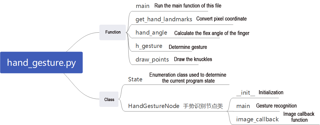

  • Program Analysis
The program file is saved in /ros2_ws/src/example/example/mediapipe_example/hand_gesture.py
Prior to making any alterations to the program, ensure to create a backup of the original factory program. Modify it only after creating the backup. Directly editing the source code file is prohibited to prevent inadvertent parameter modifications that could render the robot dysfunctional and irreparable!

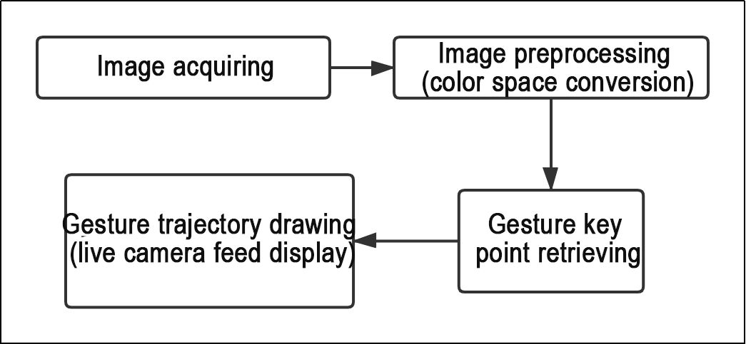

Based on the game’s impact, the process logic of this game is organized as depicted in the figure below:

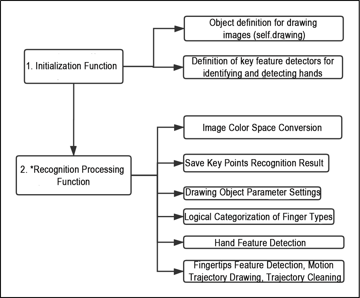

As depicted in the image above, the purpose of this game is to capture an image using the camera, preprocess it by converting its color space for easier identification, extract feature points corresponding to hand gestures from the converted image, and determine different gestures (based on angles) through logical analysis of key feature points. Finally, the trajectory of the recognized gesture is drawn on the display screen.
The program’s logic flowchart extracted from the program files is illustrated in the figure below.
From the above diagram, it can be seen that the program’s logical flow is mainly divided into initialization functions and recognition processing functions. The following document content will be written according to the program logic flow chart mentioned above.
(1) Function
Main:
209
210
211
212
213
214
215
216
217
218
def main():
    node = HandGestureNode('hand_gesture')
        rclpy.spin(node)
        node.destroy_node()
        rclpy.shutdown()
        print('shutdown')
    finally:
The main function is used to start the fingertip trajectory recognition node.
get_hand_landmarks:
def get_hand_landmarks(img, landmarks):
    将landmarks从medipipe的归一化输出转为像素坐标
    :param img: 像素坐标对应的图片
    :param landmarks: 归一化的关键点
    :return:
    h, w, _ = img.shape
    landmarks = [(lm.x * w, lm.y * h) for lm in landmarks]
    return np.array(landmarks)
Convert the normalized data from madipipe into pixel coordinates.
hand_angle:
def hand_angle(landmarks):
    计算各个手指的弯曲角度
    :param landmarks: 手部关键点
    :return: 各个手指的角度
    angle_list = []
    # thumb 大拇指
    angle_list.append(angle_)
    # index 食指
    # middle 中指
    # ring 无名指
    # pink 小拇指
    return angle_list
After extracting the hand feature points into the ‘results’ variable, it is necessary to logically process these points. By evaluating the angular relationship between the feature points, specific finger types (thumb, index finger) can be identified. The ‘hand_angle’ function accepts the landmark feature point set (results) as input, and subsequently employs the ‘vector_2d_angle’ function to compute the angles between the corresponding feature points. The feature points corresponding to the elements of the landmark set are depicted in the figure below:
Taking the thumb’s angle calculation as an example: the vector_2d_angle function is used to calculate the angle between joint points. landmarks[3], landmarks[4], landmarks[0], and landmarks[2] correspond to feature points 3, 4, 0, and 2 in the hand feature extraction diagram. By calculating the angles of these joint points, the thumb’s posture characteristics can be determined. Similarly, the processing logic for the other finger joints is analogous.
To ensure the accuracy of recognition, the parameters and basic logic (addition and subtraction of angle calculations) in the hand_angle function should remain at their default settings.
h_gesture:

After identifying the different finger types of the hand and determining their positions on the image, logical recognition processing of various gestures can be performed by implementing the ‘h_gesture’ function.
In the h_gesture function depicted above, the parameters thr_angle, thr_angle_thenum, and thr_angle_s represent the angle threshold values for corresponding gesture logic points. These values have been empirically tested to ensure stable recognition effects. It is not recommended to alter them unless the logic processing effect is unsatisfactory, in which case adjustments within a range of ±5 values are sufficient. The angle_list[0,1,2,3,4] corresponds to the five finger types associated with the palm.
Here’s an example using the gesture “one”:
The code presented represents the logical angle evaluation of the fingers for the “one” gesture. angle_list[0]>5 checks whether the angle value of the thumb joint feature point in the image is greater than 5. angle_list[1]<thr_angle_s checks if the angle feature of the index finger joint feature point is less than the predetermined value thr_angle_s. Similarly, angle_list[2]<thr_angleverifies if the angle feature of the middle finger feature point is less than the predetermined value ‘thr_angle’. The logical processing for the other two fingers, angle_list[3] and angle_list[4], follows a similar method. When the above conditions are met, the current gesture feature is recognized as “one”, and the same principle applies to recognizing other gesture features.
Different gesture recognitions involve distinct logical processing, but the overall logical framework remains similar. For recognizing other gesture features, refer to the previous paragraph.
draw_points:
107
108
109
110
111
112
113
def draw_points(img, points, thickness=4, color=(255, 0, 0)):
    points = np.array(points).astype(dtype=np.int64)
    if len(points) > 2:
            if i + 1 >= len(points):
            cv2.line(img, p, points[i + 1], color, thickness)
Draw the currently recognized hand shape and each joint point.
(2) Class
State:
101
102
103
104
105
class State(enum.Enum):
    NULL = 0
    START = 1
    TRACKING = 2
    RUNNING = 3
An enumeration class used to set the current state of the program.
HandGestureNode:
107
108
109
110
111
112
113
114
115
116
117
118
119
120
121
122
123
124
125
126
127
128
129
130
131
132
133
134
135
136
    if len(points) > 2:
class HandGestureNode(Node):
        rclpy.init()
        self.running = True
            static_image_mode=False,
            max_num_hands=1,
            min_tracking_confidence=0.05,
            min_detection_confidence=0.6
        self.fps = fps.FPS()  # fps计算器
        self.state = State.NULL
        self.points = []
        self.count = 0
The HandGestureNode is a fingertip trajectory recognition node that contains three functions: an initialization function, a main function, and an image callback function.
Init:
116
117
118
119
120
121
122
123
124
125
126
127
128
129
130
131
132
133
134
135
136
        rclpy.init()
        self.running = True
            max_num_hands=1,
        self.points = []
        self.count = 0
Initialize each component needed and call the camera node.

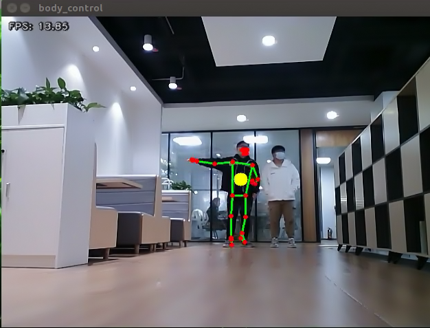

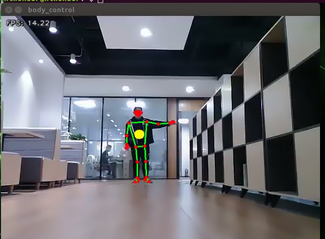

7.1.9 Posture Control
The human posture estimation model, trained using the MediaPipe machine learning framework, detects the human body feature in the captured image, identifies relevant joint positions, and subsequently recognizes a variety of sequential actions. This process enables direct control of the robot through somatosensory input.
Viewed from the perspective of the robot, the following actions correspond to specific movements:
① If the user lifts their left arm, the robot will move a certain distance to the right.
② If the user lifts their right arm, the robot will move a certain distance to the left.
③ If the user lifts their left leg, the robot will move forward a certain distance.
④ If the user lifts their right leg, the robot will move backward a certain distance.
  • Program Logic
First, import MediaPipe’s human pose estimation model and subscribe to topic messages to obtain real-time footage from the camera.
MediaPipe is an open-source multimedia machine learning model application framework that runs cross-platform on mobile devices, workstations, and servers. It supports mobile GPU acceleration and inference engines such as TensorFlow and TF Lite.
Next, utilize the built model to detect key points of the human body in the screen. Connect these key points to display the human body and determine the human body posture.
Finally, if a specific action is detected in the human body posture, the robot will respond accordingly.
  • Operation Steps
(4) Execute the command to run the game program:
ros2 launch example body_control.launch.py
(5) If you need to close this gameplay, you need to press the “Esc” key in the image interface to exit the camera image interface.
(6) Then press “Ctrl+C” in the command line terminal interface. If closing fails, please try again.
  • Program Outcome
Once the game is initiated, stand within the camera’s field of view. When a person is detected, the screen will display key points of the body and lines connecting them.
From the perspective of the robot, lifting the left arm will cause the robot to turn left; lifting the right arm will make the robot turn right; lifting the left leg will make the robot move forward a certain distance; lifting the right leg will make the robot move backward a certain distance.
  • Program Analysis
The program file is saved in ros2_ws/src/example/example/body_control/include/body_control.py

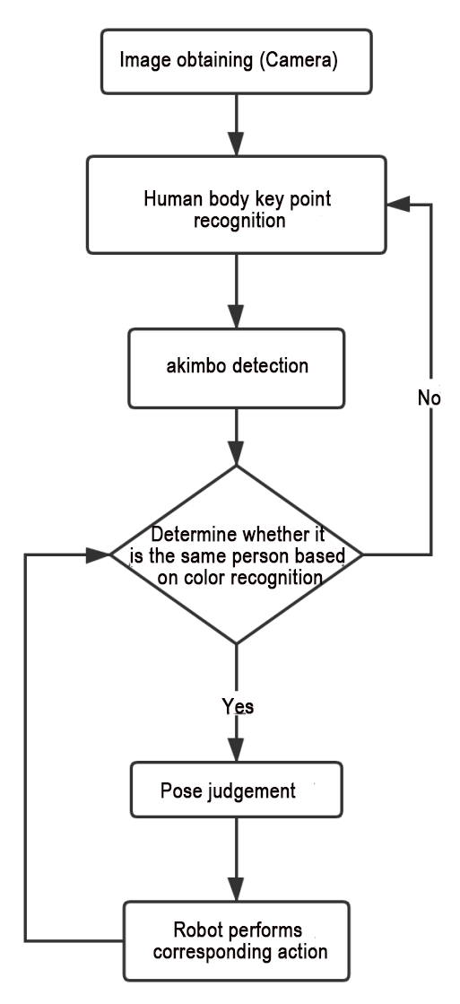

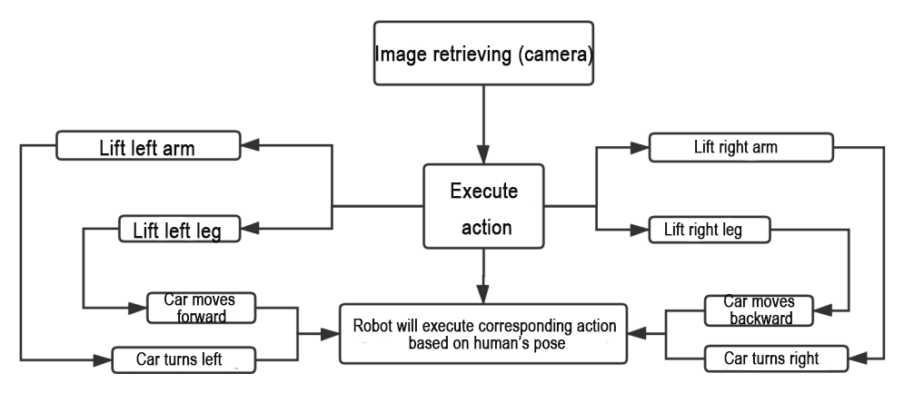

The game process logic is outlined below:
① Capture an image through the camera.
② After performing a demonstration action, the car will execute the corresponding action.
③ From the car’s perspective, lifting the left arm will cause the car to turn left; lifting the right arm will cause the car to turn right in a circle; lifting the left leg will make the car move forward a certain distance; lifting the right leg will make the car move backward a certain distance.

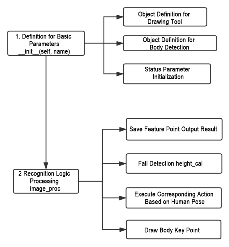

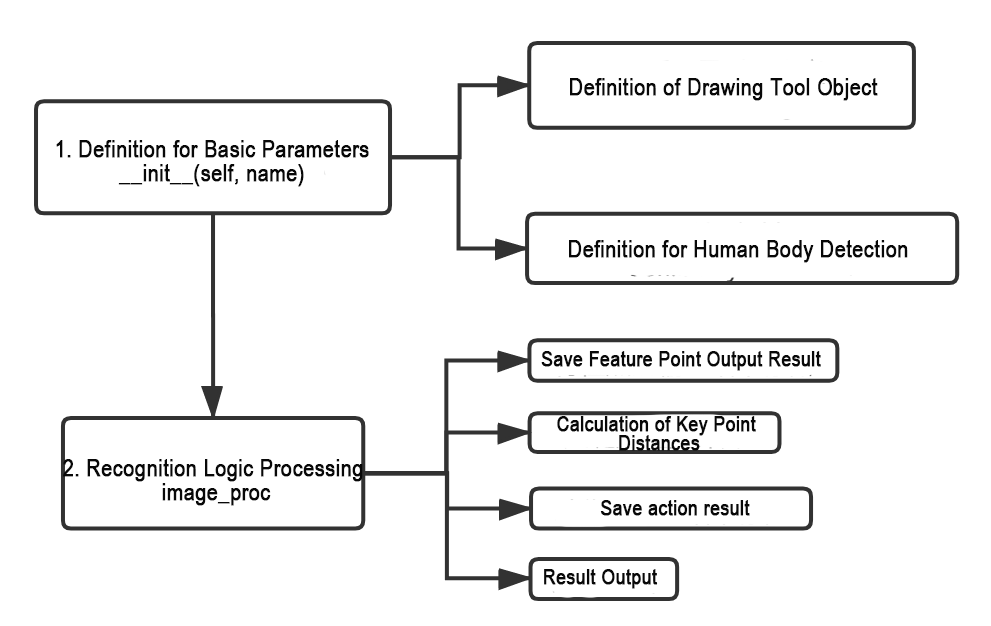

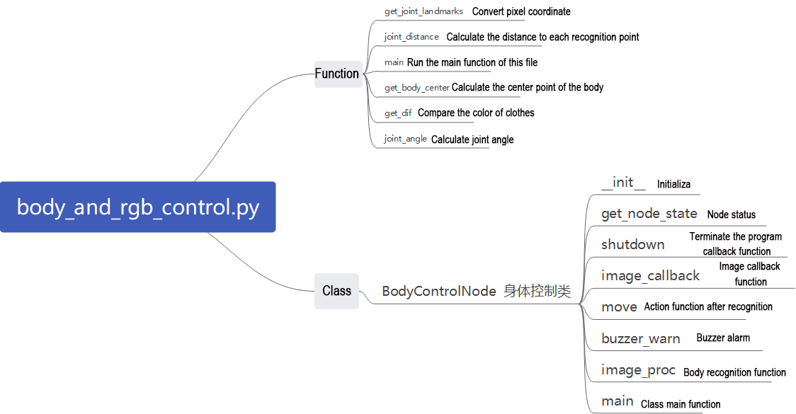

The program’s logic flowchart, obtained from the program files, is presented below:
① Initialization function (init(self.name)) defines relevant parameters, including:
  • Definition of the image tool (self.drawing) object.
  • Points used to draw recognized features.
  • Definition of the limb detection object (self.body_detector).
② Identified feature points’ output results undergo logical processing for recognition.
③ Actions are determined and stored based on key point distance conditions.
④ Finally, the output results are generated, and the car executes corresponding actions.
(1) Function

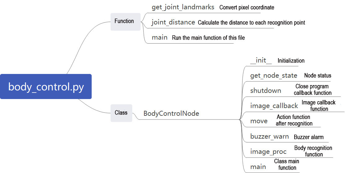

class BodyControlNode(Node):
        rclpy.init()
        self.name = name
        self.body_detector = mp_pose.Pose(
            min_tracking_confidence=0.5,
            min_detection_confidence=0.5)
        self.running = True
        self.move_finish = True
        self.stop_flag = False
        self.left_hand_count = []
        self.right_hand_count = []
        self.left_leg_count = []
        self.right_leg_count = []
        self.detect_status = [0, 0, 0, 0]
This class is the body control node.
Init:
86
87
88
89
90
91
92
93
94
95
96
97
        rclpy.init()
        self.name = name
        self.running = True
Initialize the parameters required for body control, read the image callback node from the camera, initialize nodes such as servos, chassis, buzzers, motors, etc., and finally start the main function within the class.4

Movement strategy function that moves the vehicle according to the recognized limb actions.

Buzzer control function used for buzzer alarms.

Function for recognizing limbs, which invokes the model to draw key points of the human body based on the recognized information, and then performs movements according to the recognized posture.

The main function within the BodyControlNode class, used to input image information into the recognition function and display the returned image.
7.1.10 Integration of Body Posture and RGB Control
The depth camera combines RGB capabilities, enabling both color recognition and somatosensory control. This lesson will leverage color recognition, as discussed in “7.1.9 Posture Control”, to identify individuals wearing clothing of a predefined color (which can be calibrated through operations). The robot’s movements are then controlled based on different body gestures.
If an individual wearing the specified color is not recognized, the robot remains unresponsive, ensuring accurate identification and control over the individual operating the robot.
  • Program Logic
First, import MediaPipe’s human pose estimation model and subscribe to topic messages to obtain real-time camera footage.
Next, utilize the built model to detect key points of the human torso on the screen. Connect these key points to display the human torso and determine the human posture. Calibrate the center point of the human body based on all key points.
Finally, if it is detected that the human body is standing with hands on hips, calibrate the color of the clothes to identify the control object. The robot enters control mode, and when the human body performs specific actions, the robot responds with corresponding actions.
  • Operation Steps
(4) Run the following command and hit Enter key to initiate the game:
ros2 launch example body_and_rgb_control.launch.py
(5) If you need to close this game you need to press the “Esc” key in the image interface to exit the camera image interface.
  • Program Outcome
After starting the game, stand within the camera’s field of view. When a person is detected, the screen will display key points of the human torso, lines connecting these points, and the center point of the human body.
First Step: Slightly adjust the camera to maintain a certain distance, ensuring it can detect the entire human body.
Second Step: When the person to be controlled appears on the camera screen, they can assume the posture of hands on hips. If the buzzer emits a short beep, the robot completes calibration of the human body’s center point and clothing color, entering control mode.
Third Step: At this point, with the robot as the primary viewpoint, raising the left arm causes the robot to move to the right; raising the right arm causes the robot to move to the left; raising the left leg causes the robot to move forward; raising the right leg causes the robot to move backward.
Fourth Step: If a person wearing a different clothing color enters the camera’s field of view, they will not control the robot.

Retrieve the captured image from the camera, analyze the key characteristics of the human body, initially detect and assess the “akimbo” posture using the designated function. Subsequently, determine if it’s the same individual in the picture based on clothing color. If confirmed, identify specific body movements (raising the left arm, right arm, left leg, and right leg) and instruct the car to execute corresponding actions. Otherwise, reanalyze the key feature points.

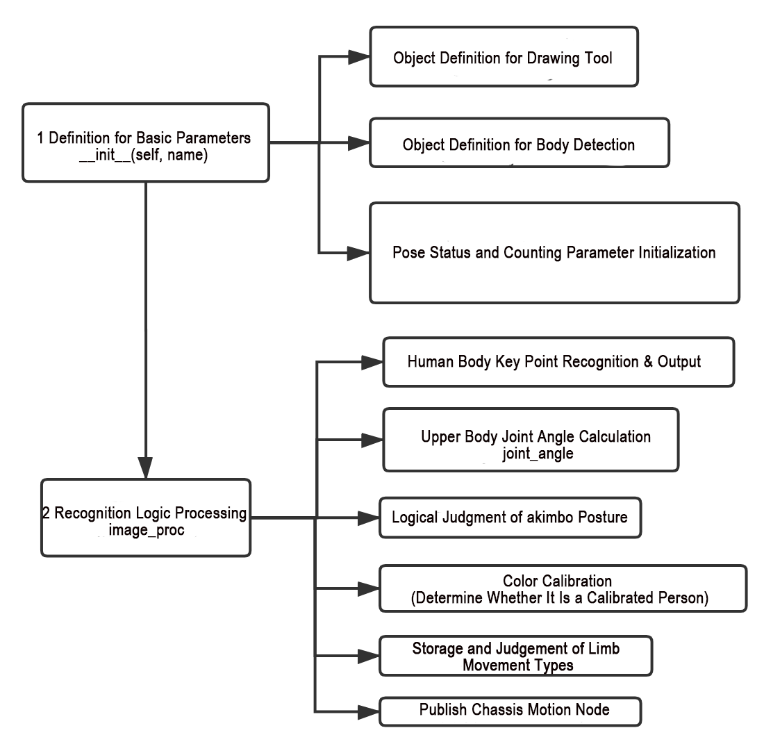

The program’s logic flowchart, derived from the program files, is illustrated below:
As shown in the above diagram, the program first uses the initialization function of the BodyControlNode class to set the default values for the relevant parameters. This primarily includes defining the drawing tool object, the limb detection object, and initializing the posture state and count parameters. After this setup, the program can logically process the incoming images. It begins by identifying and outputting key body feature points, calculating joint angles from the obtained (arm) parameters to mark the hands-on-hips posture. Then, it matches colors based on the recognized key feature points to determine if the person has been previously marked. Finally, the program controls the movement of the vehicle by recognizing demonstration actions (raising an arm, lifting a leg).

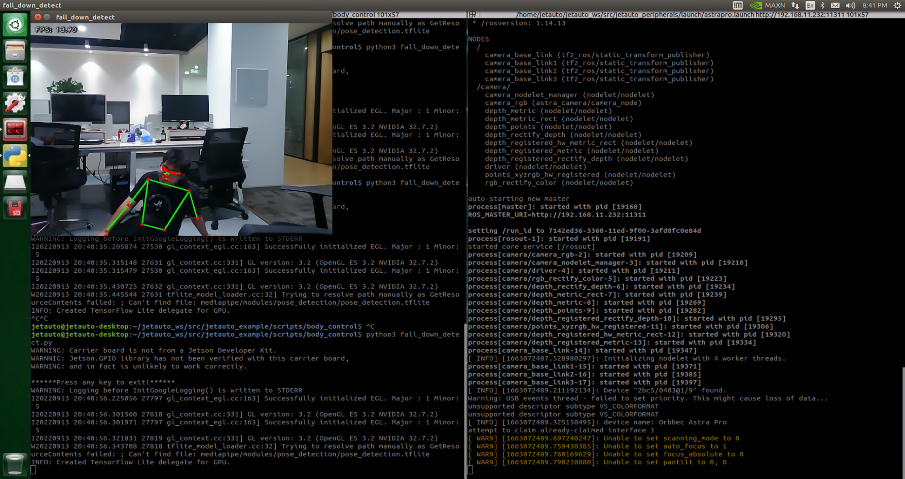

  • Operation Steps
ros2 launch example fall_down_detect.launch.py
(5) If you need to close this game, you need to press the “Esc” key in the image interface to exit the camera image interface.
  • Program Outcome
Once the game starts, ensure the human body remains as fully within the camera’s field of view as possible. Upon recognizing the human body, the key points will be highlighted in the returned image.
At this point, the individual can sit down briefly. Upon detecting the “falling” posture, the robot will continuously sound an alarm and make repeated forward and backward movements as a reminder.

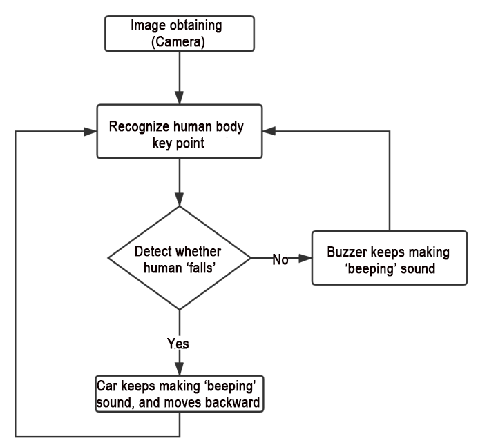

Based on the game’s effectiveness, the procedural logic is delineated as follows:
The car captures images via the camera, identifies the key feature points of the human body, and assesses whether the current posture indicates a “fall”. If a fall is detected, the car’s buzzer will emit a continuous “beep” sound while the car moves backward. Otherwise, the buzzer will only emit a single “beep” sound.
The program logic flow chart obtained from the program files is depicted in the figure below.
(1) Function
Main:
202
203
204
205
def main():
    node = FallDownDetectNode('fall_down_detect')
    rclpy.spin(node)
    node.destroy_node()
Used to start the body sensation control node.
get_joint_landmarks:
def get_joint_landmarks(img, landmarks):
    将landmarks从medipipe的归一化输出转为像素坐标(Convert landmarks from medipipe's normalized output to pixel coordinates)
    :param img: 像素坐标对应的图片(picture corresponding to pixel coordinate)
    :param landmarks: 归一化的关键点(normalized keypoint)
    :return:
    h, w, _ = img.shape
Used to convert the recognized information into pixel coordinates.
height_cal:
61
def height_cal(landmarks):
    y = []
    for i in landmarks:
        y.append(i[1])
    height = sum(y)/len(y)
    return height
Calculates the height of the limbs based on the recognized information.

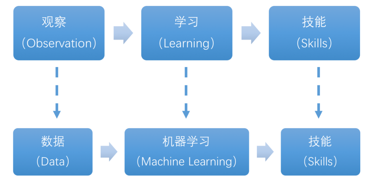

7.2.1 Machine Learning Introduction
  • What “Machine Learning” is
Machine Learning forms the cornerstone of artificial intelligence, serving as the fundamental approach to endow machines with intelligence. It spans multiple interdisciplinary fields such as probability theory, statistics, approximation theory, convex analysis, and algorithm complexity theory.
In essence, machine learning explores how computers can acquire new knowledge or skills by mimicking human learning behaviors and continuously enhancing their performance by reorganizing existing knowledge structures. Practically, it entails utilizing data to train models and leveraging these models for predictions.
For instance, consider AlphaGo, the pioneering artificial intelligence system that triumphed over human professional Go players and even world champions. AlphaGo operates on the principles of deep learning, wherein it discerns the intrinsic laws and representation layers within sample data to extract meaningful insights.

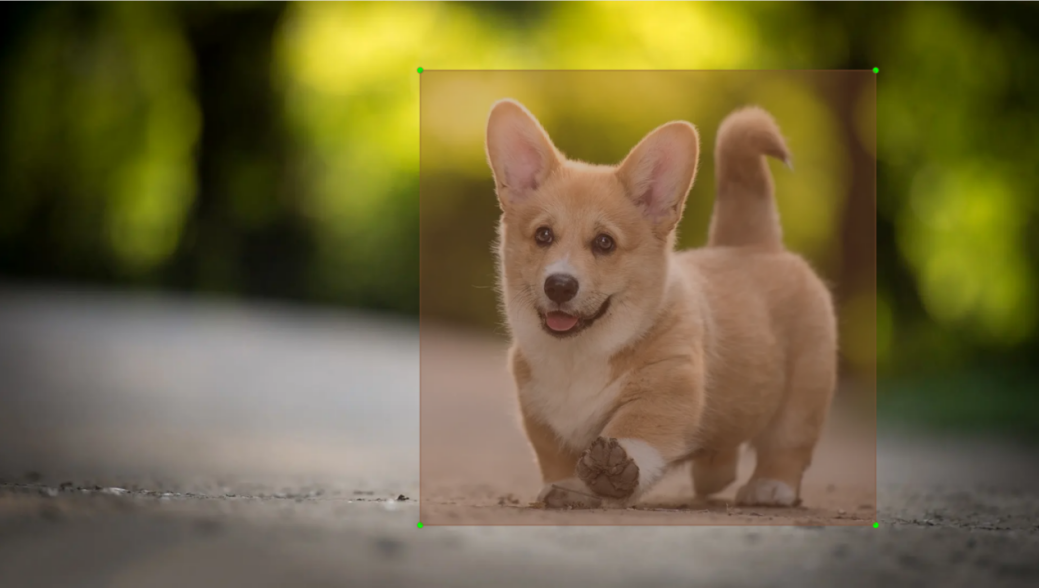

Supervised learning involves providing a labeled dataset to the algorithm, where the correct answers are known. The machine learning algorithm uses this dataset to learn how to compute the correct answers. It is the most commonly used type of machine learning.
For instance, in image recognition, a large dataset of dog pictures can be provided, with each picture labeled as “dog”. This labeled dataset serves as the “correct answer”. By learning from this dataset, the machine can develop the ability to recognize dogs in new images.

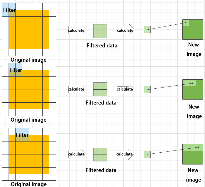

① Convolution layer: extract features of the image
Convolution refers to the effect of a phenomenon, action or process that occurs repeatedly over time, impacting the current state of things. Convolution can be divided into two components: “volume” and “accumulation”. “Volume” involves data flipping, while “accumulation” refers to the accumulation of the influence of past data on current data. Flipping the data helps to establish the relationships between data points, providing a reference for calculating the influence of past data on the current data.
During convolution, the periphery of the image may remain unchanged or be expanded as needed, and the convolution result is then placed back into the corresponding position in the image. For instance, if an image has a resolution of 6×6, it may be first expanded to a 7×7 image, and then substituted into the convolution kernel for calculation. The resulting data is then refilled into a blank image with a resolution of 6×6.

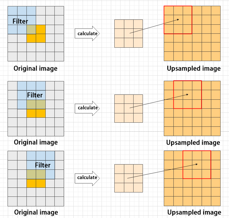

③ Upsampling layer: restore the size of an image
For example, let’s consider an image with a resolution of 6×6 pixels. Before upsampling, use 3X3 filter to calculate the original image so as to get the new image.

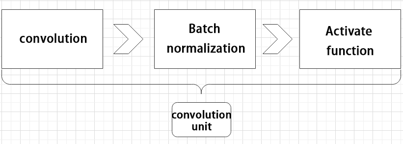

① Convolutional unit:

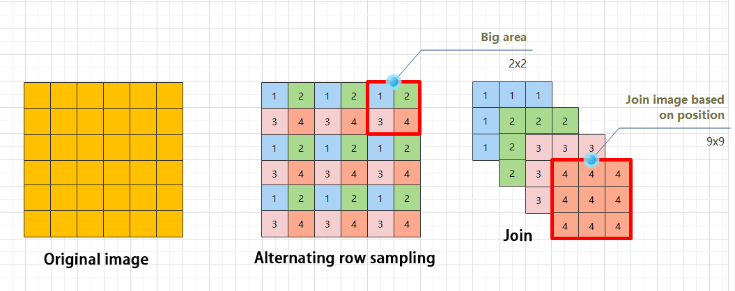

② Focus module
The Focus module for interleaved sampling and concatenation first divides the input image into multiple large regions and then concatenates the small images at the same position within each region to break down the input image into several smaller images. Finally, the images are preliminarily sampled using convolutional units.
As shown in the figure below, taking an image with a resolution of 6×6 as an example, if we set a large region as 2×2, then the image can be divided into 9 large regions, each containing 4 small images.
By concatenating the small images at position 1 in each large region, a 3×3 image can be obtained. The small images at other positions are similarly concatenated, and the original 6×6 image will be broken down into four 3×3 images.

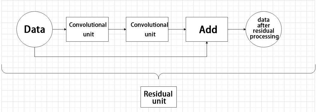

③ Residual unit
The function of the residual unit is to enable the model to learn small changes in the image. Its structure is relatively simple and is achieved by combining data from two paths.

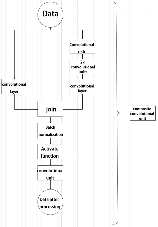

④ Composite Convolution Unit
The first path only has one convolutional layer for sampling, while the second path has 2x+1 convolutional units and one convolutional layer for sampling. After sampling and splicing, the data is organized through batch normalization and then activated by an activation function. Finally, a convolutional layer is used for sampling.’

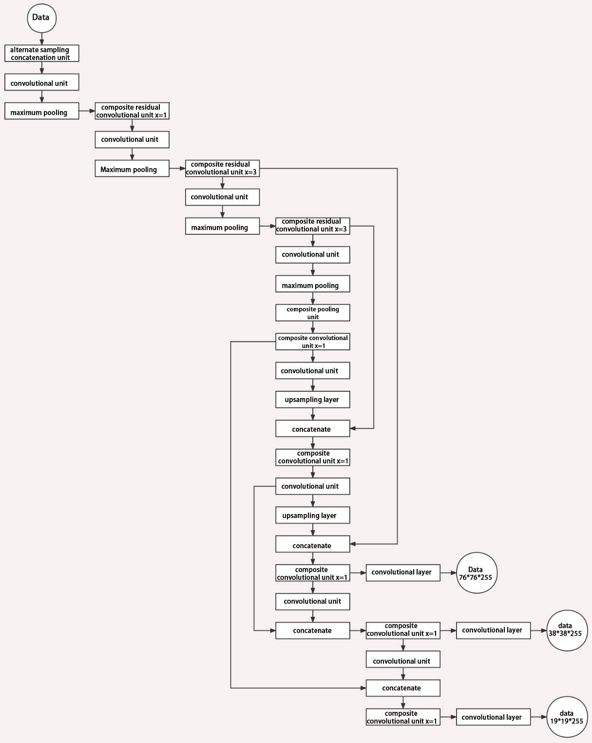

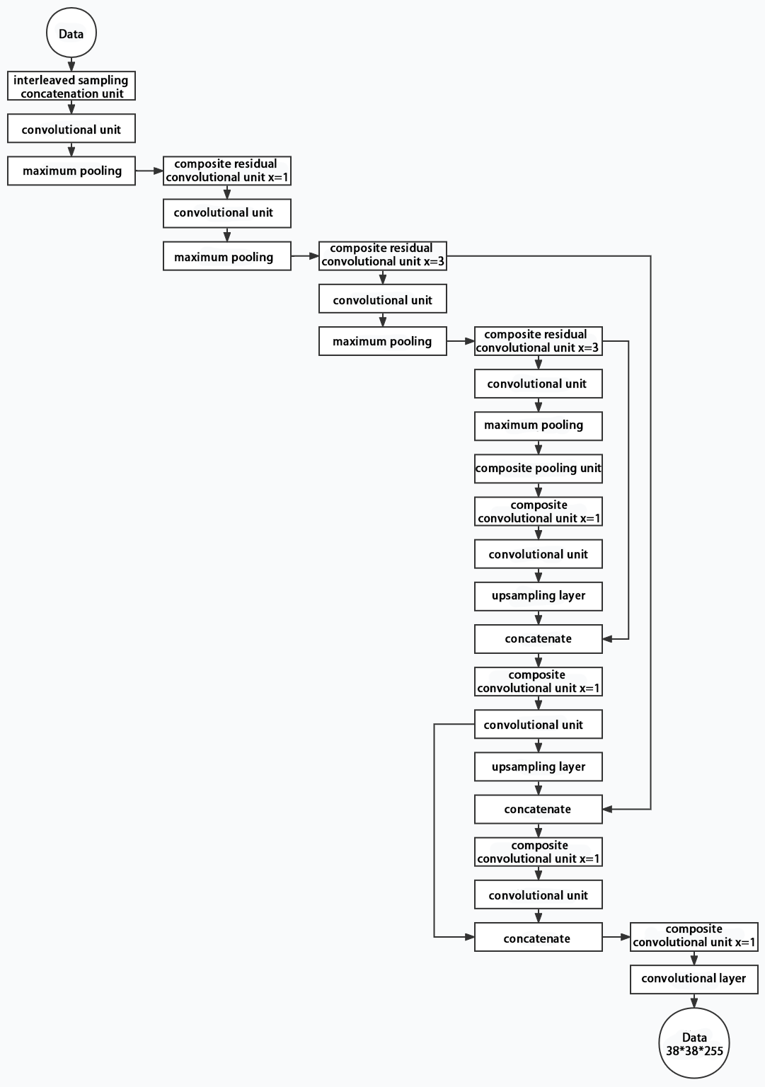

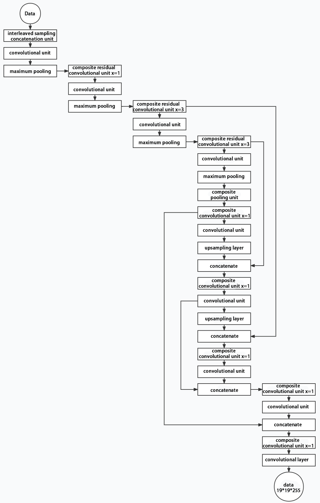

(3) Structure
Composed of three parts, YOLOv5 can output three sizes of data. Data of each size is processed in different way. The below picture is the output structure of YOLOv5.
2 3

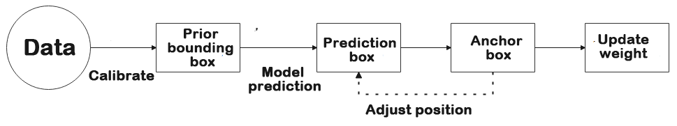

  • Prior Bounding Box
  • Prediction Box
  • Anchor Box
The generation position of anchor box is determined by prediction box. In order to influence the position of the next generation of the prediction box, the anchor box is generated at the relative center of the existing prediction box.
  • Realization Process

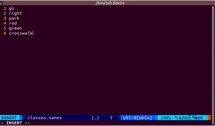

7.2.5 Image Collecting & Labeling
Given that training the Yolov5 model necessitates a substantial volume of data, our initial step involves collecting and labeling the requisite data in preparation for subsequent model training.

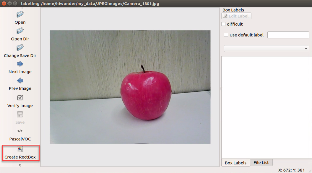

To begin, you can assemble the images that require collection. As an illustration, let’s consider the collection of traffic signs.

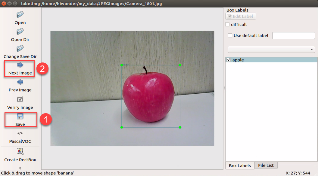

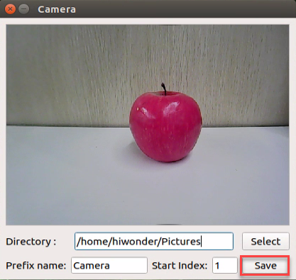

  • Image Collecting
(3) Execute the command below and hit enter to terminate the app auto-start service.
(4) Run the following command to initiate the depth camera service.
(5) Open a new command-line terminal, enter the command, and press Enter to create a new directory for storing the dataset:
mkdir -p ~/my_data
(6) Execute the following command to open the image collecting tool.
IMG_256

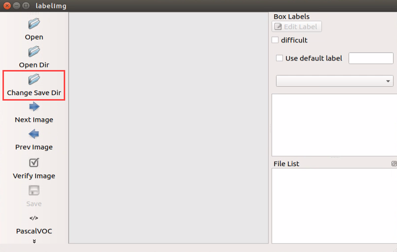

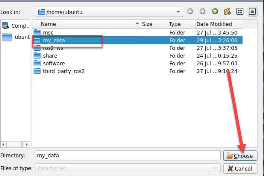

The “save number” displayed in the upper left corner represents the image ID, indicating the order in which images are saved. The term “existing” denotes the total number of images already saved.

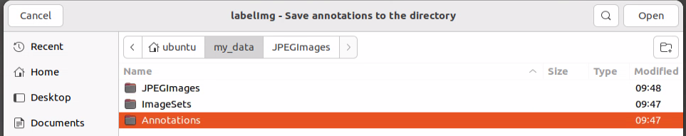

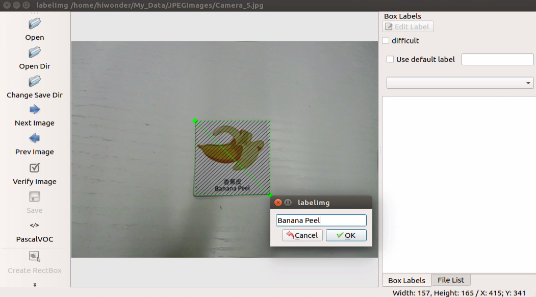

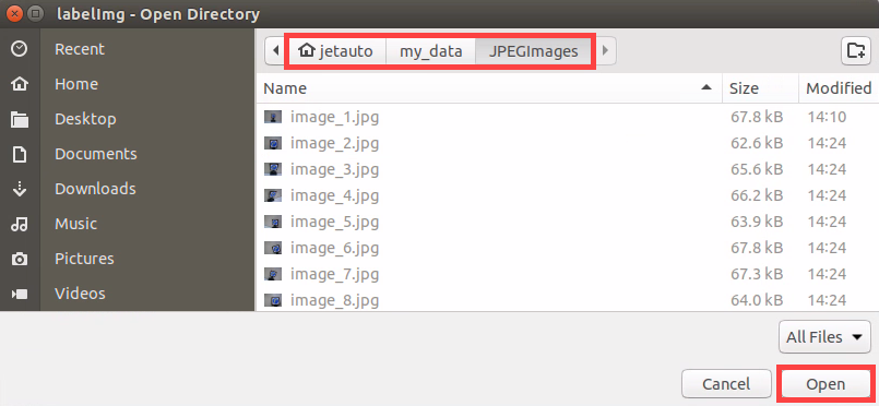

(7) Change the storage path as pictured.
(8) After selecting the corresponding directory, click-on ‘Choose’ button.
(9) Place the object you want to recognize within the camera’s field of view. Click the ‘Save (space)’ button or press the Spacebar to capture and save the current image from the camera.
After clicking ‘Save (space)’ or pressing the Spacebar, a folder named JPEGImages will be automatically created in the /home/ubuntu/my_data directory to store the images.
To enhance model reliability, capture target recognition content from various distances, rotation angles, and tilt angles.
(10) Once you have finished collecting the images, click-on ‘Quit’ button to close the software.
(11) Finally, press Ctrl+C in all the open command line terminals to exit. This completes the image collection process.
