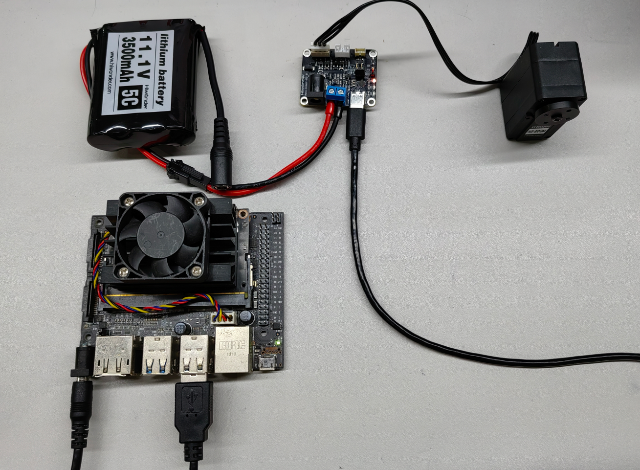

5.1.1 Wiring Instruction
This example uses a Jetson Nano controller powered by a 5 V adapter. The bus servo is connected to the debugging board, which is powered by an 11.1 V lithium battery. Finally, the debugging board is connected to any USB port of the Jetson Nano using a Type-C cable.

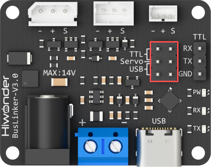

Before running this example, ensure that the jumpers on the debugging board are installed on the Servo and USB pins. Otherwise, communication will not function properly.

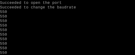

5.2.2 Reading the Servo Position
This example displays the bus servo position information through the terminal window.
5.2.2.1 Run Program
  1. Open a new terminal and enter the following command to navigate to the program directory:
cd Desktop/Demo/examples
  1. Run the program by entering:
python3 read_position.py
5.2.2.2 Program Outcome
After running the program, the terminal continuously prints the current position information of the servo.
