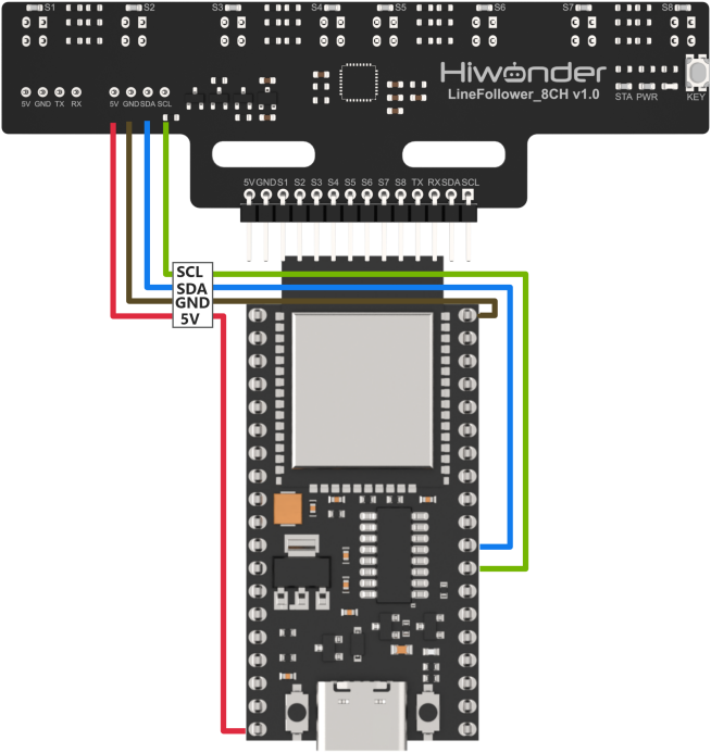

  • Wiring Instruction
Connect the 5V, GND, SDA, and SCL pins of the 8-ch Line Follower to the corresponding pins on the ESP controller. The wiring method is shown in the diagram below:
IIC IIC_IO
Before powering on, ensure that no metal objects are touching the controller. Otherwise, the exposed pins at the bottom of the board may cause a short circuit and damage the controller.

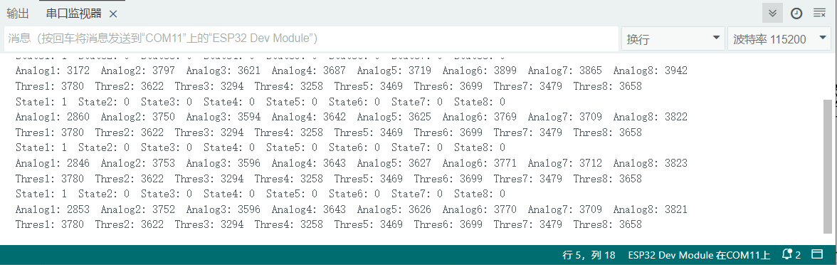

5.1.2 Test Case
This section uses the ESP32 controller to obtain the recognition results from the 8-ch Line Follower and print them through the serial port.
  • Project Outcome
Before recognition, you need to perform the one-click intelligent calibration for the sensor to ensure proper detection.
Once the 8-ch Line Follower detects the corresponding color of the line-following target, the serial port will print the status, analog values, and threshold values of each sensor. The printed data will appear as follows:

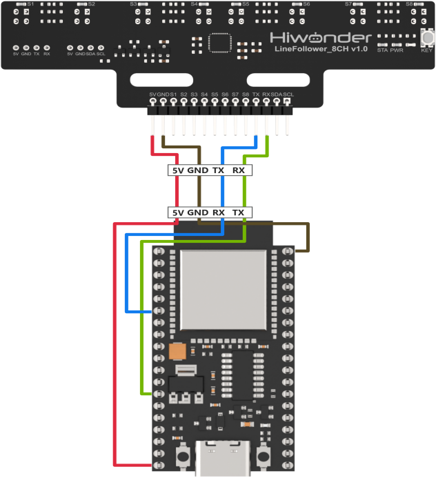

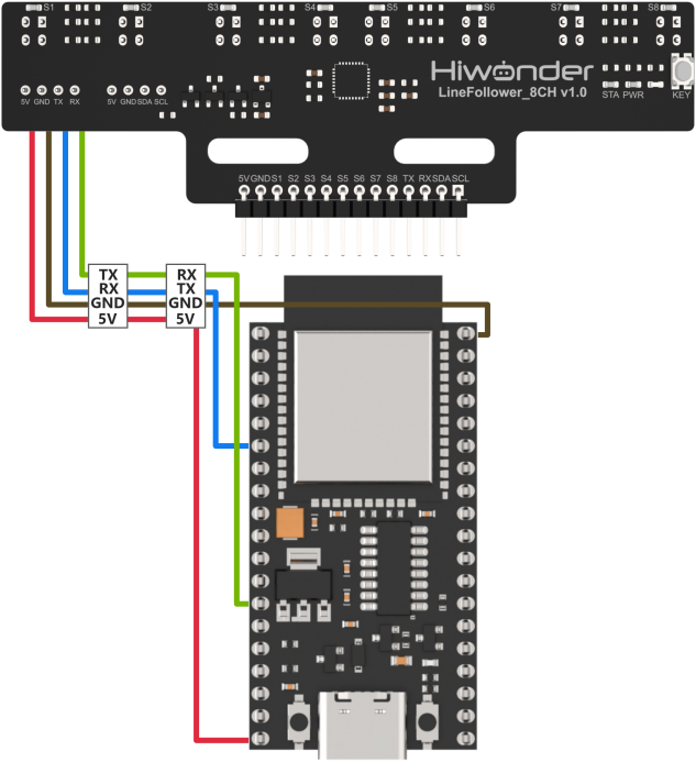

Connect the 5V, GND, TX, and RX pins of the 8-ch Line Follower to the corresponding pins on the ESP controller. The wiring method is shown in the diagram below:
UART UART_IO

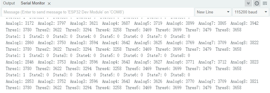

  • Project Outcome
