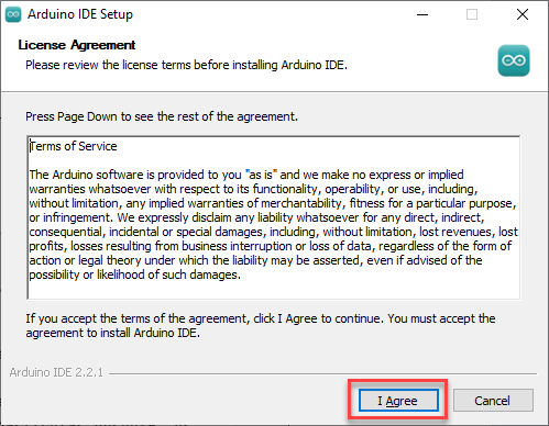

  1. Locate the ArduinoIDE installation package at the path Appendix\01 WonderLLM Development Environment Package\01 ArduinoIDE Installation Package, as shown below, and double-click to open. To download the latest version of the software, visit the official Arduino website: https://www.arduino.cc/en/software.
  2. Click I Agree to accept the license agreement to proceed with the installation.

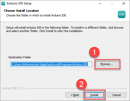

  1. Choose the desired installation path by clicking Browse. Click Install to begin installation.

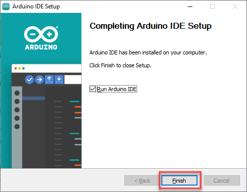

  1. Once installation is complete, click Finish to exit the installer.

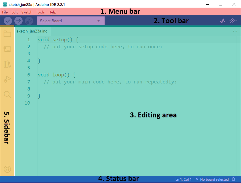

3.1.2 Arduino IDE Interface Overview
The main interface of the Arduino IDE is divided into five primary sections:
1.Menu Bar: provides access to key settings and configuration options for the Arduino IDE.
Icon Function
Create or open project files, and configure the interface preferences.
Editing options support commenting, indenting, searching, and text editing within the code.
Project options, used for configuring the entire project, compiling, running, and adding library files.
Tool options include the selection of development board and port, as well as access to board information.
Help options, such as getting started assistance and solving common issues.
  1. Toolbar: contains essential tools for project development, including program compilation, uploading, and serial monitoring.
Icon Function
Verify, check if the program is written correctly. If correct, compile the project.
Download, upload the program to the Arduino controller.
Debug, some development boards allow real-time debugging via Arduino IDE.
Select Board, choose a different development board for the project development.
Serial Plotter, visualize data printed to the Arduino serial port in a graph.
Serial Monitor, print serial information.
  1. Editor Area: The primary area for editing code.
  2. Status Bar: Displays relevant editor and project information, such as cursor position, controller selection, and other status indicators.
  3. Sidebar: A key component of the Arduino IDE, providing tools for file management, code debugging, and library installation.
Icon Function
Project Folder, displays the files of the current project.
Board Manager, add development board tool packages.
Library Manager, add or remove library files for the program.
Debug, real-time debugging of the project.
Search, search or replace code or variables.

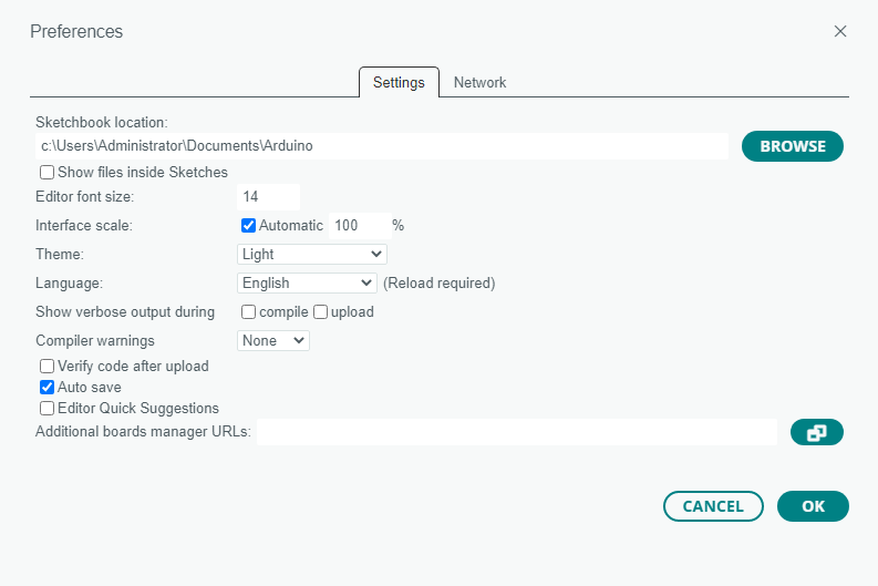

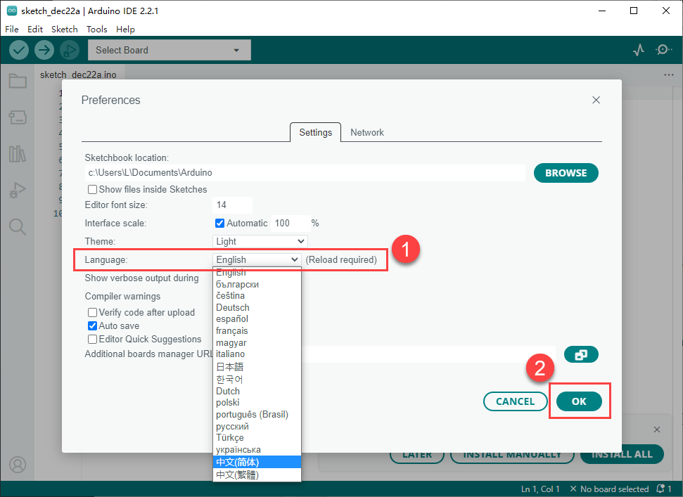

3.1.3 Arduino IDE Interface Settings
  1. Change to the English interface: In the Arduino IDE interface, select File -> Preferences, in the pop-up window, under the language option, select English, then click OK.
  2. Modify project file paths, editor text size, color theme, and other settings by selecting File -> Preferences and adjusting them in the pop-up window.

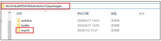

  1. If a previous version of the ESP32 package is installed and it is not version 2.0.12, please follow Step 2 to delete it. If no version has been installed, directly skip to Step 3 to begin the installation.
  2. Deletion method: In the file manager address bar, enter %LOCALAPPDATA%/Arduino15/packages, press Enter to access the folder, then delete the “esp32” folder inside.
  1. Finally, double-click the esp32_package_2.0.12_arduinome.exe file located in Appendix\01 WonderLLM Development Environment Package\02 ESP32 Module Firmware Package, and wait for the installation to complete.

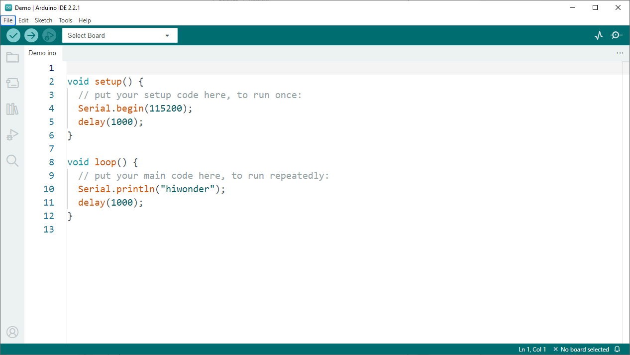

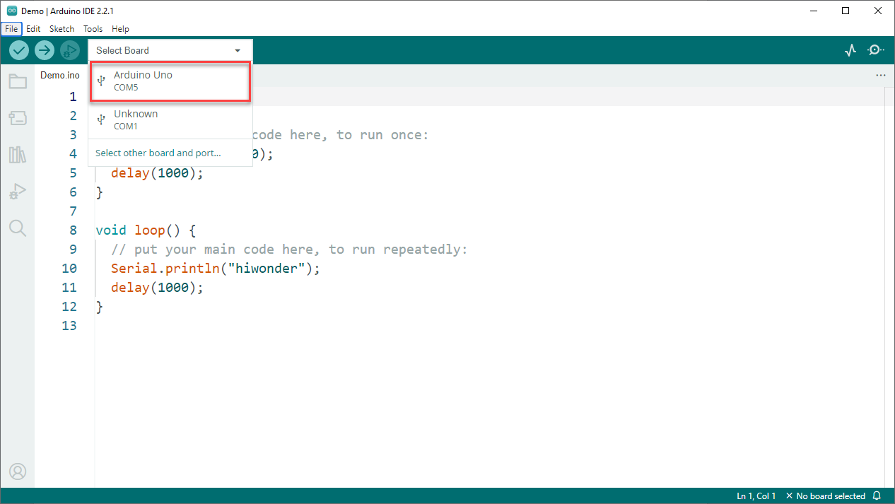

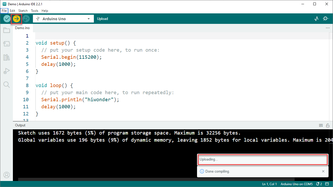

3.1.5 WonderLLM Program Download

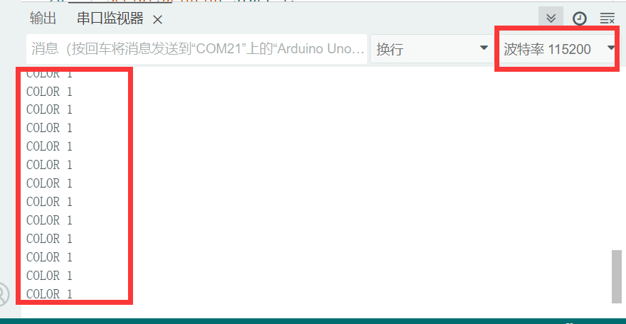

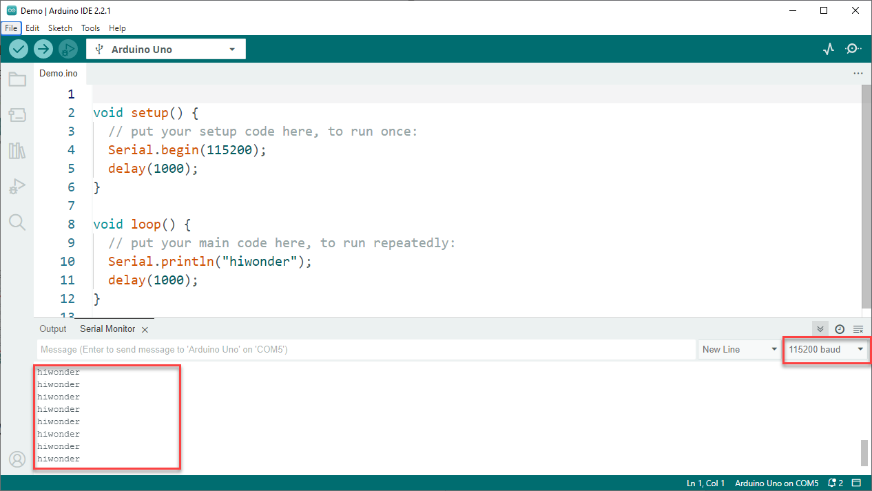

  1. This section demonstrates how to upload a simple program that prints the text hiwonder. Double-click to open the 03_Demo.ino example program located in Appendix\01 WonderLLM Development Environment Package\03_Demo.
  2. Connect the ESP32 core board to the computer using a data cable.

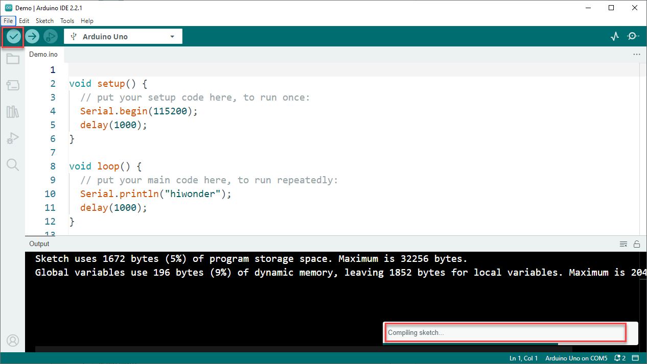

  3. From the Select Controller menu, choose the appropriate controller type. The COM port is not fixed. Check the COM number through the Device Manager on the computer. COM6 is used as an example here.
  4. Click the button to compile the sketch and check for syntax errors or other issues.
  5. After a successful compilation, click the button to upload the program to the ESP32 core board.
  6. After uploading, click and open the Serial Monitor. The text hiwonder should appear, confirming that the program is running correctly.

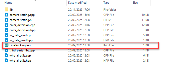

3.2.2 Program Download
  1. Connect the WonderLLM to the computer using a Type-C cable via the Type-C interface on the top of the module.
  2. Open the program Appendix\03 WonderLLM Program\APCameraWebServer\APCameraWebServer.ino.
  3. Select the development board ESP32S3 Dev Module.

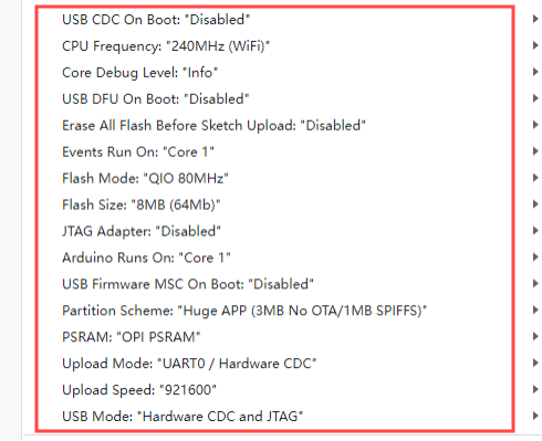

  1. In the menu bar, click Tools, and choose the corresponding ESP32S3 controller configuration as illustrated.
  1. Click to download the program to the WonderLLM and wait for the download to complete.

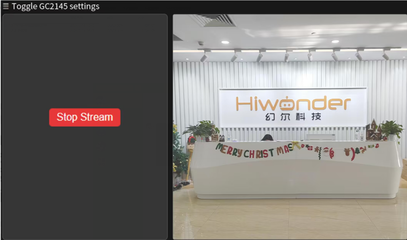

  1. After the program download is complete, connect to and locate the hotspot generated by the WonderLLM module: HW_ESP32S3CAM
  1. This procedure applies to both mobile and PC browsers, with PC used as an example. In the browser’s address bar, enter 192.168.5.1 and press Enter. On the opened page, click the button to enter the camera transmission interface
3.2.4 Project Outcome
Connect to the hotspot generated by the WonderLLM vision module and log in to a fixed URL to view the real-time video feed from the camera.

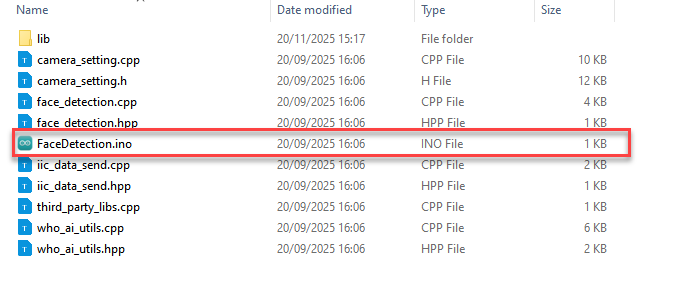

3.3.2 Program Download

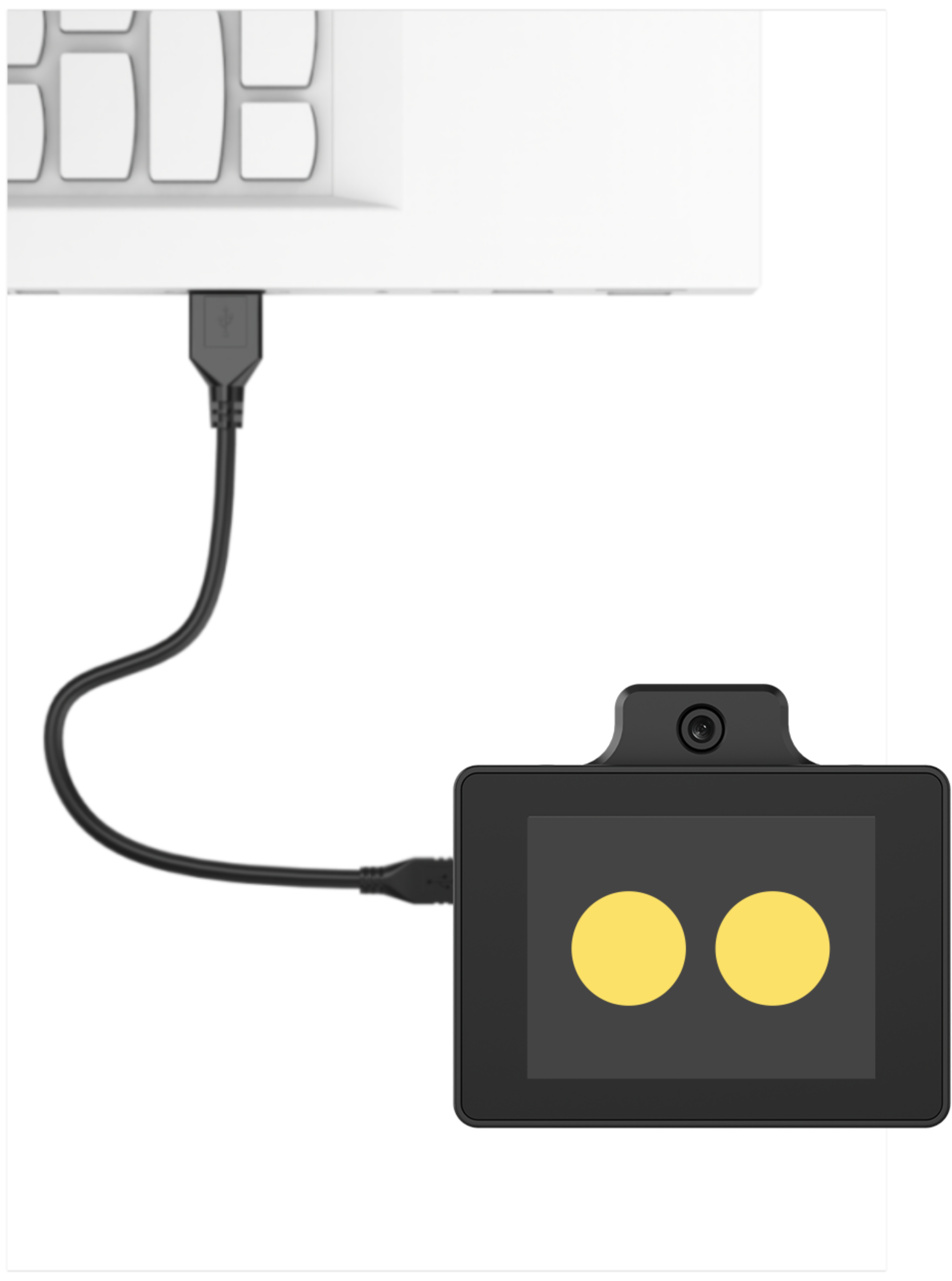

  1. Connect one end of the Type-C cable to the module and the other end to the computer’s USB port.
Open the Appendix\03 WonderLLM Program\ FaceDetection\ FaceDetection.ino file located in the same directory as this document.
  1. Select the development board “ESP32S3 Dev Module”.

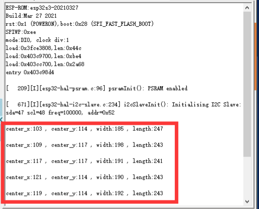

  1. Ensure that one end of the Type-C data cable is connected to the WonderLLM and the other end is connected to the USB port on the computer.
  2. Open the serial debugging tool located at the path “Appendix\02 Serial Debugging Tool”.
  3. Select the port, using COM11 as an example. Port number is not fixed. If it is COM1, do not select it as it is a system communication port. Set the baud rate to 115200.
  4. Click the button in the top-left corner of the page to open the serial communication. After WonderLLM recognizes a face, it will print the coordinates of the face in the serial monitor.
    For example:
    If the received data is center_x:103, center_y:114, width:185, length:247, it indicates that a face has been recognized. Here, center_x and center_y represent the top-left corner coordinates of the face bounding box, while width and length represent the width and height of the bounding box, with all units in pixels.

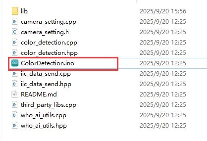

  2. Open the program Appendix\03 WonderLLM Program\ColorDetection\ColorDetection.ino.

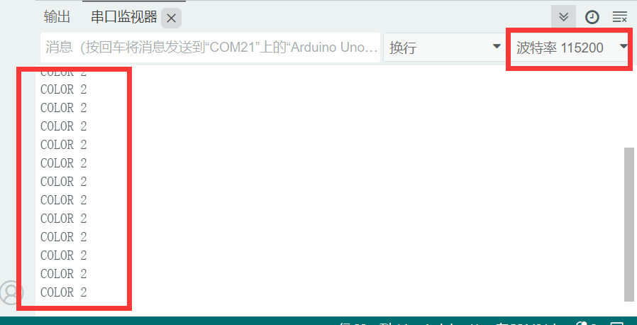

  1. Open the serial debugging tool located at the path “Appendix\02 Serial Debugging Tool”.
  2. Select the port, using COM9 as an example. Port number is not fixed. If it is COM1, do not select it as it is a system communication port. Set the baud rate to 115200.
  1. Click the button in the top-left corner of the page to open the serial communication. After the WonderLLM module recognizes the preset color, it will print the current recognized HSV color index in the serial monitor.
For example:
If color[0] is received, it indicates that the HSV color value of red has been recognized.

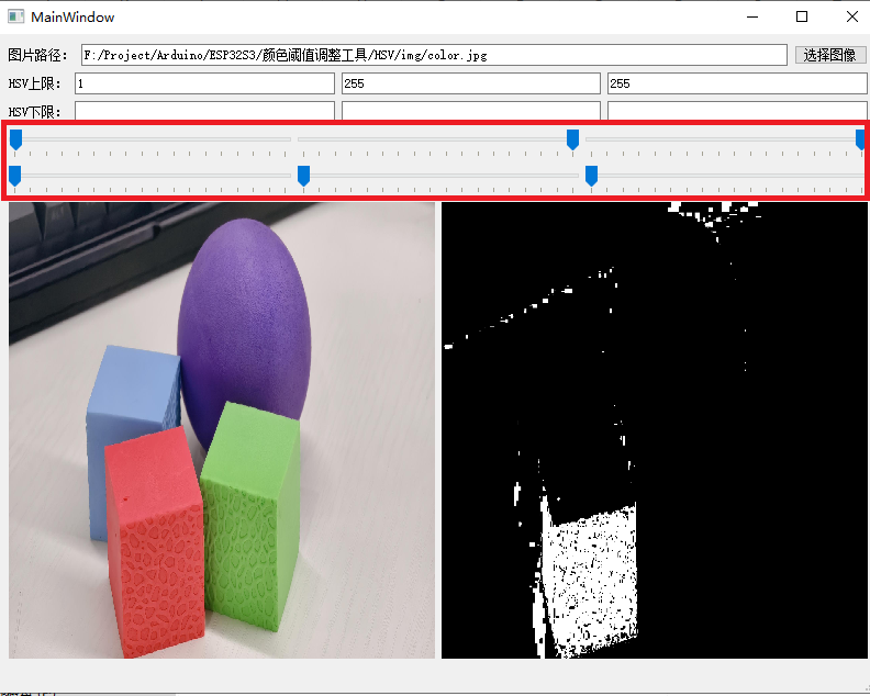

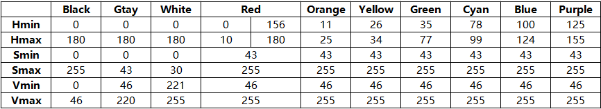

3.4.4Feature Extension
This section explains how to modify the colors recognized by WonderLLM. For specific modification details, refer to the following steps:
  1. Open the file “Appendix\08 Color Threshold Adjustment Tool\HSV\HSV.dist\HSV.exe” located in the same path as this document.
  1. Click the button to select image and import an image file.
  1. Use the sliders to perform HSV threshold segmentation on the image and adjust to the appropriate HSV threshold range. Refer to the color range table below for guidance.
  1. After saving the HSV threshold values, open the file “Appendix\03 WonderLLM Program\ColorDetection\color_detection.cpp” (line 67) located in the same path as this document. Modify the color data by changing it to the saved HSV array. Finally, refer to “3.4.2 Program Download” to flash the modified program into the WonderLLM module.
vector<color_info_t> std_color_info = {
    {{151, 15, 70, 255, 90, 255}, 64, "red"},
    {{23, 34, 70, 255, 90, 255}, 64, "yellow"},
    {{44,69,67,199,109,226}, 64, "green"},
    {{97, 117, 70, 255, 90, 255}, 64, "blue"},
    {{130, 155, 70, 255, 90, 255}, 64, "purple"}
Make sure that the array elements follow the correct format and are separated by commas.
  1. Once the flashing is complete, the WonderLLM camera will be able to recognize objects of other colors.

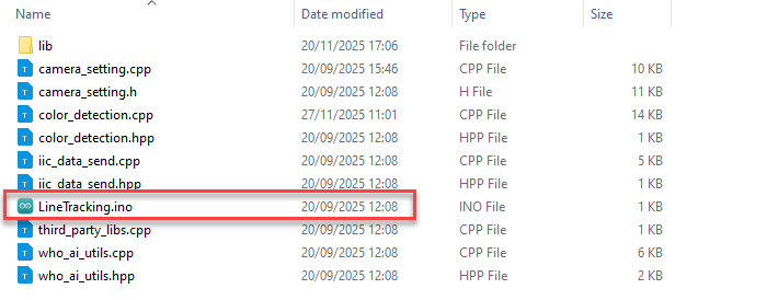

  2. Open the program Appendix\03 WonderLLM Program\LineTracking\LineTracking.ino.

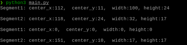

3.5.3 Feature Demonstration

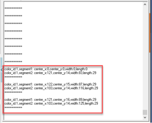

  1. Click the button in the top-left corner of the page to open the serial communication. When the WonderLLM module recognizes the preset line segments in several colors, it will print the parameters of the top and bottom recognition boxes in the serial monitor.
  • “==========” serves as a separator for each image recognition result.
  • Among the preset colors, only the line segment color data recognized by the module will be printed, to avoid excessive invalid data.
  • segment1 represents the recognition result of the top half of the image captured by the module, while segment2 represents the recognition result of the middle half of the captured image. The bottom half is not recognized by default.
For example:
If color_id:1 is received, it indicates that the HSV color value of green has been recognized.

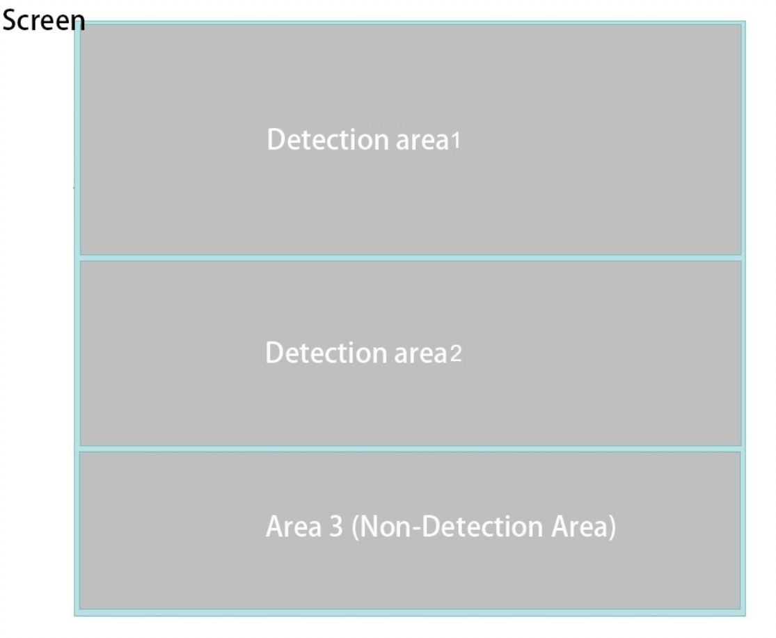

3.5.4 Working Principle
  1. As shown in the image above, this is a simple introduction to the visual line-following work area. When the module enters this mode, it divides the collected image into three regions from top to bottom for processing.
  2. The bottom region (Region 3) will not undergo any processing or recognition.
  3. The working mechanism of Detection Area 1 is identical to that of Detection Area 2. The process is explained below using Detection Area 1 as a representative example. In one detection area, the module will work according to the following logic:
(1) In one detection area, the module will by default recognize red, green, blue, and purple colors. Once recognized, it will frame the colored blocks in the image with boxes of the same color.
(2) In one detection area, only one recognition box will be drawn for each color. If multiple colored blocks of the same color appear at the same time, the module will default to recognizing and framing the largest area colored block in the image.
  • Each color-related visual line-following register records the center point coordinates, width, and height (in pixels) of the recognized colored blocks’ bounding boxes in Detection Area 1 or 2. These parameters, along with the module’s installation setup (such as module height and camera angle), can be used to design a mapping function between image coordinates and actual spatial coordinates, enabling the full implementation of the visual line-following features.
  • The module will simultaneously recognize the preset 4 colors within a detection area. Based on the line-following requirements (such as following the red line), read and process the corresponding color’s visual line-following register. The recognition of different colors will not interfere with each other.

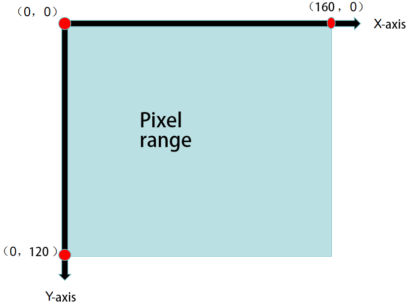

  • The x, y, w, h values represent the face detection bounding box in the original image: ① x-coordinate of the box center ② y-coordinate of the box center ③ Width of the bounding box ④ Height of the bounding box.
  • The above parameters are in pixels. For details on the pixel coordinate system in this mode, refer to “4. Module Coordinate System Description.”

  • The x, y, w, h color data in the table represent the following for the colored block recognition box marked by the module in the original image: ① x-axis coordinate of the center point ② y-axis coordinate of the center point ③ width of the recognition box ④ height of the recognition box

3.6.4 Module Coordinate System Explanation
  1. This section briefly introduces the image coordinate system design of the camera module when operating in different modes. Readers should understand this before studying the example routines.
  2. When port the example routines for secondary development, refer to this document and establish the mapping relationship between the module’s image coordinate system and the real-world coordinate system.
  3. Please note the important points of the module’s image coordinate system: ① The origin is not at the center of the screen, but at the top-left corner of the screen. ② The direction of the Y-axis is opposite to that of the Y-axis in the commonly used Cartesian coordinate system.

  • Line-following Recognition Mode
To ensure smooth image processing, the color recognition mode uses a resolution of 160×120, which is the value determined from Hiwonder’s internal testing.

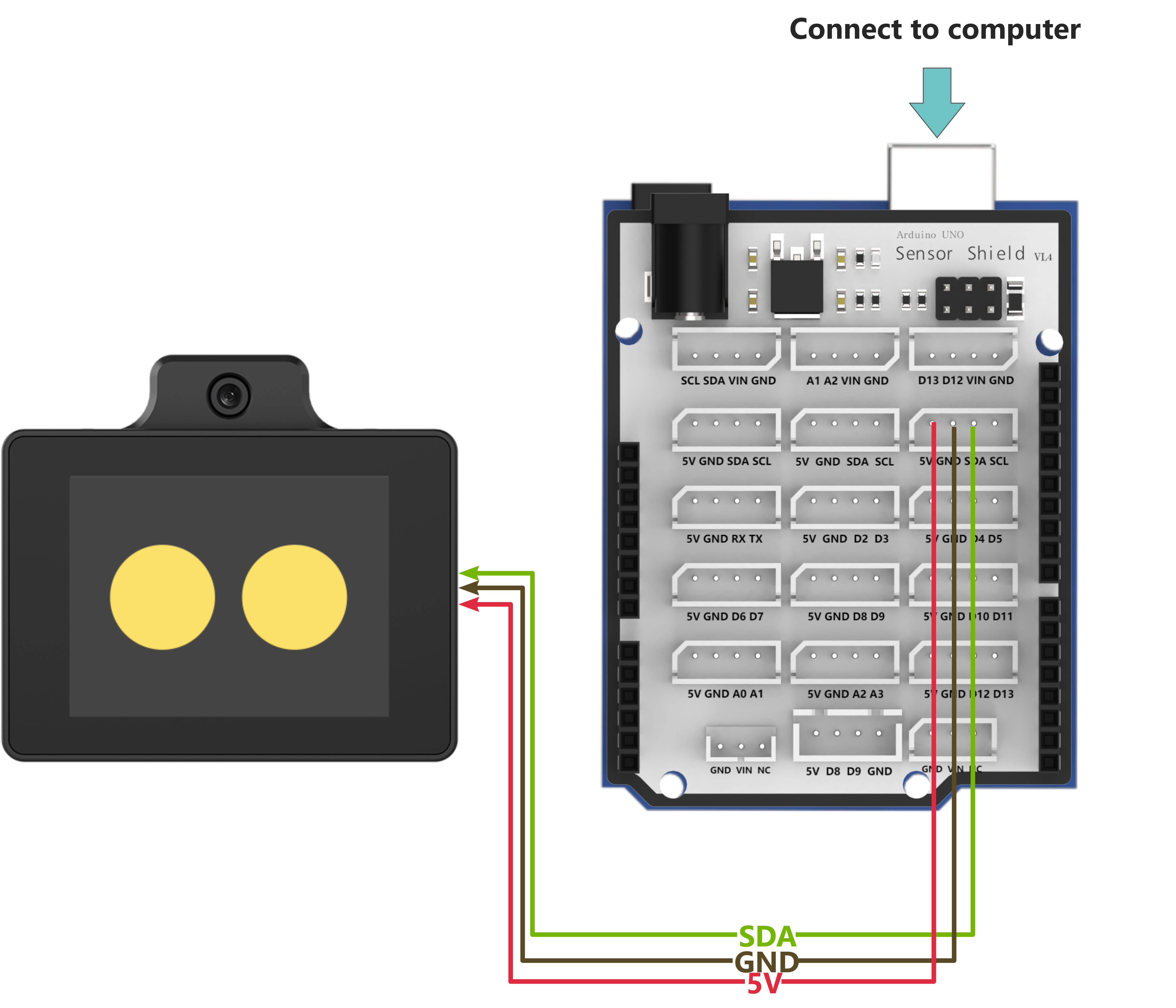

  • Implementation Flowchart

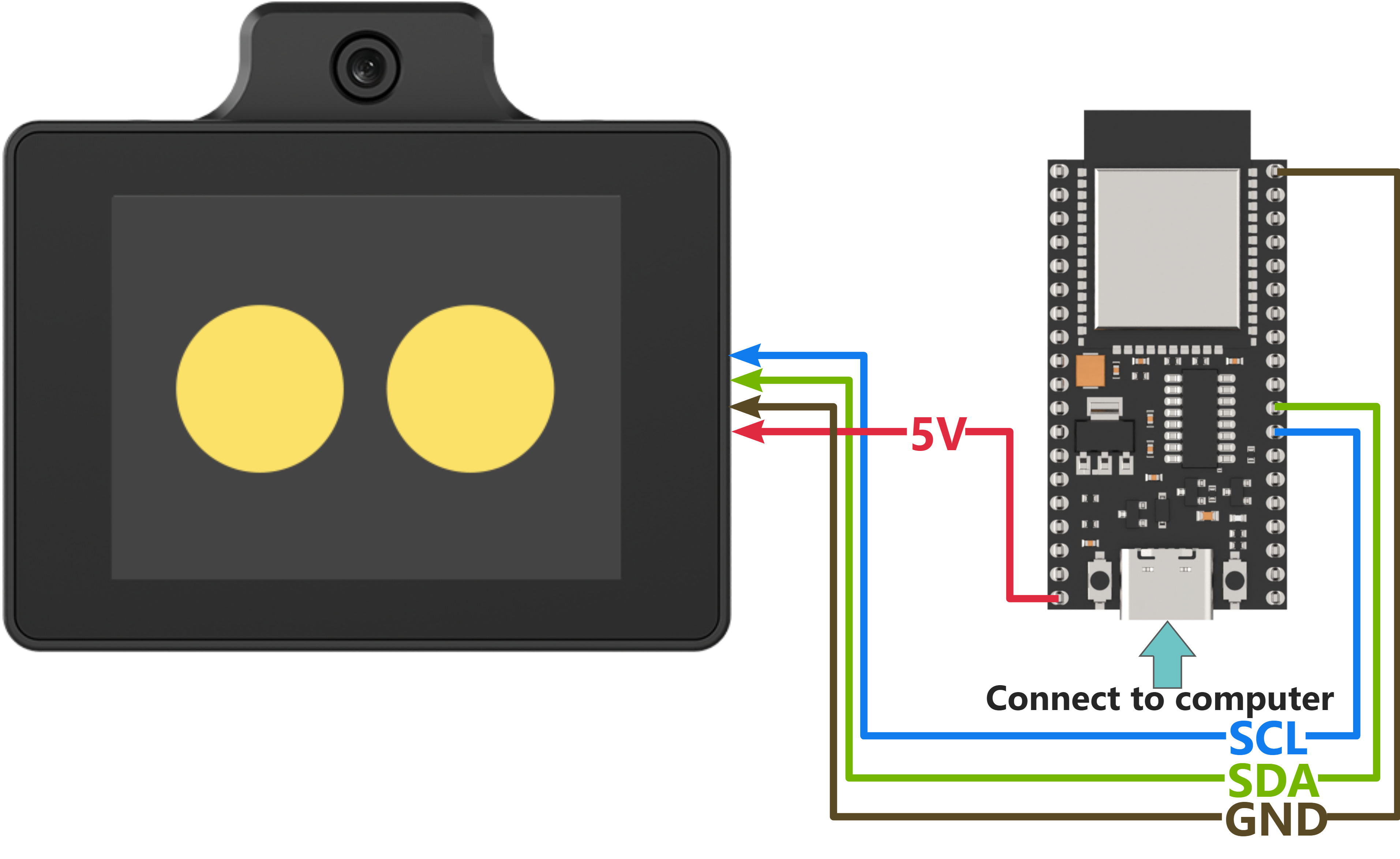

  • Sensor Wiring
    (1) When wiring, connect the WonderLLM’s 5V, GND, SCL, and SDA pins to the Arduino UNO development board as shown in the diagram below:
    (2) The Arduino UNO development board can be used with any of Hiwonder Arduino expansion boards, and the wiring with WonderLLM is shown below (using Board A as an example):
Note: Before powering on, ensure that no metal objects are touching the controller. Otherwise, the exposed pins at the bottom of the board may cause a short circuit and damage the controller.

(2) Connect the Arduino controller to the computer using a USB Type-B cable.
(3) Click the “Select Board” option. The software will automatically detect the connected Arduino serial port. Then click to connect it.
(4) Click to download the program to the Arduino and wait for the download to complete.
  1. WonderLLM Face Recognition Program Download
(1) Connect one end of the Type-C cable to the module and the other end to the computer’s USB port.
(2) Open the Appendix\03 WonderLLM Program\ FaceDetection\ FaceDetection.ino file located in the same directory as this)
(3) Choose the development board “ESP32S3 Dev Module”.
(4) In the menu bar, click Tools, and choose the corresponding ESP32S3 controller configuration as illustrated.
(5) Click to download the program to the WonderLLM and wait for the download to complete.

  1. Open the serial tool in the top-right corner of Arduino IDE , and set the baud rate to 115200.
  2. When WonderLLM does not detect a face, Arduino will print face 0 in the serial monitor.
  3. After detecting a face, the serial monitor will print find face and face 1.

(2) Open the program Appendix\03 WonderLLM Program\ColorDetection\ColorDetection.ino.

  • Project Outcome
  2. When WonderLLM detects red, it will print COLOR_1 in the serial monitor.
  1. When WonderLLM detects green, print COLOR_2 in the serial monitor.

(2) Open the program Appendix\03 WonderLLM Program\LineTracking\LineTracking.ino.
(3) Select the development board ESP32S3 Dev Module.

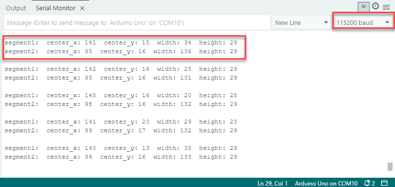

  • Project Outcome
  2. When WonderLLM detects a red line, it will print the recognition box parameters for the upper and middle sections of the image to the serial monitor. If not detected, the parameters will be all zeros.

(6) Finally, print all the parameters of the two red segment recognition boxes. If they are all 0, it indicates that no red segment was detected in this area.
  if(hw_cam.line_position(COLOR_red,line_info)){
    Serial.print("segment1:");      //Upper half area
    Serial.print("  center_x: ");
    Serial.print(line_info[0]);
    Serial.print("  center_y: ");
    Serial.print(line_info[1]);
    Serial.print("  width: ");
    Serial.print(line_info[2]);
    Serial.print("  height: ");
    Serial.println(line_info[3]);
    Serial.print("segment2:");      //Midlle half area
    Serial.print(line_info[4]);
    Serial.print(line_info[5]);
    Serial.print(line_info[6]);
    Serial.println(line_info[7]);
  }else{
    Serial.println("read failed");
  Serial.println();

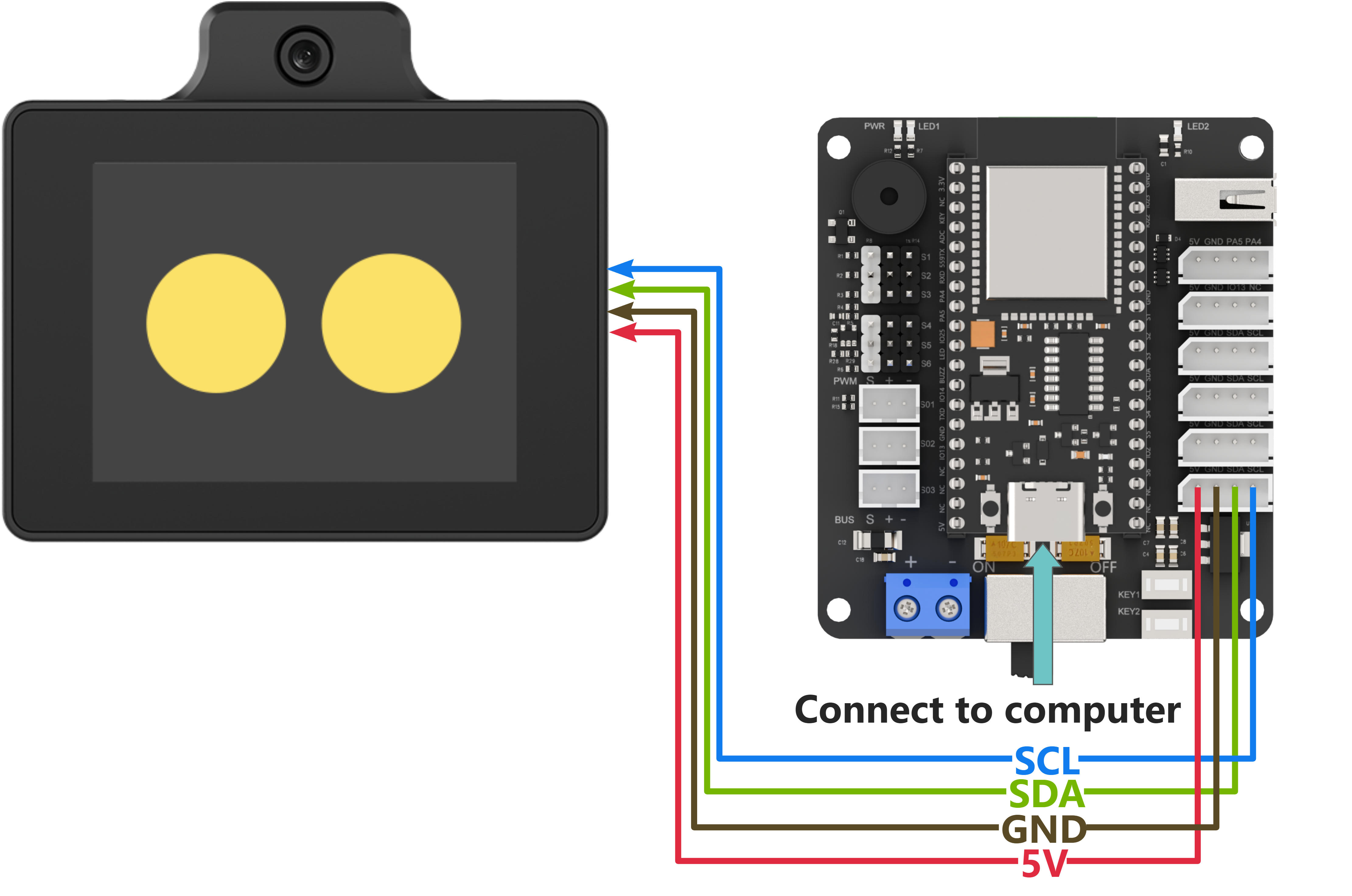

  • Wiring Instructions
MicroPython code can run on any microcontroller that supports MicroPython programming. This section uses Hiwonder ESP32 core board as an example.
  1. When wiring, connect the WonderLLM’s 5V, GND, SCL, and SDA pins to the ESP32 core board as shown in the diagram below:
  1. The ESP32 core board can be used in combination with Hiwonder open-source 6-channel servo controller, and the wiring to WonderLLM is shown in the diagram below:

  1. WonderLLM Color Recognition Program Download
Open the Appendix\ 03 WonderLLM Program\ ColorDetection\ ColorDetection.ino file located in the same directory as this document.
(3) Choose the development board ESP32S3 Dev Module.
  • Project Outcome
  1. When WonderLLM detects red, it will print COLOR_1 in the serial monitor.
  2. When WonderLLM detects green, print COLOR_2 in the serial monitor.

  1. WonderLLM Line-following Recognition Program Download
(1) Connect the WonderLLM to the computer using a Type-C cable via the Type-C interface on the top of the module.
  • Project Outcome
  • Program Brief Analysis
  1. Import Libraries
(1) Import the I2C module and the WonderLLM offline vision feature module hw_esp32cam_ctl.
from time import sleep_ms
from machine import Pin, I2C
from hw_esp32cam_ctl import HW_ESP32Cam
(2) Define the preset ID for red in the line-following recognition function, and store the parameters of two recognition boxes for one color segment in the list line_detect_result.
COLOR_red = 0
line_detect_result = [0] * 8
  1. Initial I2C
Initialize the I2C bus and pass the I2C bus handle. Instantiate the HW_ESP32Cam class as the object cam.
if __name__ == "__main__":
  iic = I2C(0, scl=Pin(23), sda=Pin(22), freq=100000)
  cam = HW_ESP32Cam(iic)
  sleep_ms(1000)
  1. Loop to Call Sub-functions
Call the line_position function to read the parameters of the two line-following recognition boxes for the red segment and print them on the screen.
    cam.line_position(COLOR_red,line_detect_result)
    print(f"Segment1: center_x:{line_detect_result[0]},  center_y:{line_detect_result[1]},  width:{line_detect_result[2]}, height:{line_detect_result[3]}\r\n")
    print(f"Segment2: center_x:{line_detect_result[4]},  center_y:{line_detect_result[5]},  width:{line_detect_result[6]}, height:{line_detect_result[7]}\r\n")
    sleep_ms(600)

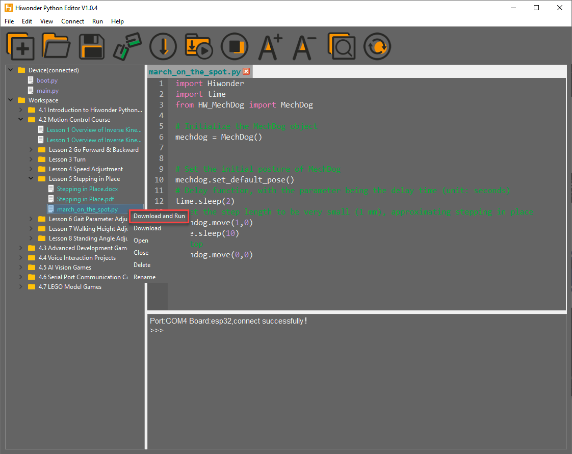

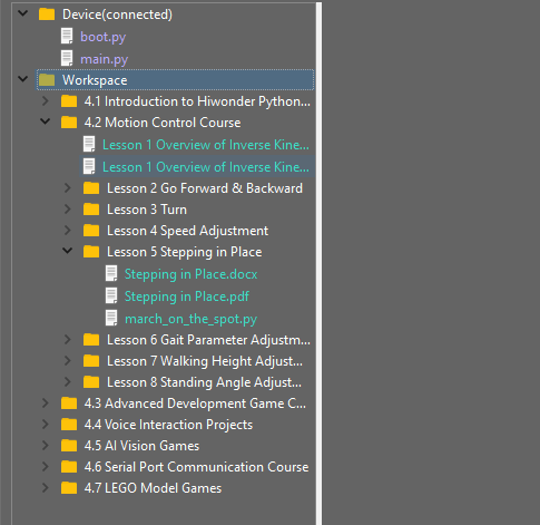

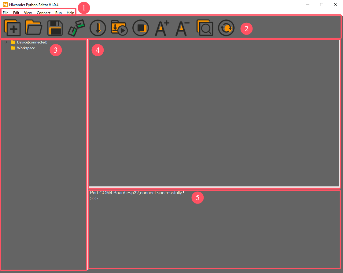

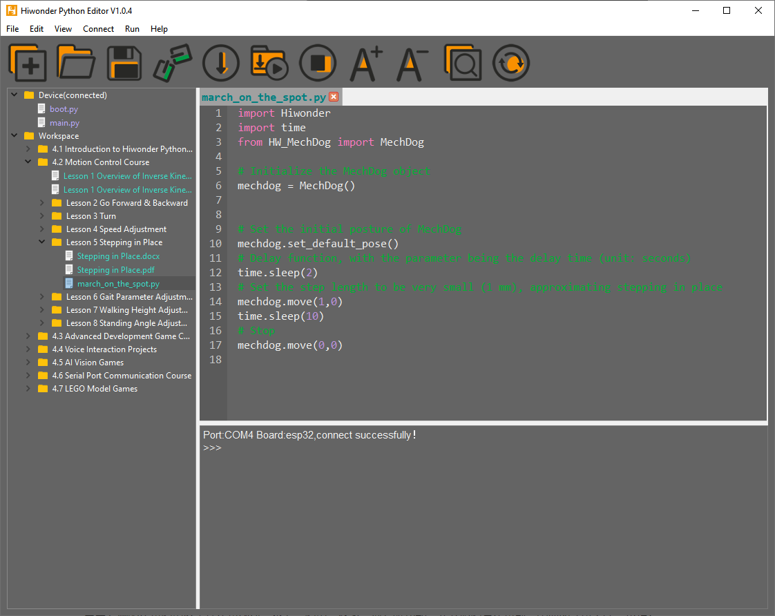

3.8.4 Hiwonder Python Editor
If the editor fails to open, rename the editor to a fully English name, such as “Hiwonder.”
  • Feature Introduction
  1. The current editor interface is divided into five parts, as shown in the image below:
  1. Each area has a corresponding function, as shown in the table below:
No. Function
1Menu BarIncludes File, Edit, View, Connect, Run, Help.
2ToolbarContains some commonly used shortcut keys, with the same functionality as some keys in the menu bar.
3File ListDivided into multiple project files within the device and local machine. Allows viewing of project file contents (folders, source code, etc.).
4Code EditorUsed for viewing and writing code.
5TerminalDisplays message logs and debugging information. When no device is connected, only message logs are displayed.
  • Operating Instructions

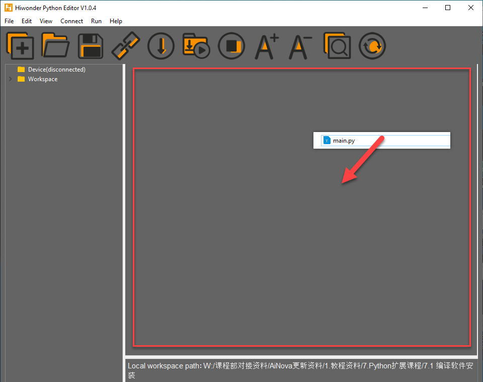

  1. Import Local Project

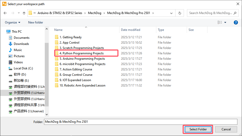

(1) When importing a local project for the first time, left-click on Local Projects to open the file selection list. (For subsequent imports, right-click on “Local Project -> Switch Project Path”).
(2) Select the folder where the MicroPython program is stored and click the Select Folder button.
(3) The files in the folder will be automatically added to the local project and can be viewed under Local Project.
Importing a local project means bringing files from the computer into the editor. It does not mean downloading them to the ESP32 Core Board.
  1. View Imported Files/Programs
Here, double-click the program file in the file list to view the detailed code. The example used here is march_on_the_spot.py:
Similarly, after downloading the program to the ESP32 board, double-click the file under the Device list to view it.
3 Code Writing and Saving
The code editing area on the right side of the interface supports creating, viewing, editing, modifying, and saving code. Before writing code, please read the following notes carefully:
(1) Users cannot create files directly under the Device tab. Files in Device can only be saved via download. To back up a file, first copy it into the Local Project.
(2) Do not modify action group files with the .rob suffix in the editor, as this may lead to format errors. To edit action group files, use the upper computer software.
(3) Among the provided low-level files, main.py is the device’s main program. All robot functions must be launched via this file. Reset and startup operations both rely on it. If main.py crashes, no other functions can be executed. To add functions to main.py, renaming the file first is safer. Even if the program hangs, shortcuts like Ctrl+C or Ctrl+D don’t respond, reset the board and re-download the program. This will restore normal operation.
4 Program Download and Execution
Downloading the program is an interaction between the editor and the device. The example used here is march_on_the_spot.py:
(1) After selecting the Hello.py file under the Local Projects tab, click the icon in the toolbar , or right-click the file and select Download and Run.
(2) View the download progress and completion status in the terminal window. The previous step selected Download and Run, so the program’s running effect can also be viewed.
(3) Once the download is complete, the program will appear in the file list under the Device tab.

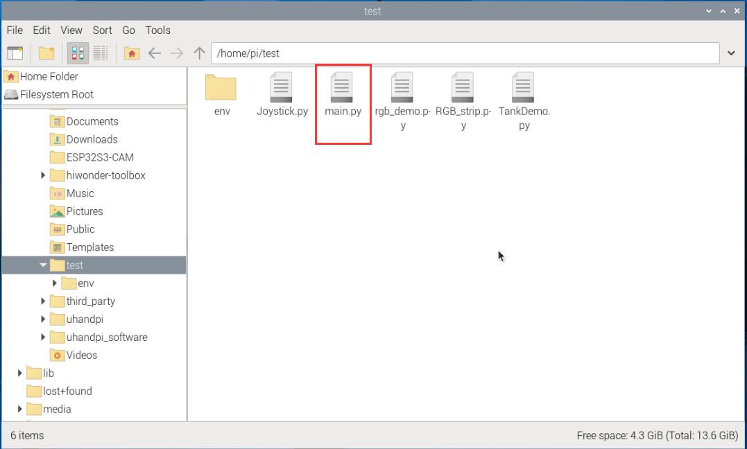

(4) Finally, delete the original main.py file and rename the downloaded change_speed.py to main.py.
(5) Additionally, there are a few points users should be aware of:
① Besides this download method, rename the file to main.py before downloading it.
② The Download and Run function first resets the device (reboots), then downloads and runs the program, which helps improve program stability.
③ If the program does not need to be executed immediately, click the button , or right-click the target file and select Download. Before executing the program, press the icon to reset the device, then execute the program.
  1. Terminal Usage (Debugging)
(1) The terminal is a functional area that combines both the information window and debugging interface. However, it should be noted that if the device is not connected, the terminal area can only be used for viewing information and cannot be used for editing or debugging.
(2) Regarding information viewing, this has already been experienced in previous steps, so it will not be discussed further. This section focuses on explaining the debugging functions.
① The terminal supports inputting code. Enter the code print(123) in the terminal and press Enter. The result will be as follows:
②Additionally, the terminal also supports auto-indentation. When typing Python statements that end with a colon, such as if, for, or while, and pressing Enter, the next line will automatically continue with the same indentation level as the current statement, or with an appropriate indentation level as required. Pressing the Backspace key undoes one level of indentation.
③ To copy and paste code, right-click the target code after selecting it in the terminal interface.
Please note that, because the terminal supports auto-indentation, before pasting code, press “Ctrl+E” to enter edit mode. Otherwise, indentation errors may occur during debugging.
④ Here’s an example of correct indentation after copying and pasting:
⑤ And here’s an example of incorrect indentation:
⑥ To exit the edit mode, press Ctrl+C. Additionally, if there is a dead loop, press Ctrl+C to exit..
  • In the terminal, the shortcut “Ctrl+C” is only used to interrupt a running program. It does not perform the copy function, and “Ctrl+V” does not paste.
  • When entering commands in the terminal, use the “Tab” key for code completion. For example, after typing “os” in the terminal and pressing “Tab”, the behavior is as follows: If there are two or more possible completions, the terminal will list all options. If there is only one possible completion, the terminal will complete it automatically. If there are no matches, nothing happens.
  • Use the Up (↑) and Down (↓) arrow keys in the terminal to browse through the command history, saving input time. For more commands and explanations, please visit:http://docs.micropython.org/en/latest/library/uos.html.

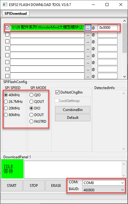

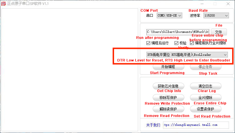

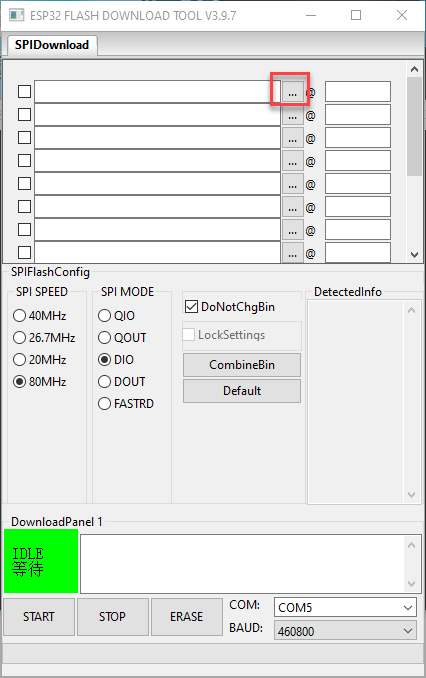

  1. Please open the flash_download_tool_3.9.7.exe file located in the “Appendix\10 ESP32 Core Board Firmware and Flashing Software\02 ESP32 Firmware Flashing Tool” folder.
  2. Select ESP32 as the Chip Type, leave the other settings as default, and then click OK.
  3. Once the tool is open, click to select the program .bin file to be flash (path: “03 ESP32 Development Board Firmware).
  4. On the left side, check the box, and configure the remaining settings as shown in the diagram. Select the COM port number corresponding to the module’s assigned port.
Setting the SPI MODE to DIO as shown in the diagram may cause the module to malfunction after flashing. Please try setting the SPI MODE to DOUT and flash the firmware again.
  1. First, click ERASE to erase the previously downloaded firmware. This step is necessary! Then wait for the status bar to display FINISH.
  2. Click START to download the newly selected firmware. Wait for the progress bar to complete, and the firmware download will be finished.
  1. After the download is complete, unplug and reconnect the data cable. Once the device powers on again, it will start operating according to the new firmware program.

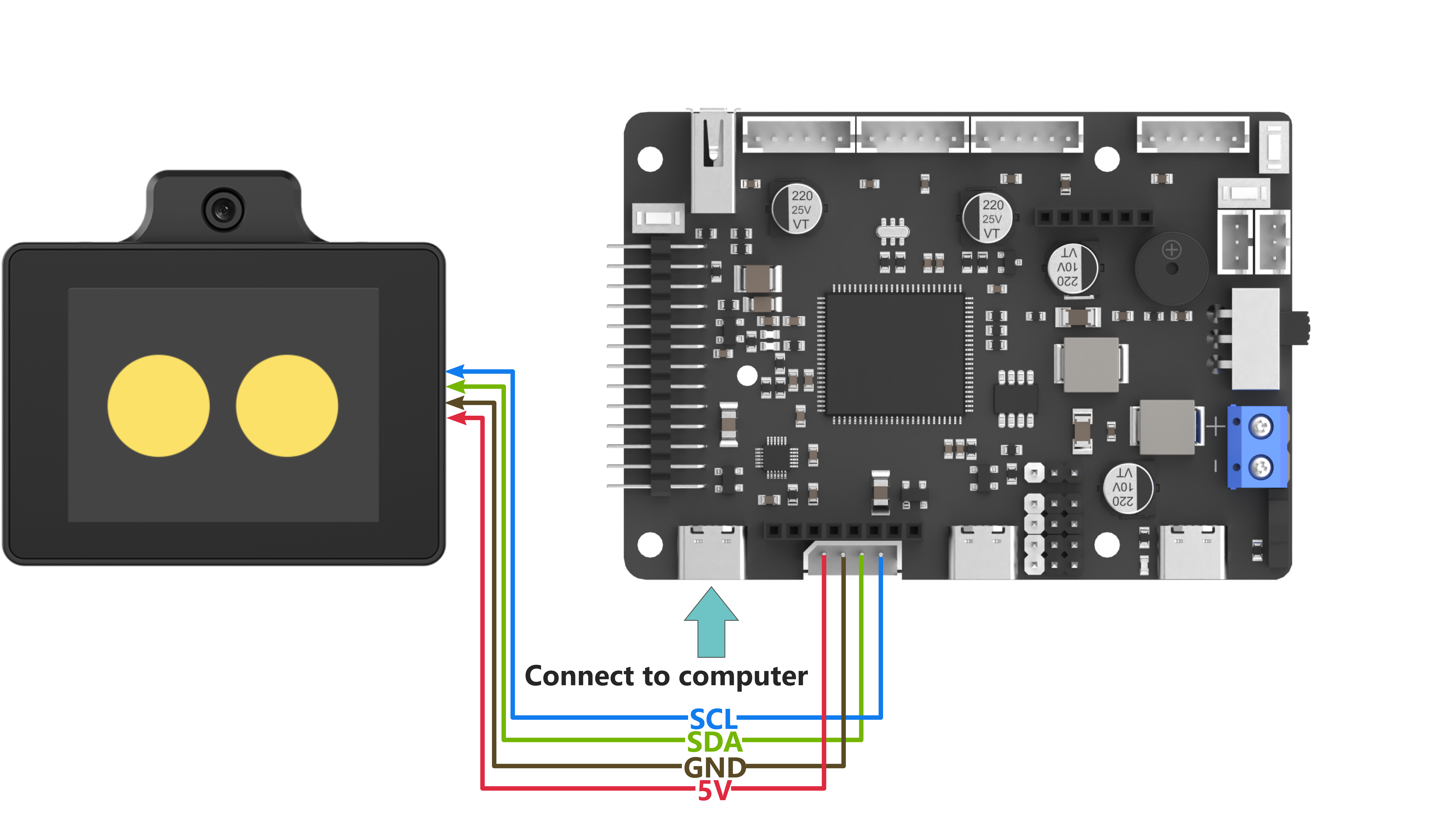

When wiring, the 5V, GND, SCL, and SDA pins of the WonderLLM module need to be connected to the STM32 development board. Using Hiwonder Ros Robot Controller v1.2 as an example. The wiring diagram is shown below:

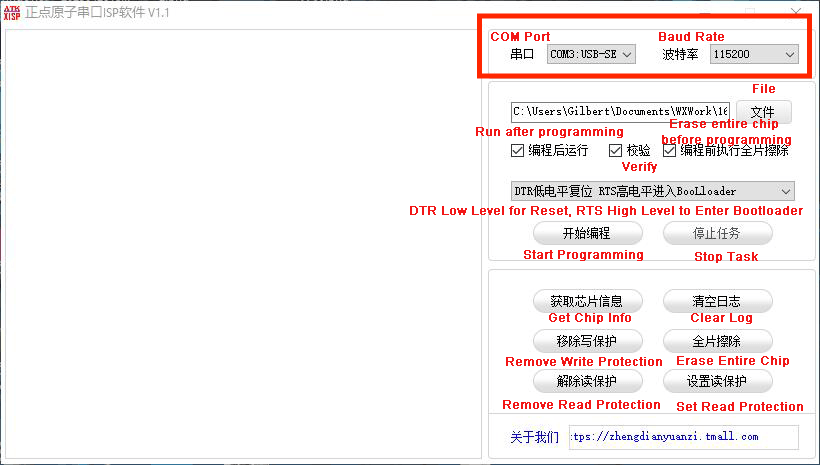

  1. STM32 Program Download
(1) Connect the Type-C cable to the Type-C port on the STM32 controller. Make sure to use the UART1 port as shown in the figure below and plug the other end into the USB port of the computer.
(2) Open the Device Manager on the computer and check the COM port number under the “Ports” section.

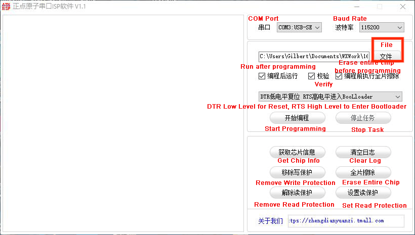

(3) Launch the ATK-XISP software, select the corresponding COM port, and set the baud rate to 115200.
(4) Configure the software as shown in the image below.
(5) Click the File button on the software interface, select the file “Appendix\06 STM32 Program Files\01 STM32 Controller Face Recognition Example\RosRobotControllerM4-armclang\MDK-ARM\RosRobotControllerM4\RosRobotControllerM4.hex” for programming.
(6) Click the Start button on the page to flash the generated hex file onto the STM32 main control board. Wait for the flashing process to complete successfully.

  • Project Outcome
When WonderLLM detects a face, the controller will print find face on serial port 3, with a baud rate of 115200.

  • Sensor Wiring
(5) Click the File button on the software interface, select the file “Appendix\06 STM32 Program Files\02 STM32 Controller Color Recognition Example\RosRobotControllerM4-armclang\MDK-ARM\RosRobotControllerM4\RosRobotControllerM4.hex” for programming.
  • Project Outcome
  1. When WonderLLM detects red, the controller will print COLOR_1 in the serial monitor.
  2. When WonderLLM detects green, the controller prints COLOR_2 in the serial monitor.

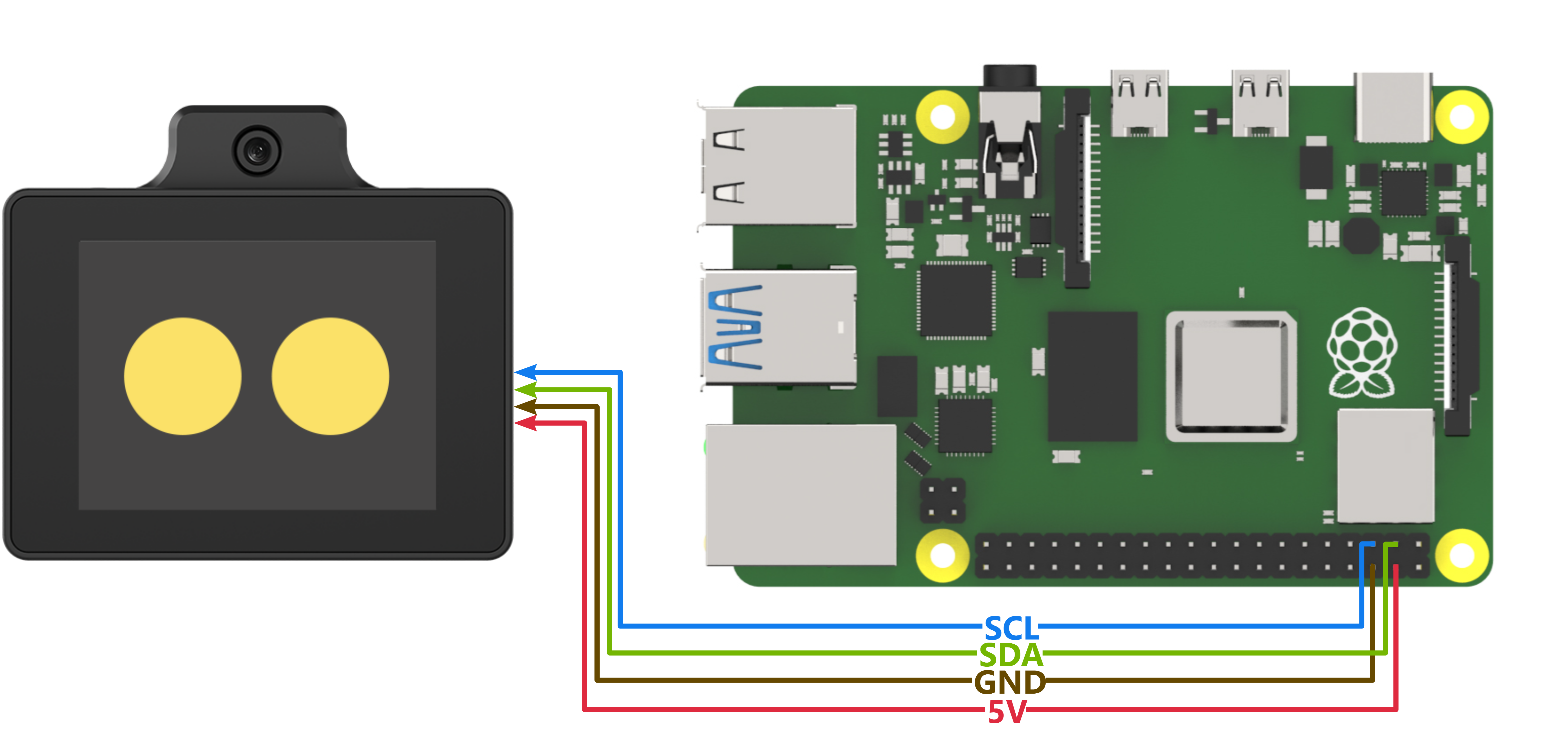

The connection between the WonderLLM module and the Raspberry Pi main control board is as shown below:

  1. Importing and Running the Program

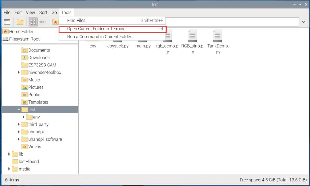

(1) First, power on the Raspberry Pi and connect to it from the PC using VNC or other methods.
(2) Upload the example file from “Appendix\07 Raspberry Pi Program Files\01 Raspberry Pi Face Recognition Example” in the same directory as this document to any path on the Raspberry Pi using SSH or other methods.
(3) In the menu bar, click: “TOOLS” – “Open Current Folder in Terminal” to open the command line in the current directory.

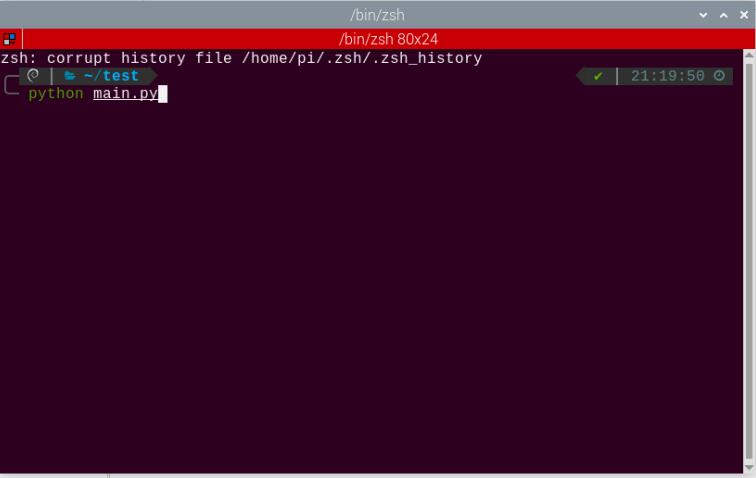

(4) Enter the following command in the command line to run the program:
python main.py

  • Sensor Wiring
(2) Upload the example file from “Appendix\07 Raspberry Pi Program Files\02 Raspberry Pi Color Recognition Example” in the same directory as this document to any path on the Raspberry Pi using SSH or other methods.
python main.py

(2) Open the “Appendix\ 03 WonderLLM Program\ColorDetection\ ColorDetection.ino” located in the same directory as this document.
  • Project Outcome

  • Sensor Wiring
(2) Upload the example file from “Appendix\07 Raspberry Pi Program Files\03 Raspberry Pi Line-following Recognition Example” in the same directory as this document to any path on the Raspberry Pi using SSH or other methods.
python main.py
  • Project Outcome
