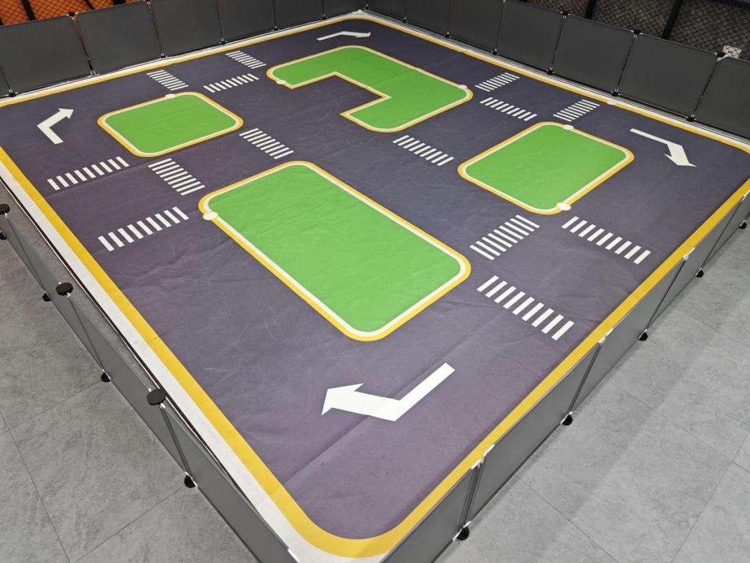

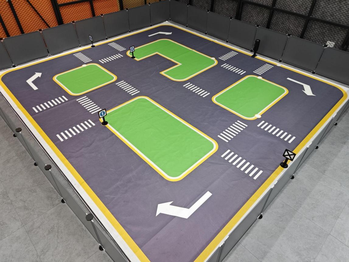

Prior to commencing autonomous driving, please follow the steps below to set up the map.
  • Setup Instructions
(1) Map Setup
To begin, ensure that the site is situated on a flat and spacious ground, and verify that there is ample lighting surrounding the area, as illustrated in the image below:
IMG_20231010_111158(1)
Place the robot at the start point as pictured.
IMG_256
As the robot advances, it will navigate along the yellow line bordering the map, and it can dynamically adjust its posture based on the lane lines in real-time.

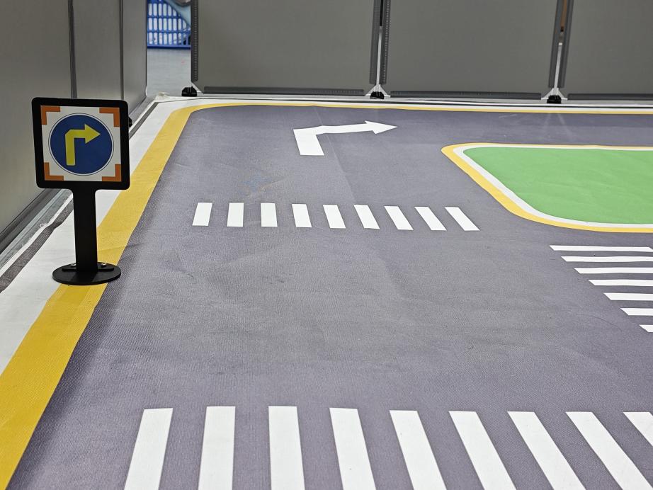

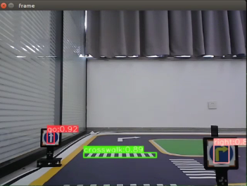

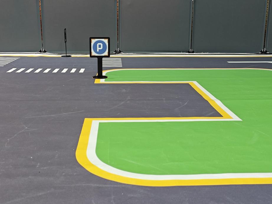

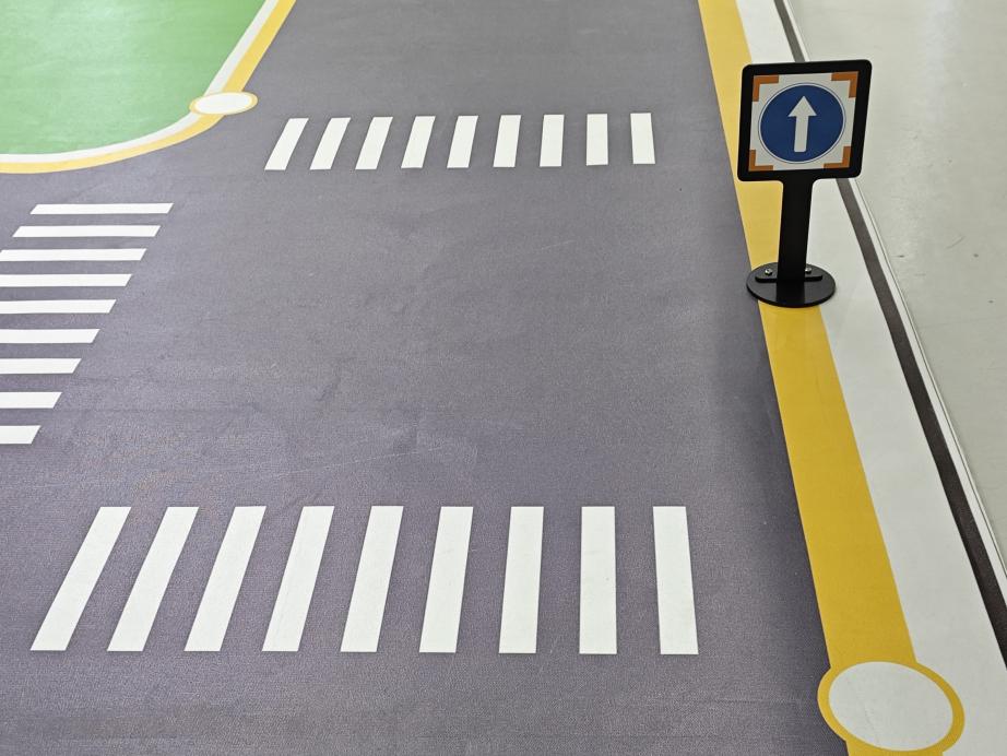

(2) Road Signs Setup
In the game of autonomous driving, a total of 4 waypoints need to be placed: 2 for straight driving, 1 for right turn, and 1 for parking. Please refer to the following image for the specific placement positions.
Ensure accurate placement!!
Go straight: instruct the robot car to go forward.
IMG_20231010_110334(1) IMG_20231010_154416(1)
Turn right: Instruct the robot car to turn right.
Park: Command the robot car to park.
The purpose of the road signs is to guide the car during its journey. Once the car recognizes a road sign, it will perform the appropriate actions. Additionally, the car will slow down as it approaches a pedestrian crosswalk.

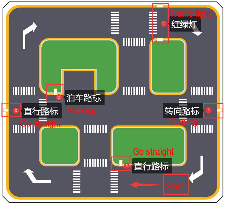

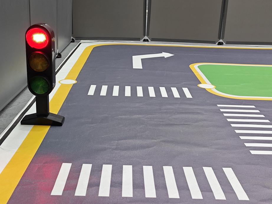

(3) Traffic Light Setup
In the game of the autonomous driving function, only one traffic light needs to be placed. The exact placement location is illustrated in the figure below:
Traffic light props are utilized to replicate real-world traffic lights on roads. When the car detects the traffic light, it will adhere to the “stop on red light, go on green light” rule.

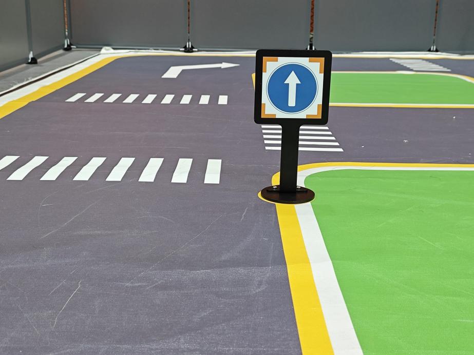

Once all venue props are arranged, refer to the following picture for setting up the venue environment:
  • Notice:
(1) Ensure that the site has adequate lighting, preferably natural ambient light. Avoid strong direct light sources and colored lights, as they may hinder overall recognition. Pay attention to this aspect when setting up the site.
(2) While laying out and using the equipment, ensure proper care and protection of the props on the site. In case of incomplete maps or signs, or if the traffic light is damaged and cannot function properly, promptly contact our after-sales personnel to purchase replacements to prevent any disruptions to the recognition process.

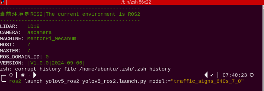

(4) In the command line terminal, enter the command and press “Enter”.
ros2 launch examplt self_driving.launch.py onpy_line_follow:=true
(5) Open a new command line terminal. Execute the command to open the interface for live camera feed.
rqt
(6) If you need to terminate the game, press ‘Ctrl+C’. If the game cannot be terminated, please retry.

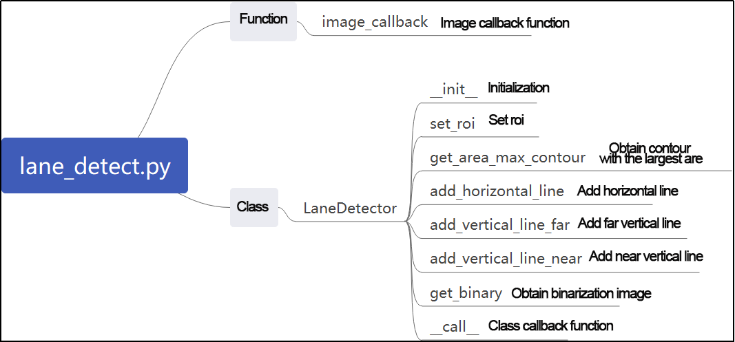

11.2.5 Program Analysis
The source code of this program is saved in /home/ubuntu/ros2_ws/src/example/example/self_driving/lane_detect.py
Function:
image_callback:

Image callback function: used to read camera node.
Class:

(8) Open a new command line terminal. Enter the command to enable the camera node.
ros2 launch yolov5_ros2 yolov5_ros2.launch.py model:="traffic_signs_640s_7_0"

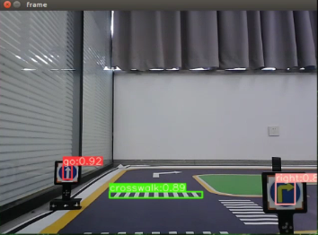

(10) Open a new command line terminal. Execute the command to open the interface for live camera feed.
rqt
(11) Position the road sign in front of the camera, and the robot will recognize the road sign automatically. If you need to terminate this game, press “Ctrl+C”. If it fails, please try again.
In the event that the model struggles to recognize traffic-related signs, it may be necessary to lower the confidence level. Conversely, if the model consistently misidentifies traffic-related signs, raising the confidence level might be advisable.

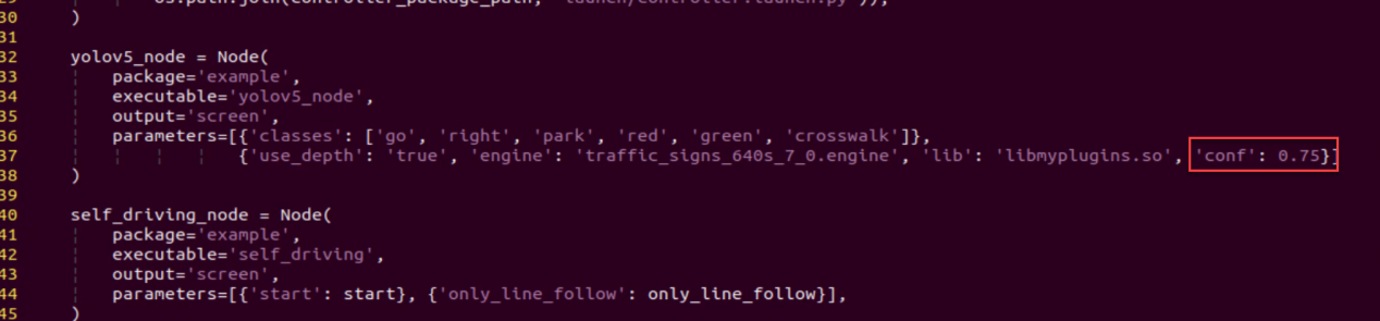

(13) Execute the command to open the game program.
vim self_driving.launch.py
The red box represents the confidence value, which can be adjusted to modify the effectiveness of target detection.

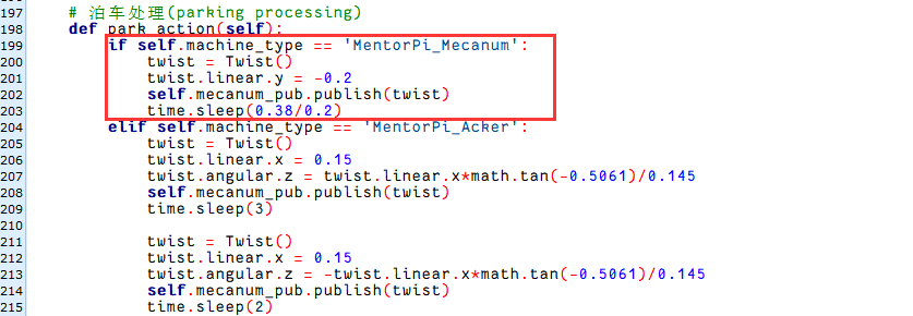

11.6.5 Parameter Adjustment
If the robot stops upon recognizing the parking sign and the parking position is not optimal, adjustments to the parameters in the program source code can be made.
(2) Execute the command to navigate to the directory containing game programs.
cd ros2_ws/src/example/example/self_driving/
(3) Run the command to access the source code.
vim self_driving.py
(4) Press the “i” key to enter insert mode and locate the code within the red box. Adjusting the parameters within the red box allows you to control the starting position for the robot to initiate the parking operation. Decreasing the parameters will result in the robot stopping closer to the zebra crossing, while increasing them will cause the robot to stop further away. Once adjustments are made, press the “ESC” key, type “:wq”, and press Enter to save and exit.
You can adjust the parking processing function to alter the parking position of the robot. Initially, the parking action sets the linear speed in the negative direction of the Y-axis (right of the robot) to 0.2 meters per second, with a forward movement time of (0.38/2) seconds. To position the robot in the ideal location on the left side of the parking space, modify the speed and time accordingly.

  • Map Setup
To ensure accurate navigation, place the map on a flat, smooth surface, free of wrinkles and obstacles. Position all road signs and traffic lights at designated locations on the map, facing clockwise. The starting point and locations of road signs are indicated below:

11.7.5 Program Analysis
The source code for this program can be found at:/home/ubuntu/ros2_ws/src/example/example/self_driving/self_driving.py

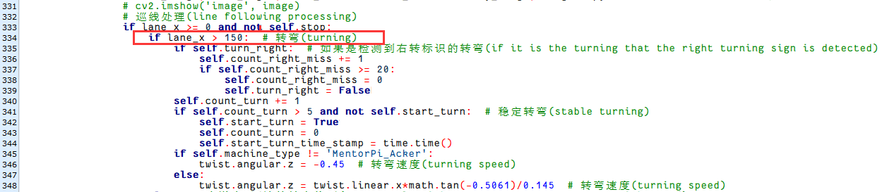

        self.pid = pid.PID(0.4, 0.0, 0.05)

park_action:
187
188
189
190
191
192
193
194
195
196
197
198
199
200
201
202
203
204
205
206
207
208
209
210
211
    # parking processing
    def park_action(self):
        if self.machine_type == 'MentorPi_Mecanum':
            twist = Twist()
            twist.linear.y = -0.2
            time.sleep(0.38/0.2)
        elif self.machine_type == 'MentorPi_Acker':
            twist = Twist()
            twist.linear.x = 0.15
            twist.angular.z = twist.linear.x*math.tan(-0.5061)/0.145
            time.sleep(3)
            twist = Twist()
            twist.angular.z = -twist.linear.x*math.tan(-0.5061)/0.145
            time.sleep(2)
            twist = Twist()
            twist.linear.x = -0.15
            time.sleep(1.5)
Parking logic, which will run two different parking strategies based on two different chassis types.

(1) The robot exhibits inconsistent performance during line patrolling, often veering off course.
Adjust the color threshold to better suit the lighting conditions of the actual scene. For precise instructions on color threshold adjustment, please consult “ROS+OpenCV Lesson” for detailed guidance.
(2) Modify the line patrol processing code
Navigate to the game program path by entering the command.
cd ~/ros2_ws/src/example/example/self_driving/
vim self_driving.py
The red box denotes the lane’s center point, which can be adjusted to fine-tune the turning effect. Decreasing the value will result in earlier turns, while increasing it will cause later turns.
(3) The parking location is suboptimal.
You can adjust the parking processing function or modify the starting position of the parking operation.
(4) Inaccurate traffic sign recognition.
Adjust the target detection confidence. For detailed instructions, please refer to “11.7.3 Operation Steps” for comprehensive learning.
